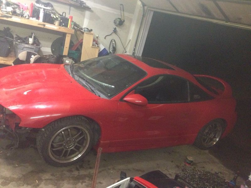

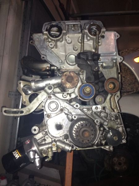

How it all started!!:(
1998 RED
Auto GSX

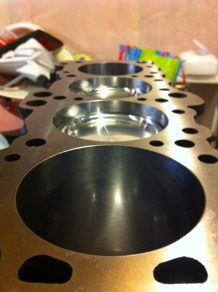

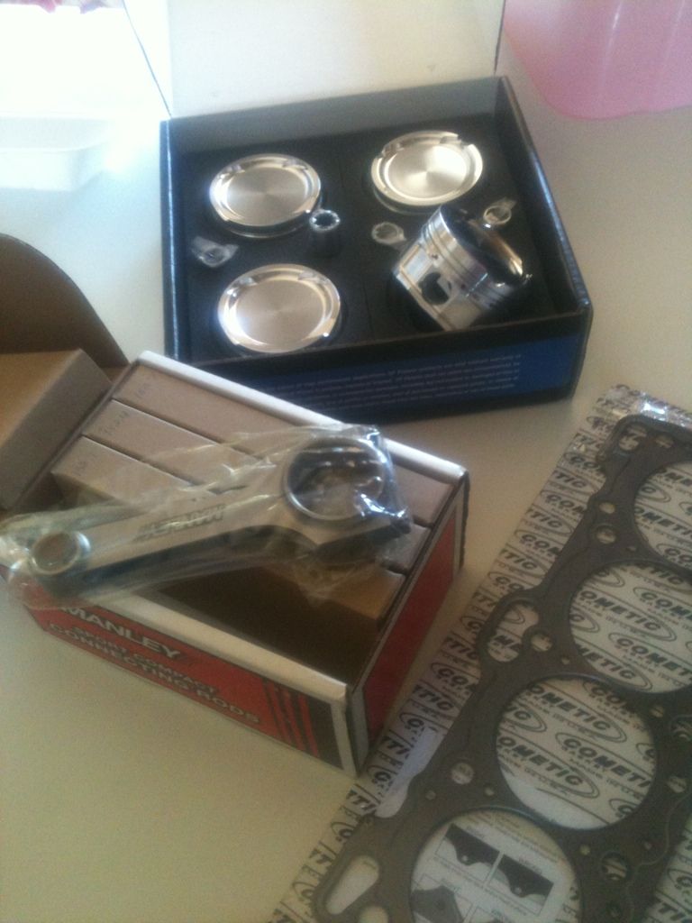

Shortblock

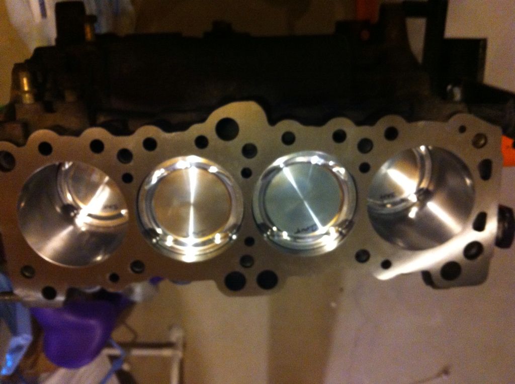

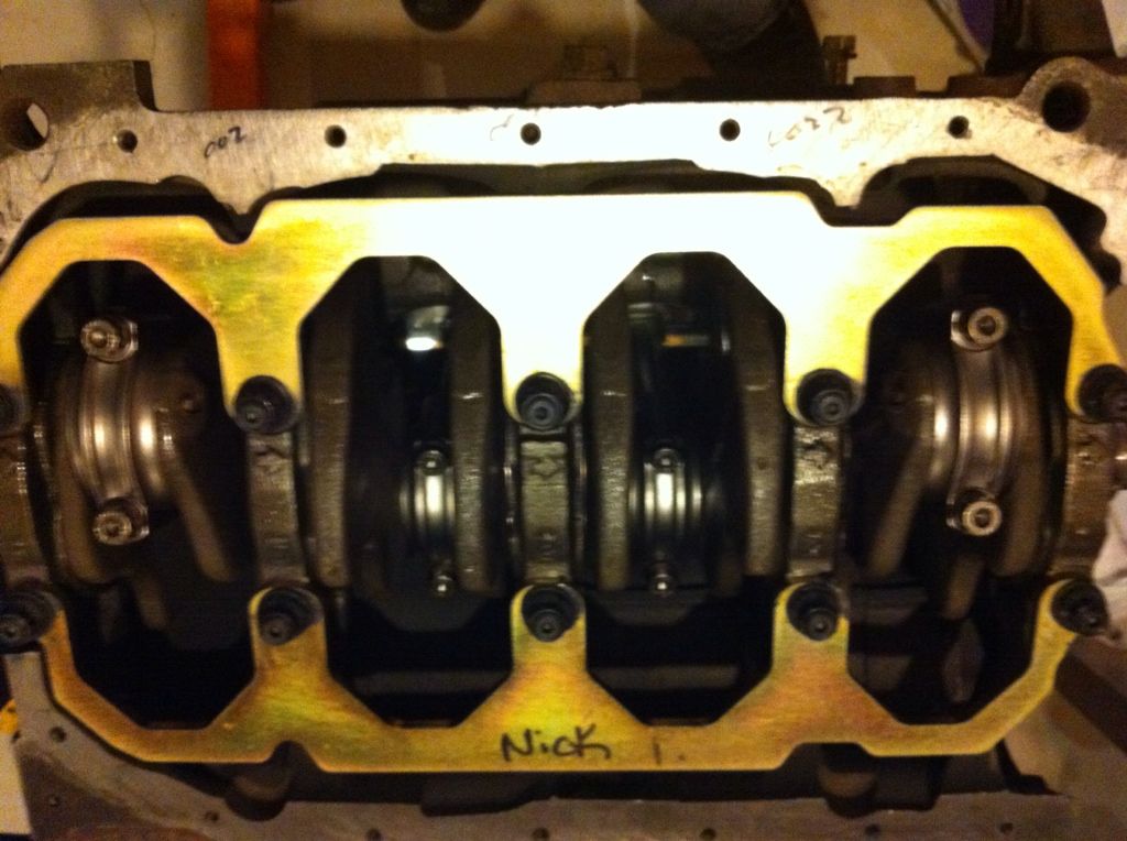

2.4 g4cs .40 over 87.5mm
Manley H beams w/22 wrist pins
CP custom 9:5:1 87.5mm
Acl race bearings (main,rod)
Kiggly main girdle
Arp mains (line,honed)
BSE
AMS race shaft
Mighty max FF OFH
Maximal sandwich plate (external oil cooler)

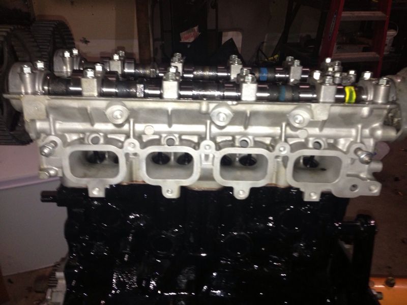

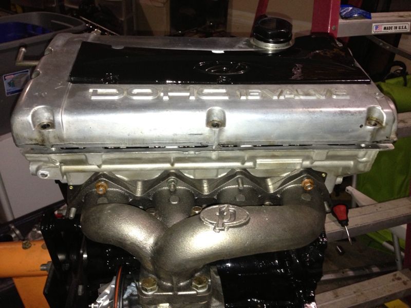

Head
1G no porting
GSC springs/evo retainers
GSC S2
1mm over exhaust/intake valves (unknown brand)
L19 head studs
Cometic Custom MLS
Kiggly HLA regulator

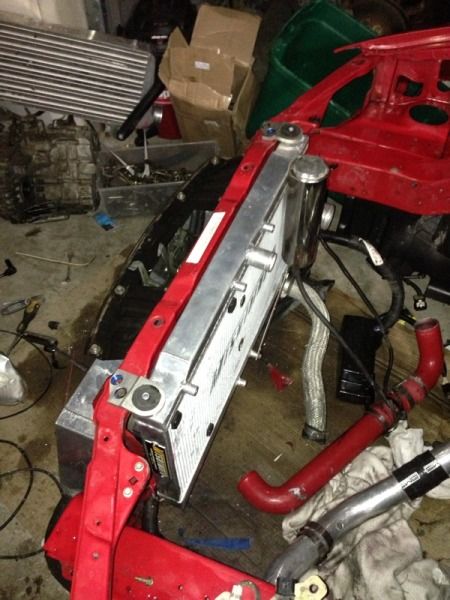

Mishimoto radiator with 2 slimline pushers mounted in front
Mishimoto overflow
B&M oil cooler -8an lines
B&M trans cooler -6an lines

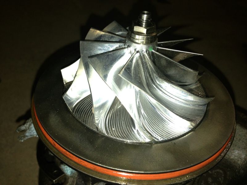

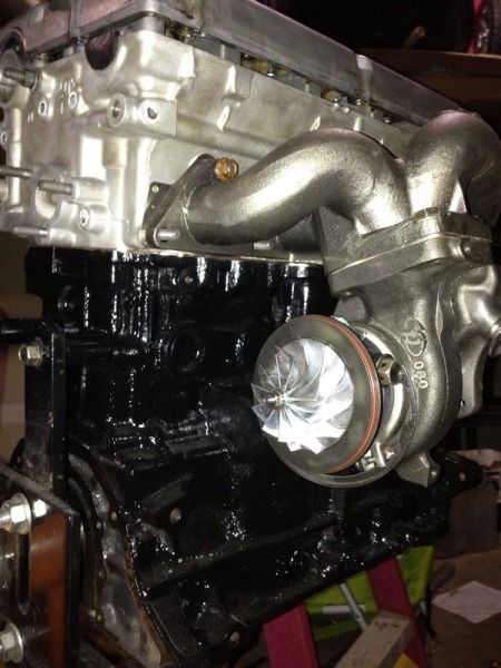

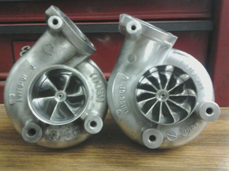

3076 billet wheel
Tdo6h4
FP 8cm hotside
Holset actuator
FP race mani

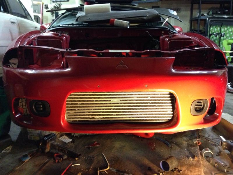

FP 4" non recirc
Vrsf FMIC

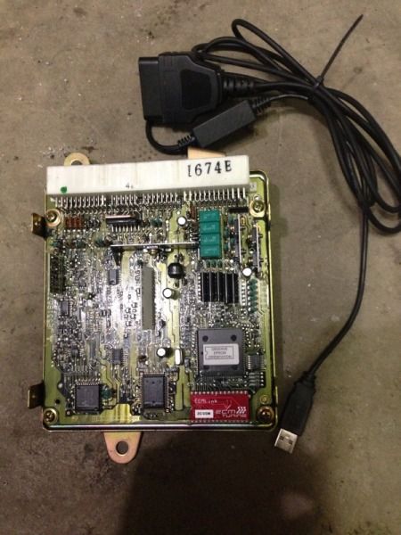

Ecmlink v3

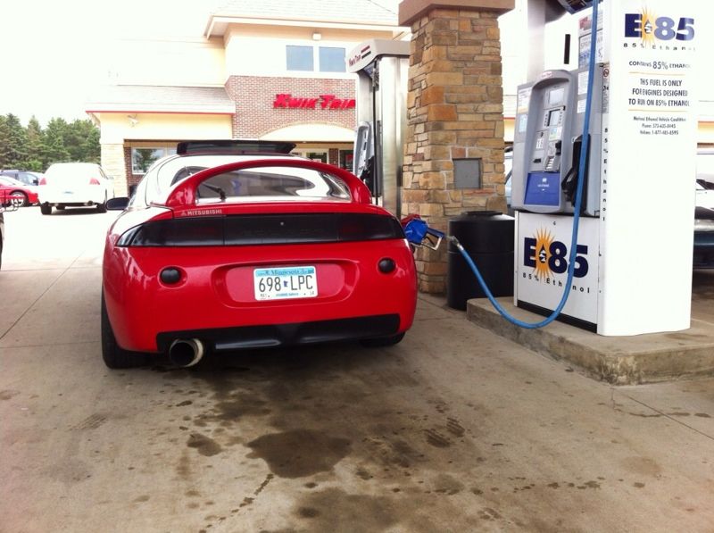

E85

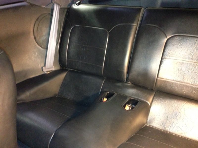

Interior
Black leather seats
Black dash
Black door skins
Black rear speaker covers

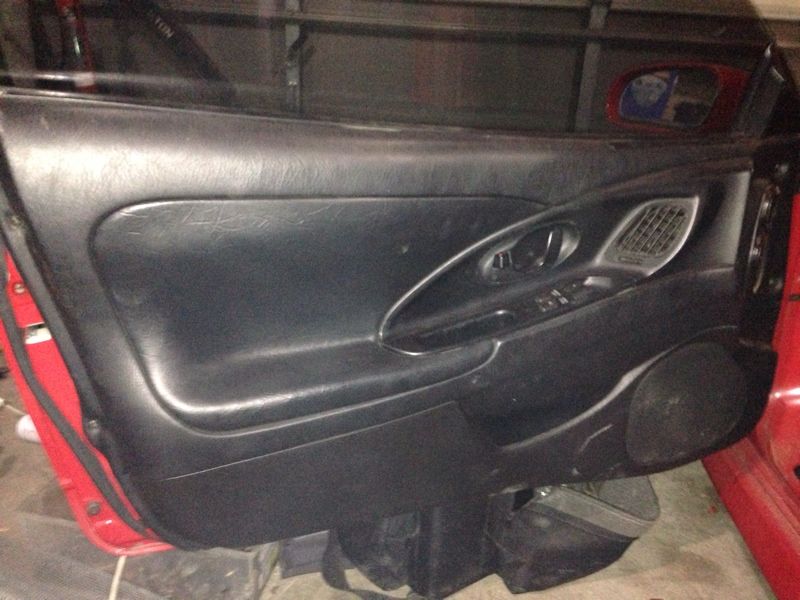

black carpet (DIY)
All other panels that were oem grey are being painted satin black

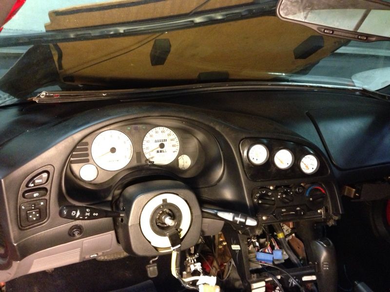

Custom triple gauge pod in place of center vent
Custom gauge pod where radio was
Black suede headliner

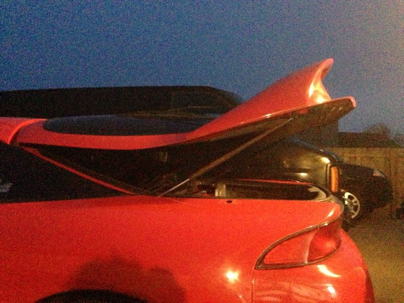

Carbon hatch
FAL poly carbonate hatch window

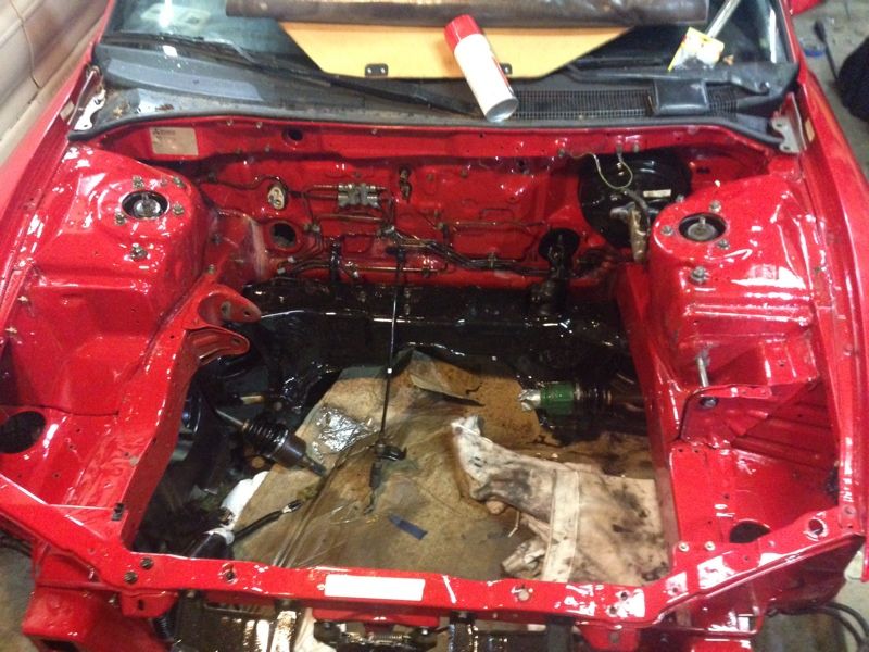

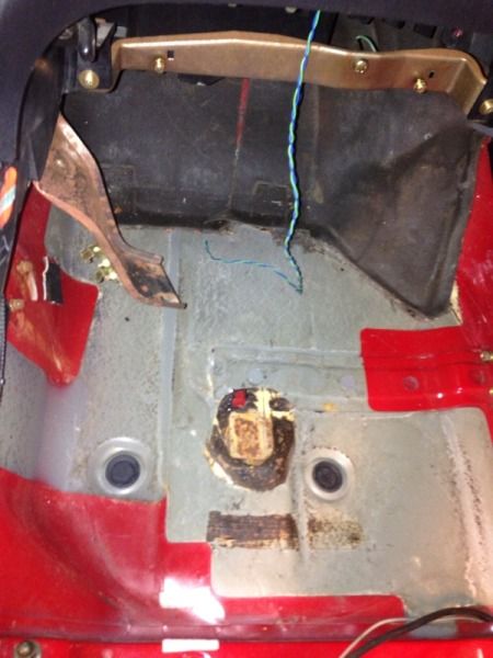

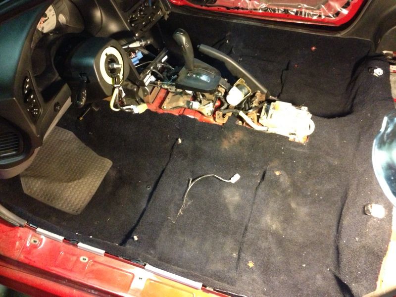

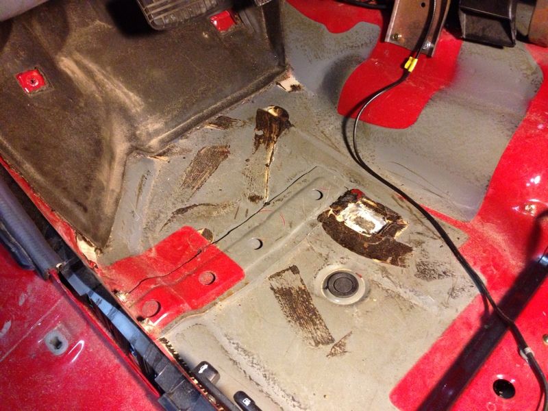

Sound detening removal. Works awesome when cold out peels right up
Still need to swap black belts in

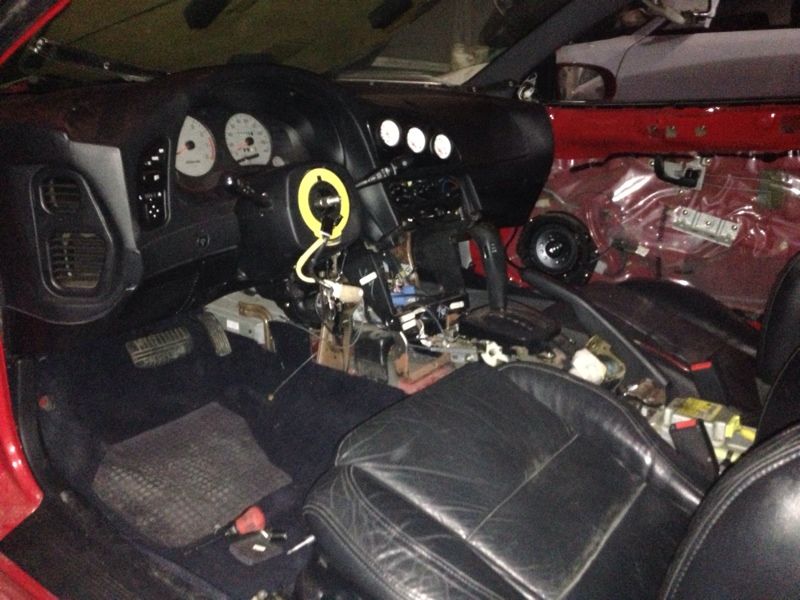

Jeebus that was alot.
Plan is to get well into the tens (10.5-10.7) in almost full weight car
Ill keep updating as I go but car should be ready to start by early may. Just gotta cross fingers as my work schedule is getting busier.

Also picked up v3

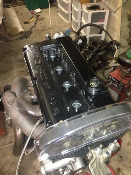

Just gotta order cams and I'm ready to put it together break in motor iron out bugs.

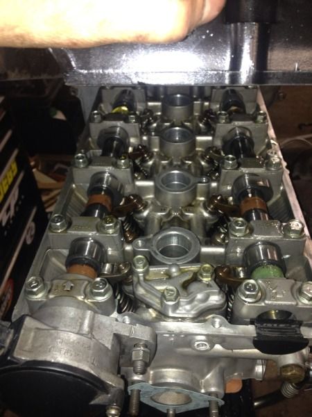

Also bought some gsc s2 cams today just have to go pick them up.

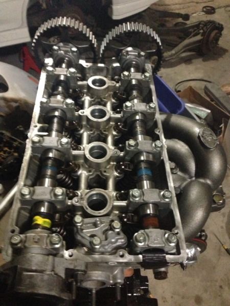

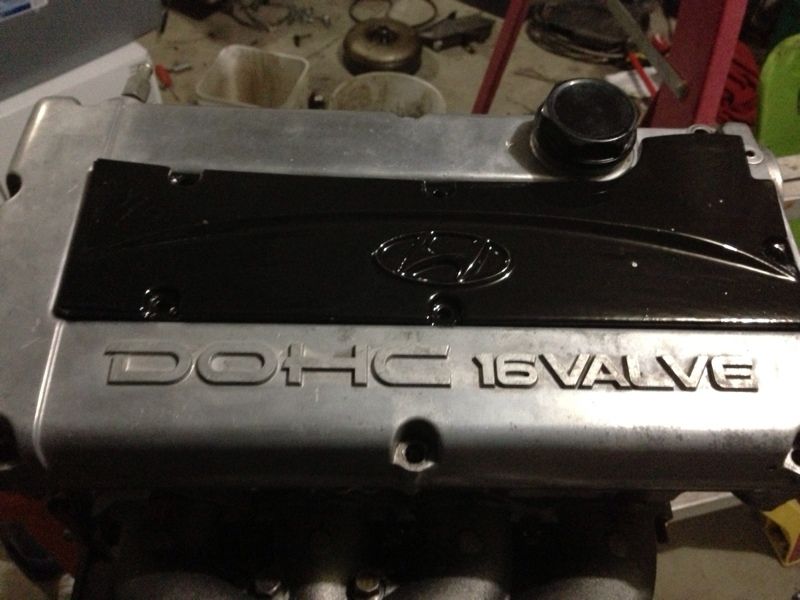

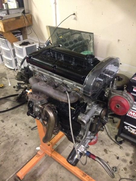

Got the gsc s2 installed and the timing set! Coming along now.

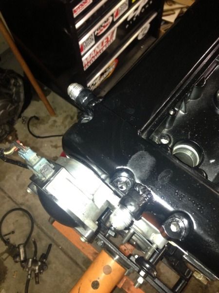

Also got my an fittings welded on my valve cover today.
Also got some injectors off tuners today so I know have everything I should need to get running.
Turbo is kinda a test so not sure. It's supposed to make 450-480 through a 5 spd so maybe 350 through an auto.
Main goal is to make a really big usable powerband.
If the turbo doesn't run a 10 with the stock cover ill be switching to a t3 6266 BB setup.

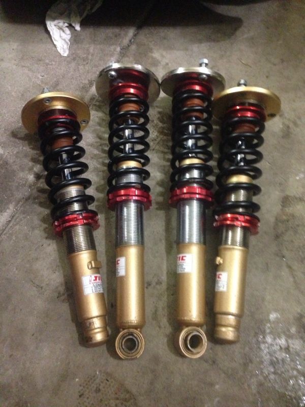

Some more parts came in
Jic coilovers

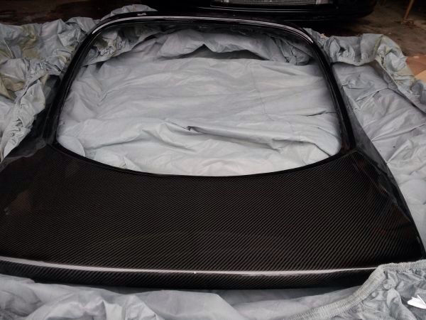

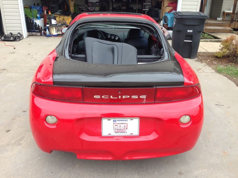

New RTM carbon hatch
Placing order this week for the FAL rear glass

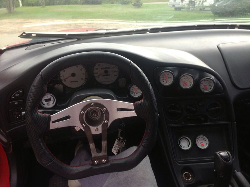

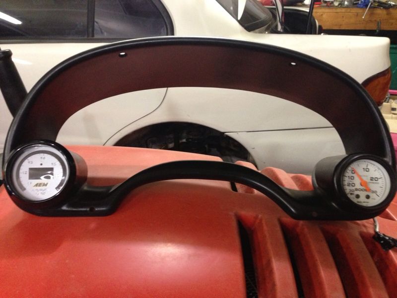

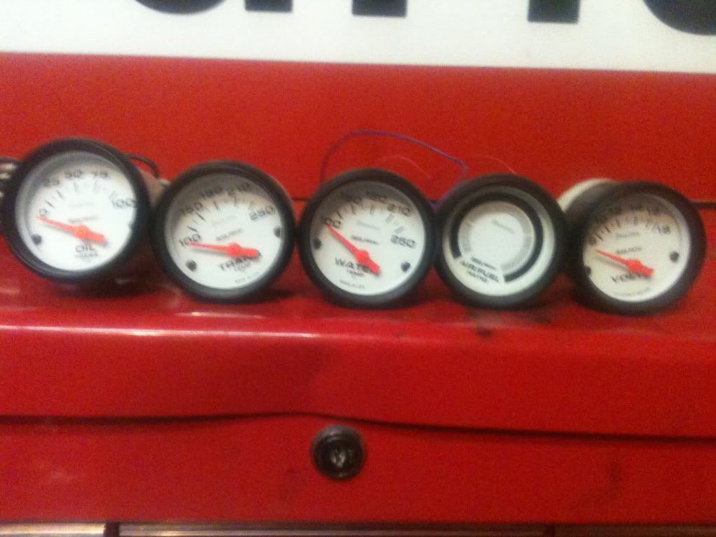

Gauge setup and steering wheel. BECAUSE RACECAR!!!

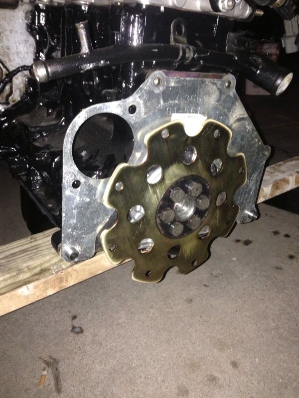

Heading out to get some ATF +4 so at the very least get this tranny mounted to the short block.
Thanks
I gotta pull one of the boosts and put in my auto temp one.
Also just put the narrow band in there to see if I cut the hole right.

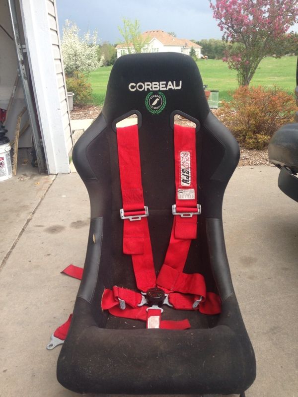

Why the steering wheel? Cause its better than rocking a stock one with airbag for track days.
Also huge thanks to Tyler, Miles and Joel. Got a lot more done than I thought I would which is awesome considering we didn't start doing anything till 6:30 tonight.

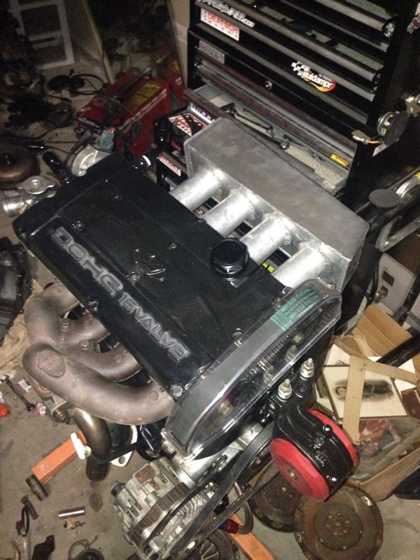

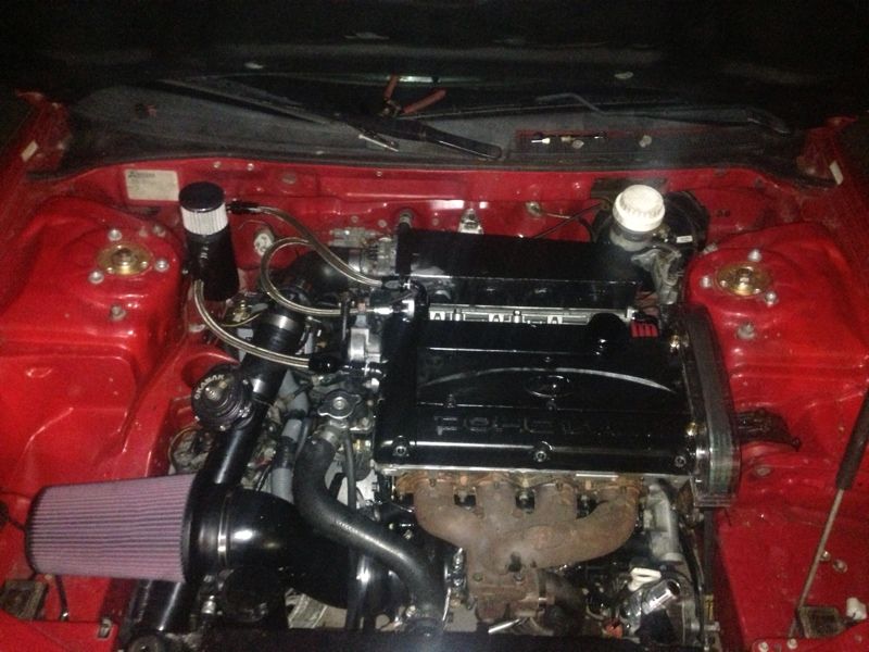

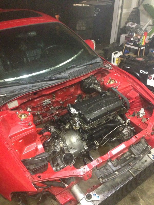

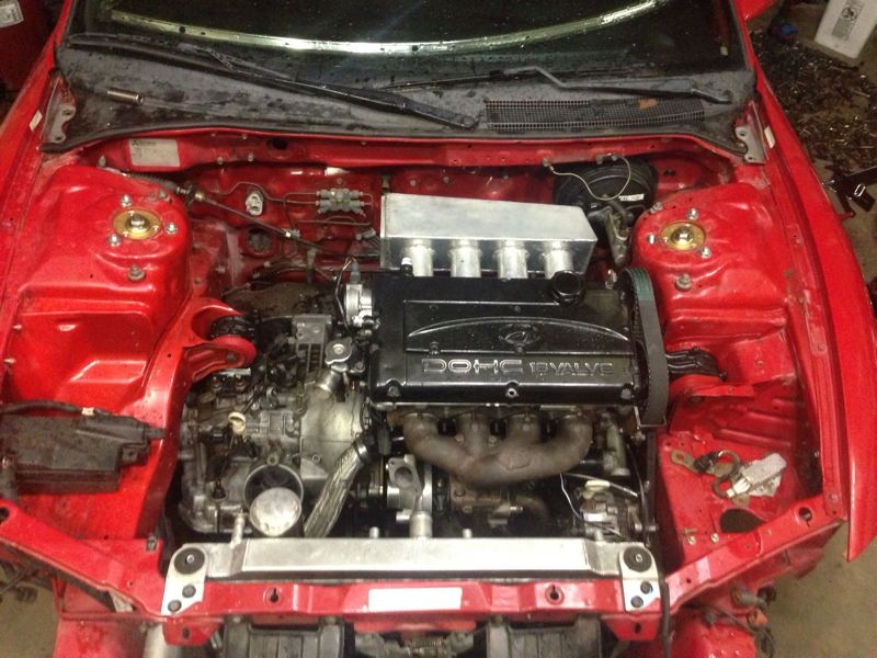

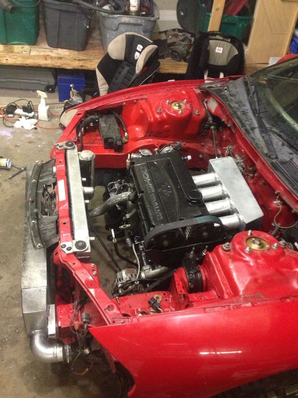

Got the JIC coilovers installed, trans bolted to the motor with the kiggly kit, and the motor installed in the car. Also swapped rear rotors out for the slotted ones I had sitting here.
On to the pics.
Not much left now!

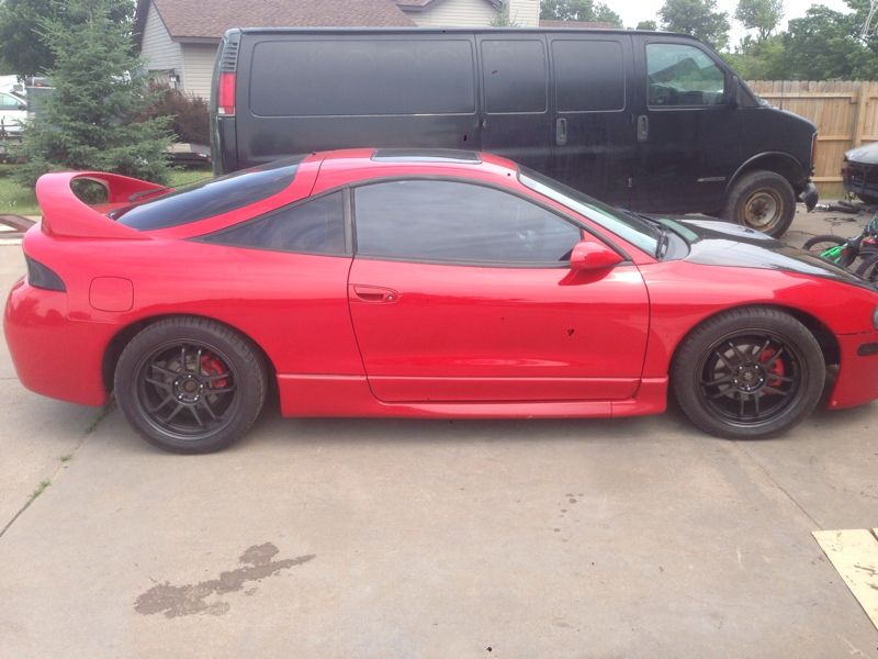

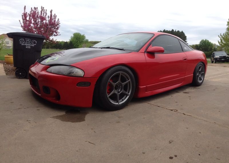

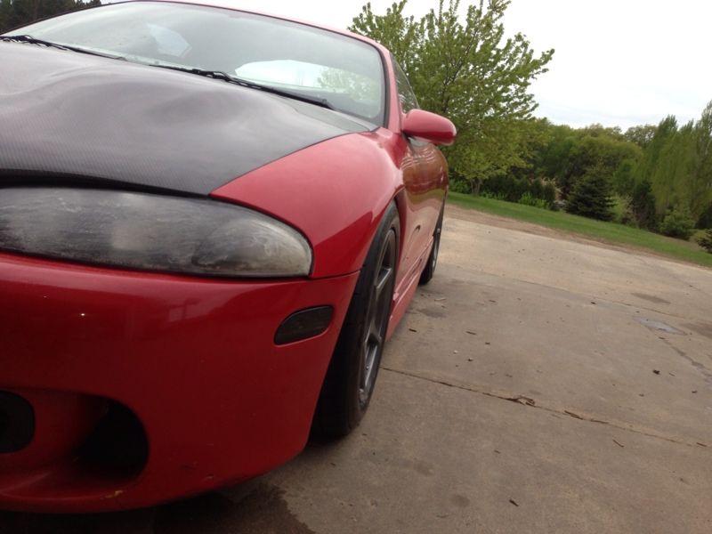

Pictures 5/26/13

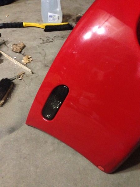

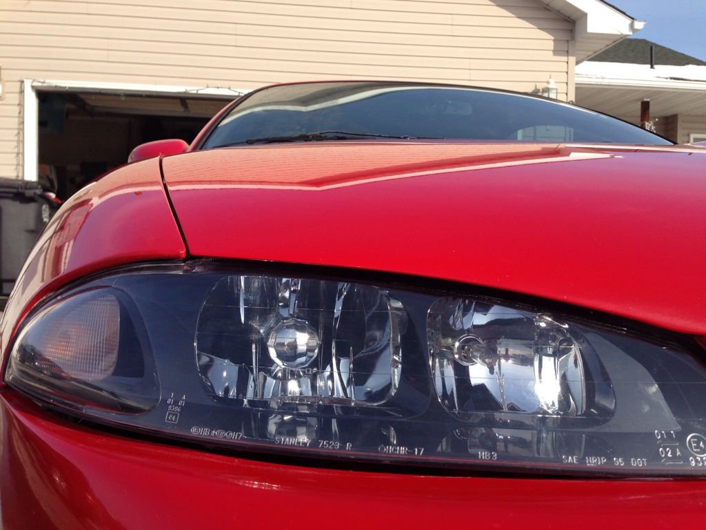

Still have to finish one flush mount on hood, tint headlights, tails and reverse lights. Then the exterior should be finished.
I'm going to be installing the oem fog lights as well. Shouldn't be to hard. People say you can't with the vrsf kit but I'm out to prove them wrong.
Ya sorry for the lack of updates.
The drop was really only for pics. It's sitting much higher now.

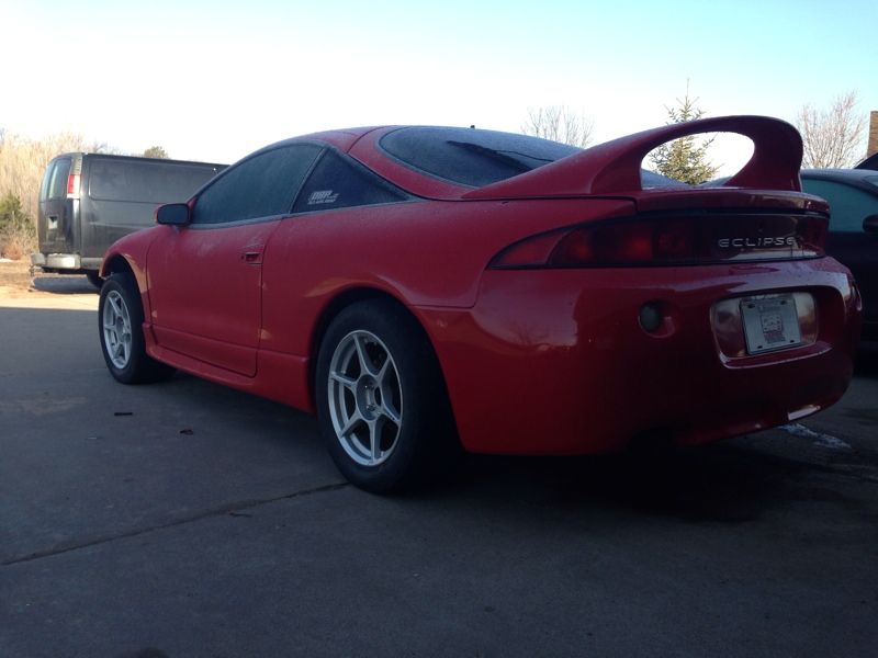

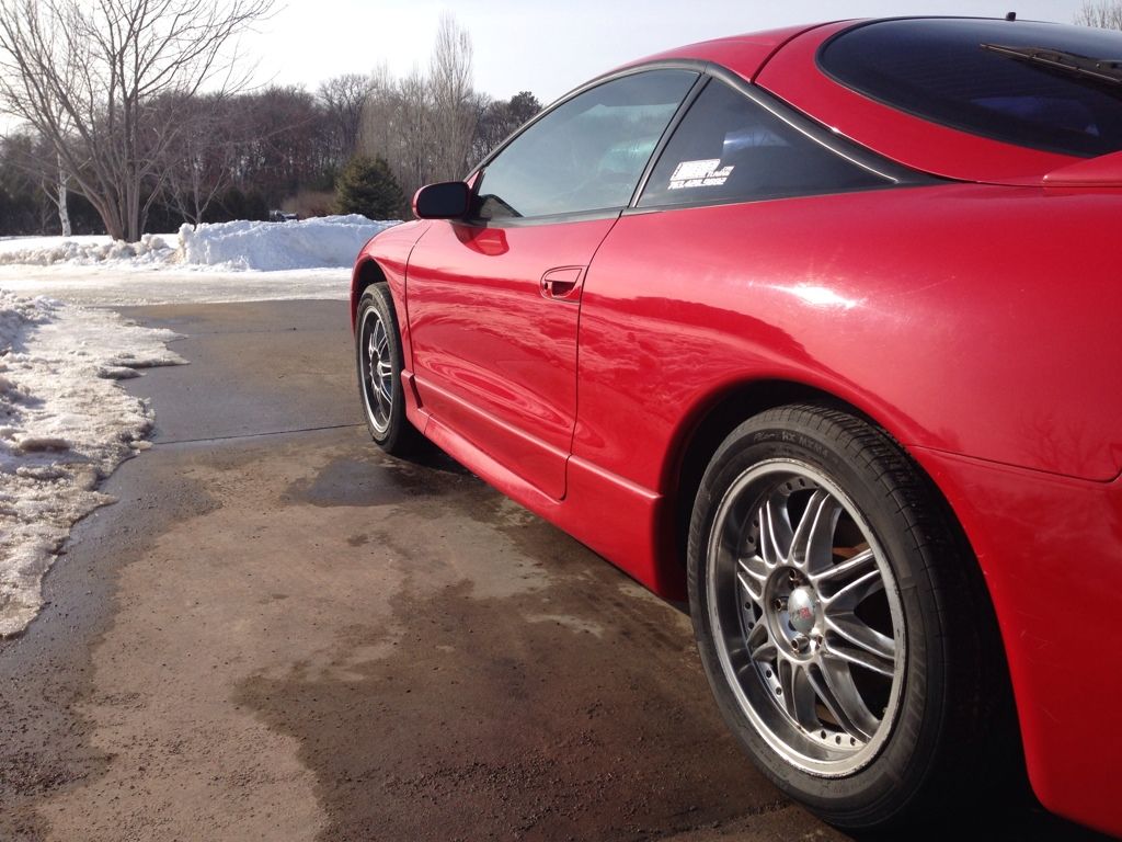

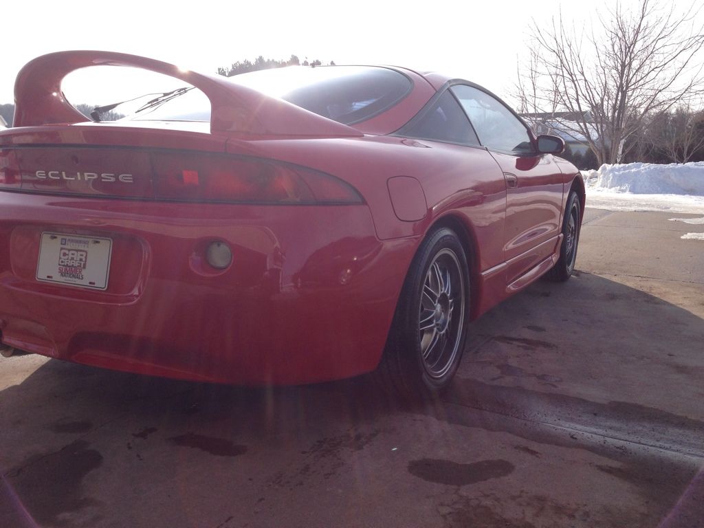

Thanks for liking the car. Here's a few pics
With the Rotas (street setup) on
See post 13 for power.

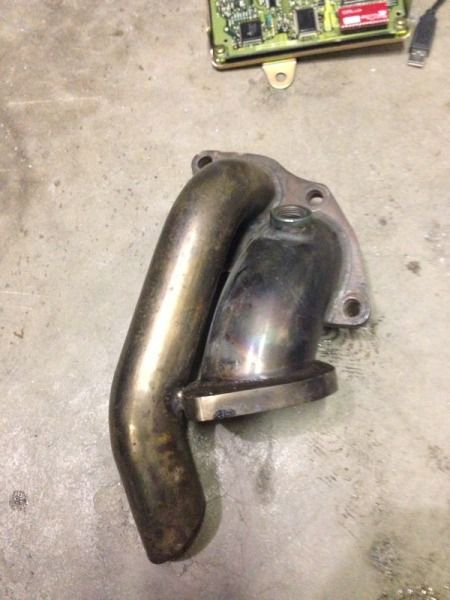

I ditch the stock j cover and put on an 18g cover. Turbo is still the same as in post one though.

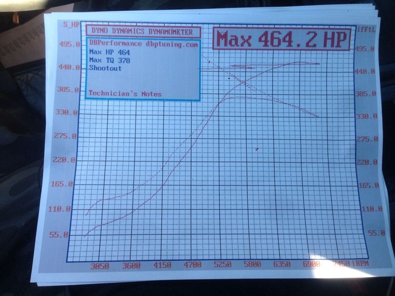

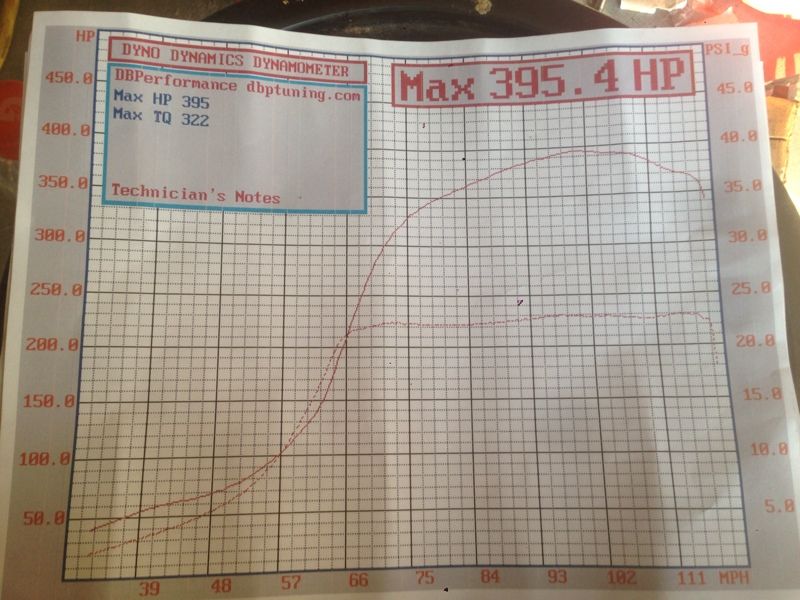

So made it to the dyno. No ill effects minus running out if fuel. Which is fine I surpassed my hp goal with the car with at least 8 lbs of boost left on the table.
So here is a quick run down of the setup.
2.4 fully built
1G head
S2 cams
Gsc beehives
1100 high z
255 hp rewired

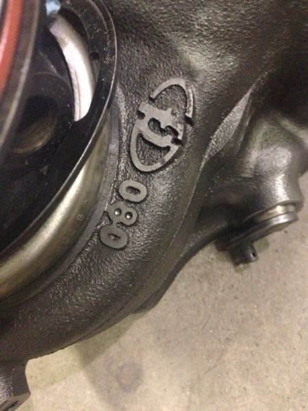

Bolt on 3076 8cm fp hotside tdo6h4 turbine
These #s were through an auto at 22-23 lbs of boost and 17-18 peak timing. Also it's a dyno dynamics (heartbreaker) so first #s are corrected
Shootout
Uncorrected
Plan as of right now is to get to the track and see what it runs.
In the meantime ill be looking for some 2150s and a walbro 450.
Huge thanks to Shane @ DB. I know I was shocked at the #s and the fact I ran out of fuel but I don't think I was the only one.
Next update should be a timeslip
Pointers not really its pretty straight forward. Just follow the directions that kiggly sent.
I'm on a stock converter.
I see 22 by 4500 rpms. We ran out of fuel though so couldn't turn it up.
