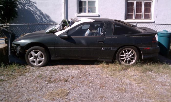

About a year ago i found a 1991 Gst In craigslist For $350... ended up getting it for 260.. good deal.:hellyeah:
We Didn't know what was wrong with the car,
Took it home and got it running for our surprise a spun bearing.OMG

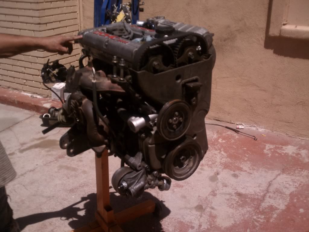

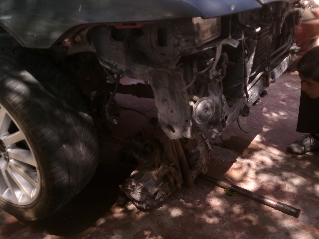

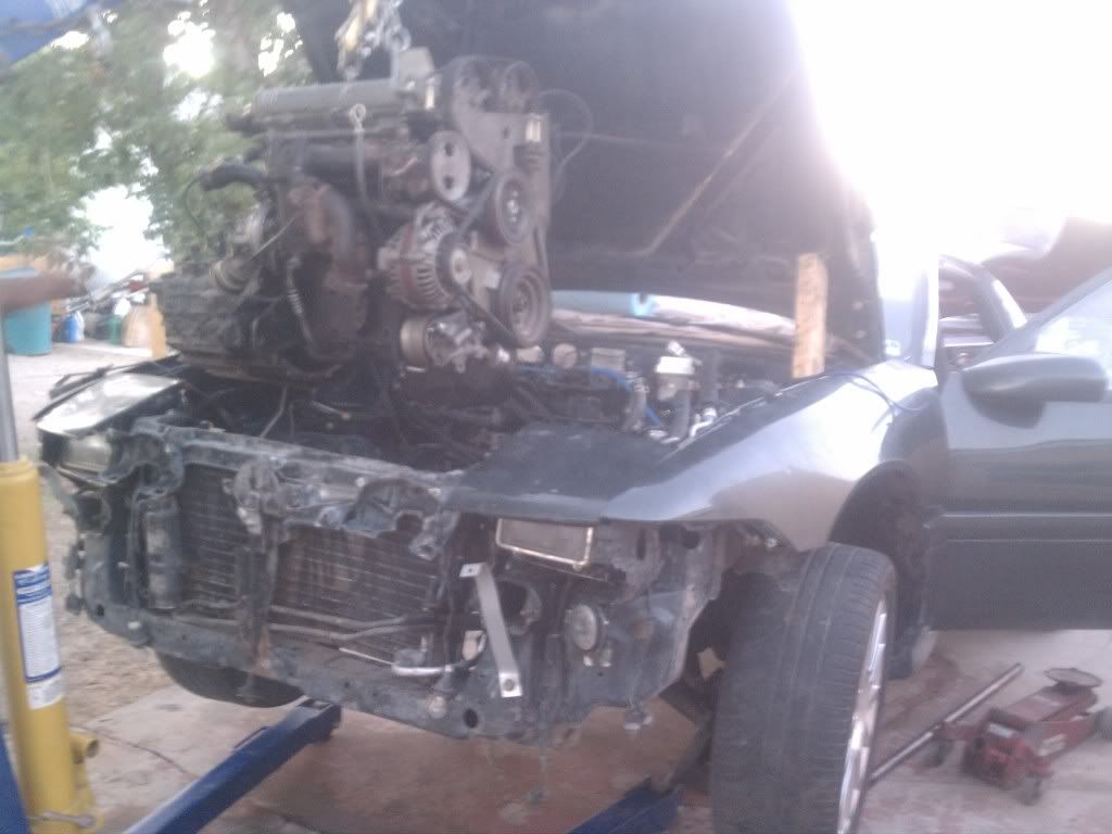

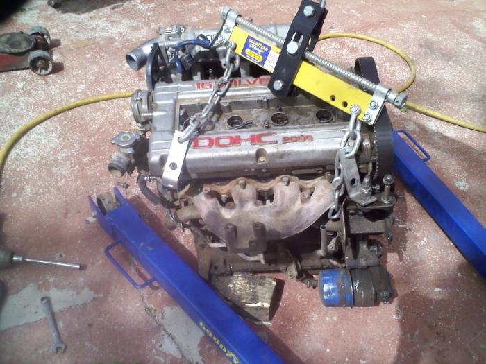

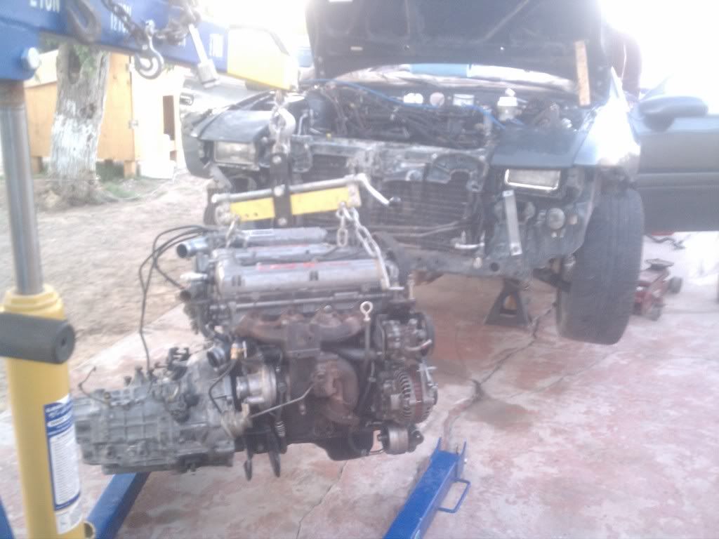

Started buying parts about 10 months ago, at the same time we took the engine/transmission out.

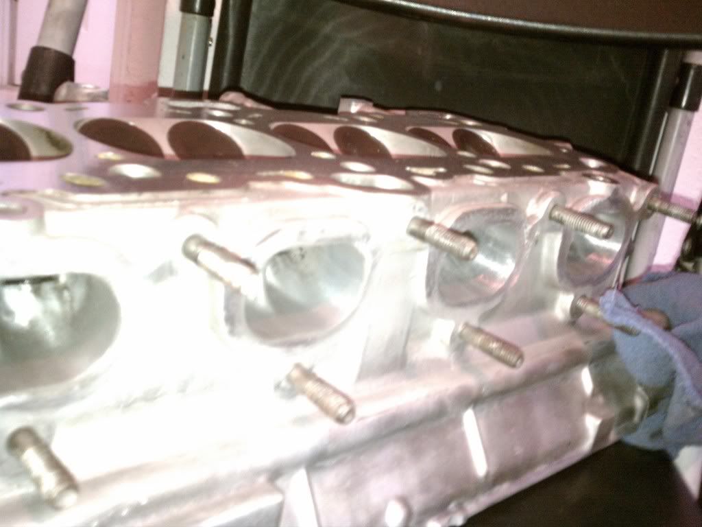

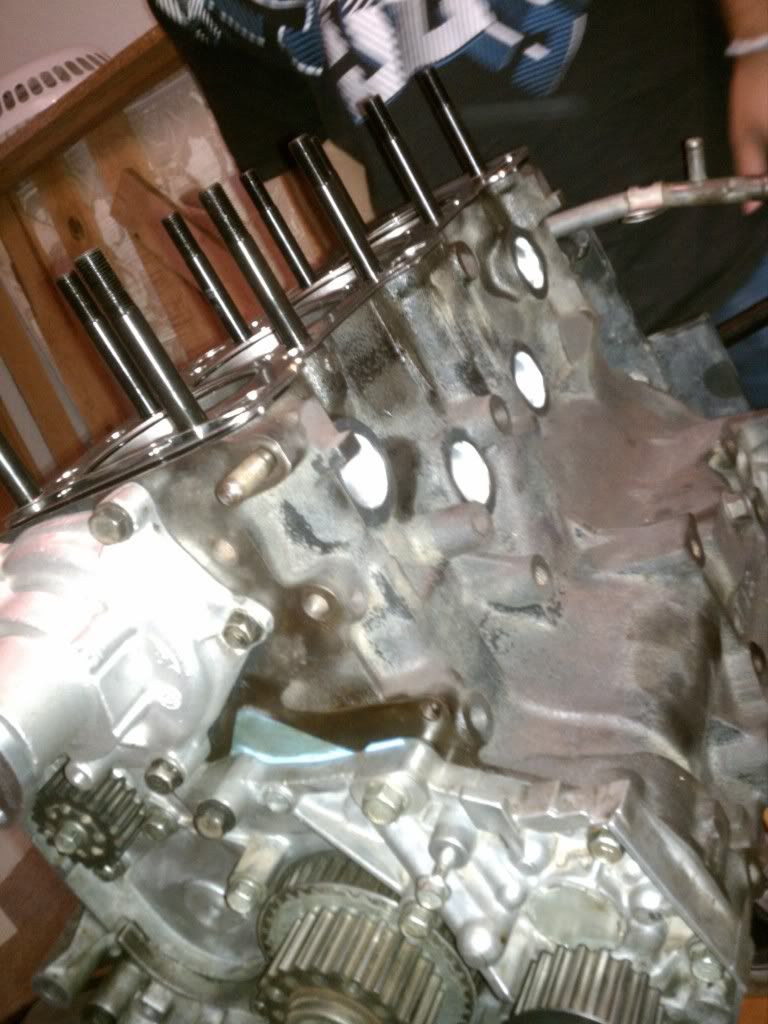

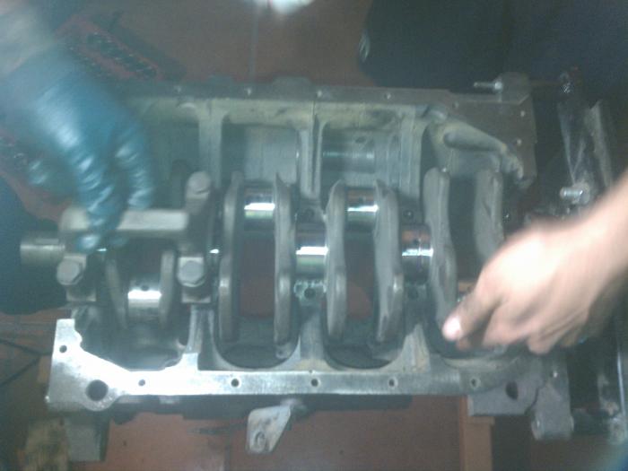

Disasemble the engine and the bearings were not too bad. We took the engine to the machine shop and good thing we know the guy at the machine shop so he gave us all the work for cheap.

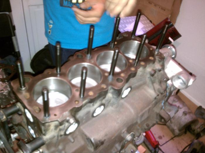

The block was
-hot tank
-over bore to .20
-the deck was mil cut

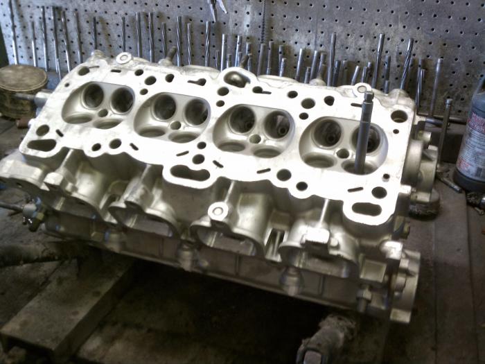

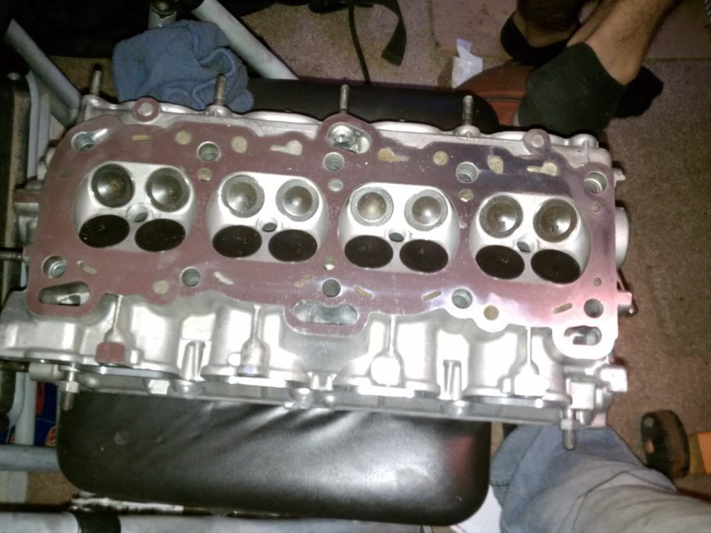

The head was
-pressure tested
-mil cut
-5 angle valve job
-stage 1 port polish

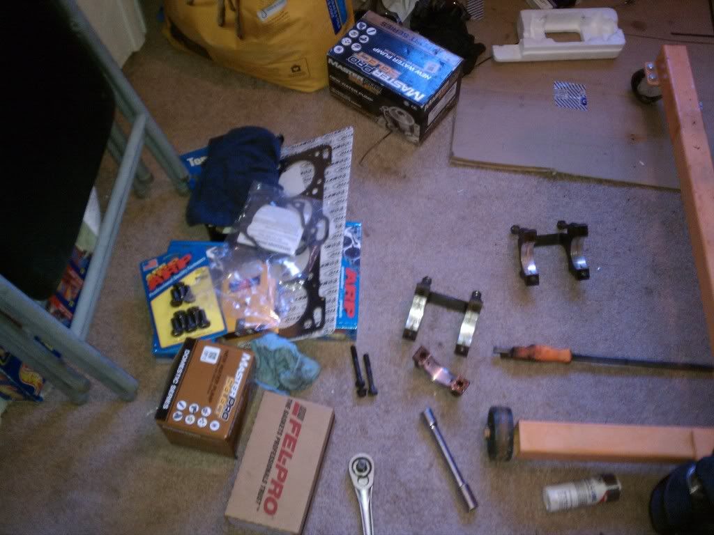

Bought

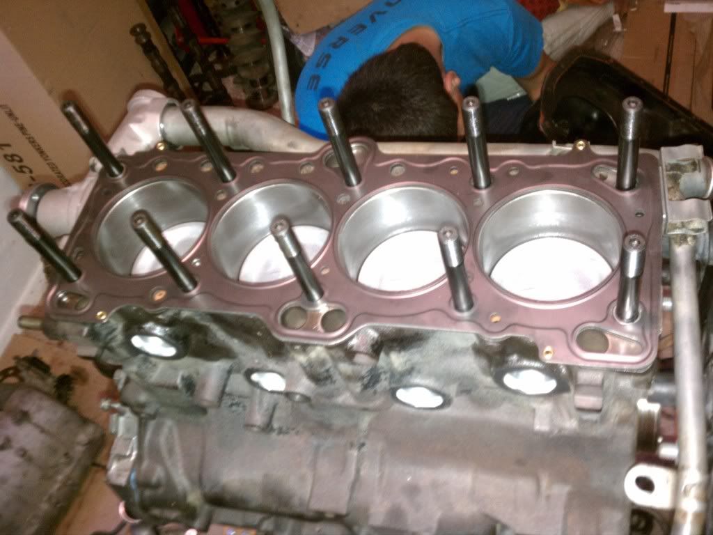

-A set of 1G six bolt rods.
-2G pistons.
-arp head studs, main studs and crank bolts.
-cometic head gasket
-new bearings.
-gates timing kit and new water pump.
-all gaskets were replaced.

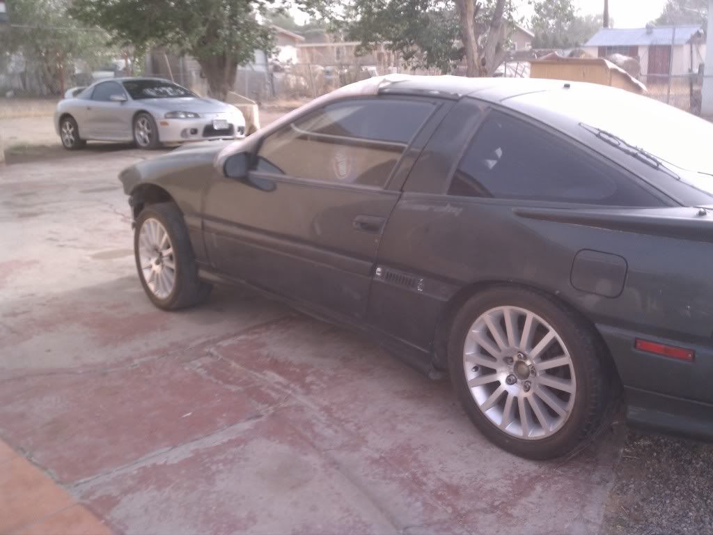

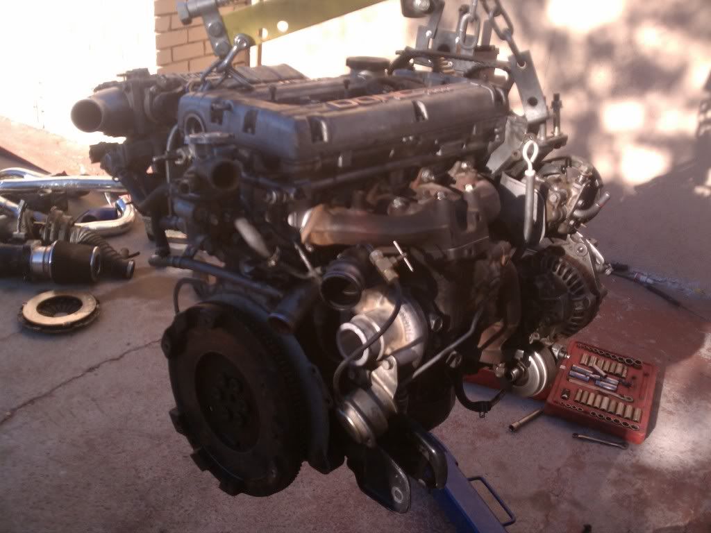

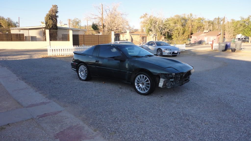

-The day i brought the car home

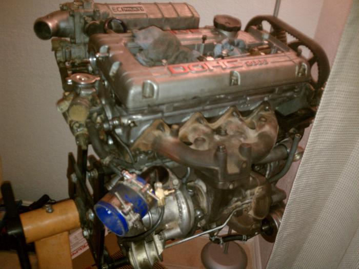

-Very first look at the engine

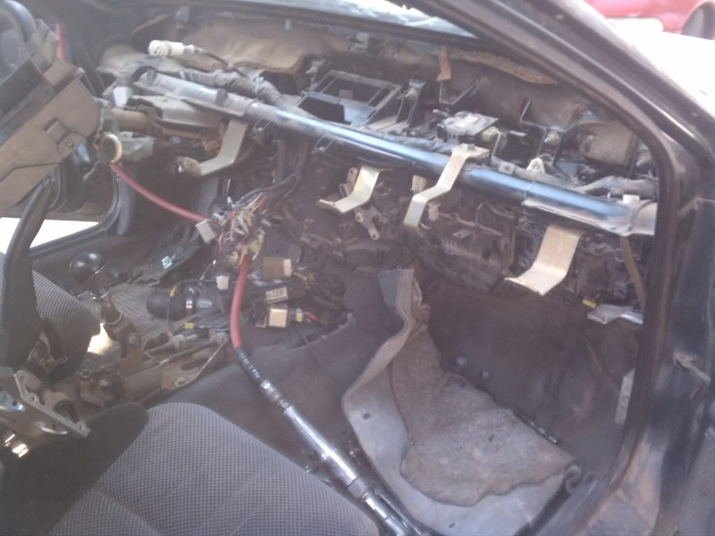

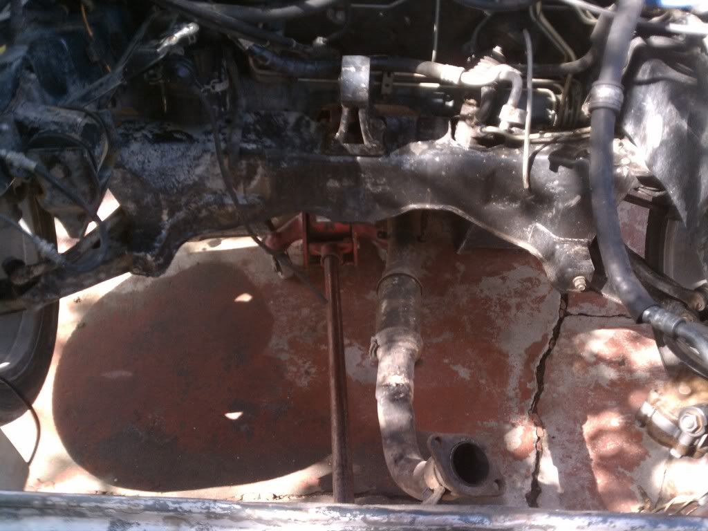

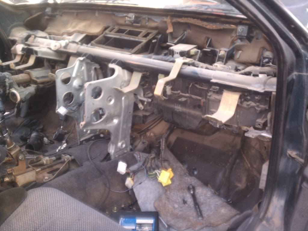

-Engine bay dirty

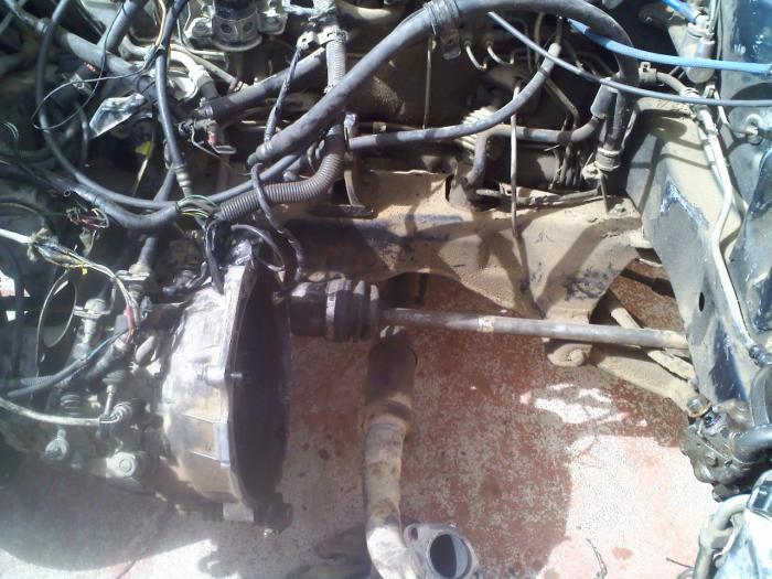

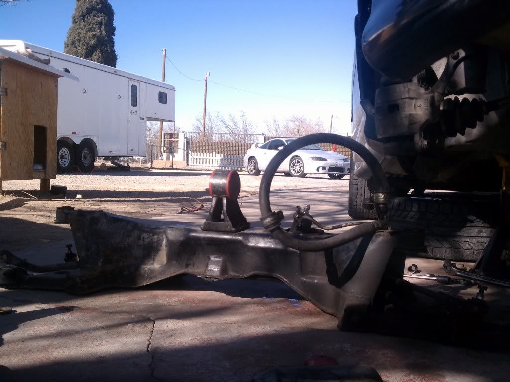

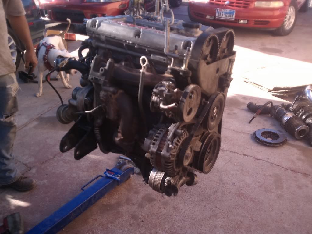

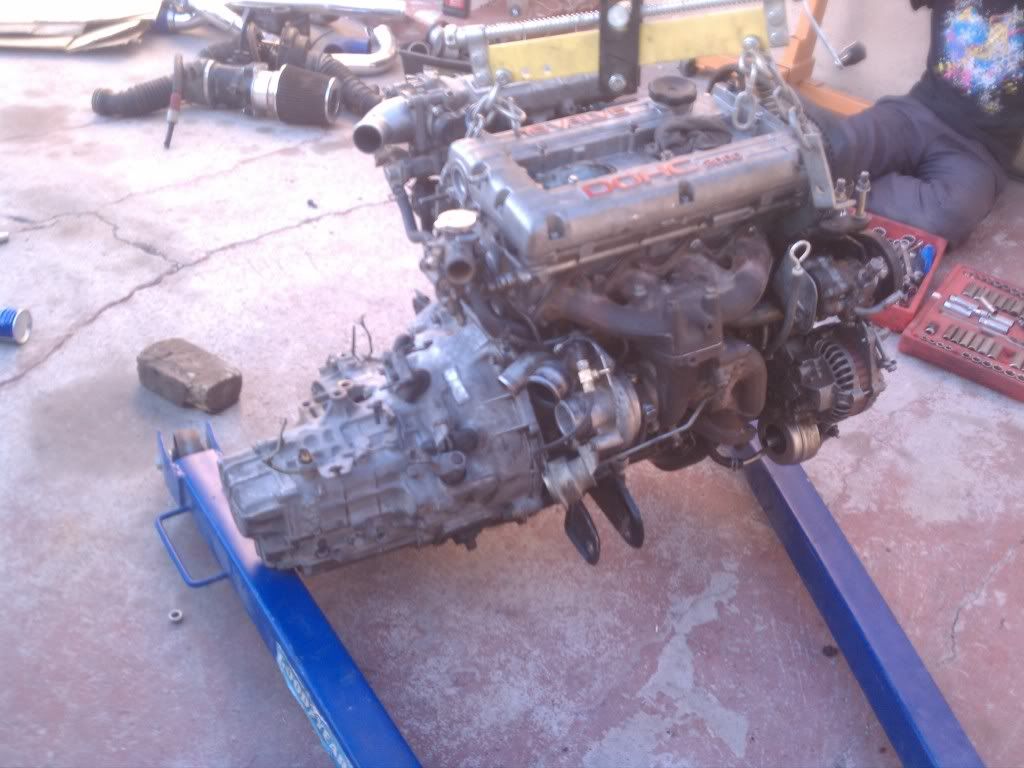

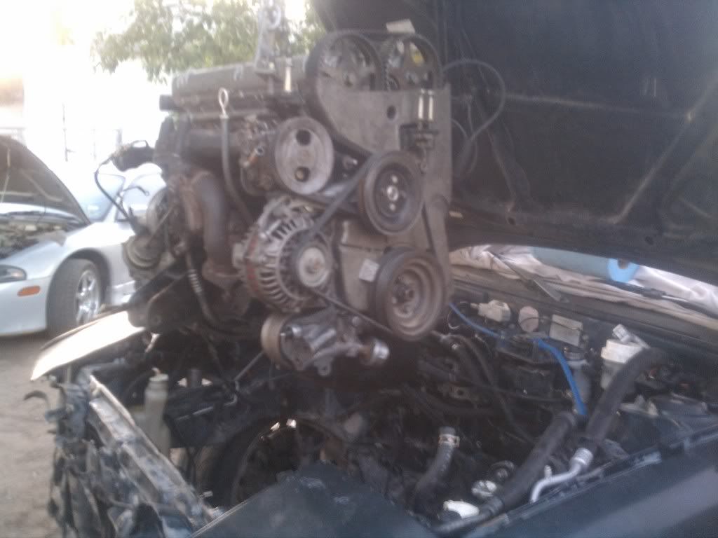

-engine out
-engine out

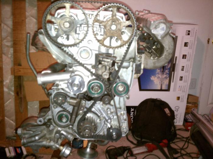

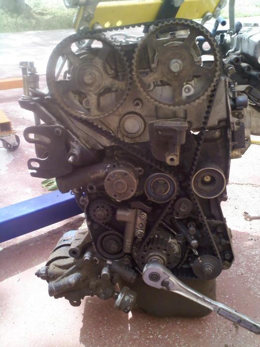

-installing crank
-Build
-Build
-Build

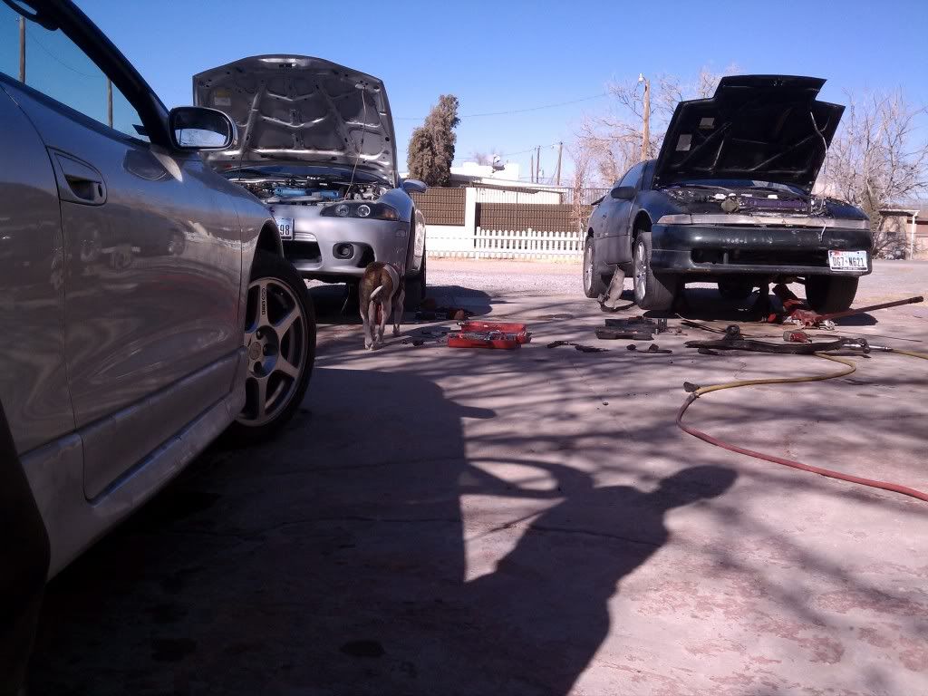

once i started getting all the parts it took about 7 months to get the engine assemble completely.... there was a little bit of a set back because we weren't able to work in the car as much as we wanted....
Took tranny out to clean everything
Before
After
Clean

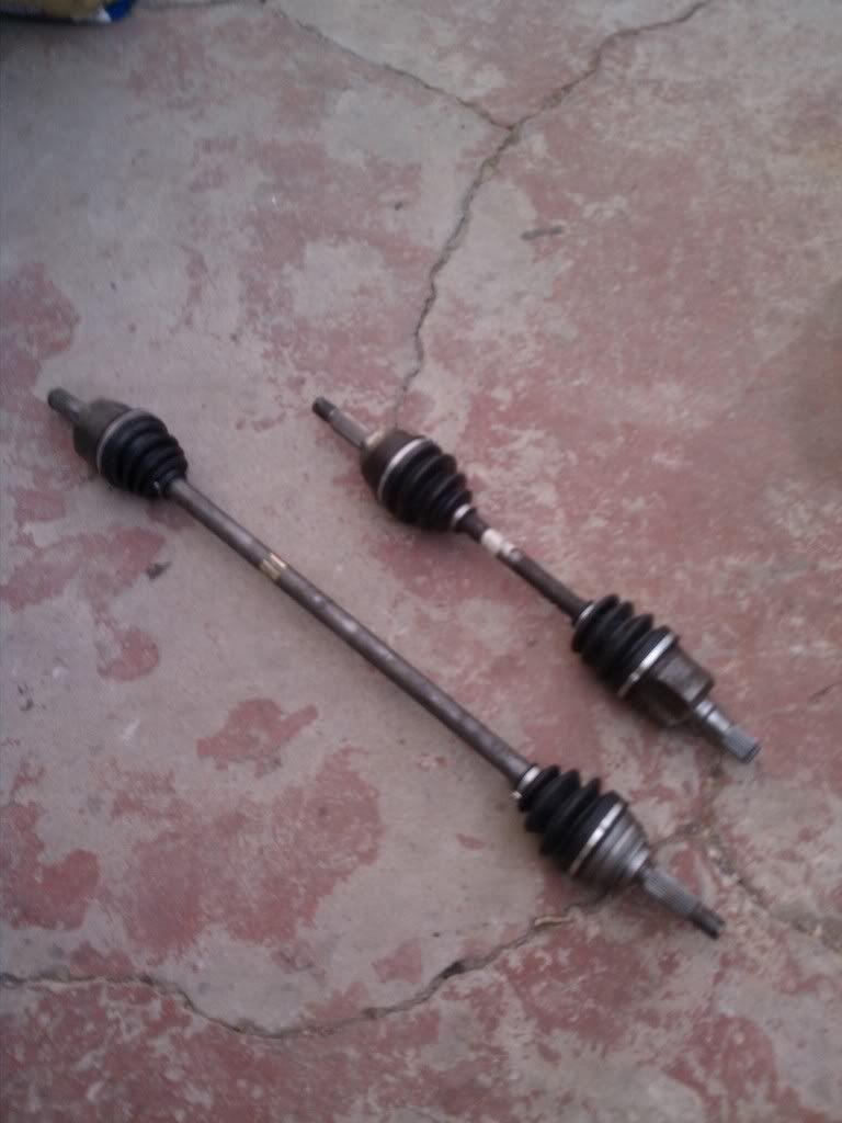

At the same time Clean axels and install new boots...

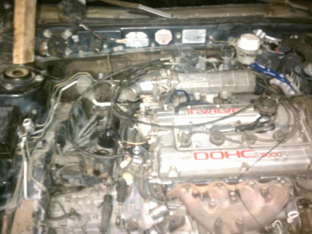

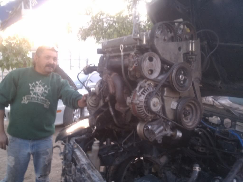

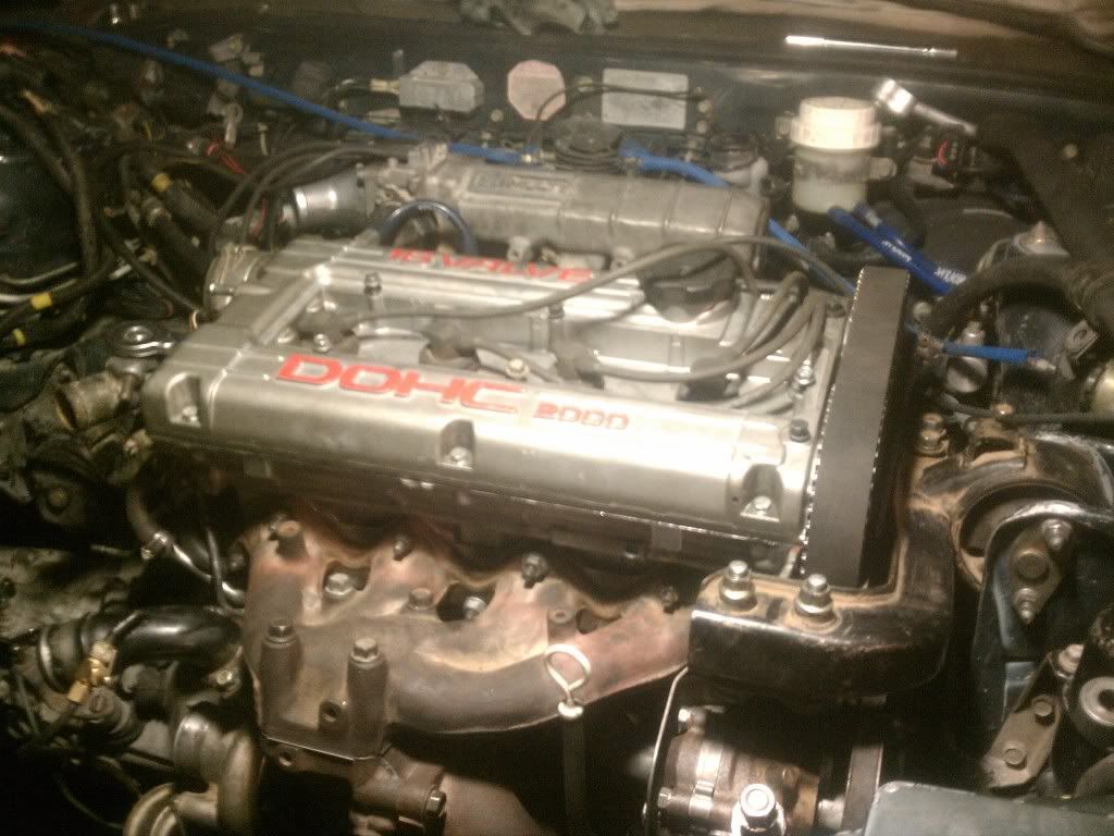

well about 2 months ago we got the engine back in the car so everything look good.
My Dad Happier than us!!!!

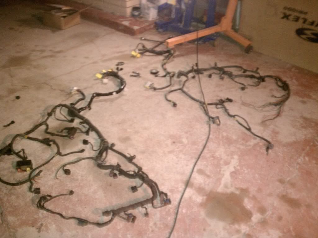

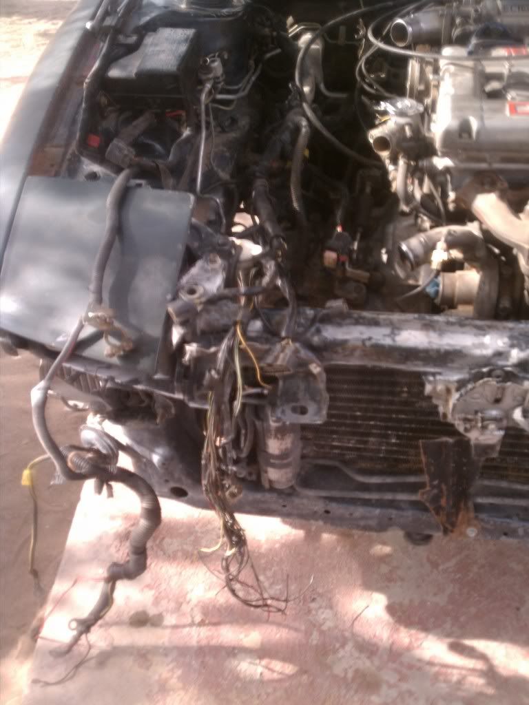

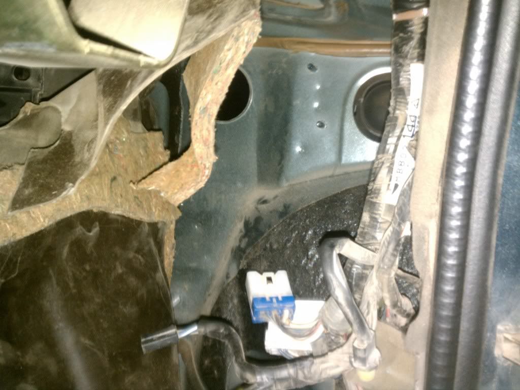

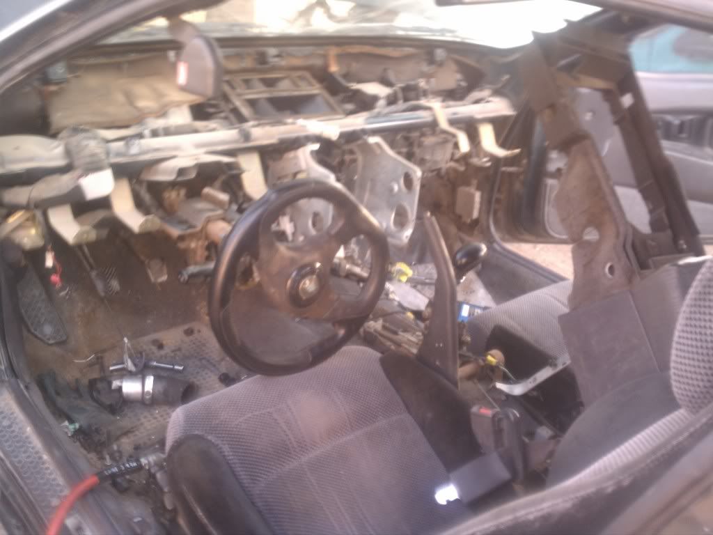

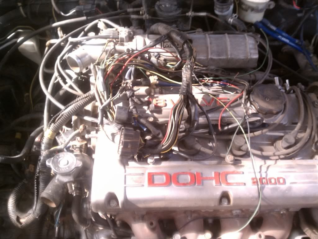

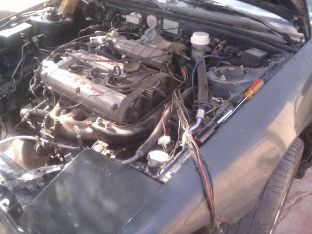

woke up next morning to get the wiring harness connected and to my surprise my dog ate half of it.....
Car waiting for wiring harness
three weeks later found one in tuners bought it and installed it in like five hours...
Finally took it out completly

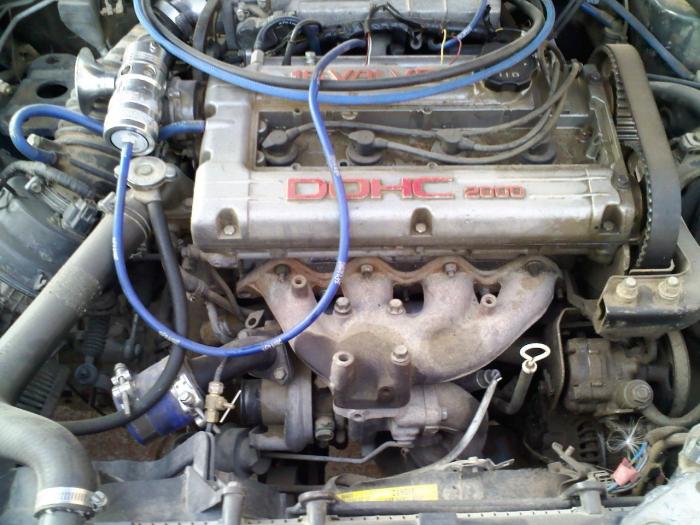

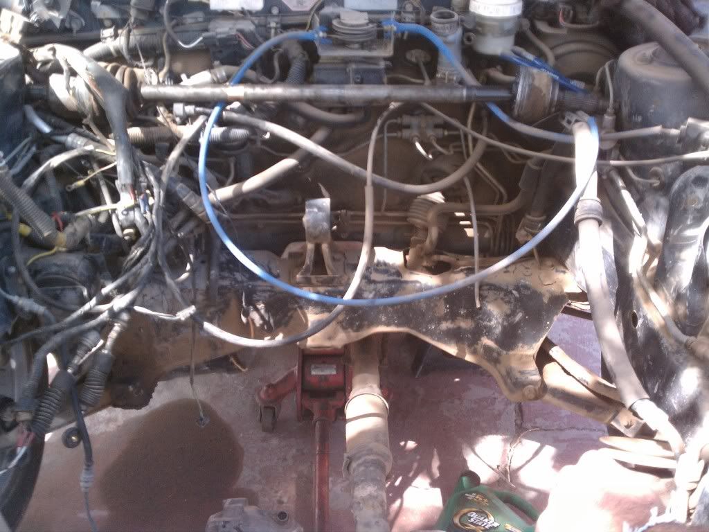

next morning the day we all wait for start the car and it didn't want to idle, it would start but it would die right away, so we checked the basic fuel and spark it was all there....
so i ask nathan (9!'clipseDOHC) for help, Next week he came over to help. We couldn't figure it out but we were sure it was a boost leak.
We checked all the fuel and spark system, and everything was in good working condition... we were about to leave it for another day but we couldn't just leave it so we check all gasket and the injectors seals were missing...LOL
i know such a simple thing.
Next morning Nathan gave me his 450's with seals which i will pay u don't worry...LOL

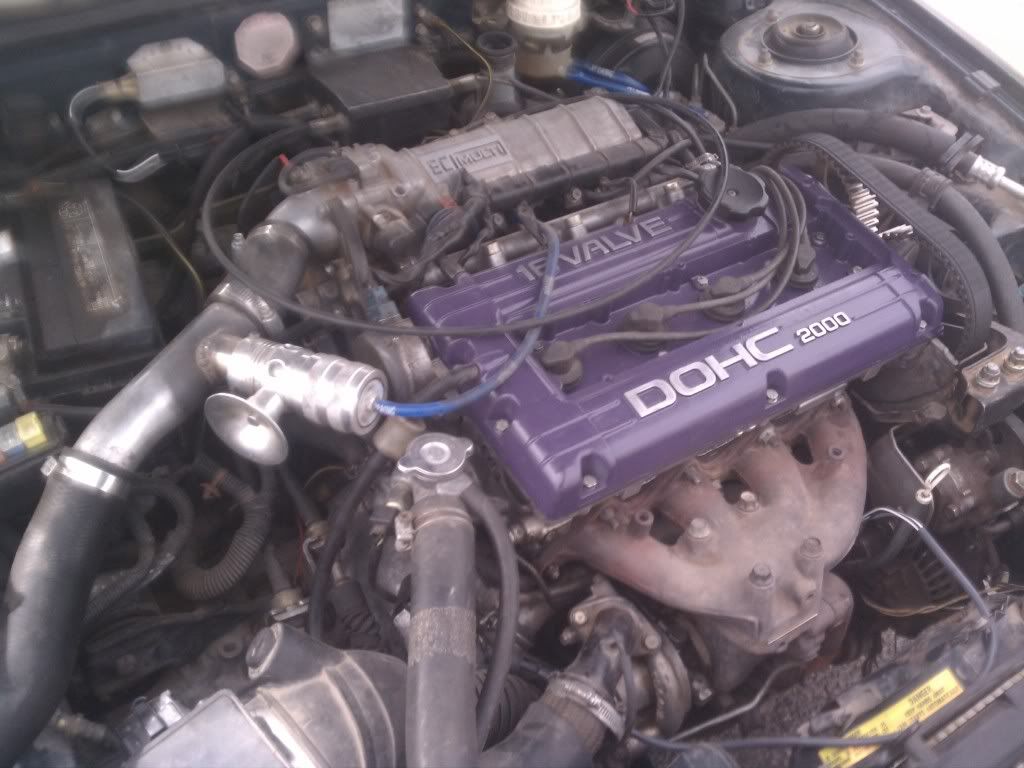

and got the car running, took it for a test drive around the block... and chage the oil..

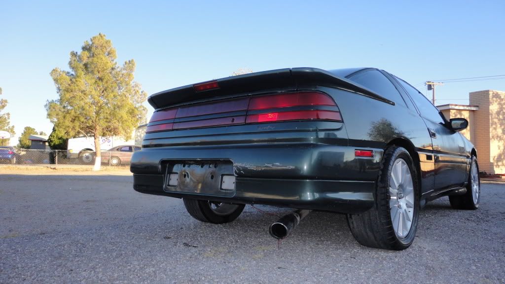

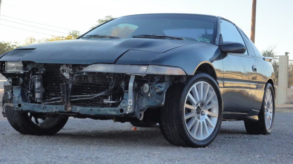

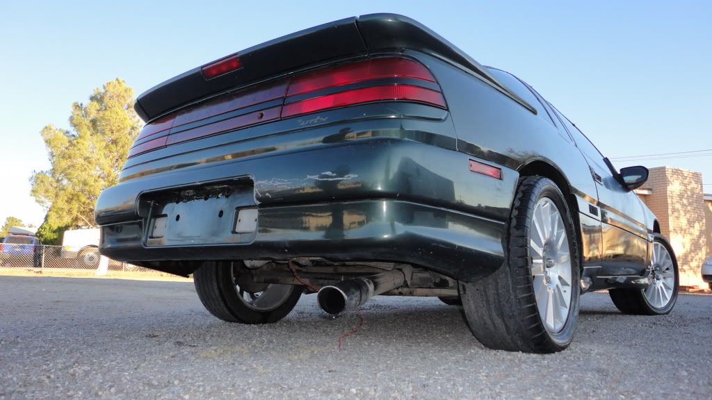

And this is the car yesterday after welding last wires the dog ate....
Yeah i got 255/45/17 when everyone says you can't
Engine bay today
I know not the best but open to ideas....

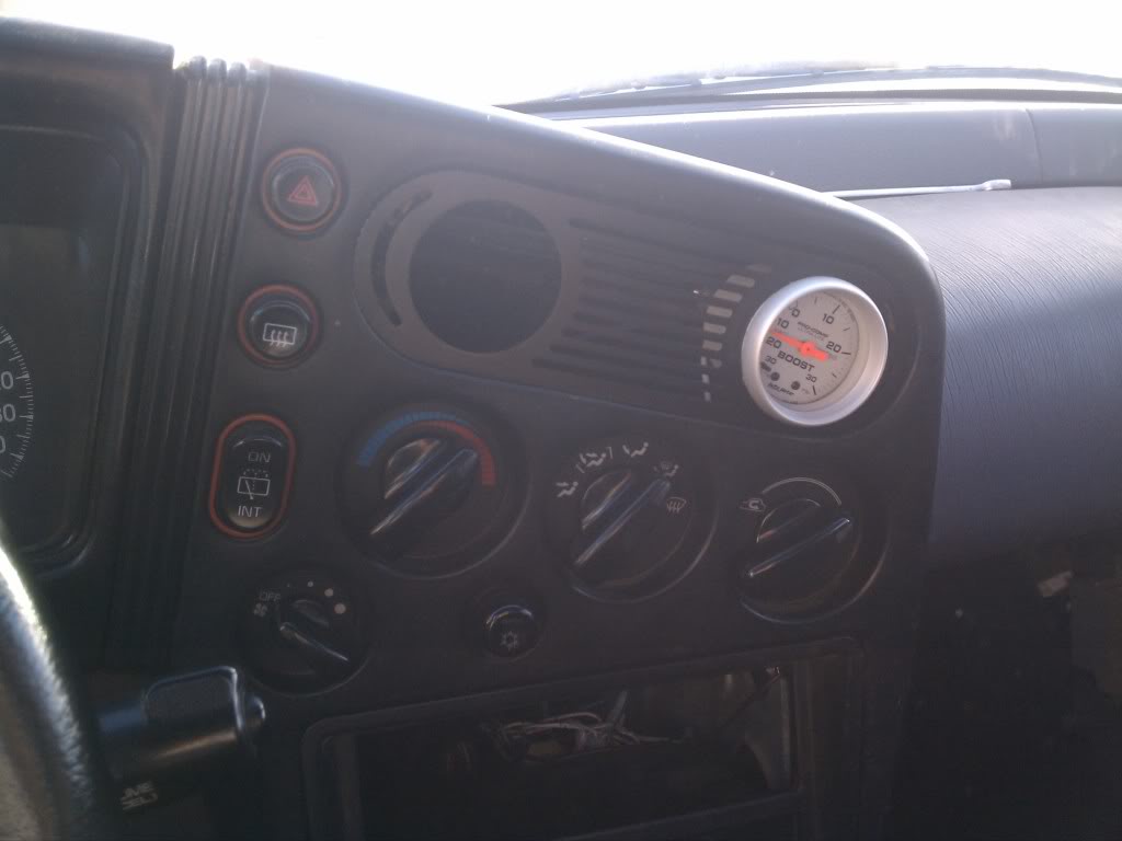

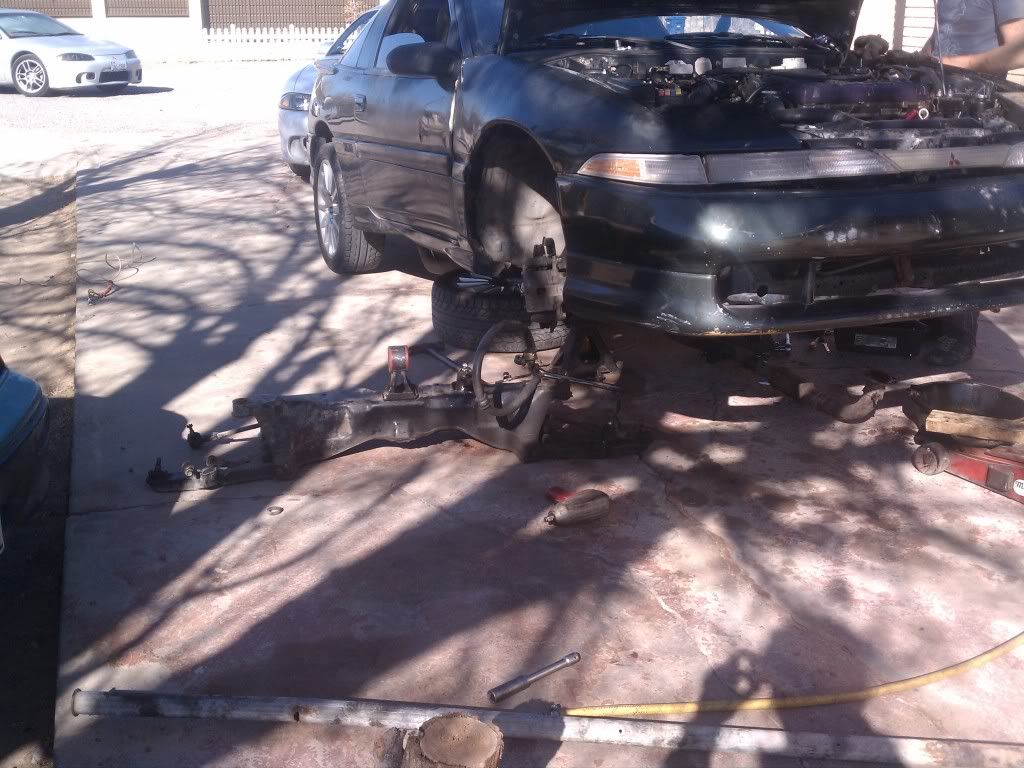

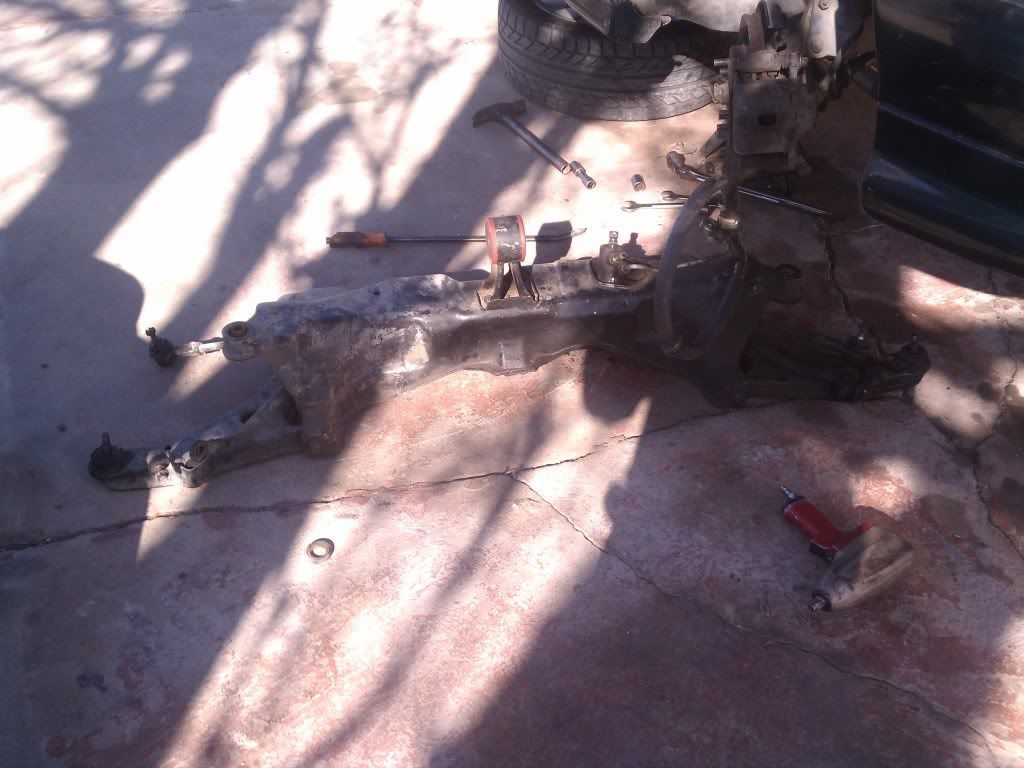

This past week my brother and i have been really working on the car.
We installed new motor mounts and all the suspencion bushings from engergy supencion.
And a new autometer boost gauge, soon will install the oil pressure gauge, as soon as
the new ss braided hose arrives.
Thanks Nathan..... Yeah I it is 0-150 I just need the ss braided line
And the adapters.... I think I know , but I want to make sure! what is the thread size on the oil
Filter housing?
I will tell you that the copper lines are a lot easier to bend and work then with the stainless braided ones. For the adapter you need a 1/8 BSPT male to 1/8 NPT female adapter (I used Autometer part# 2269). http://www.dsmtuners.com/forums/articles-engine-fuel/359004-using-t-install-oil-pressure-gauge.html
