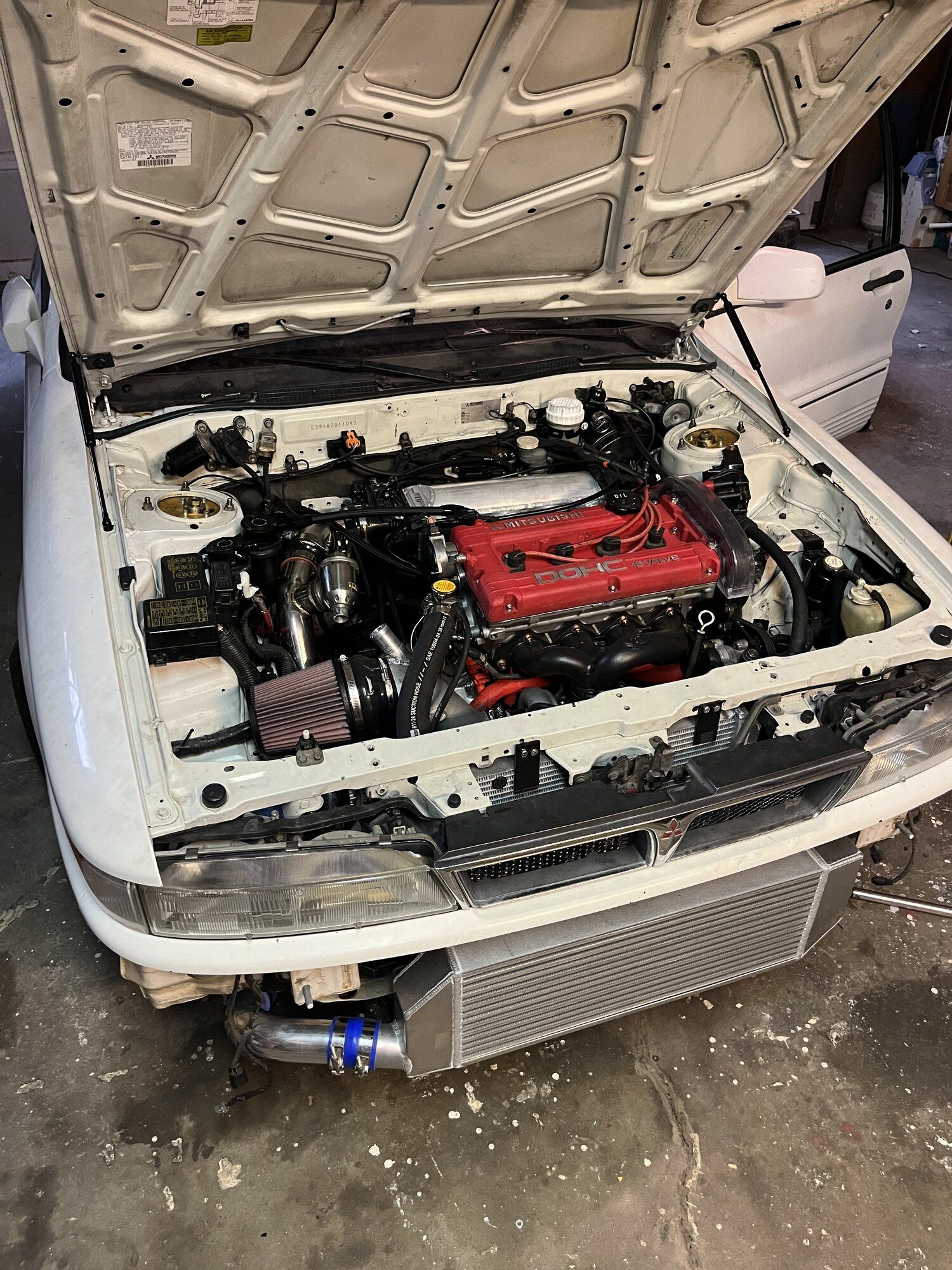

Gives me hope for my Green. It's not a UHF, but hopefully I can hit some similar numbers. I bet it freakin' rips with the G4CS pushing that turbo. 52 lbs/min on 22lbs is insane.
Also: gotta get a video of a 1-3rd rip. Or even a 1-2 pull.
I’ve never had an FP series turbo before, so this is my first and only experience with it, but I must say it is truly incredible for its size. I ordered the turbo quite early on in the build and always doubted my decision of not going with a red or bigger but to me it is the perfect middle ground for a street turbo I’m able to pump up into 30+ psi on ethanol and I can’t see any reason I would need more yet.
I’d be happy to get a video you’ll have to check back here soon
They’re installing an e85 pump like 40 mins from me so honestly I think my plan is the same as yours. 20-22lbs on 93 Oct, and 30 on E85 just to see what she makes. Quite confident I’ll need a 4 spider diff to handle the power though. Cross that bridge when I come to it though. :p
And honestly I think way too many people are going with turbos that are way too big because for some reason there’s this idea that only big turbos go fast. Guys ran 10’s on 16Gs back in the day, so with modern tech and tuning knowledge a mid/smaller sized turbo should be an amazing street setup.
Too many guys out there with 6266+ sized turbos barely, barely breaking 10’s in a gutted tin can with a side exit exhaust. I’d be happy with high-mid 11’s in my full weight, full interior, A/C having street car.
Couldn’t have said it better. You’ll be happy with the green I’m sure. You’ll love the UHF if you ever choose to upgrade too. My buddy sent in his old regular red and they stuffed the UHF turbine wheel into it so it might be something to ask them about.

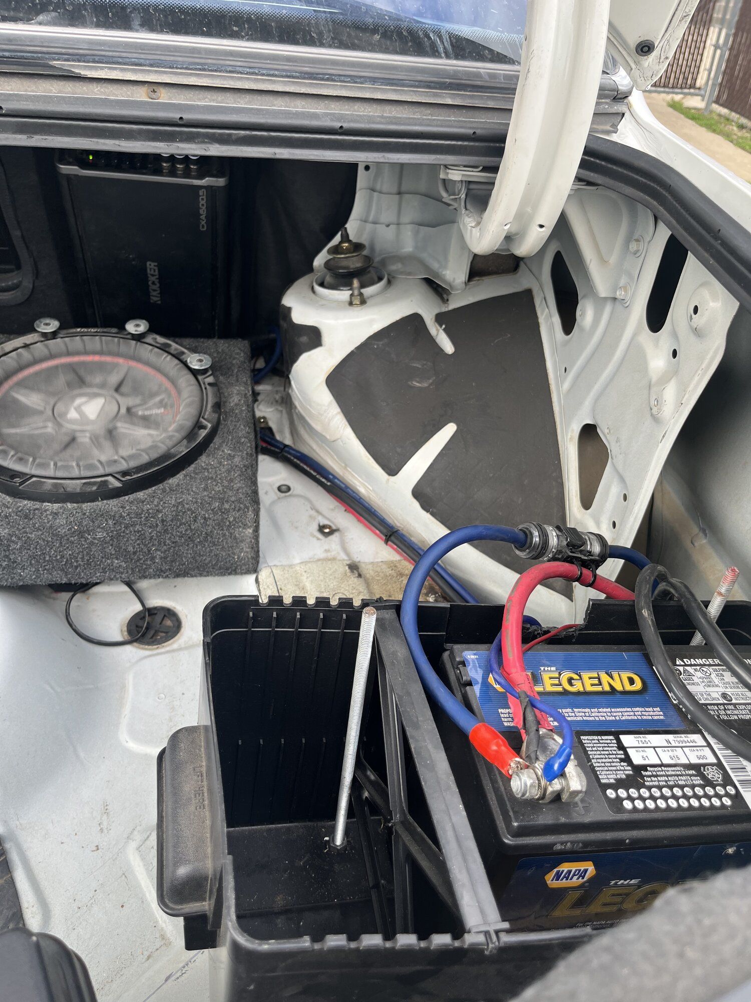

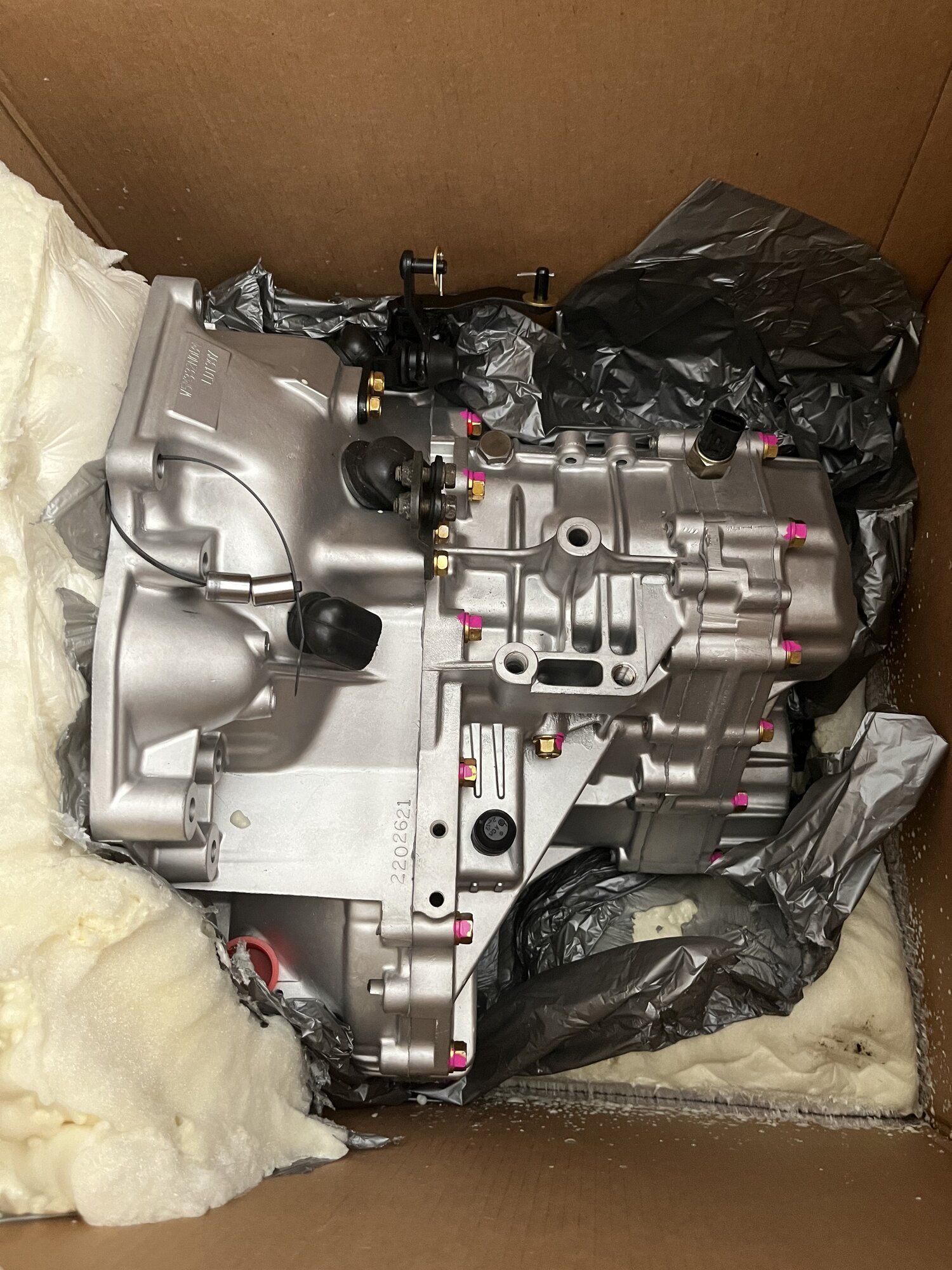

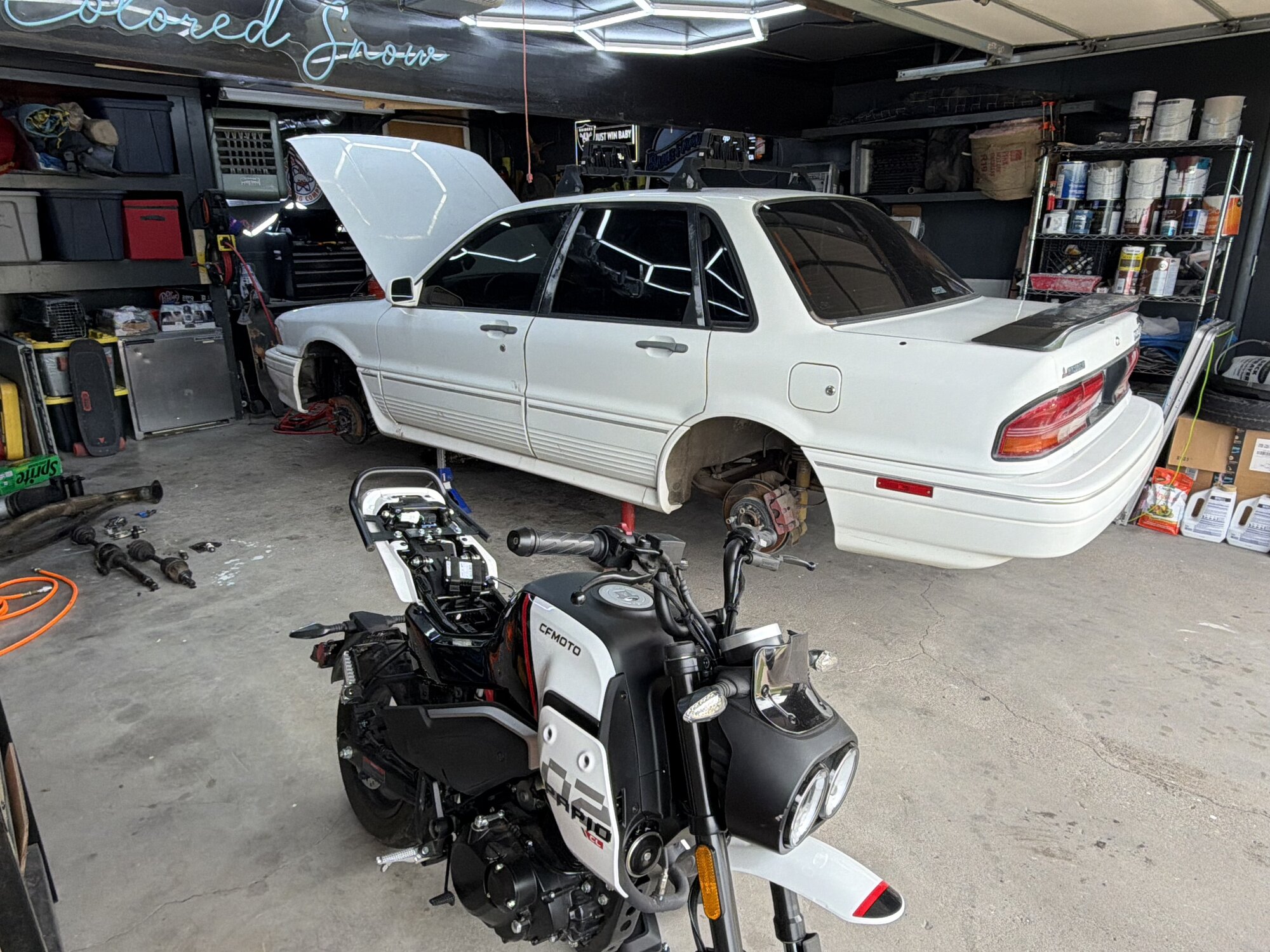

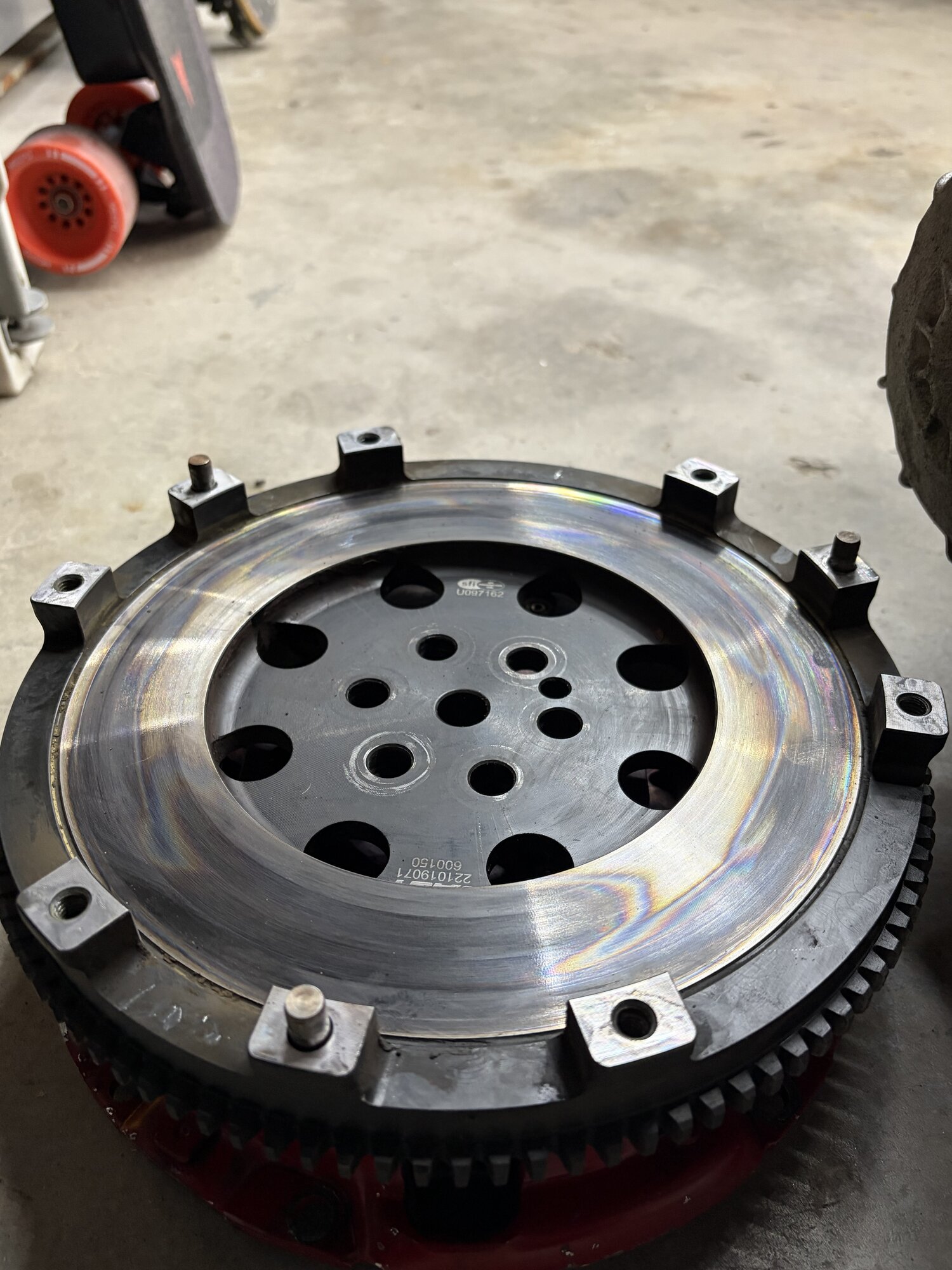

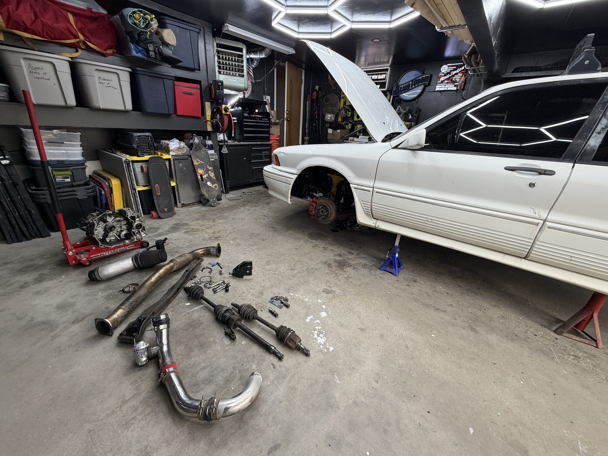

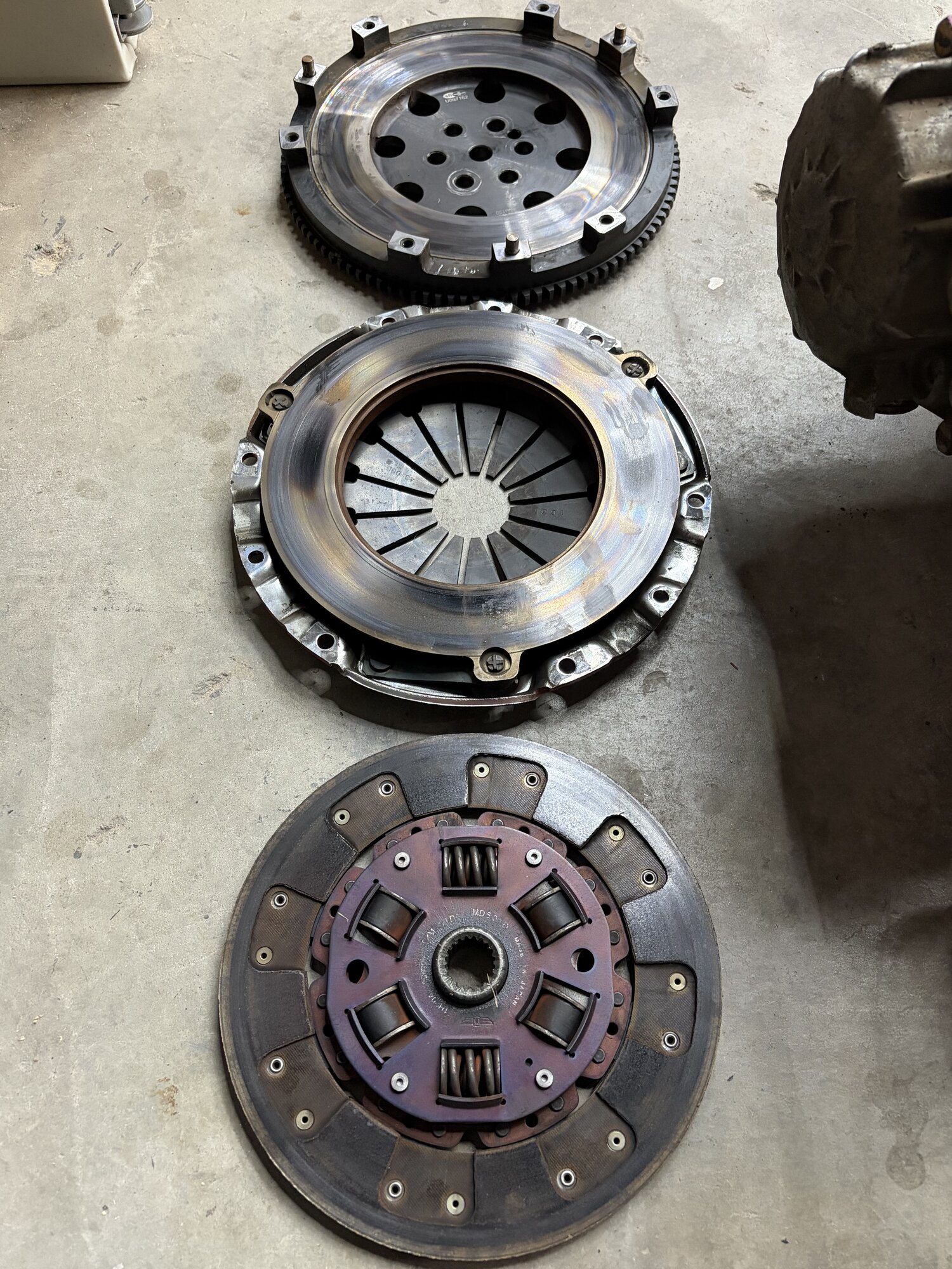

Haven’t worked on this car in a year. Going to revive her fix her leaks and add a new clutch. New issue where the voltage drops and resets the wideband rendering it useless.
Obviously didn’t make it in the garage this year, needed the space for a painting studio for our kitchen cabinets. I still love this car. It’s just a lot sometimes.
