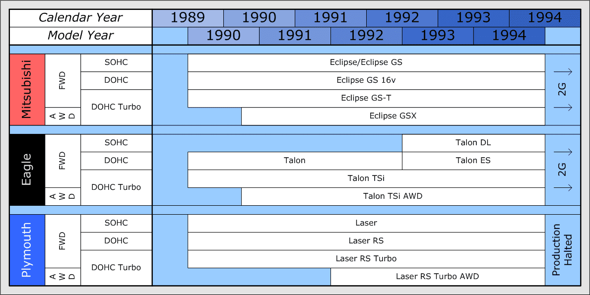

I think it's confusing because the Talon and the Eclipse did this differently.
With the Talon, the TSi could be either AWD or FWD and it was still a TSi.
With the Eclipse, the AWD turbo car was the GSX. The FWD turbo car was a GS-T.
Here's a chart shown for it in the Wikipedia article "Mitsubishi Eclipse":

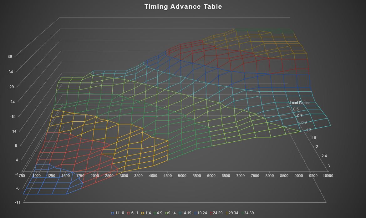

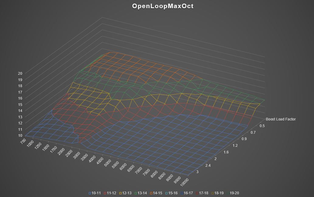

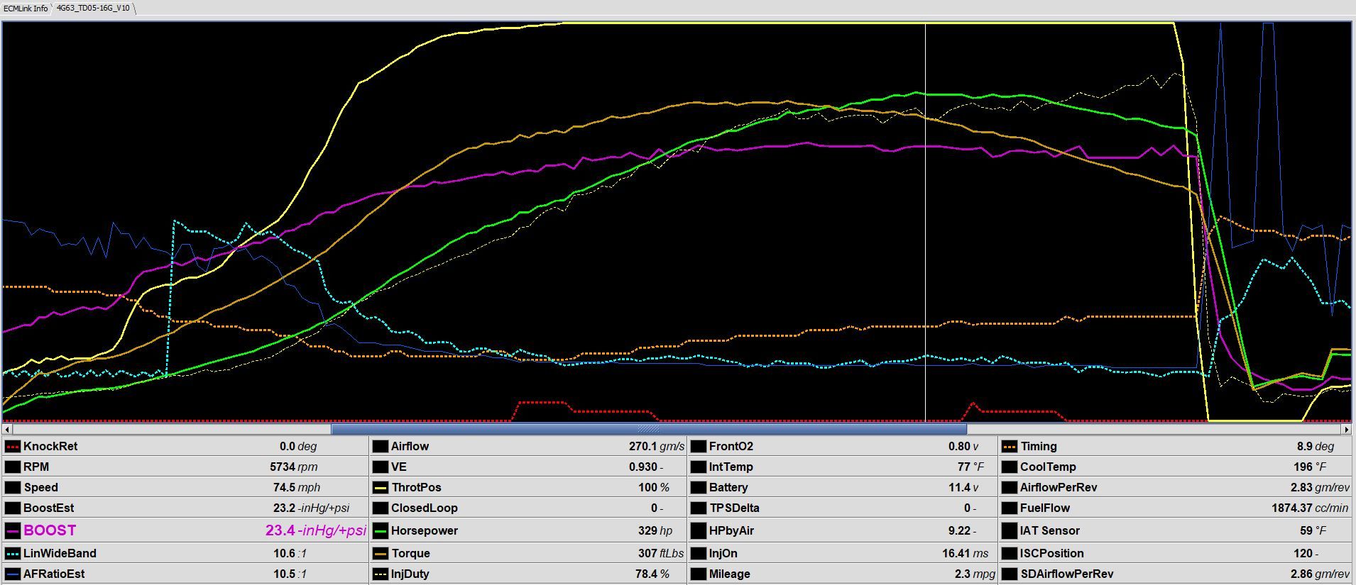

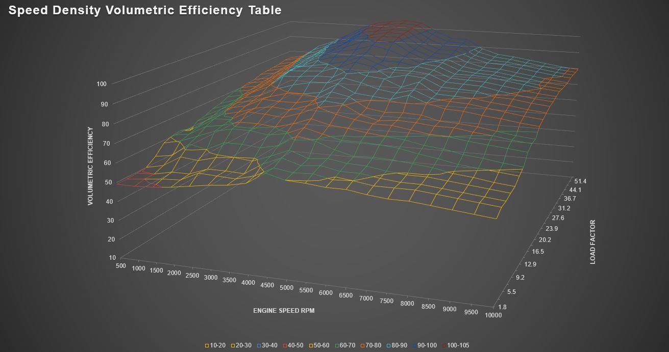

It's been a while, I figured I should post an update.
I had the car running quite well but still not satisfied with the log data, I continued to tweak and refine the tune. Each time the tune got better, and the car ran a little stronger, so I persisted to keep working on it.
I think I have the VE table close to a few percent from perfect now and the results are apparent: It runs so much smoother now, and makes a little more power. According to the virtual dyno, the car appears to hit peak HP of ~320HP between 5500-6k and peak torque ~320ftlbs between 4500-5000. I am seeing +300ftlbs from ~4000rpm to almost 6k.
The car demonstrates a really nice/fat powerband that makes it a pleasure to drive. Boost comes on fairly quick, really just a couple seconds to go from vacuum to +16psi, and hits max boost of ~23-4psi after another second and it continues to hold +20psi past 6k rpm where power and efficiency start dropping.
I must say, I am really impressed with the 4g63 platform. I am very happy with the current tune, as well as the performance. I am not sure that I will bother making any significant tuning changes for a while. I may take another attempt in spring at making more power, after we get the Cyclone intake working.
I have attached a log from today's effort, and picture of the log data for anyone interested, as well as a spreadsheet I built that some might be interested in using to visualize the VE, timing, and ignition tables. (*pictures of 3d charts from the spreadsheet below)
I want to say a big thank you to all the people on this wonderful forum who offered suggestions and provided feedback which helped me get the car running so well. I would add, that I now have a much greater appreciation for the level of effort that goes into tuning on this platform.
