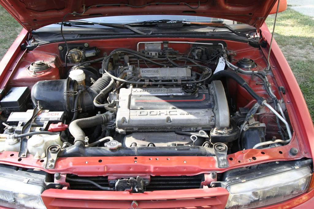

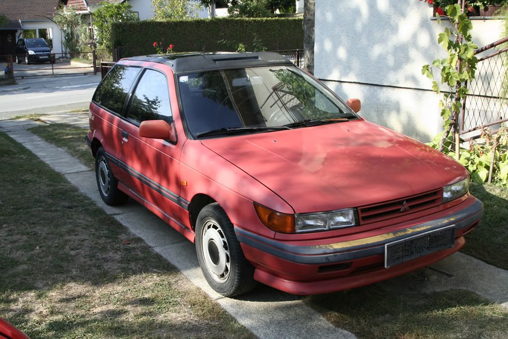

]Few years back i come across a Colt GTi, Dubai edition, here in Croatia.
Only three of them were imported back in 90es, so you can image that these kind of cars are really rare here.
The engine was 4G61, 1.6 N/A with 125hp. Here are the pic of the car when it arrived.
As you can see the car was OK but the bad things was the paint that oxidised and windshield was scratched by wipers.
Dubai edition Colt has a SUPERTOP roof and air condition but no power steering.

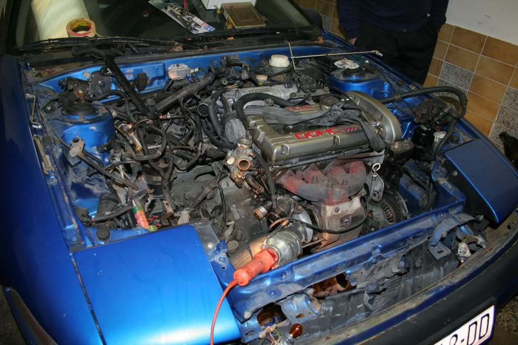

In meantime we found Eclipse 1G from '91 with 4G63 turbo engine that wasn't originally installed but swapped with original 1.8L.
Eclipse wasn't in so good condition so we agreed to get the engine out and put it into Colt.

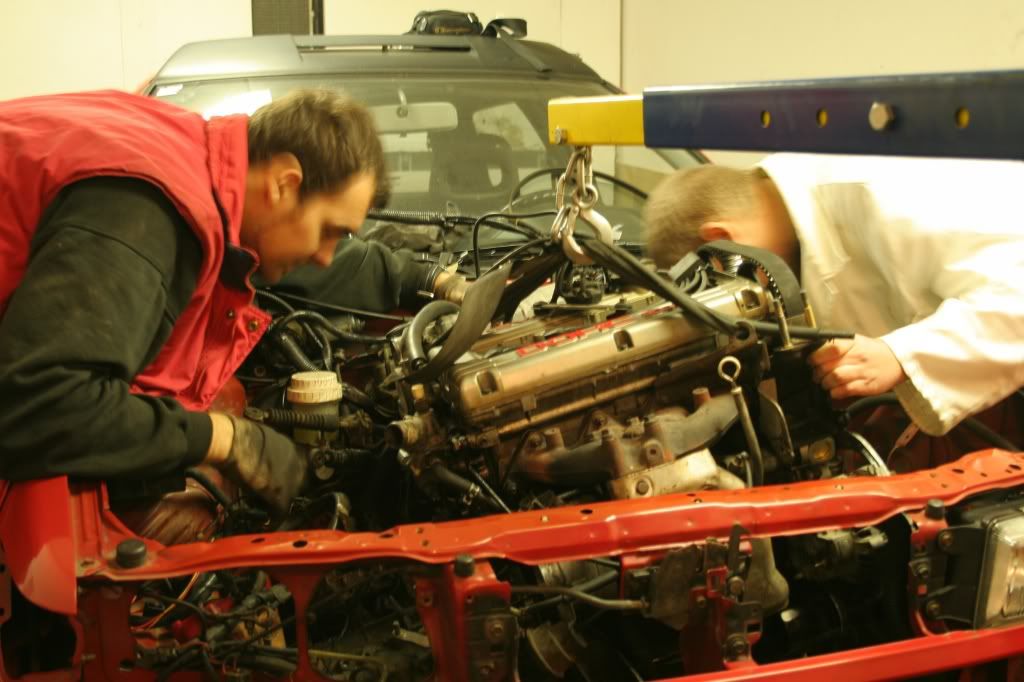

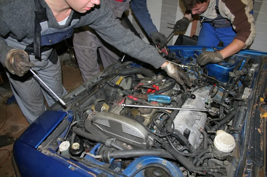

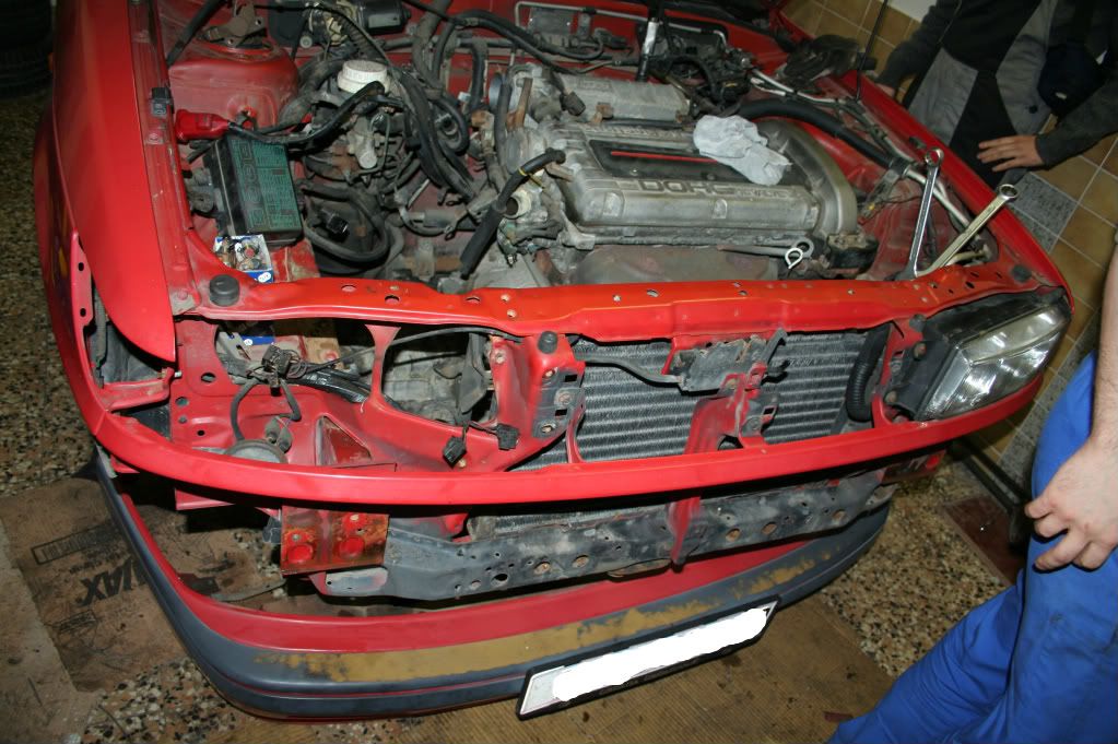

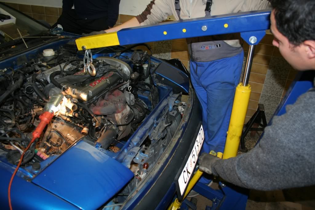

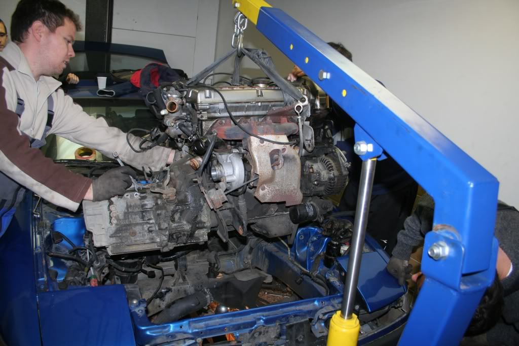

First it was the Eclipse. We had to get out all the parts that we needed for putting the engine in Colt.
Here how it started! :)

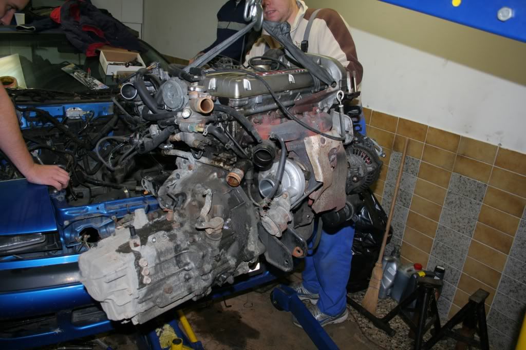

First the engine.
The engine was out. We took the stock intercooler, wiring, oil cooler, axles, power steering pump and some other thingies.

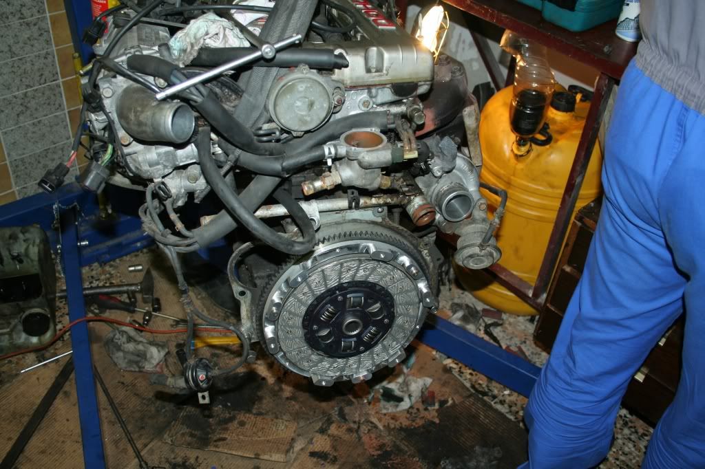

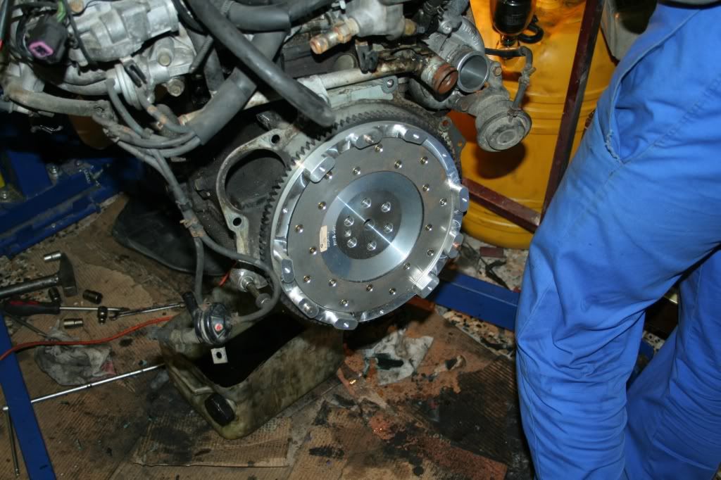

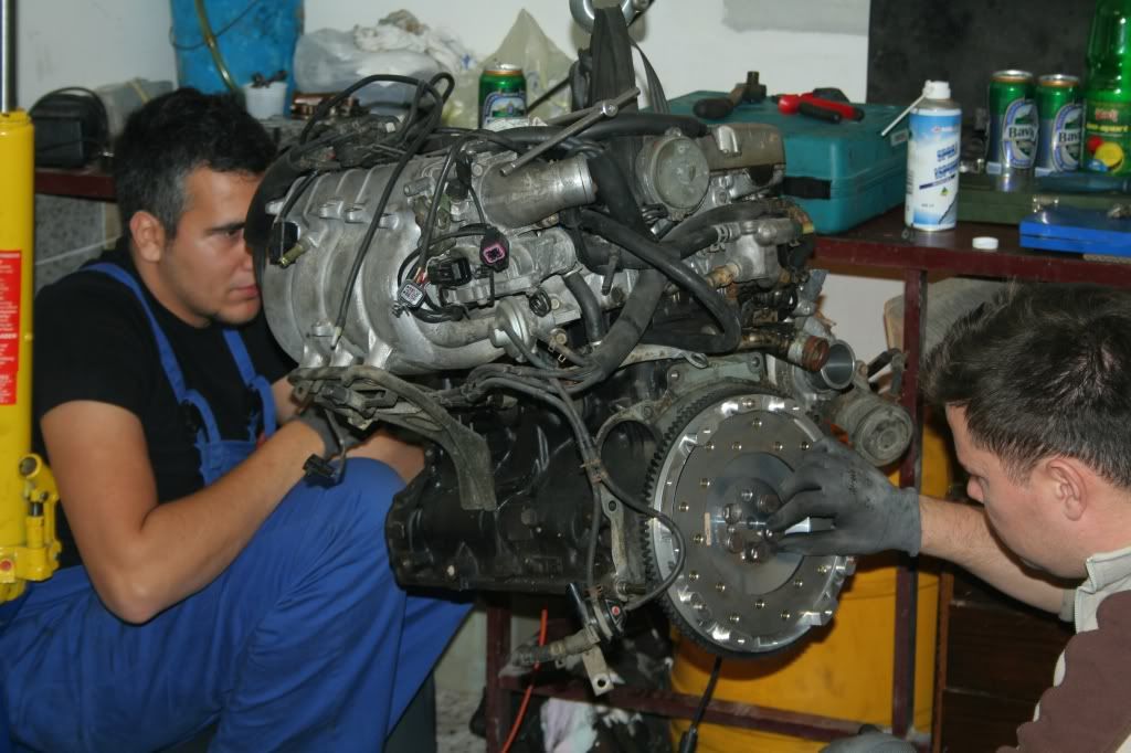

Then it was time to suit up the engine! :)

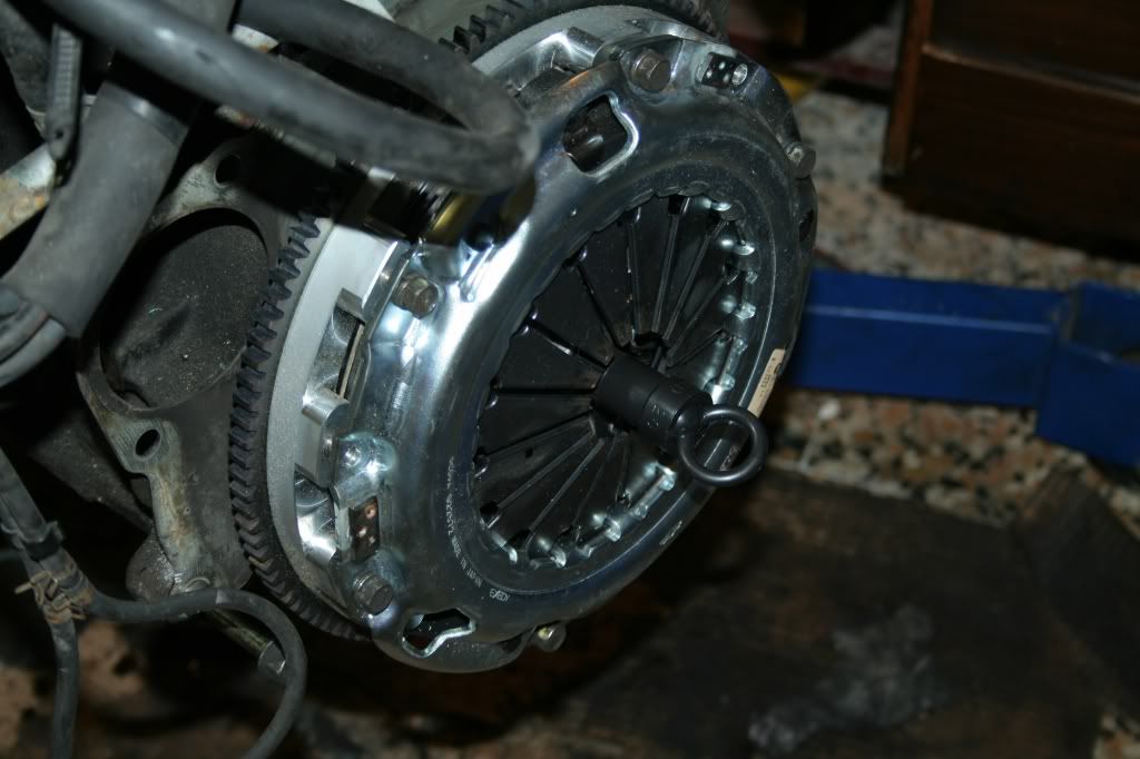

I got Fidanza alu flywheel, exedy stage 1 clutch kit and OBX crank pulley. And regular stuff, new strainer, belts, water pump etc etc.

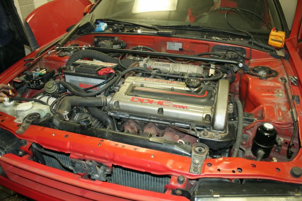

Then it was Colt's turn :)

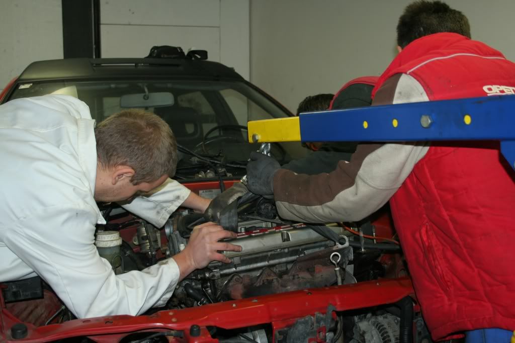

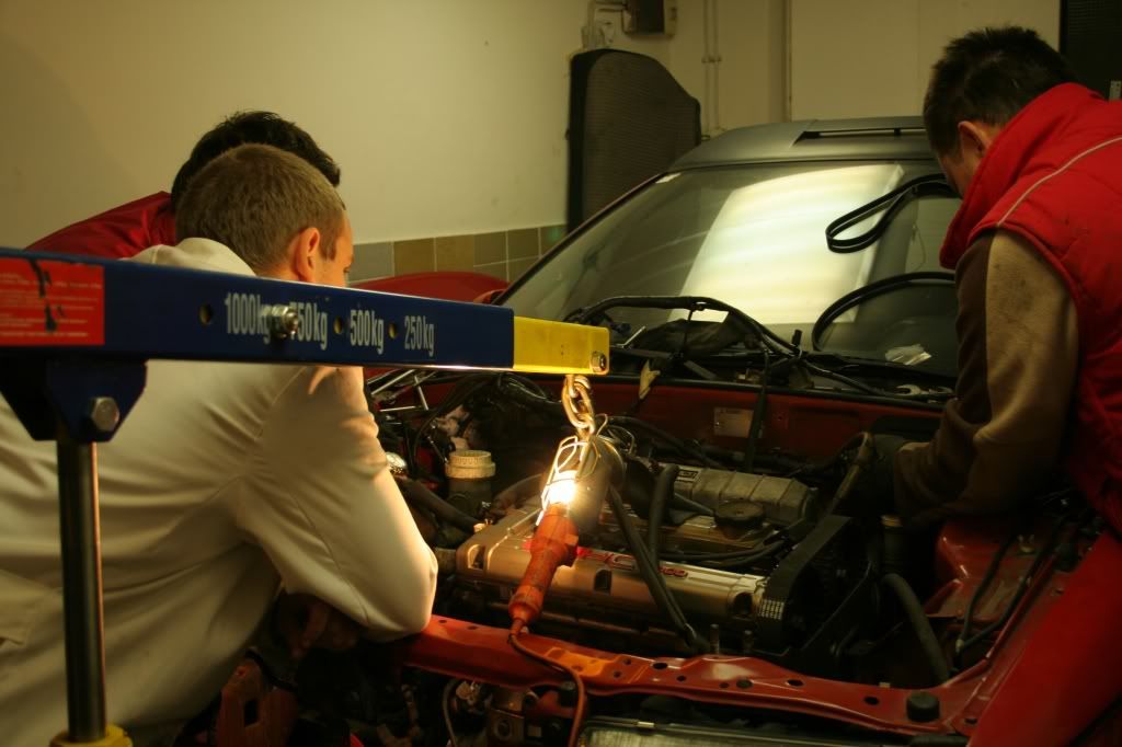

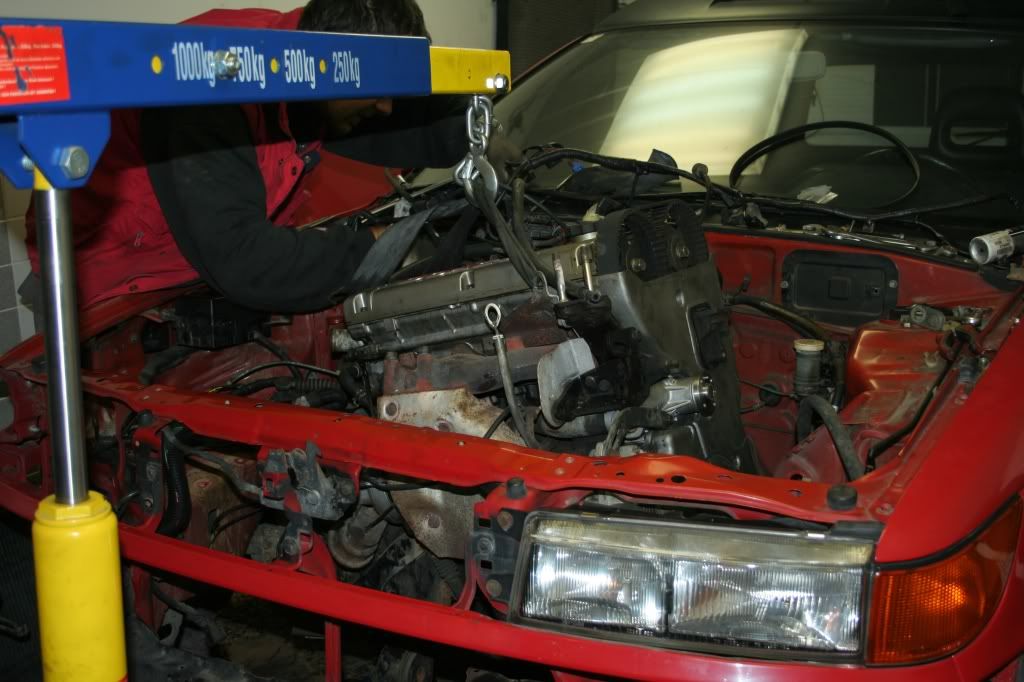

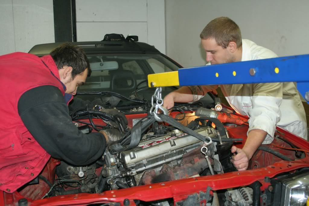

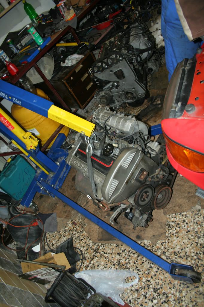

Back in the garage:
Get the engine out.

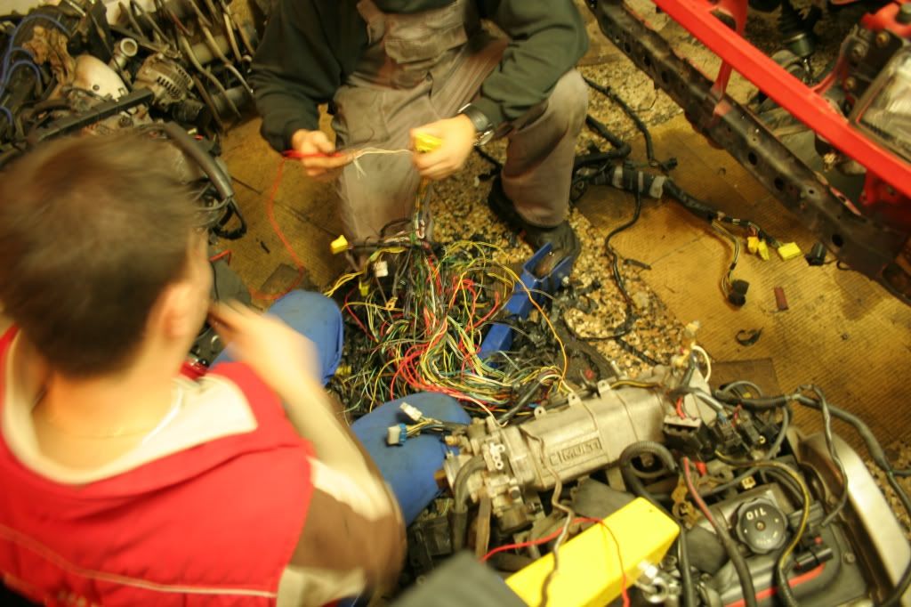

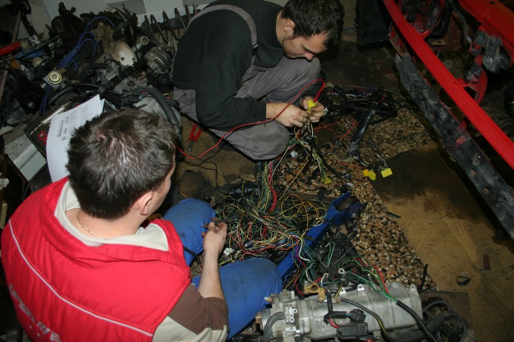

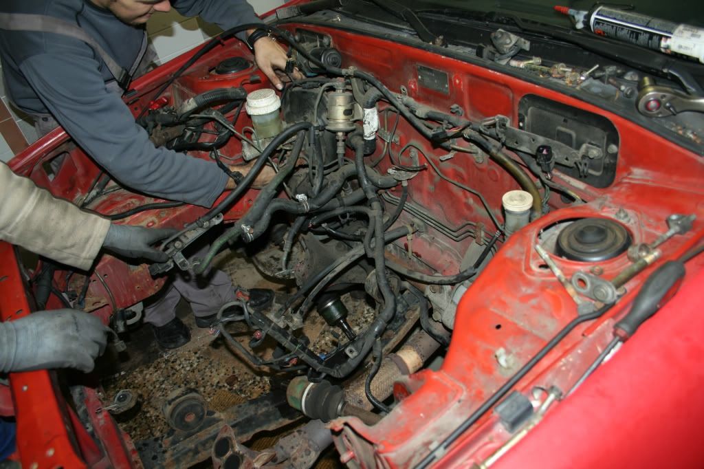

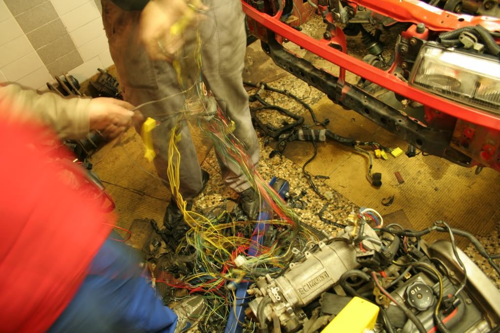

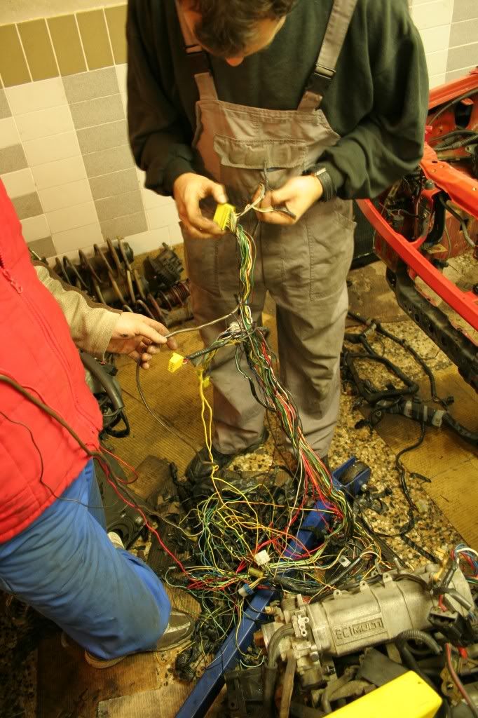

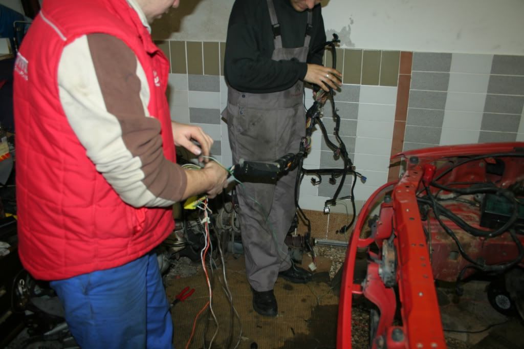

Then it was a wire party! :)
Had to add additional wires onto original wiring in Colt.

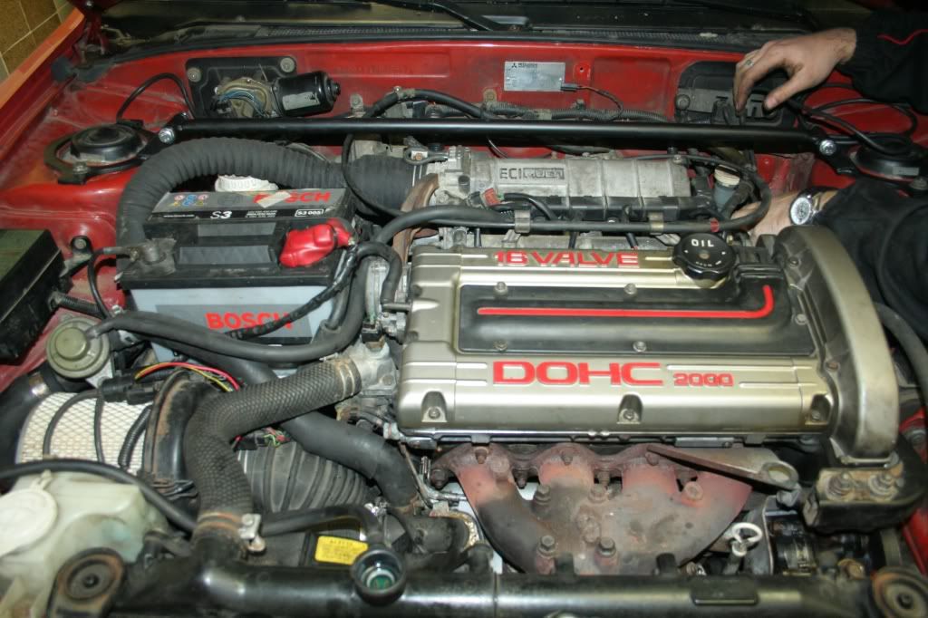

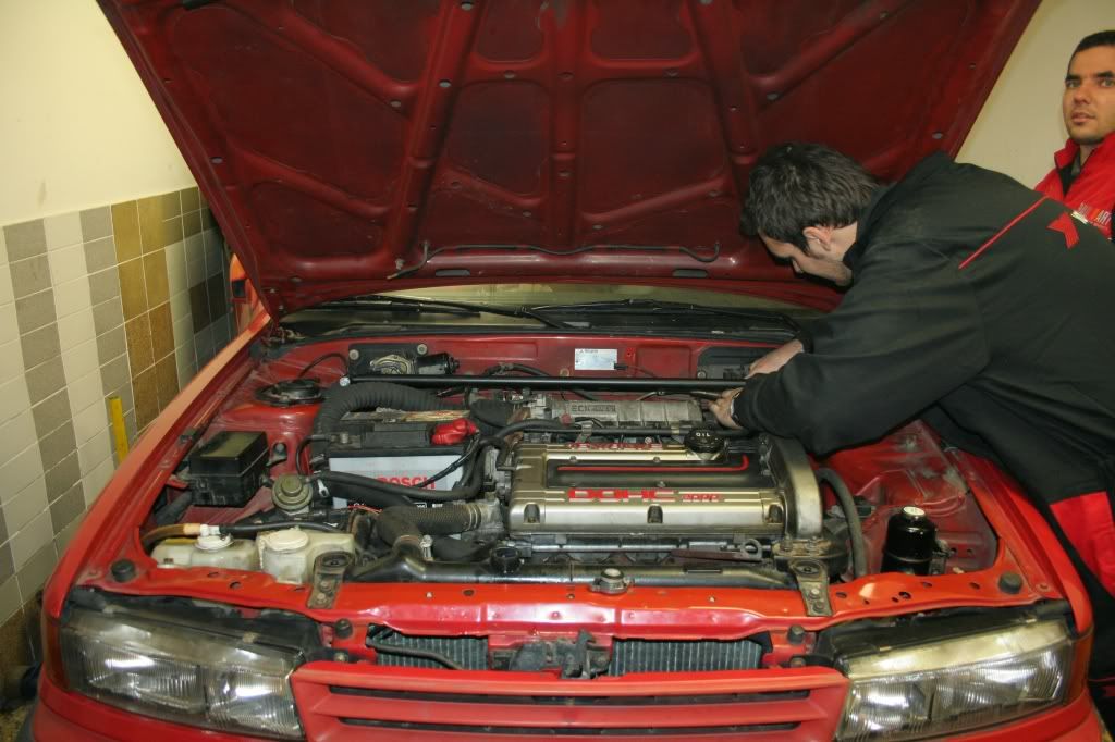

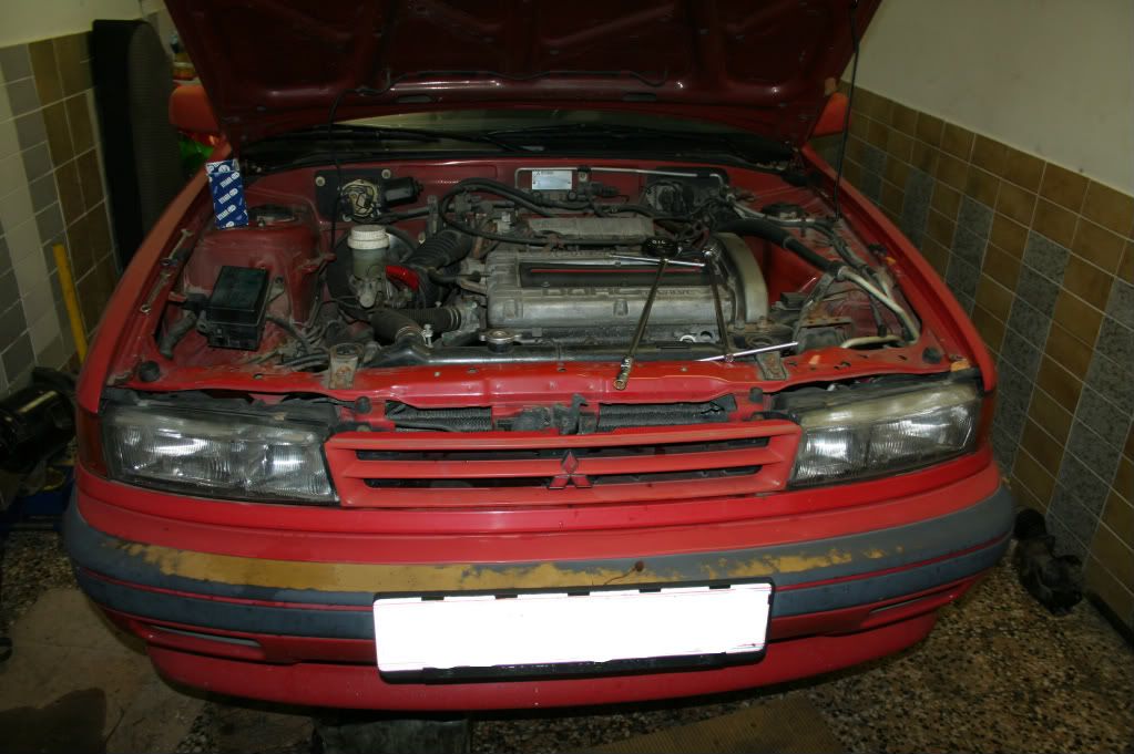

After putting it back in it was time for new engine to slip into a new suite :)
Patient survived :)

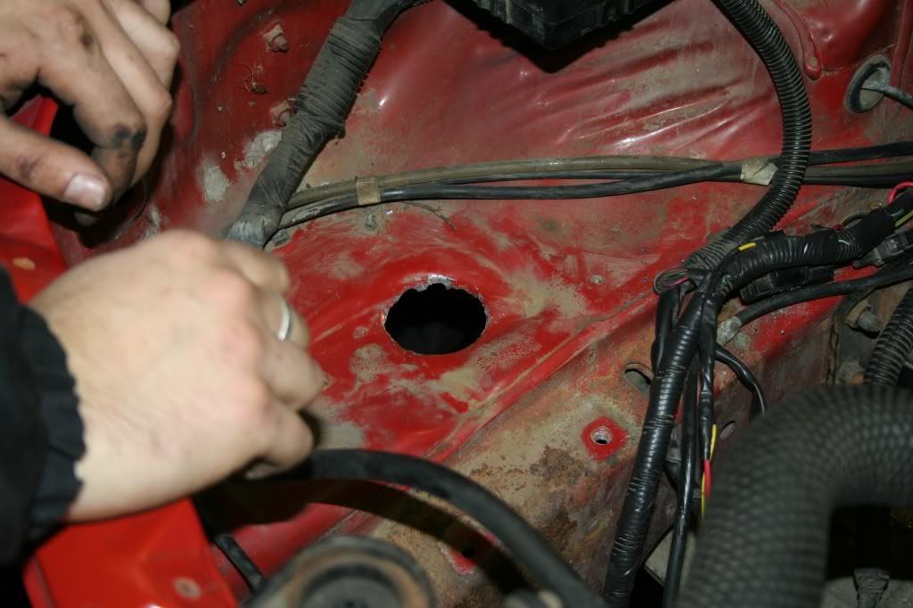

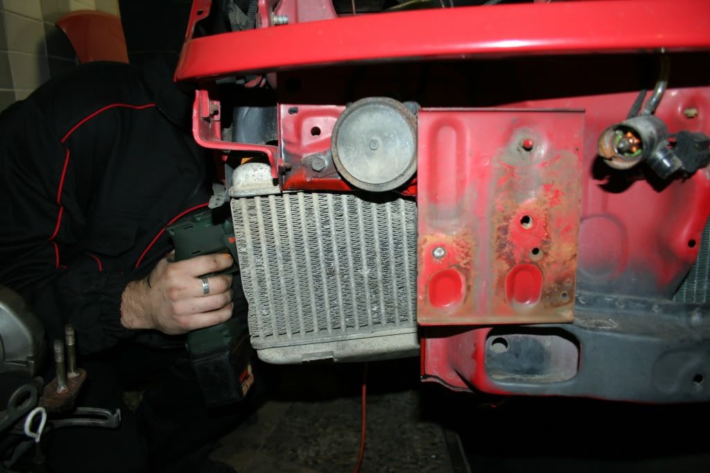

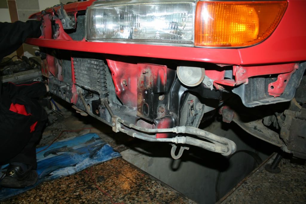

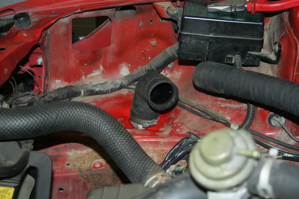

We made a hole for intercooler hose.
Fitted oil cooler.
Eat some :D
Putted temporary intercooler.

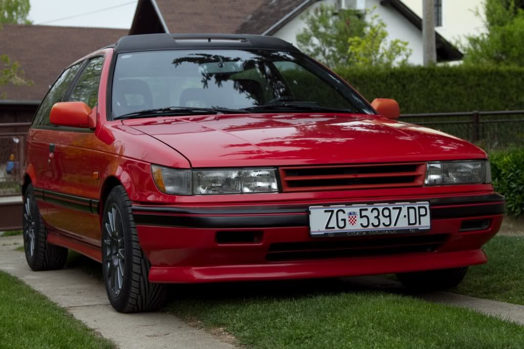

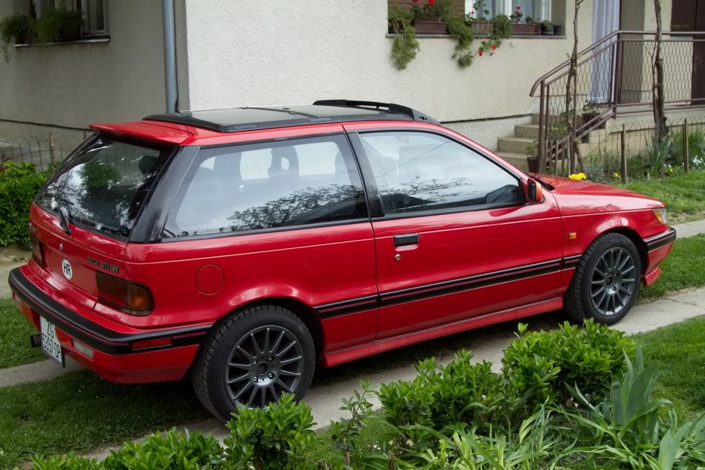

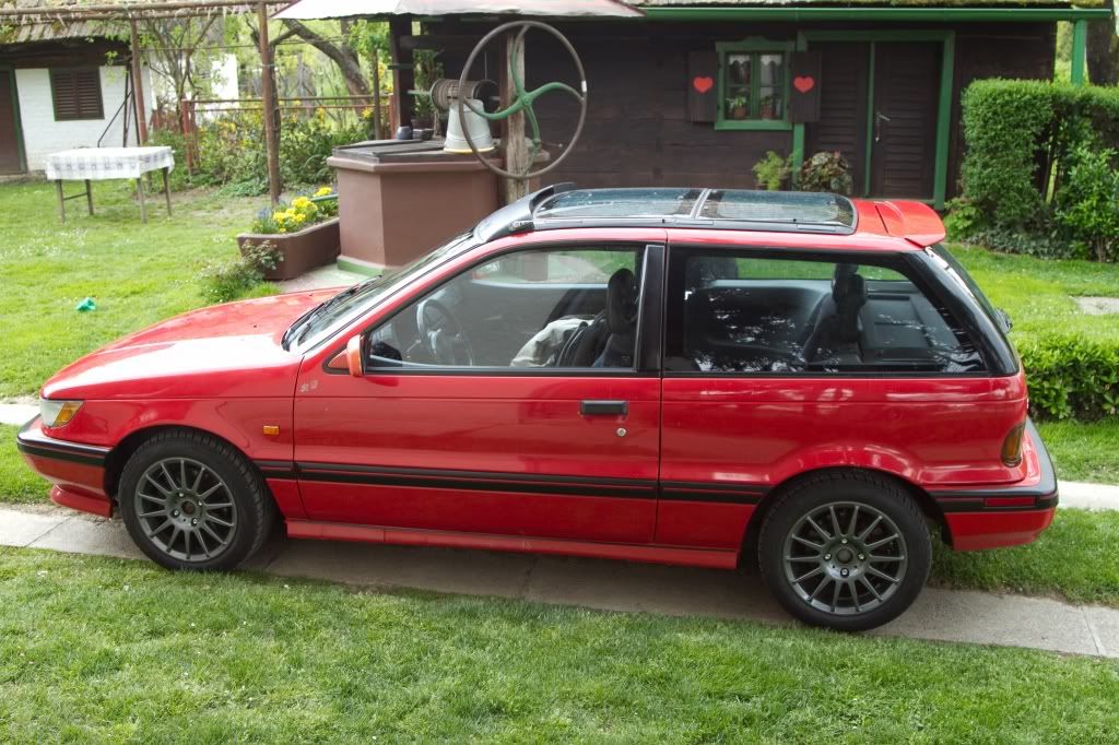

I painted those strips on all sides and ordered corner lights on ebay from '89 Eagle Summit. As you know the paint is horrible so i tried to freshen it up a bit by polishing it.
I want to do the hole new paint job but at the moment i work on the car as much as my paycheck allows me :)
So the polishing is a good option for now. Ah yes, i bought new rims and tires, fited the corner lights, 2.75" exhaust with only middle muffler, i bought brand new original windshield that came all the way from Japan :) , and here is the result.

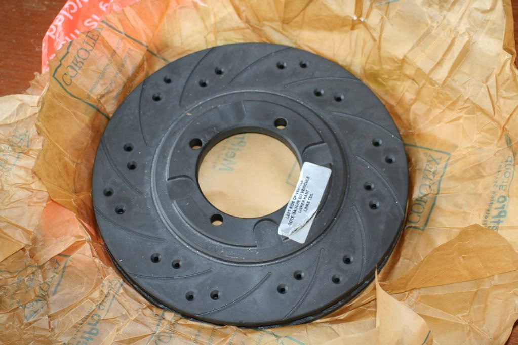

Got the BlackDiamond rotors.

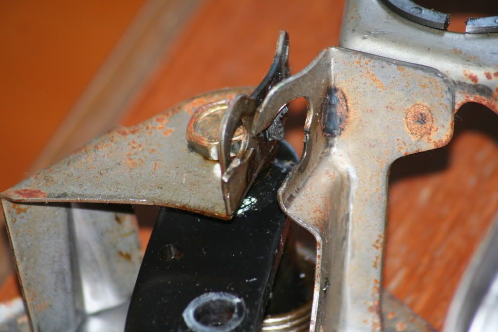

I had only one problem.. I blame the hard clutch for it, I'm not violent :)

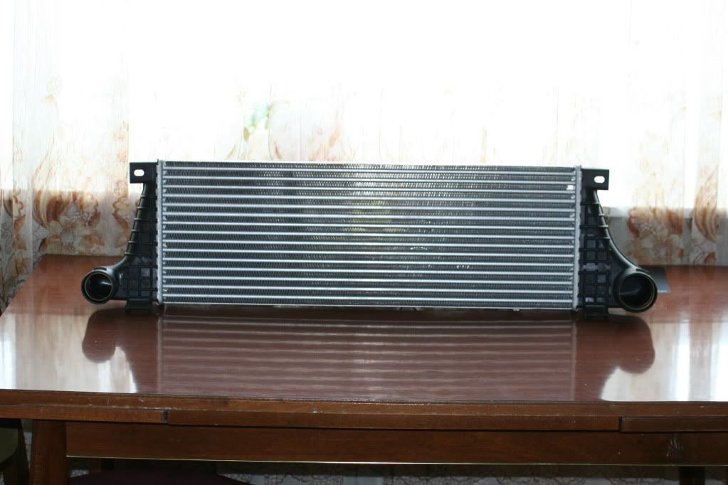

For now this has arrived:

Wow the paint turned out very nicely after the polish and detail work you did. I bet that little Colt moves quick with the 4g63t in it. Nice work! Can't wait to see more.
