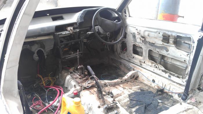

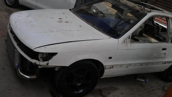

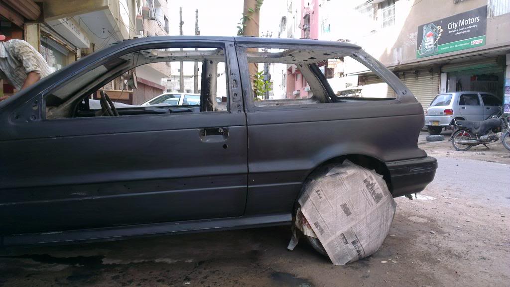

Started off as a LHD Mitsubishi Colt model 1990 4g15 auto and ended as a RHD Mitsubishi Colt 4g63T FWD Manual.

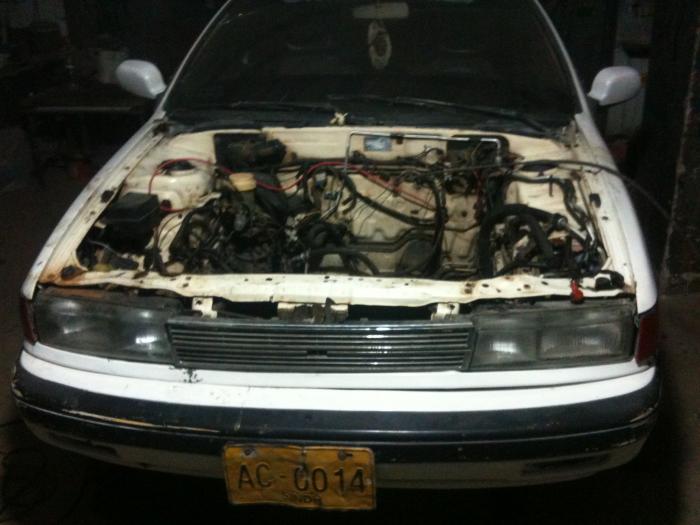

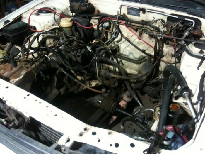

Starting with when i got it:

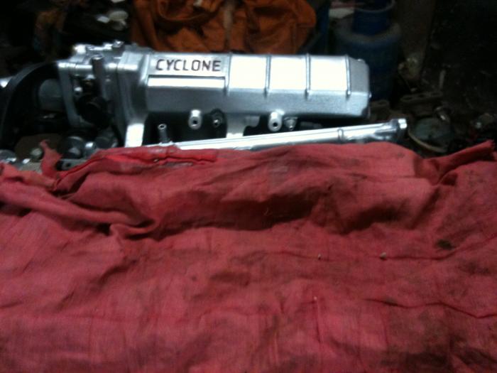

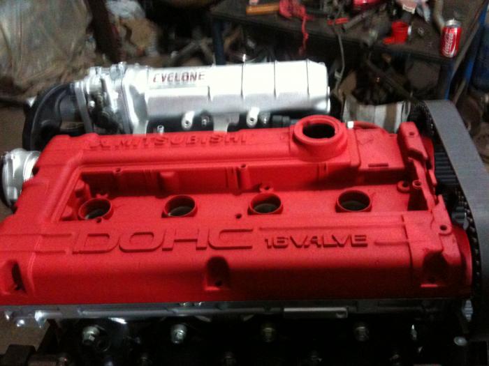

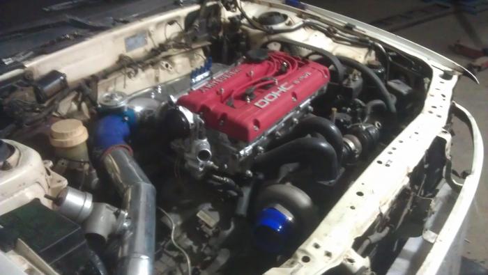

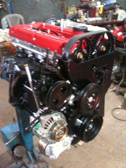

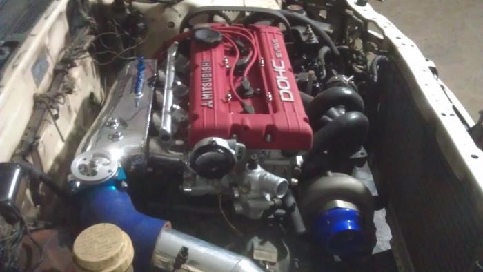

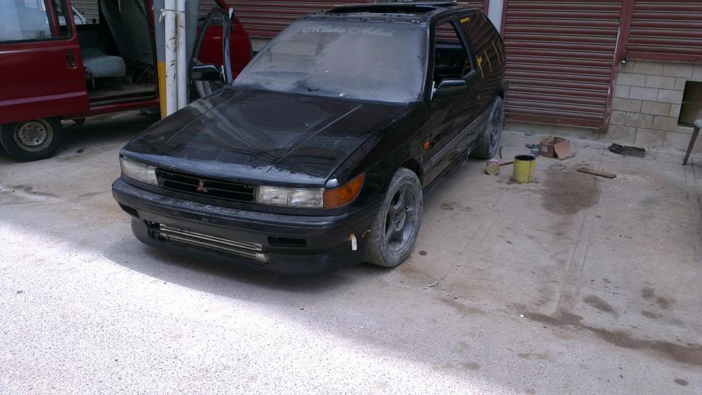

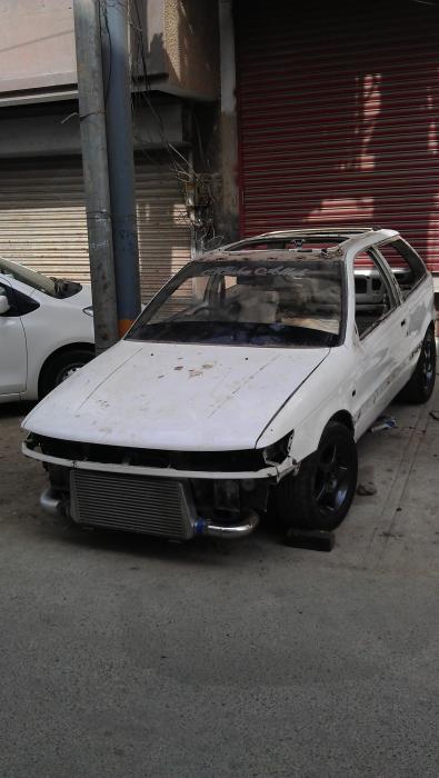

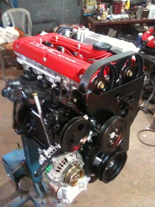

then the good stuff:

i just needed the dash, which i got from the junkyard and made a hole in the firewall to pass the steering column, got a steering rack to match and some pedals as converting to manual and we are good to go. Moved the steering from the left to the right by cut and weld :)
the 88 sedan parts are a direct bolt on to it so was fairly easy although time consuming.

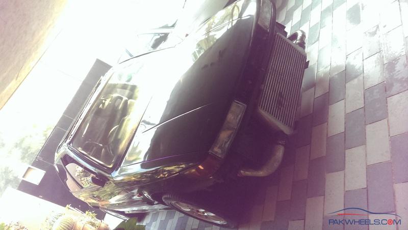

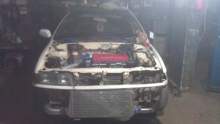

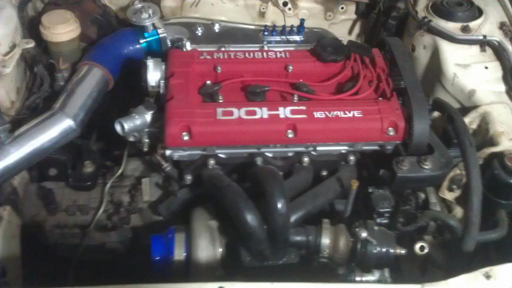

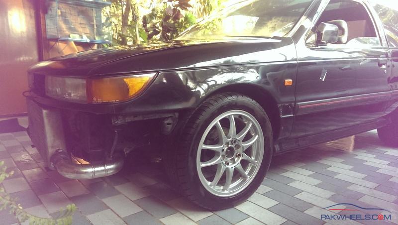

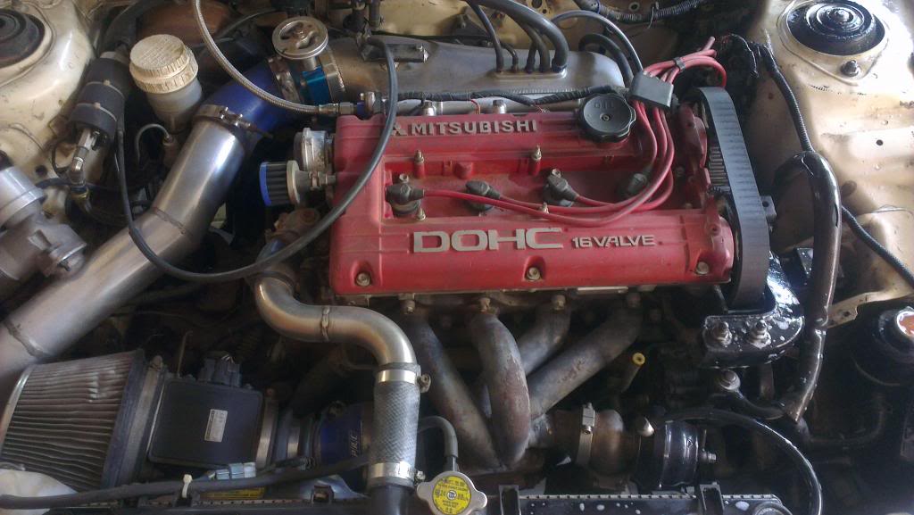

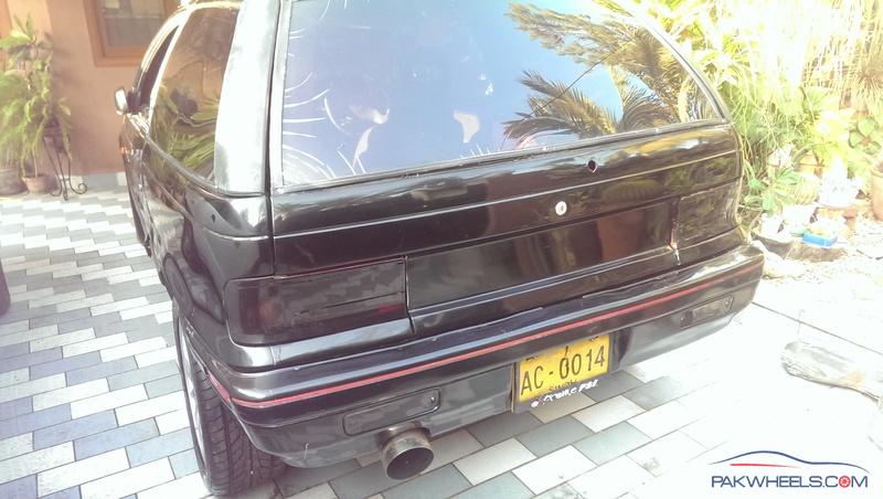

some pics of the car as it looks now, redid the entire car with new wheels, moonroof and cleaned up the engine bay. Some minor work left and then will post more pictures.
