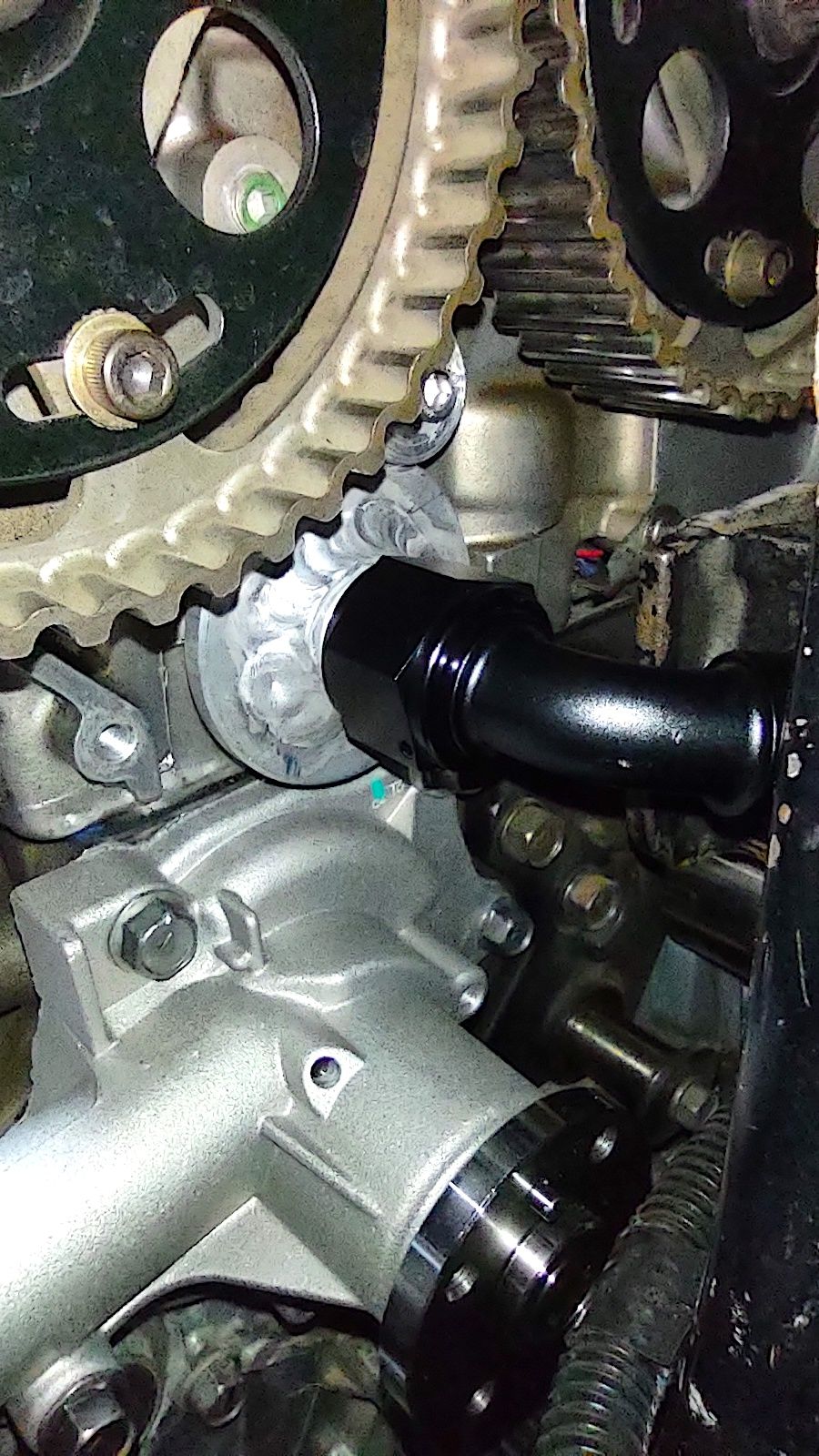

I am working on my 1g to have better engine cooling since recently I am motivated to take the 1g out to the streets a bit more. The block is filled 2/3~3/4 and has a poor coolant flow to the head. It has no problem in cruising or short period of time. But where I live started to be too hot to use being like this, especially at low RPM. I am running a small auxiliary water pump directly to the cylinder head.
Where I live started to be really hot in this week. It's around 118~122 degrees F range yesterday. I took my 1g out to see if the auxiliary water pump and the fluid cooler for electric power steering pump would be able to handle this heat. Drove about one hour by mixing pulling hard, slow cruising, idling and turning the engine off. So far it seems they are working very well.
Hiroshi, do you have anything in the thermostat housing? Is it no thermostat?
Do you regulate the flowrate through the head and auxiliary water pump in any way? Does it just run wide-open when ever it's on? Do you think the flowrate of water through the head with this system is more than what a stock engine would have with the thermostat wide open?
No I don't have the thermostat in this 1g. I control it through the ECU. Making it synchronized with the radiator fan, and also I installed a toggle switch to allow me to manually turn on and off. That helps a lot after shutting off the engine. You can still make the coolant flow without the engine running to avoid to get heat spot in the cylinder head.
No I don't control flow rate on this tiny pump. This pump would be just On or OFF by following the radiator fan activation temp. But it can make more coolant flow to the head at idle with a mechanical pump.
Since the block is filled 2/3~3/4 and it's disturbing the coolant flow from the block to the head, I didn't plan to drive this 1g on street much when built this engine, but recently I am motivated to take it to the streets to have fun. So I tried to make a bit more coolant flow for that.
I believe so, but with a stock mechanical pump. This pump is just a little support for the stock cooling system. If without the stock mechanical water pump like when the block is completely filled, it would require a much larger electric water pump. I now am wanting to do this on my 2g to see how it would work. Actually my 2g gets much hotter in this weather.

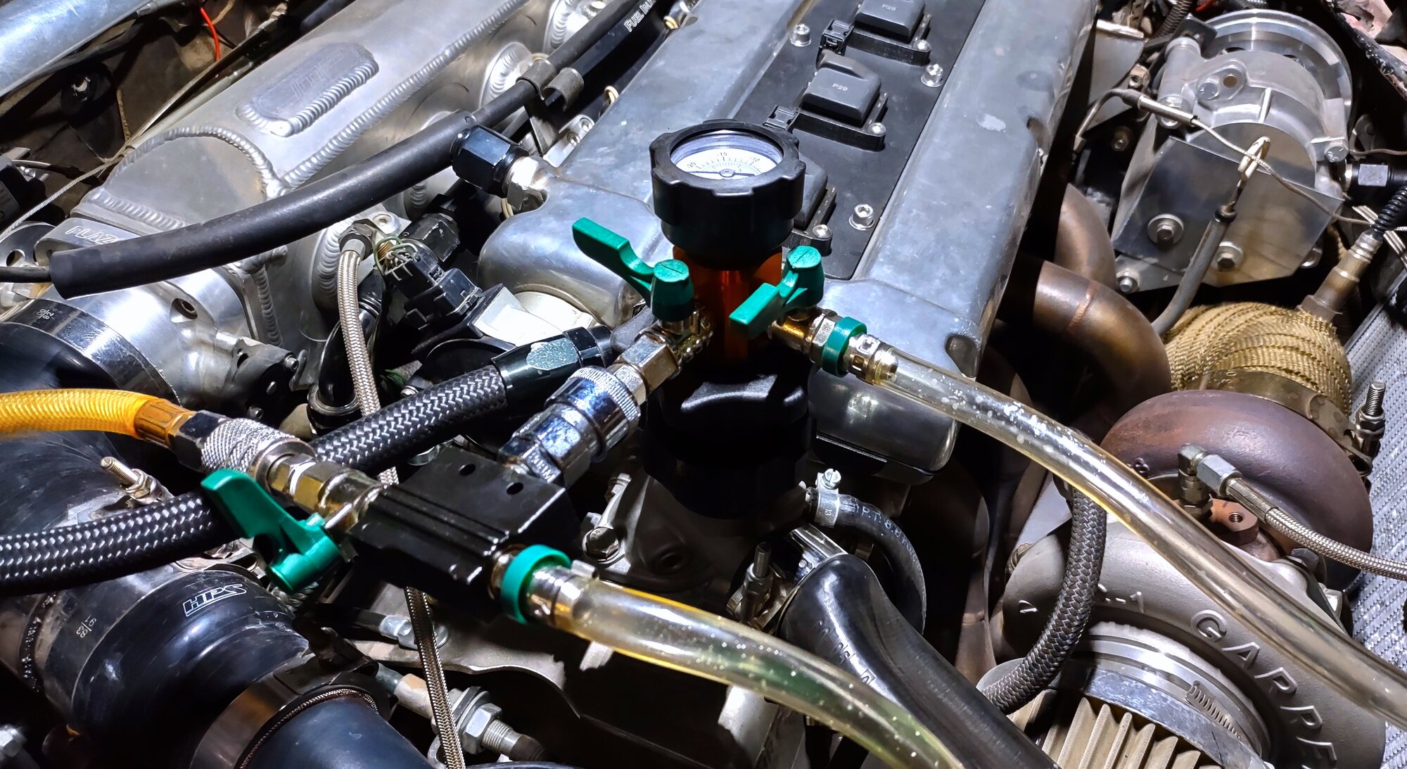

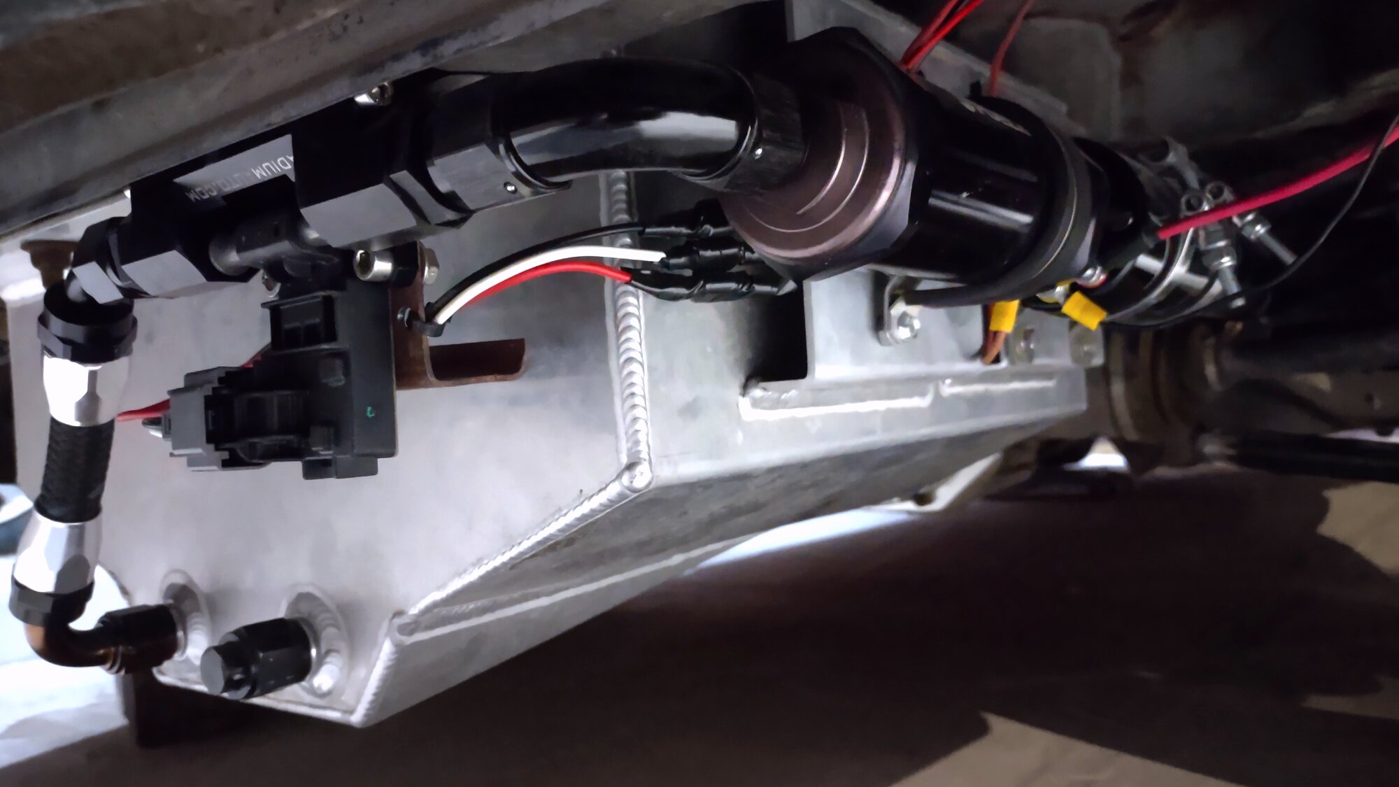

Finally installed the new fuel pump. And ran a coolant leak test with vacuum before firing up for the first time in 5 months since the fuel pump got failed. I hadn't done anything for 5 months to my 1g and it's collecting so much dust...
It was a Prodigy wasn't it?
Yes, it was a Fuelab Prodigy 42401 but was much older revision. Fuelab told me that the one I sent back to repair was built 11 yers ago. I bought it new back in 2017 or 2018, so maybe I got an old stock at that time. And Fuelab don't have replacement parts for this revision anymore. I was disappointed about that because I just wanted to repair. I didn't care if it was an old rev since the pump was working just fine in my setup with gasoline.
Anyways I had to buy a new one. I was thinking to order a newer revision 42401 through my wholesaler but Fuelab finally gave me a pretty good deal instead of warranty. Then in this time since I have been thinking to go more methanol blend %, I went a Prodigy 42402 which flows most in the Prodigy lineup before going a mechanical pump or a spur gear pump. The spec sheet I received says that's a Prodigy II.
Do you have any ideas about why the fuel pump failed?
According to a Fuelab tech rep, internally leaked and that made the controller wet. Also told me that the pump is now entirely different from the one I had and comes with a lifetime warranty.
I just did a quick pressure test by applying compressed air to fuel regulator. The old 42401 in my setup (10AN feed/8AN return. Regulator set at 55 psi) was building 115-120 psi max at 12.0v. This latest 42402 is building 125-130 psi max at 12.0v. But the flow is guaranteed at 100 psi though.
