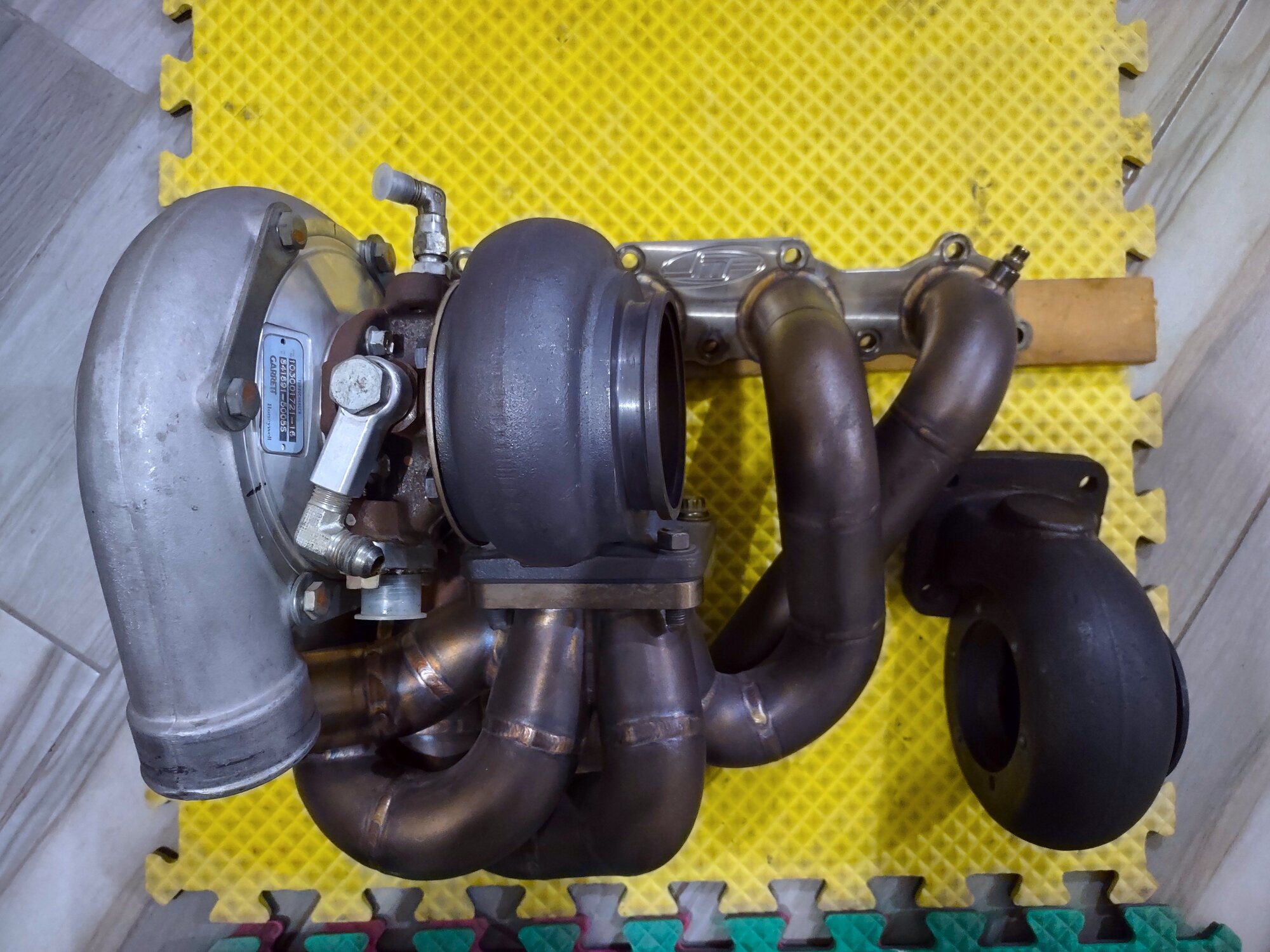

Going back with the .81A/R turbine housing for higher boost at high RPM. The .61 and .68 is fun while the boost is below 30 psi on streets. But obviously the flow is insufficient at higher RPM.

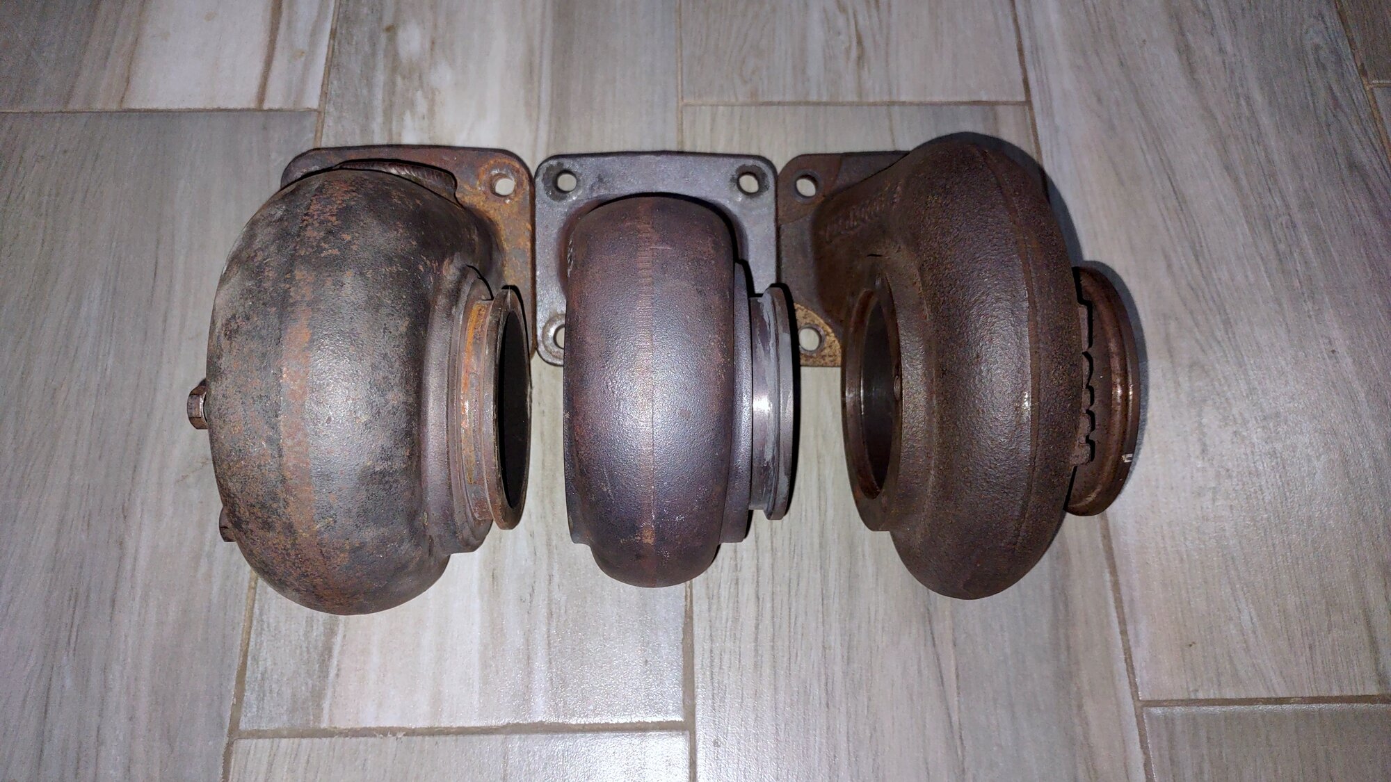

It's T4 open, the A/R is, .81, .68, .61 from left. I have a 1.15, too. But it's too big.
So what is the spool time on the previous set up compared to this new one
I compared when the engine was 2.0. Now the engine is 2.15, so there may be a little difference though.
Between the .61/.68 and .81, as for the spool time on my setup, somewhere around 500-800 RPM different. But the turbo is 67mm and the cams are 282/288, who run a 67mm or larger probably run very agressive cams like 280s or up. So anyways the agressive cams wouldn't allow us to see the boost below 5500rpm regardless of the turbine housing A/R.
With the same boost pressure range at high RPM, the exhaust back pressure is really different, with the .81 would make much more power due to less loss by the back pressure. The power difference significantly can be felt.
For example, I now have a 35 psi rate spring in the wastegate, but with the .61 or .68 housing, I need to use boost controller to have 35 psi. Without the boost controller, the gate would start to open earlier. With the .81 housing, I can have 35 psi with no boost controller or with much less duty.
With the .68 housing, I can probably go close to 40 psi by maxing out the boost controller with 2 port connection, but high back pressure would stress out many parts including the turbo and cause much power loss, that's I don't want. Anyways if I want to run 40+ psi of boost again, I definitely need to switch back to the larger A/R housing.

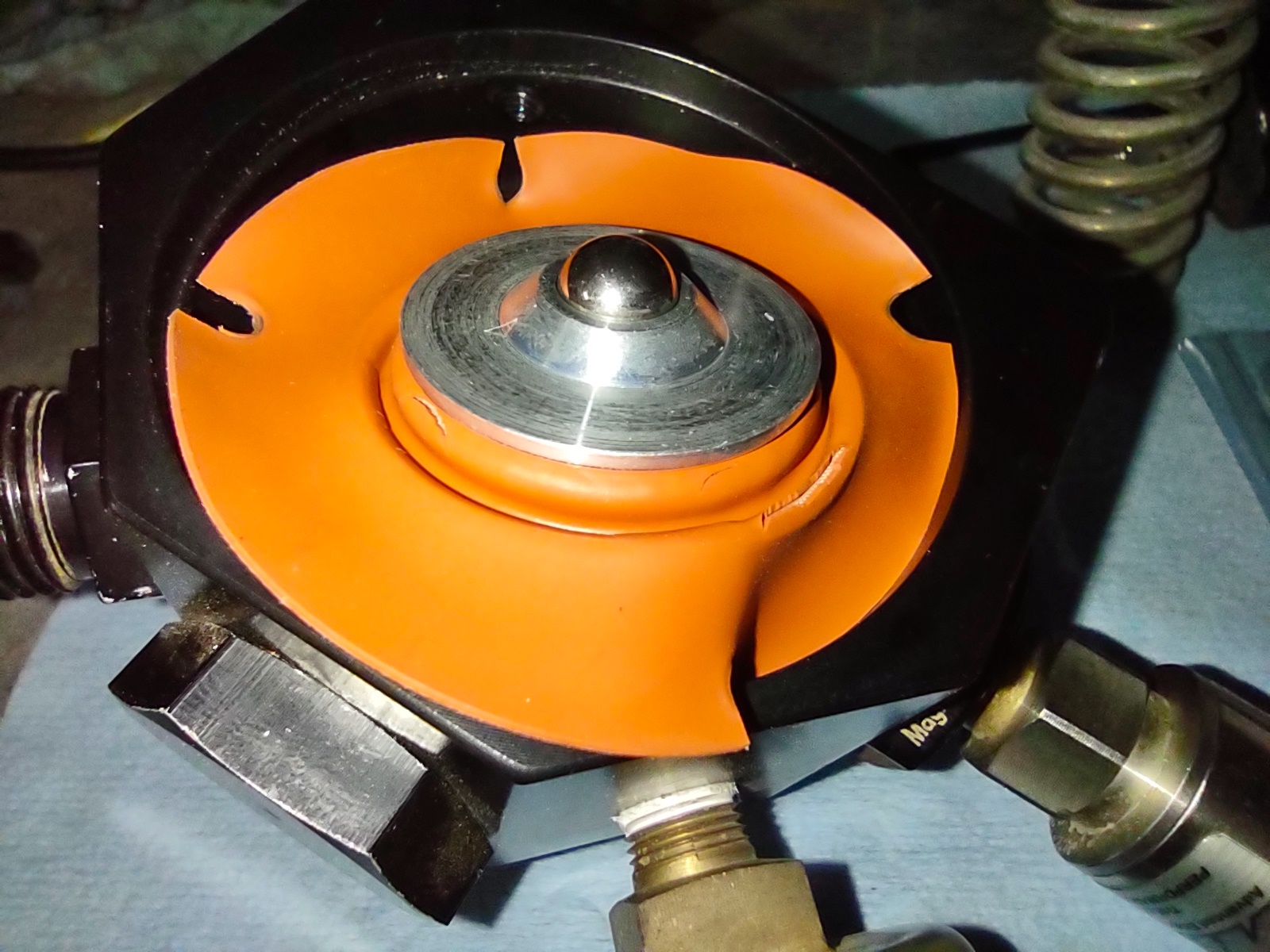

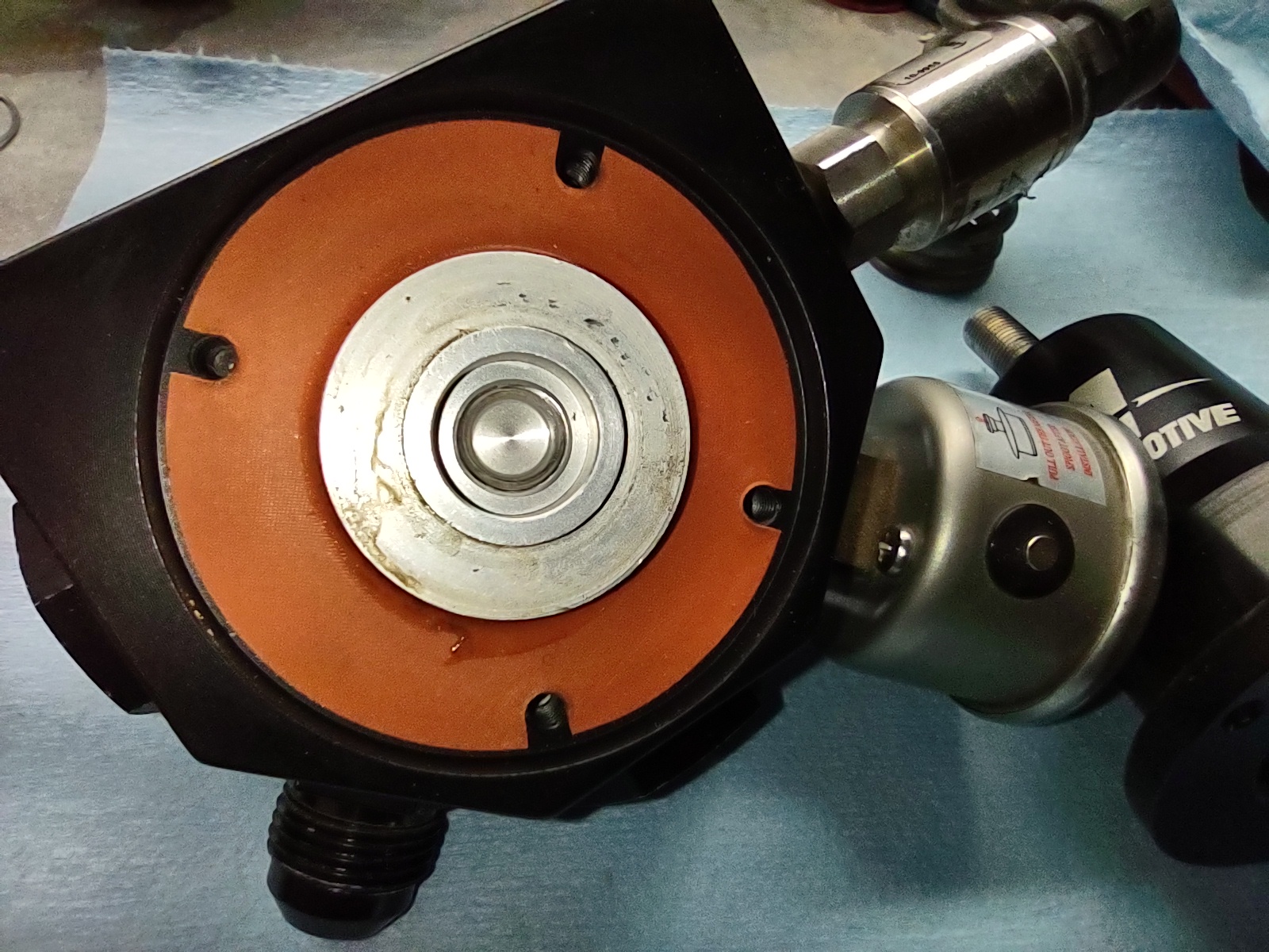

The crankcase pressure was about 3.5~3.7 psi under 30-32 psi of boost at 8000 rpm in 3rd gear. Before going higher boost, the fuel pressure started to be acting weirdly and unstable suddenly. Figured out the regulator diaphragm went bad.
