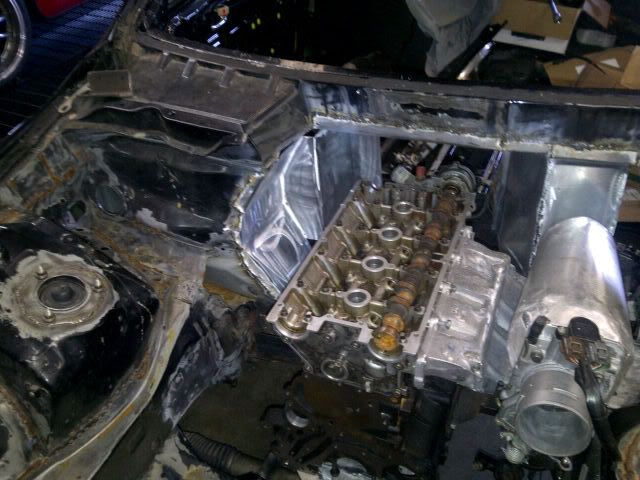

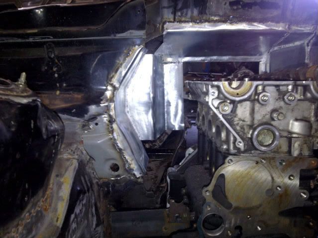

I have both style CAS, and figured I can make the firewall too far back, but would be pissed if I did not leave enough room. I want to be able to remove the head while the engine is in the car.
You might also want to consider using quick-turn fasteners and making that portion of the firewall removable so that you can access the rear portion of the engine easier when you need to service something.

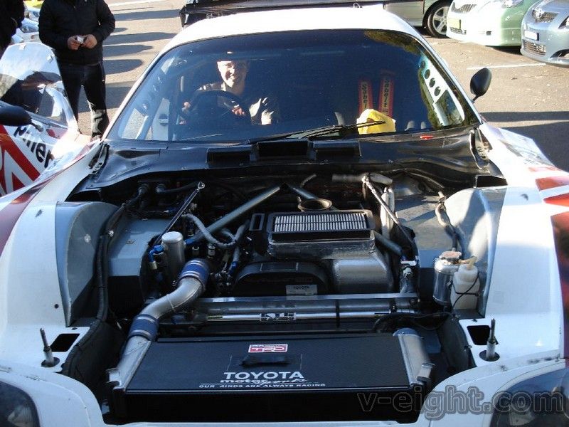

Oh, and for the 2J lovers out there, Toyota put the 3SGTE in the Supra for the JGTC back in the day.
Yessir. It seems to make sense to me doing it that way, so that was the plan. I was going to plug both the fronts.
I basically need it front mounted because I don't want to touch the firewall, but I want it as far back as possible.
I don't mean to threadjack here, but like this:

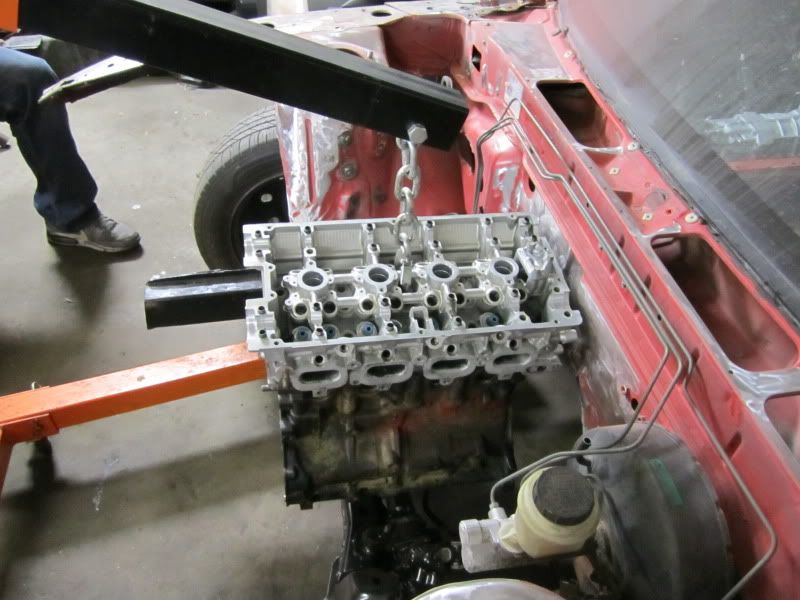

Also, I have been told that with the 95 cas you can not run adjustable cam gears. I have thought of trying to attaching the CAS wheel to an adjustable cam gear, but am worried about the cam and crank syncing together. What chassis is that? Looks cool.
I love that JGTC supra.

That's an S13 240sx chassis, not mine, but nearly the same as the one my 4G is going into.

Got more done on the firewall. There is adequate room to make a turbo manifold.
