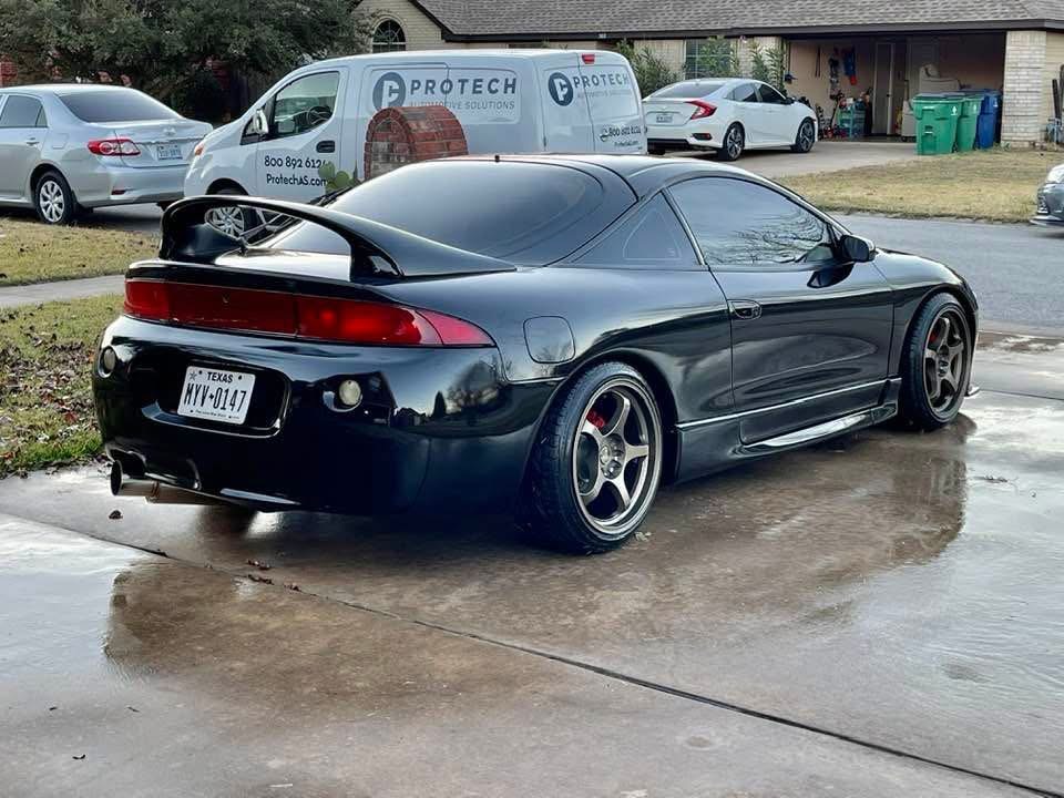

1999 Eclipse GST black on black. Car has sat for at least 5 years but has a lot of good parts on it
Current issues affect everything. Clutch pedal needs adjustment and feels like to weights 60lbs. Fuel pump has issues when warm, and car smokes at idle most likely needing valve stem seals. Missing all A/C components and lines
I’m not sure what my plans are for the car, I bought it cheap for what it is, but it does need a lot of work. The 5zigen FR7 wheels with stretched tires look amazing. Car has a fresh paint job as well

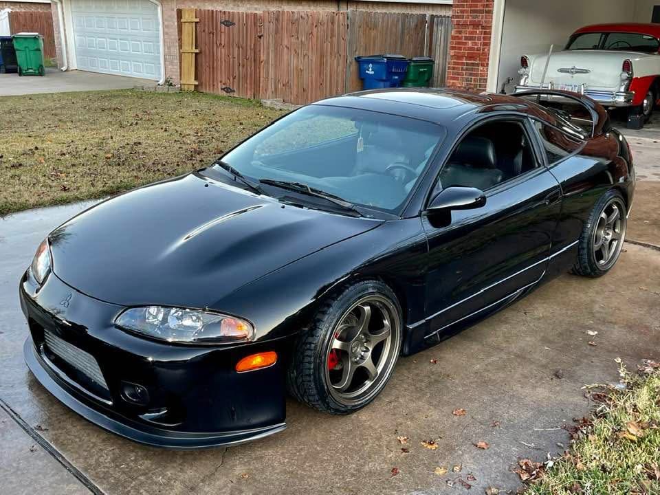

Here are some pictures of the car on black 18s from the white eclipse
