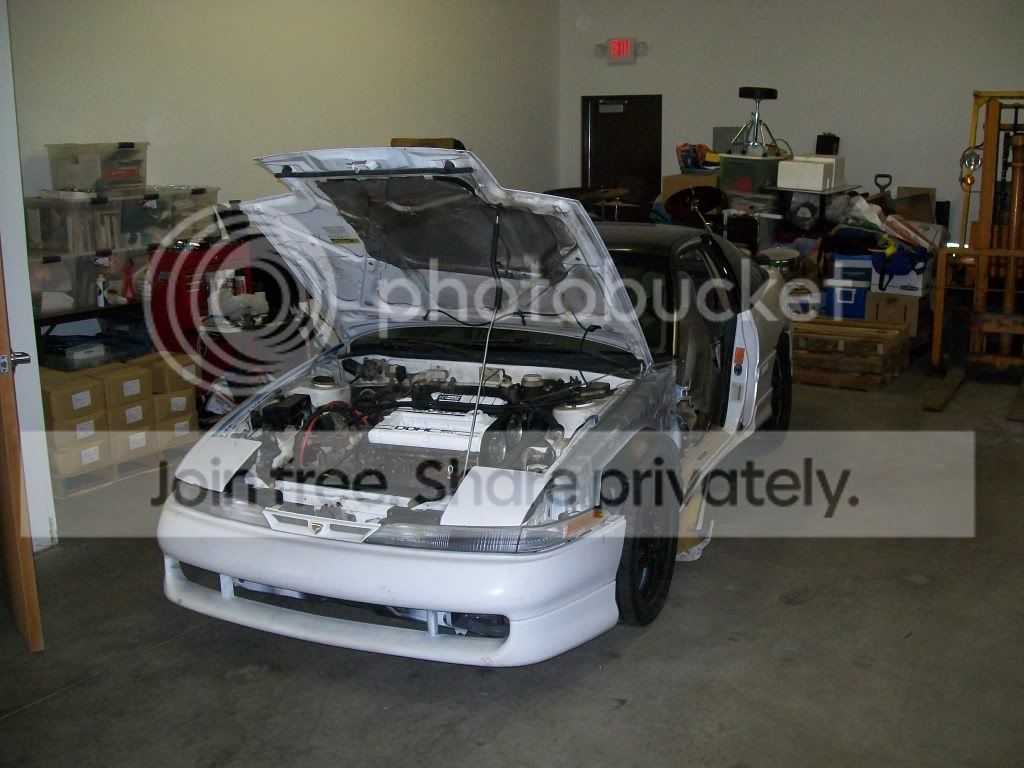

Well I touched up the valve cover and intake manifold and put it back together.

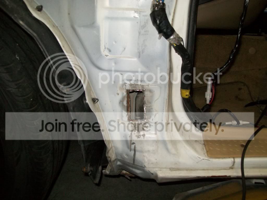

The JB Weld didn't hold up at all, like you guys predicted, so I cleaned up the cut around where the hinge would go and I'll probably have to have a plate welded in now won't I?

There are companies out there that sell stuff to seal gas tanks. If they dont work, Unfortrunately the only option is another tank. As for the spot on the door, I reccomend if you are planning on keeping this car, to invest in a welder. I got the cheapest one I could find, It was 100 bucks on sale. Its not the greatest, but it gets the job done.

Nice touch up! looks a lot better then your previous try at the valve cover and intake.
can i predict one more thing:
1- you will pull out the parts you painted so ugly you will end up painting it a solid color to avoid having look crappy. (possibly black.)
Yeah you need to repaint the white VC. It will turn yellow and look like shit from the heat.
That white and black theme on your valve cover and intake mani is secks!! I love it.
