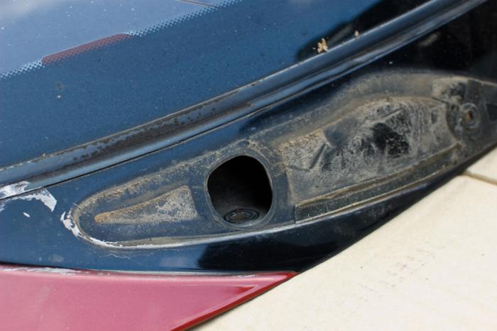

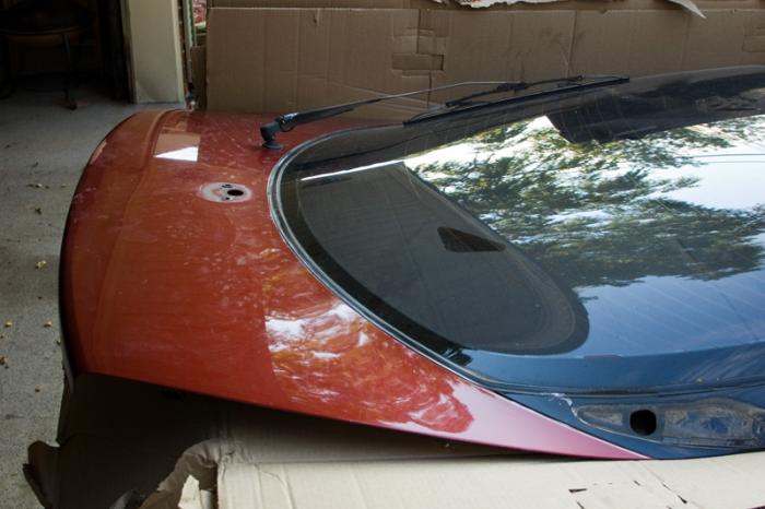

that looks nicely built, what will the hp ratings be? are u gonna keep it like this after or are you gonna put everything back on the gsx after?
