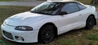

I have removed the following:
Cruise Control
Replaced OEM battery with Honda Half size battery
Battery tray & bracket
Replaced OEM hood with CF hood
Front & Rear Bumper Crash Beams
Misc. brackets & bolts (insert pic)
Glove Box steel plate (insert pic)
Spare tire & jack
Passenger side Airbag
If you look at my gallery, most of that you wouldn't have guessed. It makes a difference. I would say anywhere from 150 to 200 lbs can be saved.
I still have functioning A/C, but I believe my heater core is clogged. So I blocked it off.
