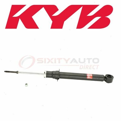

Can this fit on my 2g with stock springs? There is no eclipse specific shocks here in my country. Thanks
You need 341163 for the front and 341164 for the rear.
Those shocks are for an 8th gen galant (Asia/EU market). They will mount up to a 2G DSM however the ride height and feel will be different. There's a chance your car will sit even higher with those. Try getting a shipping quote from Rockauto as Marty is suggesting, and if it ends up too expensive, you can go with the ones you've picked and see how it ends up. 7th/8th gen Galant suspension is for the most part interchangeable with a 2G DSM.

if i use 341165. rear for awd? will the ride height change?

Is your car a FWD not a AWD? If so, then that is the correct strut. I wouldn't mix a shock that wasn't meant for my car though. There is possibly a difference in the way they mount up between a FWD and an AWD and the proportioning is probably different between the 2 models for a reason.

KYB representatives here keeps saying awd and fwd shocks are the same, they dont have the one specifically for fwd. Guess i'll take the locally made shocks with the correct part number than a kyb for awd.
The 341165 is now showing up as all models from what I can see here in the states so I would use them, as your KYB reps are saying also. They are not differentiating between AWD and FWD.
Here is a screen shot for a 1996......... and I would say it will not change ride height.
