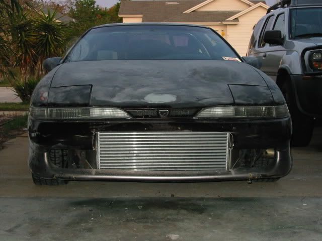

I've had my build on a couple other forums. I figured I could share it here as well. I frequent the board daily but rarely post. Oh and don't mind the S/N...ROFL
Bare with me while I get everything I can dig up posted.

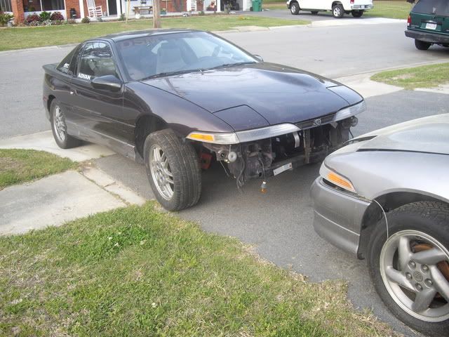

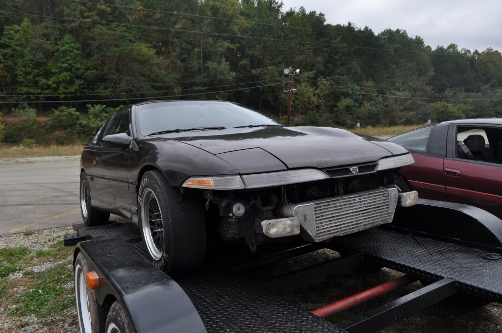

Well you all have been waiting here is the first page in the new car It's just pictures but trust me progress pictures will included!
* The bumper is off because it was on a trailer

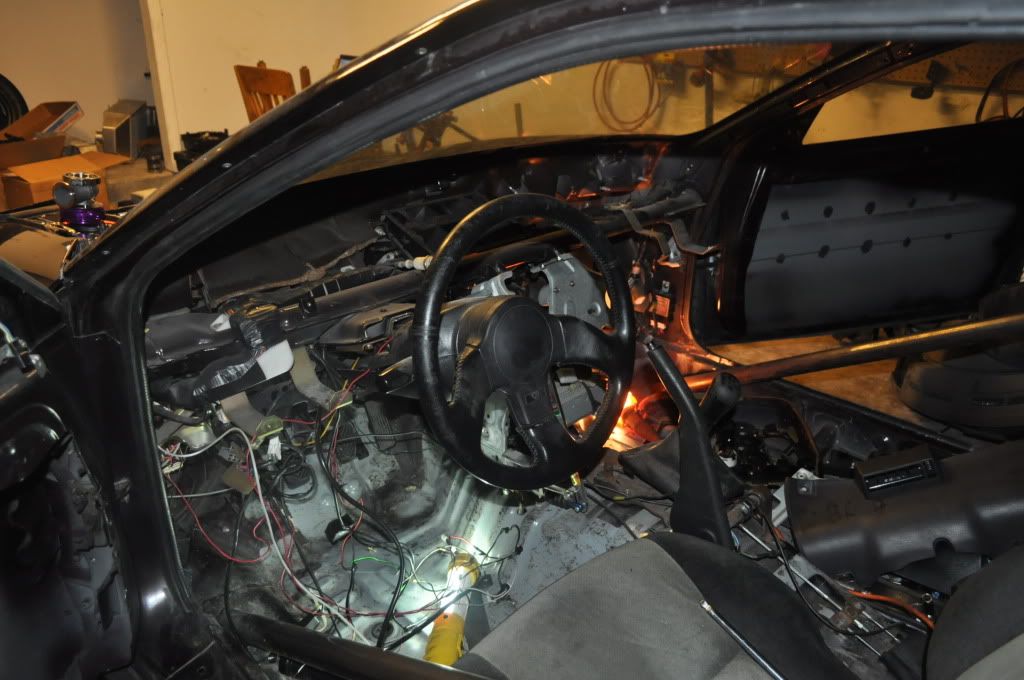

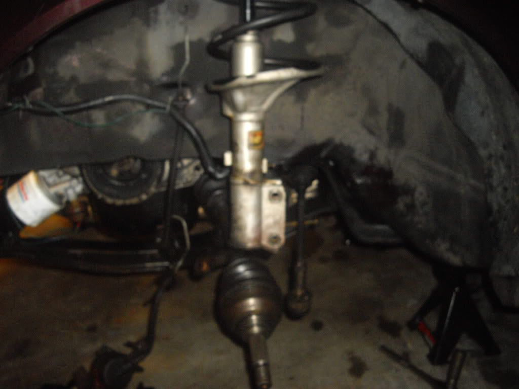

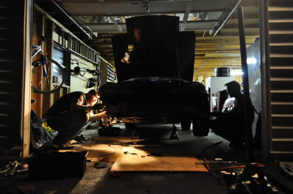

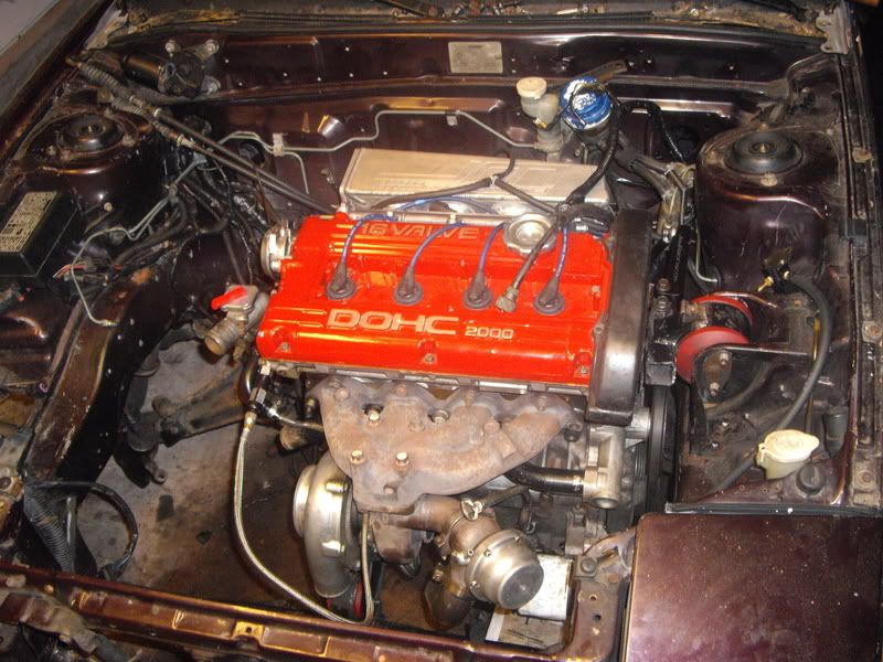

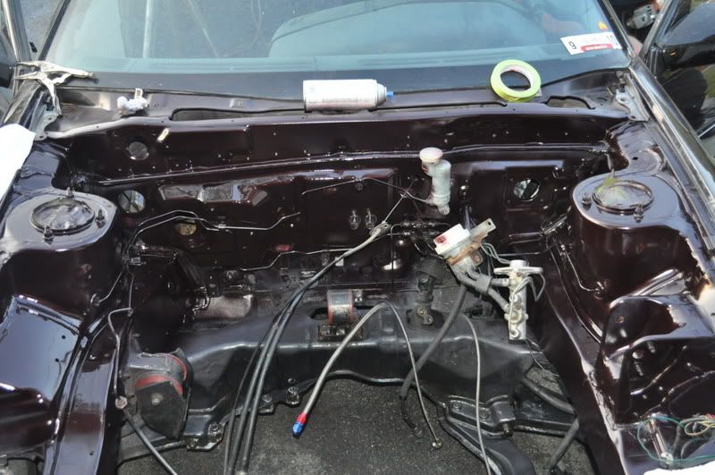

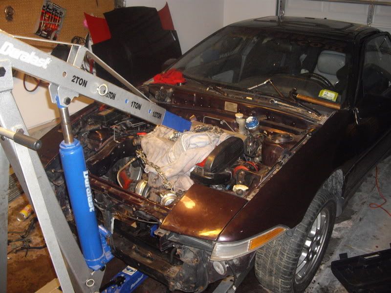

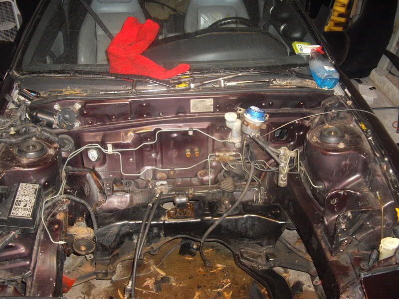

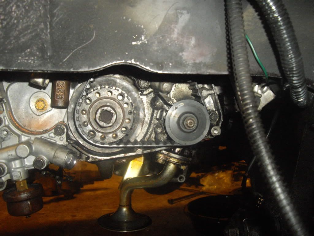

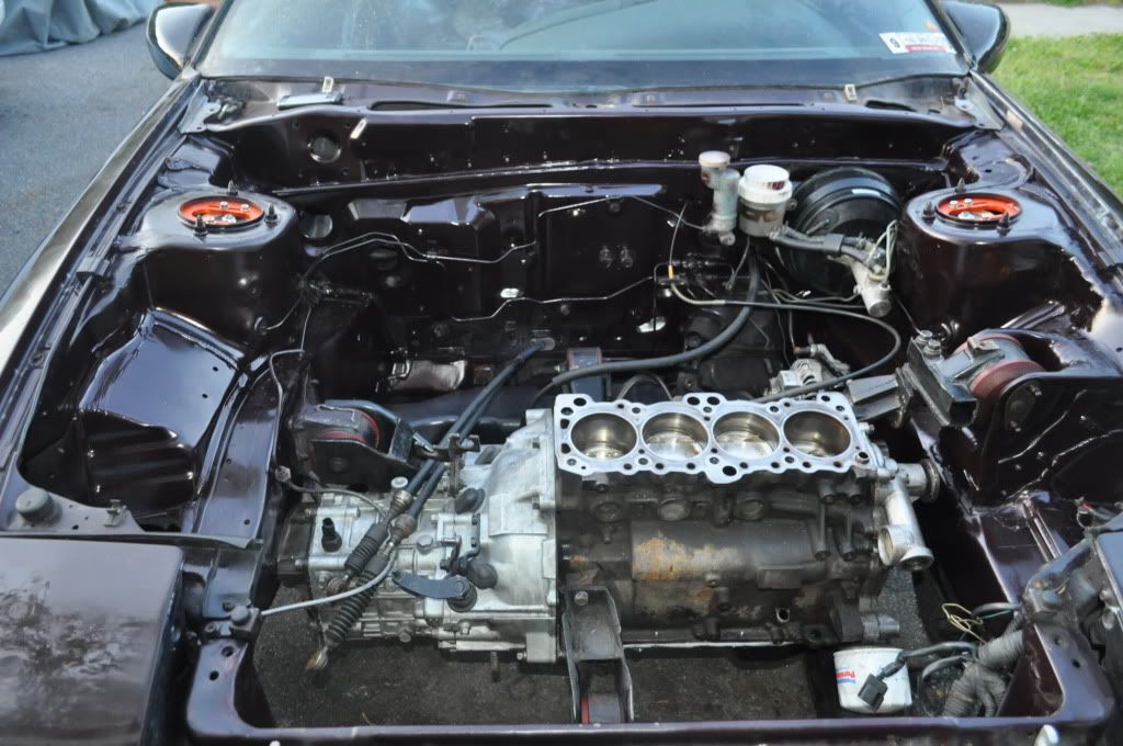

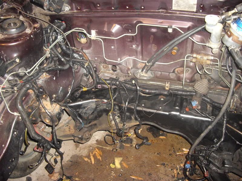

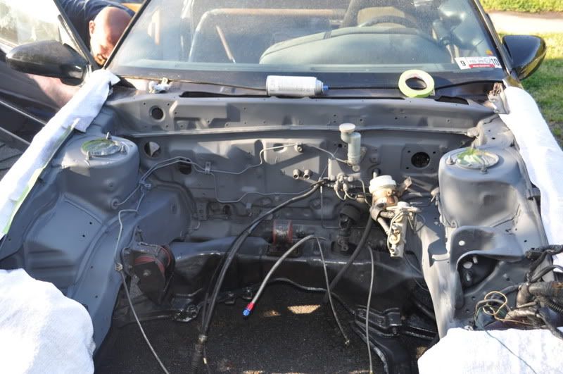

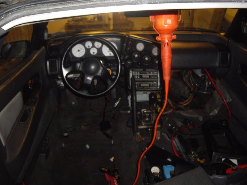

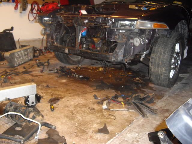

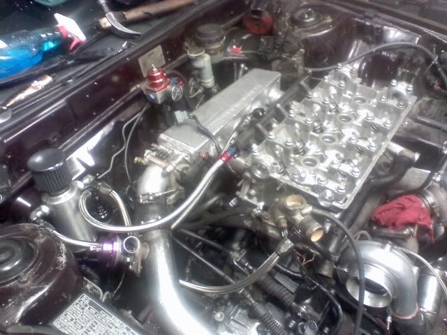

Got the bay cleaned up some, ran the Harness, Dropped the engine in.
Did some more. It doesn't look like much but believe me its a lot! There was a rats nest of wiring under the dash that Had to be taken out. Rewired the car for the gauges, vacuumed the car out, put in the black rear seats, put on working hatch struts, hooked up the lever that opens the hatch. I can't remember everything but here are some quick pictures.

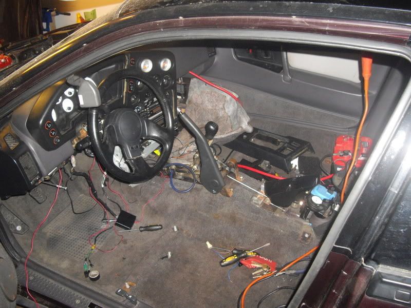

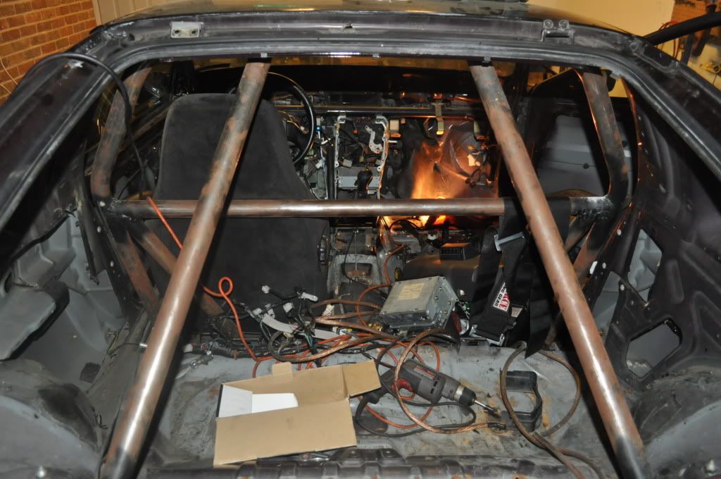

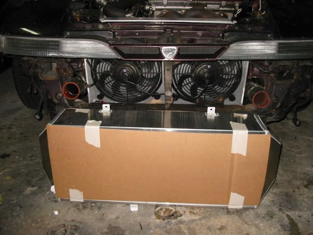

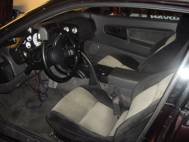

Ok well I did some more today. The interior is finished. I just have to mount the boost controller and turbo timer. I took the wing off and cleaned up the 2 pounds of dirt and leaves that were in there.

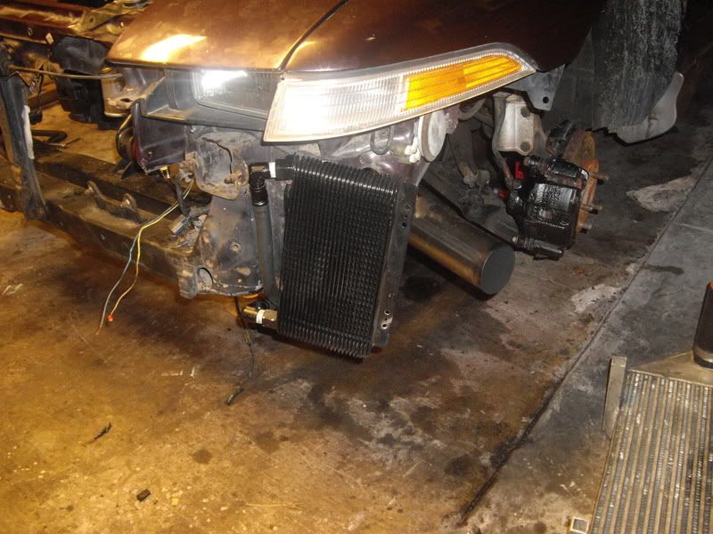

I also mounted up the oil cooler and exhaust. I wired up the alternator with the extended harness. As soon as I get a flywheel and sending unit I'll be set.

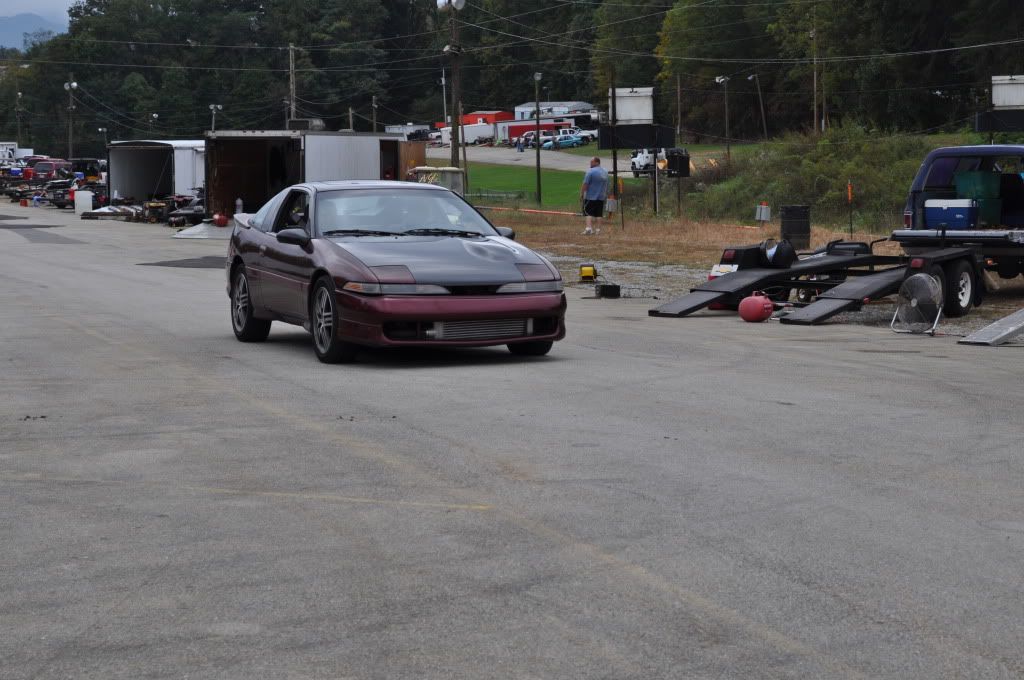

Well I am freaking stoked !! I had her at the track today for the first time.
First pass of the day I wanted to roll out of the hole and just get a feel for her at the track
r/t .435
60ft 2.472
330 6.181
1/8 9.144
mph 86.15
1000 11.553
1/4 13.555
mph 112.56

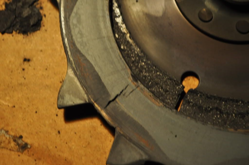

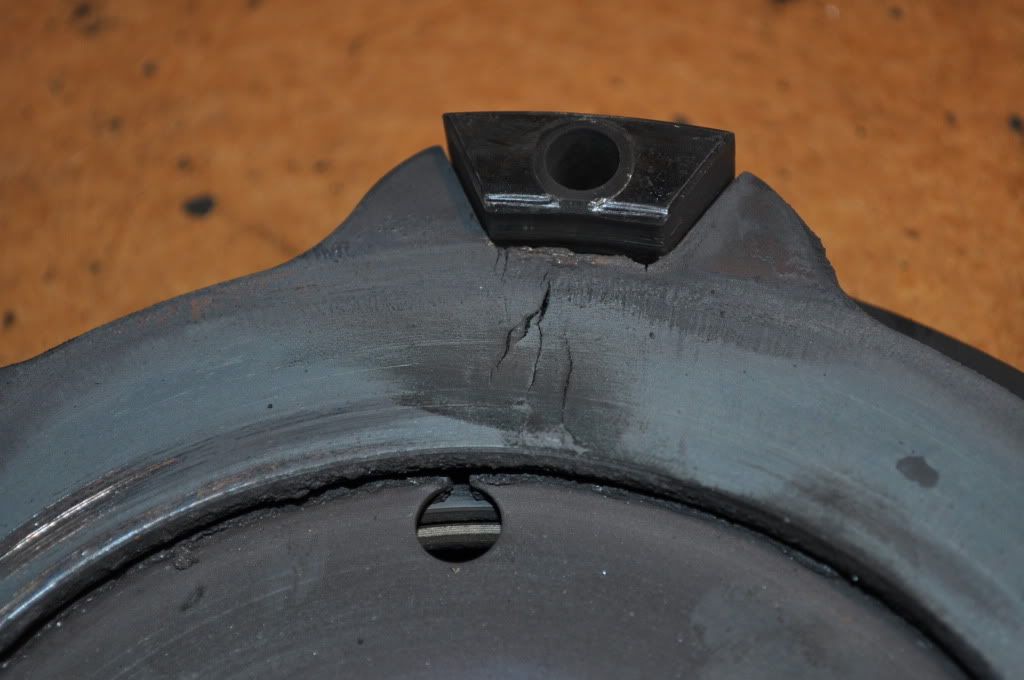

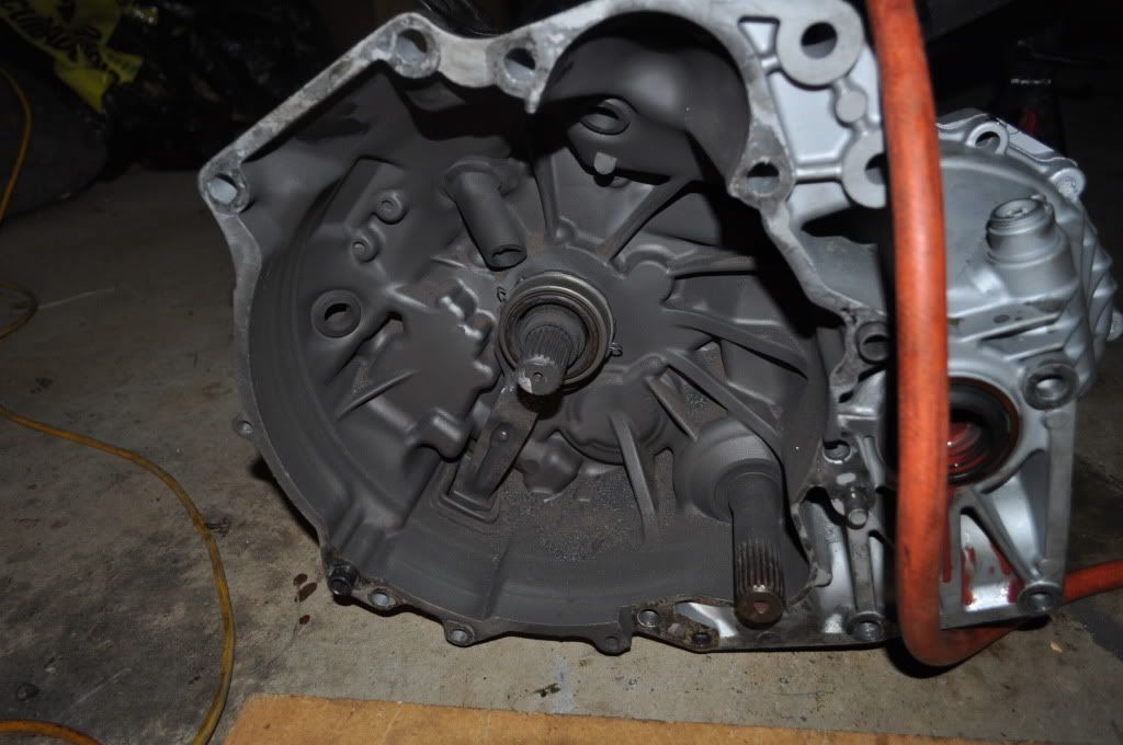

During the day at the track I was trying to make some adjustments to my AFR's well no matter how much fuel I pulled it would just run rich (10.0-10.5) the entire time. My airflow readings were jacked up.

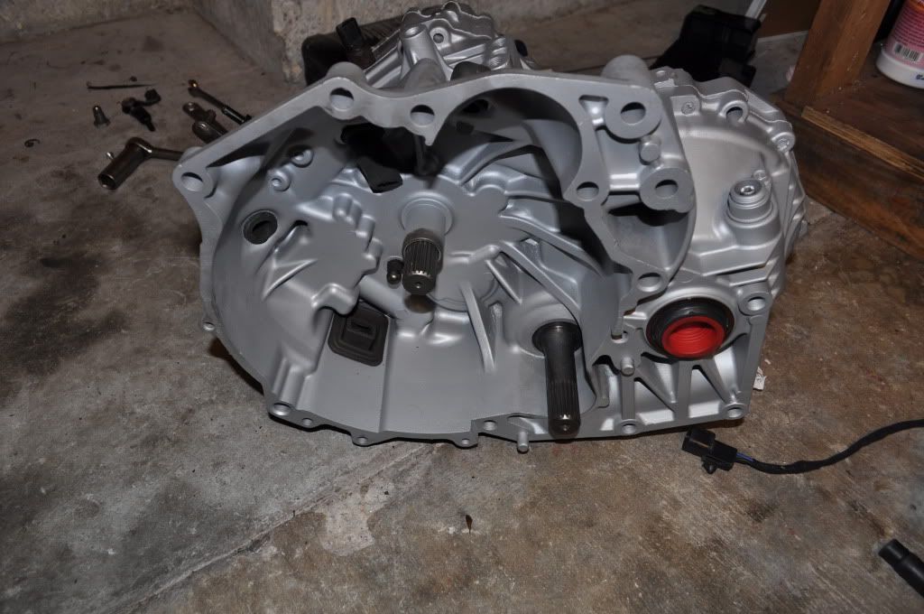

Well the trans took a shit. It will not shift at all. Well it does but it makes this lovely grinding noise. I decided to pull the trans and have a look. I found my 4 month old 2900 to be junk. The 6 puck is smeared, the pressure plate is cracked and it ate the Surface on the flywheel. Oh well time to order that twin disc again…
During pulling out the trans and swapping in different clutches a friend sits down in front of the car. He’s like hey Chris do you know your front mount is cracked? WTF? Yep…. I am guessing it has been cracked since I swapped everything into the car.
My logs weren’t looking the same I was getting 7 counts of knock and my afrs were always rich as hell.
So hey that 12.2 I ran isn’t too bad now :D

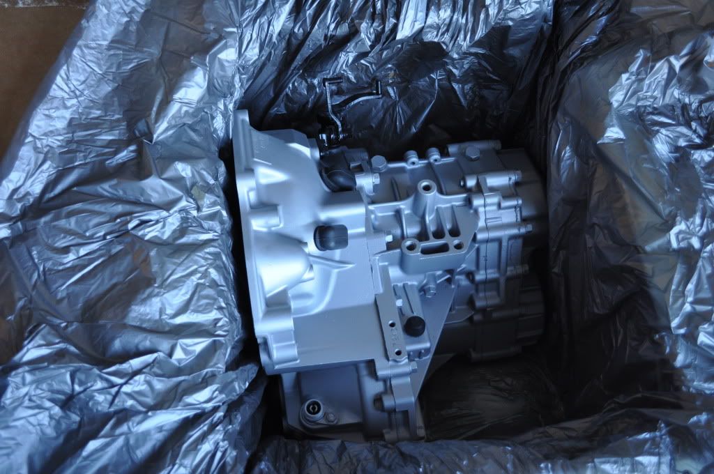

I am currently looking into a built trans. Just checking different sites and prices now. I am also going to get the twin disc again. Most likely it will be the PTT this time around.

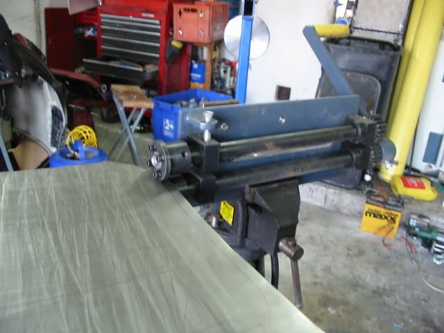

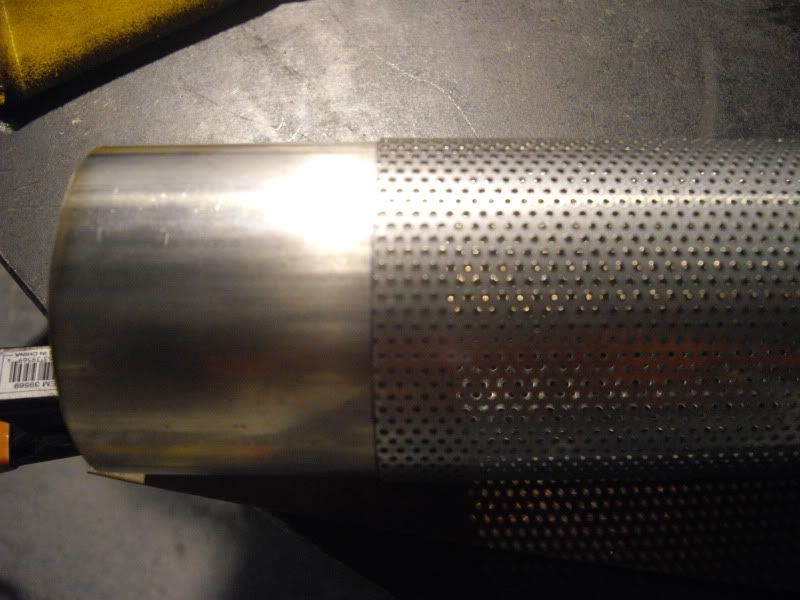

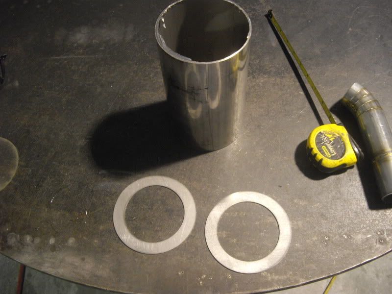

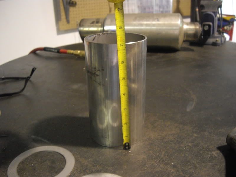

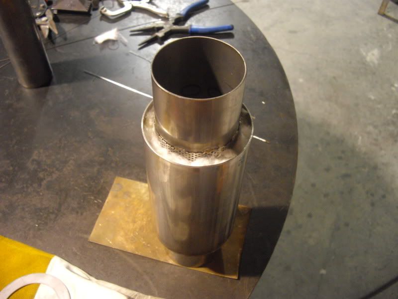

Took the car down to Fabworx today to get the full exhaust made. Gave her a little pull and guess what it holds boost. So much it pegged out my 30psi gauge and spun 2nd gear :D. After I get this tranny fixed it should be alot of fun once its back together!
Well.. it's been a little bit but the car is getting some changes. As most of you know the clutch disc and pressure plate took a shit. Well I'm in search for a twin disc for a decent price now. I have 2 brand new clutch discs for it so hopefully I can find a pressure plate and plates cheap!
Now other changes.
Rereading the rules for the classes at the show down basically states if you arn't running Q16 you need a full exhaust. Well after a couple hook ups she's getting it! It will be full 3" V-band from the turbo back with custom muffler.

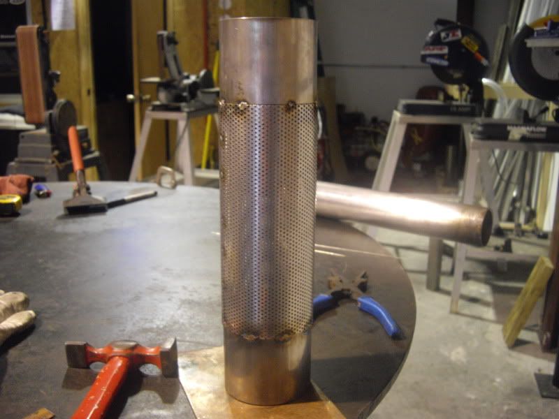

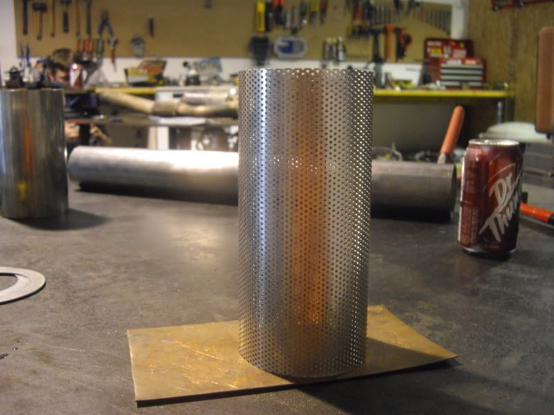

Some teasers. My custom muffler made curtasy of FabWorx.

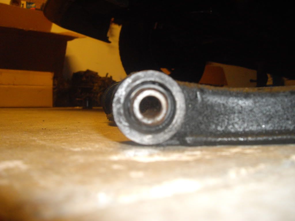

Full bushing kit (finally)

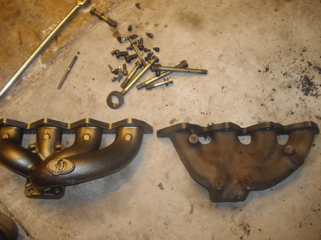

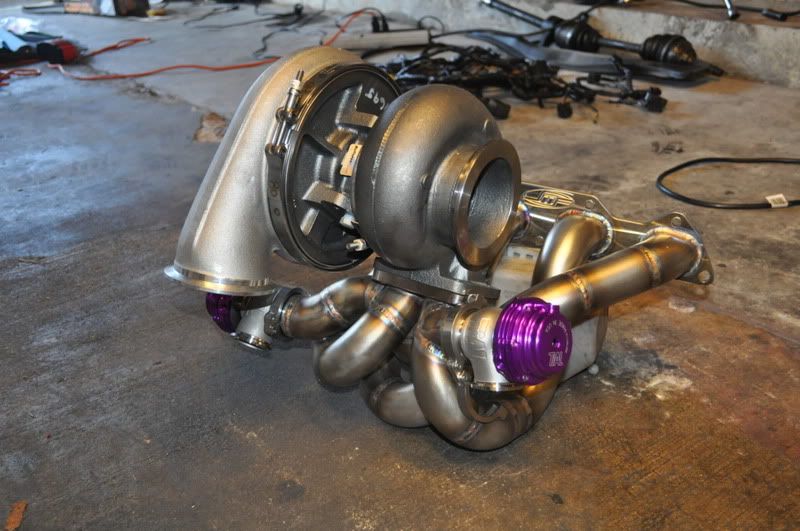

FP Race Exhaust Manifold

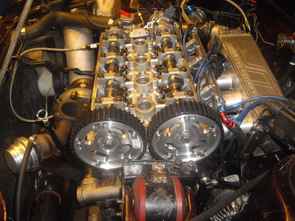

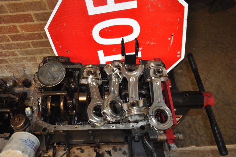

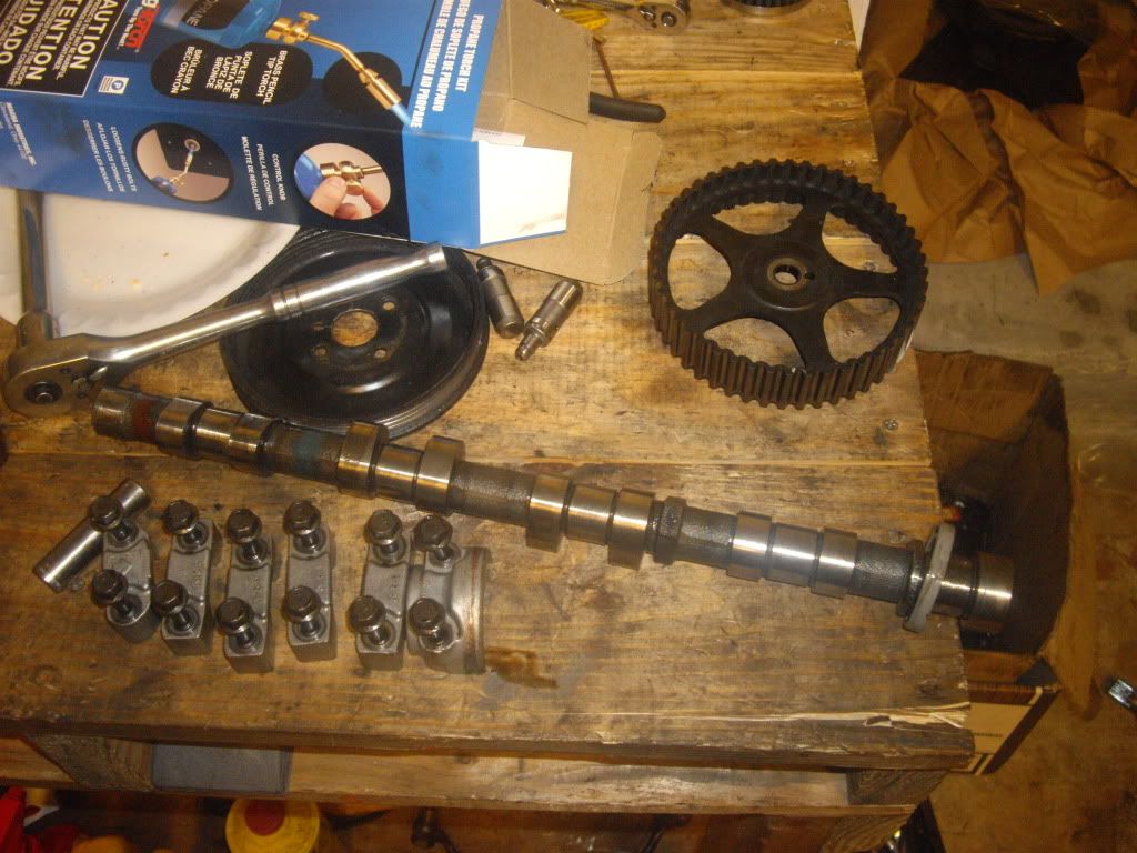

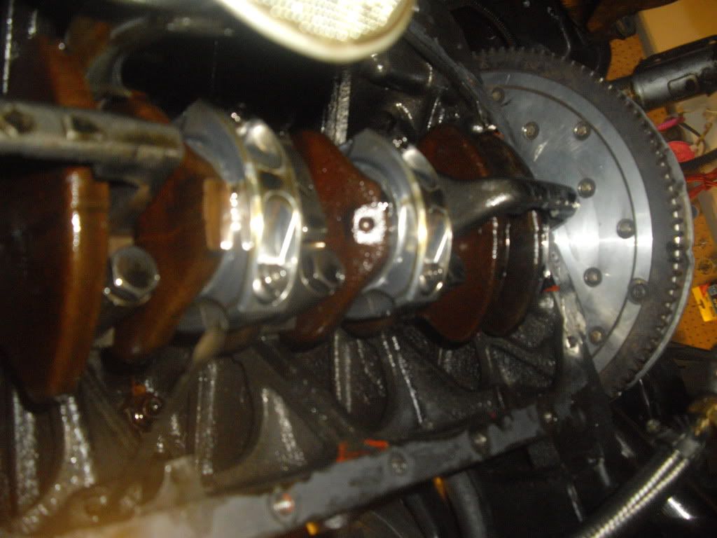

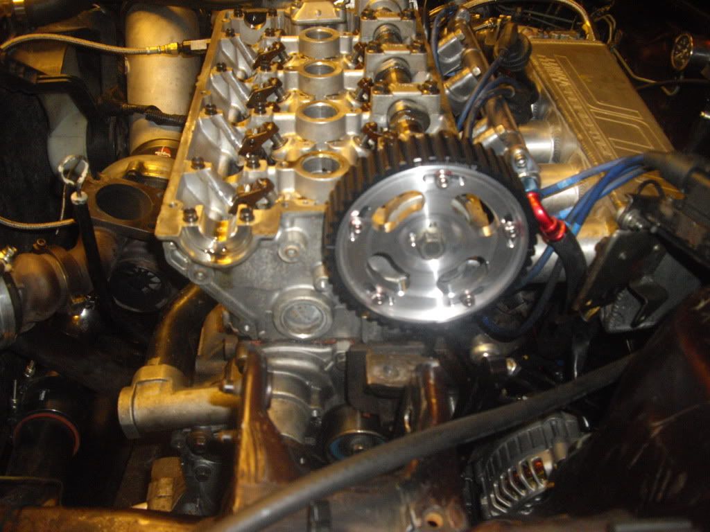

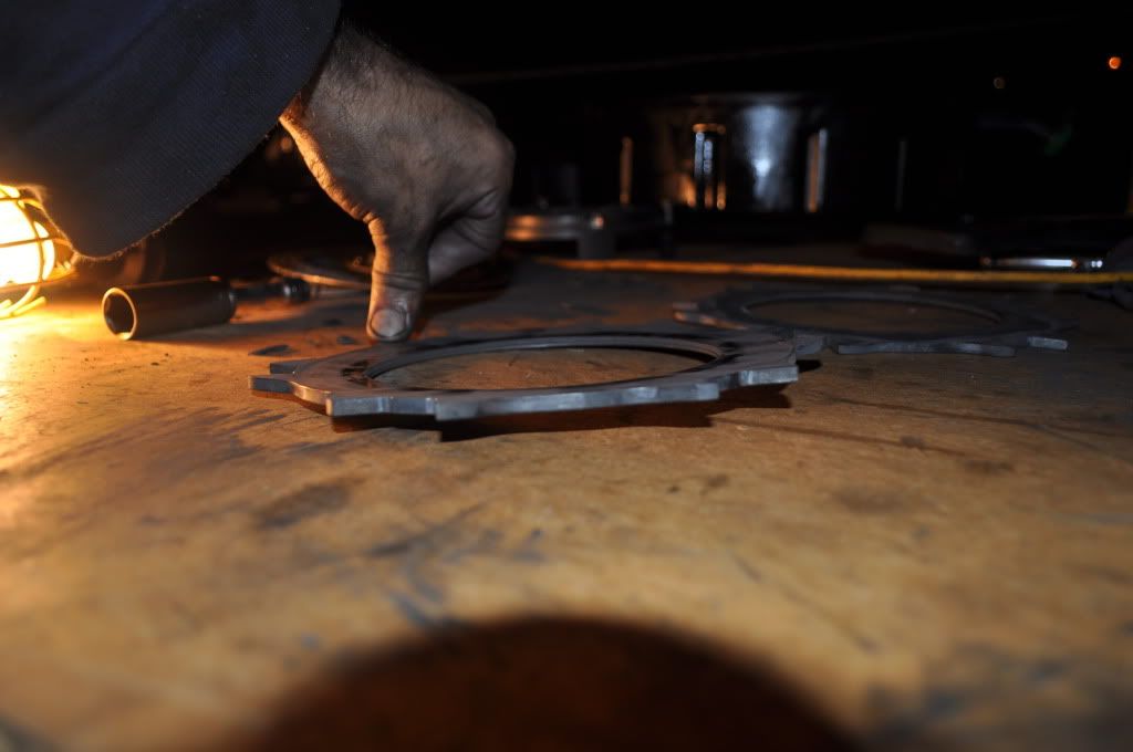

Yay for GRP action! Had to go looking for the rest of the broken rocker! They just look so sexy in there!

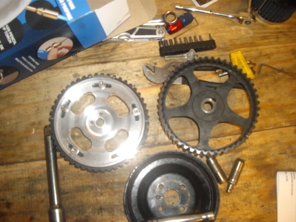

280 Exhaust cam removed!
Pair of pliers, Allen wrenches, 3/4 ratchet, filter 6an fitting oh and a Fidanza cam gear!

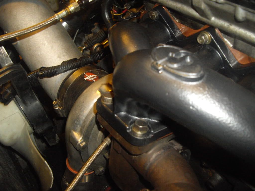

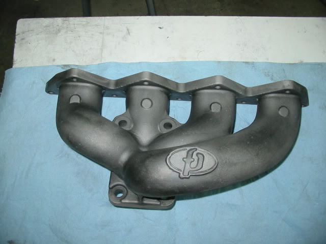

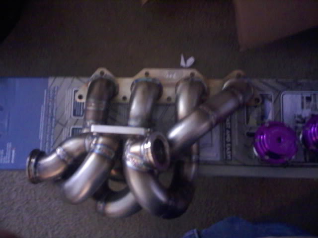

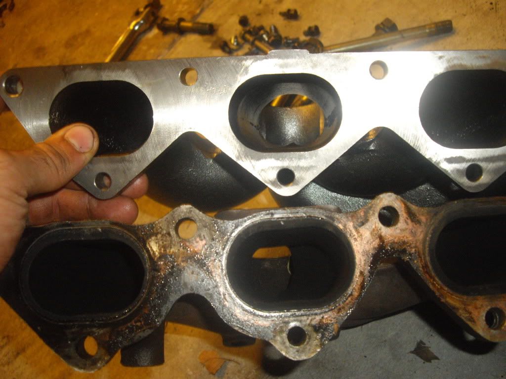

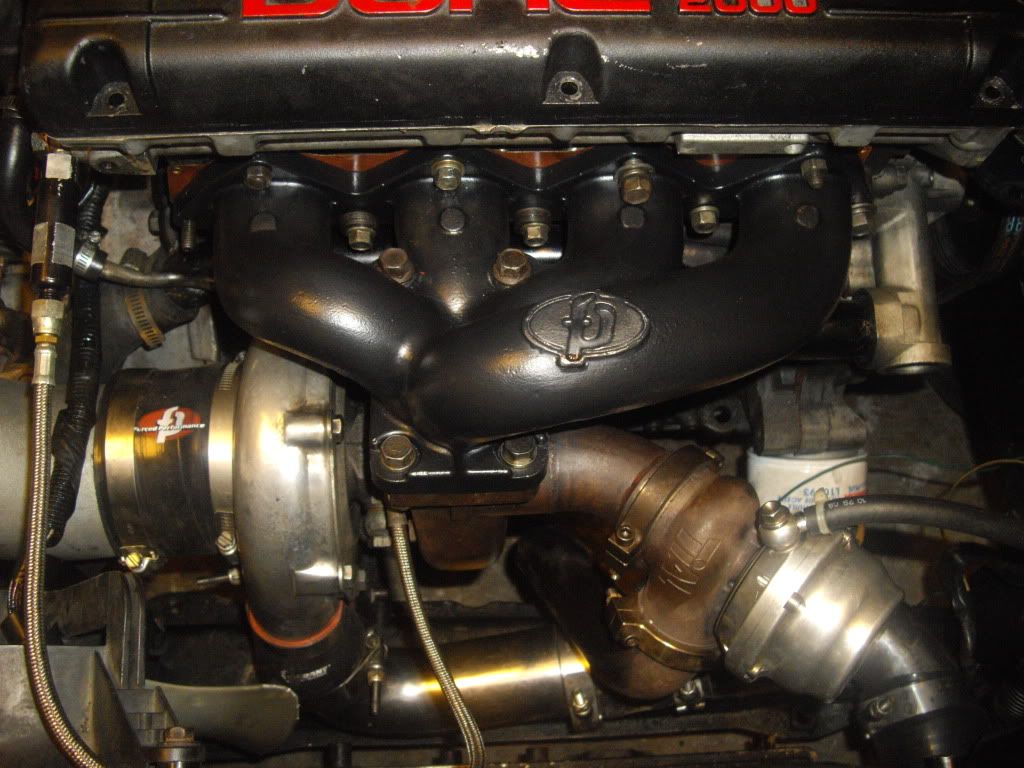

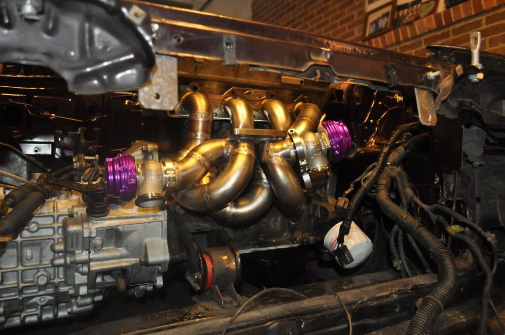

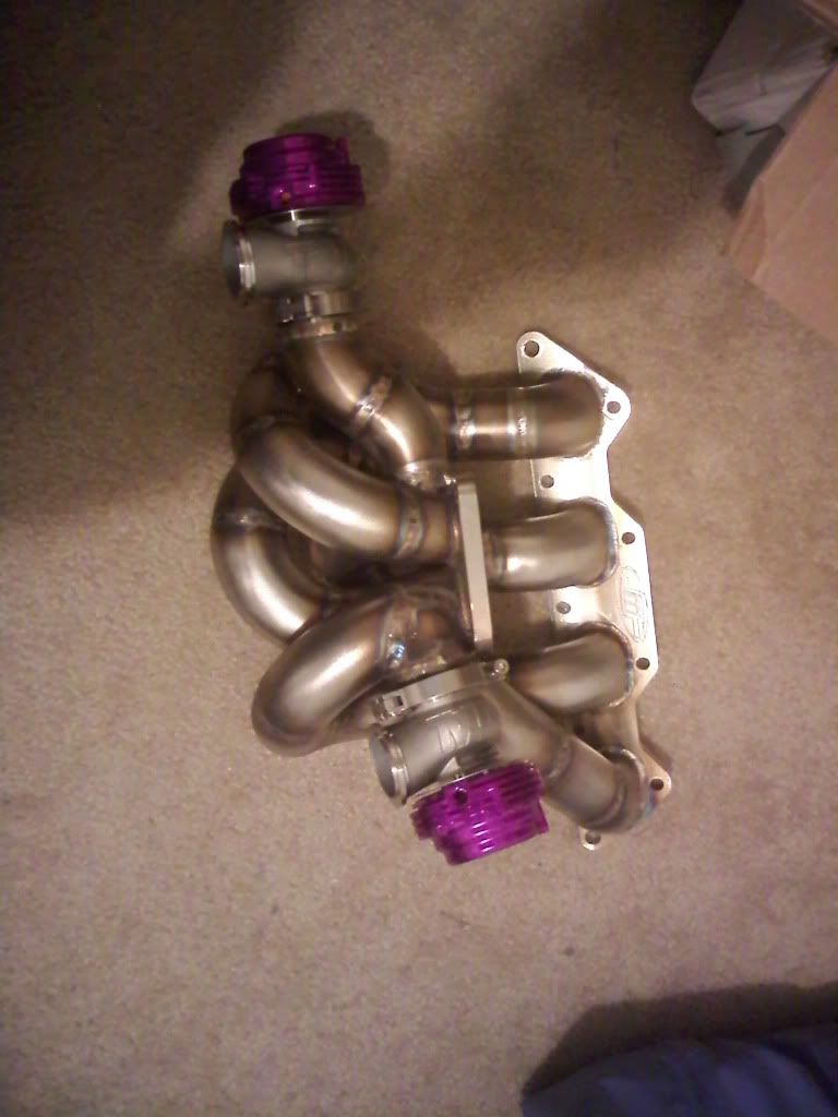

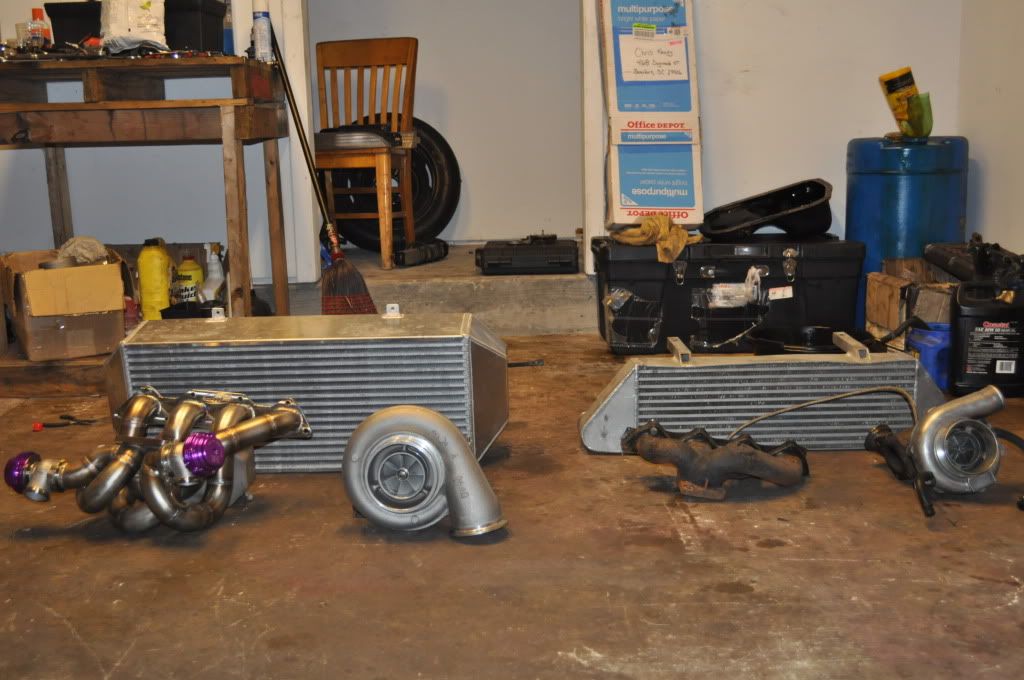

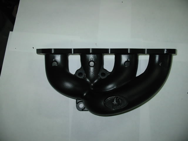

These are to show the comparison between the New FP race manifold and my current one Stock unported 2g manifold.
Hope you guys enjoy these pictures.

Bushings!

Fp Manifold Cleaned and Coated by Mike
Just got the FP manifold back from Mike (JAXWHITE1G).
Thanks man I love it!

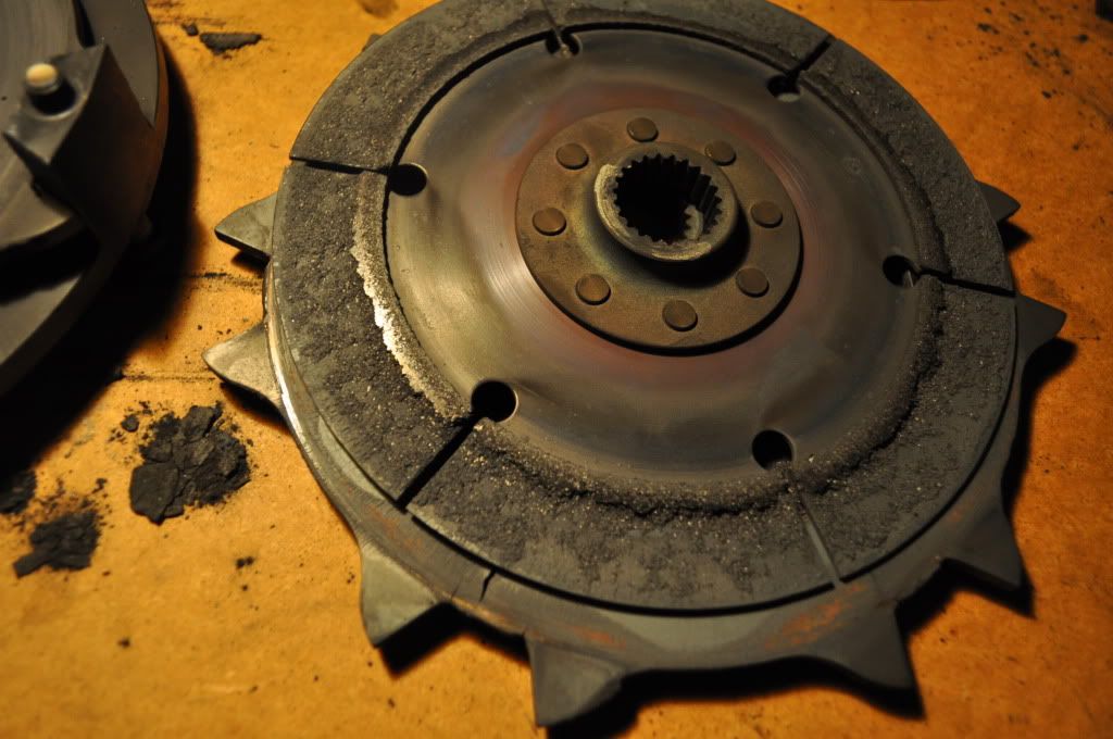

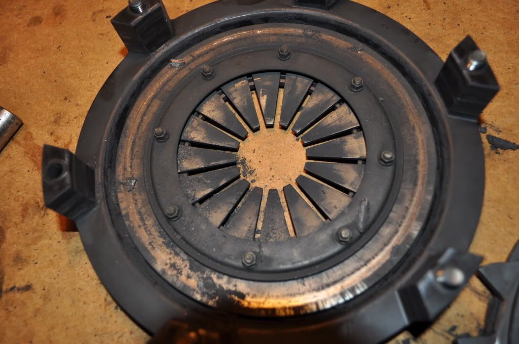

Since the new parts I have done a good bit more work. The car destroyed a

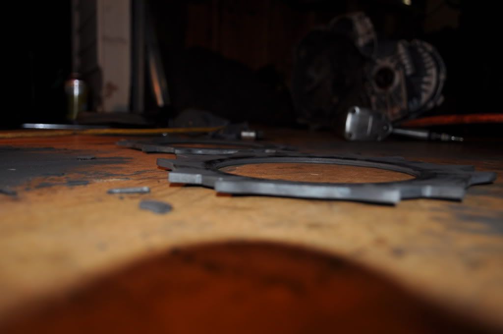

clutchmasters fx500 clutch. It is a solid 4puck.
This clutch was basically brand new and only lasted 9 passes down the 1/8 mile.
With that clutch I went 7.4@105 and 7.5@103 and various other numbers.

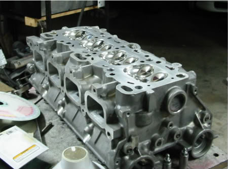

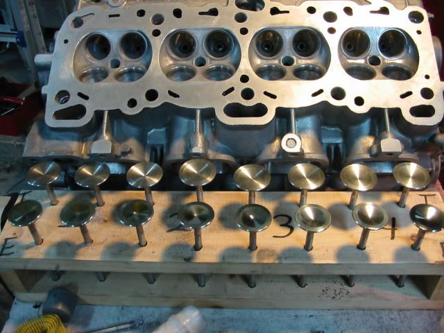

I have a friend Mike Ellis who is starting up a performance company and he
offered to do a head for the car to do some testing.
The head has Enginebuilder 1mm oversized valves, Bowl work, ported runners, and
Matched intake and exhaust manifolds.
I started polishing the exhaust valves in this photo, the intakes were as
shipped.

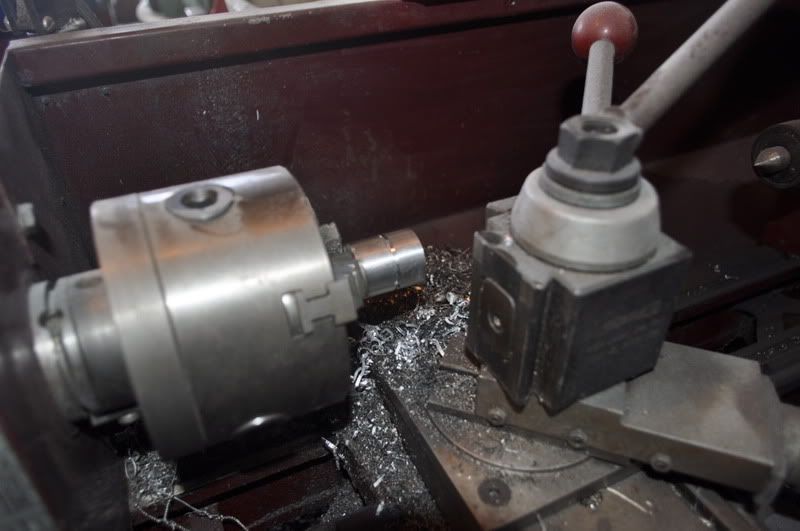

I couldn't get the machine marks out without first turning them on the lathe with
some oiled 1500grit sand paper.
Then I buffed them with a small cone buffing wheel. I tried a larger wheel but
couldn't get into the concave part of the valve well so this worked better.
The final product.
The final product.

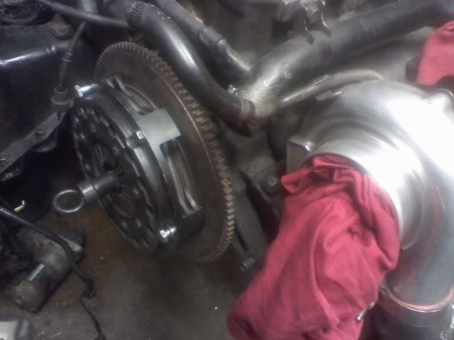

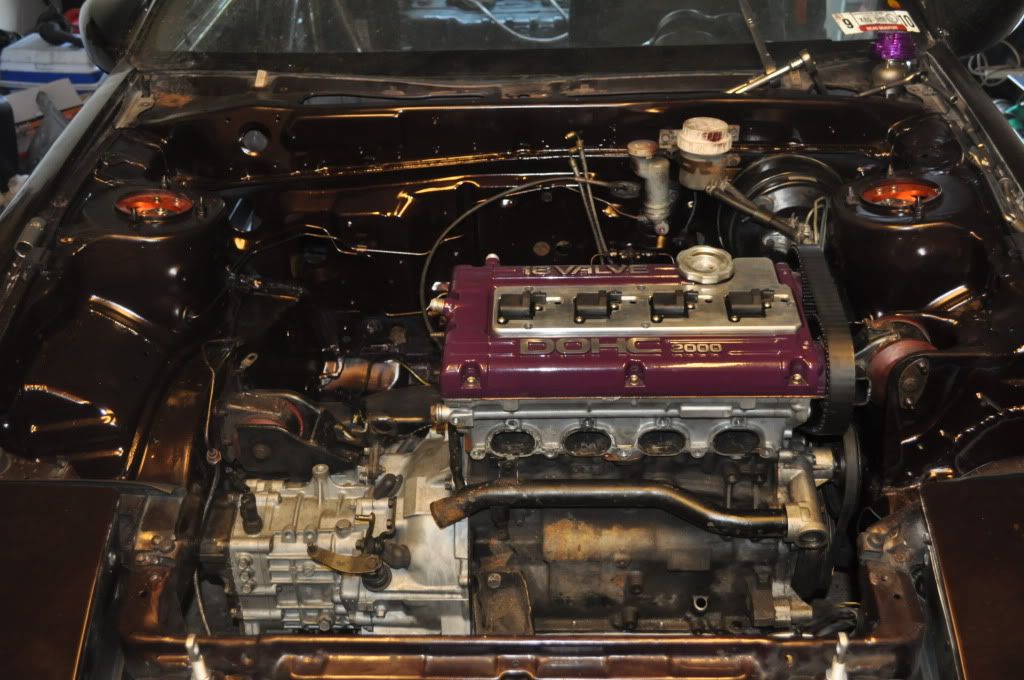

Twin Disc installed!
:D

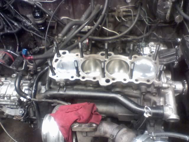

Installed ARP's, Ran on stock studs until this.

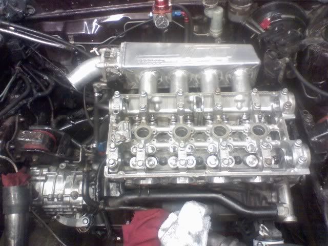

Head on!
Pictures during bathroom break!!
More port work pics and assembly
More coming.

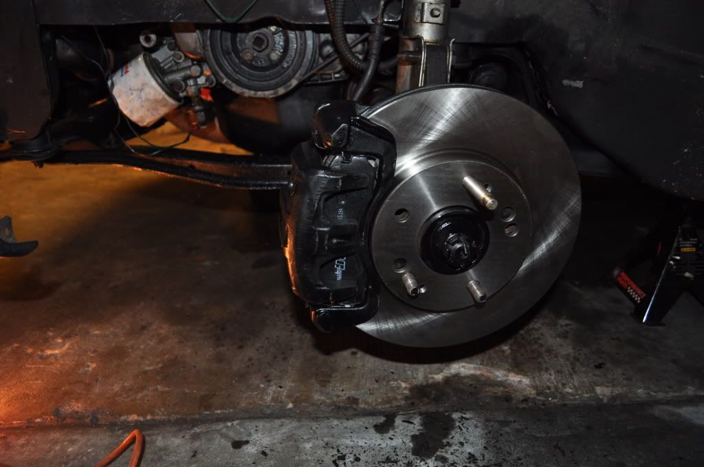

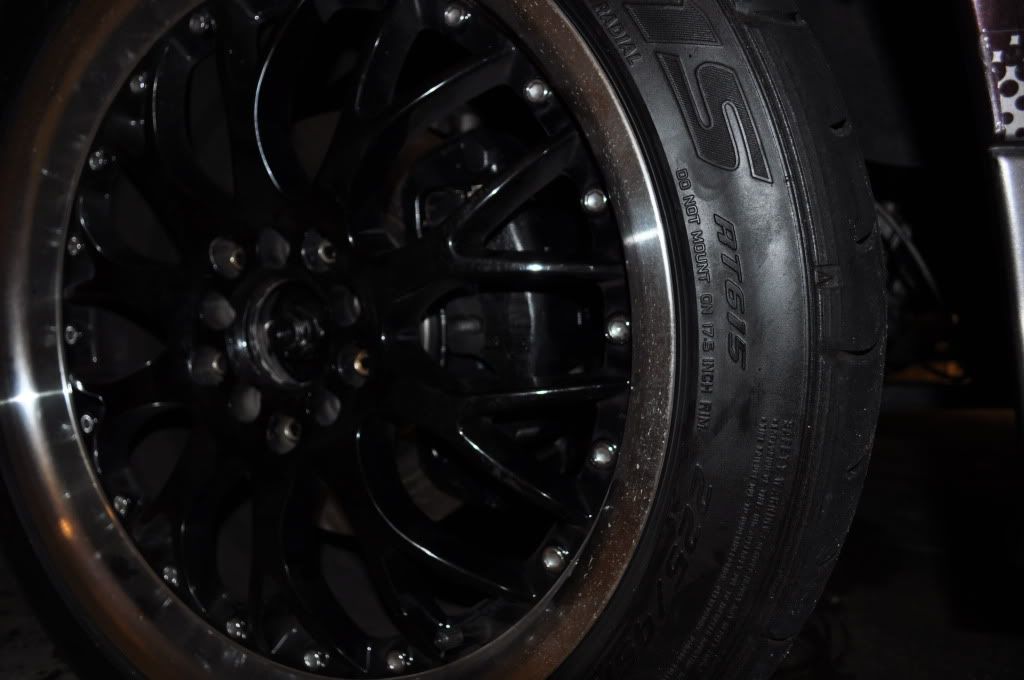

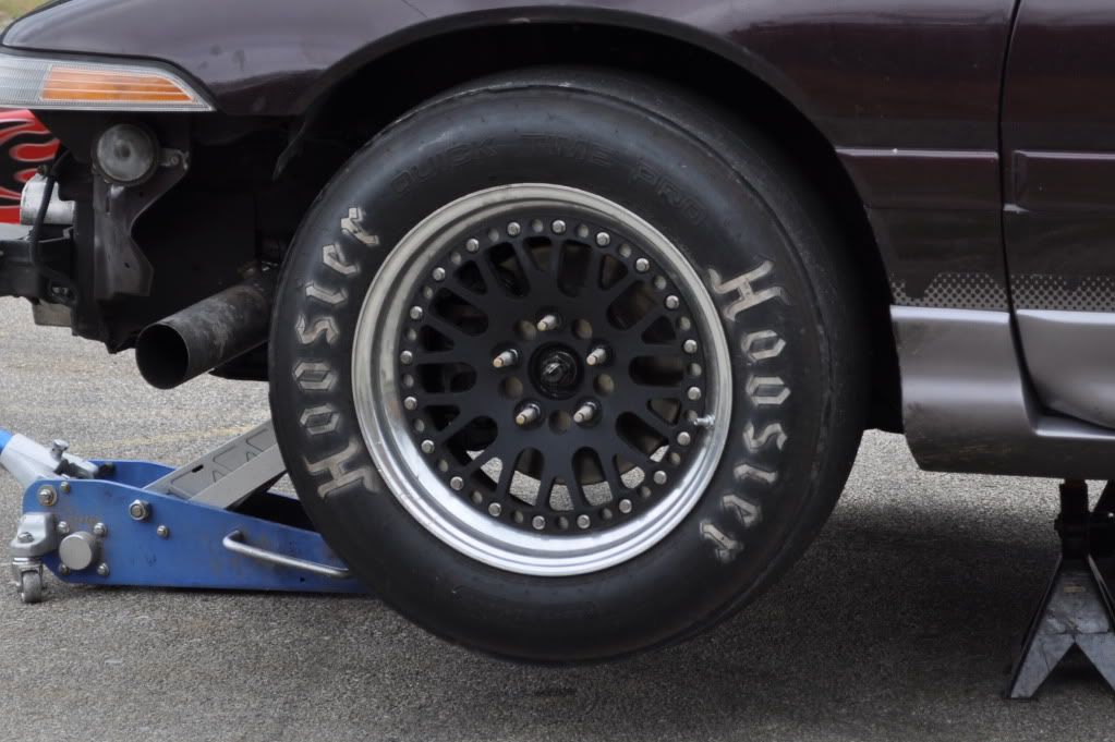

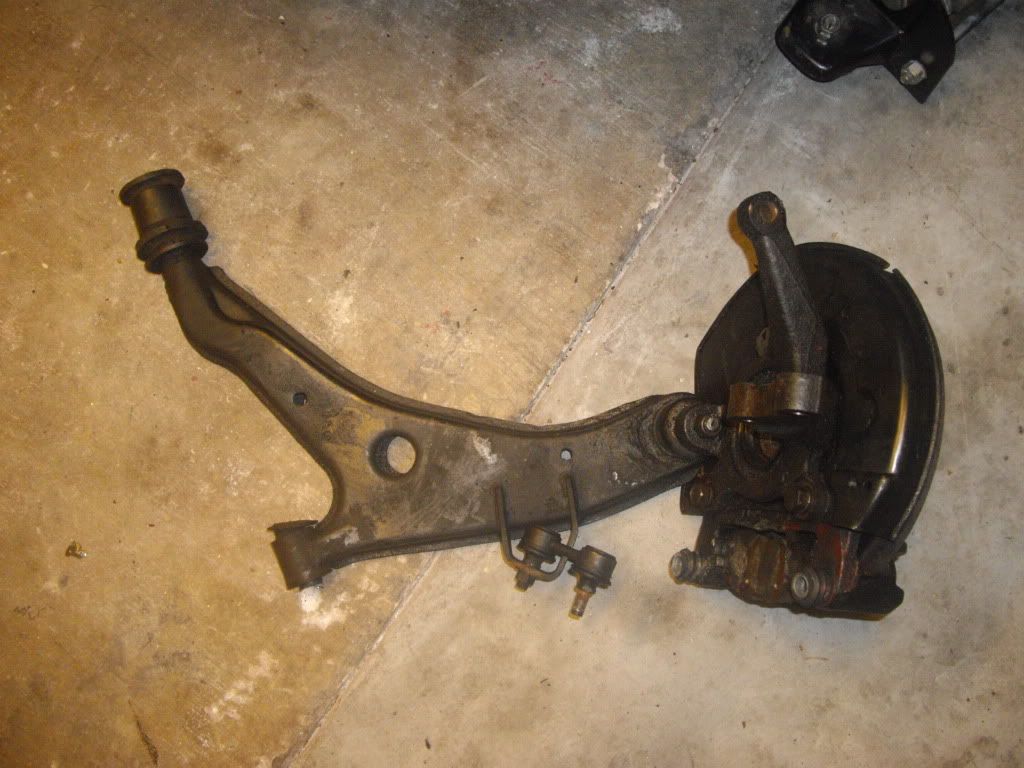

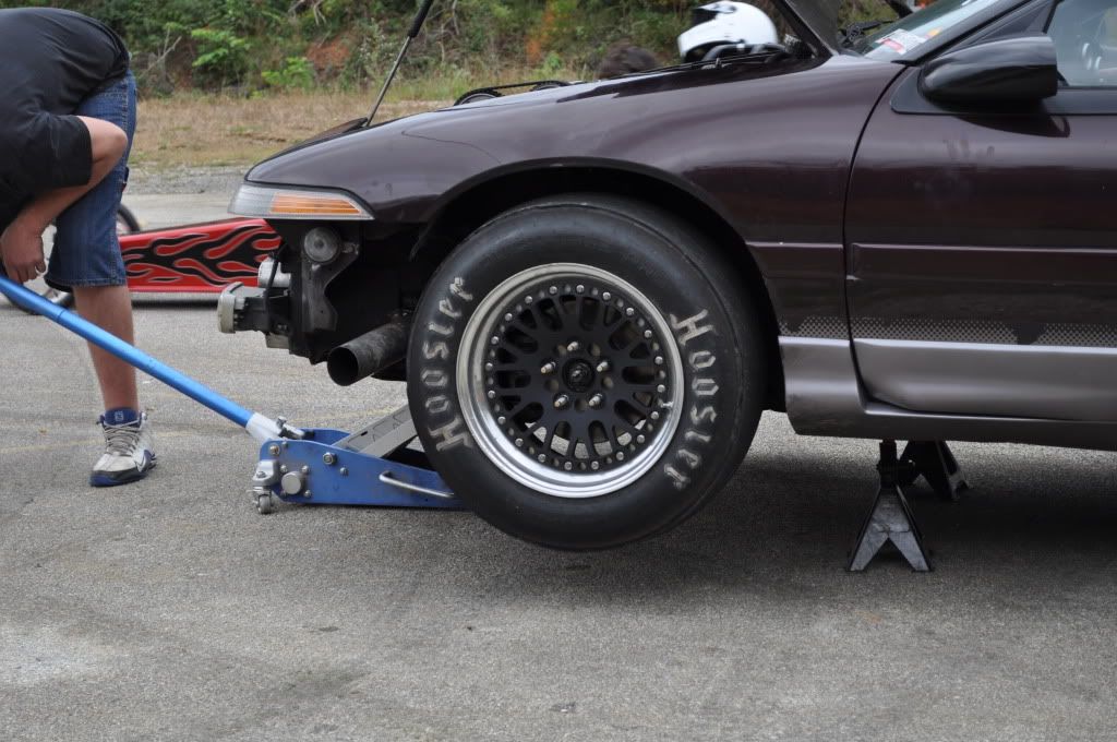

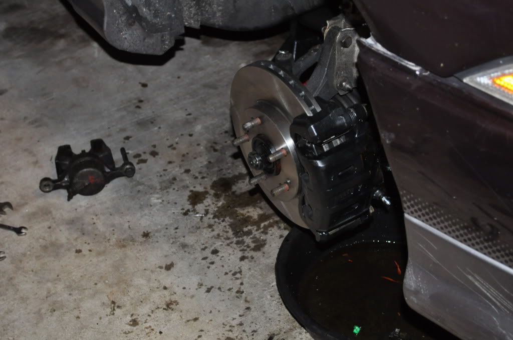

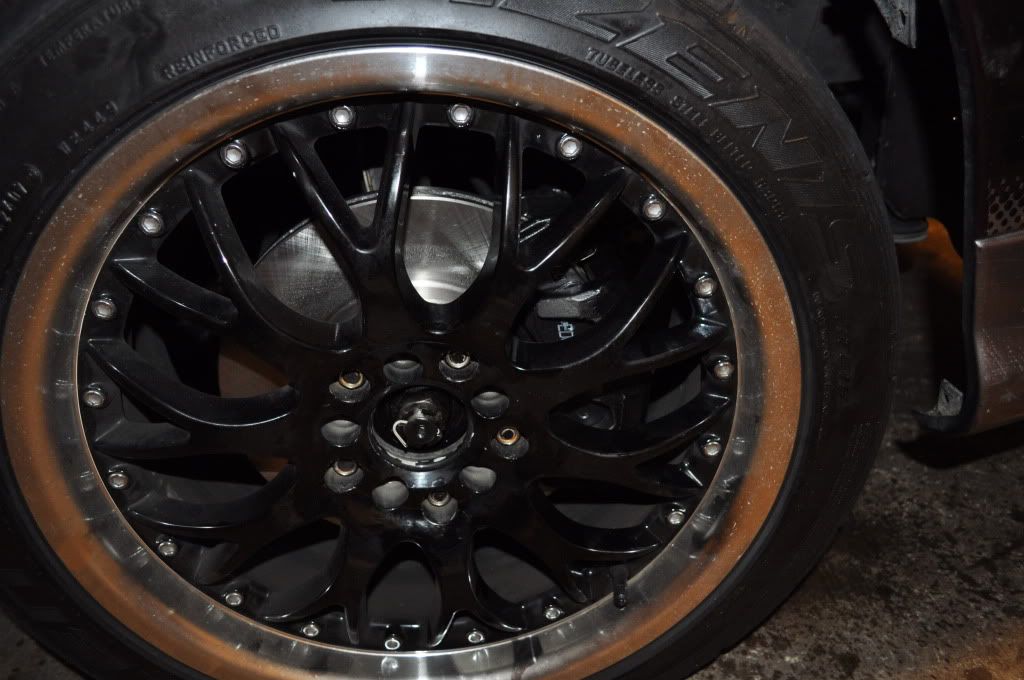

So at 130mph these stock brakes suck balls. So I got some bigger ones :D.
Don't mind the single extended stud... LOL. Those will be on tomorrow when I get a hold of a impact gun.

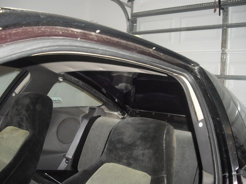

Now I am prepping the car for a cage and a new trans.
I'm going to be picking up a Dogbox from Shep with in the next 2-3 weeks.
Stay tuned for hopefully low 10s!

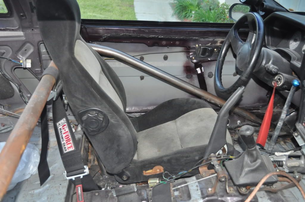

8point cage
Gforce 5point harness

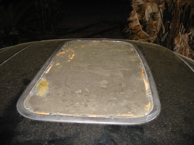

OEM minus sun roof

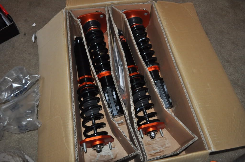

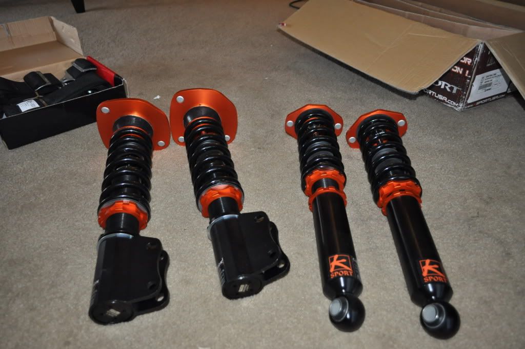

K-Sport Coilovers
Prothane bushings

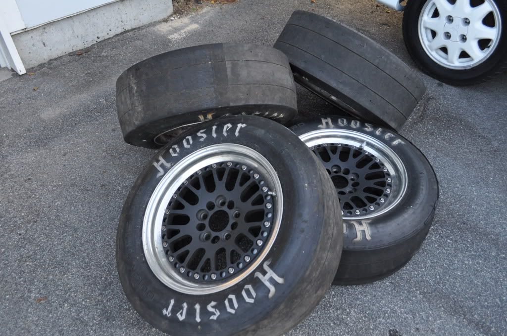

Hoosier QTP 26x9.5x16

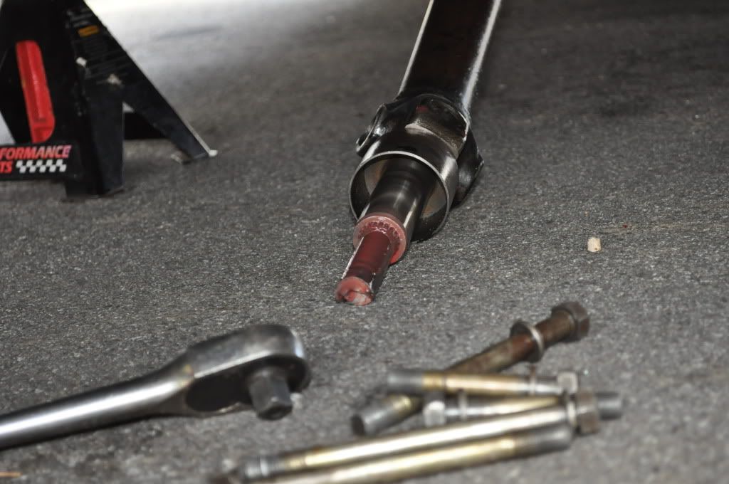

I made it about 60' before It blew the driveshaft off the rear end. All 4 bolts that hold it onto the rear broke off.

Broke driveshaft
broke driveshaft - YouTube
Hit the 1/8th mile track near here. It was in Newport,TN
First pass the car blew the U-joint apart at the front of the driveshaft.

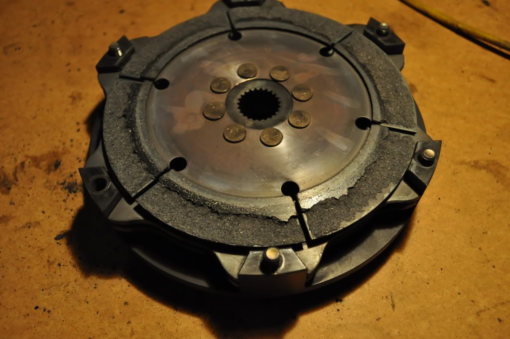

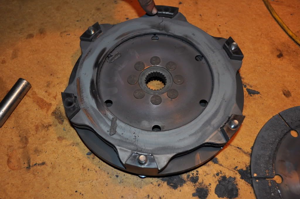

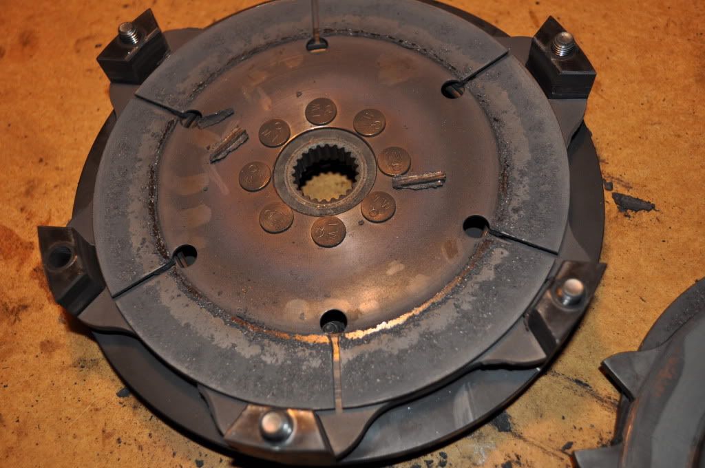

Oh and here is my twin disc I destroyed.

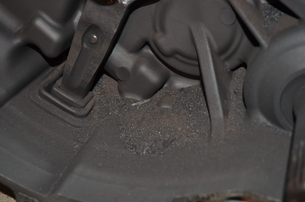

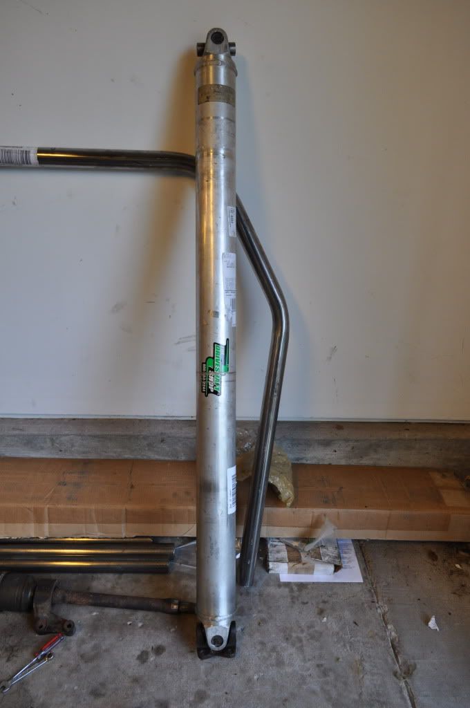

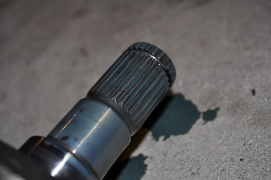

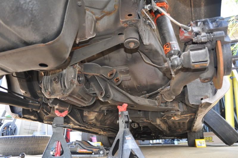

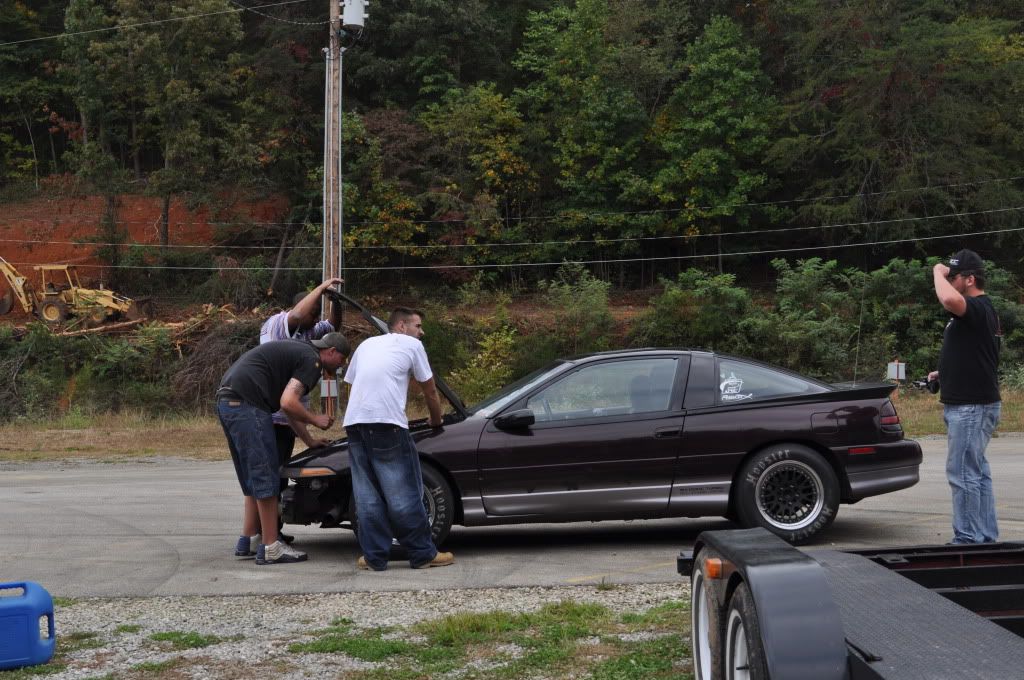

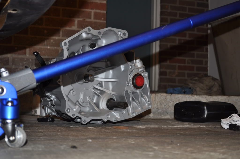

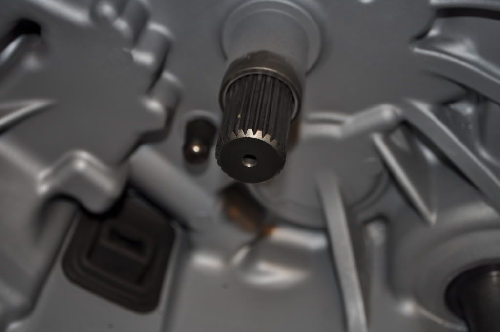

So I split a transfercase in half Thursday night. On street tires. And broke the yoke where the U-joint attaches. Also broke the drive shaft side where the U-joint attaches.
I am putting on a different stock drive shaft and it is currently drying from filling the carrier bearings.
I also pieced together a new 23 spline transfer case using a 22 spline and a 23 spline case. Yes you can mix and match :D
Video. It's blurry because the camera man didn't expect me to come up to run so fast.
Ran the car Saturday and Sunday. Both nights I broke the drive shaft. Couldn't figure out what the hell was going on until my last pass Sunday night.

I got on it in 2nd and hit third. As soon as I hit 3rd the drive shaft exploded.
Pulled everything off and ran fwd. I tried dialing it in a little better with the suspension to hook better. But the best 60 was a 2.4 I think.

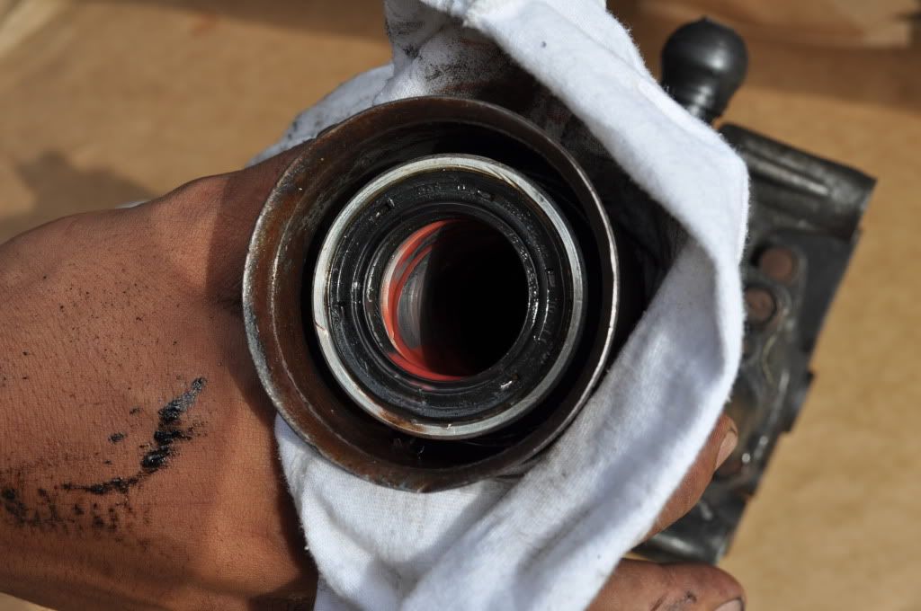

The last pass something broke and sounded familiar. like a drive shaft broke. Well I get to the trailer and jack it up. The 4 bolts that hold the left rear axle on broke.
So the rear has to be locking up.
I am done for now. I am going to have to wait until I get back to fix it up and freshen up the engine.

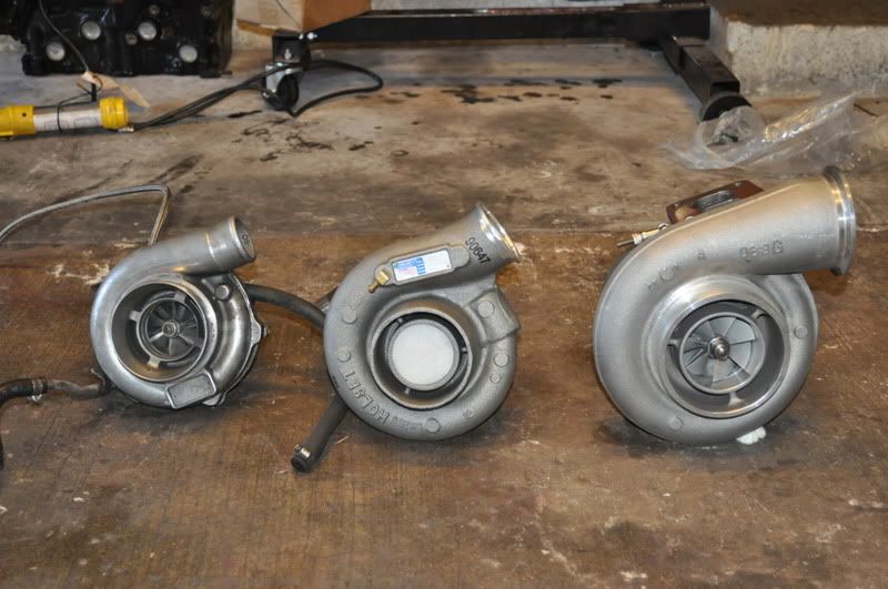

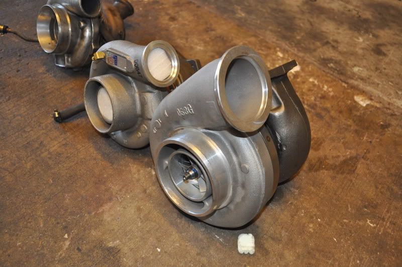

I should be getting a total for my turbo tomorrow so I will be able to pay for that and have it sitting at the house.
It's a Borg Warner s374. I'm selling the 3052 setup when I get back so I can order a top mount and wastegates.

Jmf topmount
Tial MVS wastegates

I'm getting their 5" thick with 3" inlet and outlets.
Update on the FMIC. Got an email from Michael at ETS. Let me know they don't have the proper 5" core to build my FMIC, so he offered to do a 6" core for just a slight price increase.
So shes going to be even beefier! Pictures of the paint process are coming too!

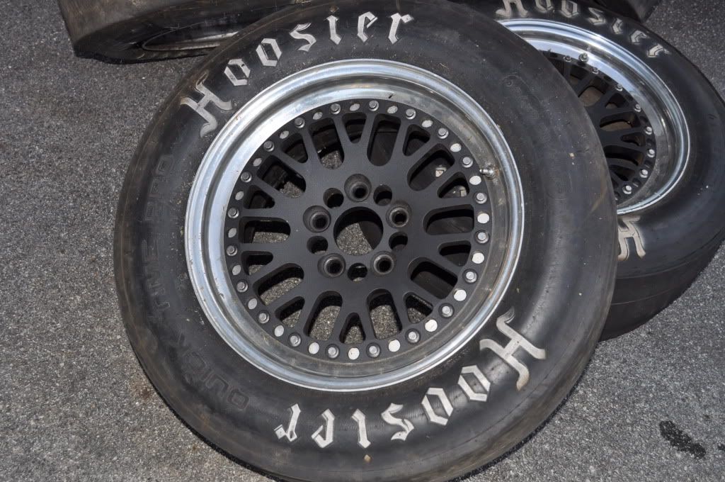

Tubes for the Hoosiers.

Well I sent out a mass email looking for some cams... Fail on all vendors..
But JNZ did mention that my Manifold will be done soon! Good thing I'm not in a hurry for it, I normally want my parts NOW! haha.
I also decided to change to a JMF Drag manifold, I'm just waiting around for a little to see if one pops up in the FS adds before I get back.
The body and paint work should be starting on the 1st from what Mike said! He is mounting the front mount and cutting the bumper for a good fit!

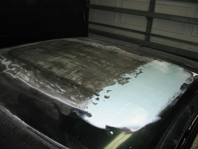

Most people don't know this but here is some magic that Mike worked on my car. I blew my sun roof out one pass and was using a piece of sheet metal I bolted in.
From JAXWHITE1G:
I wish I had time to keep up with this thread. I have to many projects and little free time. Earlier in this thread there is a video of the infamous flying sunroof. I promised Chris I would take care of it and straighten her up and give her a new shine. Time flies when your in the States. I bet it's been a long wait when your in the desert. Well here goes. Several photos.

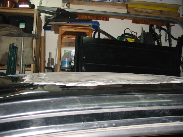

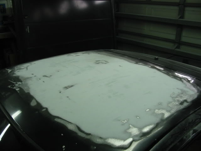

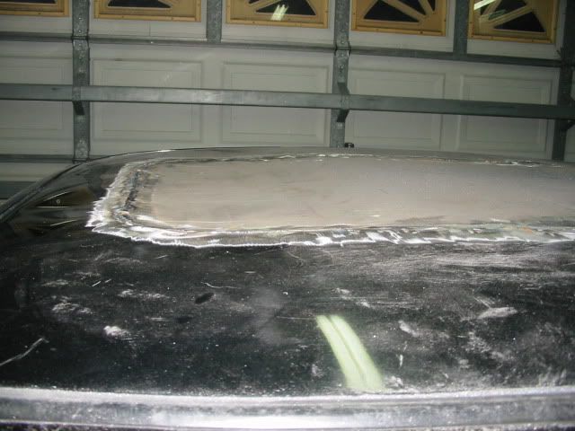

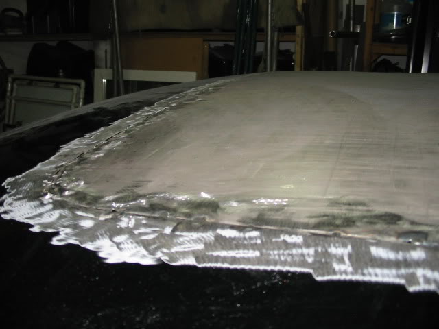

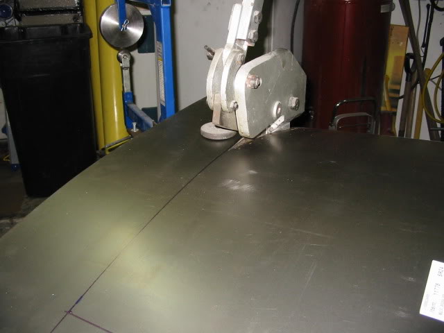

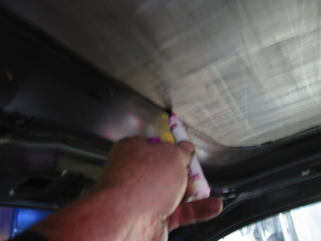

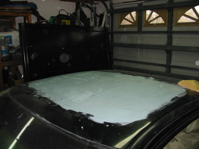

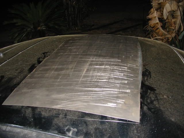

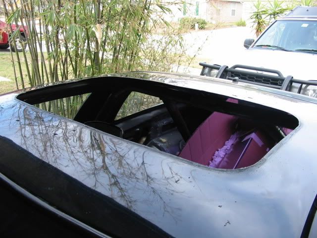

What I started with.
22gage sheet metal.
After rough cutting I did some shaping on the bench wheel.
Laying it out on the top as I wheel to try to match the curvature of the roof.
I removed the sunroof and continued shaping.
Then I taped it to the opening and drew a line around the opening.

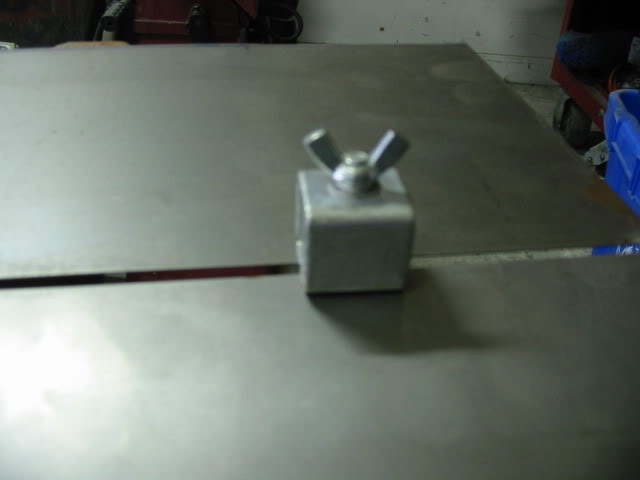

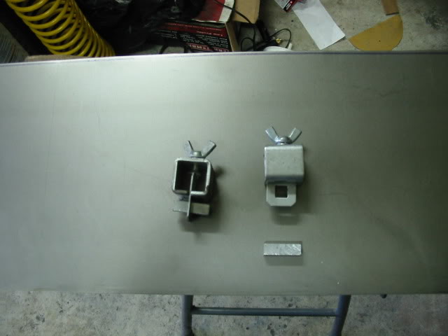

Using the bead roller / cutter. Courtesy of Jestoy7. I trimmed it to fit.
These are a neat little tool for sheet metal fitting and welding.
Due to expansion when welding there should be a 1/6th gap in the metal so it's hand fitting and trimming from here on.
I need to grind the paint and start welding.
To be continued.

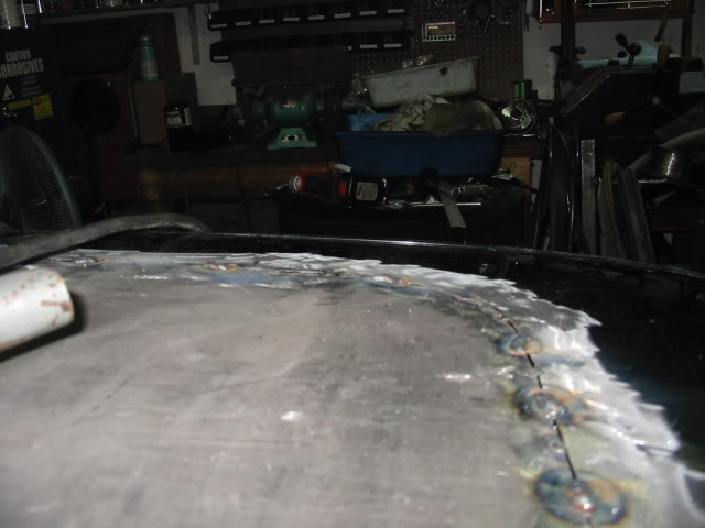

Originally Posted by JAXWHITE1G
I don't do well with photos or taking the time to shoot them. I get busy and don't think of it.

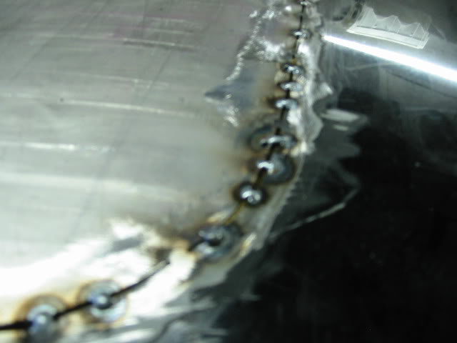

I started welding tonight beginning with tack welds several inches apart and working down to about a half inch apart.
I then ground the welds and planished the seam .
Then weld the spaces between each tack weld skipping about 5" continuing around letting the heat dissipate as you go and let it cool to the touch before you make another lap around.
There is always a lot of distortion when welding sheet metal so I will have to do a lot of planishing to get is smooth. It follows the couture pretty well so far.
My welder reached it's duty cycle and had to cool down so I stopped for the night. Will continue tomorrow.
Mike
There are only 28 dents not counting the hood. Think you said you had bought a CF hood?
Tonights progress report. All welded in but got a lot of distortion from the heat.
I did a little shrinking and stretching and it's looking a little better.
Now the hard part begins. YES it will have bondo in it! I will do my best to keep it to the minimum. With a max of 1/16".
Mike

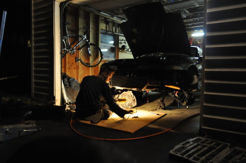

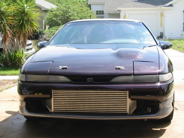

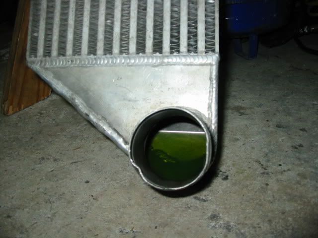

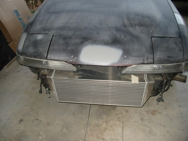

Decided to pull the front cover to plan the IC install. I don't thing Zip Ties are NHRA approved for mounting a bumper cover so I'll figure some other way.
Here comes the problem. While removing the car from the trailer the engine had a hard time staying running at low rpm. Lots of steam and antifreeze smell. Figuring a head gasket is an afternoons work and a reasonable price I wasn't to worried about it until now. Here is what I found.
I haven't read this whole thread, was a new turbo in the plans? Or someone correct me and tell me how water could get into the IC without a cracked center section.
Now on to the new IC. This baby is heavy. Has to weigh 30 + lbs. Building a structure to hold it while removing enough of the radiator support so it will fit behind the cover will be a challenge.
I'm planning on having it ready for paint on the 27th.

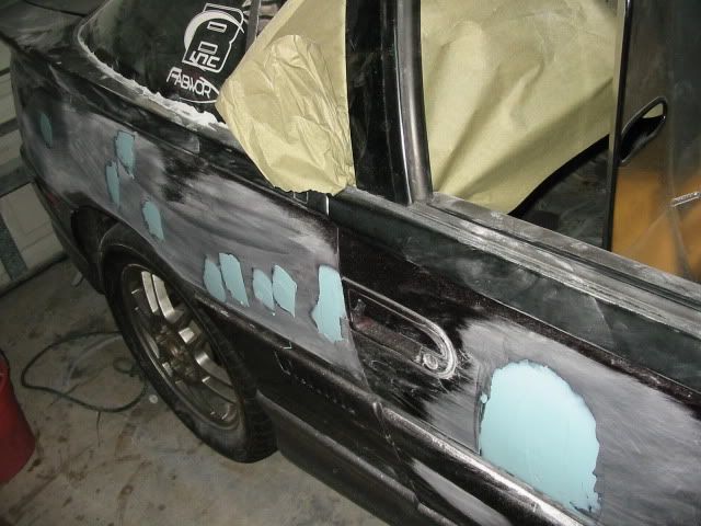

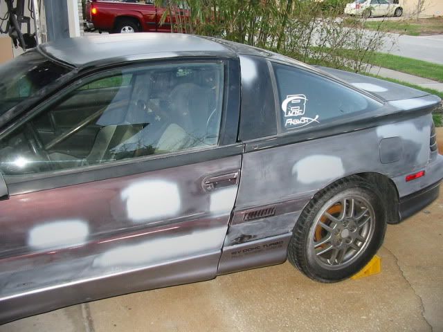

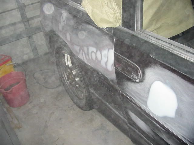

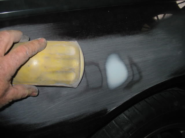

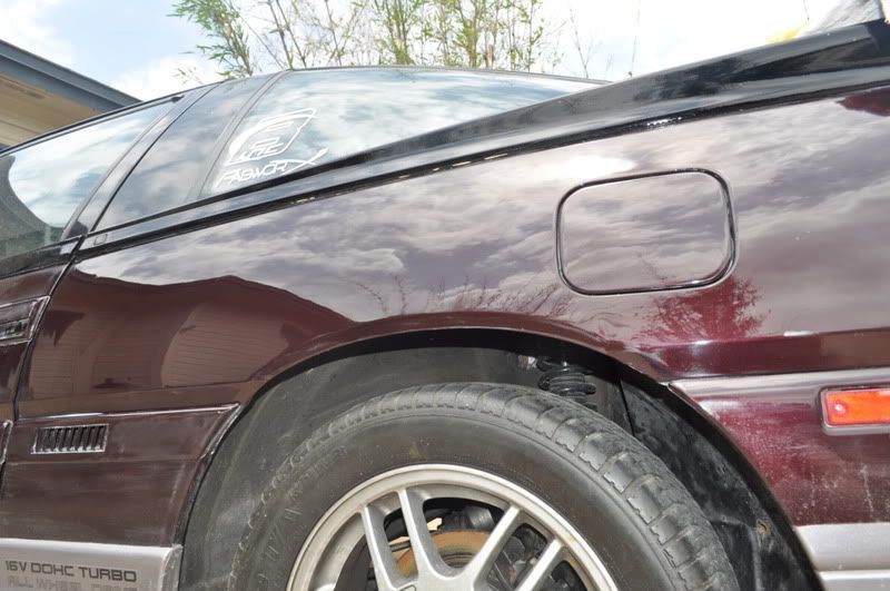

Don't think I have ever used so much bondo at one time.
Sanded, tapped down some high spots and another light coat.
Block sanded over the small dents to expose them and ground and filled them.
Block sanded them and am about ready for primer.
I found a couple more dents so it will be a couple more days for primer.
Mike

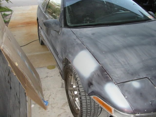

Originally Posted by JAXWHITE1G Posted Image I keep finding more dents in the Monster so I haven't primered anything yet. Had to install the IC to be able to finish the front bumper for paint.
The Purple Monster is coming along. The front has a lot of rock chips. Sanding them out would require stripping the hood and leaving them in would really stand out so I'm trying to minimize them by filling them with primer. I took a tooth pick and dabbed a little on each one with a toothpick. I could have used spot putty but that is even more time consuming. Pretty close to ready for paint. There must have been a lot of greasy hands on this car because I got some fish eyes in the primer.

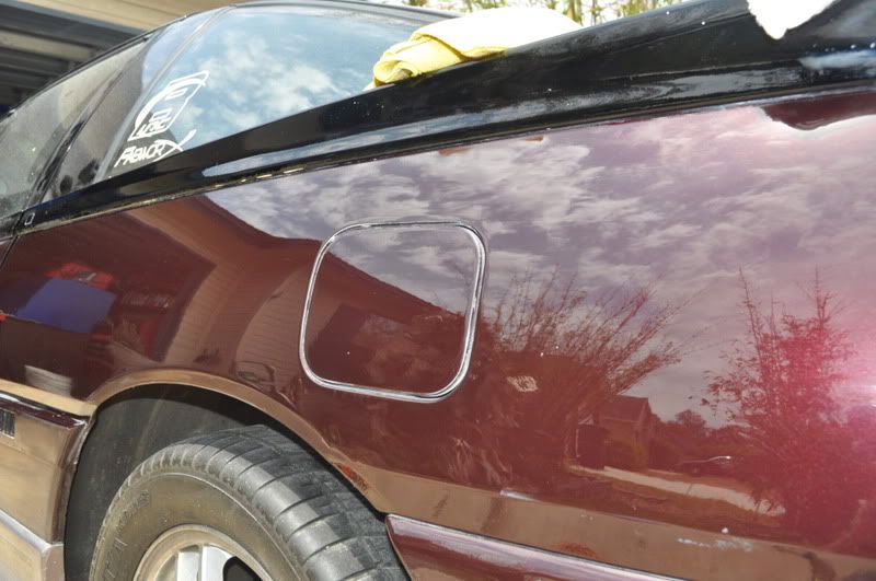

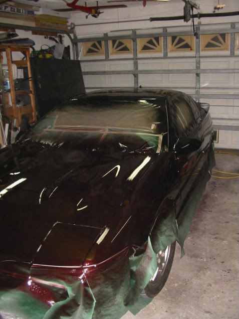

So I got busy today :)

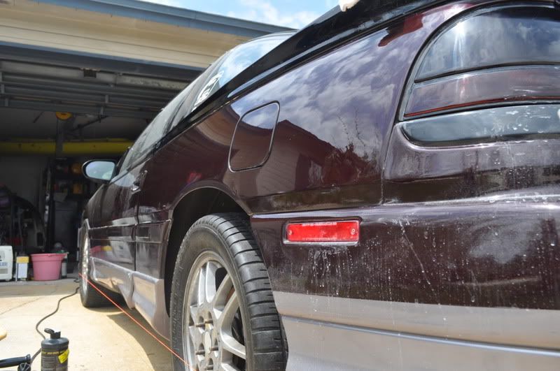

Still wet sanding and buffing her out some. It got a couple runs in the clear because it was a little thin when he sprayed it on.
Did some wet sanding and buffing today.
I got her home tonight and with in about 2 hours......
More pics from today

Got in some work today. I have to wait for springs to get here so I got the block together, put it in, and got the trans bolted up.
Didn't get much done today. Had a longer day at work .. then I ran out of cutting wheels.
Had to stop here for the night..

Block:
Wiseco 9.0:1 (.020 Over) custom specs
GRP Aluminum Rods
ACL Tri-Metal Race Rod and Main Bearings
Stock main blots
ARP Standard Head Studs
New OEM Front Cover w/Gears
New OEM Water Pump
New OEM Timing Components
Mitsubishi MLS Head Gasket
Forward-facing oil filter housing
New Knock Sensor
Head:
(Courtesy of Modern Automotive Dynamics)
Ported and polished
Kiggly HLA
Matched Exhaust and Intake manifolds ports
1mm oversized Intake and Exhaust valve
Brian Crower 280/280
Kiggly Springs and Retainers (good for 11,000rpms)
Revised Lifters
Fidanza Cam Gears

Turbo / Exhaust / Intake:
Borg Warner S374, T4, Twin scroll, 1.10ar exhaust housing
JMFabrications Top Mount exhaust manifold
Custom 4” Side exit exhaust (Courtesy of Fabworx Beaufort, SC)
ETS’s 6” thick FMIC
3” IC piping (Courtesy of Fabworx Beaufort, SC)
Tial BOV
Twin Tial MV-S wastegates
JM Fabrications Drag Intake Manifold

Driveshaft shop 3” aluminum Driveshaft

Suspension:
K-Sport Coilovers

2g Brakes
SS brake lines

Got my ignition panel wired up.
First switch is Power for all components, kinda like the master kill switch on the rear of the car.
Second is the push button, or momentary switch for the starter.
Blue LED light above the starter shows power is being provided by the first switch.
Third switch is for my fans.
The last red switch will be for the check engine light.

New exhaust ;)
This is a Dogbox center diff
Just waiting for the gear

New gears for the oil pump are here, head is at the machine shop and a new head gasket is on the way.
Got the head back from the machine shop today. Dropped it off yesterday. It is all back together and I am just waiting on a head gasket and front main seal from JNZ Tuning to arrive!
Put it together watching TV LOL.

New tranny is a shep stage 4. New clutch discs are in.
So parts came in today! :D FedEx showed up with my new Kelford 288s!
I put them in after work :)
And about 30 mins later...
She runs!!
Boosted INC: Purple Monster 2011 First Start up - YouTube

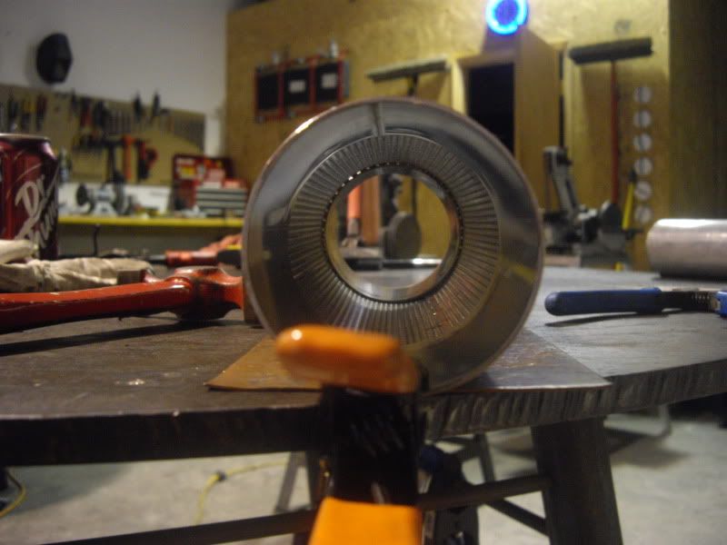

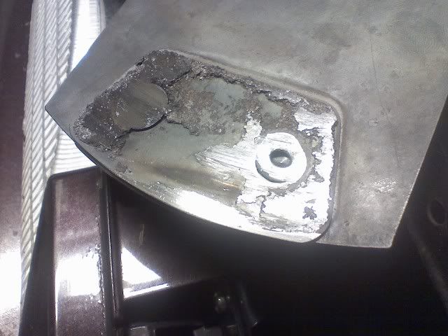

Got some stuff welded tonight!
Found out the water pipe is steal... oops! I put a bung on order tonight and I'll have lines and everything ready hopefully this weekend

The next weekend I was bored and hit up the local 1/8 to play with some guys.
Had about 3 runs and then this pass happened.
Dorchester 4/10 - YouTube

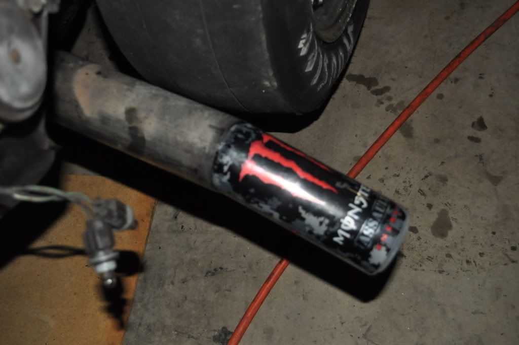

Had some smoke come in the car and I thought I caught something on fire! Turned out to be the head melting out the side :dunno:
Thing made a mess!

Hit the track with John. Broke the 3/4 shift fork coasted to a 11.9@103
I went back and looked at the slip. The only useable info was from the 60' which was a 1.5 and the 330' mark which was a 4.2sec. Shows she was at least moving compared to my other slips. My 10.1@15x was a 4.6 330'.

Broken part was a shift rail and it did not have billet forks. I'm still installing a billet fork and the clutch is going out monday to quartermaster.
Well I'm waiting on my clutch from quartermaster. So I decided to take care of some other things that I have just been putting off.
Quarter windows swapped out with lexan.
It's not completely installed. I need to grab a few longer bolts before I seal it down.
I checked a hunch today. Found the rear trans bolt pulled the threads out. I also noticed something that I knew would become a problem and show its ugly face. Crank has noticeable end play when the clutch is depressed. I knew it was happening I just wanted to blow the engine apart, which it refuses to do...
I decided before the auto swap happens that I am going to pull out my trusty street car engine and actually build a race motor. I also need to change out this cage and clean the car up some. Jake M.'s car has always inspired me with how clean it looked. I want that clean look for this thing.
I checked the 3/4 syncros and they still look new. I did have some wear marks on the hub that Tim attempted to band-aid for me. I have a replacement for that which I stole from a spare trans.
Everything else looks mint. I am also putting all the internals into a new bell housing that does not have a stripped rear bolt.
There is a race November 12-13th that I want to race at and it looks like I'll still be 5 speed for that.
John Wigger hooked me up with two input shafts and a set of main bearings last night. Hit wild wings, saved some boobies, and headed back.
Finished this last night.
I also noticed some excessive free play in my magnus shift fork so I emailed Marco with some questions about them.
I should be testing with John at Fayetteville this sunday.
I replaced the main bearings for the first time since I built this engine back in 09'. It seems to have fixed my "crankwalk" like movement on my crank. I use to be able to press the clutch and watch the crank shift... Shit still ran 10s like that.
I reinstalled the trans last night. All that is left is tracking down a new O-ring for my turbo outlet, Replace the oil return, Axles and wheels.

These past couple days I have been tracking down an electrical gremlin. Finally found that back in the day I wired all the grounds to ground. I did not separate sensor ground or chassis ground. This causes a jumping signal from the sensors.
Now that the harness is fixed I still need to put it back in. Next month is a race at Fayetteville so hopefully it is ready to rock then.
Well... She ran like a damn champ after I figured out the wiring.

This past weekend I took first place at the South East Face Off in Fayetteville, NC.
The car put down (3) 9sec passes in a row going faster each time. 9.9@151, 9.8@151, and 9.7@149.

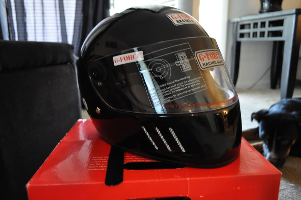

New addition to the car :)
Look what the wife got me for Christmas!!!!!!
Started getting busy today. I worked all day yesterday cleaning out the garage. It was loaded with crap from Christmas and what not.
Mostly ready to pull..
Pulled it out the rest of the way.
I'm getting in a stack of stock gears to play with. Hopefully I can have a bad ass shifting trans soon. ;)
Going to disassemble the engine tomorrow and see what all I need to replace.

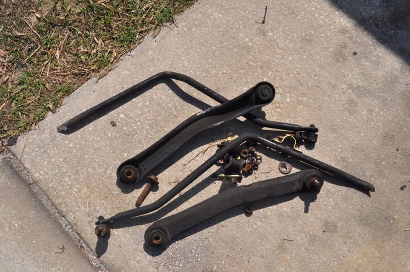

I was messing with some parts last night and noticed my transfer case is in need of new bearings. I'm pretty sure the output shaft is not suppose to wiggle... ha
I might just cut the front end off of this thing while I'm at it. Mike @ Modern Automotive Dynamics is designing a front end and K member for these so I might be a guniea pig for it. He already has built control arms which are on Jeff Bush's 1g right now.
