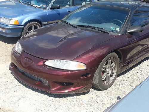

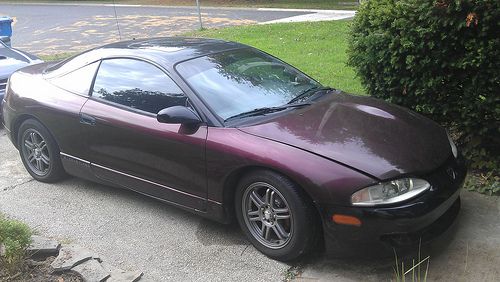

Hey all, So apparently i've waited long enough to do a thread on this.. So basically I picked this car up in march of 2012 for $1800 plus an 02 Oldmobile Alero. Little did I realize that the previous owner had done just about everything under the sun to screw this car up.. Here is how the car looked when I picked it up..
IMAG0262 by talon 2g, on Flickr
And yes, that is a GSX spoiler... WITH the low rise talon spoiler. So that was the first to go.. Followed by a quick compound buffing and wax and she turned into this..

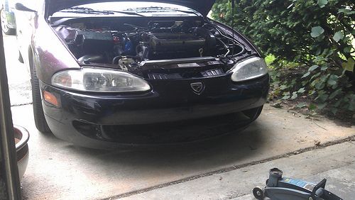

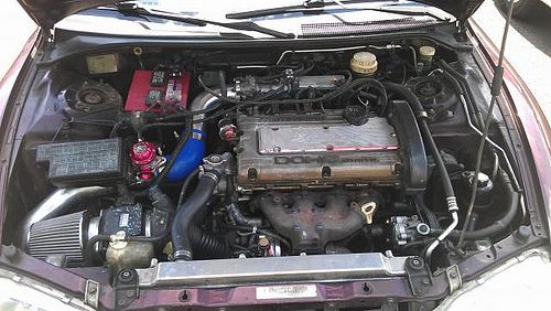

Stock engine bay with blow through BOV... no speed density, no ECMlink and a hideous chipped spark plug cover..
IMAG0264 by talon 2g, on Flickr

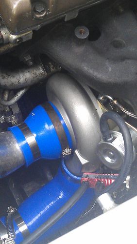

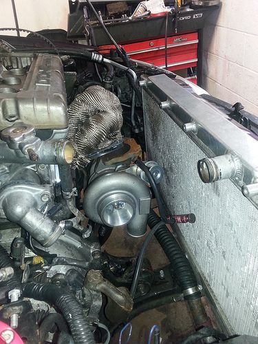

First round of upgrades... 20g MHI turbo, HUGE shoutout to justin for the beautiful snail!
10-56311920-83075-960 by talon 2g, on Flickr
Dented water-pipe
IMAG0384 by talon 2g, on Flickr

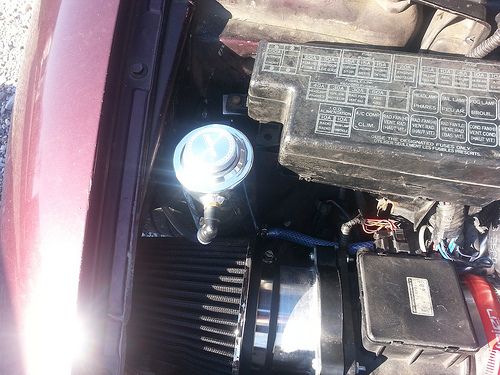

Injen intake care of Knochgoon! Thanks bud!
IMAG0399 by talon 2g, on Flickr

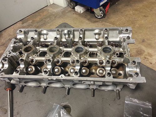

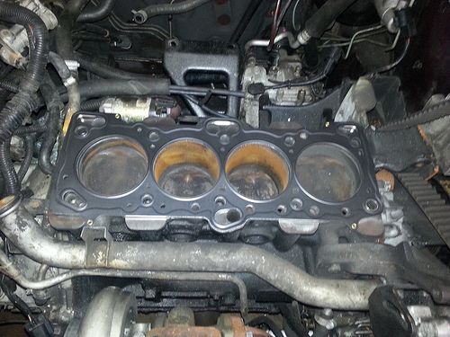

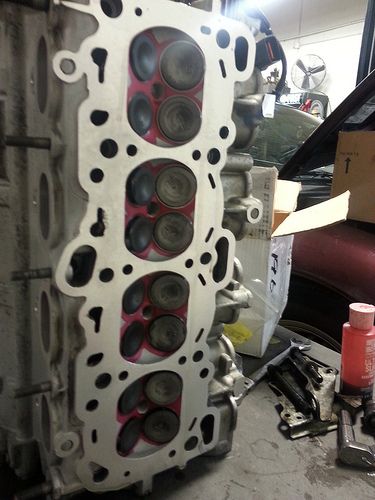

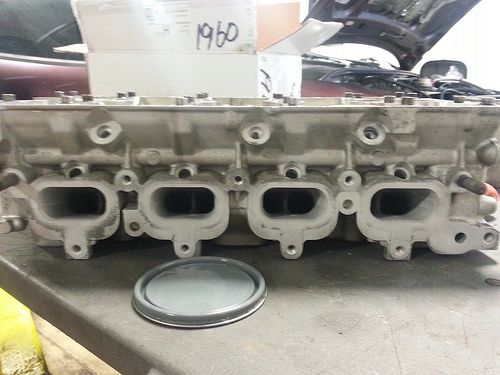

As of 2/24/13- Due to the burst hose, I ran into a no-start issue. Huge thread created about it which most of you have probably seen. Turned out that the head was warped horribly by the overheat, and thus the build began. Sent the head off to be machined, including decked, hot tanked, new exhaust valves. She looked fantastic when i got it back!
20130221_144903 by talon 2g, on Flickr
20130221_144913 by talon 2g, on Flickr
20130221_153137 by talon 2g, on Flickr
Also sprang for some better upgrades. Cometic 4-layer head gasket, and a set of ARP Head bolts and studs!
20130221_154359 by talon 2g, on Flickr

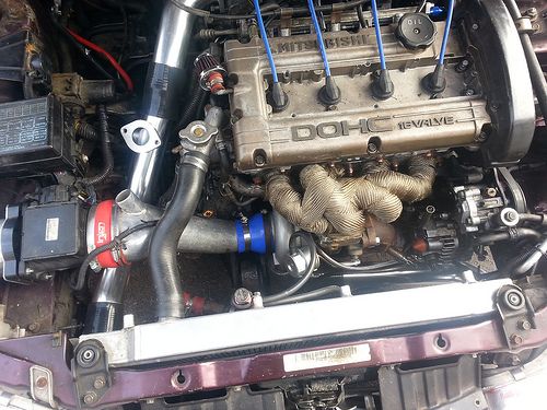

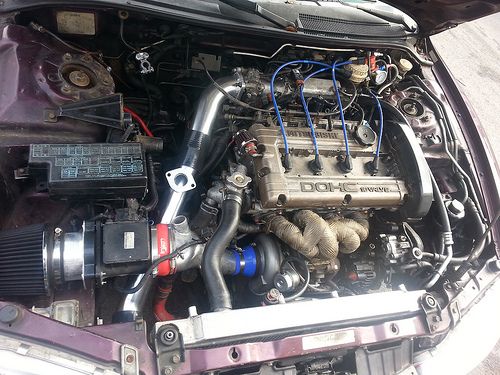

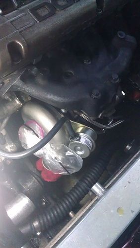

Today we got the head secured down and torqued in. Also added my SS tubular manifold (heat wrap turned out shitty, but will work for now) Also had another shot of the 20g.
20130225_122032 by talon 2g, on Flickr

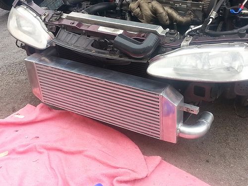

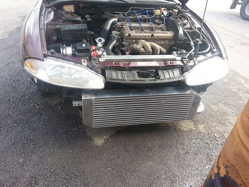

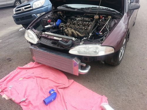

Next up was the fitment of the VRSF 2g FMIC. Core is fantastic and huge!!
20130222_122225 by talon 2g, on Flickr
20130222_122234 by talon 2g, on Flickr
Turns out the front sub frame needs to be cut away a little more to accommodate the inter cooler couplers, should be finished within the week. :hellyeah:

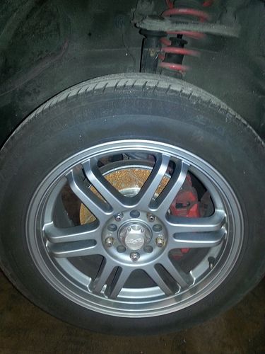

Also installed a set of EBC slotted rotors prior to the break down.. which sucks because now they look like this..
20130225_122054 by talon 2g, on Flickr

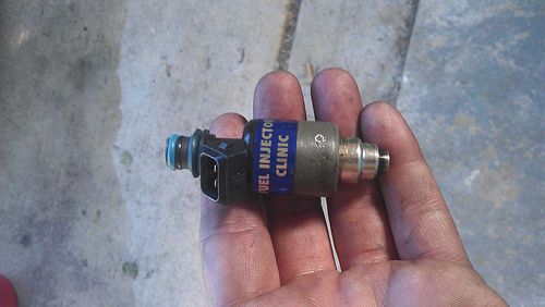

FIC 650cc injectors
IMAG0388 by talon 2g, on Flickr

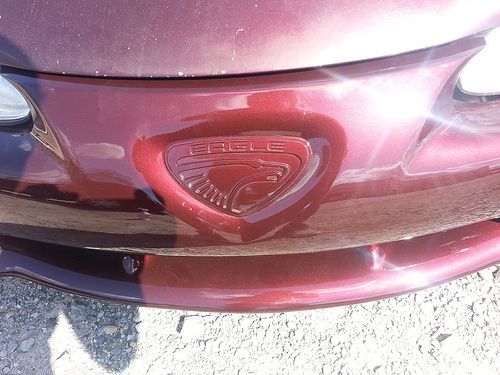

Test Fitted a 2ga front bumper, and i'm gonna go with it. Should be stripped and painted within the next month!
IMAG0382 by talon 2g, on Flickr

Not a bad start! Im not sure if you will have this issue with the 2ga talon bumper but for my 2gb bumper and the VRS FMIC I had to make some brackets to drop the IC about 2" down. There was a gap between the bottom of the IC and the mouth of the bumper. Drove me crazy!! Keep it up.
Thanks crash! Not sure about the bumper clearance yet, as I took the core off to make more room for the piping between the sub-frame and the radiator. I'll let you know though!

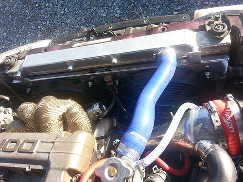

The car is running! I put up some video clips of it, just 2 for now. Still ironing out the AFC street tune settings, then waiting for a Water temp gauge sending unit and the tires and she'll be good to go. Here are some new pics as well! Enjoy!

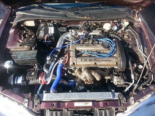

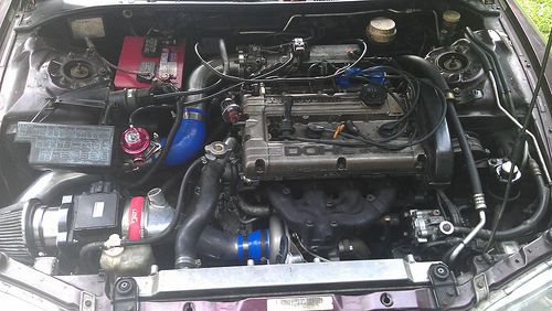

New and improved engine bay:
20130320_093714 by talon 2g, on Flickr

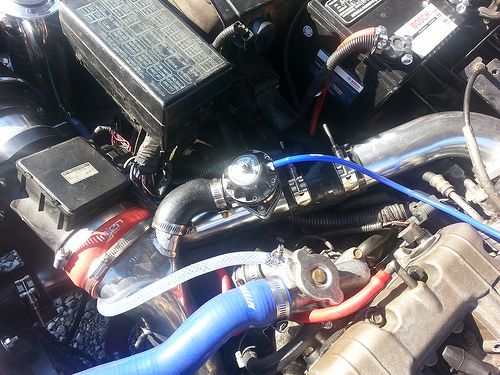

New Greddy Type-RZ BOV:
20130320_093720 by talon 2g, on Flickr
New Weapon-R Coolant overflow bottle:
20130320_093723 by talon 2g, on Flickr
New Mishimoto Dual Fan Shroud and Upper Rad hose:
20130320_093750 by talon 2g, on Flickr
Those fans sure as hell pull! I was standing there during fire up and it was making my clothes ruffle from the amount of air they move. Outstanding product Mishimoto!

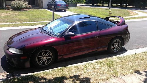

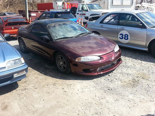

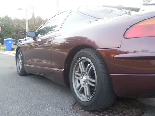

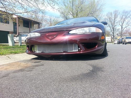

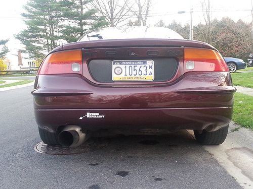

Well, after many many requests (both in thread, PMs and in person) i've decided to forego waiting until the east coast DSM meet to unveil her. These are some shots of her as she sits right now. 95 Talon Tsi V2.0 Enjoy!
20130414_144442 by talon 2g, on Flickr
20130414_144413 by talon 2g, on Flickr
20130414_144409 by talon 2g, on Flickr
20130414_144459 by talon 2g, on Flickr

Soon to have her under the knife again to receive a stage 3 Southbend clutch and PP, powdercoated VC, DSMlink and PTE 1000cc injectors followed by a conservative tune at 18 lbs. :D So stay tuned!

As for rubbing I havent seen anything yet. I have to remove it to put in a new bolt for the drivers side headlamp but im gonna check to make sure. It is kinda bowing out on the underside of it, as it does scrape a lot. Thinking of rhino-lining it
