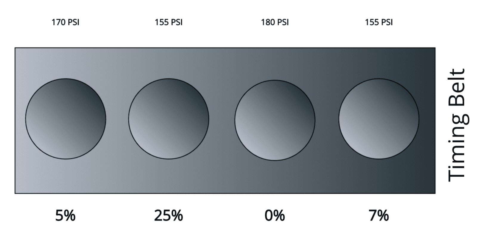

Got the car leak-down and compression tested and was surprised by the results. The car has around 140K miles on it, and a history that is mostly unknown to me. I'm just glad I can actually build the thing without worrying about it failing LOL
I didn't like the 25% result for cylinder #2, but since the compression is similar to the other cylinders I think it's going to be ok... at least, I HOPE it's going to be ok.
Now the question is (now that I can actually build this engine), do I stick with my 16G plans or go with a 68HTA? A friend of mine brought up the 68HTA, and it will definitely get me to my 350whp goal no problem, with some room to grow, but a 16G is the 'easier' route, since you can basically buy a 16G and an install kit from Extreme PSI and be good to go. Oh the choices...

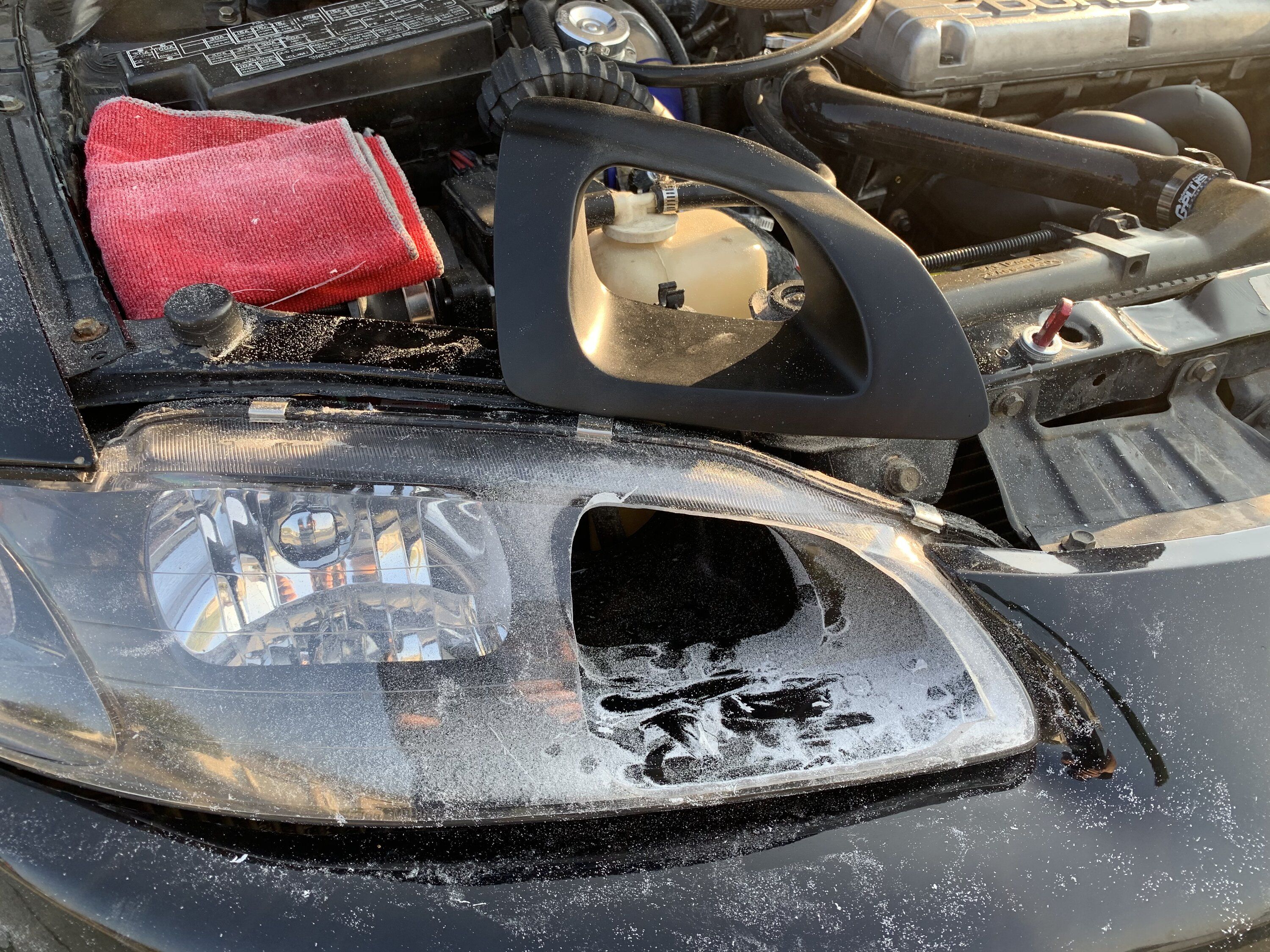

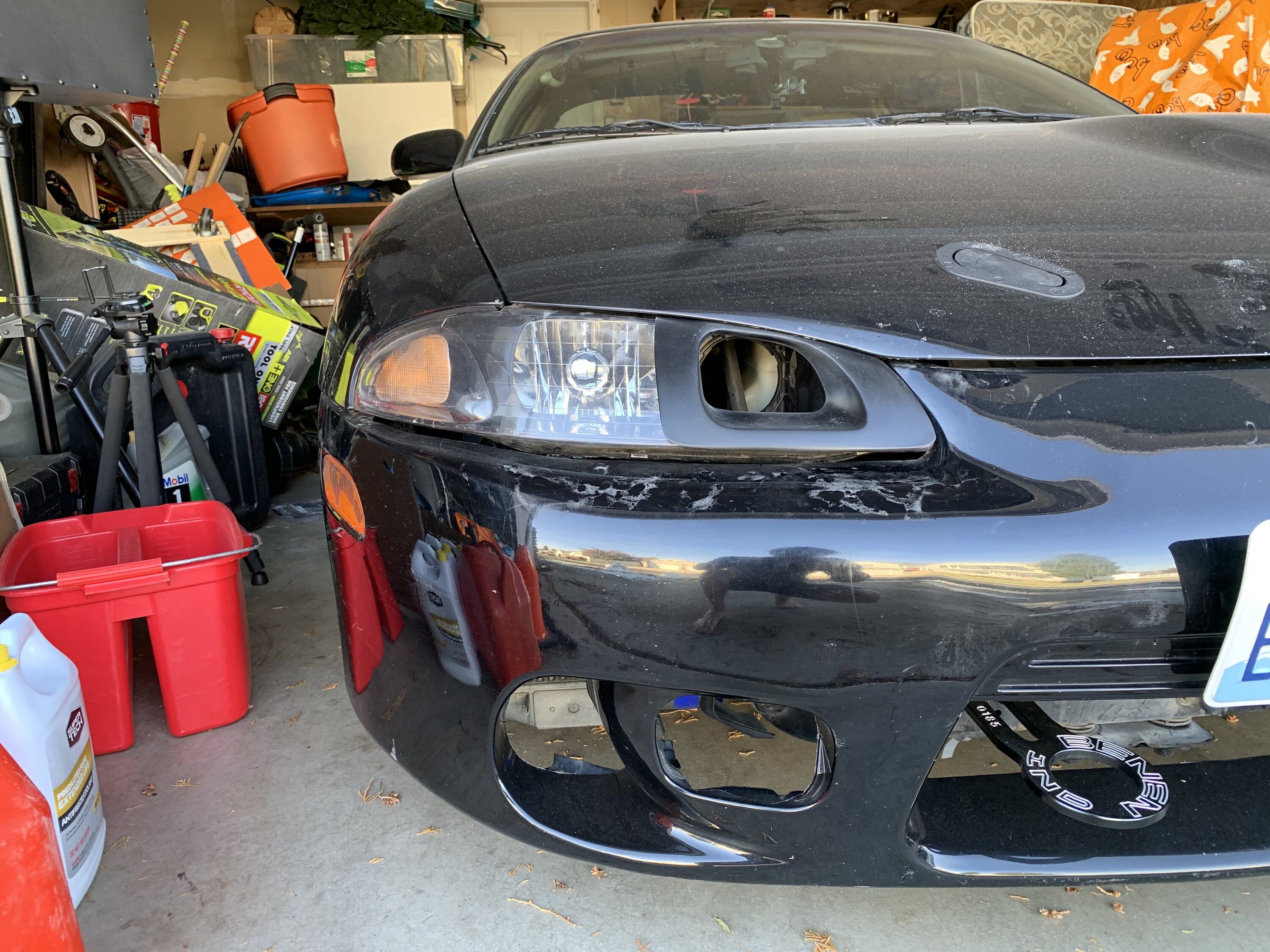

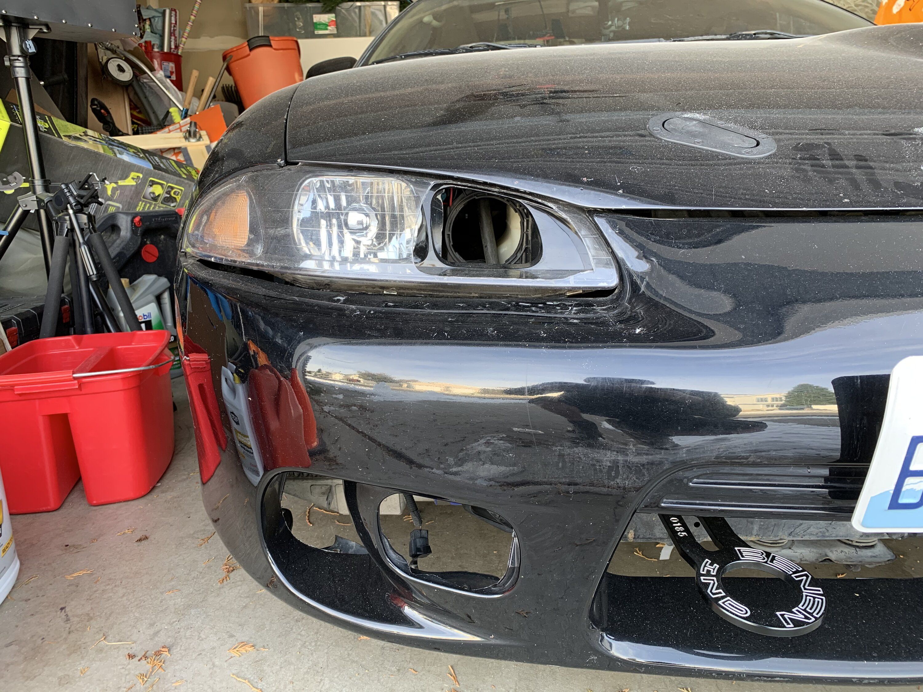

Didn't do a whole lot this week, I just put the Carbonetics headlight cowl on. Looks pretty good, I just hope it doesn't fall off (it's only got 3M double-sided tape holding it on LOL).
Turns out, the cowl is actually meant to be installed with the chrome piece AND the black insert cut and removed... so I had to use a Dremel tool (which seems to be a regular on this build haha) and grind the back of the cowl down to fit. Not perfectly flush still, but should be OK.
Pictures!!
/\ Had to make the whole a bit larger
Before:
After:
Personally, I dig it.

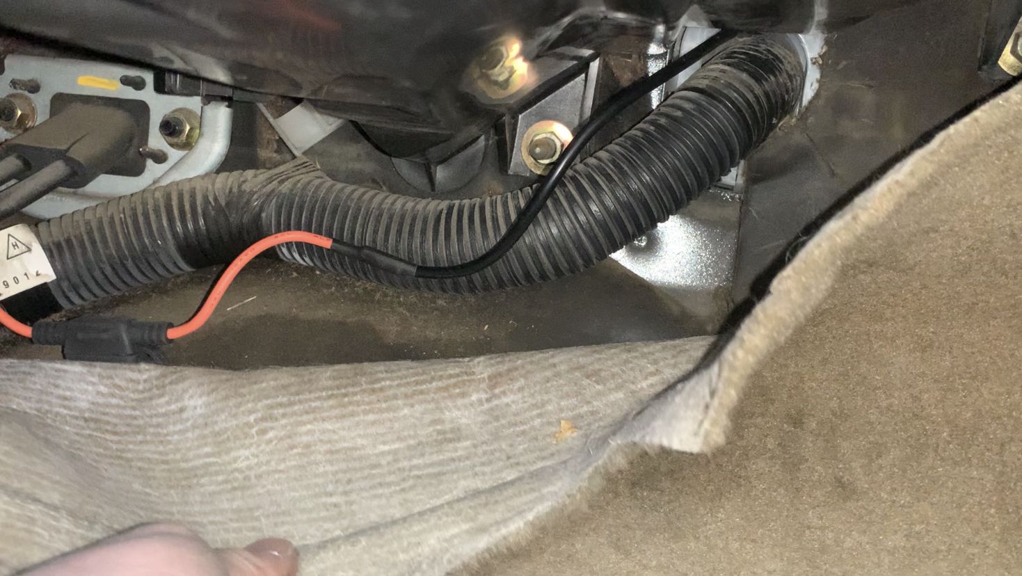

So, I have a slight fascination with doing things differently from everyone else. Case in point: the way I did my fuel pump re-wire.

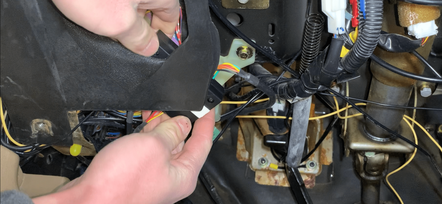

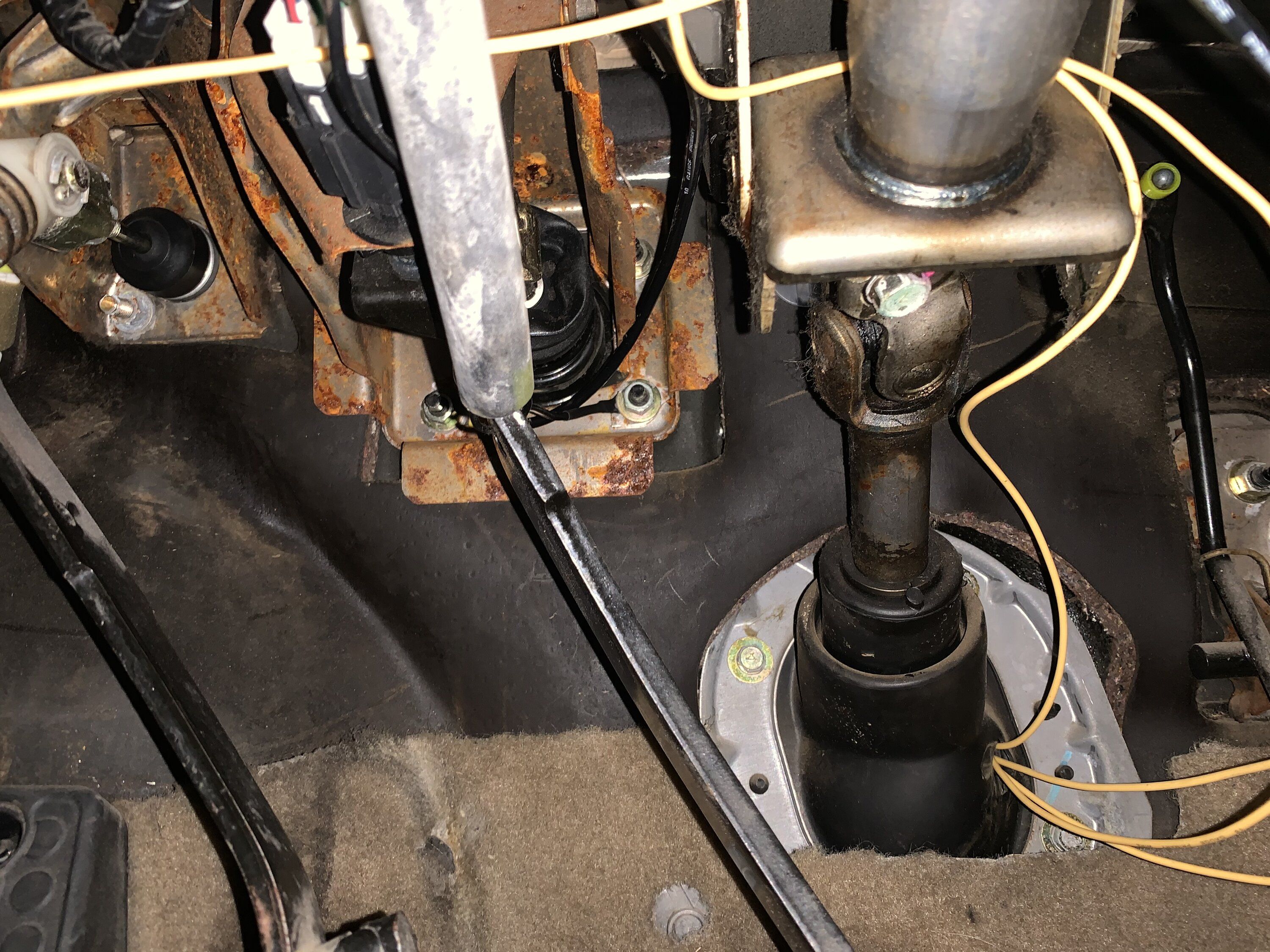

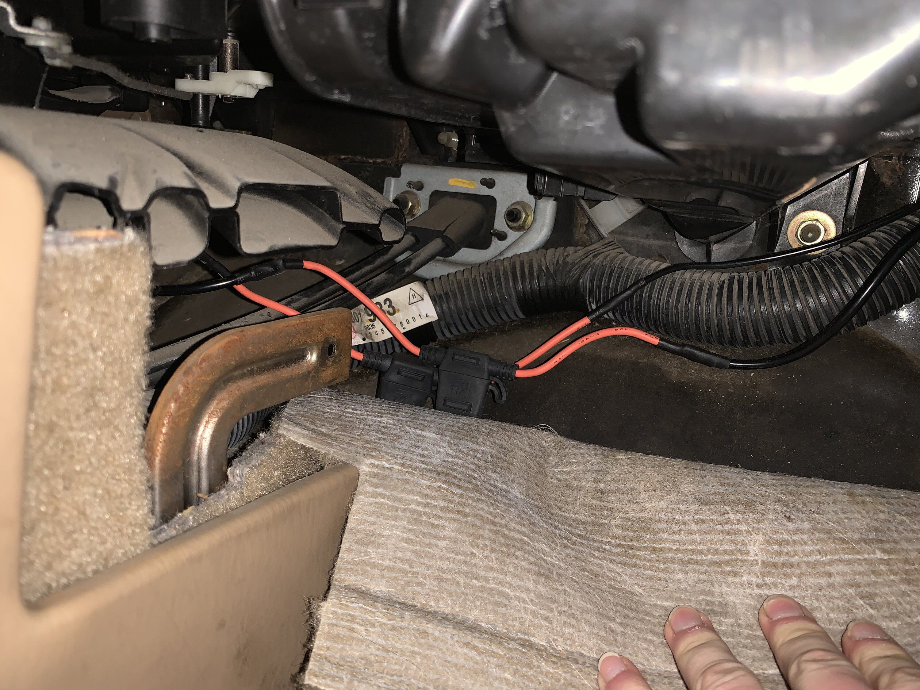

Generally, people run the wiring under the carpet on the passenger side of the car, and hide the relay and wiring either under the rear seats or under the plate that covers the fuel pump. I said “to heck with that!”. I wanted to 1. Make everything easy to access, 2. Keep things neat and out of the way, and 3. Include a kill switch. Here’s how I did it:

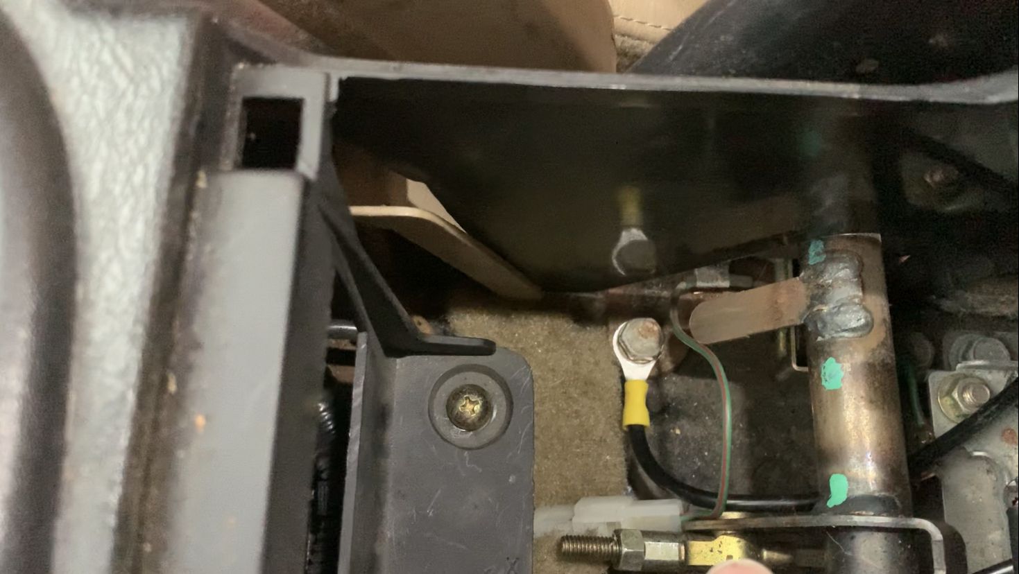

I started by running the power wire through the firewall on the passenger side, and then I hid the in-line fuse holder right behind the carpet; easy to access, and out of the way.

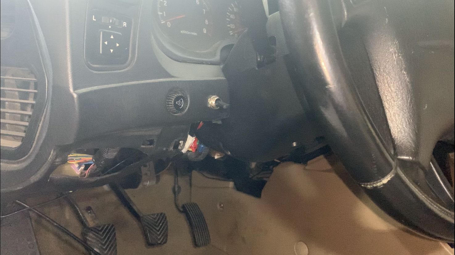

Next, I ran the power wire behind the center console and to the left of the steering wheel, where I drilled a hole and hollowed out the section where I installed the kill switch.

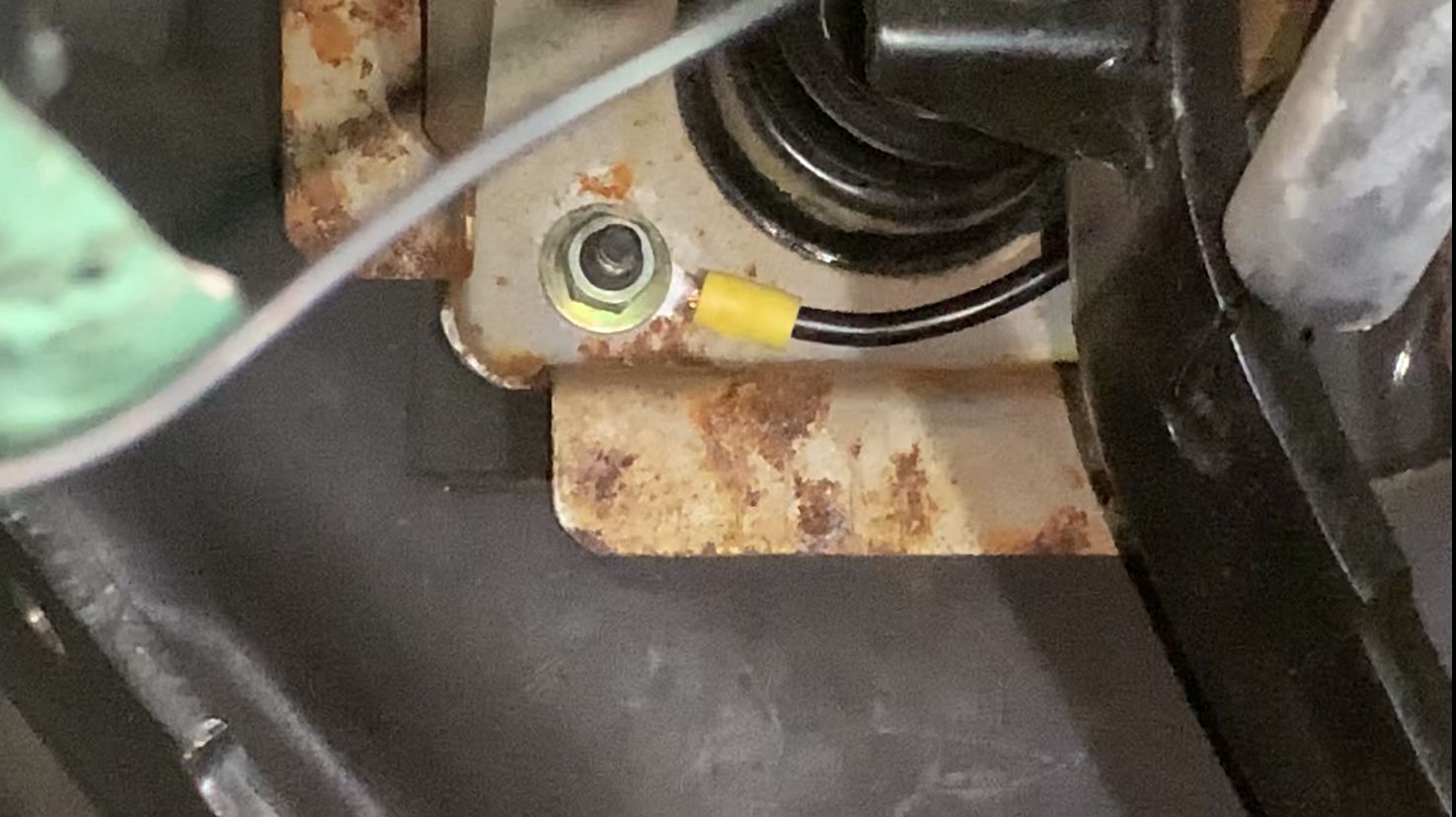

I grounded the kill switch to a bolt directly underneath the steering column.

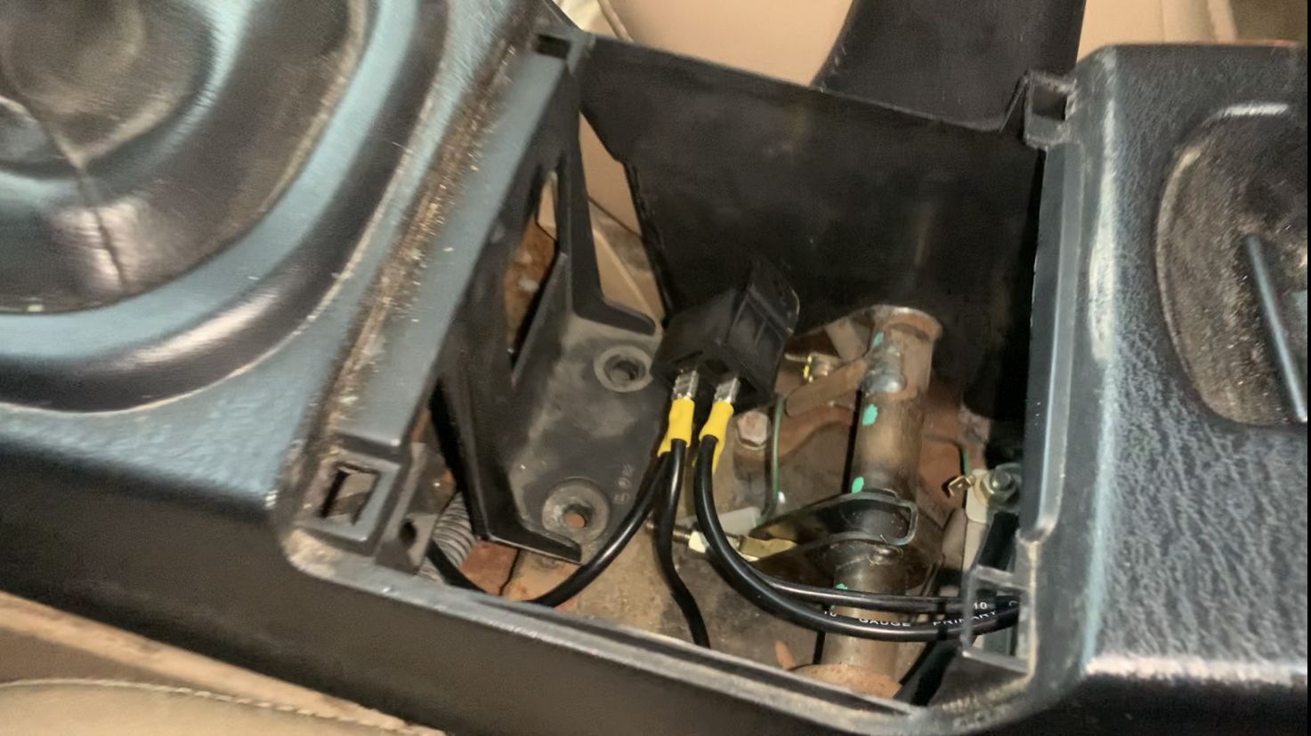

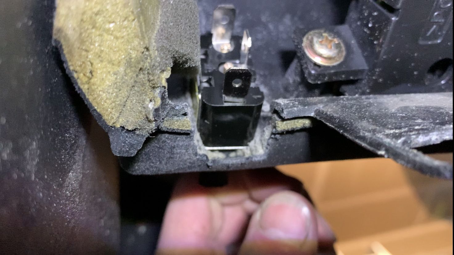

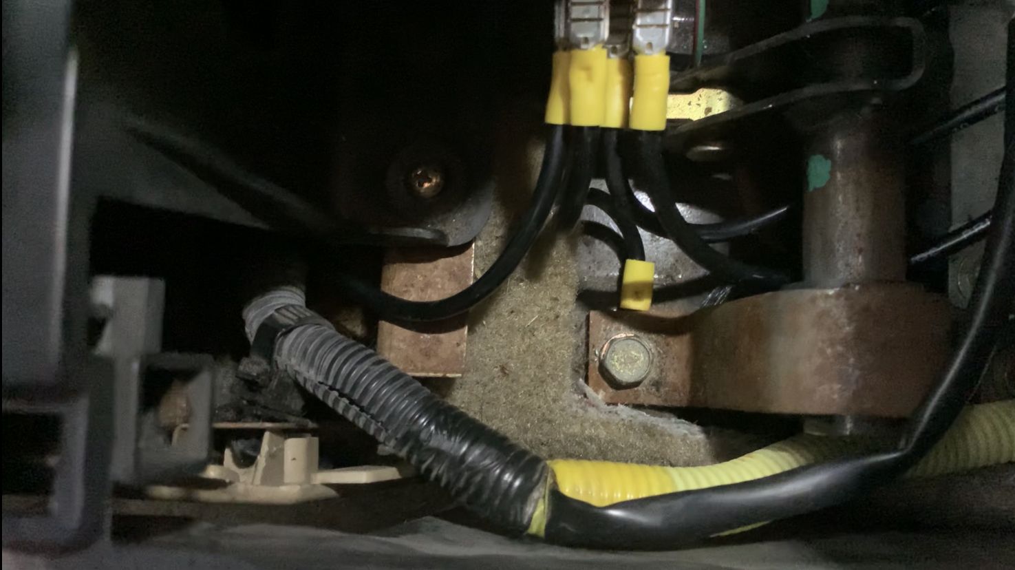

I then ran the power wire through the center console, and this is where my technique really starts to differ from the way most do the fuel pump re-wire.

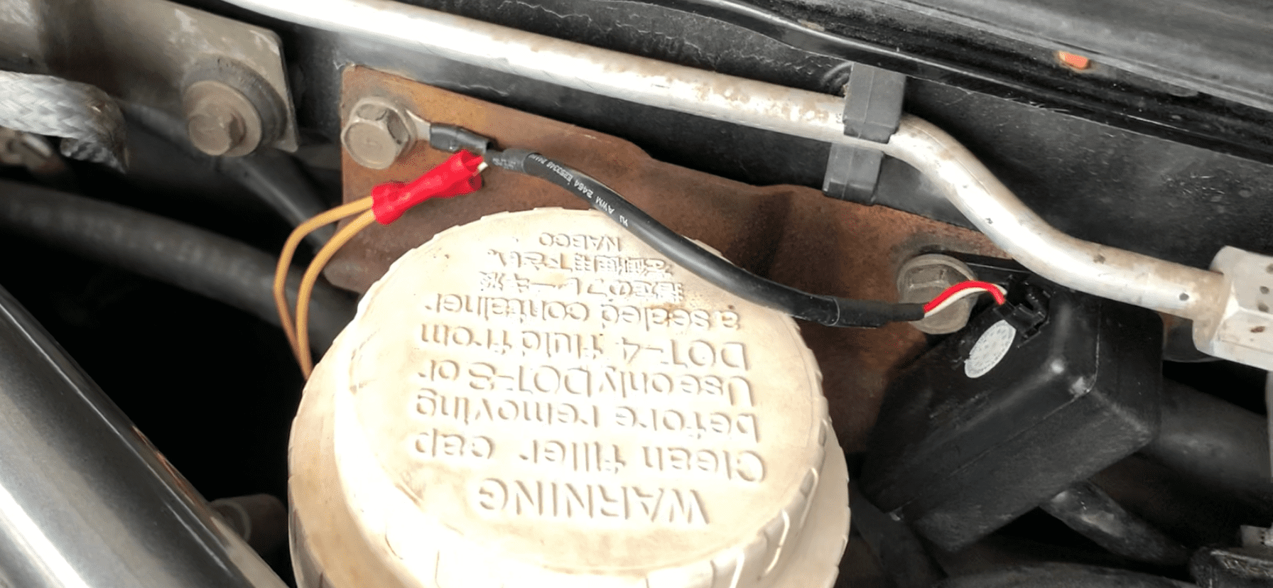

The wire from the kill switch goes underneath the cup holder and connects to the relay. This is where the relay will be; easy to access and out of the way. Ever need to get to the relay? Just pull the cup holder section out!

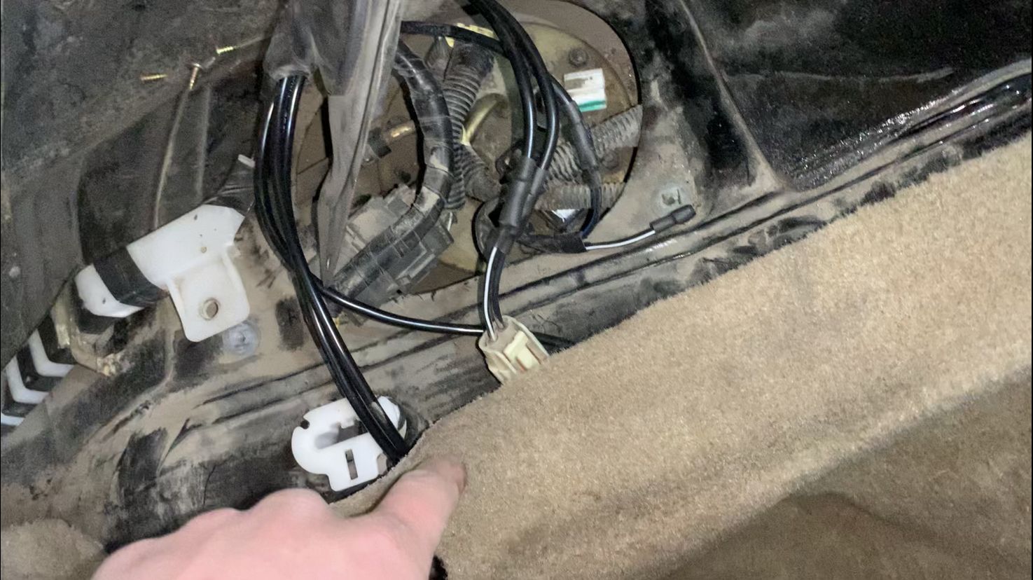

Finally, I ran three wires to the fuel pump by using one of those grabber tools (normally used if you drop a bolt in the engine bay or something) to pull them out from underneath the carpet; one for the remote, one for the power, and one for the ground. I just poked a hole in the boot that connects to the cover plate and fed the wires through that.
I also ended up grounding both the relay and the fuel pump underneath the cup holder. Not sure if the ground for the fuel pump needs to be close in proximity to the pump so the wire is shorter (not sure if that matters, I’m not an electrician LOL), but it’s worked so far.

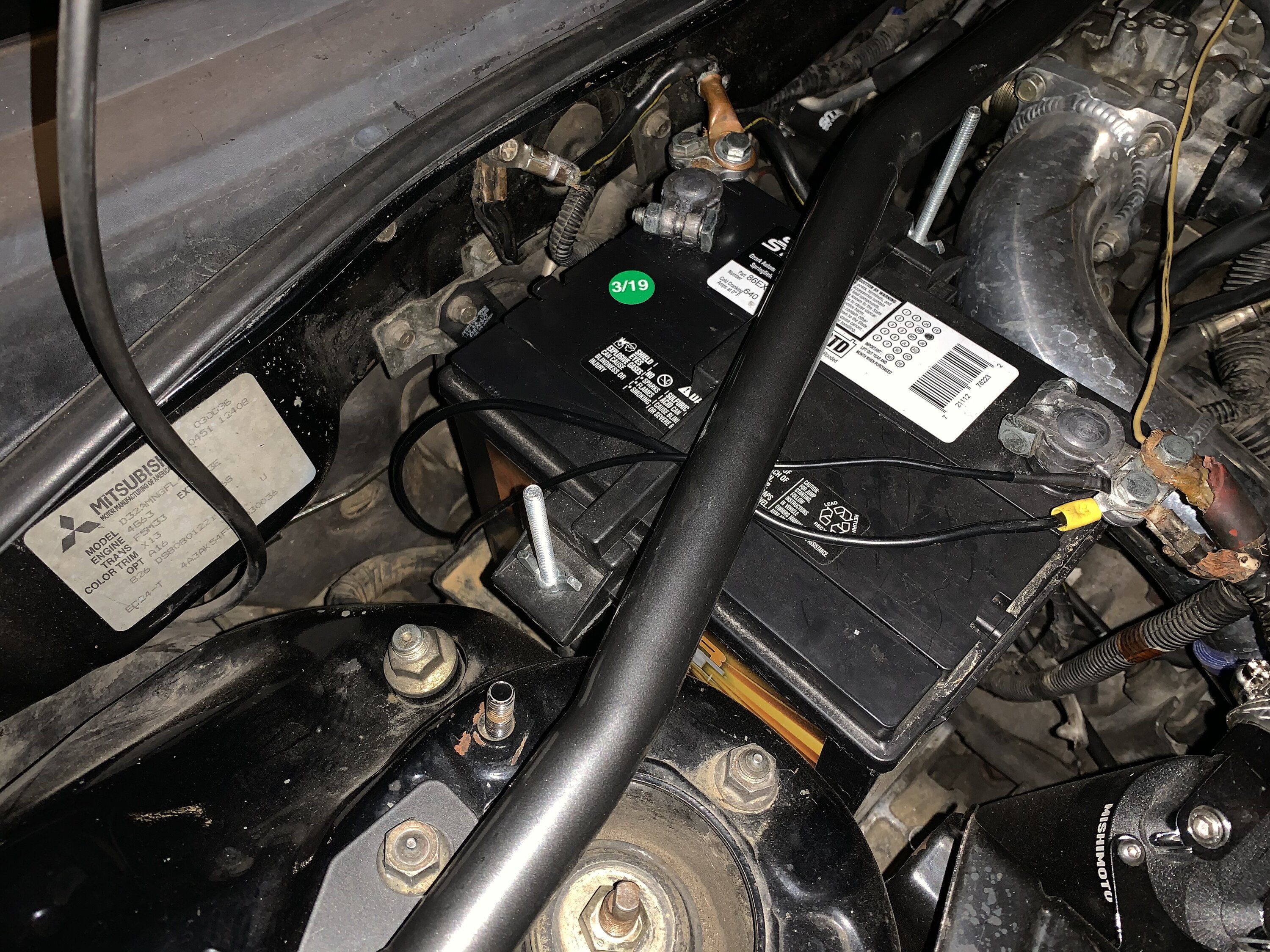

For the power, I sent a 12 gauge wire to the battery, and included an in-line, 10 amp fuse (fire bad).
/\ The second fuse is for the fuel pump.
For the ground I connected the wire to a bolt underneath the brake line (also with a 12 gauge wire).

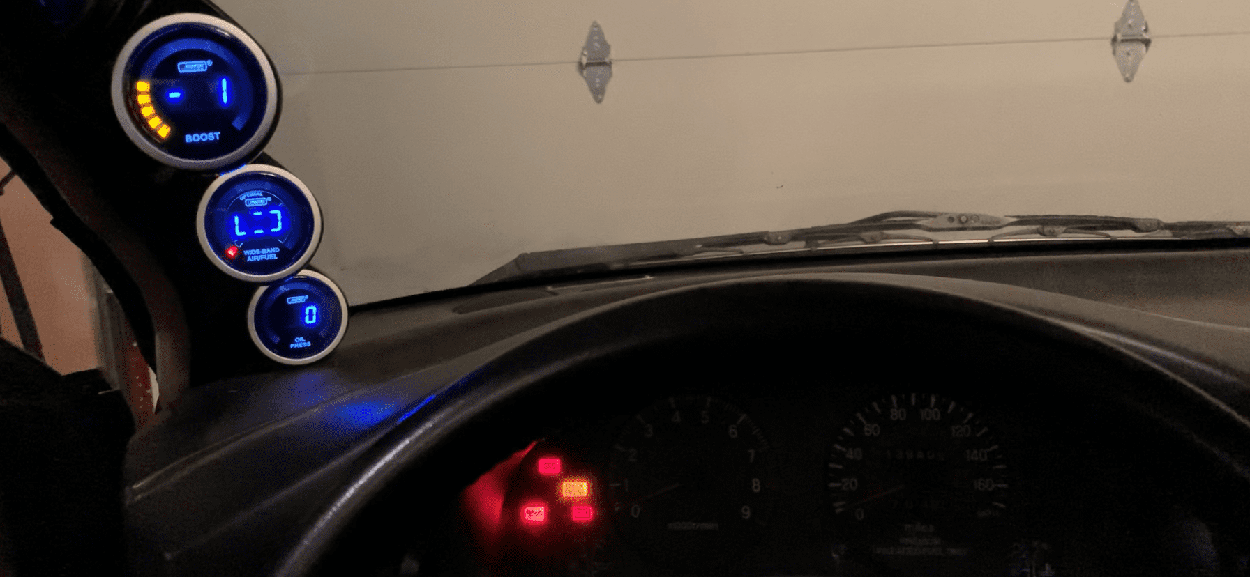

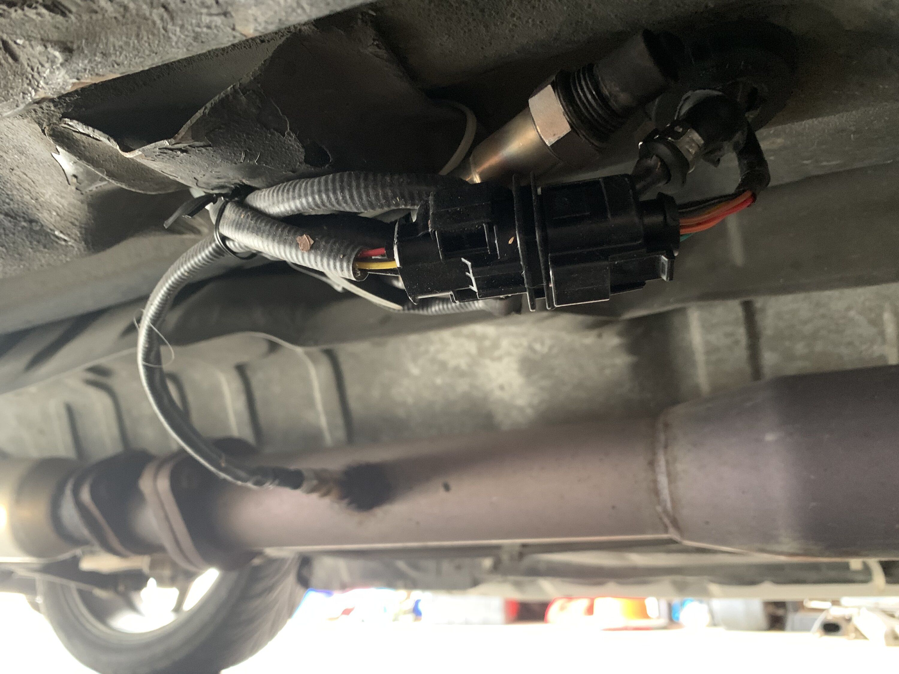

So I FINALLY finished installing the last of my gauges, the last one being the A/F ratio gauge. I put the sensor in the rear O2 sensors place, since it appears that I have a high-flow cat of some kind...
I still have the sensor, I just coiled it up (along with the excess wiring from the new sensor) and zip-tied it to keep it from hanging down and hitting the road.
I used the boot that goes into the cabin that the original sensor uses, and ran the wiring under the carpet and into the control box (a.k.a. home base).
And HUZZAH! It works!! Mostly. It goes straight to 20.0 when I let off the gas, which is strange, and the values are, uh, varied while driving LOL Not sure if this is normal, but I didn't see any dangerous values. Worst case scenario I'll get the exhaust redone when I take the car to get tuned.
I'm using the carbon fiber a-pillar cover with gauge pods from Special Carbon Fiber.

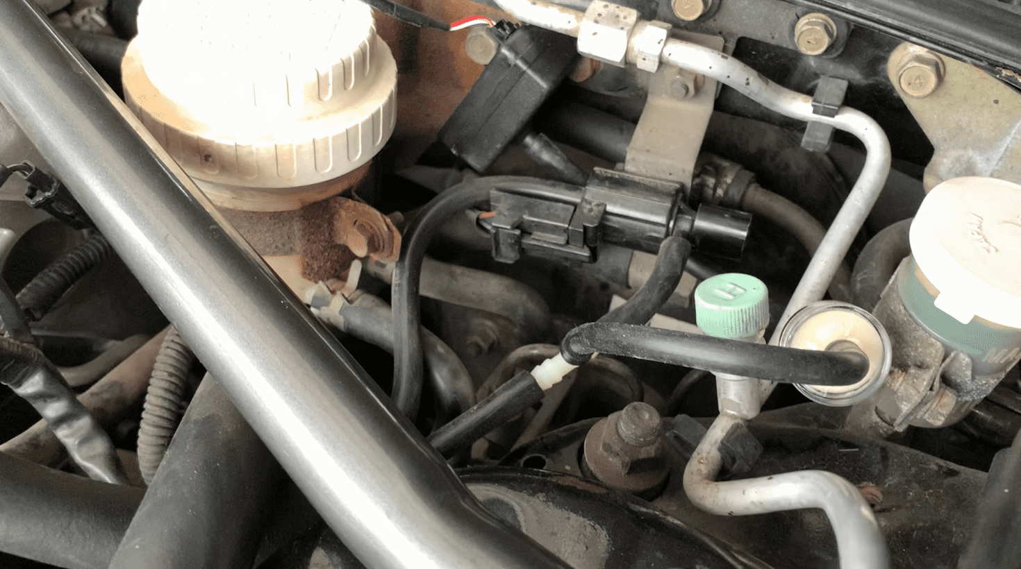

So I went to instal my new, Aeromotive AFPR with the 2G install kit form STM Tuned, and I realized "Wow, I have nowhere to put this". So, I decided to do some engine bay clean-up.

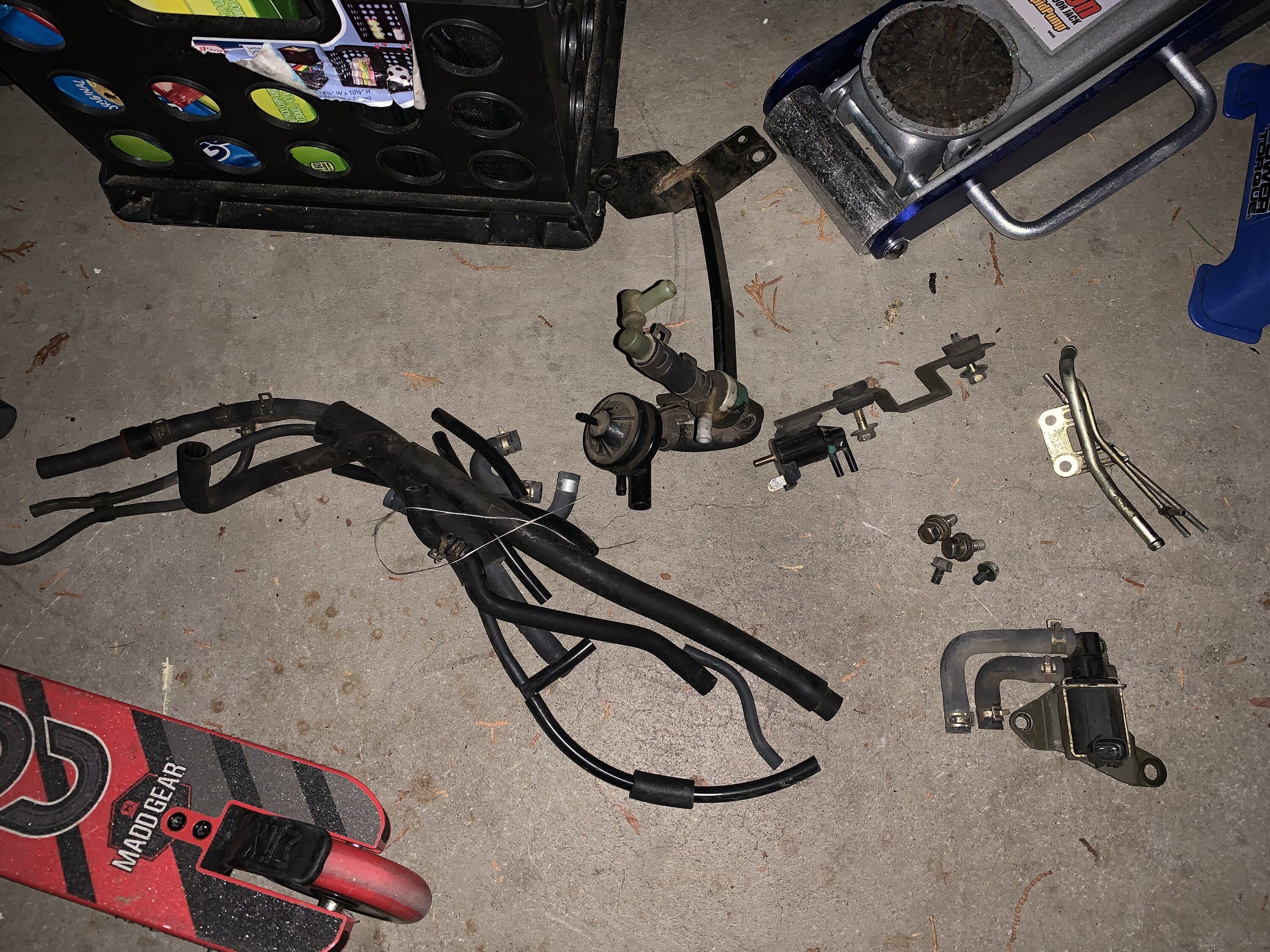

VIOLA!! EGR system: gone. EVAP system: mostly gone. I still have to get rid of the charcoal canister (thank you Mitsubishi for putting it in the gas tank).

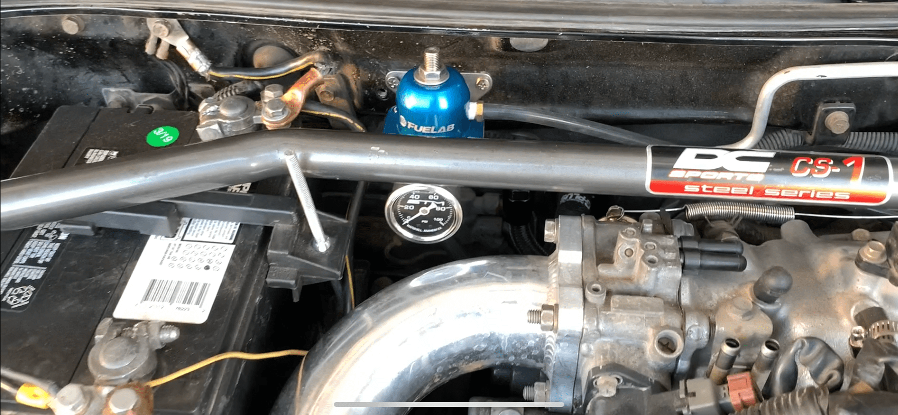

The biggest thing however was the installation of the Aeromotive Adjustable Fuel Pressure Regulator and 2G DSM Install Kit! Now I can put that bigger fuel pump in...
It actually didn't take a huge amount of time to do, but I did have to put the regulator in an interesting spot...

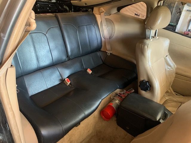

And then today, I got some rears seats out of a 3rd gen Eclipse and slapped those in:
One of the brackets was a little bent, so I had to, uh, "convince" one of the seat backs to line up better with the other. But other than that, they bolted right up! $34 well spent 😌
The only reason why I got rid of them in the first place was 1. weight savings, and 2. I didn't really drive anyone around other than myself. But recently I've been doing a lot of carpooling people to church and stuff, so I decided to put some rears seats back in instead of constantly borrowing the family C-Max.

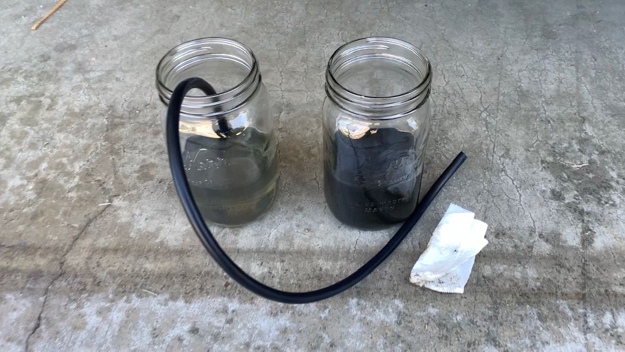

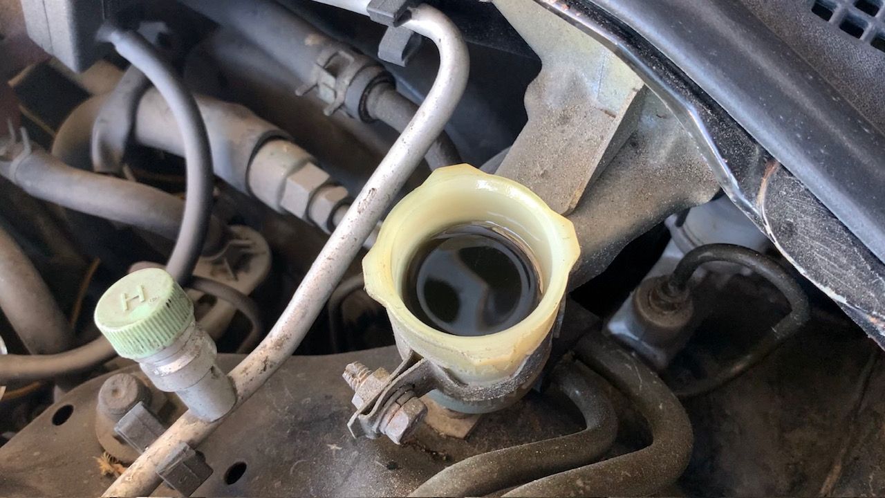

So I replaced the clutch fluid today in an attempt to get the car working again... and BOY did it need a clutch fluid change! I went through a lot of clutch fluid to change all of it, and almost used the entire 1 quart!
That stuff was nasty!!
Unfortunately, the fluid change wasn't enough to get the car to shift into gear, which means I'm going to have to replace my slave- and master-cylinders as the next step in this process.

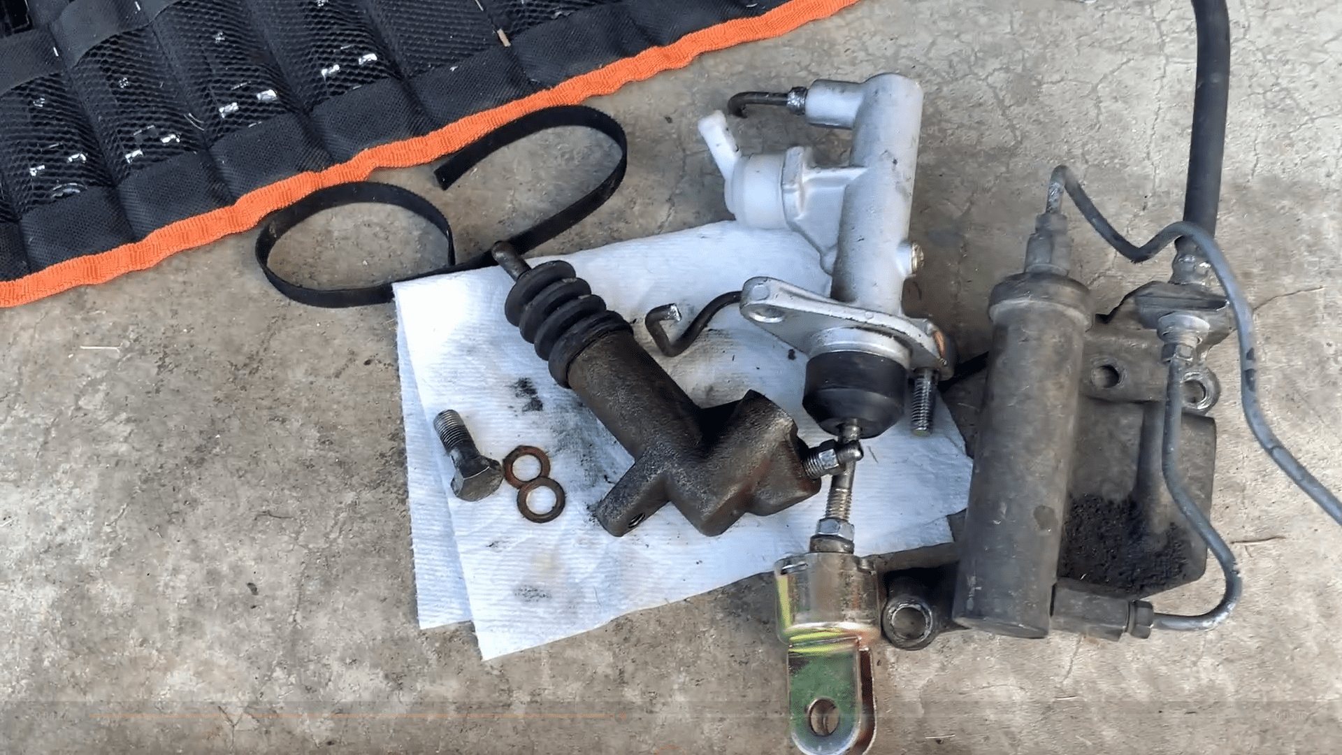

So I ordered a new slave cylinder and master cylinder and started to install them, when I saw that the clutch line was rounded out at the master cylinder! Gosh, I have bad luck with these hard lines on this car (Thinking of you, oil feed line to the turbo 😒). Anyways, I promptly ordered the stainless-steel line from STM Tuned and waited for about a week and a half for it to arrive.
The install was pretty straight forward, although I do wish the line was shorter so that I didn't have to route it all the way around the engine bay. But hey, I'm glad it's all over with 😂
Something that I didn't show in the video is when I was bleeding the new clutch line. Bubbles just kept coming out! But then I tried not opening the bleed nipple as much and the bubbles stopped, so maybe by loosening it too much it can actually suck air into the drain tube? 🤷‍♂️ Also, it may have just been my slave cylinder that was the problem, because the master cylinder looks pretty good, even though I checked the slave cylinder and it seemed ok...
