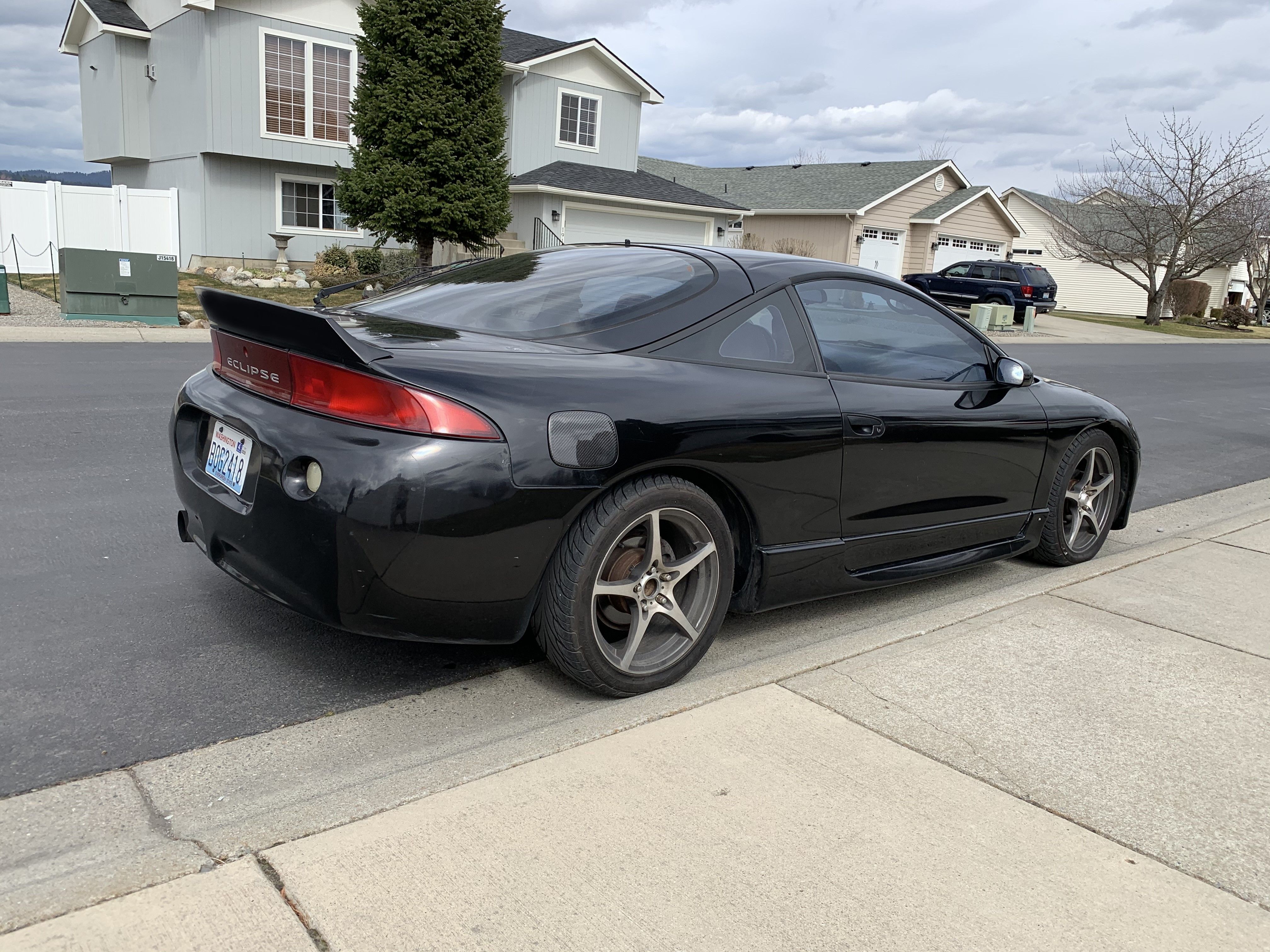

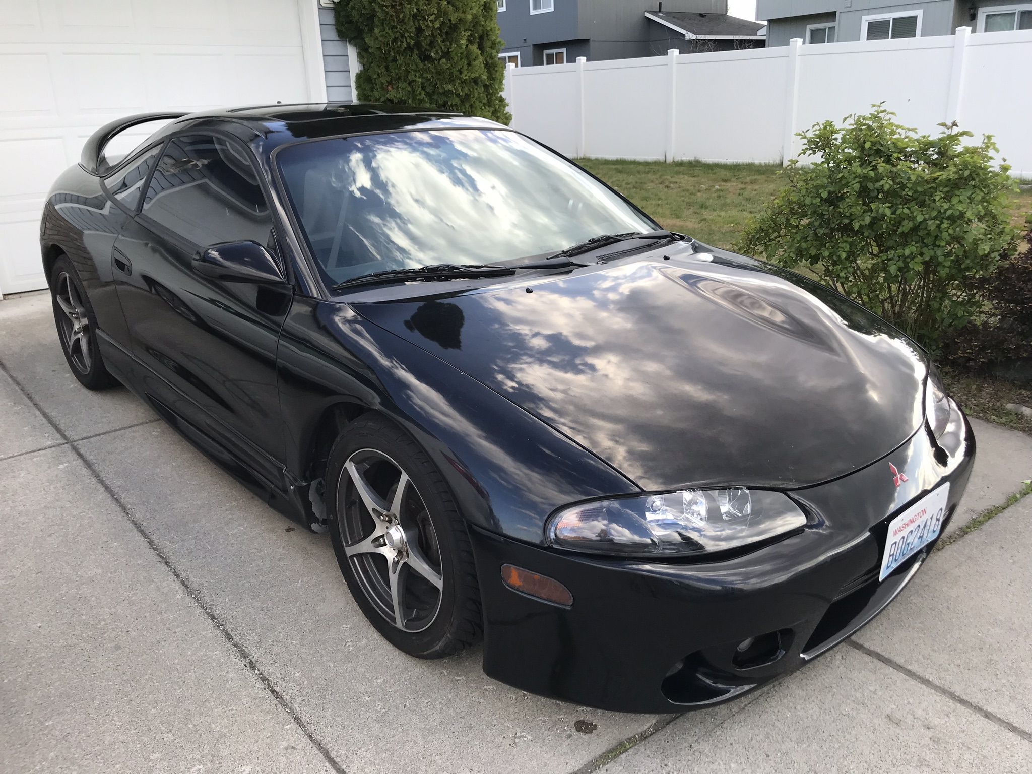

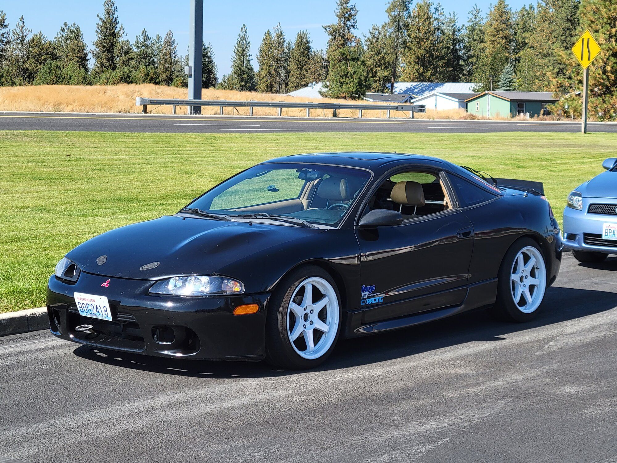

My 1999 Mitsubishi Eclipse GST.
Before I tell you my mod list and future mod list, I'm gonna tell you the story behind this DSM. The car truly chose the driver and I've definitely grown to love this car. I don't expect you to read all this (ecpecially since it's the size of a small book LOL), I'm writing all this mostly for my own purpose of having a record of my 2G.

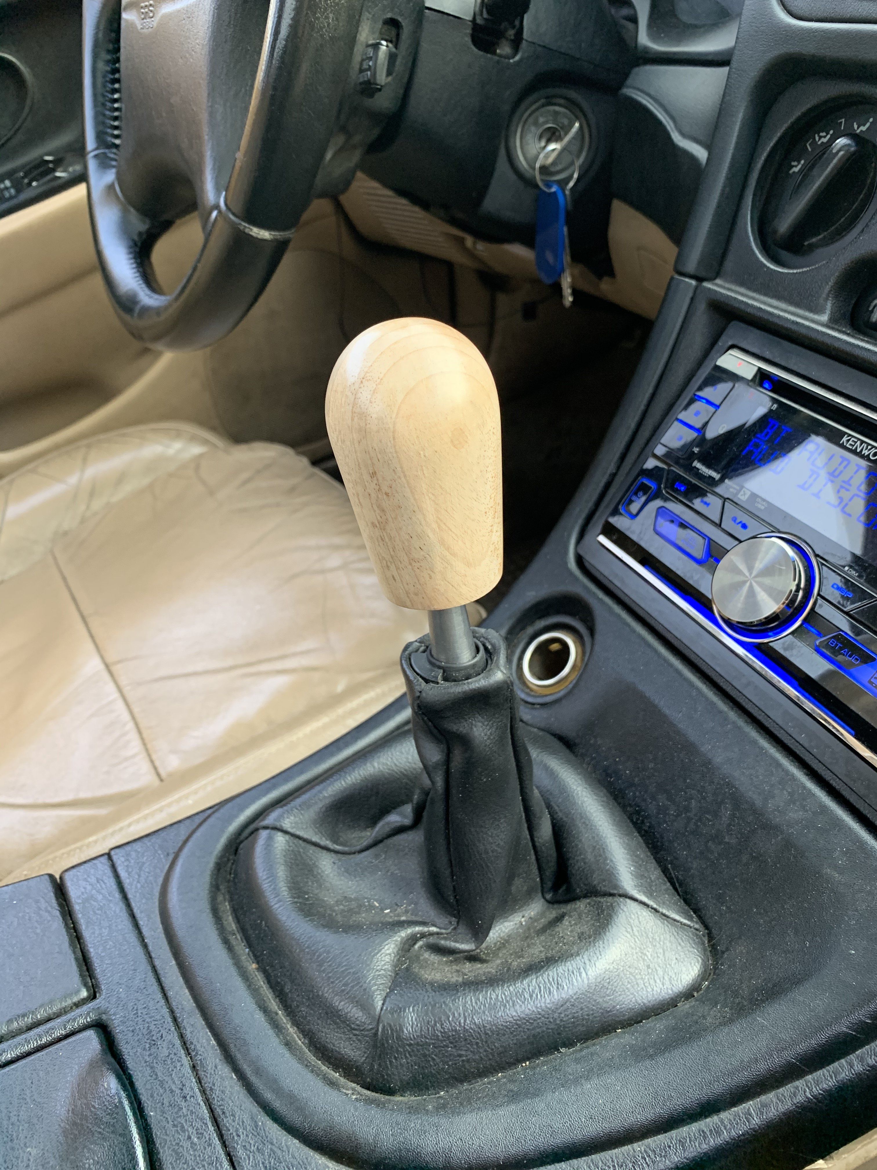

Meanwhile, my best friend Trevor gave me a new shift knob that he made himself! I love it and will keep it in my car for as long as I own it (which is hopefully for a long time). Might need to get a new boot though to take up the space between the current boot and the new knob...

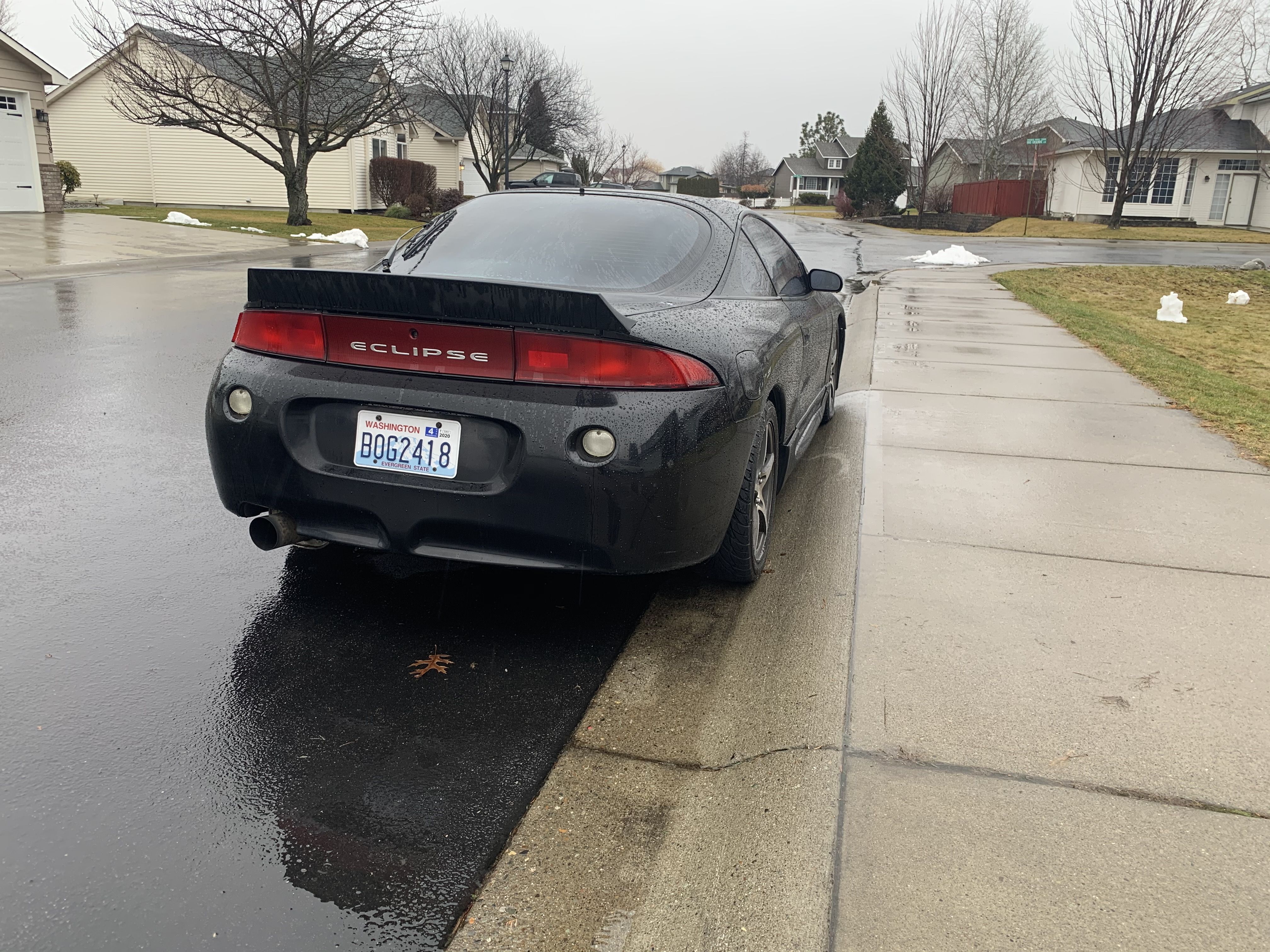

And last but not least, my search for a 2G duckbill spoiler has FINALLY come to an end. For the longest time I couldn't find one (except for some random one on ebay that was from Russia), but then I found out that Carbonetics builds exterior parts for 2Gs. I ordered the duckbill spoiler from the widebody kit they make and am anxiously awaiting it's arrival... I've heard horror stories about Carbonetics by reading some threads on this site, but I was told it was going to be shipped as of yesterday so we'll see.
The journey continues...
I put the new fuel filter in, which was a PAIN to take off because the bolts refused to loosen for 4 hours... but alas, I did it. But then the filter started to leak, so the next day off I had I went back in, tightened it up and everything was set!

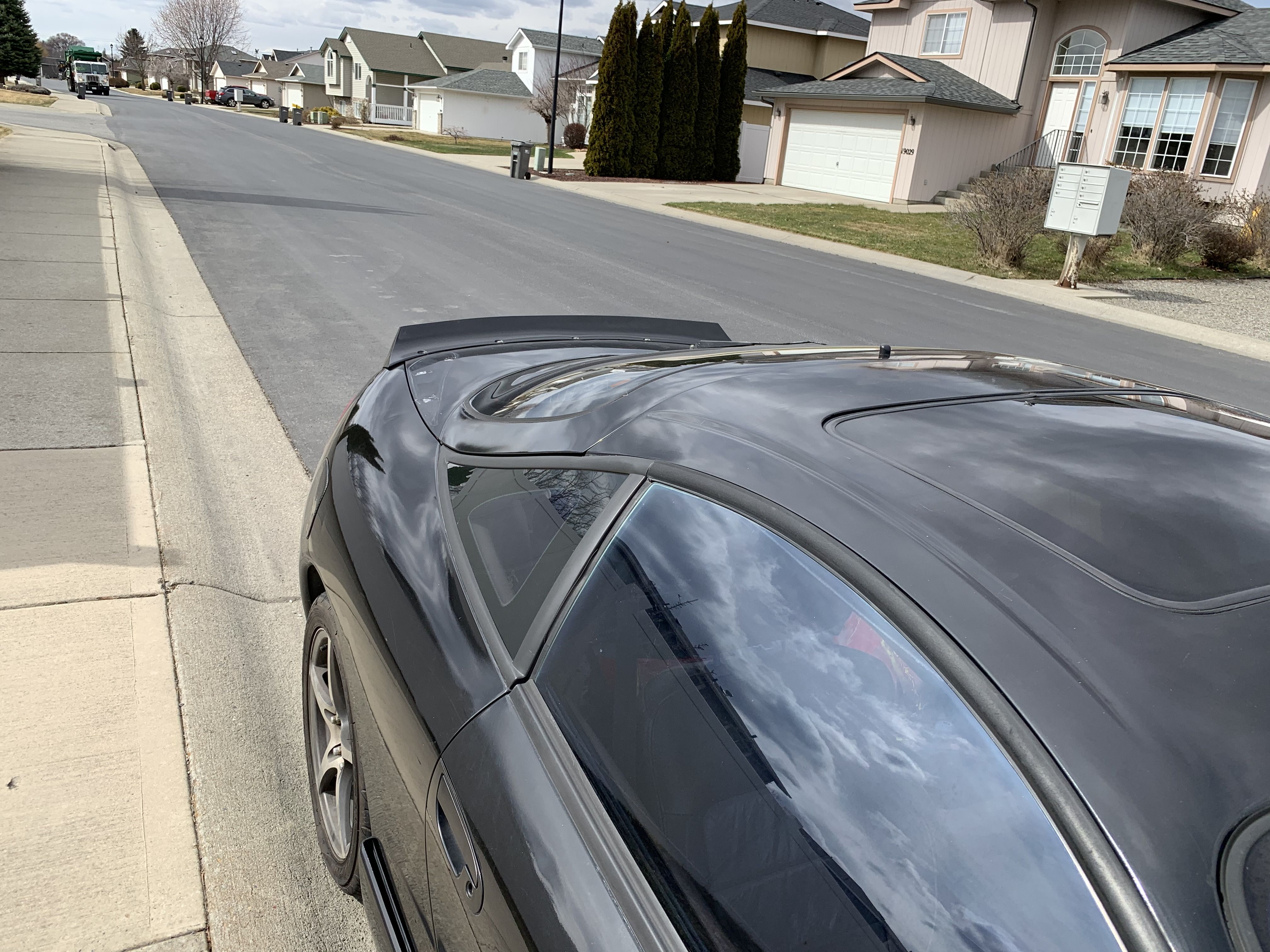

Then I started the installation of the duckbill. I've waited so long for this! I purchased the appropriate hardware, drilled the holes for the new spoiler, and then it snowed. I taped the holes closed, but by the time the snow was clear, there were some sizable puddles of water in my cabin and trunk. I put the spoiler on, vacuumed it out, and then took the spoiler off again to paint it... but not before I took a quick pic of what it looked like ;)
The fitment isn't perfect, but it's good enough. I'm not complaining since this is the only duckbill spoiler for the 2G on the market right now. To be honest, I really dig the look of the 2G without the spoiler. Once it's painted, I'll post more photos of the spoiler. Engine mods coming up pretty soon!

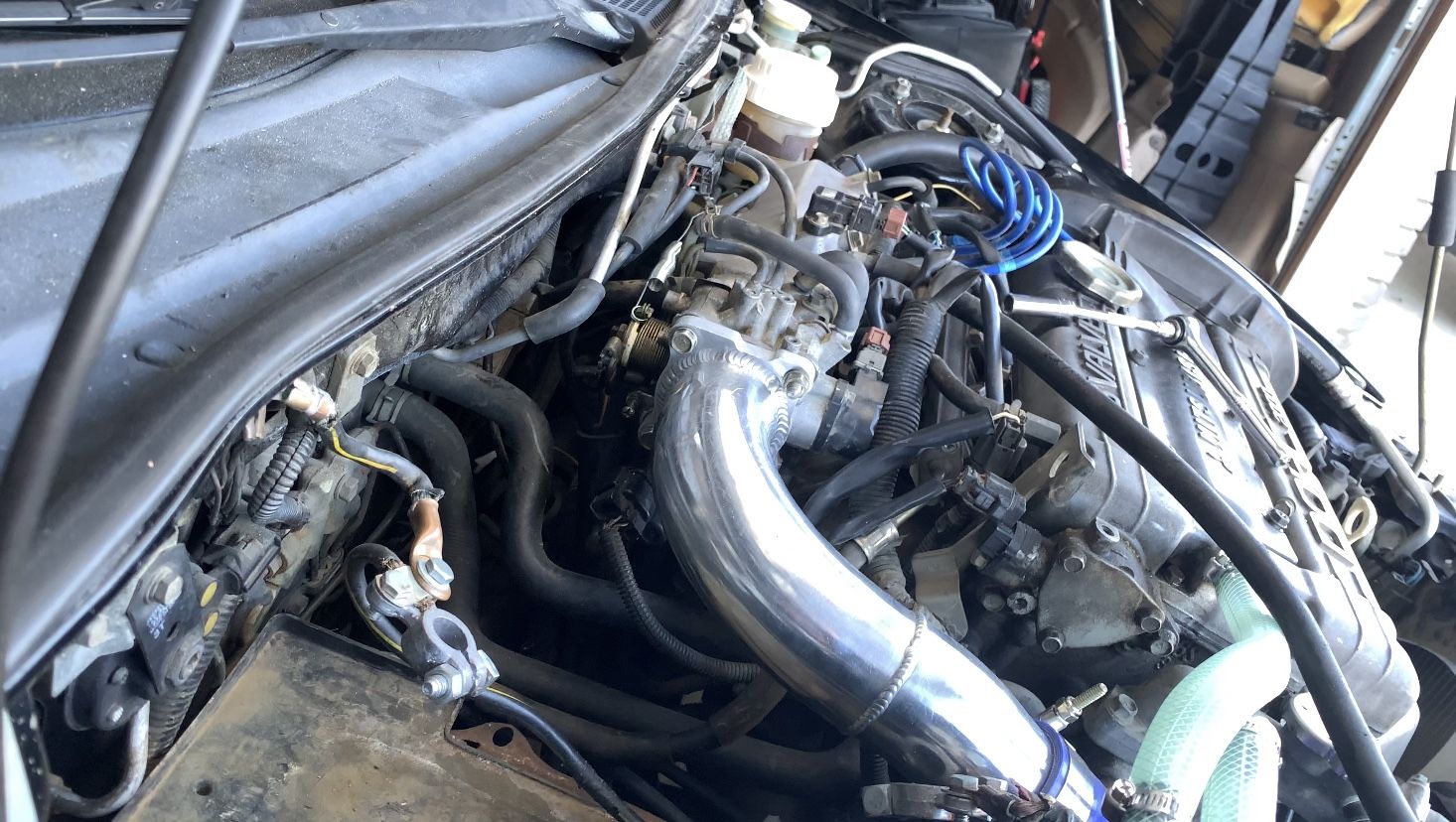

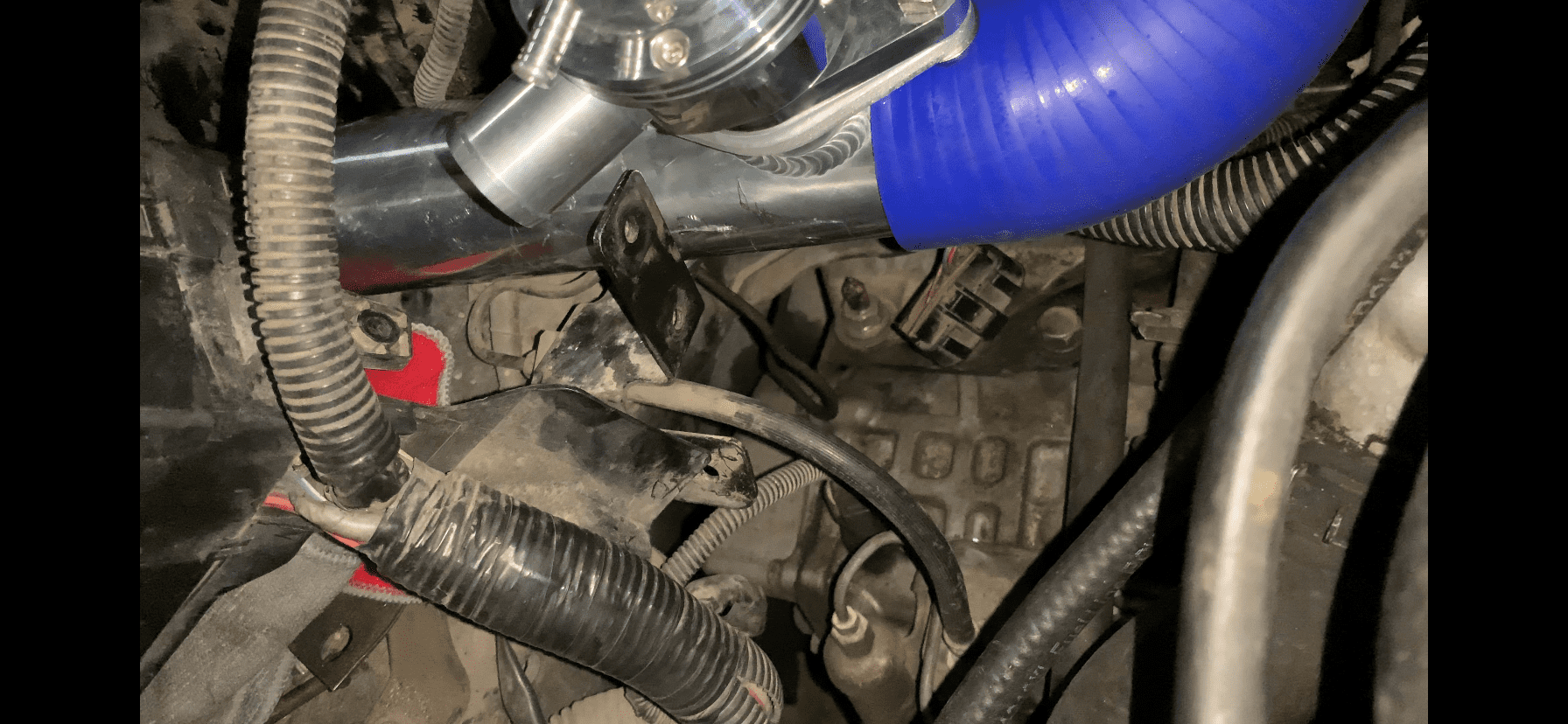

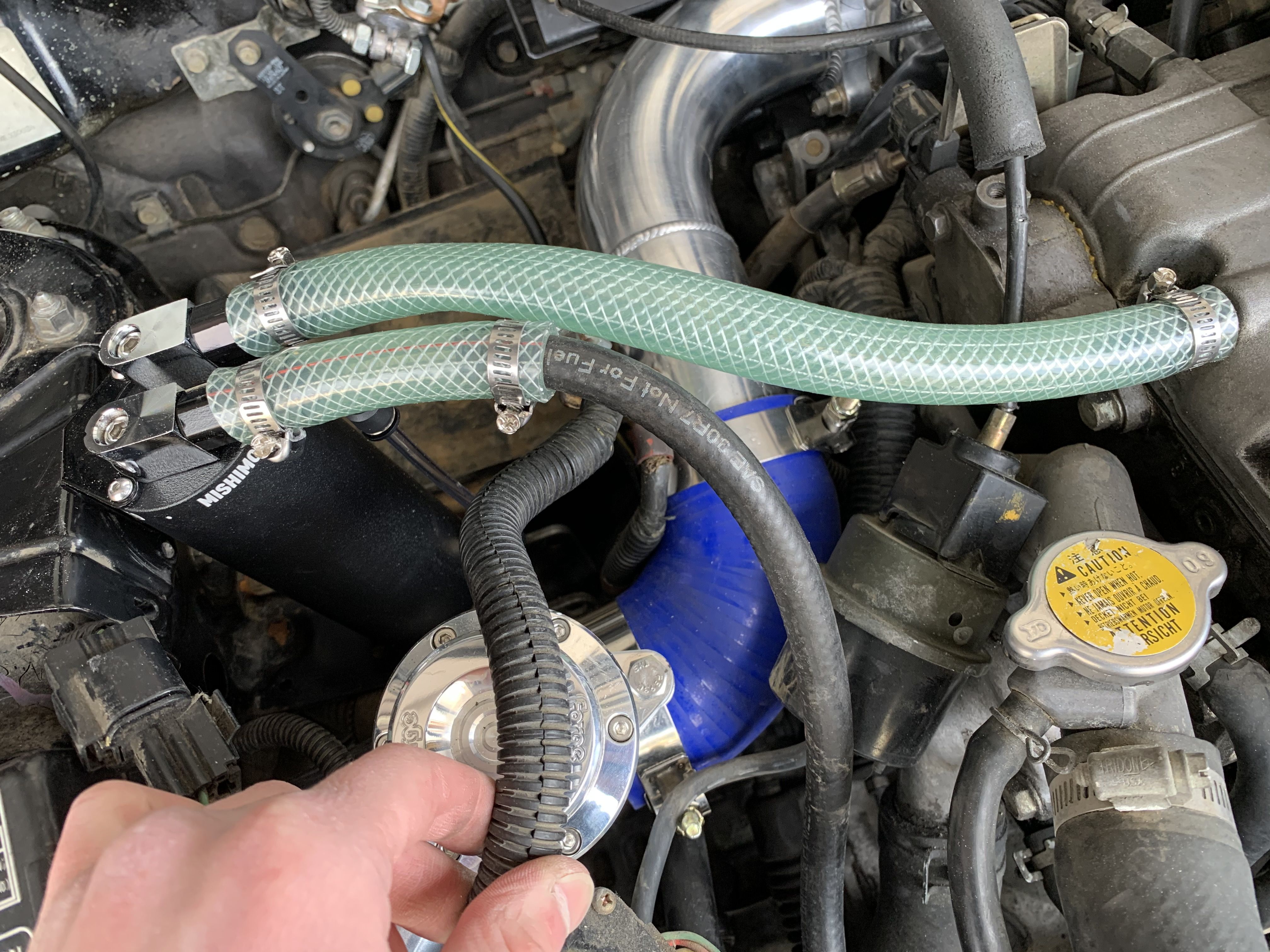

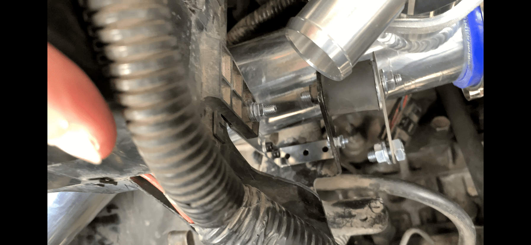

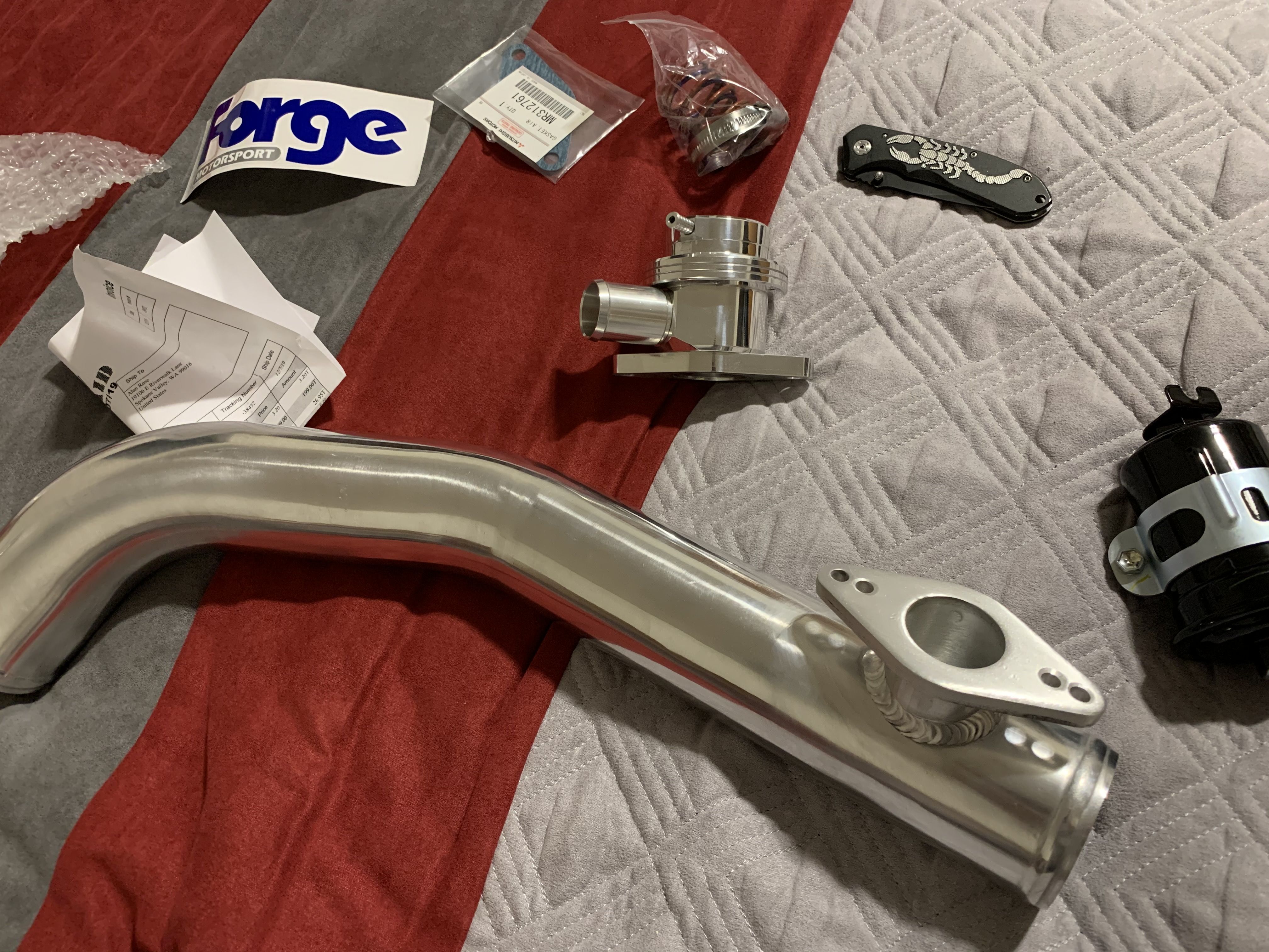

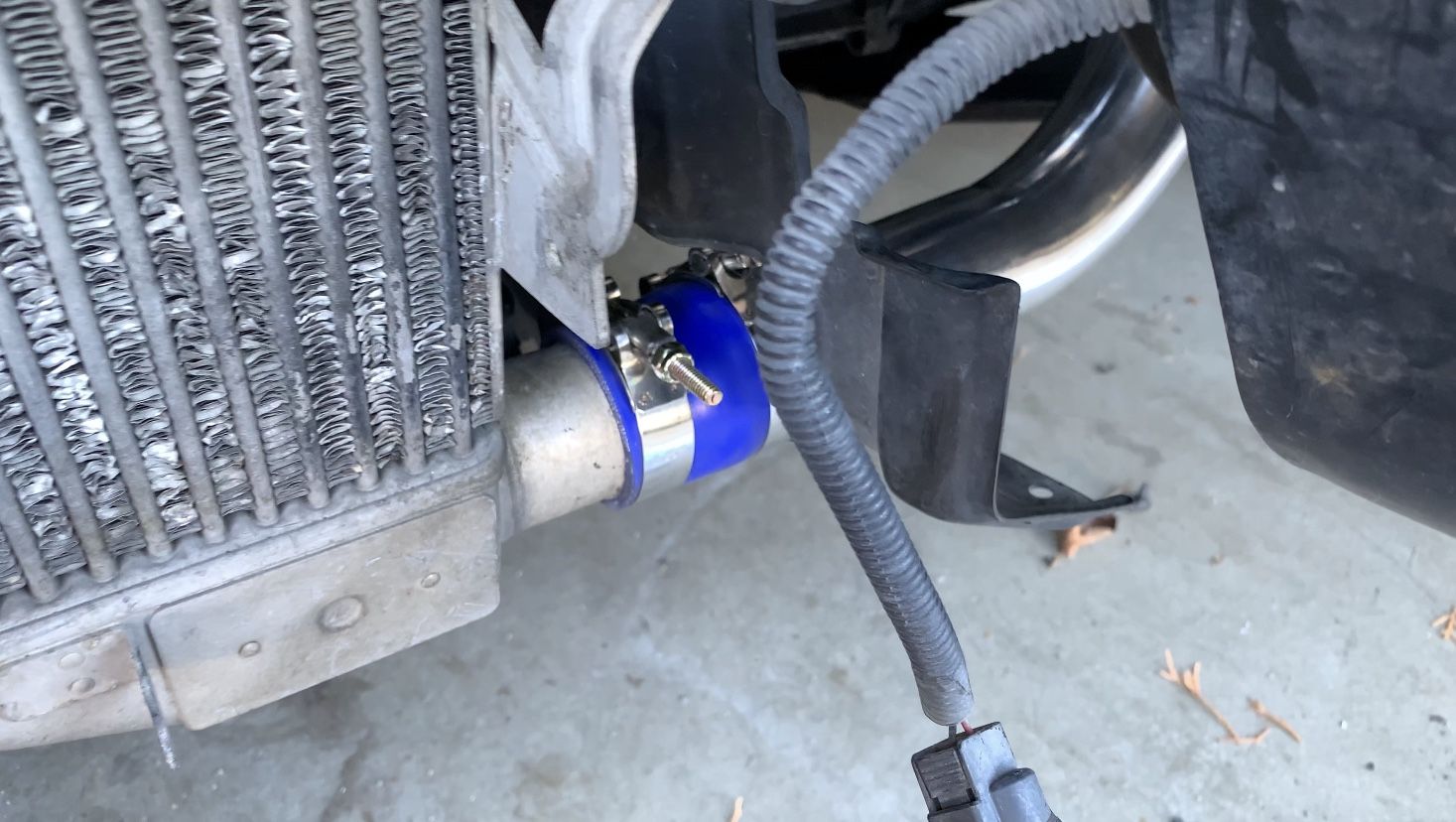

So last Monday, I had the project of trying to get the new aluminum intercooler piping to fit. I had to cut some excess off of a support piece that held up the fuse box in order to have room to get it to line up right. I actually started a YouTube channel just for fun, so that's all in the video. My videos will have more than just car stuff in them, but there will almost always be a car project in them. I actually have to post the video about a week after I film it, (so every video I upload will be on Monday, but it will have been filmed the week before. I need time to edit and add music, etc.), however, since it's easier to type and post photos than it is to practice, film, edit, add music, etc. when it comes to making videos, I'm going to post updates sooner than I post the video, then I'll go back and put in the link when I actually post the video... if that makes sense. Kind of an early access type of deal I guess :thumb:
^ Before cutting, I had NO room to make the intercooler piping fit. The 1G BOV also is causing some fitment issues with the fuse box, but I fixed those later... mostly.
^ After cutting. This is the same piece you saw earlier, just sans the pipes. I originally thought that I was going to have to cut the whole thing off, but thankfully I didn't.

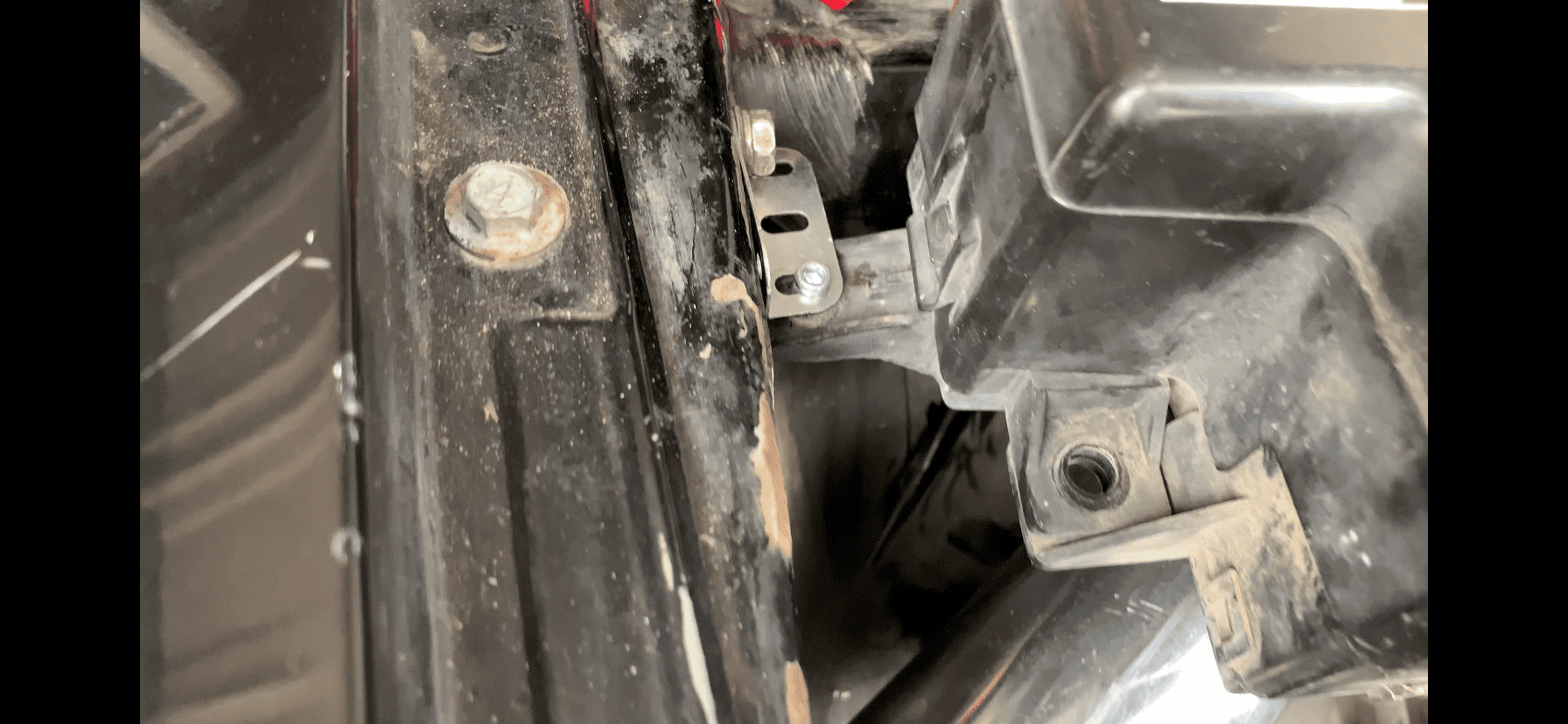

And then what I did yesterday was basically secure the fuse box so it wasn't touching the piping, install my new oil catch can, and then put on the rest of the intercooler piping. I actually started removing the cruise control yesterday since I kind of took it's place with the catch can... well, I guess I'm looking for a throttle cable from a non-cruise-control DSM now LOL Please do keep in mind that I'm a complete noob when it comes to working on cars, so bear with me :D

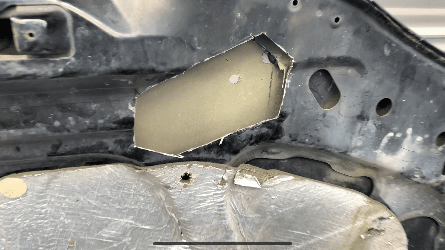

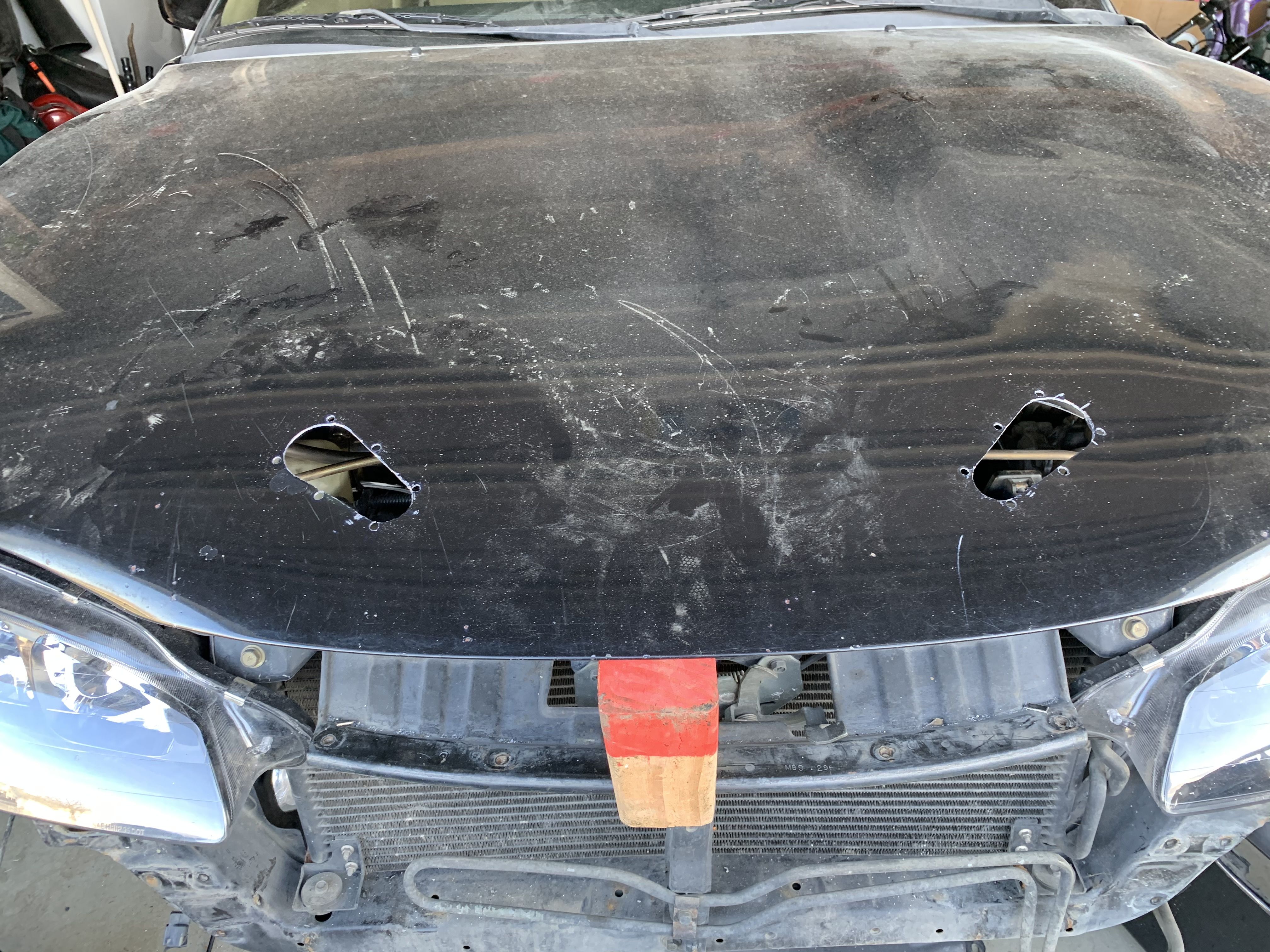

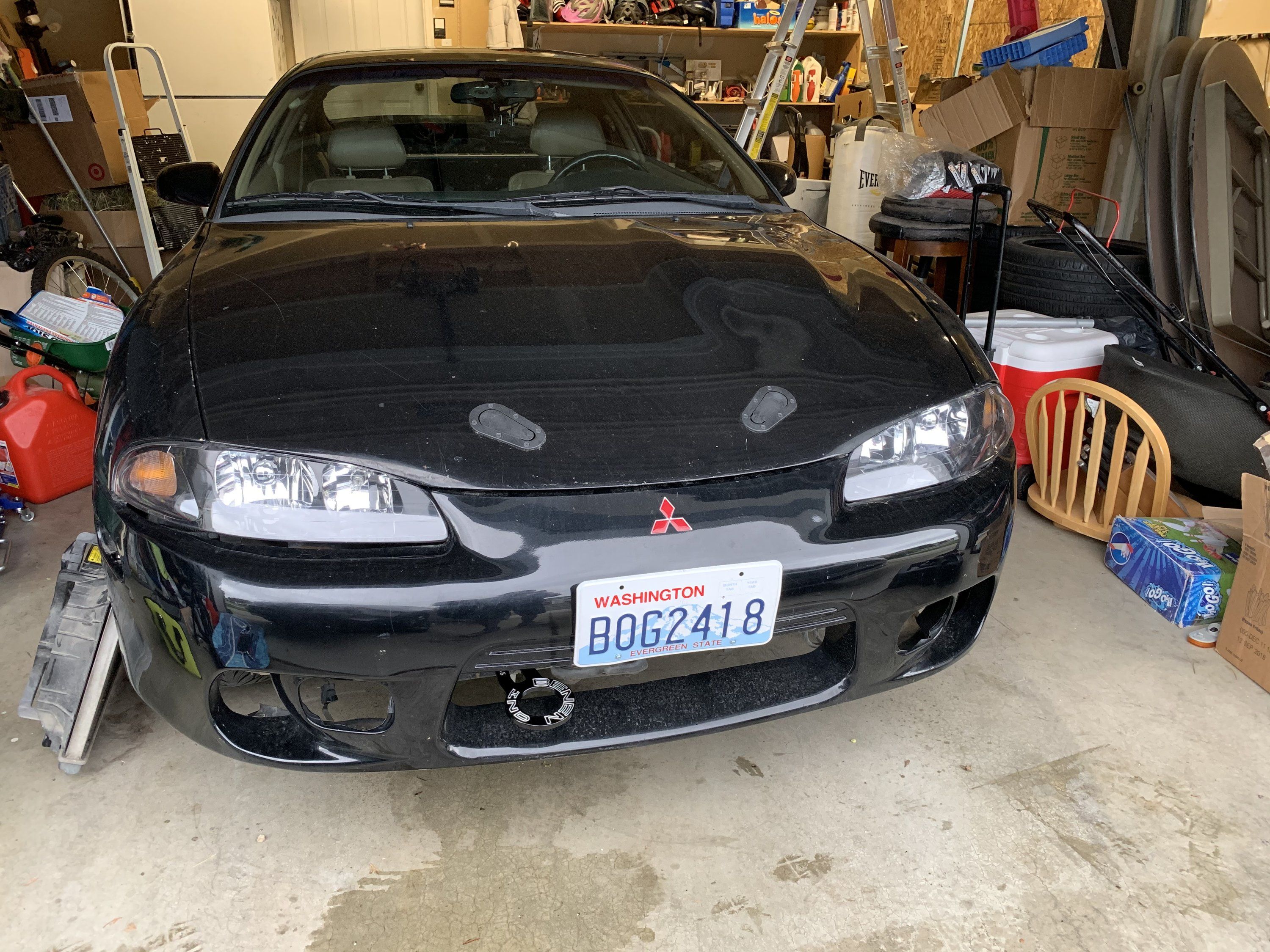

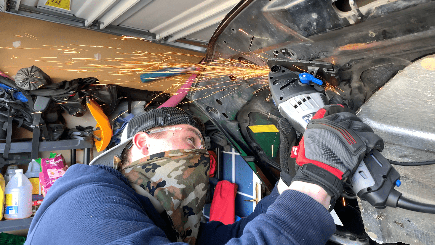

Over the past week, I was able to get a few things done. My friend and I fully removed the cruise control system from the engine bay, and now I'm just waiting for the non-cruise throttle cable to come in the mail so I can drive this guy again. Also removed the plastic cover over the radiator, because I didn't like that being there. And then after 8 long hours, I put my hood pins on! I've been waiting to do this for so long, only now did I have the time (and the guts LOL) to do this... my car has eyebrows!
^ Yes, I cut the wrong way. I've never done anything like this before :ohdamn:
^ After I cut everything and drilled the holes.
^ This is where I placed the anchors.
BOOM... eyebrows :sneaky:
I liked the angle, makes the car look a bit more 'angry'.

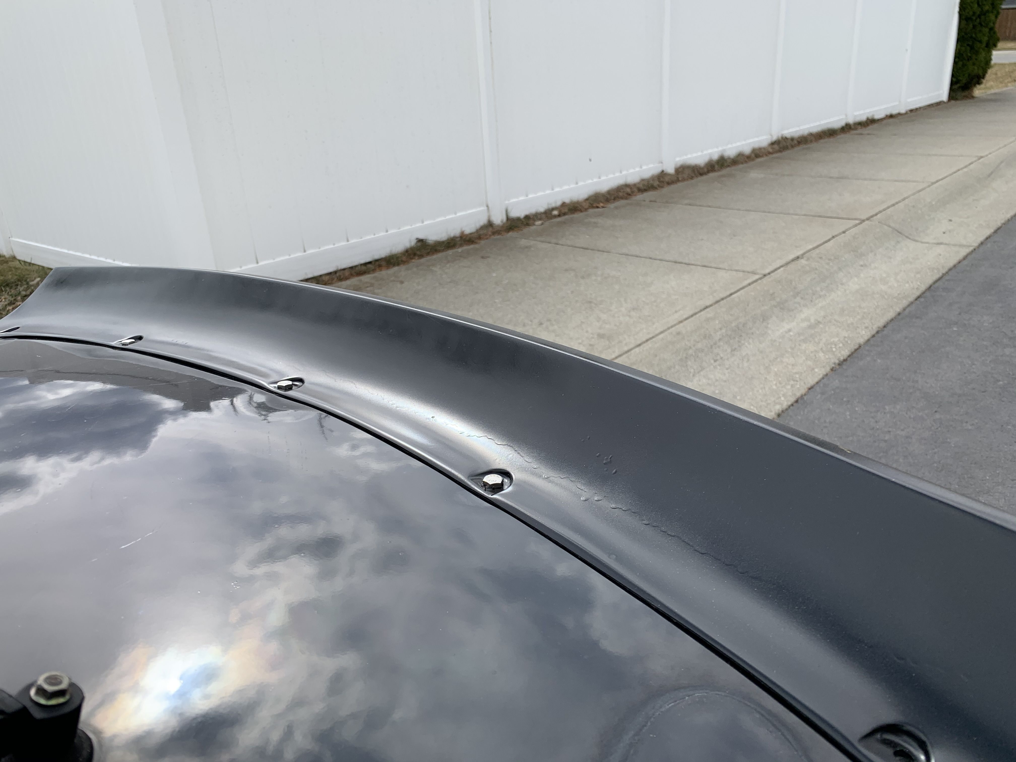

Put the car together and finally got it running again! Had to take it apart again and fix a boost leak that developed, but I was finally able to get some good shots with the duckbill spoiler!! Btw, I used a DIY boost leak tester that literally cost me less than $2. All I used was a PVC end cap that was the width of the inlet to my turbo, drilled a hole through it, and stuck in a rubber valve I got from a tire store for free.
^ Fairly basic, but it was cheap and got the job done! I used the coupler that went from the intake to the turbo to attach the tester to the turbo instead so I didn't have to buy a new one.
^ My paint job isn't the best, don't really know what I'm doing... (story of my life LOL)
I like the look. It's more subtle that the stock turbo spoiler, but outrageous in it's own way. Just gotta get some plugs for the screw holes that are there from the last spoiler.

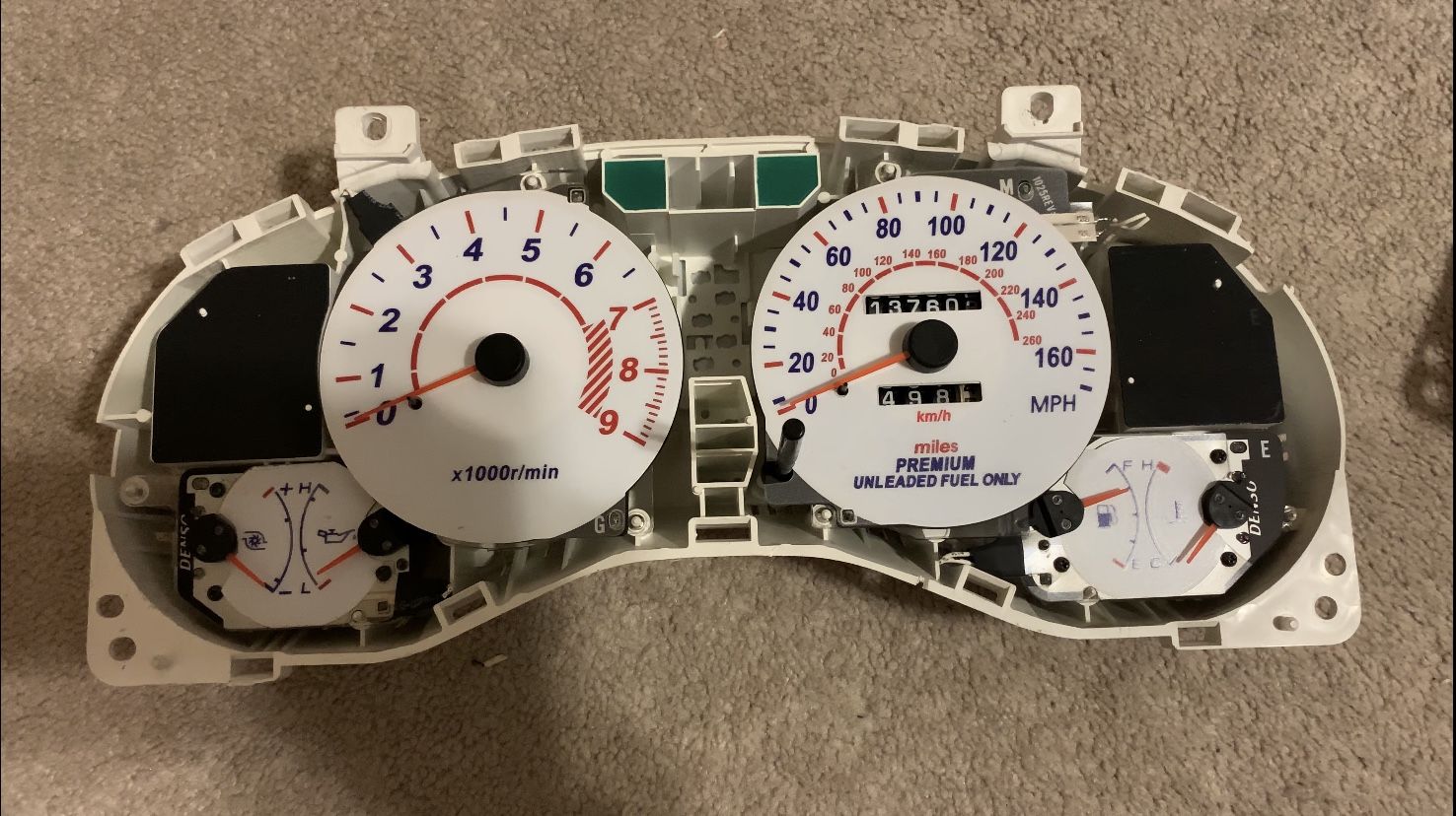

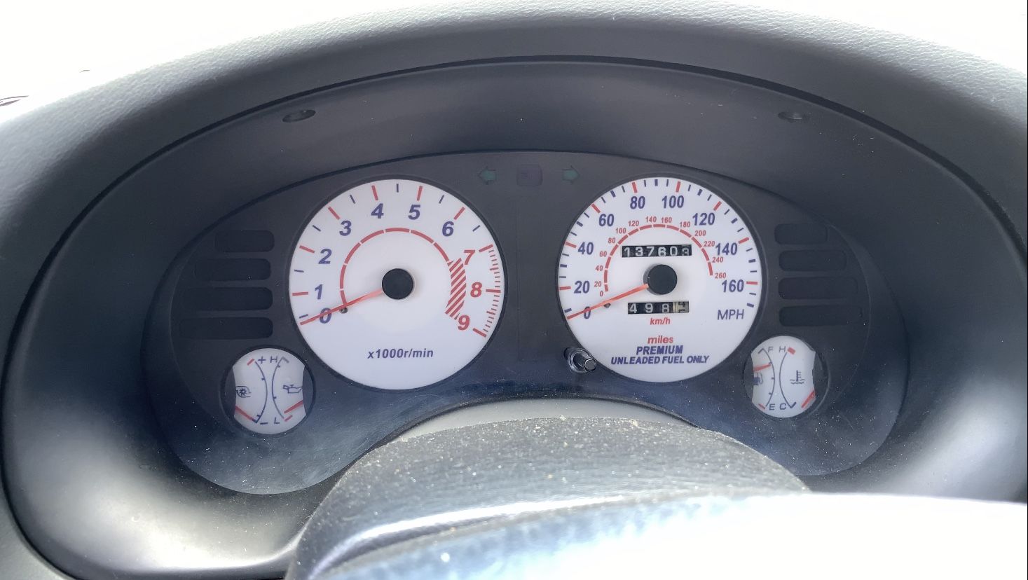

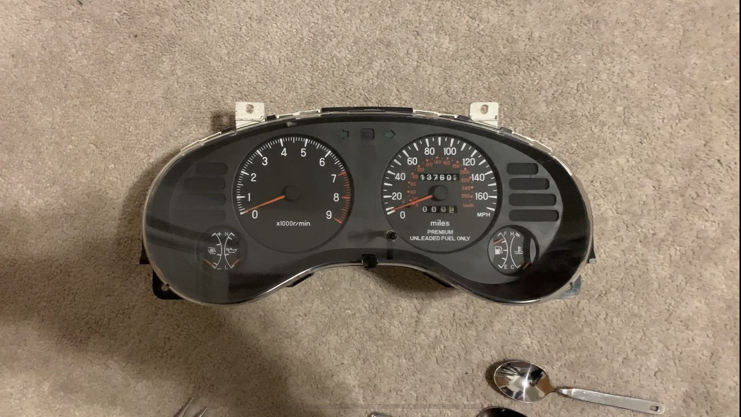

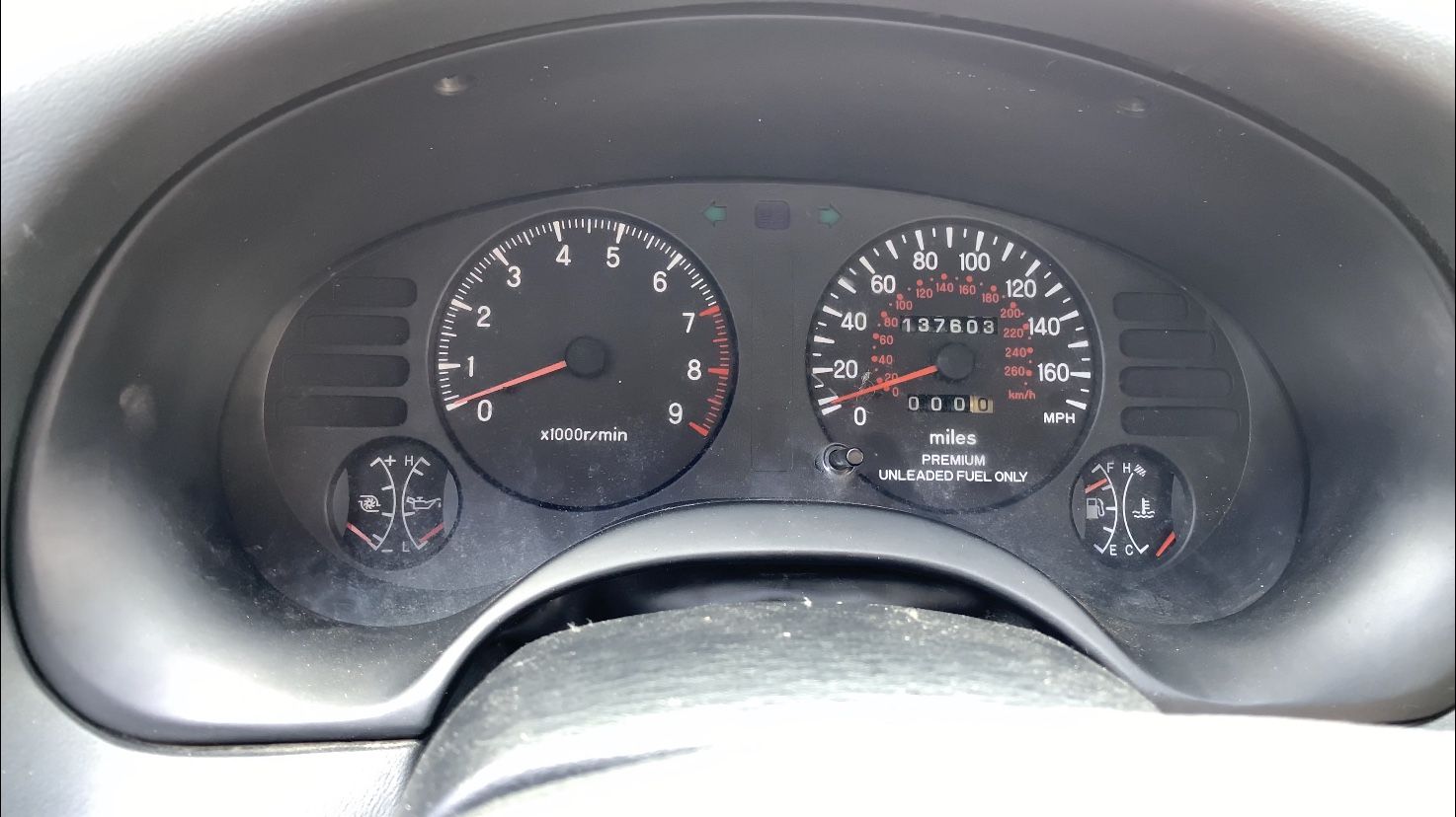

Didn't do a whole lot this time, but what I did do was replace the gauge cluster with a stock one that I got off of Rix Racing. Why replace the one I've got? The lights don't work, and I kinda need that while driving at night haha
Tricky thing is though, I had to find out how to change the mileage on the odometer of the new cluster, because I don't want to have to guess what mileage I'm at. Legal? Not totally sure...
^ The OG gauge cluster. It had a bunch of wires sticking out of it that went to an external box... some kind of aftermarket thing I guess... didn't want that.
^ New cluster, with miles adjusted to 137,603, the same miles on the old cluster.
During the process, I had to remove the needle on the speedometer, which threw it all out of wack. Luckily, I found a really stupid way of fixing that... drive the car without the needle, find the nearest speed sensing sign, and then place the needle in the correct position. Problem solved ROFL
Yeah, that's about it. The lights still don't work though, so I think the gauge cluster not lighting up is a problem with the car and not the cluster... hooray electrical issues! LOL And the oil pressure gauge doesn't work on the new cluster either, but I think it looks better than the old one, and I'd rather have a stock unit in it than an aftermarket one... that, and I'm too lazy to put the old one in there LOL

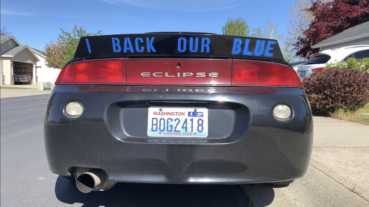

Not a whole lot happened here, I just repainted my spoiler to have the message "I Back Our Blue" on it. My Dad used to be an MP, so I have a lot of respect for the police. It turned out pretty good!

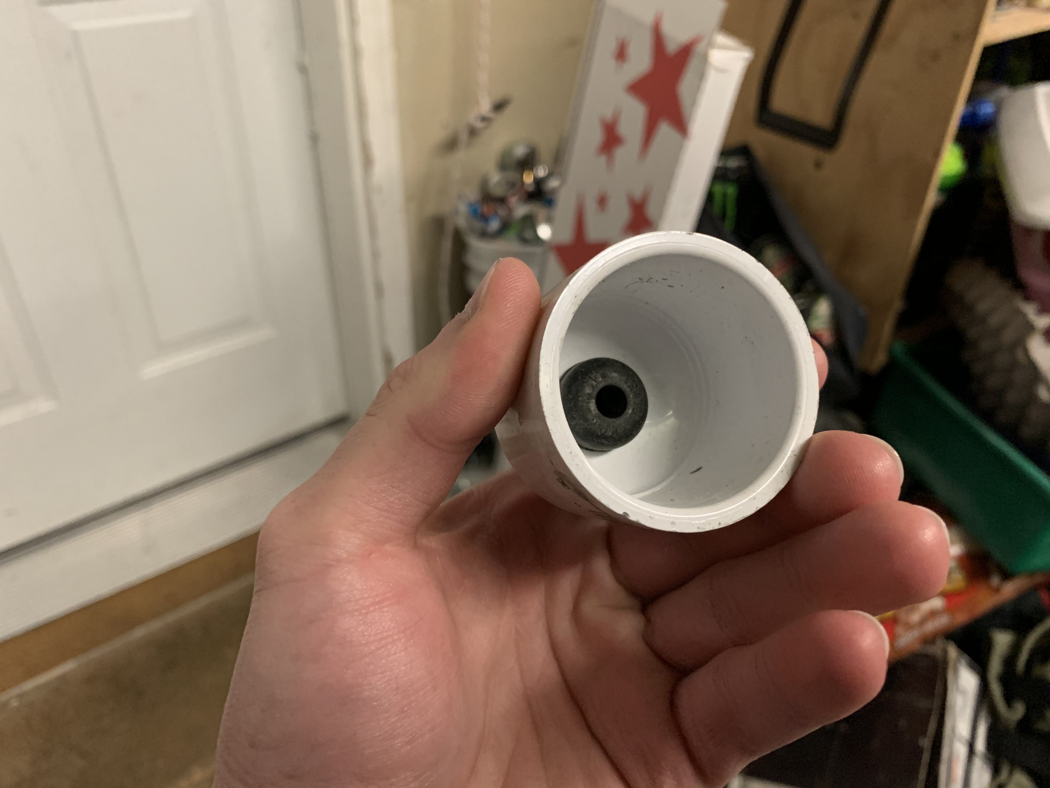

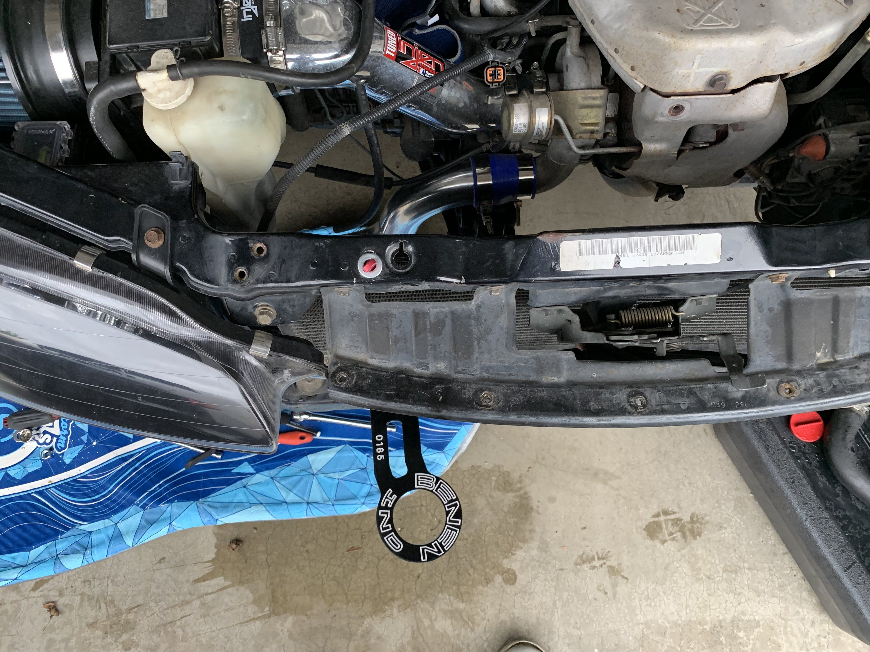

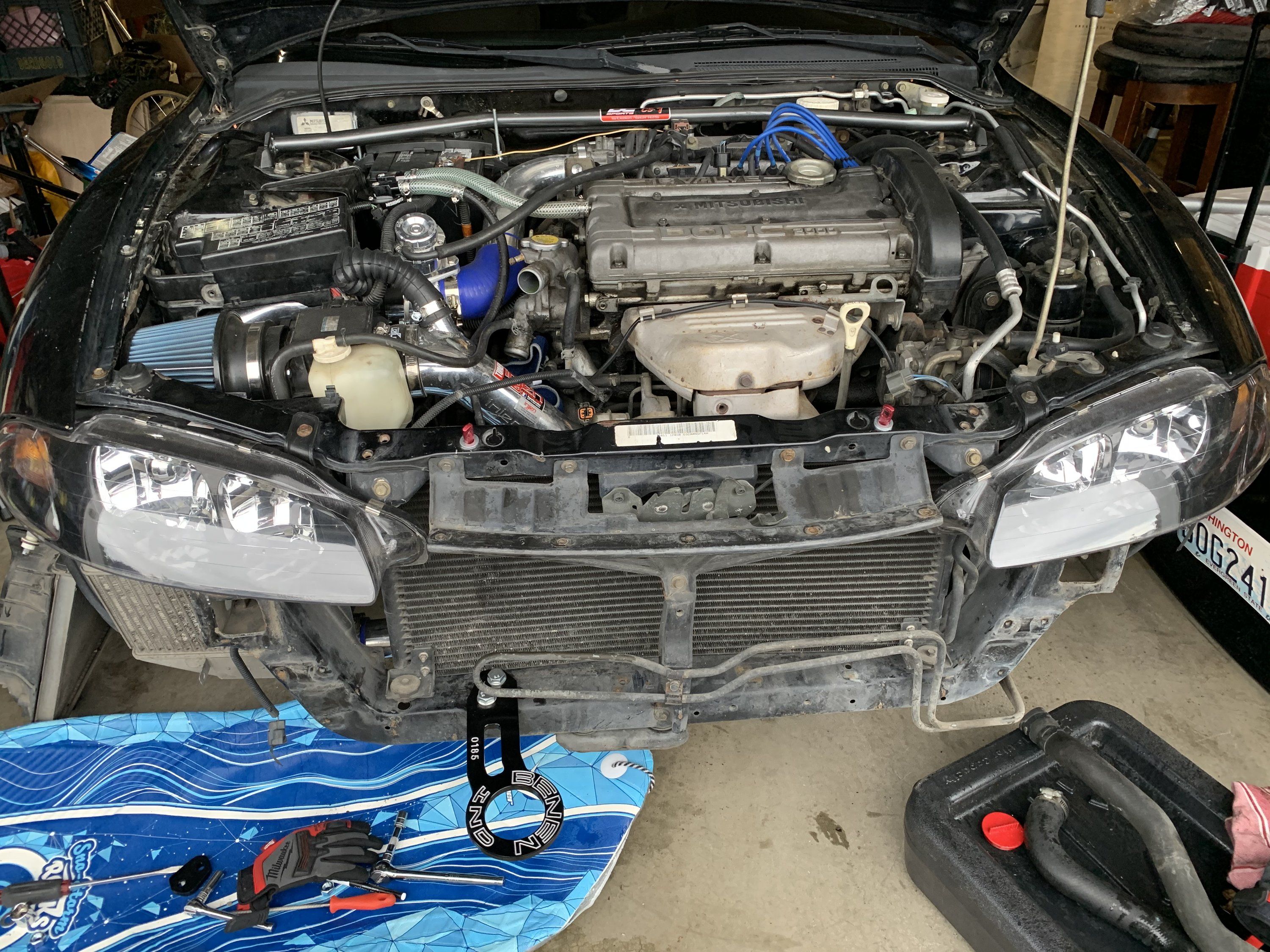

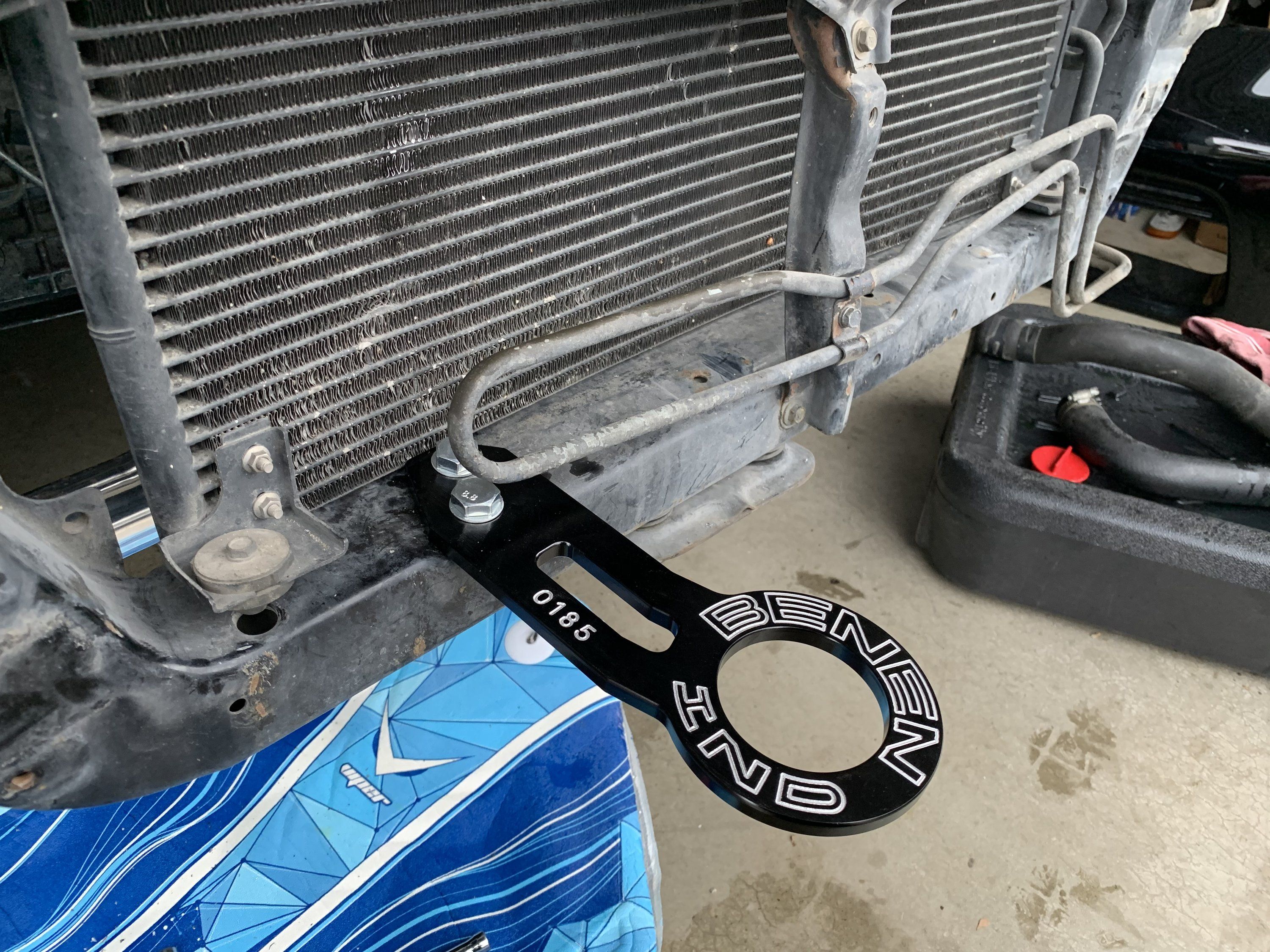

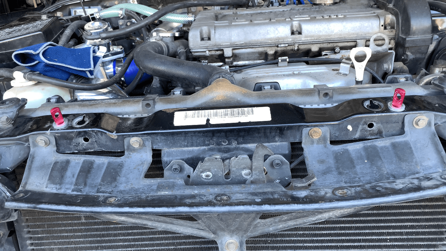

This is something I've been wanting to do for a while... put a tow hook on the Eclipse!! I've never seen a tow hook in this style on a 2G unless it is VERY modified, and I'm really proud of how it turned out! It took me a while to figure out how to do it, cuz there's no guide out there and you don't really see tow hooks on DSMs unless, again, they are very modified, but my bull crappery came through... somehow...
Anyways, this wasn't just for looks. There have been multiple times where my car has broken down, and it would've been nice to have this guy... but it is mostly for looks :D
Basically, I couldn't get the tow hook on they way I wanted it because there was NO way to put the nuts on the inside of the frame unless I wanted to cut a hole big enough to reach in there, so I drilled a couple holes that so that I could just barely screw the bolts in and IT WORKED!! It's solid, and I hope it works when the time comes LOL
Excuse the garage mess, I still live at home LOL Subtle, but functional. That's how I like it :cool: If I ever get a FMIC this will have to move somewhere else, but that isn't really in the plans for now.

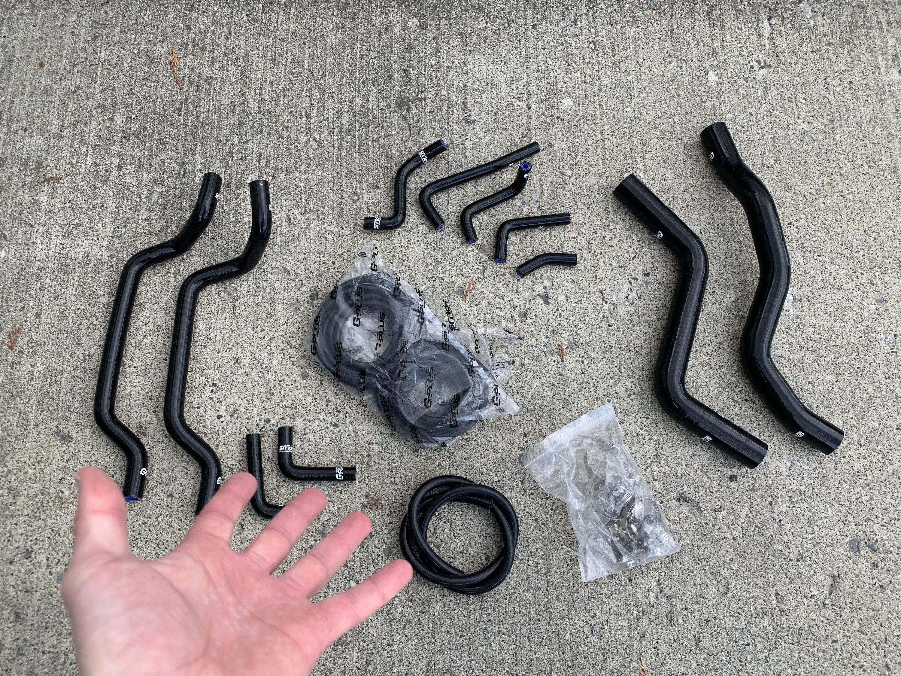

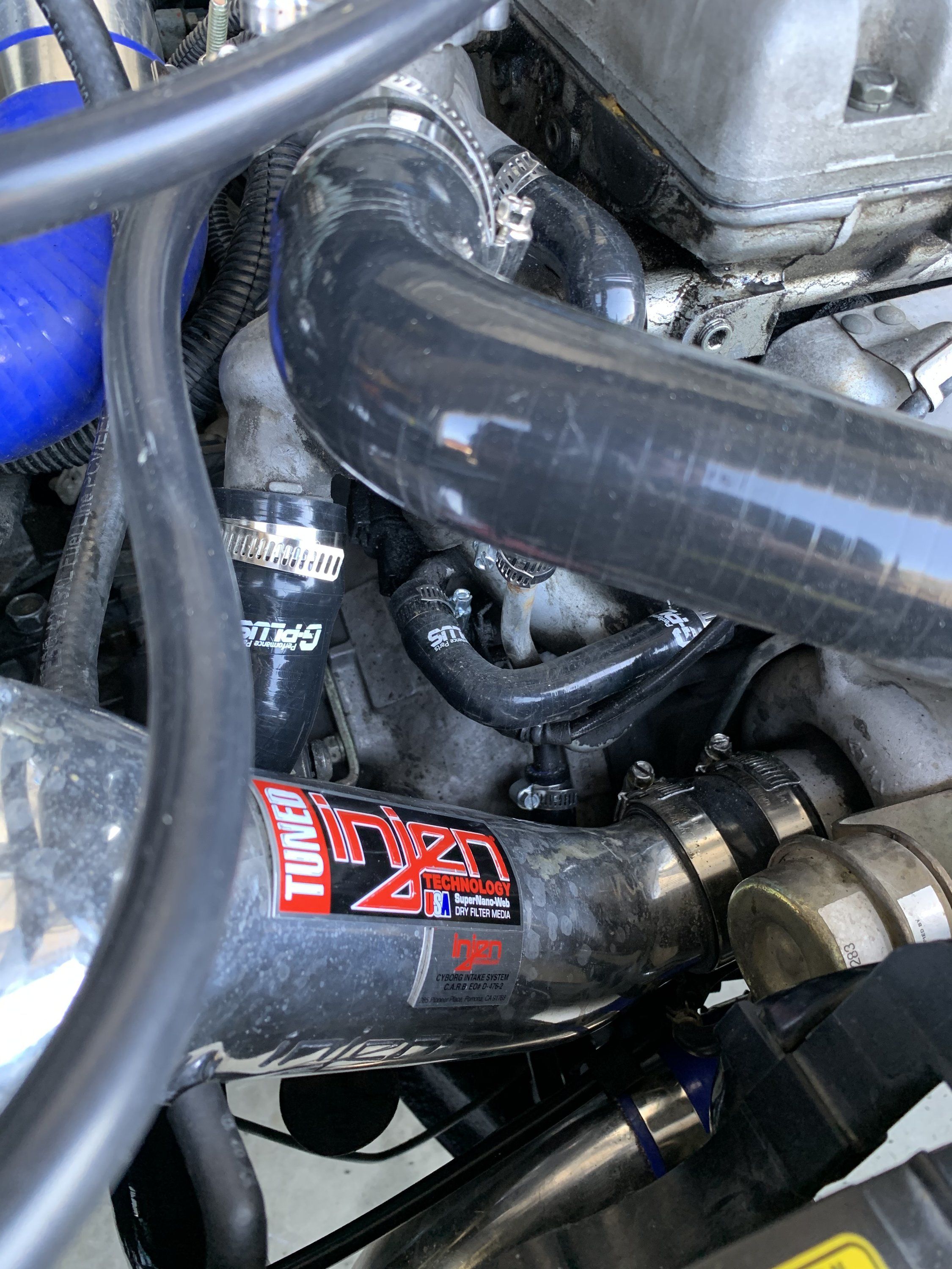

While my car was in pieces from the last project, I decided to do something that was long overdue. Yesterday I replaced all of my coolant hoses. And when I say all of them, I mean ALL of them. All 11 of them. (Well, except for the tiny elbow right next to the oil filter, that one ended up tearing because it was so hard to put on)
It was a pain, and took a solid two days, but I got all of them replaced. For those who are wondering, it was a kit off of eBay. It was not a cheap kit, and the hoses are nice, thicker than the ones that came with the car. I could've just gotten the upper and lower radiator hoses, but I wanted to replace as many rubber things on this car as I could, because from the look of things, they were the original pieces...
^ This was AFTER I sprayed it down with some WD-40 cleaner and brushed it down with a brass brush.
I'm gonna be honest, I've had this kit for a while, just never broke it out because I was genuinely intimidated by all the hoses and also wanted to find a good time to do it. I didn't even know where most of them went! But the more I dug around and replaced a couple, I'd find a couple more, so it worked out fine. After I replaced all the hoses, there were some rolled up lines that I used freely and replaced just about every vacuum line I could find. It felt really good to finally replace those nasty hoses. Won't have to worry about those going bad!
And my engine bay looks so pretty!
Almost every hose and vacuum line in the engine bay has been replaced now. I feel a lot more confident in this cars ability to be reliable, and I feel like I'm actually taking care of it rather than throwing performance mods at it LOL
The video:
Thanks for reading!!

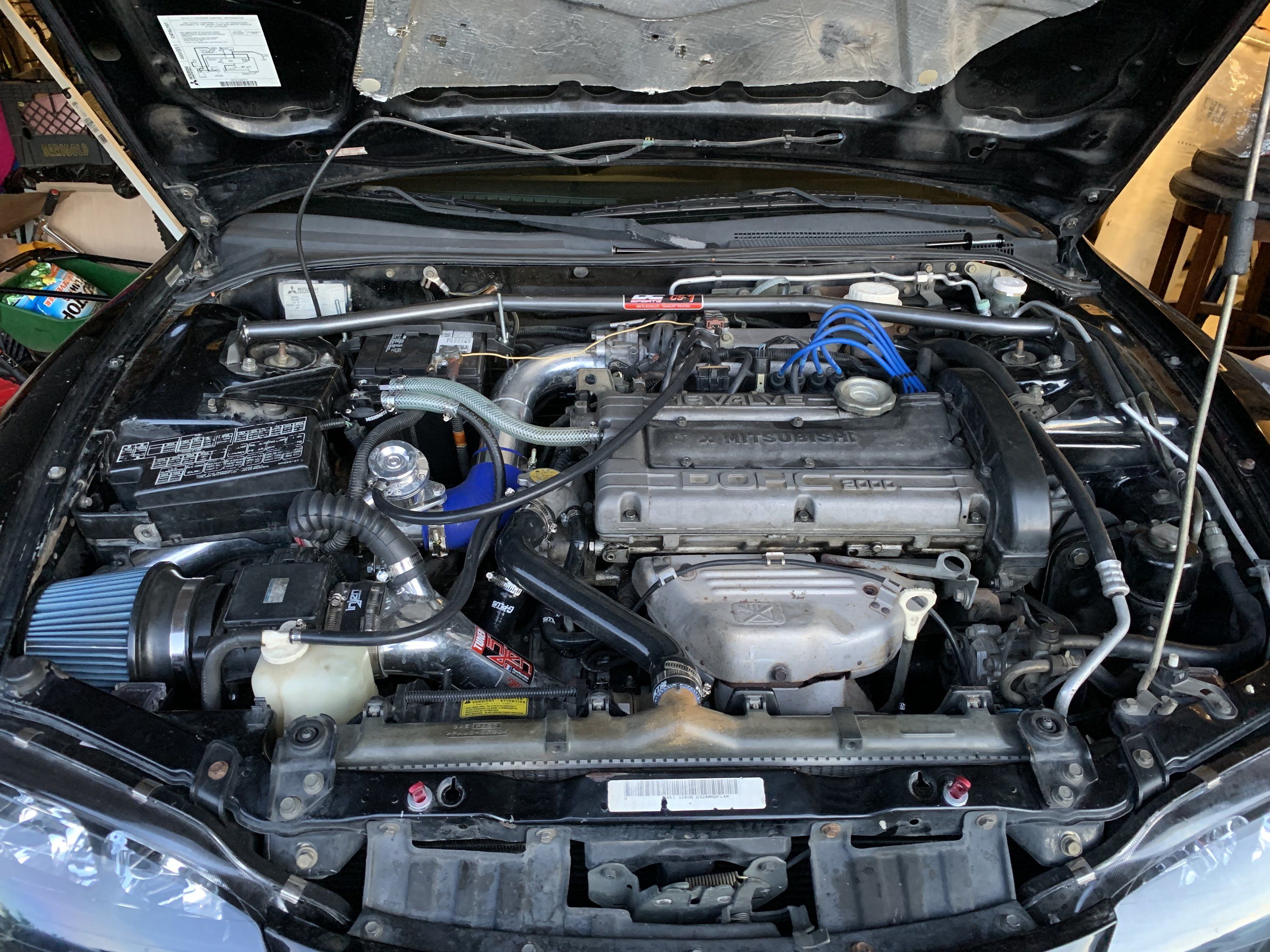

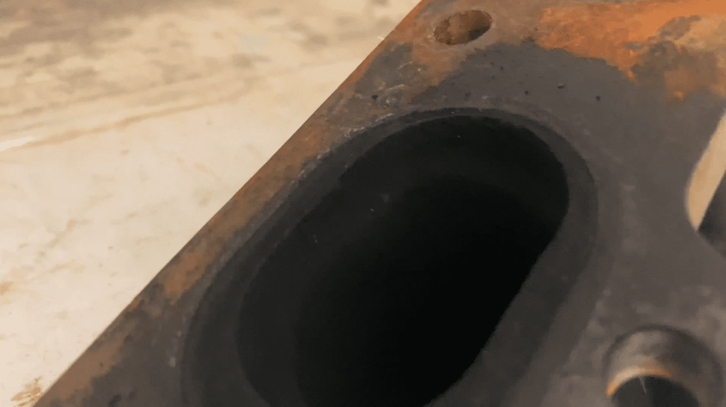

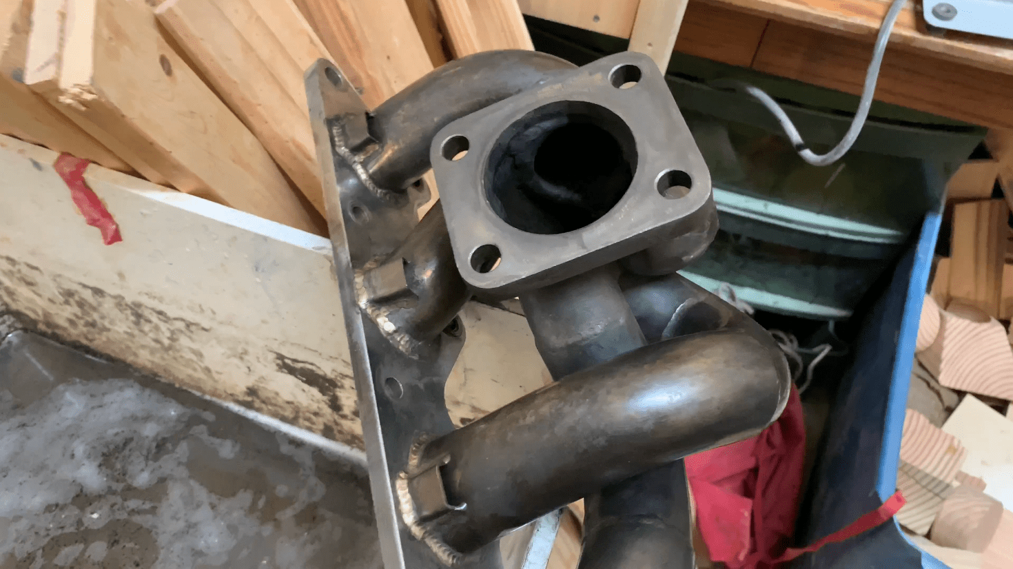

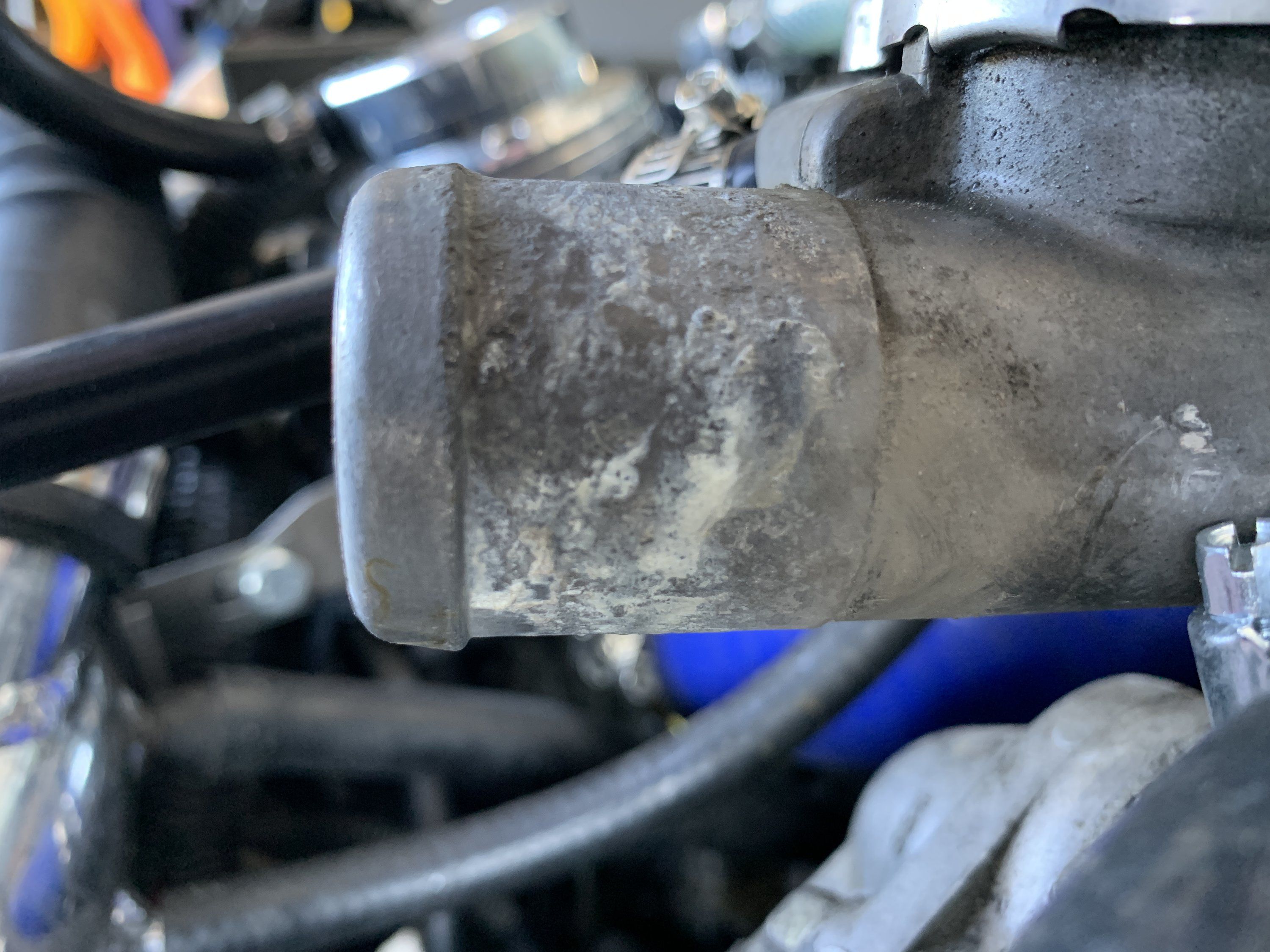

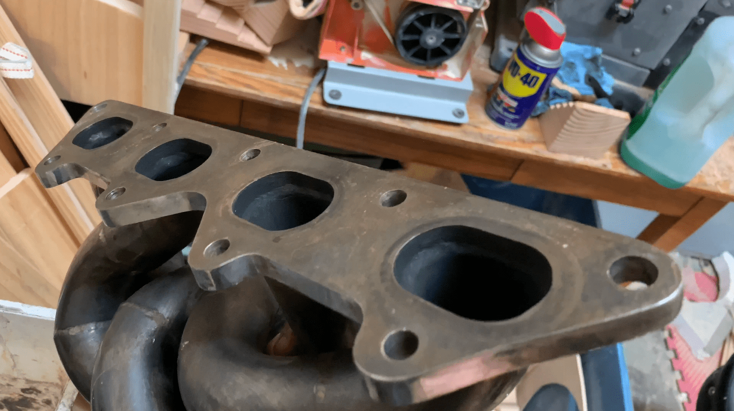

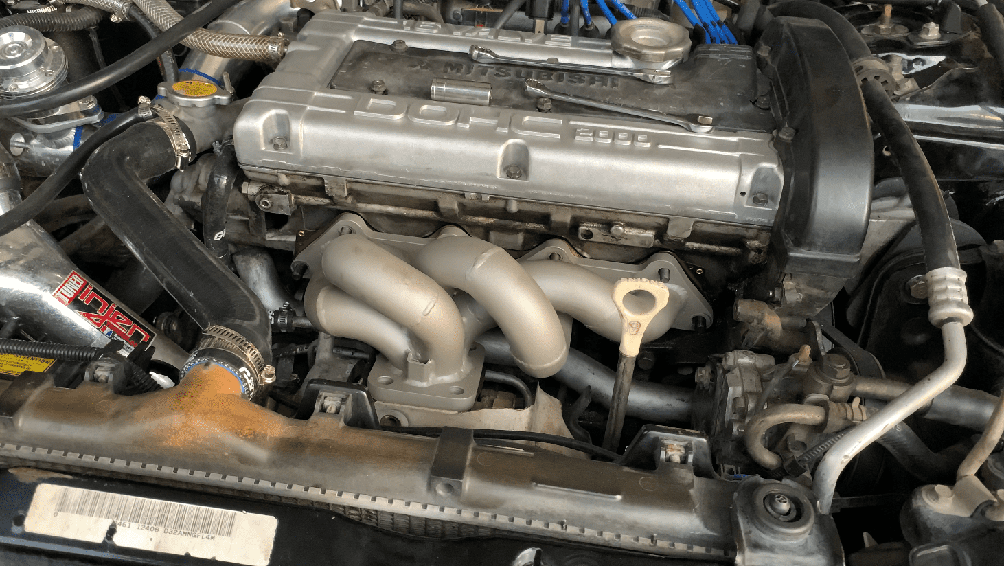

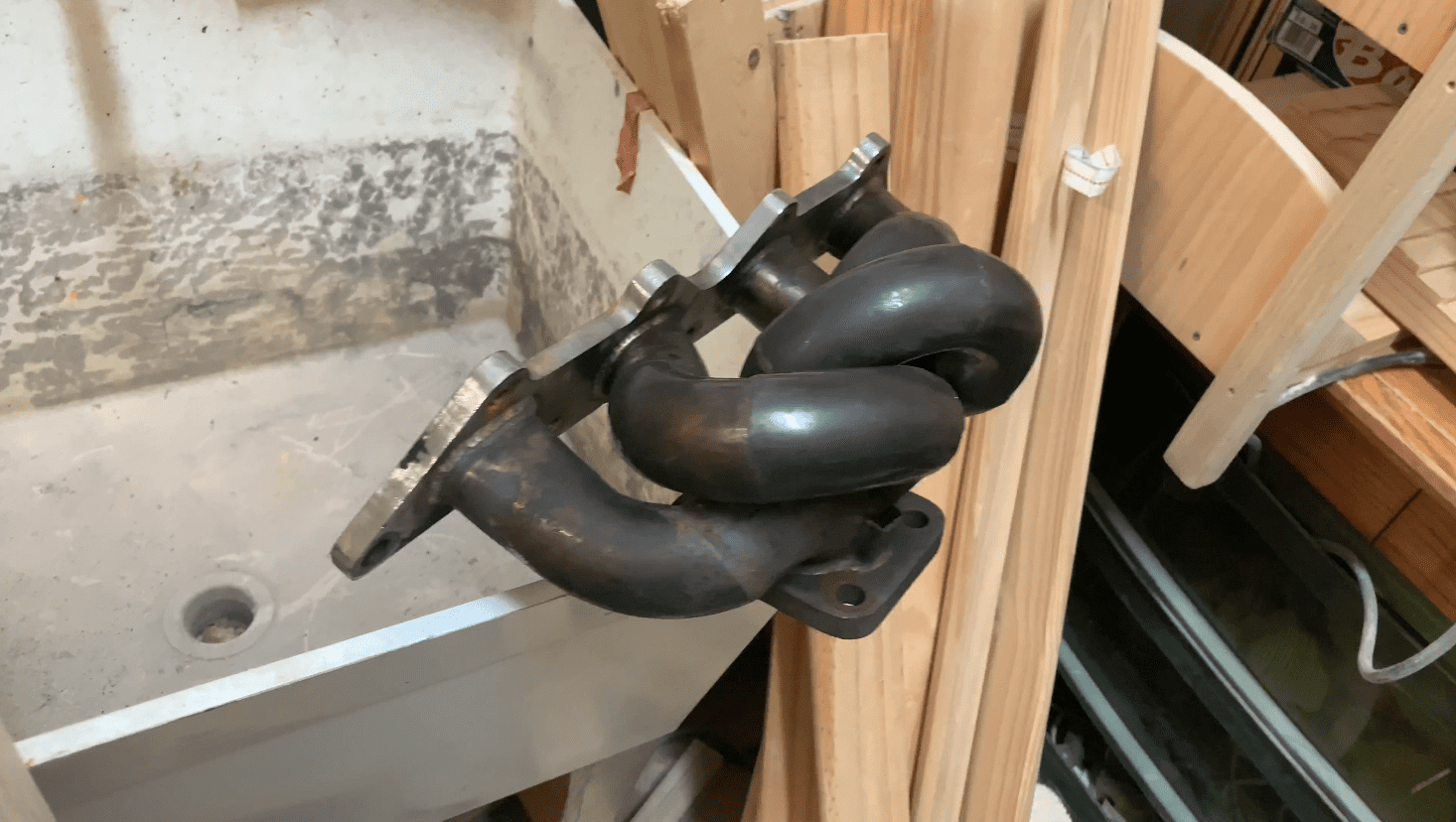

So I got a new, tubular (tubular dude!!) exhaust manifold for my car. Not sure what brand it is, all I know is that it is very used, works with the T25 and 16G, and was $40! I actually got it from a user on this site! Anyways, I decided to take my very rudimentary skillz and try my best to clean it up.
The before photos:
Like I said, I don't really know what I'm doing, but I used some WD40, a grease cutting soap, and a brass brush, and I cleaned the carbon out of it! (literally) But I'm not really sure how clean it's supposed to be, what it's supposed to look like, etc. So I'm going to take it to a shop and see what they say, see if they can get all the garbage out of the inside. Then I need to test it for leaks. Still don't totally trust this manifold, it being $40 and all, but hey, maybe the guy just wanted to get rid of it.
Here are the after photos:
I have to say, it looks WAY better, and the mounting faces are nice and smooth. But we'll see if it'll be worth putting on my car.

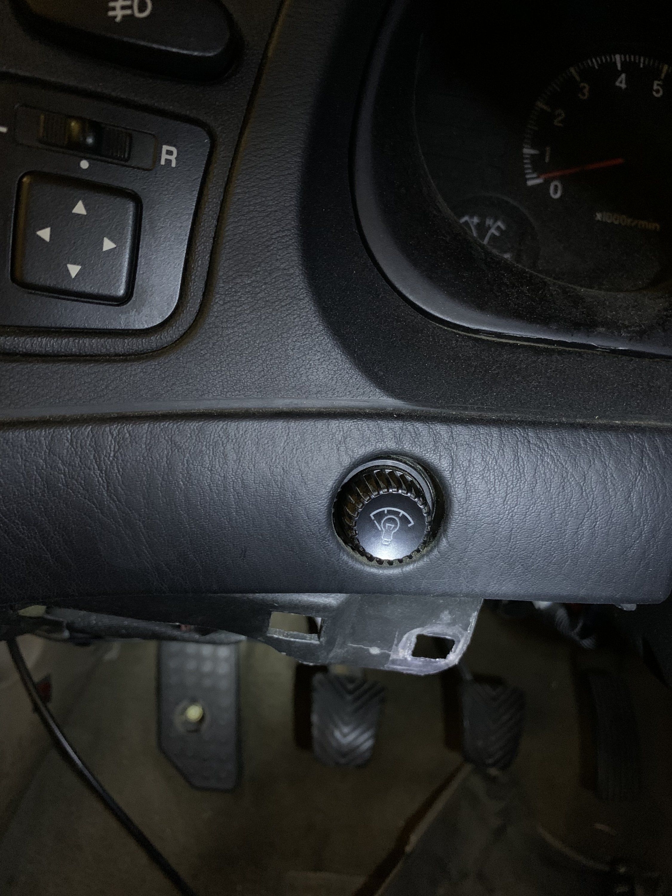

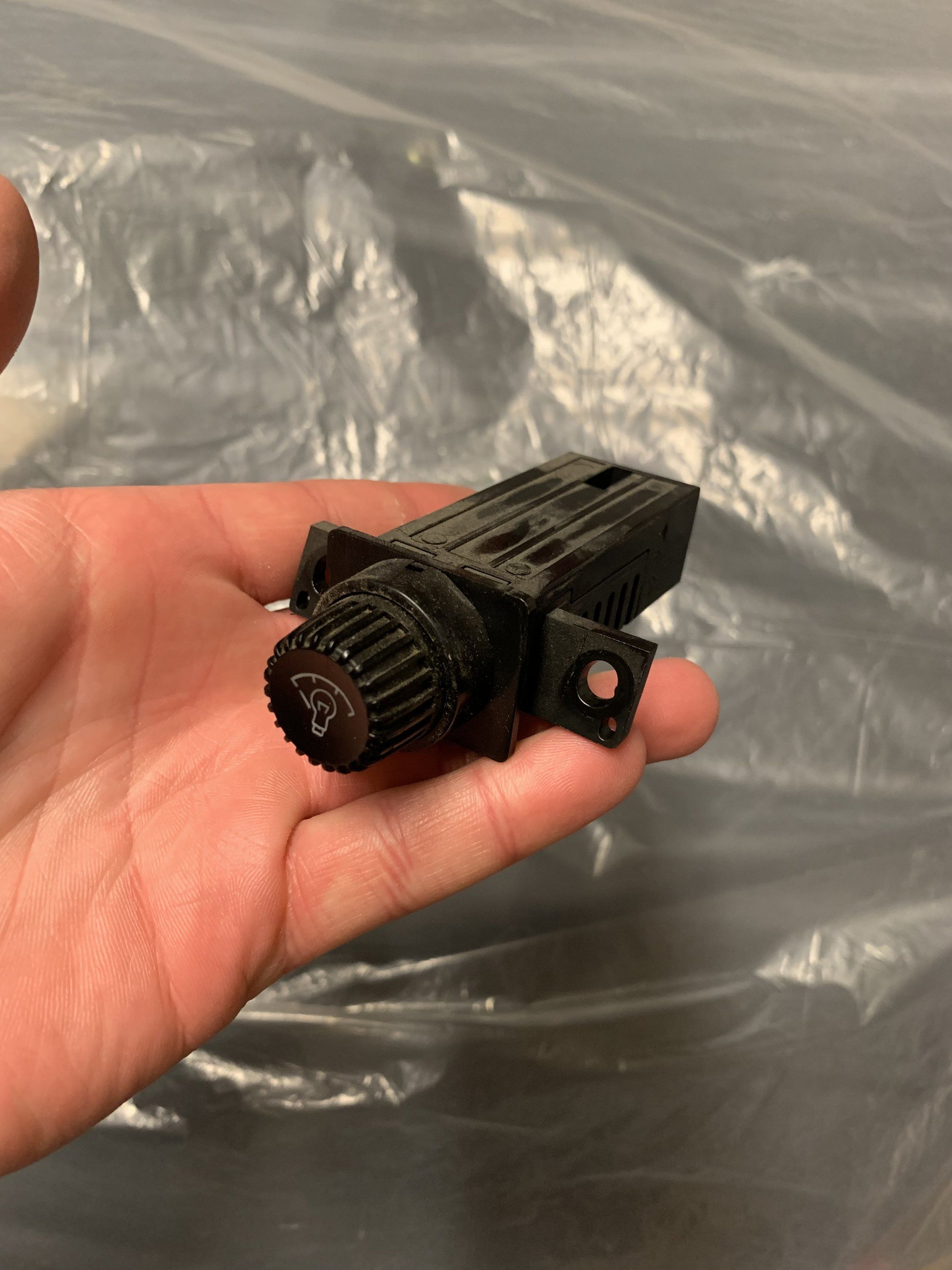

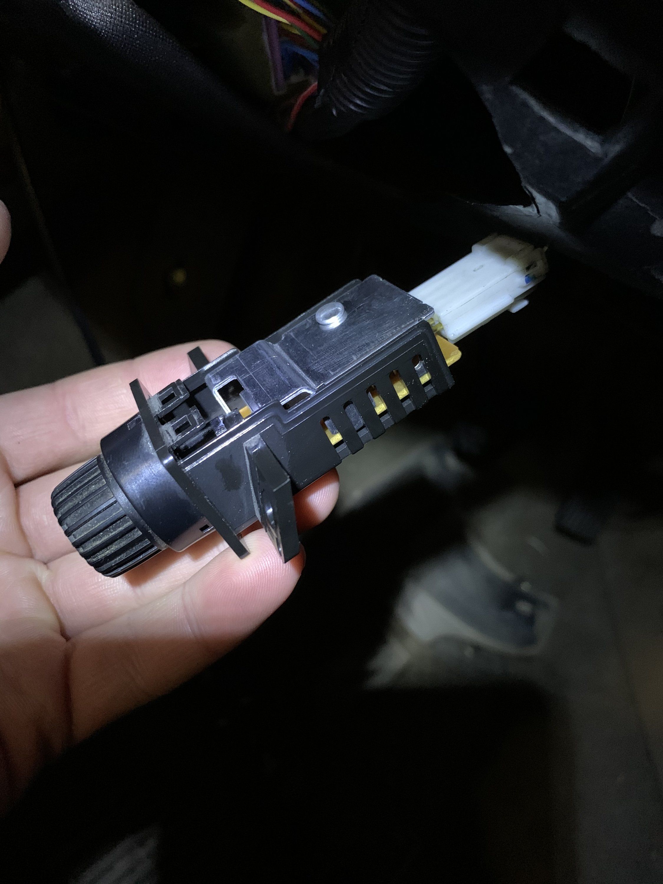

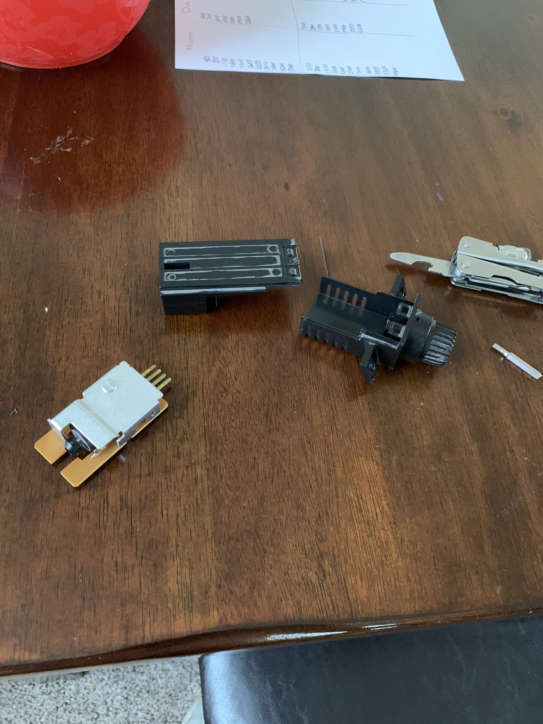

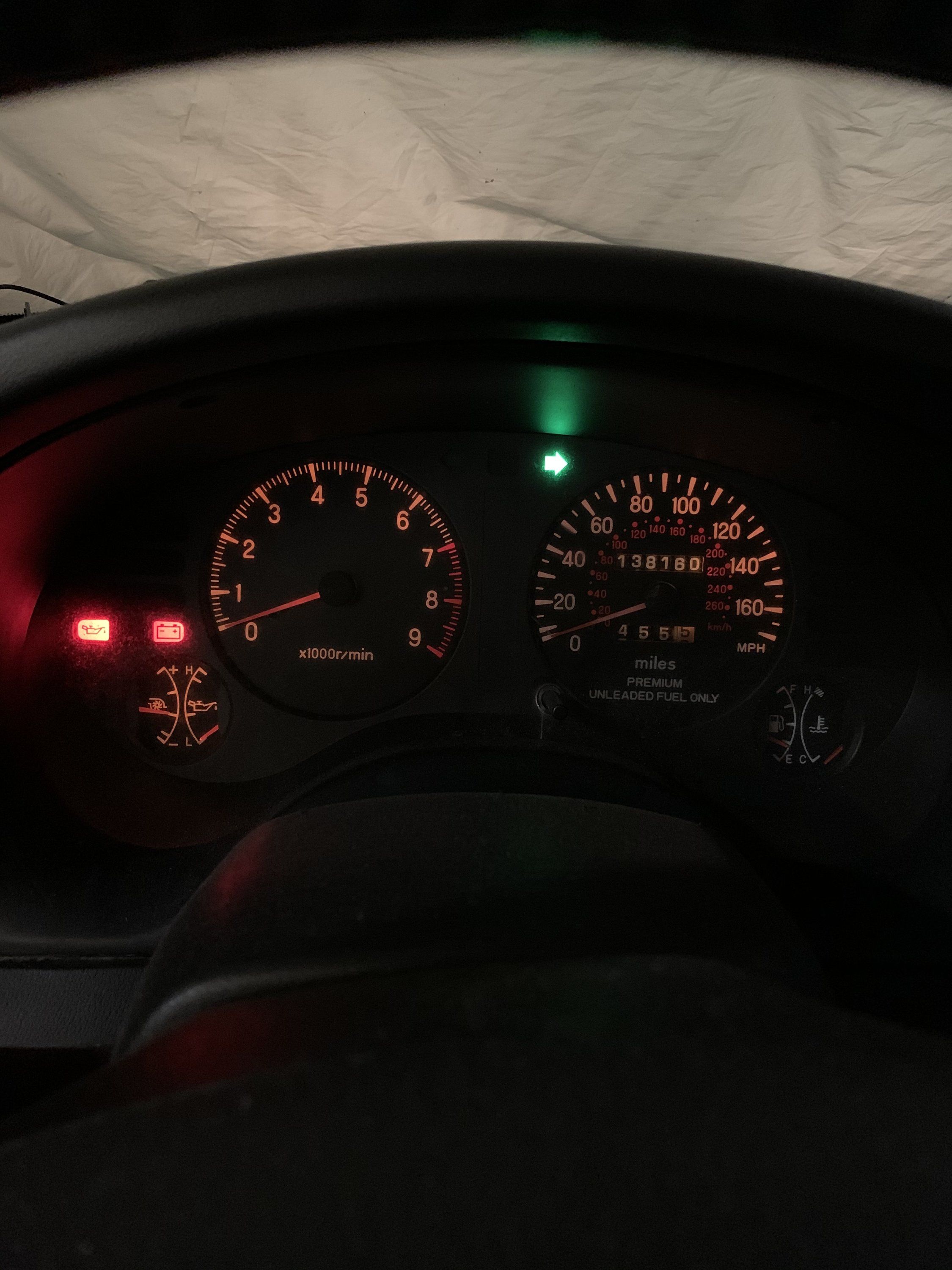

Today I did something that I've been trying to figure out for a while. I finally got my gauge lights to work!! This was a weird one...
So I started by disconnecting the dimmer switch, and then I took a multi meter to see if the switch was getting power. Yup, it was. Both through the power and remote wires... so it had to be the switch itself, so I took it apart.
It looked like nothing was wrong with the switch itself... so I decided to hook it up without the box on it, just the circuit board you see on the far left in the picture above. Weird thing is, the dash lights lit right up!! I couldn't get them to flicker or act abnormally in any way either, so I thought "okay, so lets just put it back together." NOPE. As soon as I had reassembled the whole unit, it wouldn't work. So I made a makeshift 'shelf' with just the lower piece of the box, plugged it in, and I now have functional dash lights!!
^ The "Shelf"; I kept the top piece off.
^ Looks normal. No modification here ;)
^ Viola!!!
Sometimes I don't get these cars... XD

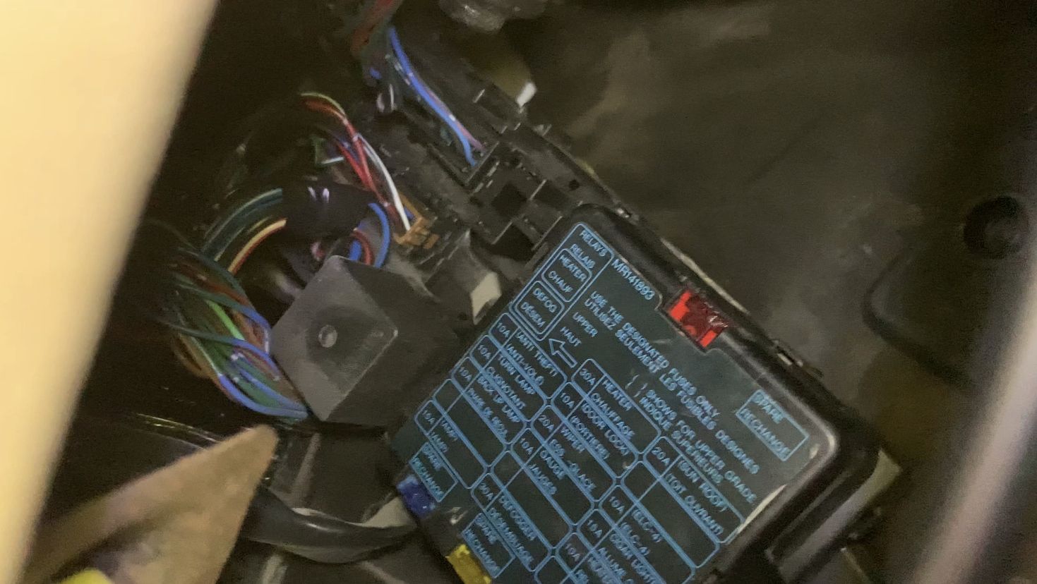

I fixed my A/C today... literally was missing the relay for the heater... me not so smart LOL
Not really sure how it happened... but it did. At least it was an easy fix.

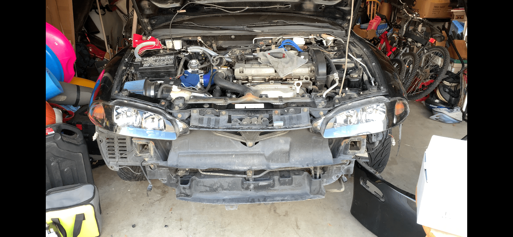

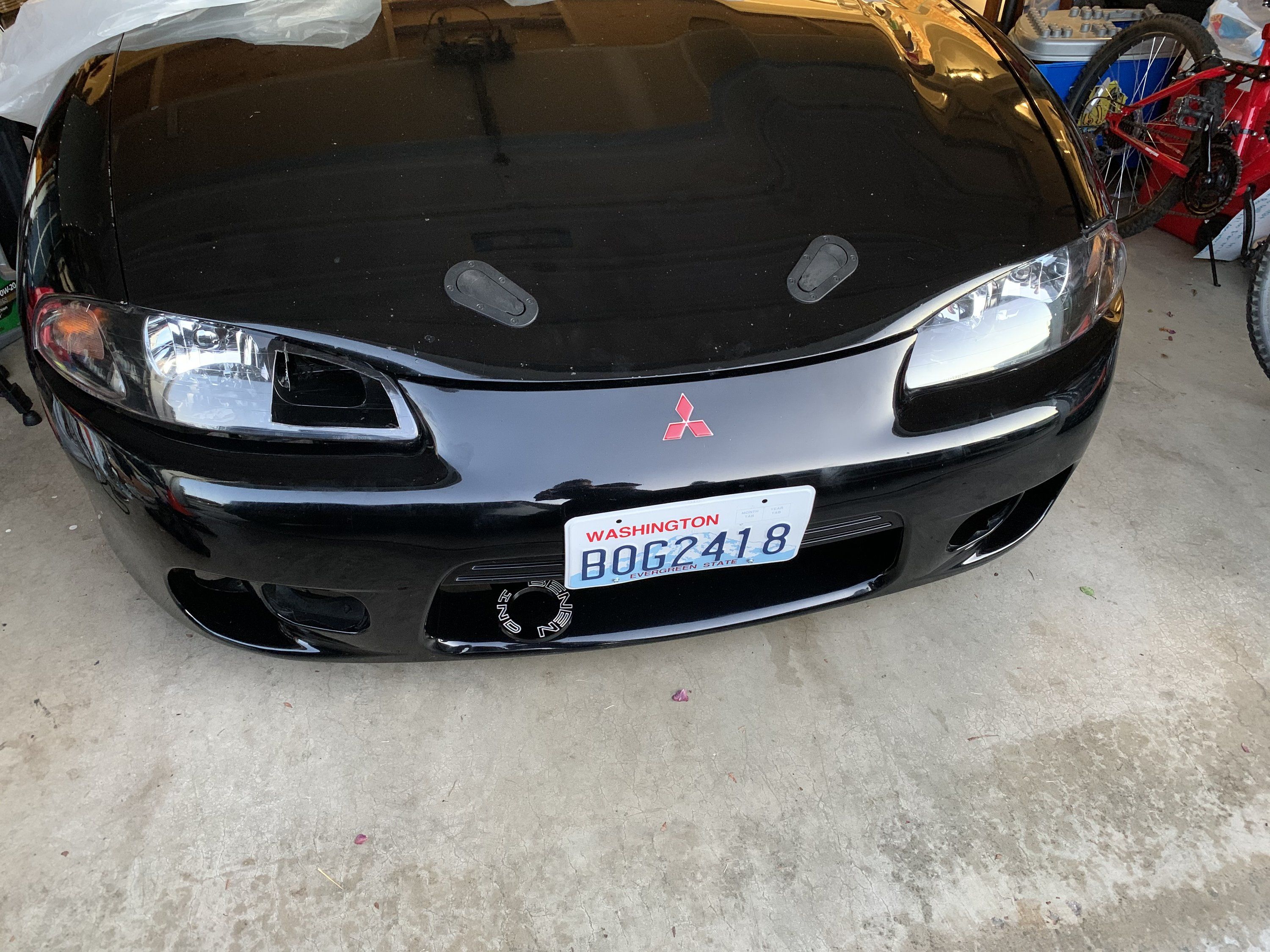

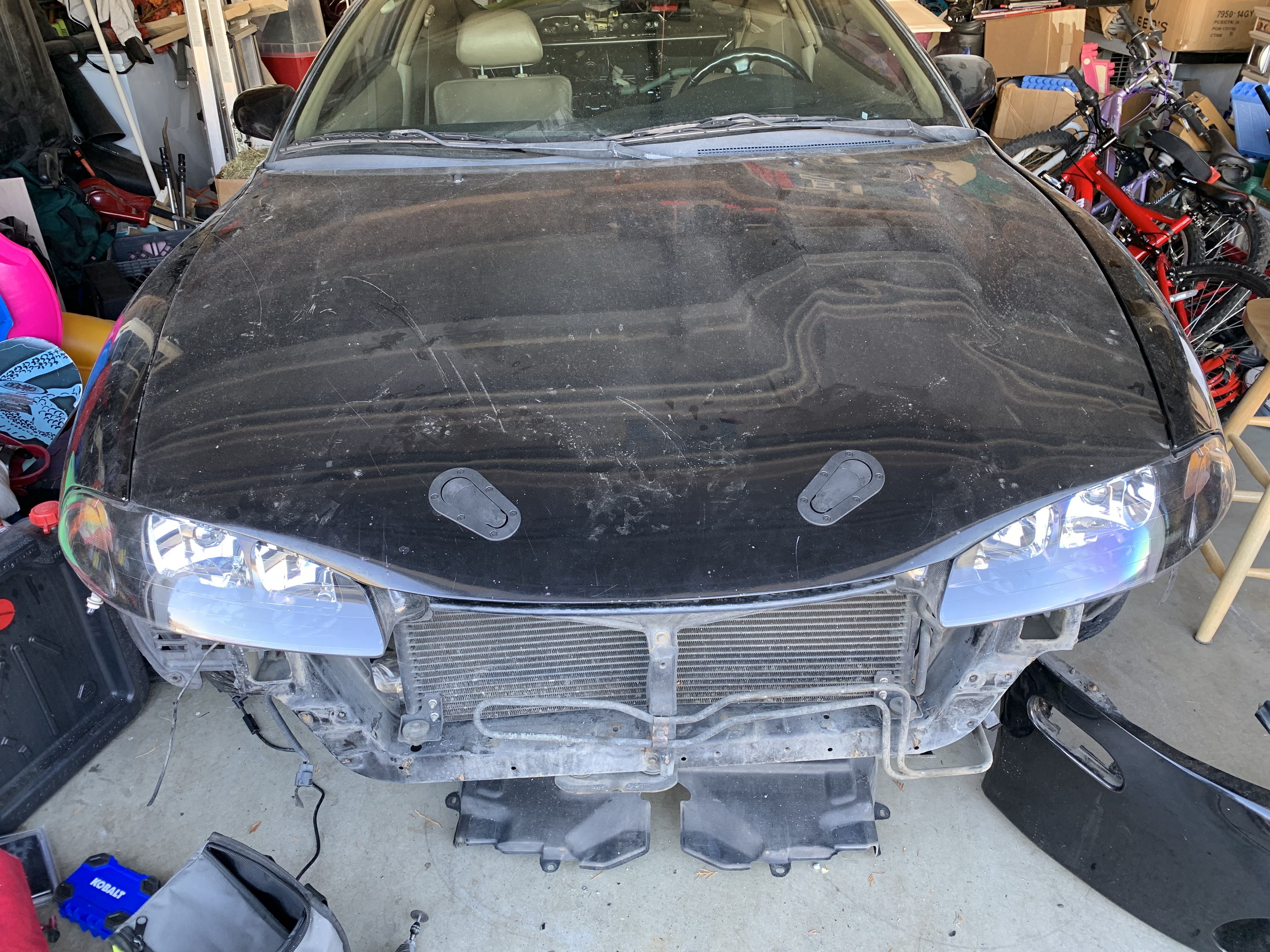

I've done a couple things in the last week and a half. First things first, I removed the stock exhaust manifold so that I can put the new one in. I'm so pumped! I've decided to get it ceramic coated and then I'm going to make a custom heat shield, and that should be enough to keep the heat around the manifold and not in the rest of the bay... but I still wish that my intake had more room to breath...

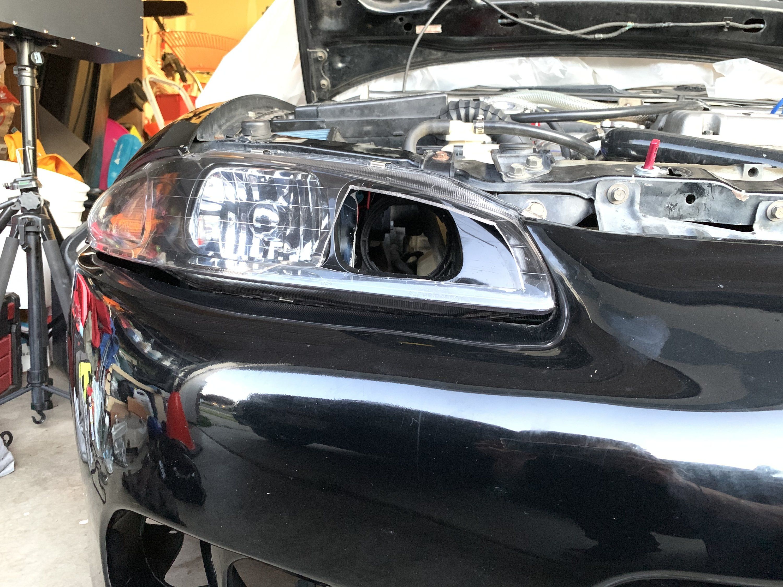

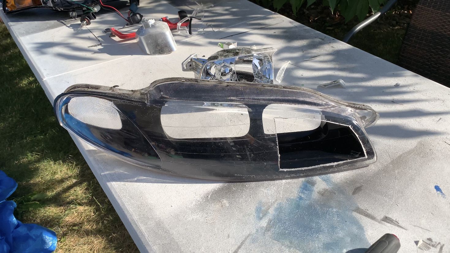

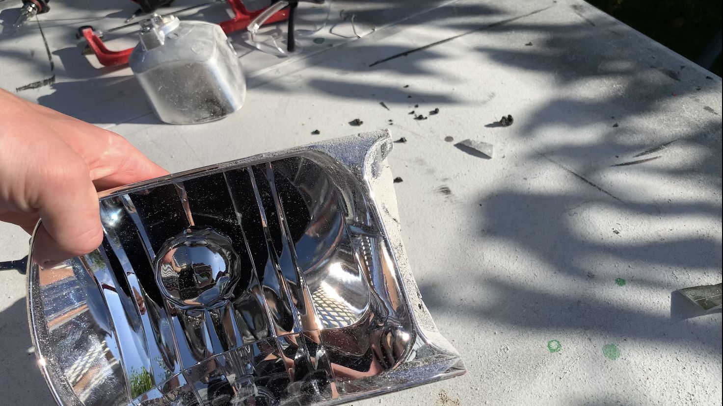

... so I gave it some! Last Tuesday I took the headlight out, took it apart, cut off half of the chrome part, cut a whole in the lens, and then put it back together and viola! Headlight intake port.
Before:
After:
I don't think it looks that, well, aesthetically pleasing. I will be getting a fiberglass cowl from carbonetics eventually, which will help it look better, but I personally don't think it looks very 'cool', I just did this because I HATE how suffocated the air filter seems. So this'll help my car breath a bit easier, and help me breath a bit easier too LOL

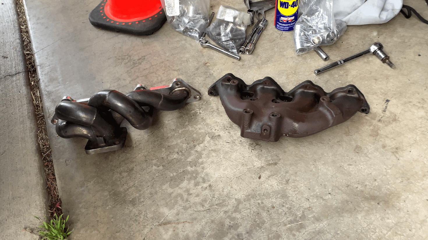

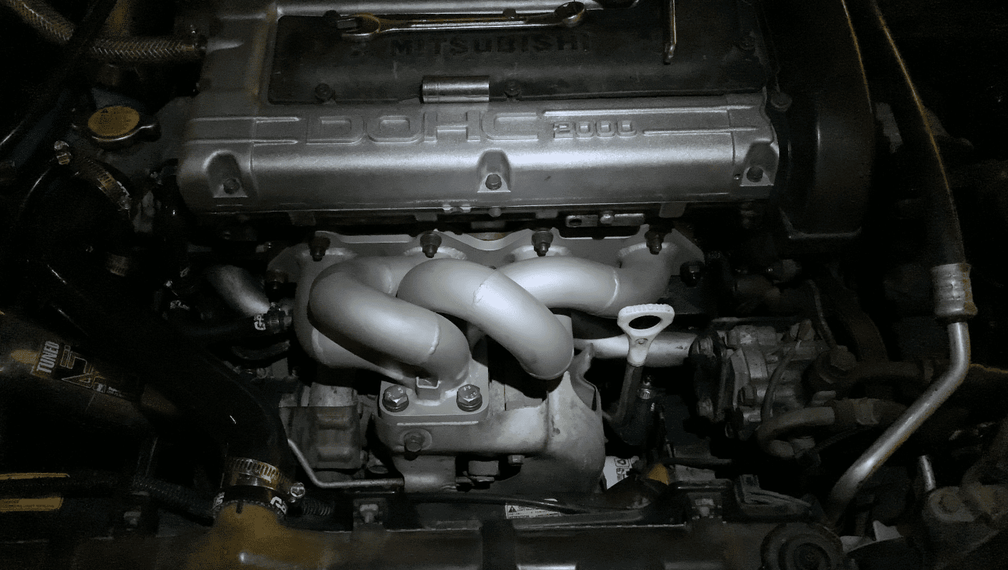

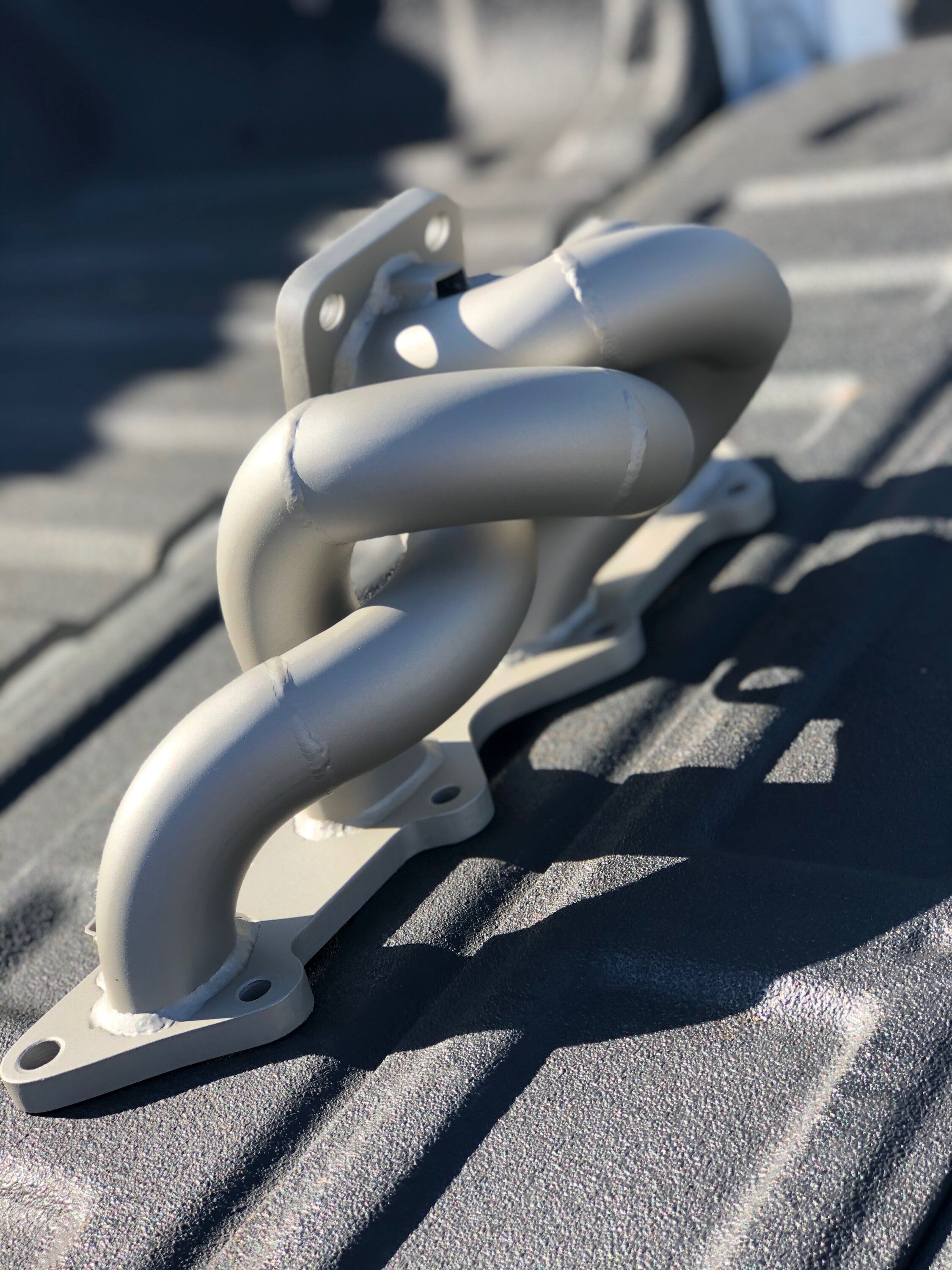

Yesterday I finished a project that has been in the works for a while now.
I got an old exhaust manifold about a month ago from a user here, and I cleaned it up, removed the old manifold, and was about to install the new manifold. However, I decided to get some sort of heat protection for the header first before I install it, I want to do this the right way ya know? So I had to put the old manifold back on so that I could drive the Eclipse to work since my Mazda was going into the dealership for a recall and some body work from an accident. While installing the old manifold however, I broke two studs.
^ I have no idea what brand this header is... but I'ts got to be an improvement over stock, right?
^ Definition of PAIN
Fast forward a couple weeks and I've got two new studs, and a BEAUTIFUL, freshly ceramic coated exhaust manifold ready to be bolted on!

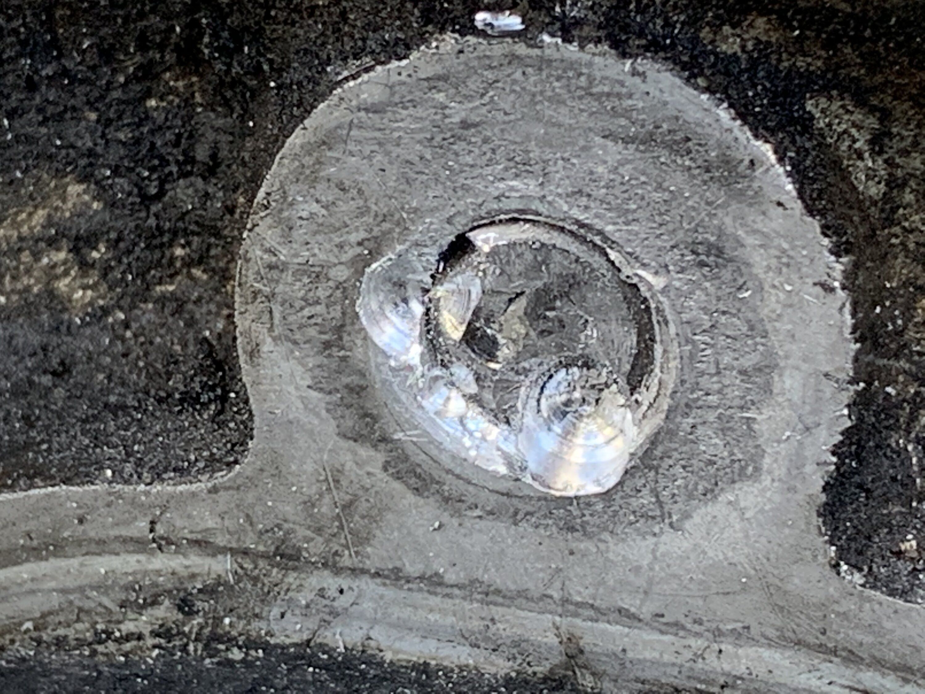

The first stud took about 4 and a half hours to get out since my stud extractor bit broke off inside the stud, but the next day I was able to get the second stud out within about a half hour (you learn quick with these cars LOL). Got the new manifold on WITHOUT breaking any new studs *hallelujah* and then bolted it to the turbo... just got to find a way to torque these suckers down because I can't seem to be able to get a socket onto them...
^ On but not bolted down
^ On and bolted down
