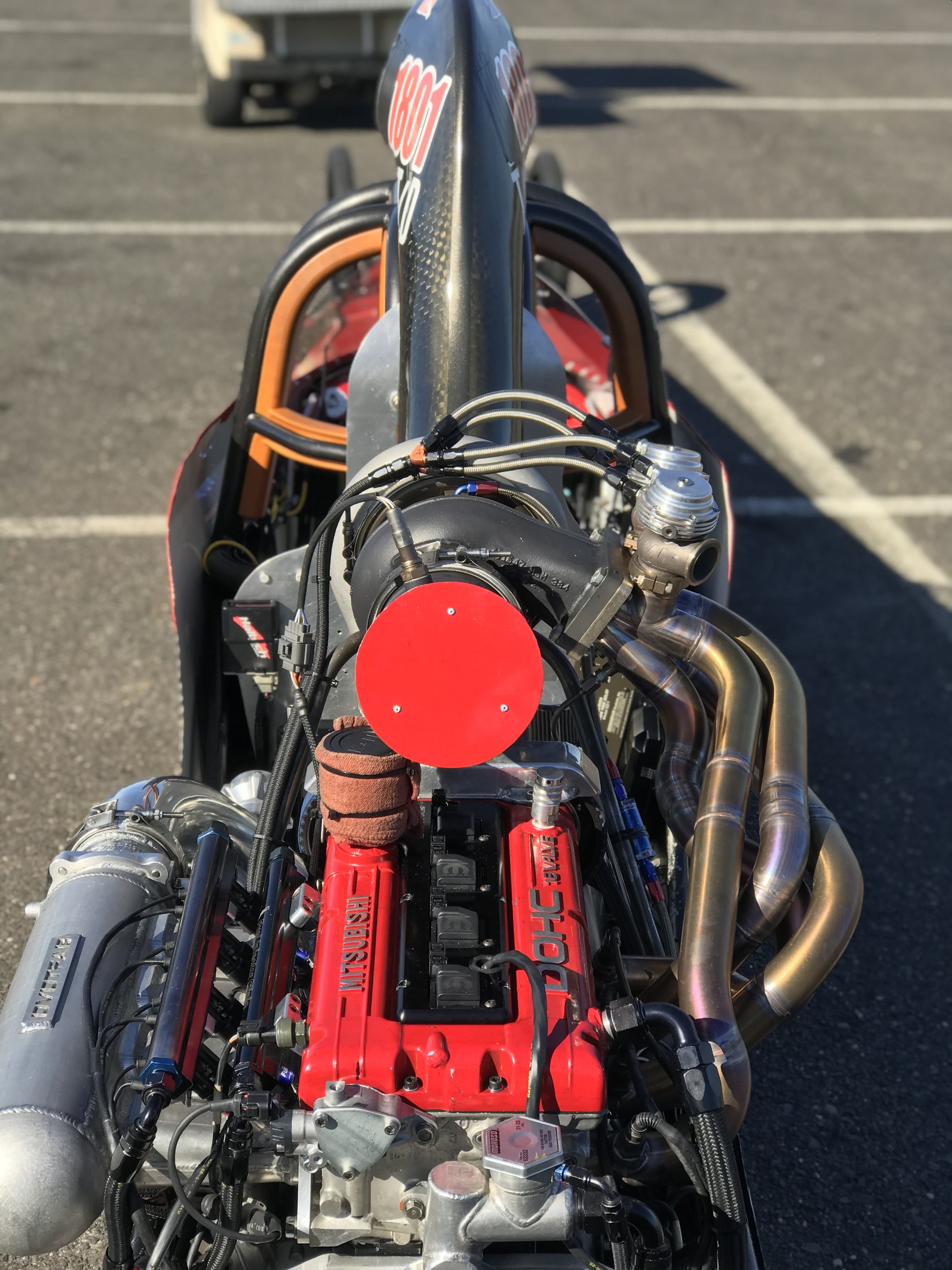

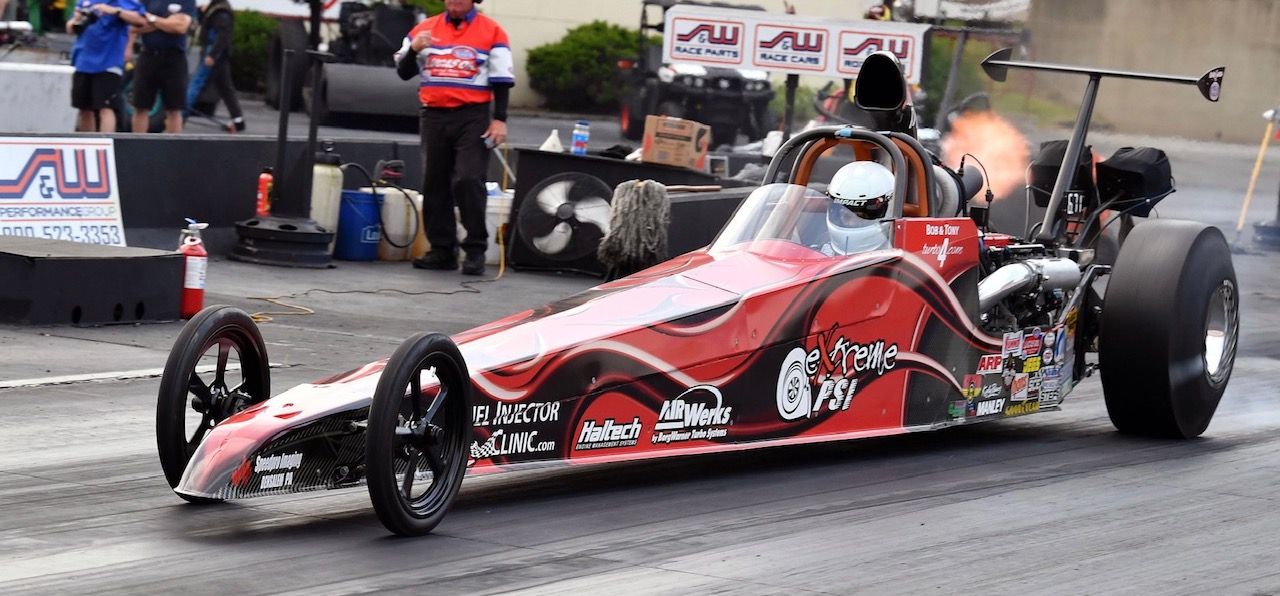

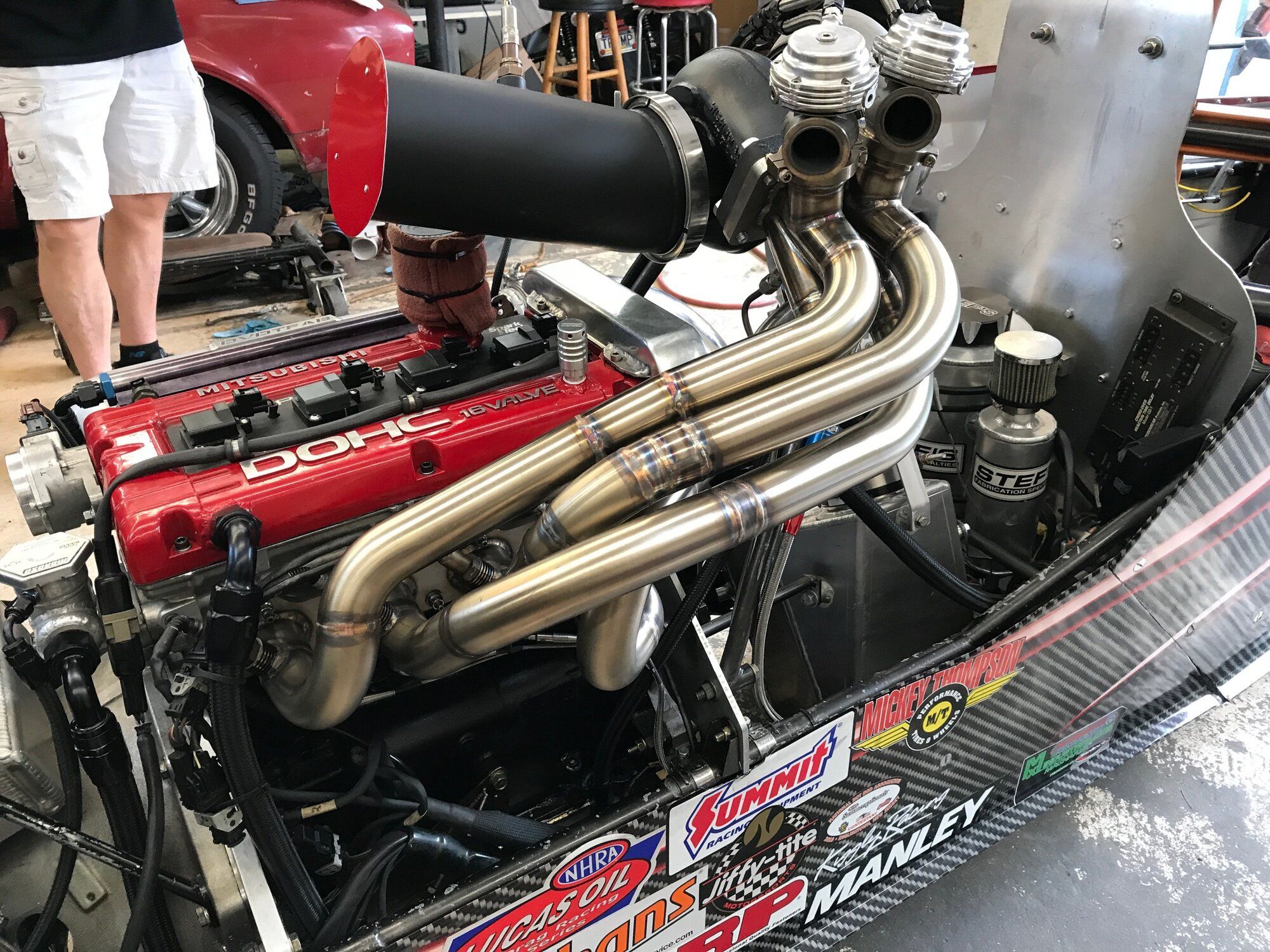

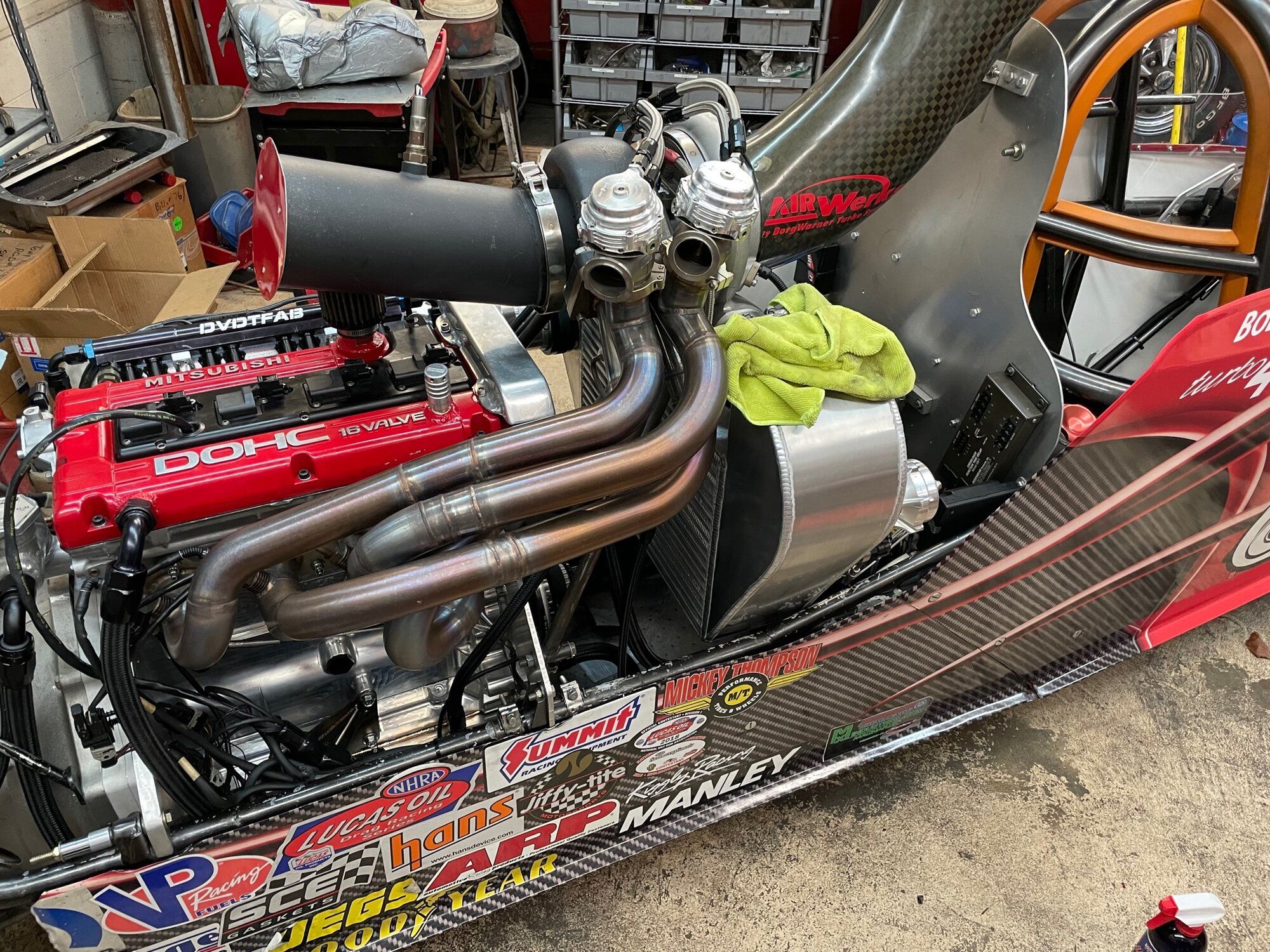

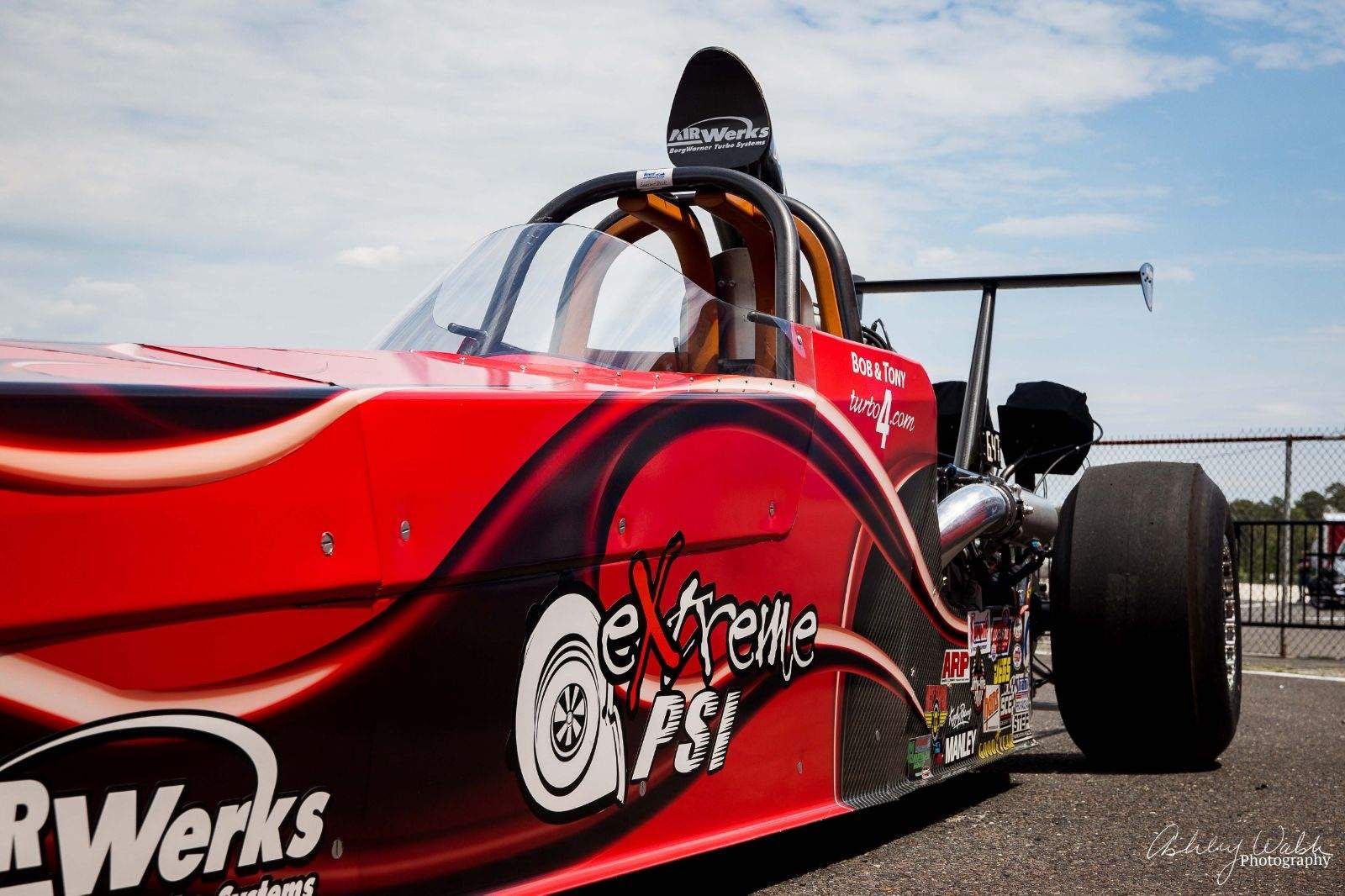

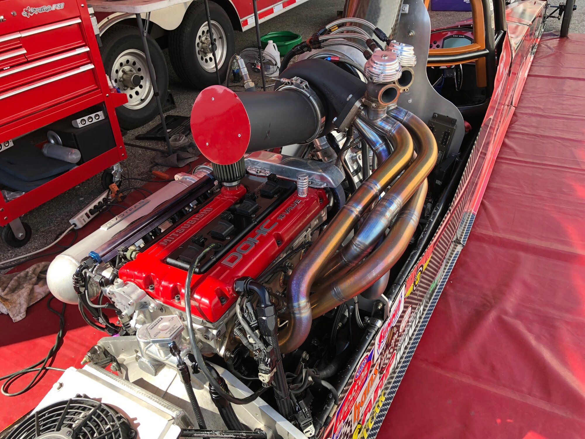

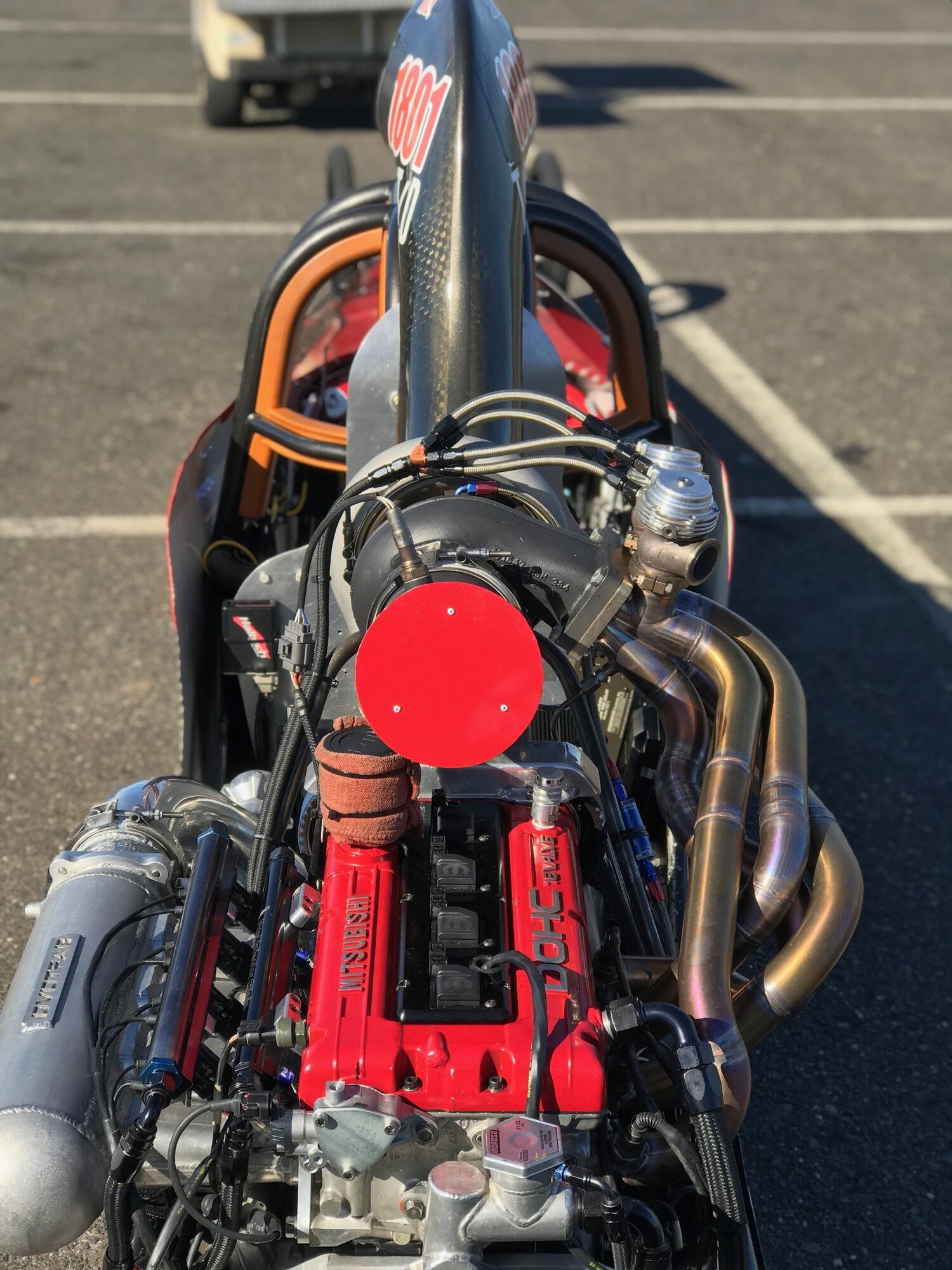

I think it's time to add some info on our 4G63 dragster here. We built this car back in 2008 and have been racing it ever since. This car is owned by my father and me and we do virtually everything on the car. We bought the car as a bare chassis custom built for us from Ken's Kustom Chassis setup for a 4G63. Since then it's been through many configurations but the general formula has been the same. It's always been a 2.0L 6 Bolt 4G63 with a 2 speed powerglide. A 76-80mm turbo, methanol and no nitrous.

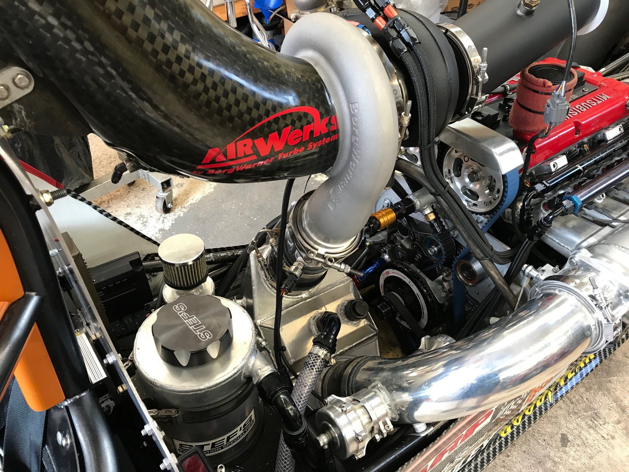

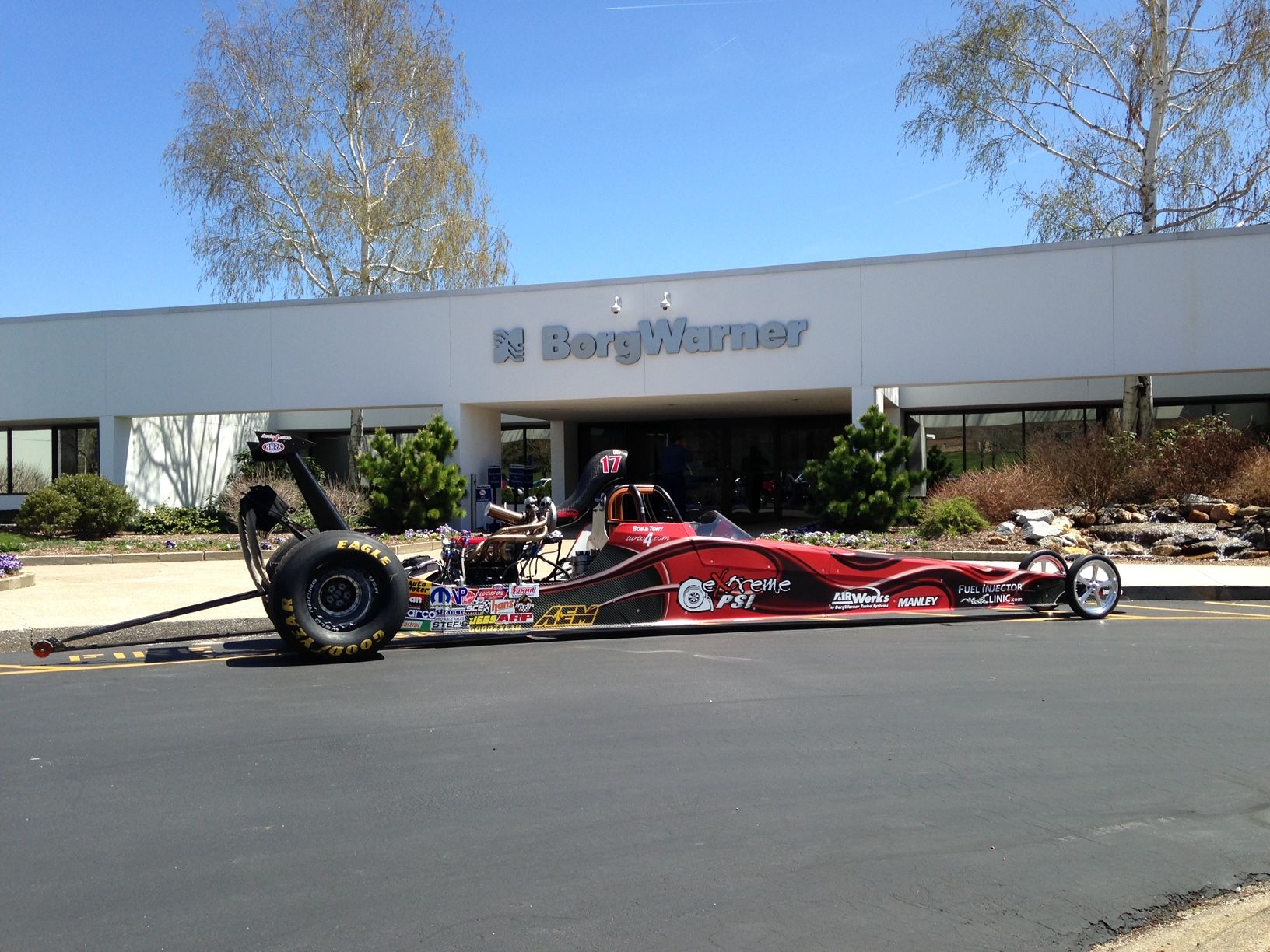

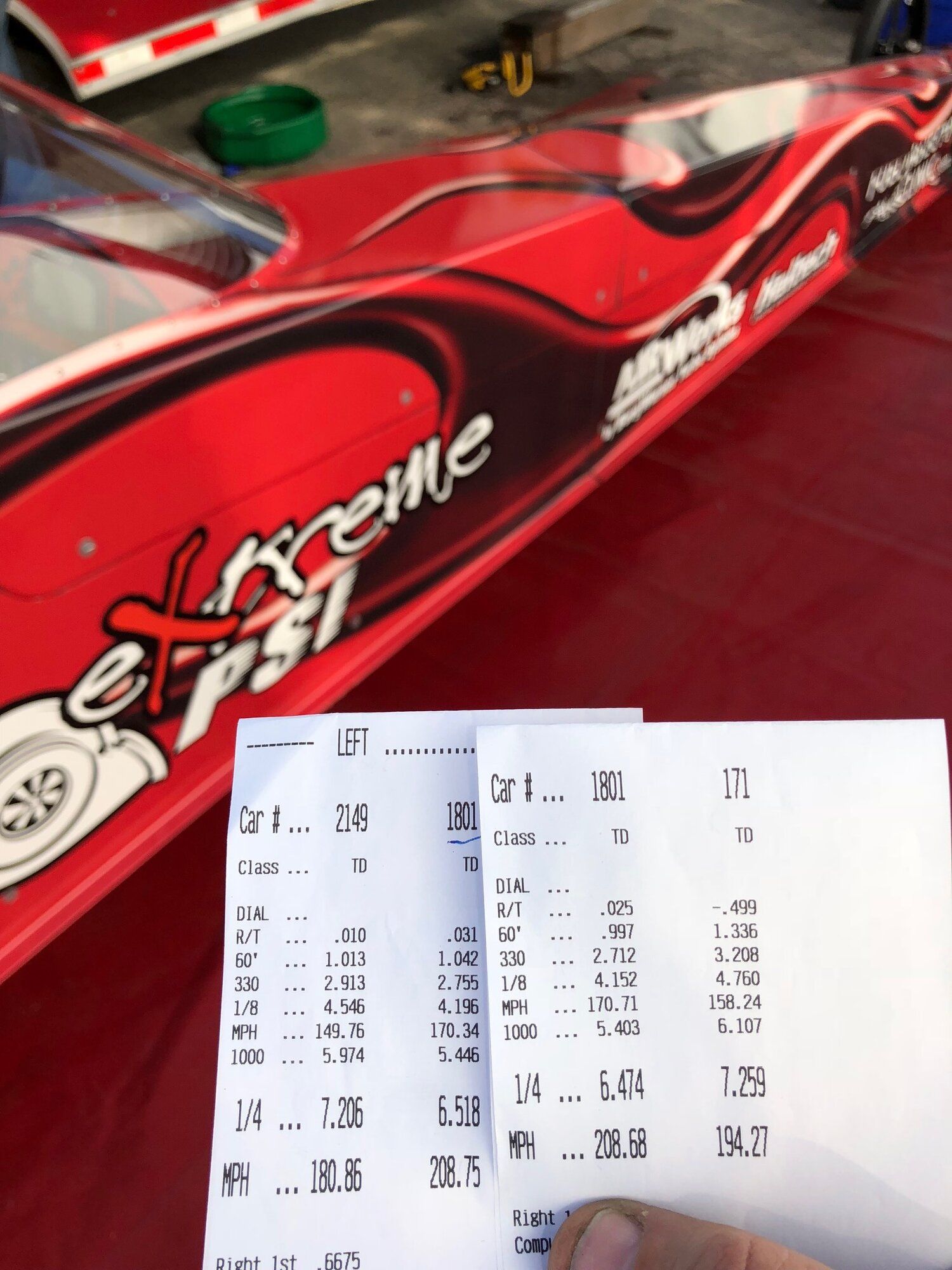

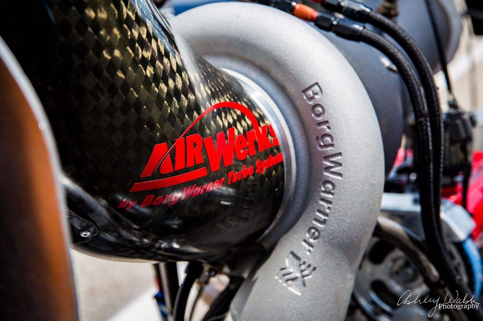

When we started on this adventure, our goal was a 6.80 at 200 mph. At the last event of our first season (2009), we went a 7.30 (I forget the MPH, I think about 185). With the turbo limits we had, getting down to a 6.80 seemed incredibly difficult at that time. I met some folks from BorgWarner and they offered to send me their 76mm turbo and told me if it didn't make more power and go faster, then I can send it back, if it does go faster, just continue to run it. It was a no-lose situation. Their turbo made gobs more power and we were able to get the car into the 6's and never really looked back.

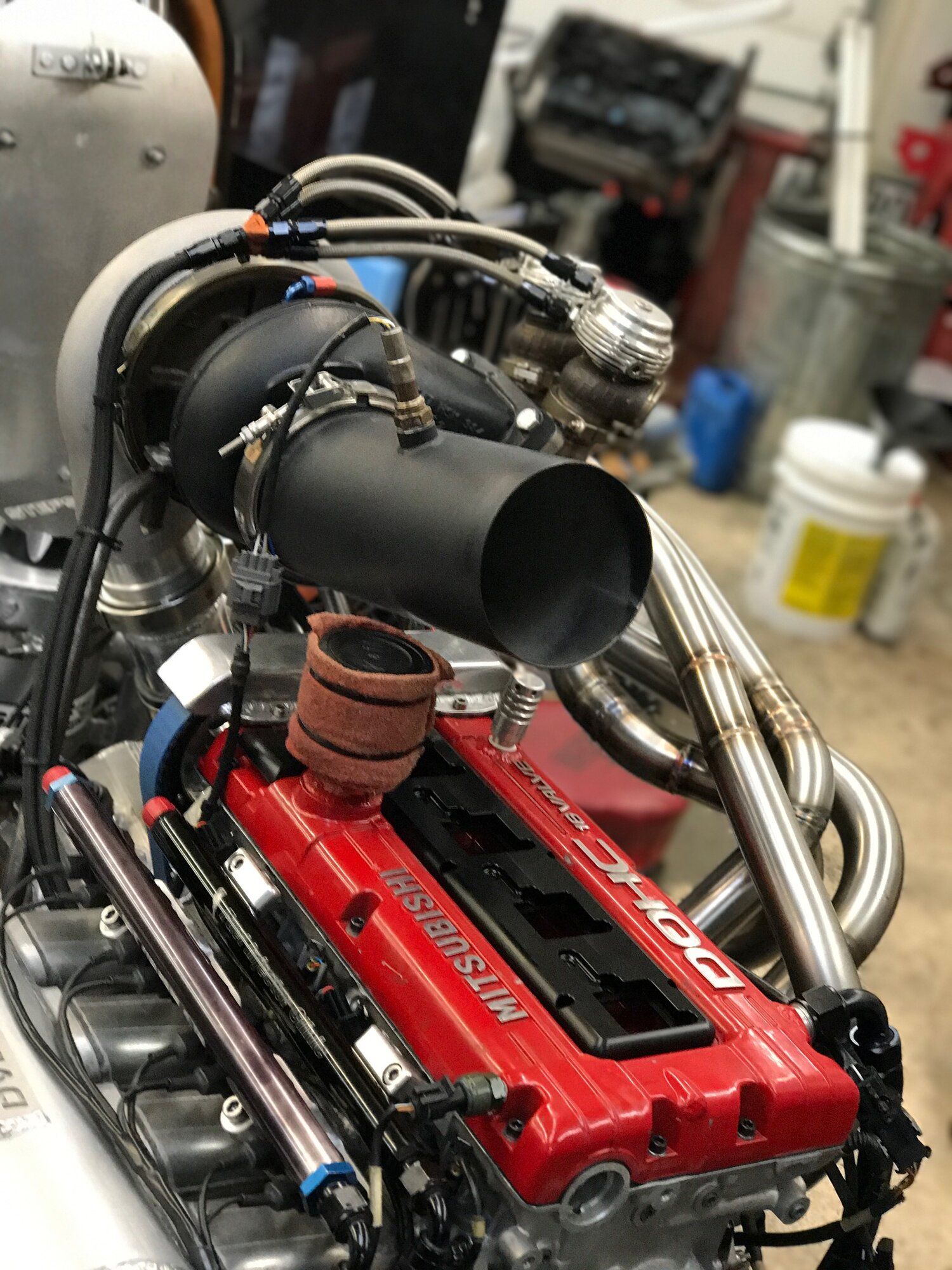

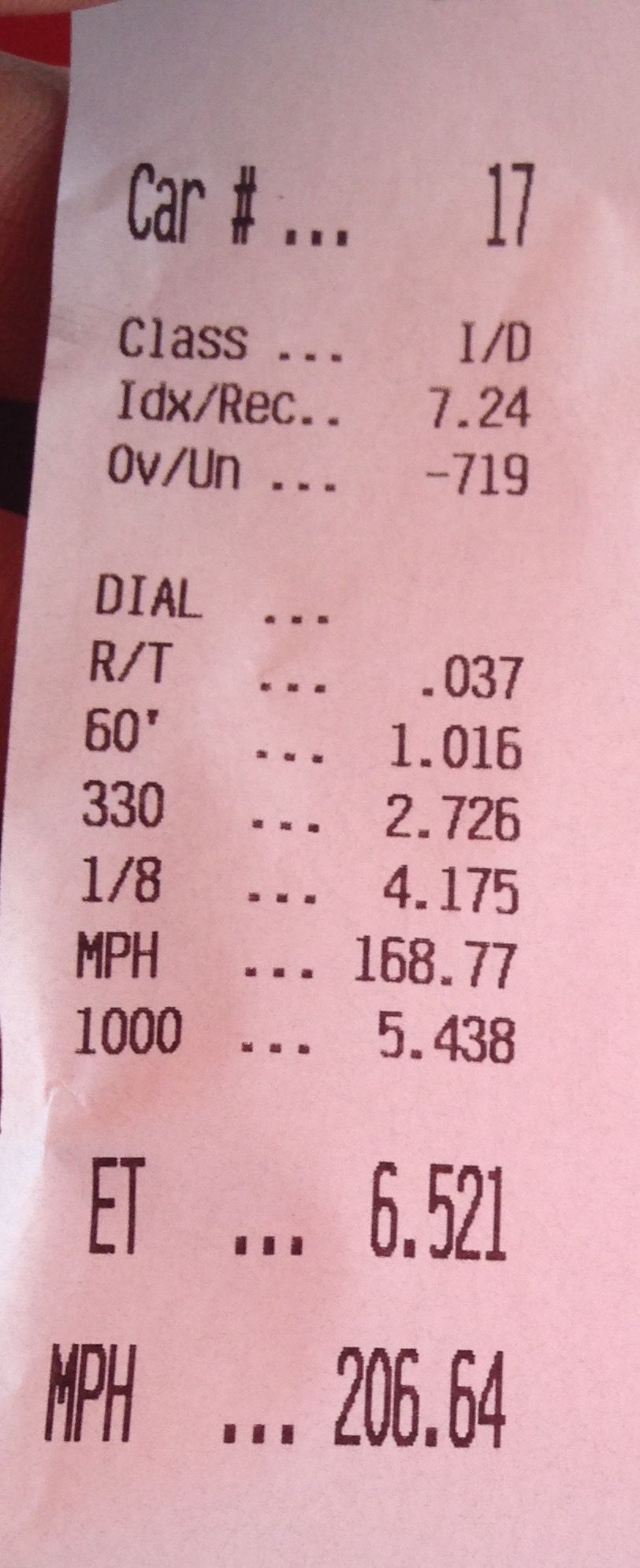

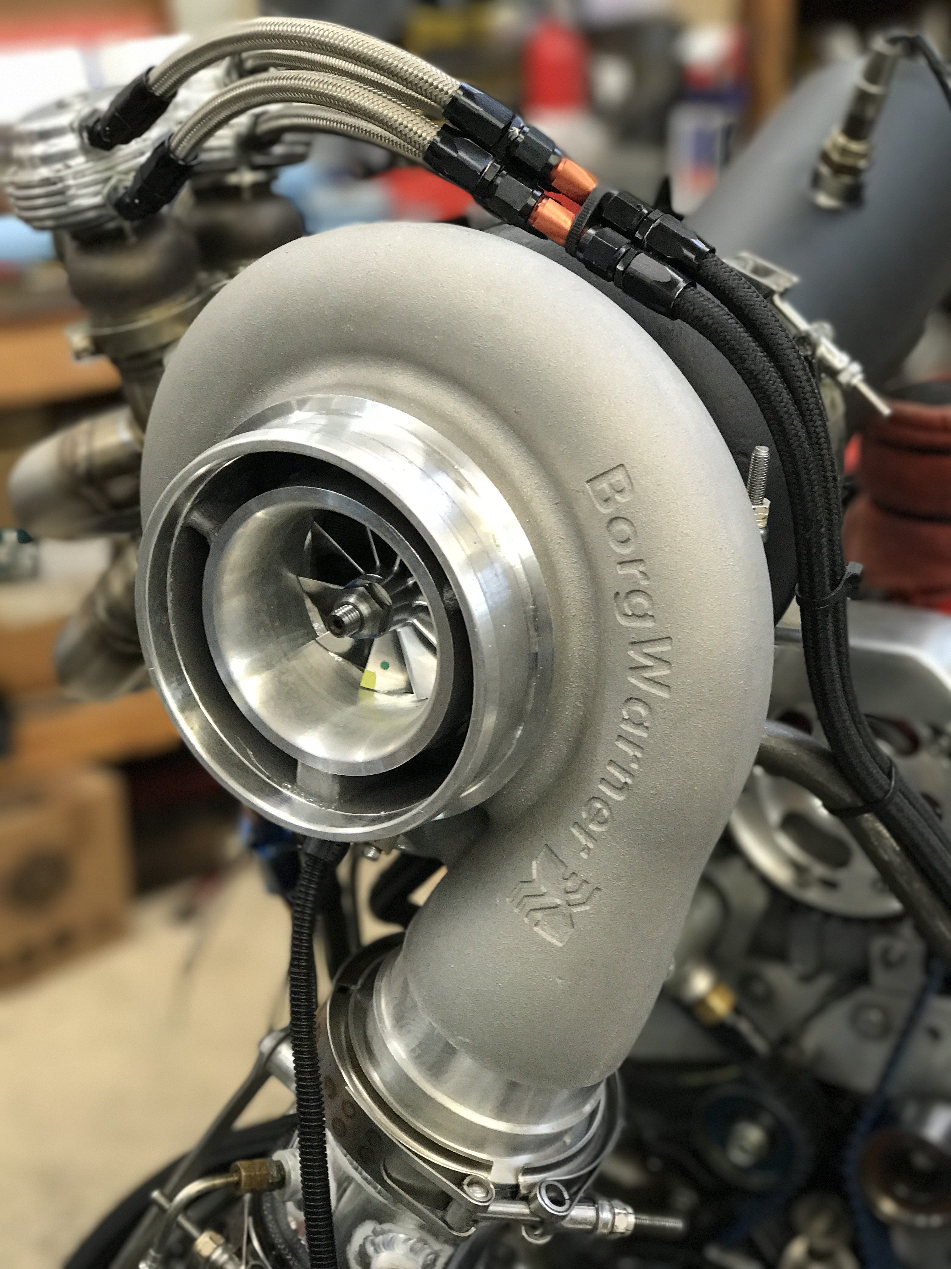

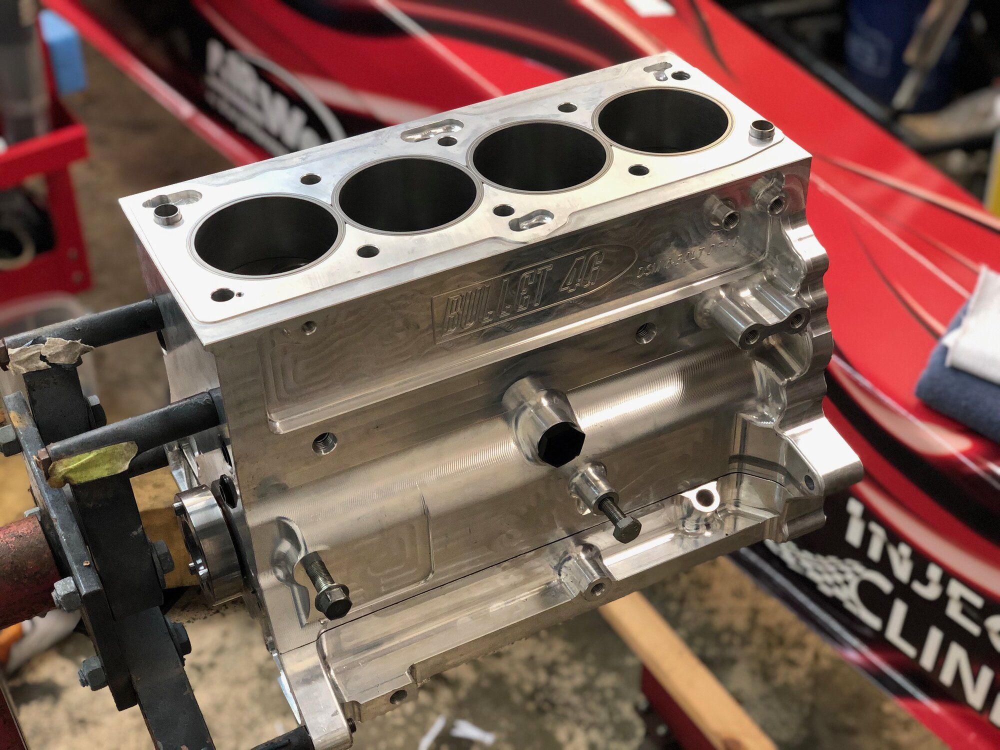

By 2018 we had gone 6.52 at 206 MPH, had set and reset the NHRA Comp Eliminator I/D National Record numerous times, had finished as high as 7th in the NHRA Division 1 Comp Points and accomplished a lot of what we had wanted with the car in that class. We decided to throw an 80mm BorgWarner turbo on the car and turn up the wick a bit. We ended up going a couple 6.4x passes with the best being a 6.47 and a best MPH of 210. At the next event unfortunately, we split the block in half, it seems we had hit the limits of the iron block 4G63.

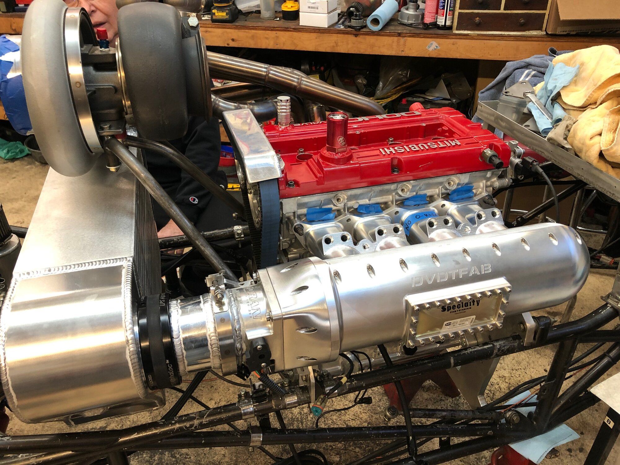

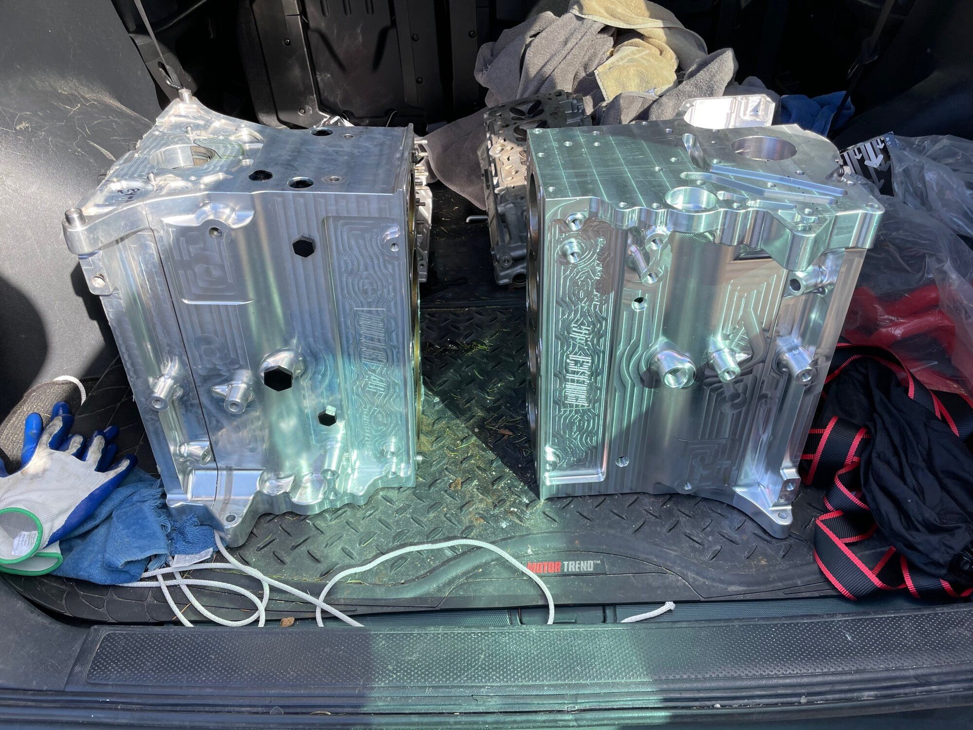

Since then we haven't had a chance to really run the car much, but we're getting to it this year. I think the best is yet to come. We changed some setup stuff on the car, moving weight around to get a better weight distribution. We purchased a pair of Bullet 4G63 blocks so that we can hopefully not have any stock block issues. We also have a nice 88mm turbo sitting here that will be going on once we get things dialed back in.
Please feel free to ask questions here and I'll do my best to answer. I'll make a couple posts below with photo dumps.

Fuel Injector Clinic - Another amazing group that have been a part of this project a LONG time. We run 4x 1650's and 8x 2150's.
BorgWarner - The story above speaks volumes. We gained power and spool up switching to their turbos and never looked back.
Haltech - We run the Elite 2500 on this car and it's phenomenal. Another great company to work with, with exceptional quality products.
