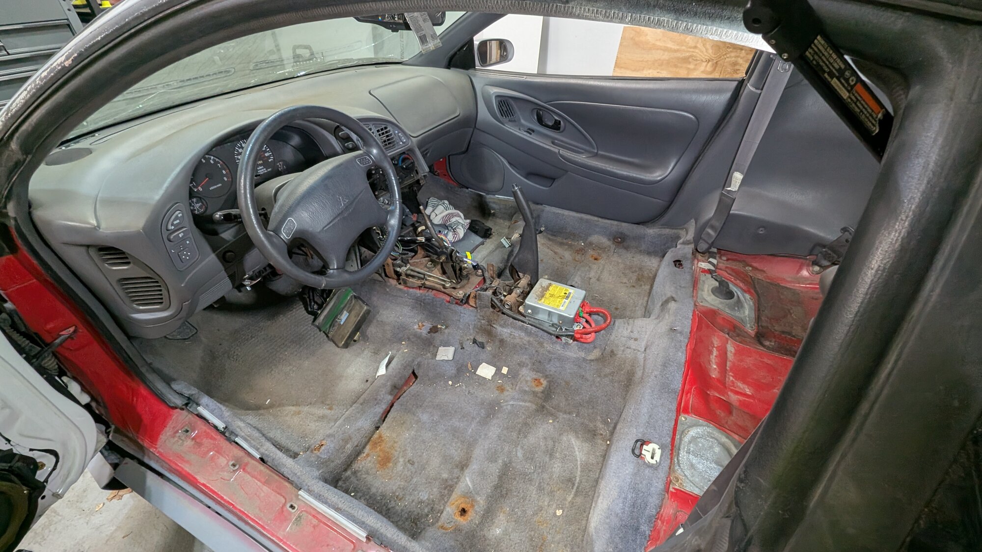

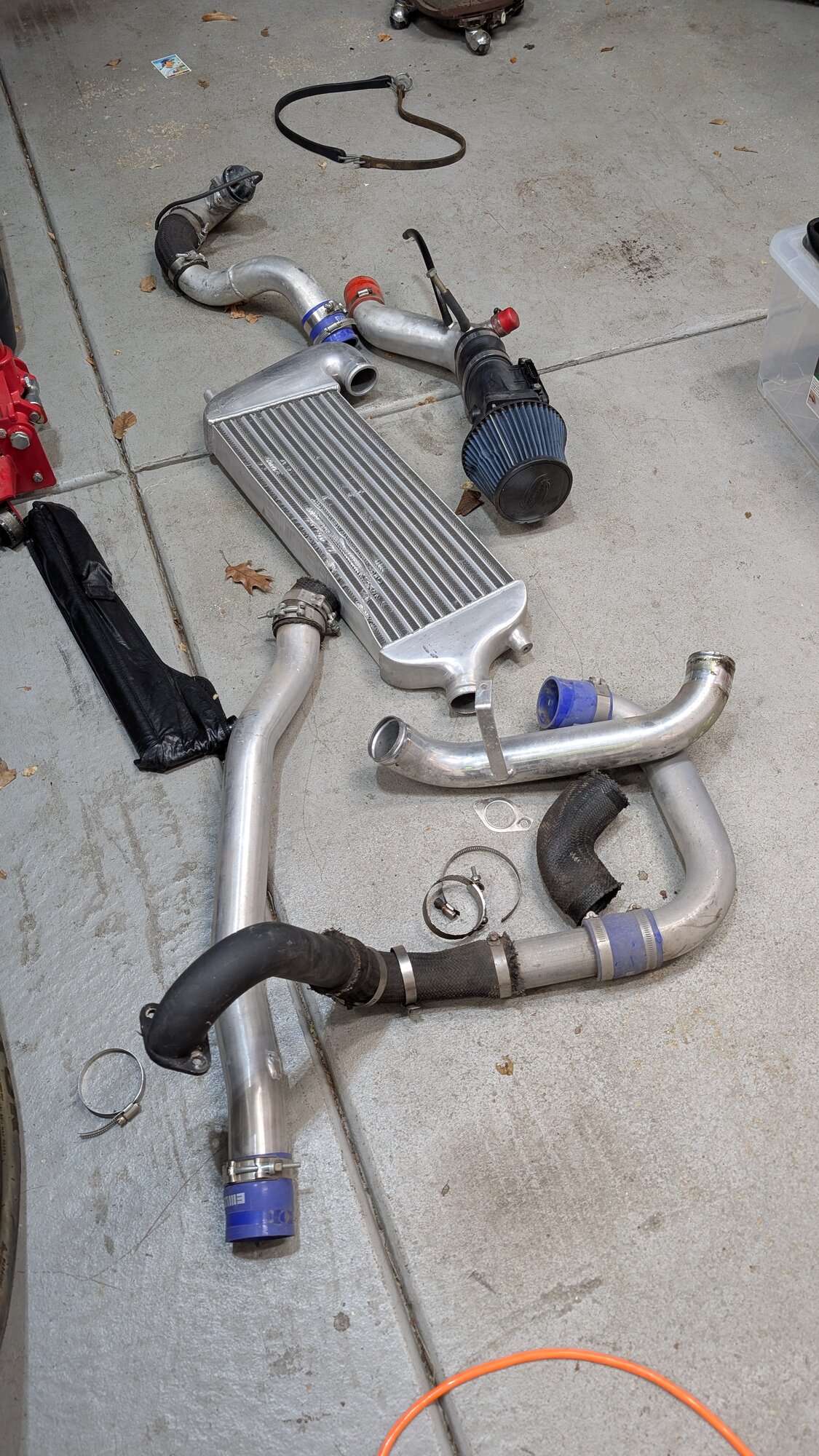

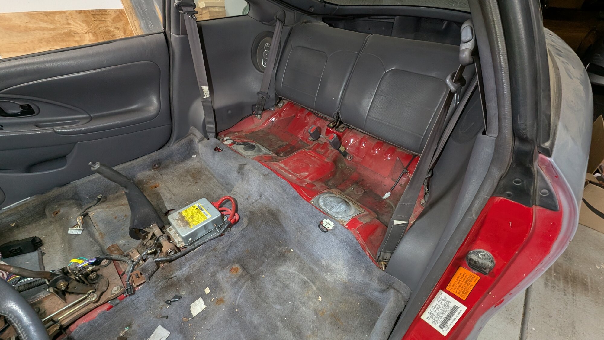

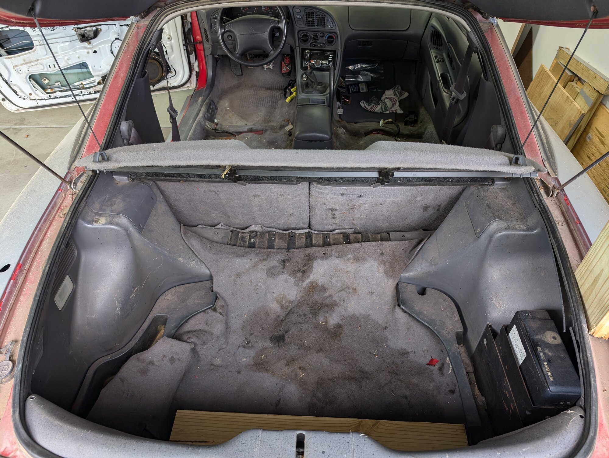

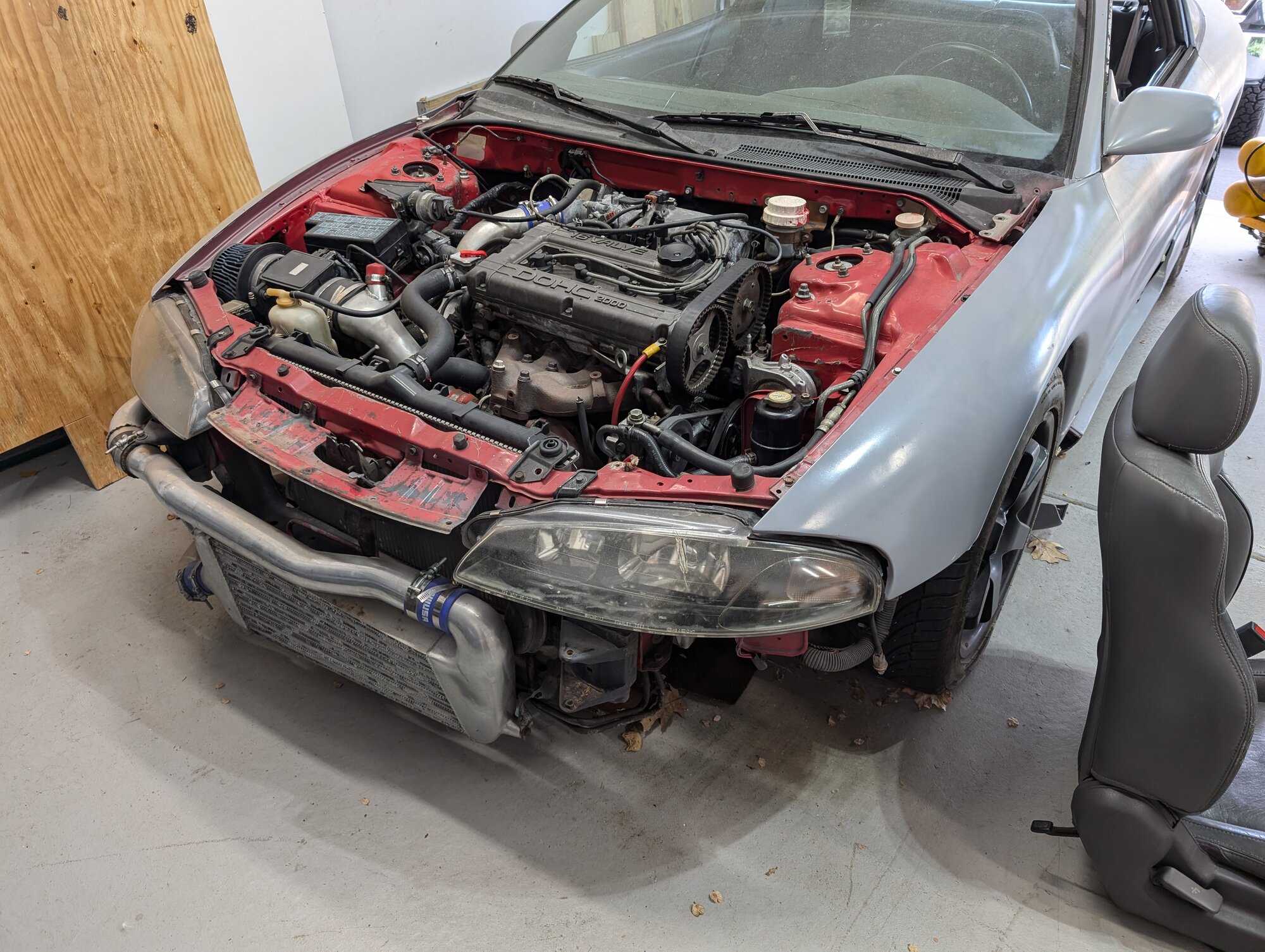

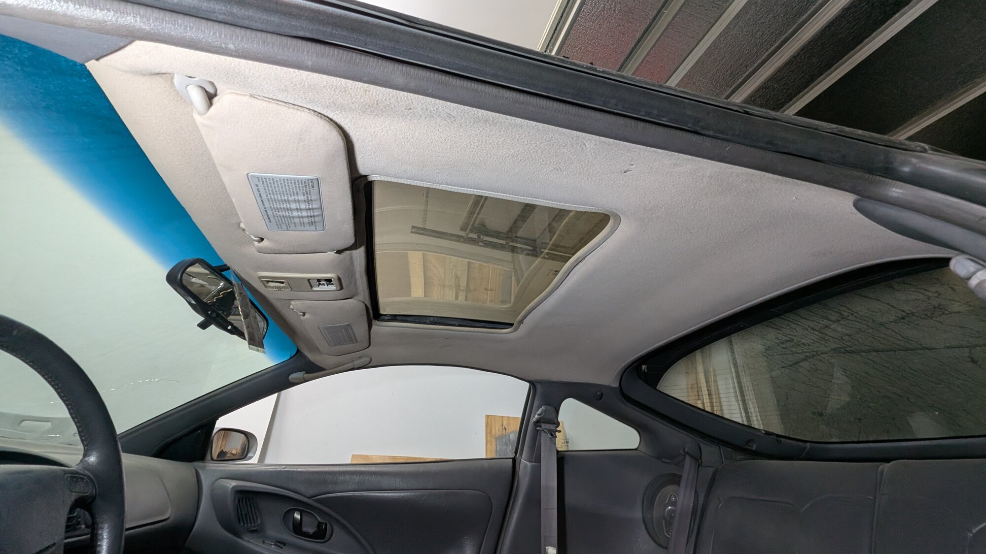

Got to work pulling out some of the interior and intake.

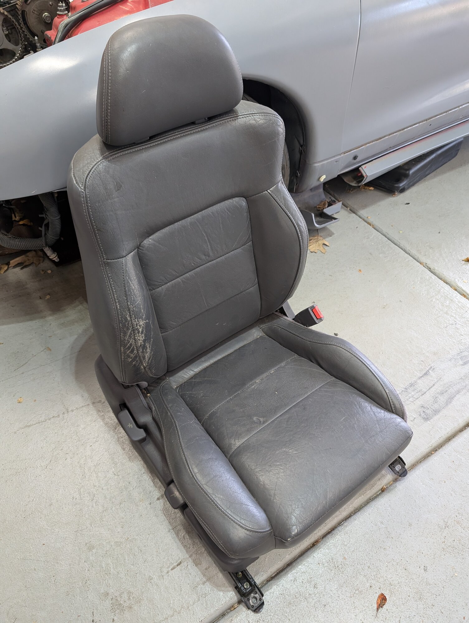

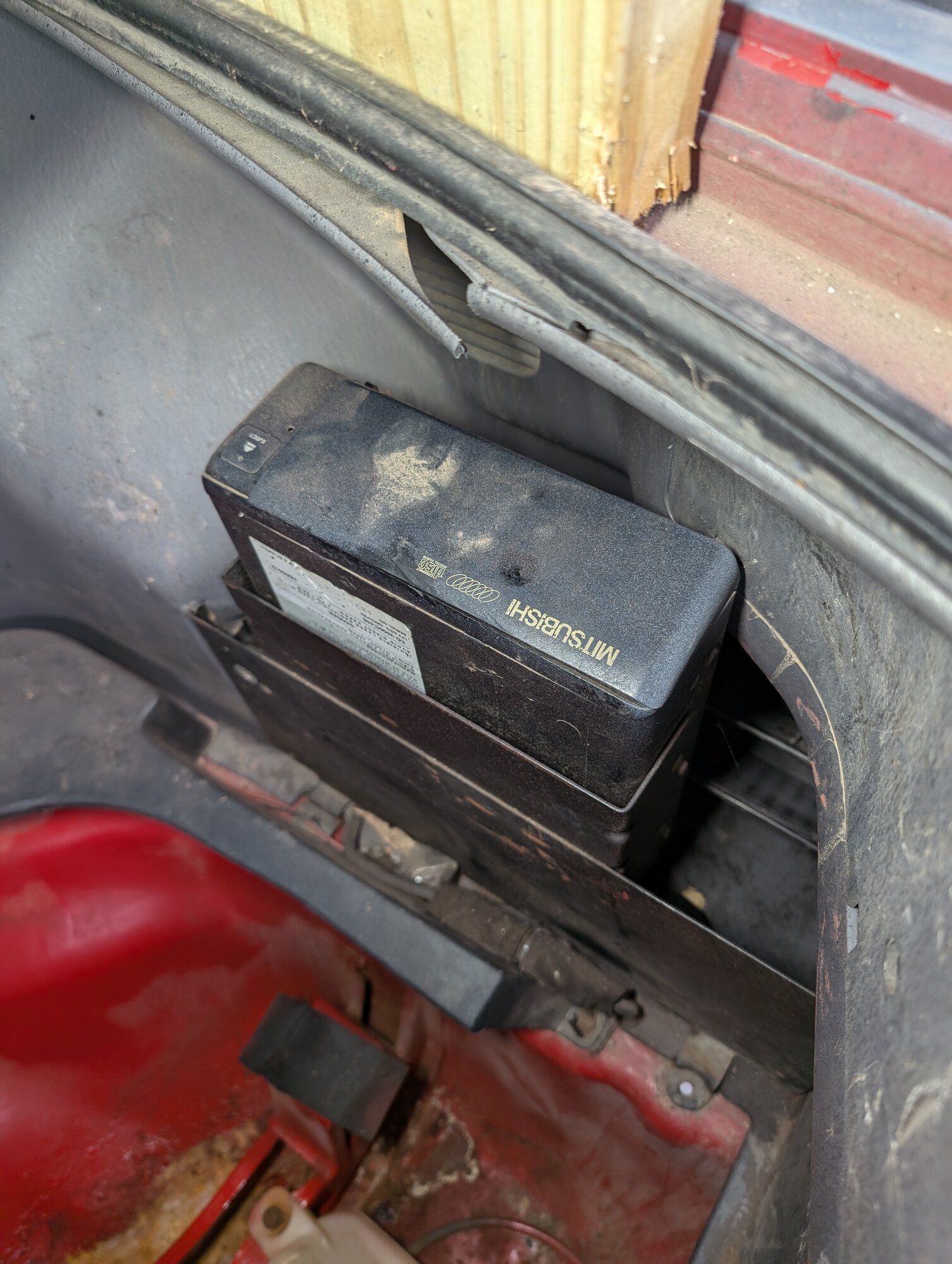

Interior is in pretty good shape. Has the original disc changer LOL.
I plan to keep everything behind the front seats removed. Would like to swap to a black interior as well so began shopping for that. Carpet is disgusting and don't feel like cleaning so will be buying new from StockInteriors.

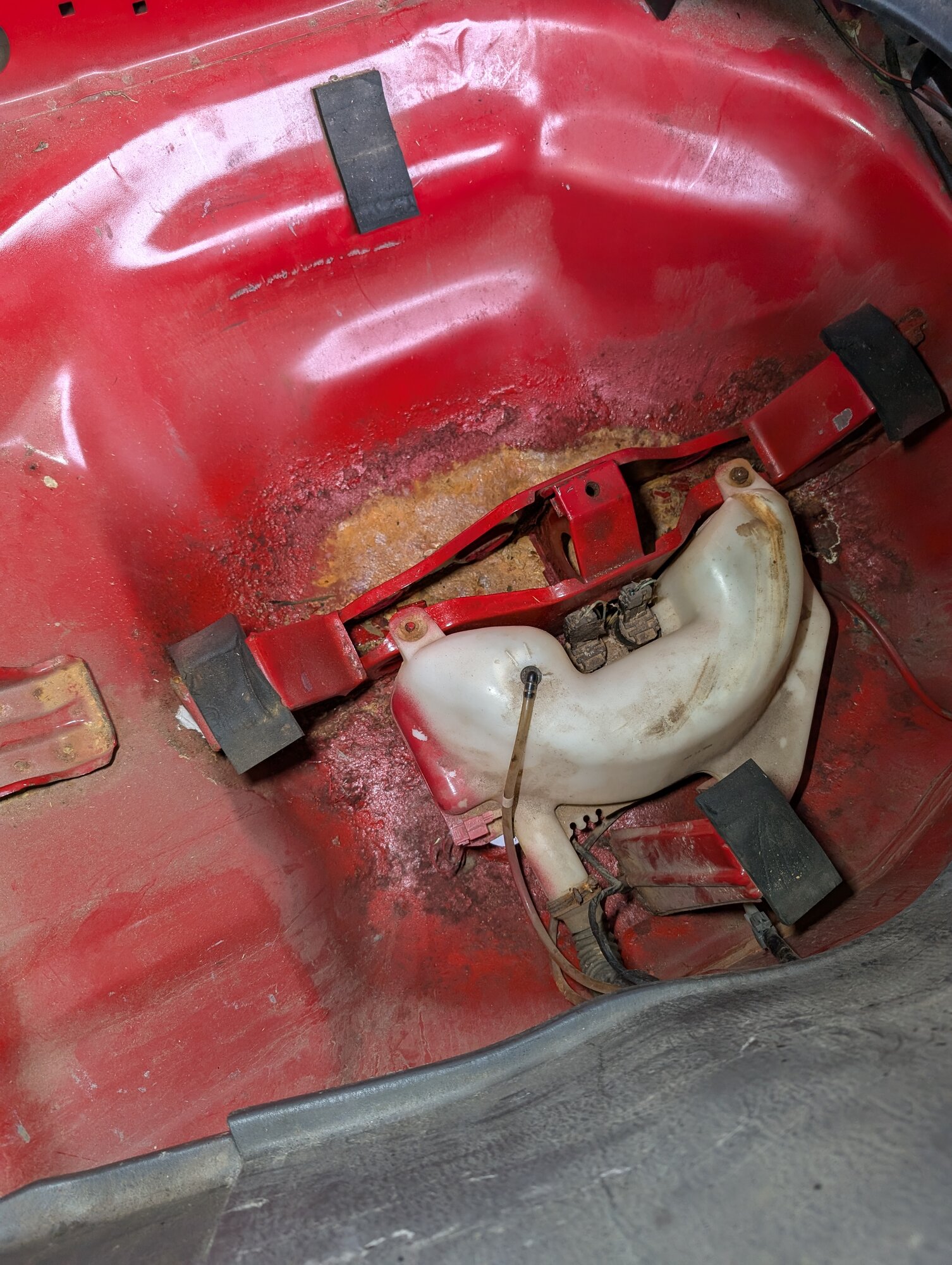

Spare tire wheel well is in rough shape but I planned to cut it out anyway.

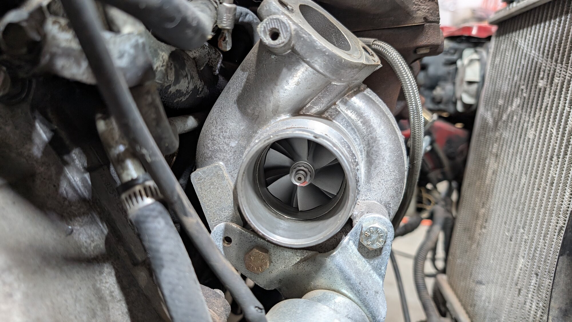

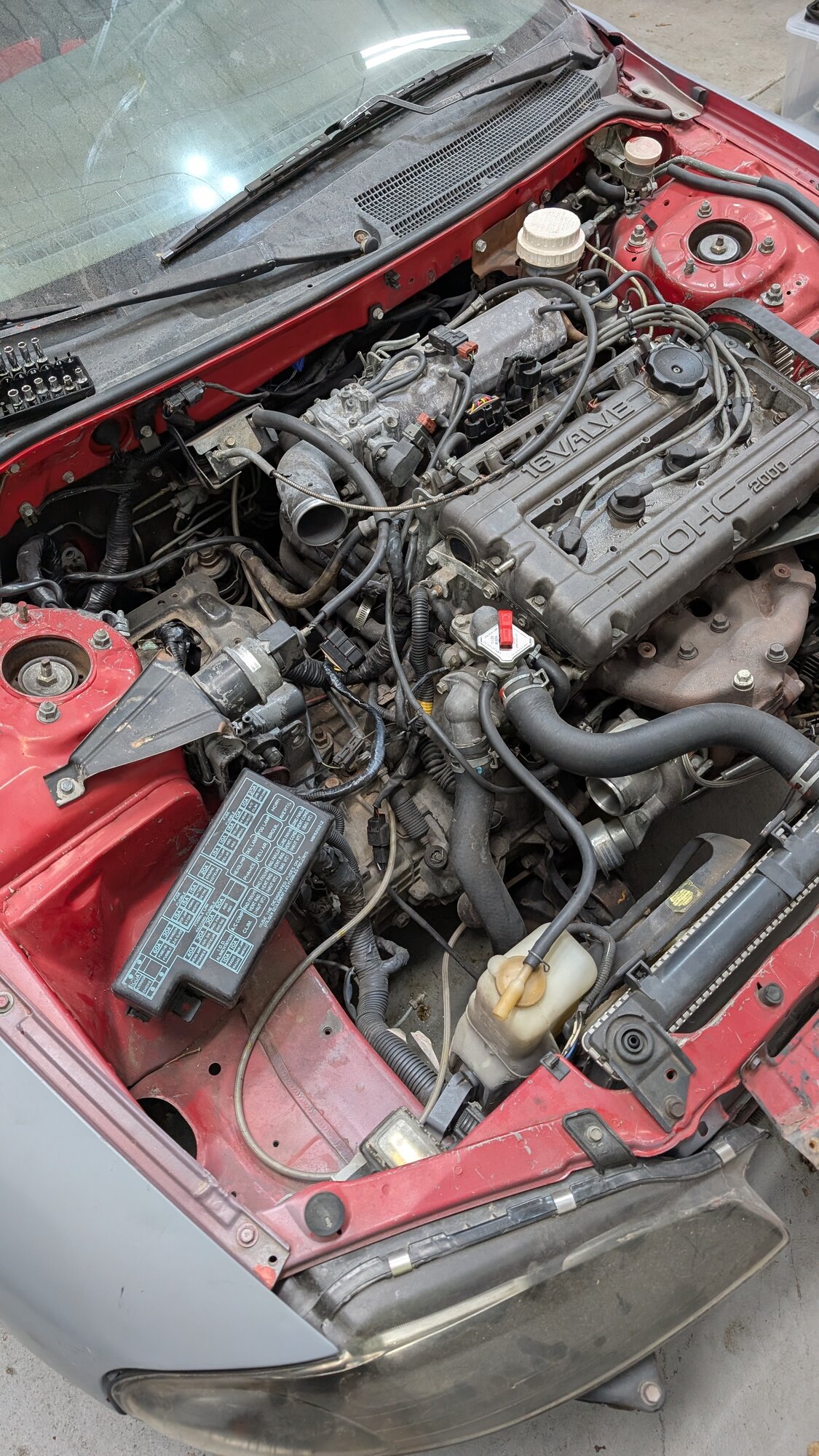

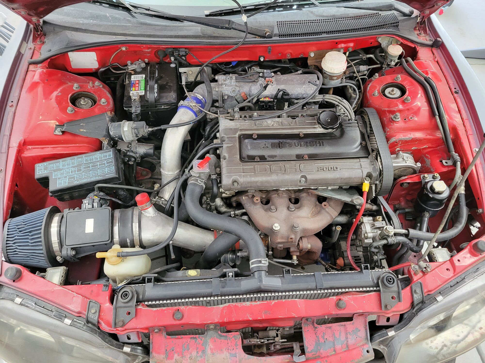

The engine bay is a complete hodge-podged together mess, missing and mismatched bolts, intercooler screwed into the frame with a piece of bent scrap metal. Makes sense I suppose, previous owner said he dropped the engine it into this shell. So the shell almost seems unmolested so far. Couldn't find the identifying plate on the turbo but there's no shaft play which seems good.
Going to keep pulling stuff out. Looking at how chopped up the engine harness is I'm considering just getting the OHM Racing tucked harness.
If you plan on keeping that Chinese turbo run a restrictor and an in line filter. For some unknown reason the Chinese make the tolerances stupid tight on those and keeping junk out of it will prolong it. Also always let it warm up before ripping on it. I ran my Chinese 16g all summer at 20 pounds like that and had zero issues. I'm not telling people they should run them but if your budget is tight this is what I'd do. Then again you could find a good used genuine 16g probably for the same price as a new Chinese. You also do run the risk of possibly snapping a wheel because who know how durable the things actually are.
I'm probably going to go FP Green. Guy near me selling brand new ceramic coated one + manifold for $1500.

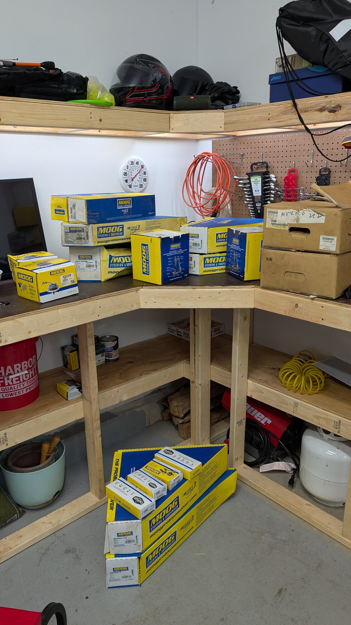

Got a great deal on all new front suspension components. $350!
Front Lower Forward Control Arms
Front Lower Rearward Arms
Front Sway Bar Links
Outer Tie Rods
Front Upper Control Arms
Front Wheel Bearings
Front Knuckles. Never had bushings installed in it.
