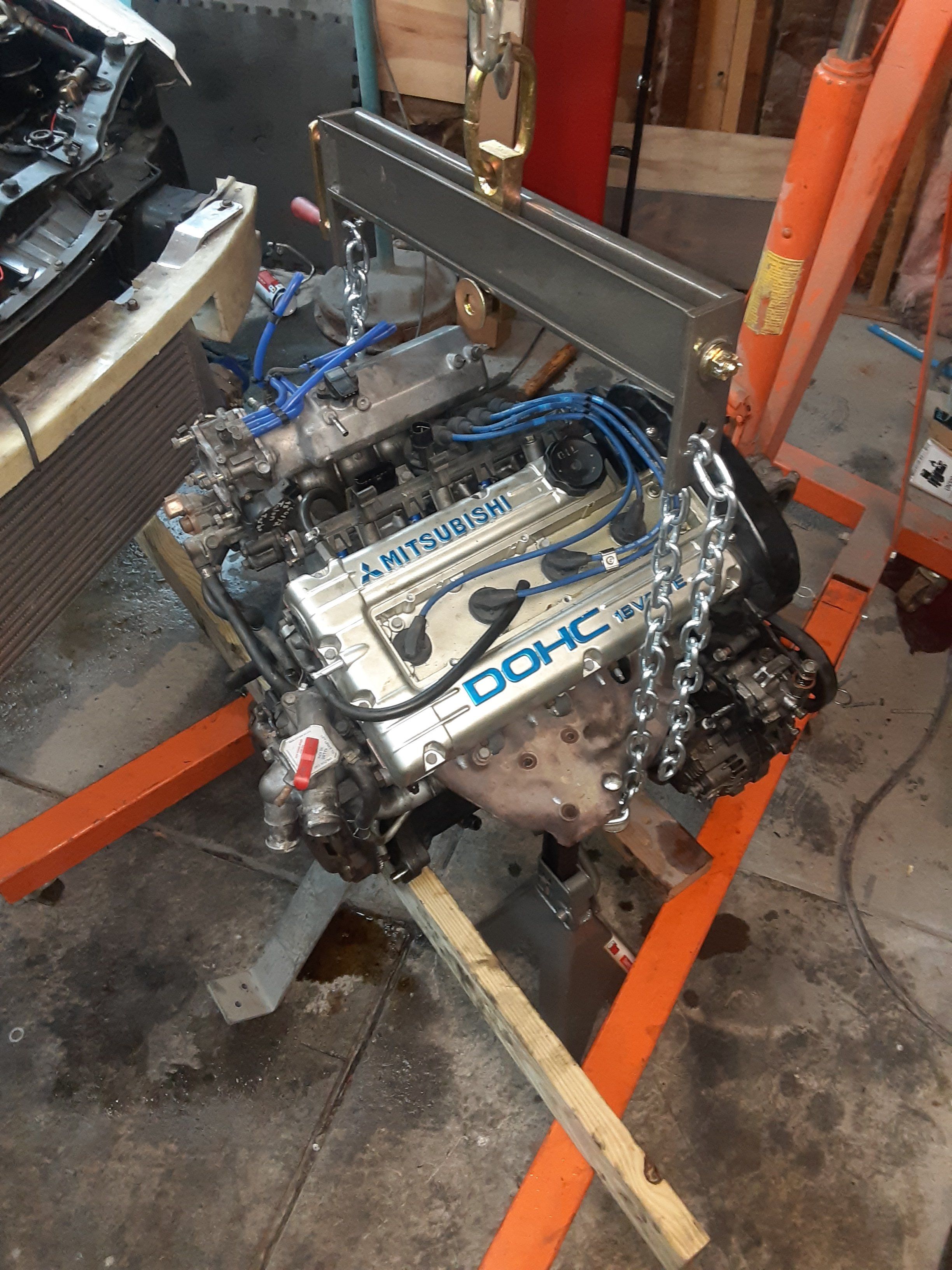

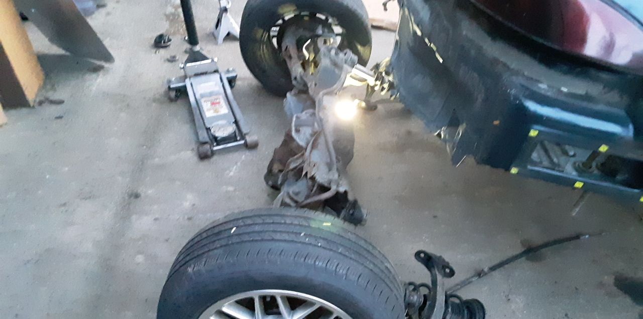

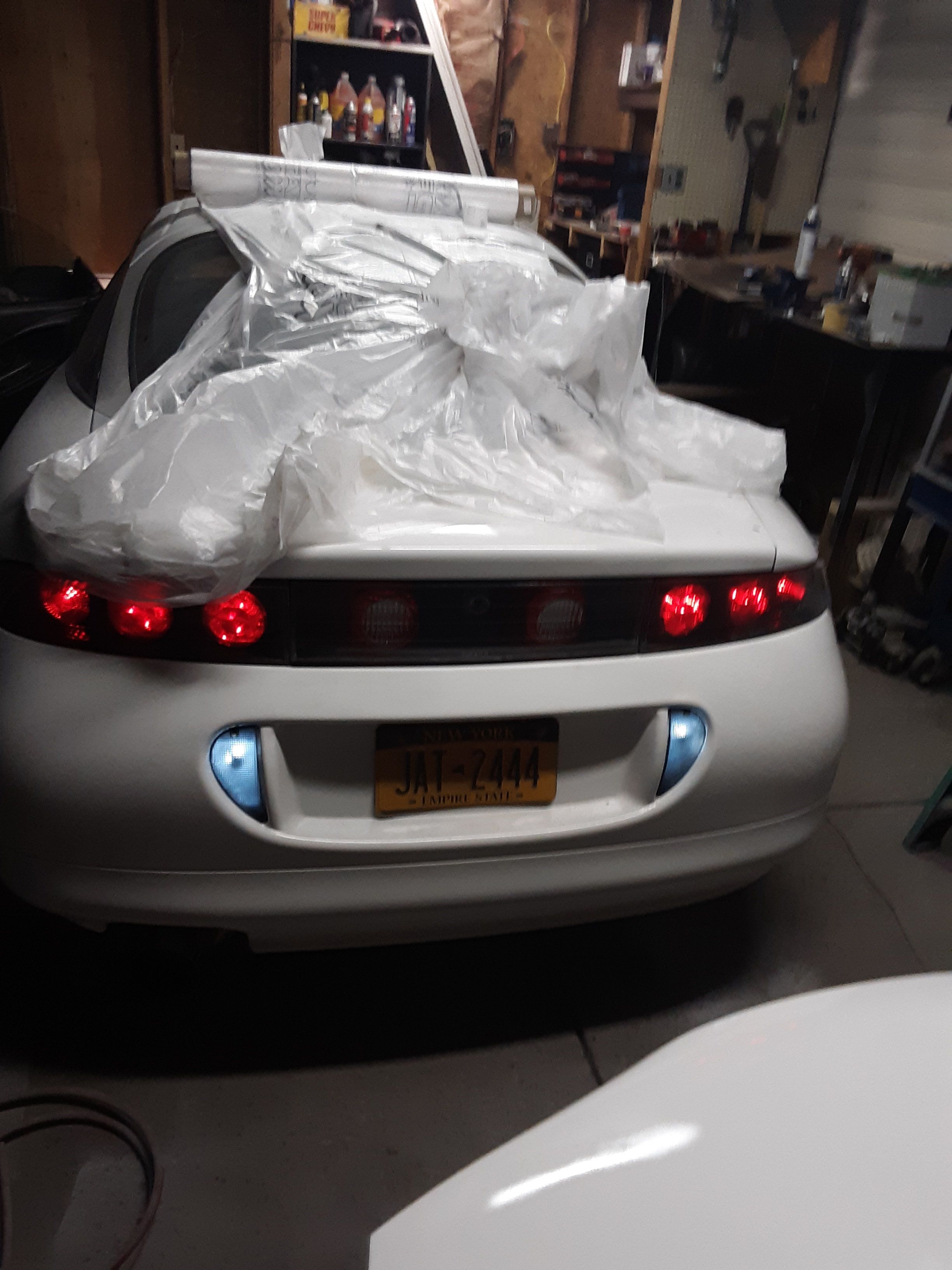

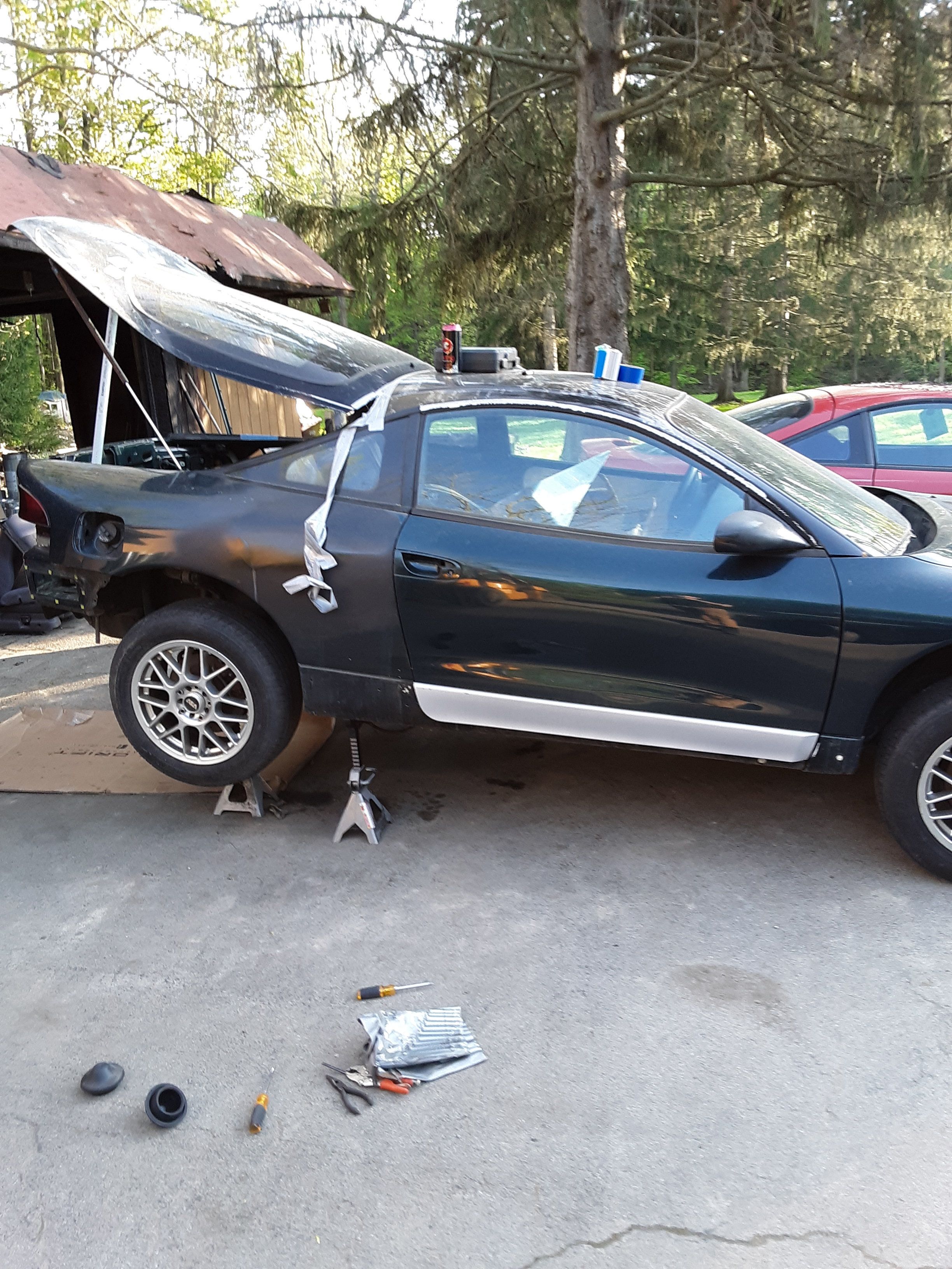

Got all the parts I need for the awd conversion that I'll be starting around November. Well everything except a 96-96 transfer case. This talon was a 60k original mile mint vehicle that some teen got ahold of and threw a rod through the block by simply putting a giant turbo on it and no other mods or tuning and hit the tcase.... what a shame. Oh well this car apparantly had to die to make mine awd

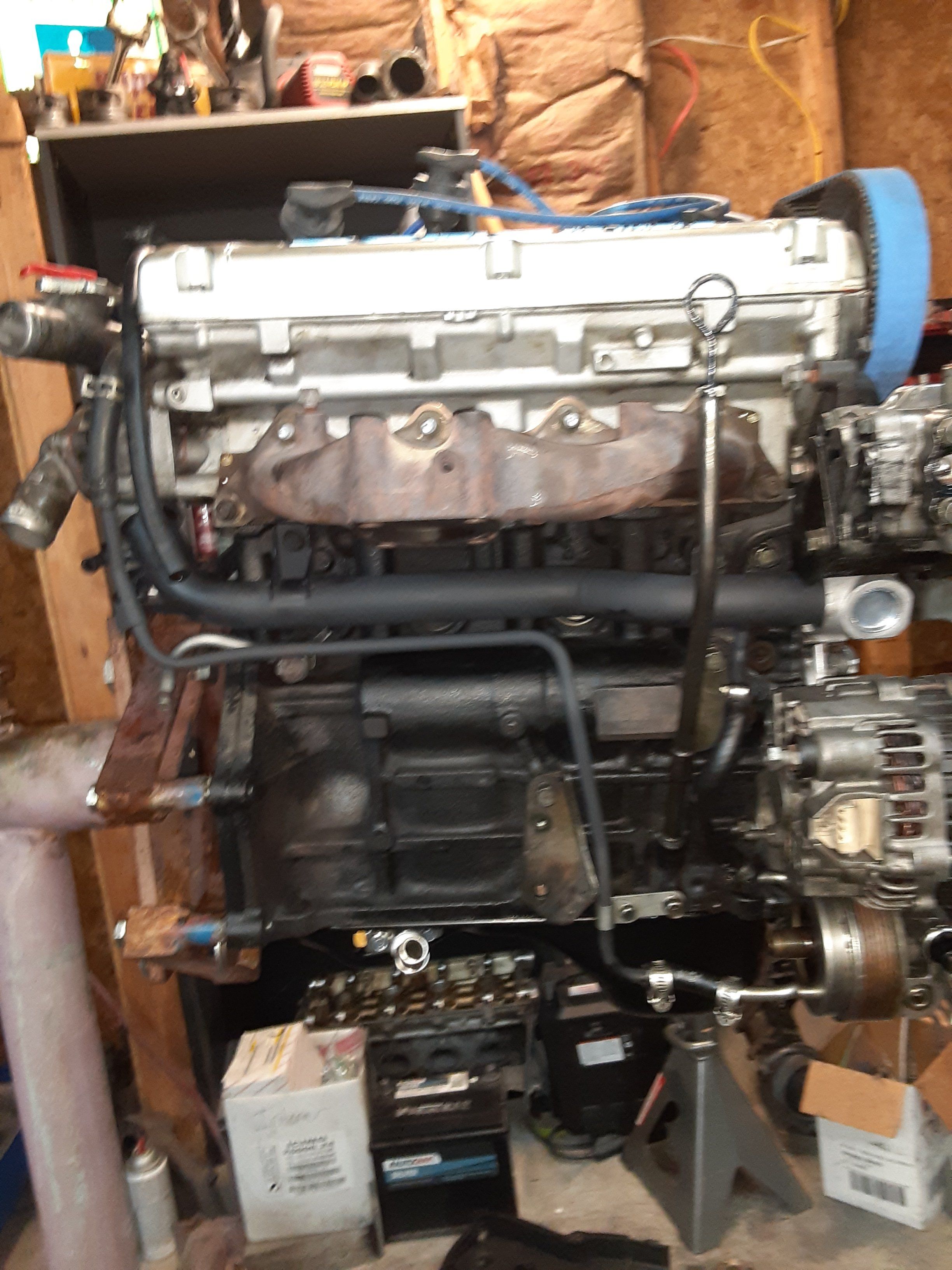

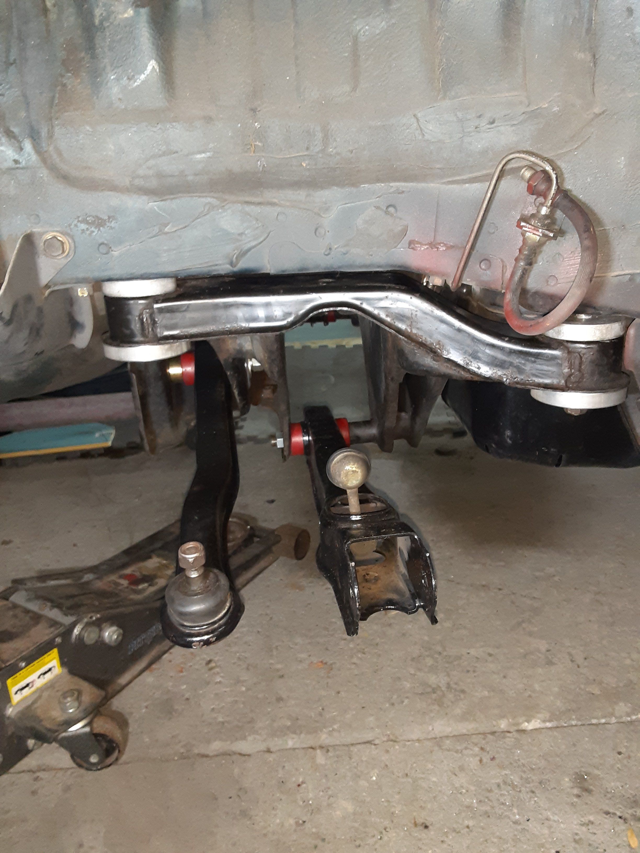

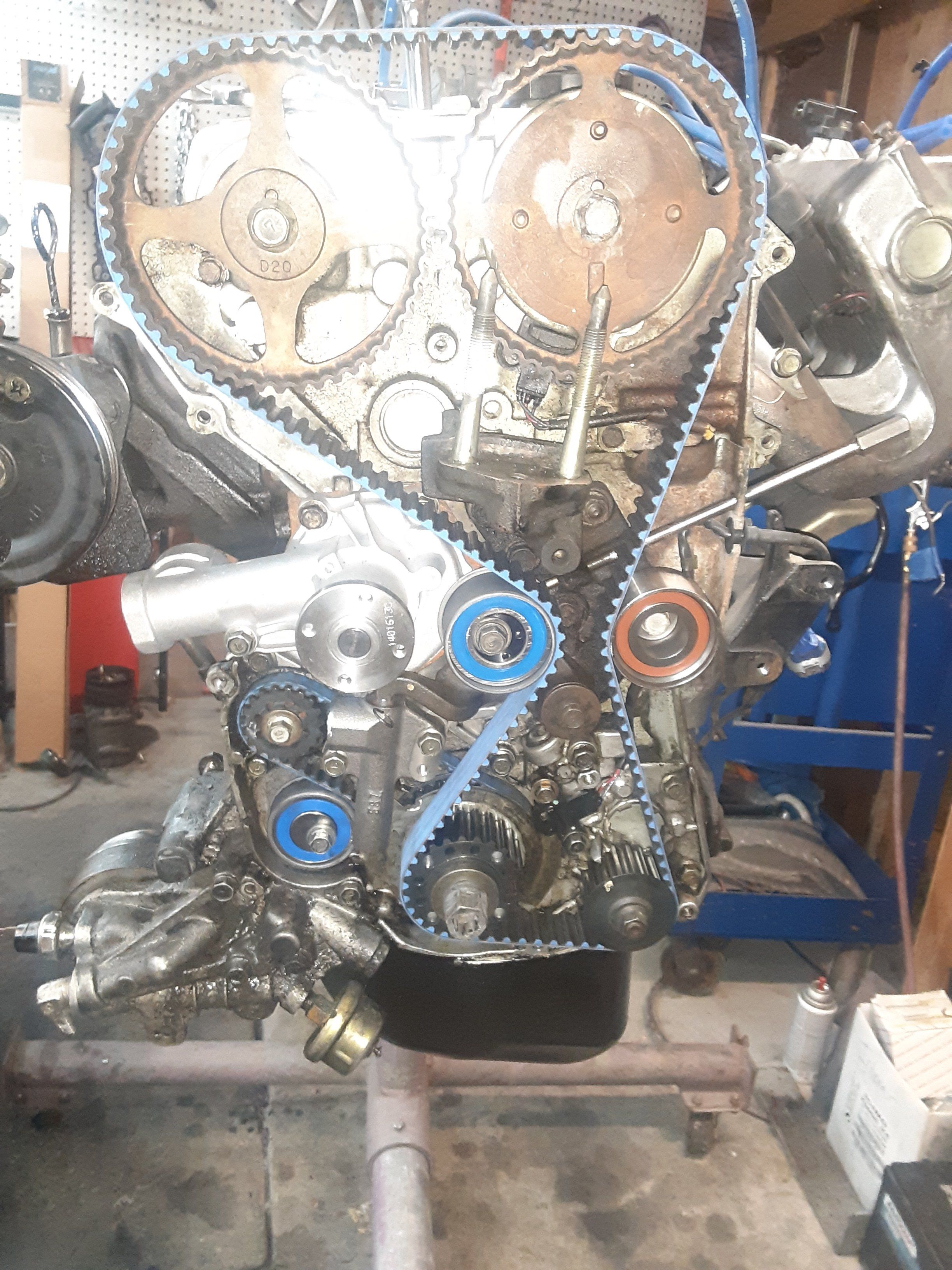

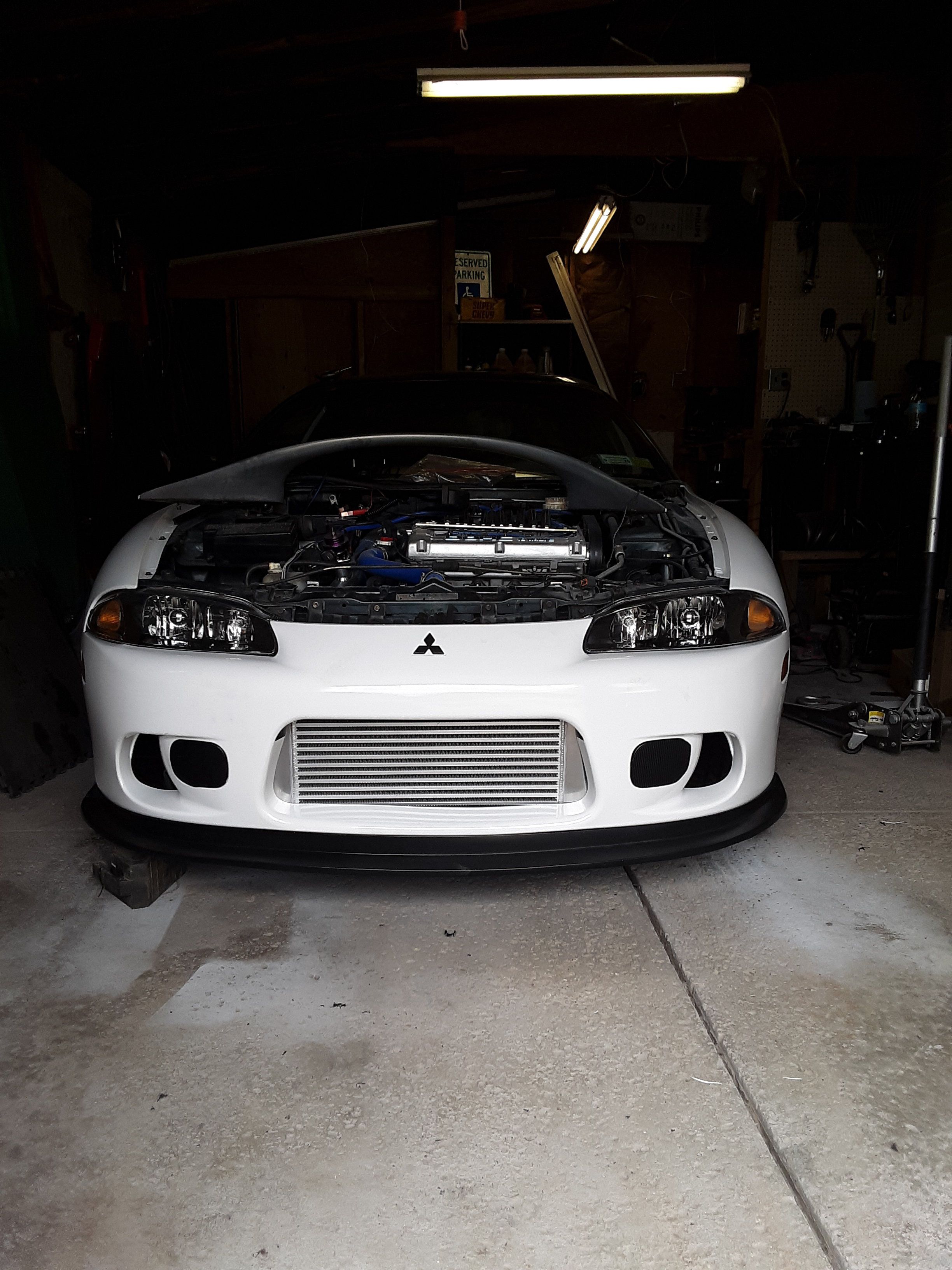

5/20 awd swap is almost done, replaced all bushings in the suspension with poly, awd gastank mounted with wally 450 wired in for e85 next year, stm solid driveshaft carrier bushings, motor is out with fresh timing belt job with gates belts and OEM pulleys/tensioner and water pump, new poly engine mount inserts differential and subframe bushings got volk solid replacements, got some tein coilovers, and all the little things like new drain plugs, breathers for the trans and diff, crush washers for everything like the water lines for my evo3 big 16g, act clutch and flywheel with arp bolts. Should be rolling in a few weeks as I'm only able to work in the garage one night a week replaced a few busted electrical connections with ones from donor car harness, DC rear strut brace
