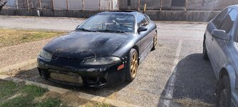

My steering clicks when ever I turn the steering wheel to the left. It'll give one click when I turn it left and then two quick clicks when it goes back to the right. If I turn the wheel to the right it wont make a noise until I bring the wheel back to the left where it'll give that one click then when I turn it right again it'll give the two quick clicks. Also noticed that it mostly does this when the car isn't moving. It'll do it occasionally while I'm driving. Does anyone know what this could be my guess is the left inner tie rod. Its a 98 eclipse spyder gs
