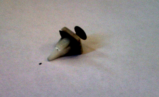

I have a similar situation. I have these TEIN skirts that have been sitting around for months waiting to be intstalled. I know about those Ebay clips, but this clip is something I can't find anywhere. I've looked all over. Not even sure what it's called. That's a Phillips head screw sticking out of it. Anyone know what this is?
Dgdsm- I think these are what you are talking about. If so I picked them up at oreillys. Part number in pic.
Those are the ones used for the inner fenders in the wheel wells.
