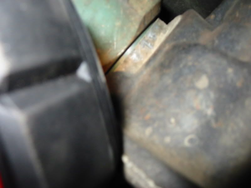

Looks like I may need to get axles anyways. This is what I found that looks different between my driver side and passenger side axles.
Drivers side axles looks normal
Passenger side looks like it may be separating from the cup
Since the axles are rust welded in, I would require the old axles to be cut out from the thing that the hub bearing goes into ( forgive me I dont know the name ), Knuckle assembly? What years of cars could I use the assembly from? Are the N/T's the same as the Turbos? If so, I could always grab a couple from the local pick a part for cheap.
Or, perhaps switching out the cups on the rear axles for non LSD ones?
Still looking for any input from anyone who may have any suggestion on what I could or should do.

Axles wont work, I just tried to put the passenger side in and it is being blocked by the bar in the middle. Oh well.
