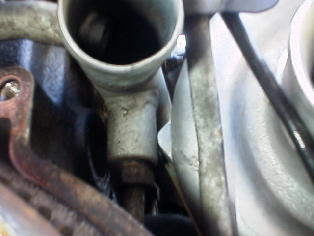

I seem to have fixed the overheating problem. Just a simple stuck thermostat and expired radiator cap.
