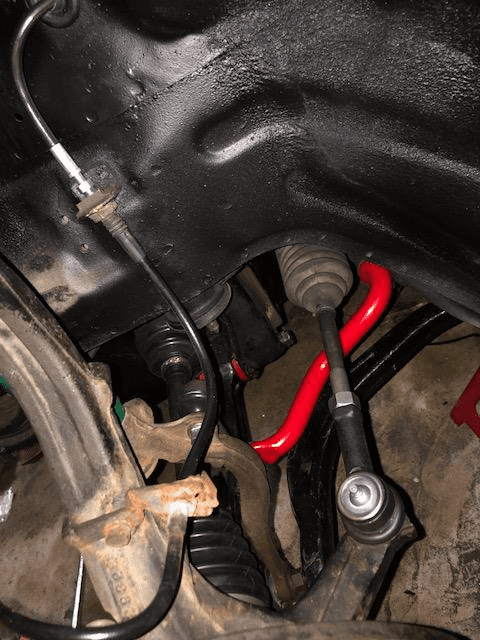

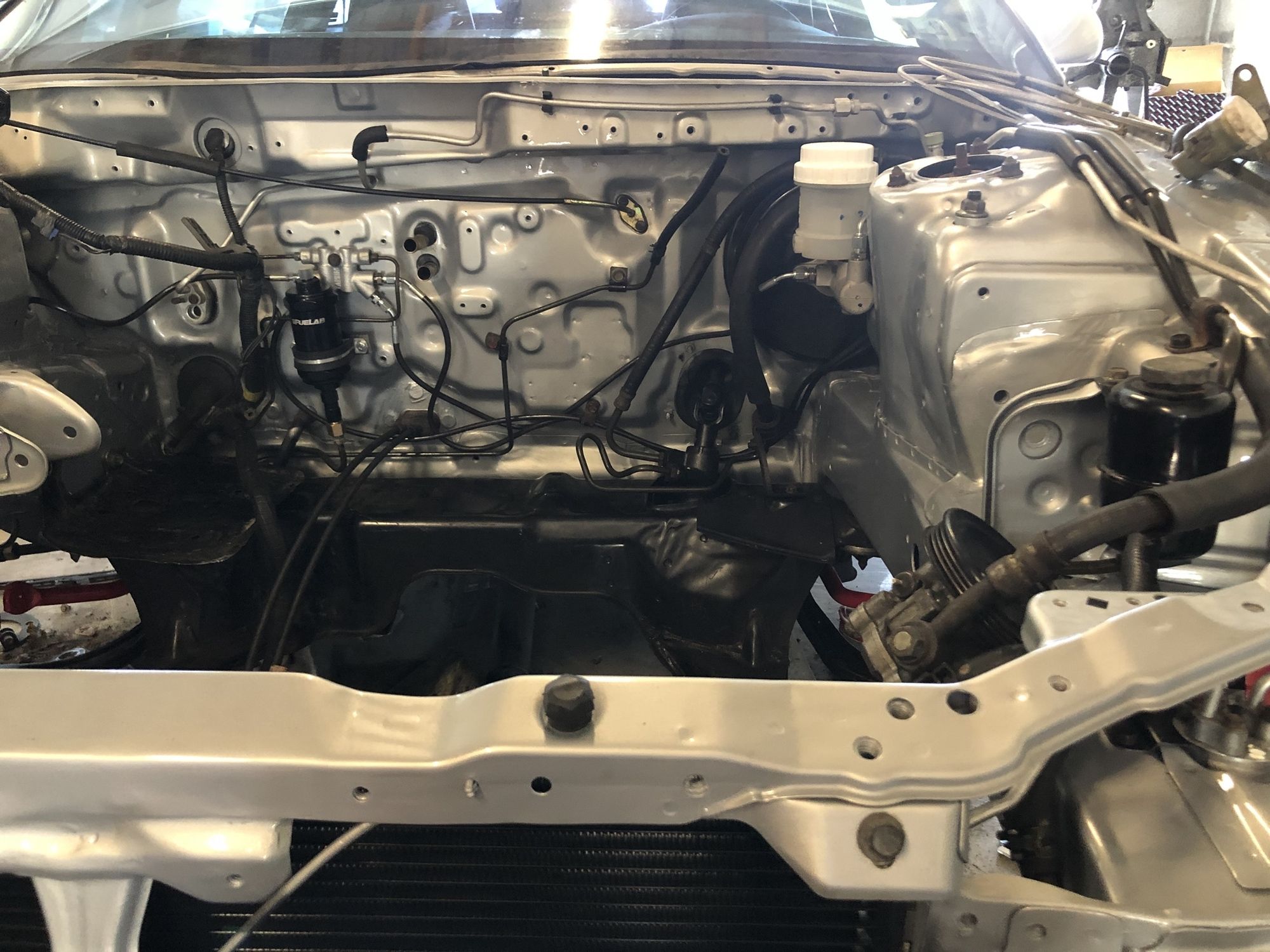

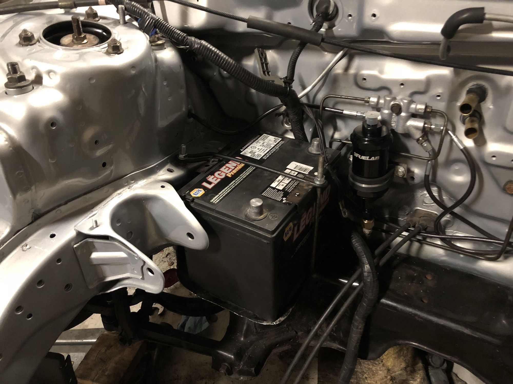

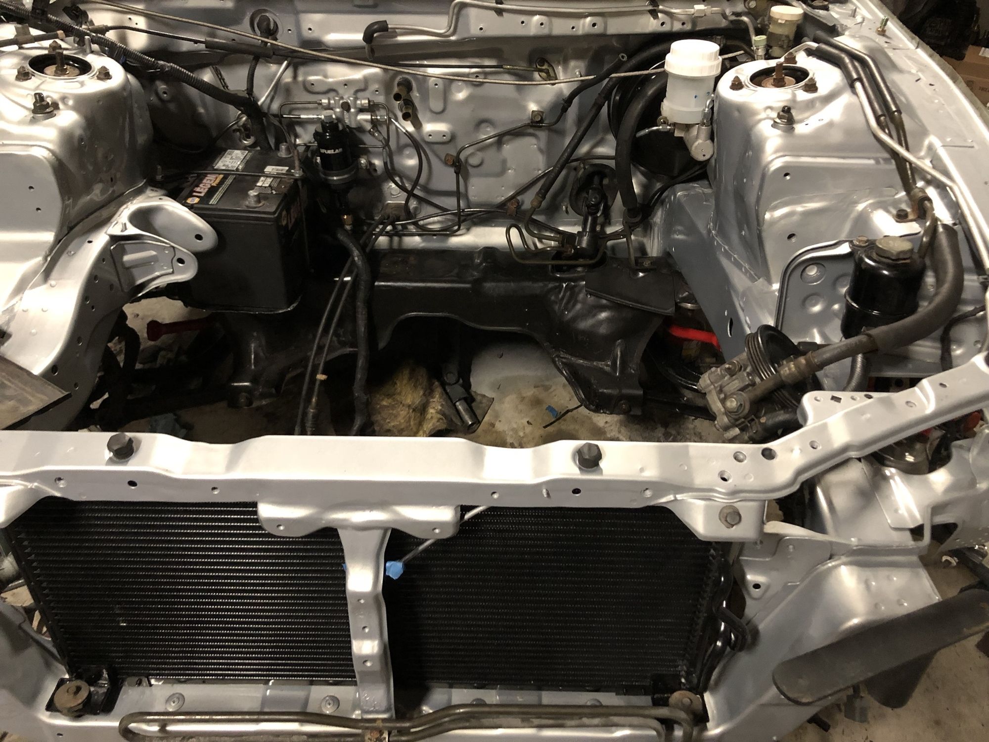

I have spent the last couple days working on the car. I installed all new ball joints, tie rods, control arms and I coated the wheel wells. As far as the engine bay I think I have everything in that needs to be installed before the engine. Power steering, ABS delete lines, brake booster and both master cylinders, A/C lines, I also made a bracket for the fuel lab filter and I did the battery relocation (thanks to GOFER for the great write up).

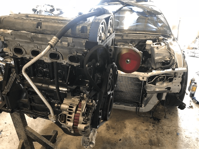

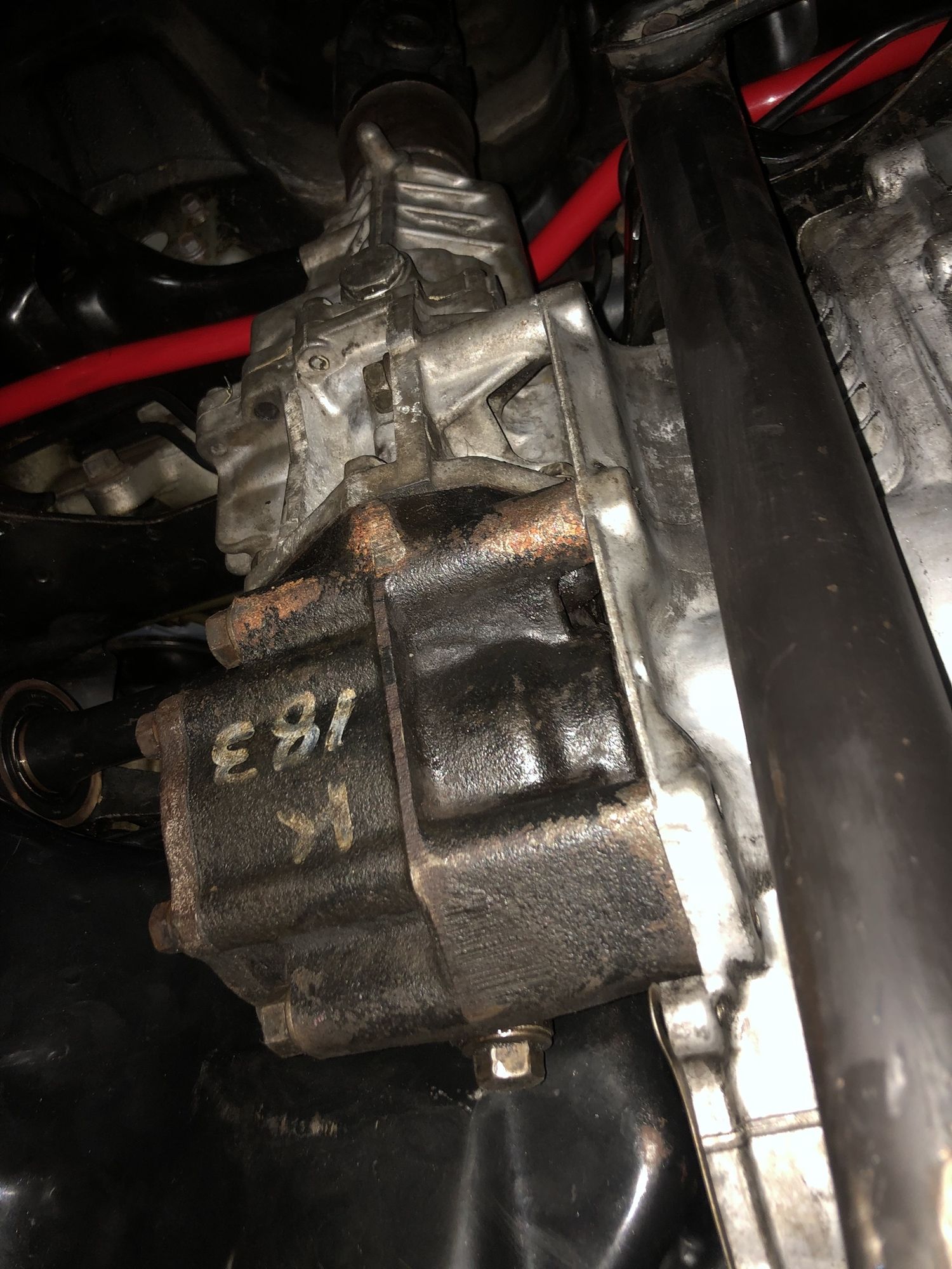

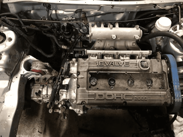

Engine is now in! Took a couple hours to clean up the transmission, install new seals, install flywheel and clutch and then put it all in. The solid aluminum subframe mounts and poly engine mounts make it a little tougher to line everything up as there is no slack.

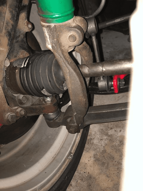

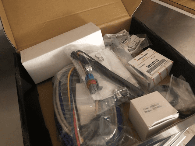

Had to battle the heat this weekend in the 90s but got a few things done. I also had some parts come in (walbro 450, rewire, transfer case seals and some other little odds and ends). I installed both axles and the rest of the suspension is in and torqued to spec.

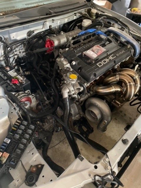

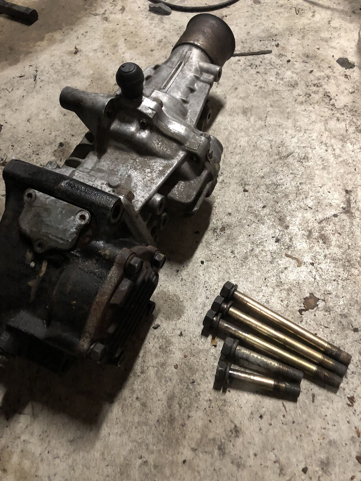

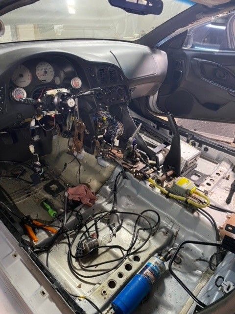

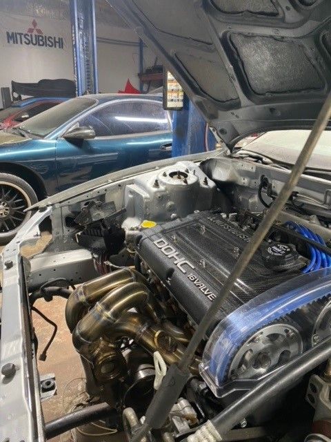

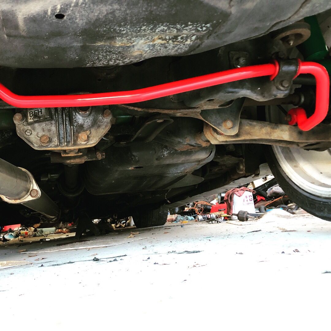

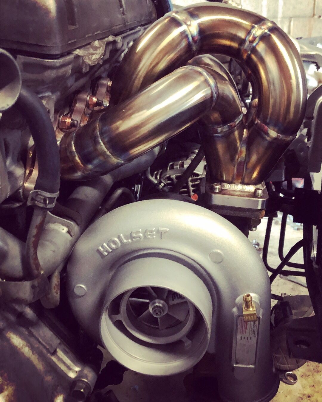

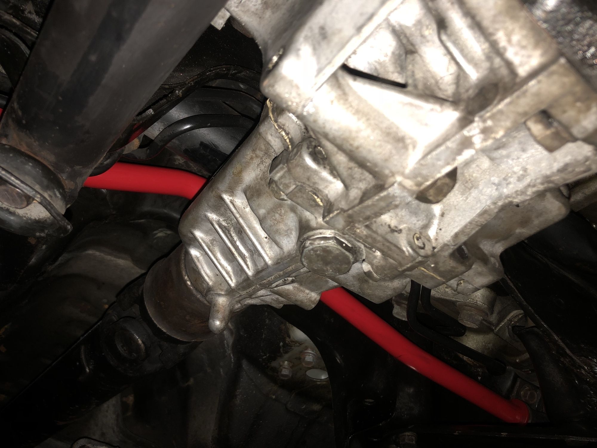

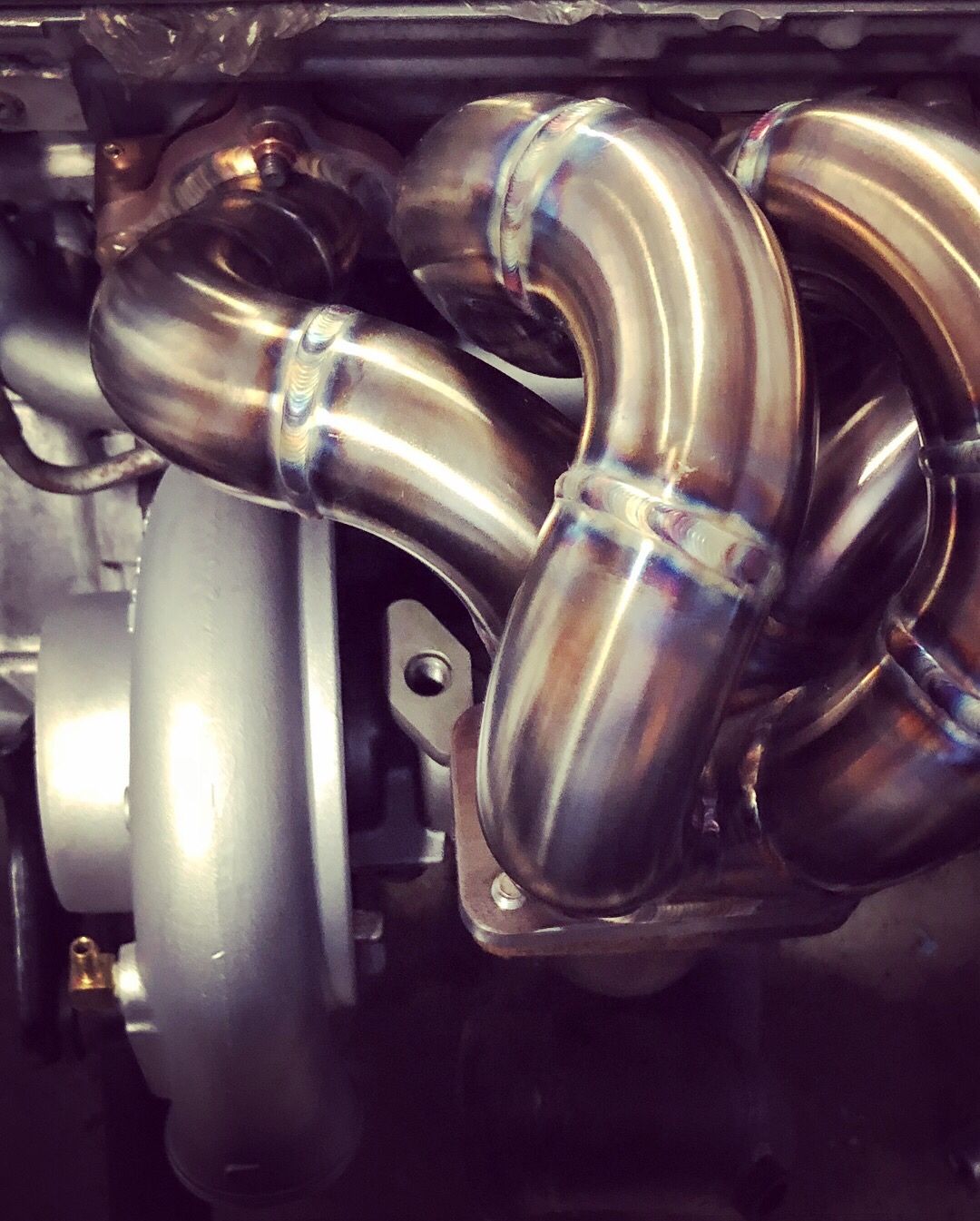

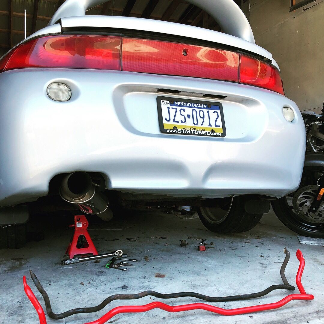

I finally feel like I am making progress on the car:hellyeah: Still have a nightmare of wiring in the interior which I am looking to tackle this weekend. I ordered new seals for the transfer case and got that bolted in the car along with my Bulfab tubular cross member. I also installed the rear RM swaybar to match the front. Biggest news is that I bolted in the Archer Fab manifold and HX40 I cannot wait to drive this car.

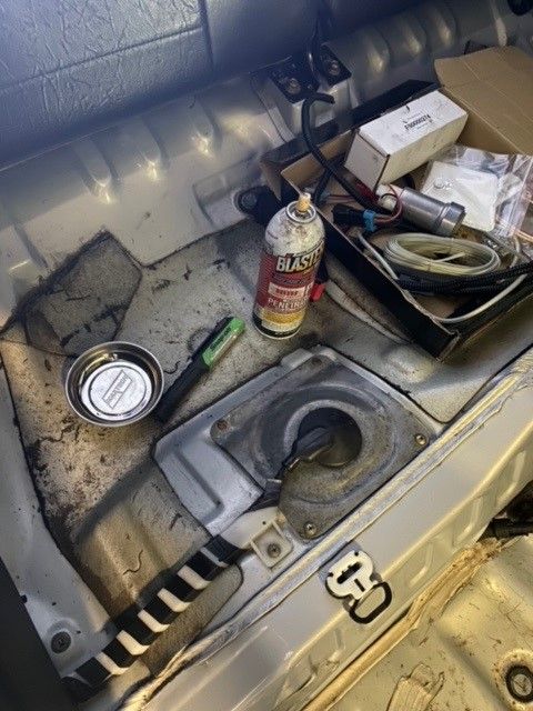

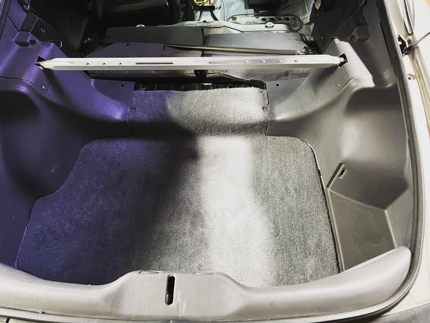

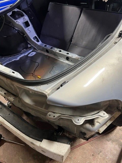

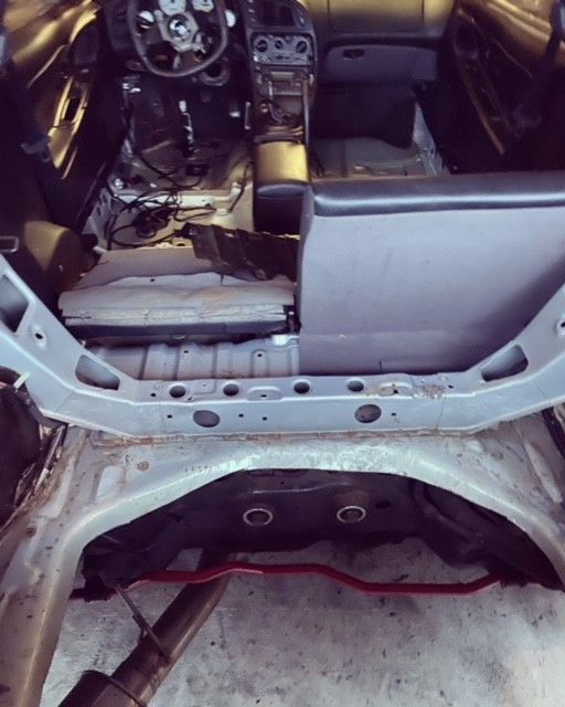

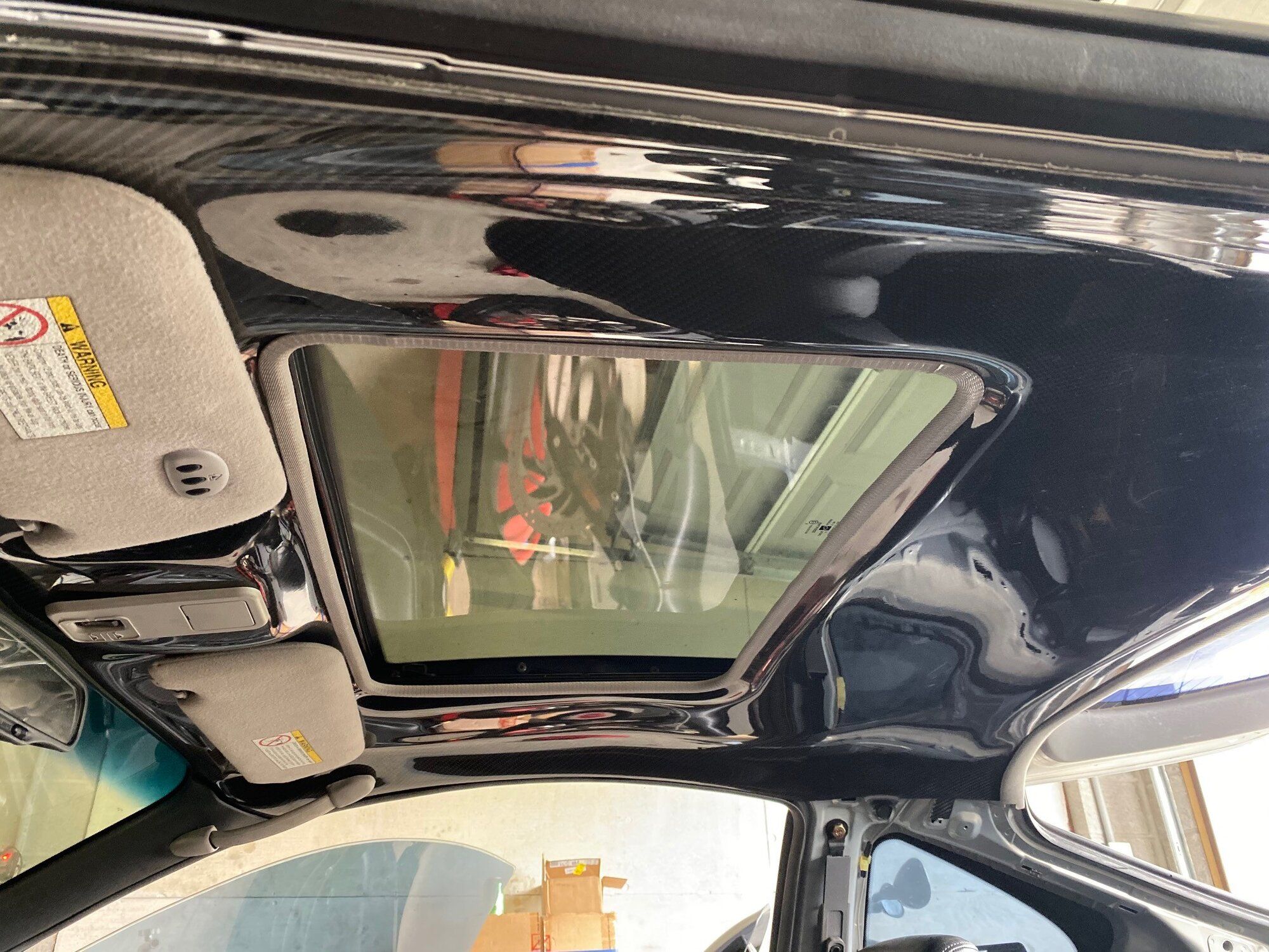

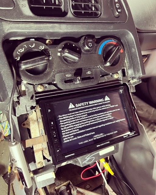

Im back at it! Ive been super busy but now have time to finish this project. I cut out the spare tire section and installed a plate/trim. In the cabin I added a rewired 450 pump, apple carplay/backup camera and a carbon headliner. I am currently working on cutting the new carpet and installing the seats.

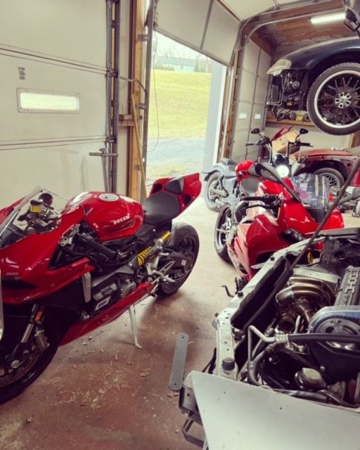

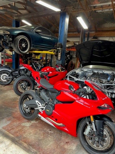

Most importantly I moved into a new garage so I have some space to actually work.
