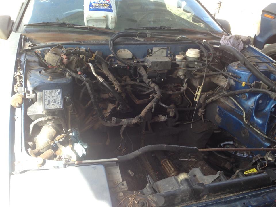

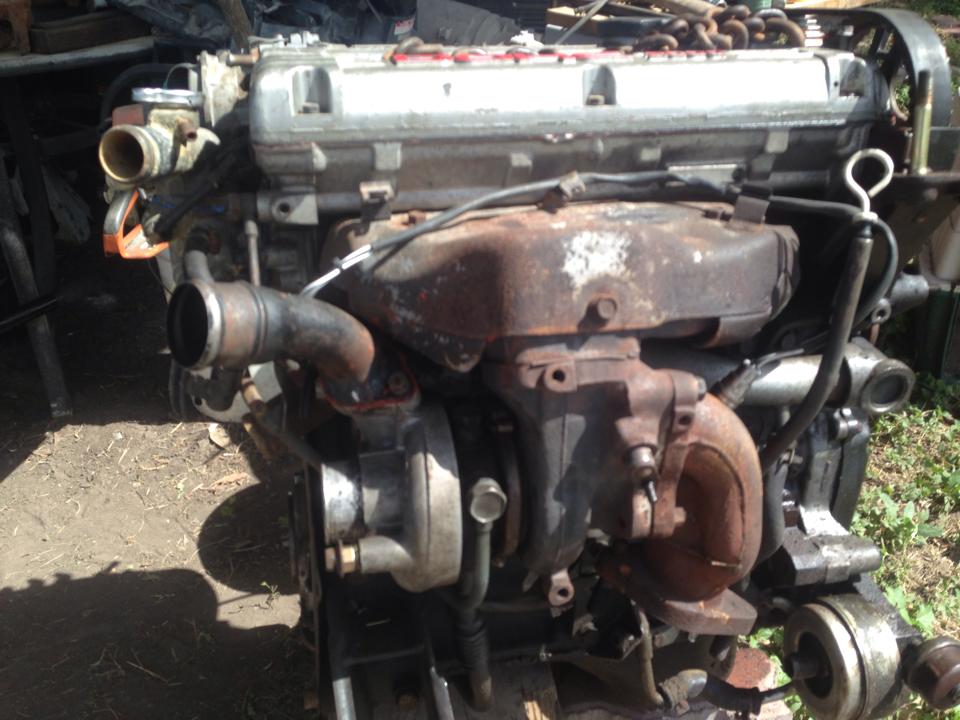

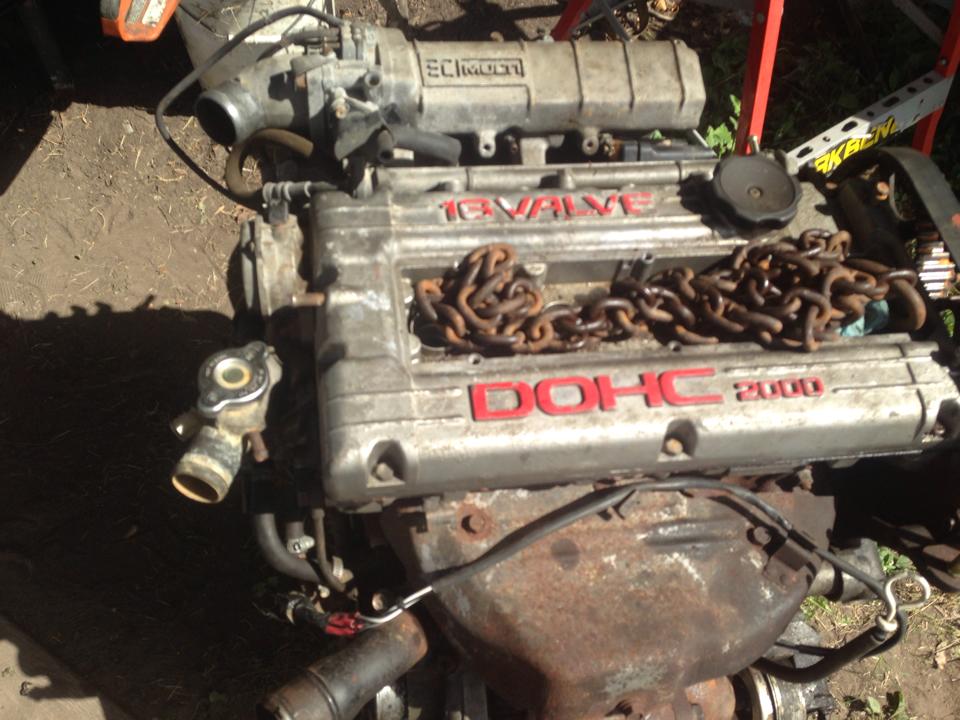

fun week end car that will see the drag strip once a month or so
There good motor mounts, they are much stiffer then stock ones an you will notice more vibration from the motor if you use these. You will need to burn out the old ones and cut out the pressed fitting to get these in. And it's a Plymouth laser not lancer.
