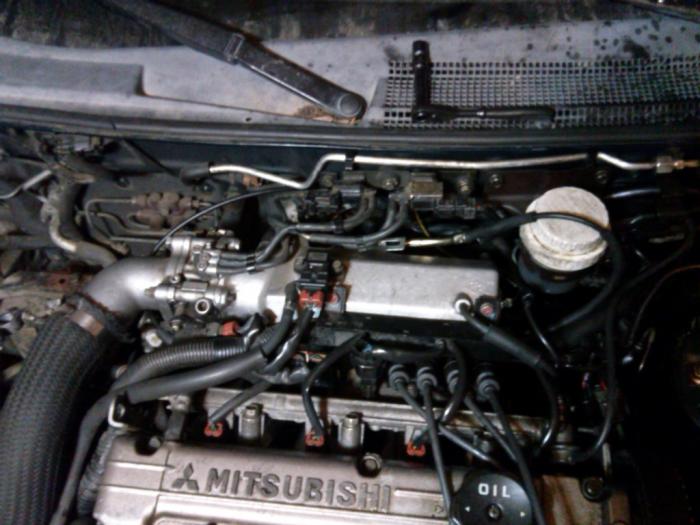

Does it have a 6 bolt or 7 bolt? I only ask because you said "JDM" engine. Mine has a 6 bolt and my CAS turned out to be bad. Had the same kind of starting issues. Replaced the CAS and has been running fine ever since (was back last Sept when I replaced it). You should post some engine pics as well so we can see without needing to ask ;)
If you don't know which engine it has, a pic will let us all know.

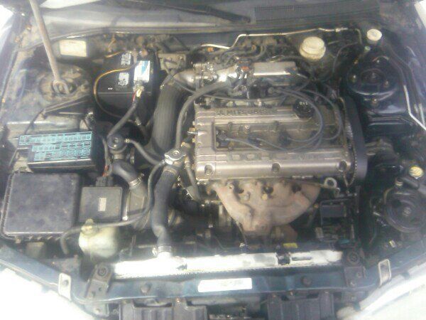

So after I posted this I realized I left out some important things, but I wanted to make sure I had SOME attention at least. I forgot a picture of the engine (7 bolt, by the way) which would also show that whoever had it before me replaced the radiator with a 1G, but just cut and bent the hose to fit. Also, I don't have a very good job so my income is limited. And to answer the other question: I don't know if its throwing any codes because I dont own a reader or know anyone that does.

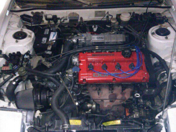

Well as of yesterday, I got the GSX running. It seems to be pretty smoky though. I'm going to take her for a test drive today and see how it goes. But since I got it running, I snapped an updated picture of the engine. One thing I really wanna do is delete the cruise control, since it is very in the way and is cluttering up my engine compartment. Any suggestions on how to do said delete? In the mean time, here's that pic:

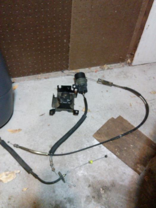

So last night I messed with the Talon a bit on what I had researched could cause high idle. Every time I started it though, the RPMs would jump straight up to about 4500 and would even go to 5000 before I shut it off. Long story short, I found out the PO had not DELETED cruise control, just broken the box and said it was deleted. So it was holding my throttle pretty far open. So I adjusted it before I started the car and it started up around 2000 RPM and was steady. I adjusted the cables at the cruise control box until the engine was down to a nice low purr. I thought I was there and finally had my Talon. The engine was steady idling at about 950 or 1000 and the accelerator pedal was very responsive. I put it in reverse and it backed out of my driveway just fine. I have very bad luck and have learned to counter it by just not taking chances, so I drove it right back up the driveway just fine as well. Still idled right at 950-1000. So I turned it off to see if I could get it started again consistently, since that has been an issue in the past. Just as I thought, I tried turning over the engine and...nothing. It will just crank and crank but doesn't even seem to want to start. But I will put money on the fact that when I get home from work and try to start it, it'll fire right up... :banghead:

Broken cruise control.

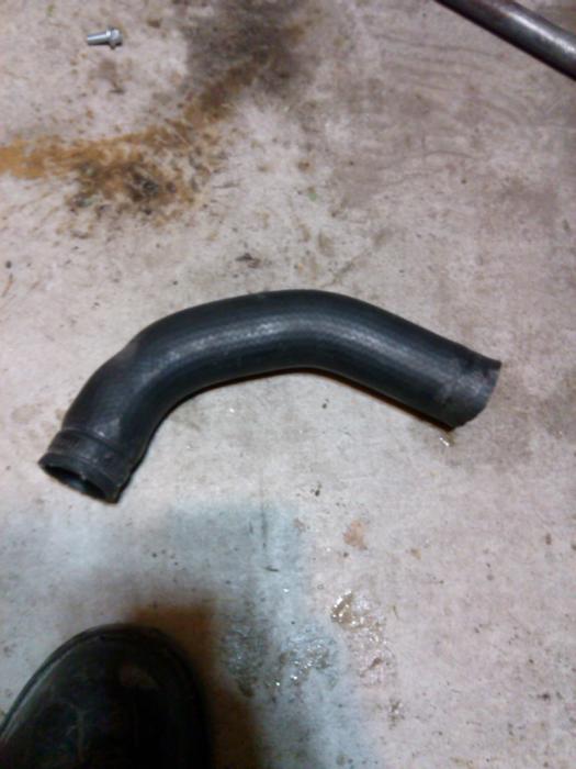

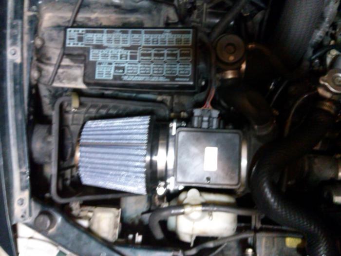

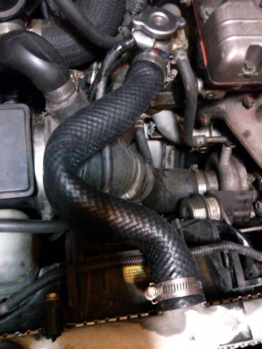

So pretty big update today. I got most of my packages, the only one I need is the one I REALLY need, which is my new VSS. All the other parts I ordered, I received today. I spent most of the day with the lady, then went out to work on the Talon after she left. I started off easy with the air filter and adapter, which proved as easy as I thought. Then I drained my cooling system and put on the new upper radiator hose. Unfortunately, the new hose did not fit as well as I was hoping, but it is a 100x improvement over the old hose. The pain in the ass came from converting the Talon from cruise control to non-cruise control. I wanted to do it right and make it look perfect, so it took me quite a while. But the Talon is now down from about 3 cables to just one. :) Got the tension on it dialed in and it is quite nice. I can not wait to get the VSS so I can get this beast going. Now for the interesting part: the pictures:

Also, thank you for the advice. I was thinking about that, but of course that was already after I'd filled back up my system. I'll do a drain and trim it down a bit, because it is kinked a little. Compared to the other one though, this is great. Do you know if not having a Vehicle Speed Sensor would cause any of the issues I have? Because after I got it in the garage and pulled the old VSS, I can not get her started again. She'll crank and crank but won't turn over. I'm not too worried yet though, since I still need to get the proper gear installed.
