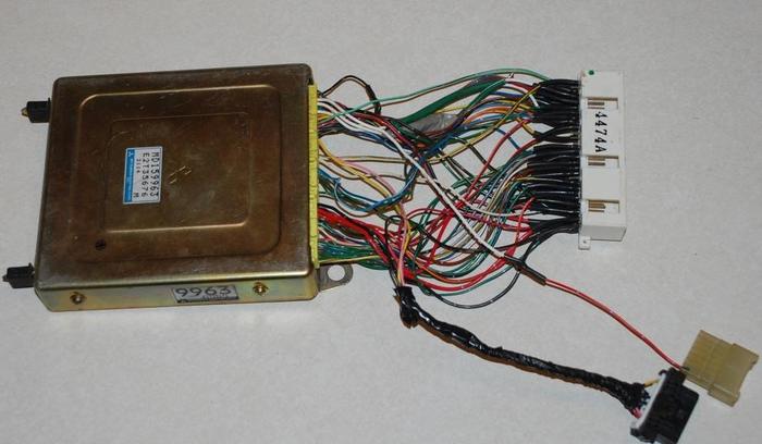

I've found pictures like this: http://www.dsmtuners.com/attachments/evo-8-harness-for-1g-jpg.105305/
That picture shows a 1g harness with a connector hanging off of Pin 79, which I see in the car. It just has a red wire hanging from it. Am i supposed to just cut it off and solder it up to Pin 79 of my ECU? Will that work? Remember I'm 2nd gen... I need to reflash my ECU so I can start the car considering the evo 8 ecu I got will not fire the engine up due to not having the immobilizer disabled.

So again, do I just cut off the connector and wire it like in the picture above??
Actually depends on your year DSM. I am assuming that you are asking because you have a 95, 96 or 97. If that is the case then yes all you need to do is add the the small flash connector into the main ECU harness, no need to solder anything to the ECU just get a spare connector and install it into the main harness. If you have a 98 or 99 that connector is already there, no need to do anything. There should be a how to add 8n the wire needed for rent flashing the ECU in the thread for first flashed DSM ECU thread... give me a minute to look.
