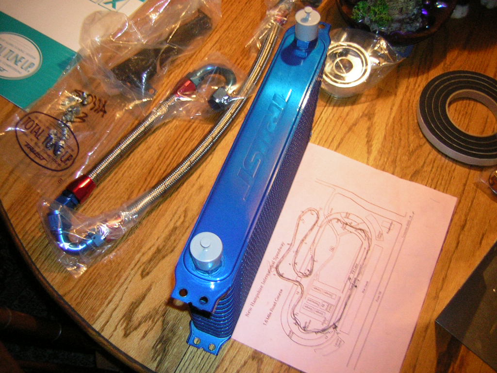

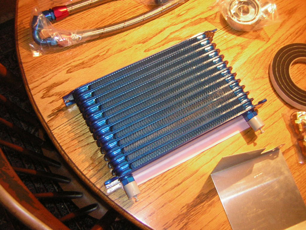

If you're worried about your radiator, you're going to have an even bigger problem with your oil cooling system.
I was hitting 120° celcius at the head at NHIS on oil temps and hit 104ish on water temps in the upper water pipe with a Koyo, Apexi front mount, a modded thermostat, 1.3 kg/mm cap, and the little weenie stock water/oil cooler.
So I went out and blew a bunch of money on a Greddy 13 row oil cooler. Well, actually I had already ordered it but it hadn't arrived before the event.
http://www.syntheticpawn.com/junk/greddy1.jpg
http://www.syntheticpawn.com/junk/greddy2.jpg
