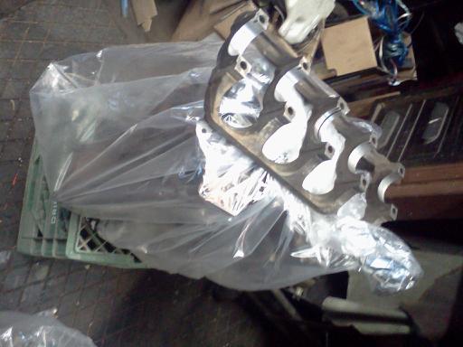

I got really lucky on the internals (wiesco 9:0.1s and eagle rods). since i wasnt racing the car when it broke. I got a fresh crank and had it balanced blue printed, and micro polished with the rotating assembly since i dont think it was done the first time. I also had alot of coolant push issues so i went with a good ol felpro composite head gasket and my arp studs. I ported my head when the motor went together the first time, so i basically had that cleaned up with the block and put back together.

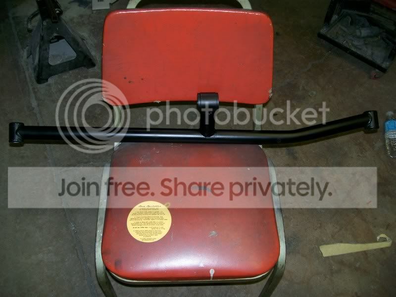

I also have a very custom tubular K member made by a good friend of mine that does very sick fabrication.

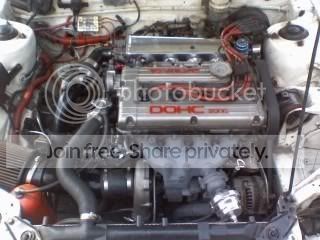

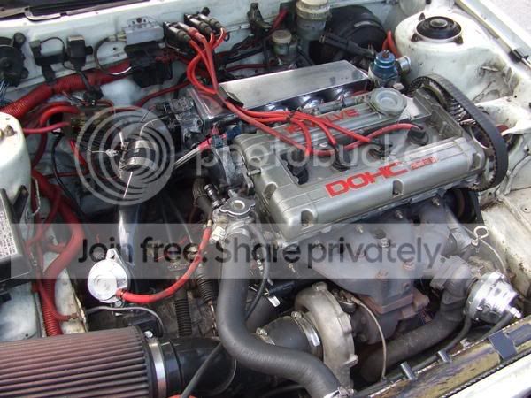

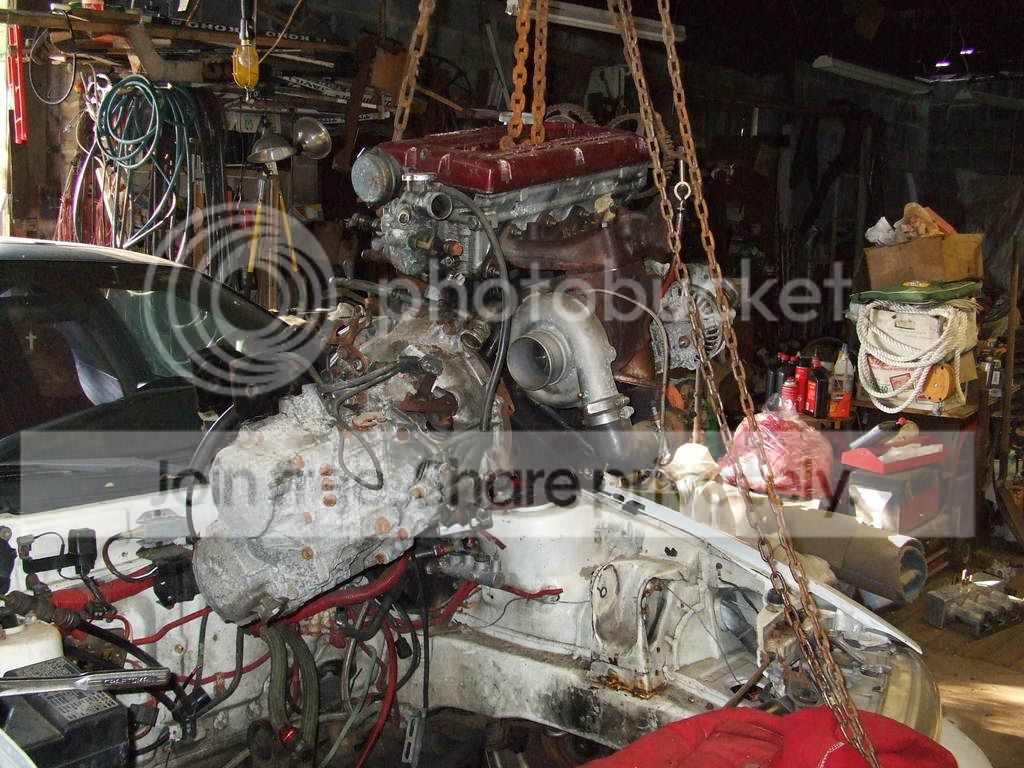

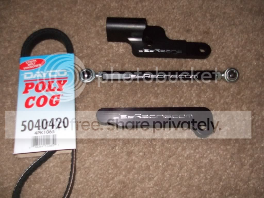

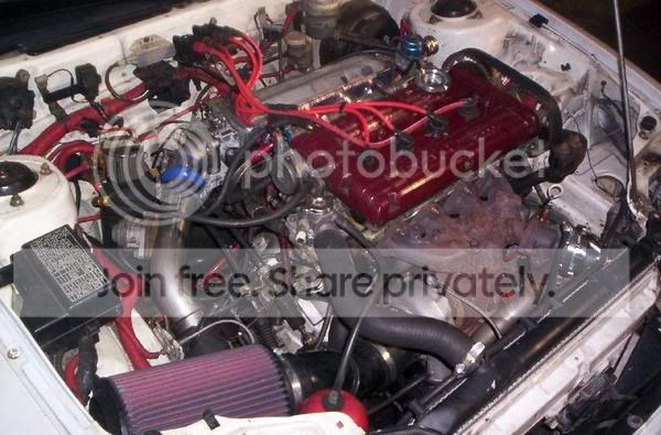

Here some pics, and im going to take some more undated pics of the fluidamper i put on the car acouple months ago, the twin disk installed and what not. Thanks for looking.
Pic is 1-2 weeks before crank broke

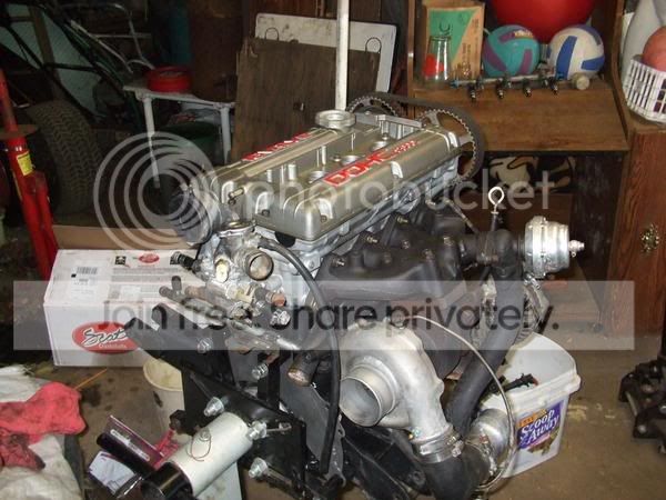

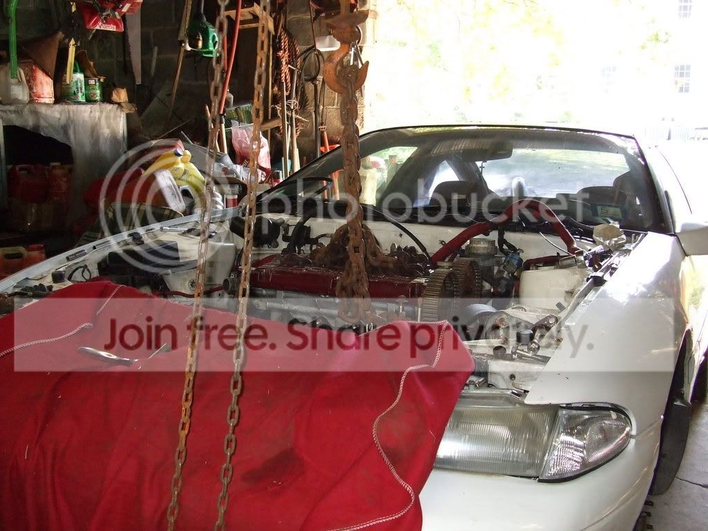

Taking the motor out to fix it. 1 year after it broke.
All fixed a back together. Fresh crank, fully balanced.

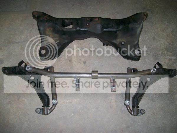

New tubular K-member Fresh
Front bar

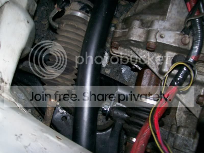

K-member in

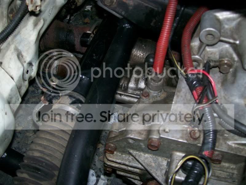

Cleaned some more stuff up, ran harness under the intake manifold. Wired on 2g injector clips (so much easier to take on and off. Relocated the coil pack

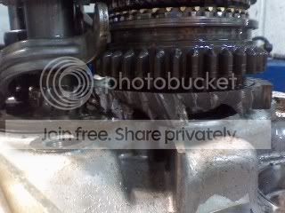

Twin disk installed.

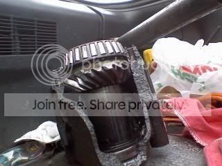

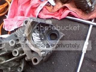

Week later, twin disk carnage
First Gear...well whats left.

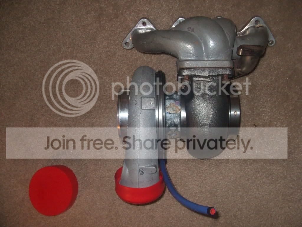

This is whats waiting now. GT4294 1.01 a/r, On Green Performance equal lenth divided t4 CAST manifold. Magnus DOG engagement trans.

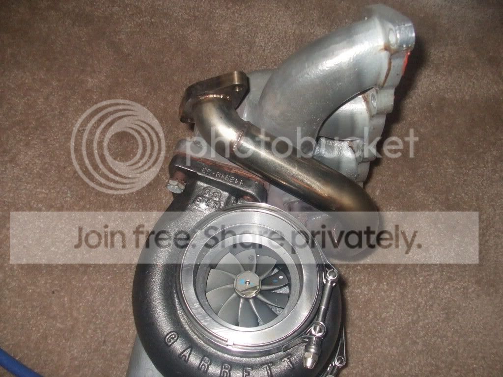

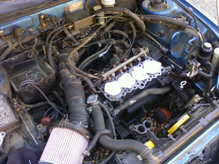

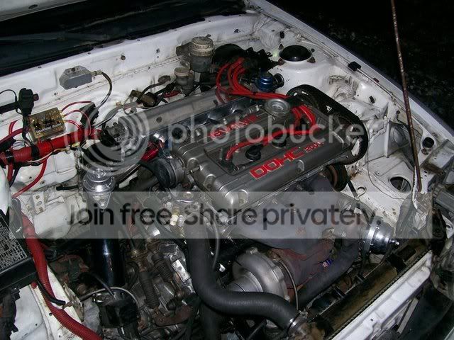

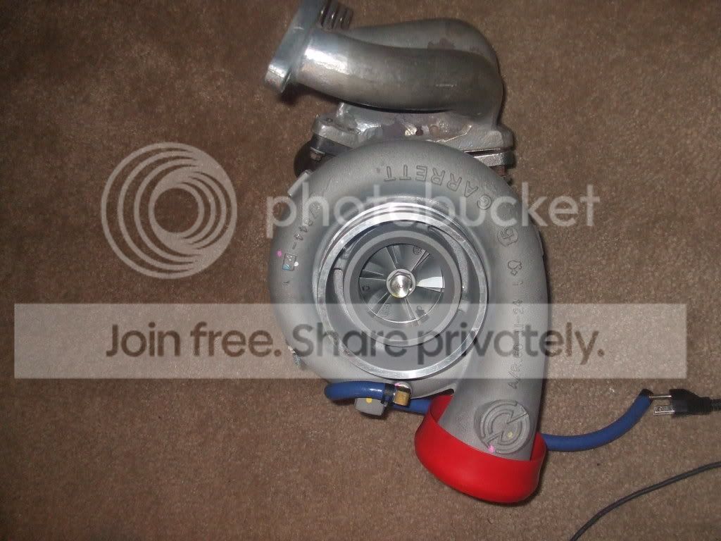

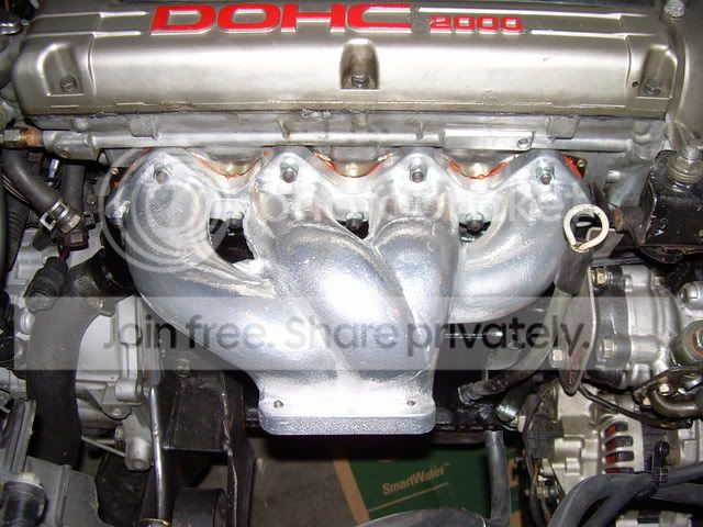

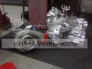

Got my t4 divided 1.01 turbine housing. Looks so good bolted to the manifold. Also have some of the last pieces i need on there way pte 1600cc injectors/ jays racing alternator relocation kit/ 2g vss (so i can setup my aem ems 2 step off the speed sensor so i can load up the drivetrain on the clutch, plus still have a 2 step since it dosent work now unless im on the clutch switch).
