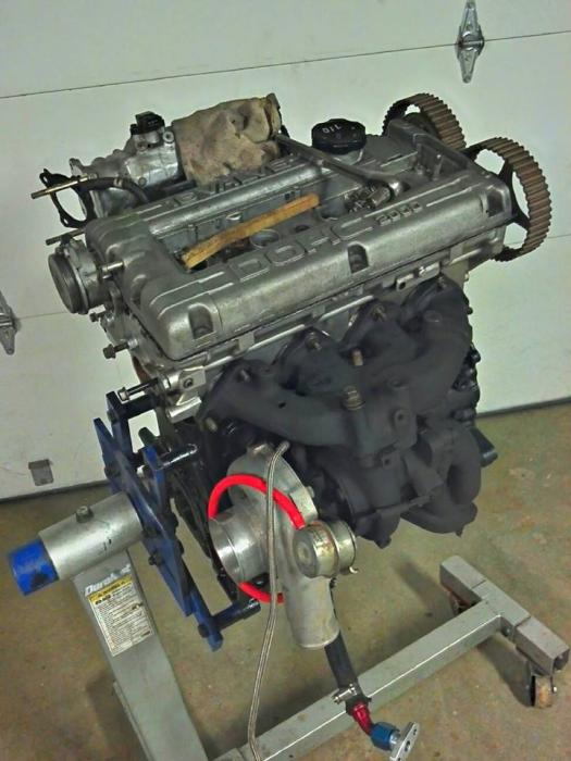

I have a scm5162e turbocharger for it with a 5 knob safc, data logger, and wideband for tuning with stock injectors. Before I turn up the boost I will purchase an ecm tuning computer and run my 880cc injectors.
Does anyone have any experience with this turbo? I hear it doesn't like high oil pressure and as a result begins to tear itself apart above 28psi, any stories with this turbo?

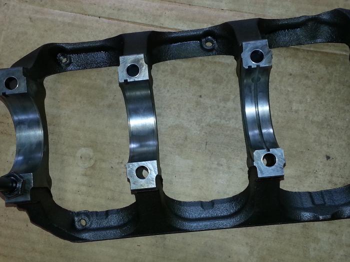

Got the balance shaft removal bearings in and the main cap dowels pins installed. Was a little worried that I was going to have to send the main cap to the machine shop to get the dowel pins to fit. Good day!:D

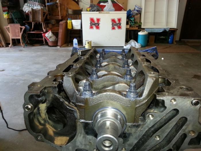

Put the crank in, spins smoothy, end play measured about .005 inch.
Next the arp rod studs, wiseco rings and everything from then on out is basic bolt on stuff.
Thinking of the rings I forgot to mention that I did hone the cylinder walls.
Measured the crank before I torqued the main down. The main journals on the crank measure 2.226 (stock is 2.244) and the rod journals measure 1.76 (stock is 1.77) Since I bought the crank new and was not told its measurements I assumed everything was to oem spec. Have to order new main bearings .010 over-sized. So with .008 of "play" between the crank and the main bearings (which is within spec) I'll run thicker oil like 5w/50 but how unhealthy would that be for the rod bearings? I really don't want to spend more money at the machine shop.
