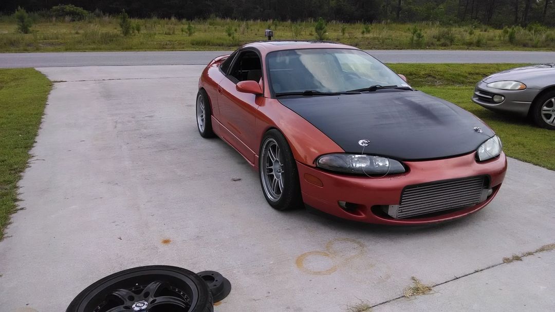

Which 3g rear susp parts did you use? Anything need to be modified?
The upper and lower control arms are a direct swap. The rear way bar I removed from a v6 3g, I would recommend using the 3g endlinks. The swaybar brakets holes have to be opened up a little to work.
The trailing arm and toe adjustment are the same. All my parts were for the 3.0v6 3g.

Curious, is there a significant advantage to using the 3g components?
The only real difference is the Rear swaybar(FWD Platfrom only), its larger. Other than that the components weigh a little less. Not much of a gain, but gives a nice tubular look.
Stock GST swaybar- 13mm
3g V6 model swaybar- 19mm

Test fitting for this weekend, have to raise the car and get it another alignment.
