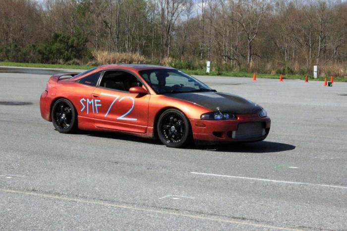

Here is my current set up.
3g rear suspension with the 19mm 3g sway bar. My BC coilovers were set to 8 front and 10 rear, spring rates are 670/335.
My alignment was set to
Front left------------------Front right
Camber -1.8-------------Camber -1.8
Caster 5----------------Caster 4.2
Toe -0.02------------Toe 0.01
Rear left-----------------Rear right
Camber -1.2------------Camber -1.2
Toe 0.07------------Toe 0.06
Front brake had Wilwood Ploymatrix D pads ( Thanks Todd at TCE for recommending them)
Rear brake had posi quiet street pads.(evo8 brembos)
Today was the first time I used this. My turn in was alot better than my last set up.The slalom had a bit of oversteer. I didn't have any understeer at all.( could be that i didn't over drive the car) I was able to accelerate out of the corners better than my last setup. I was a bit skeptical about the BC coilovers, they helped alot over my old KYB GR2 with the Eibach sportline springs.

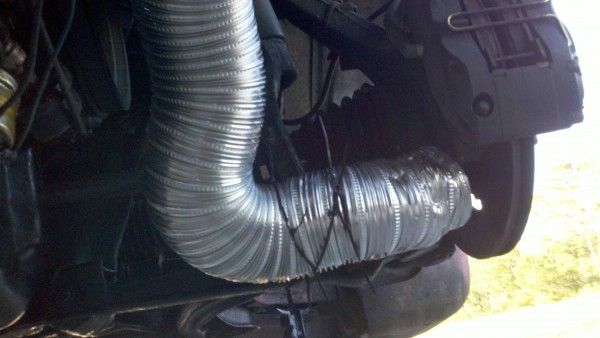

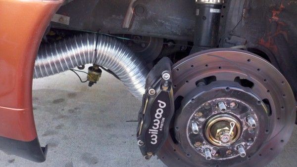

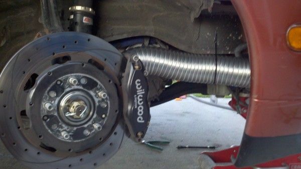

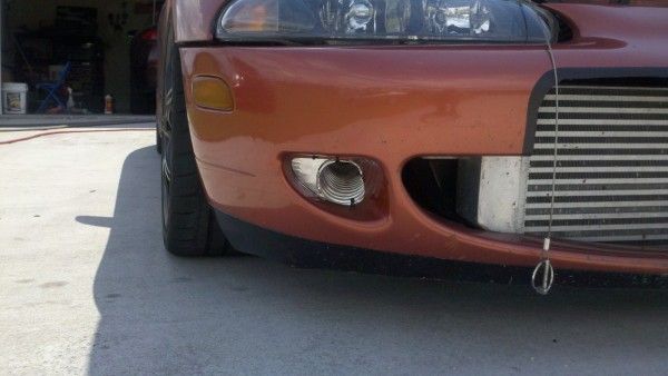

I may need to do some brake ducting and or change pads again.
My brakes were sticking a bit on my fifth run, and after my sixth the were sticking really bad. Took little over a hour to cool down enough to drive home. Not sticking now. It was just the fronts.
