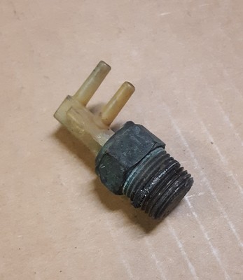

~78k km on the dash and the gearbox and engine run just fine, buuuuuuuuuuuuuut has a little coldstart problem as it dies (gotta hold it at 1,8k RPM for 2 mins and the idle is fine and doesnt have any problems anymore). Replaced most of the ECT-sensors already but i am still looking for one specific one (this one:)
(i have no idea whats the name and/or use of it is, so if you know what it is and maybe where i could buy one, that would be lovely) and im am looking to buy a new idle switch (no, not iac or idle regulator XD) (its located next to the trottle body if i remember correctly).

The item you have pictured is a thermal valve for the emissions system, that opens and closes a vacuum line with temperature- If it's broken hopefully the lines are plugged.
I see several online here in America at least:
New:
Used:
I have a spare one as well, marked with number MD103867 that may or may not be identical to yours. Can you read any numbers molded into the plastic on yours, or is the main plastic piece broken off?

I'll have a look for the parts, now that i know the names, but they seem to be very rare, since i wasnt able to find them before. The other two "copies" of the car (lazer and talon) werent really sold at all here in Germany so i can only get Mitsubishi Parts (and Mitsubishi is a TINY brand here aswell), therefore parts are very hard to find. Thanks for the offer! But before i would import 2 sensors from the states, ill look for them here :D
All the lines are completely undamaged (might change them in the future anyways, since they are probably 30 years old and it would be beneficial to replace them) and the idle stop switch is plugged in.. might only be internal damage since its getting voltage (if i remember correctly, but ill check later).
My english isnt the best, so i have to ask: What do you mean by "If it's broken hopefully the lines are plugged" regarding the thermal valve for the emissions system... You mean that there is stuff in the lines, not allowing air to flow correctly, or do you mean that they are still plugged into the sensor?
@wparks is meaning that if that sensor is broken, it could be a vacuum leak since the hoses that go to it are working vacuum for the engine. If the sensors plastic tips were broken it could be running lean if it has a vacuum leak.
