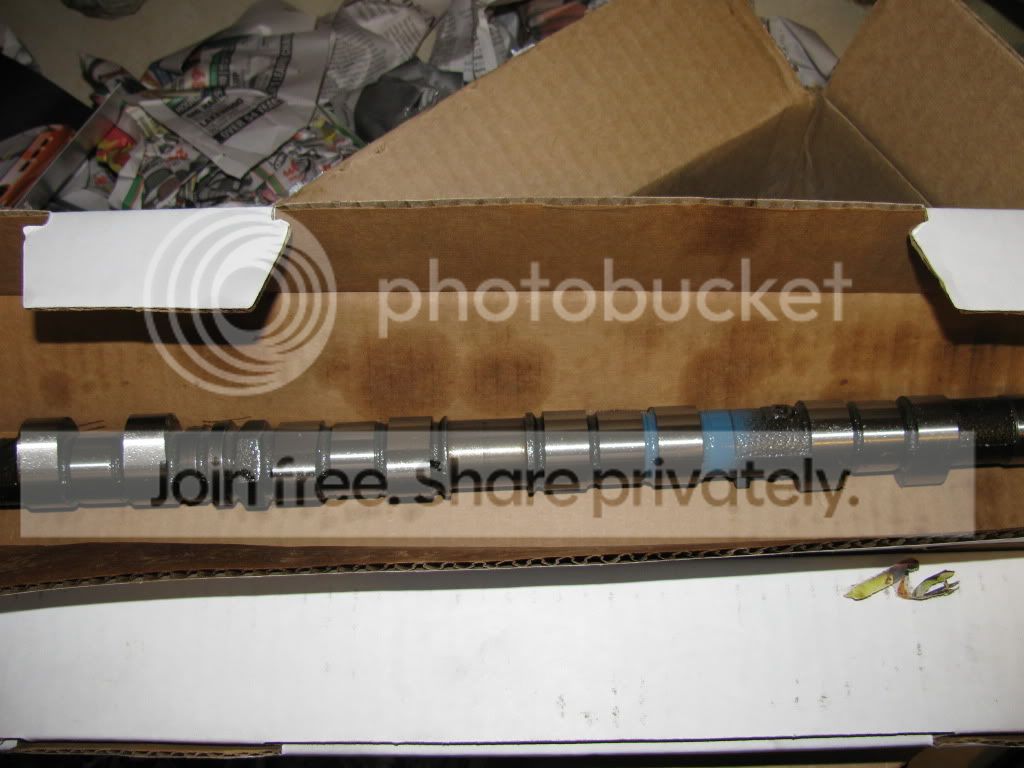

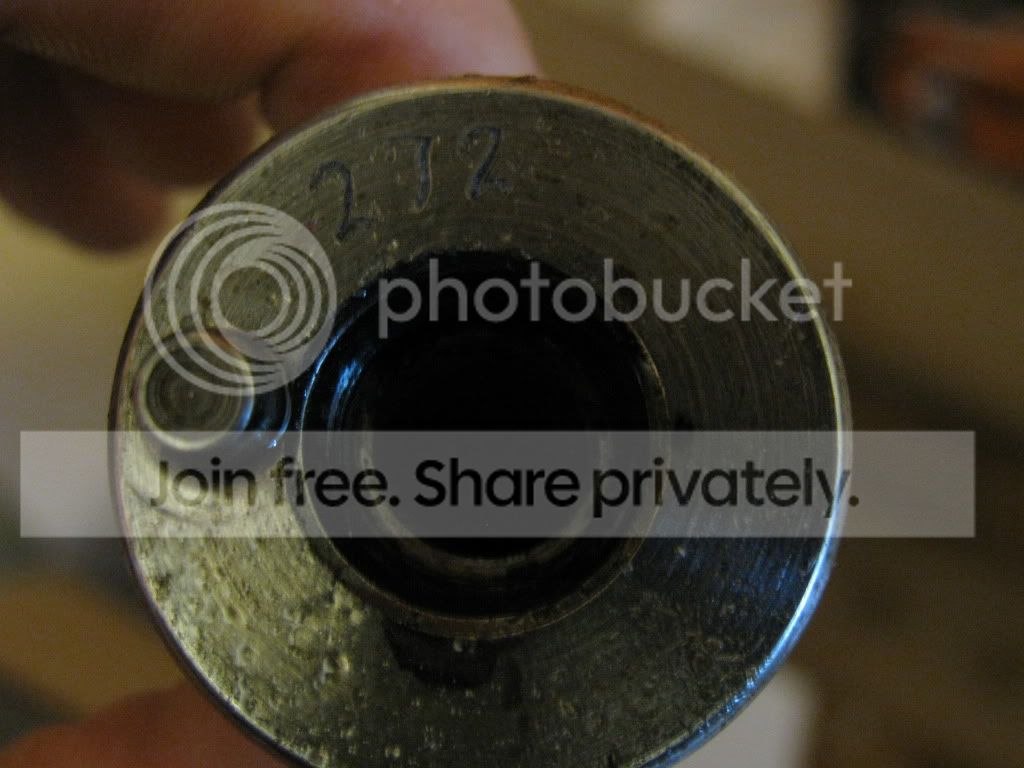

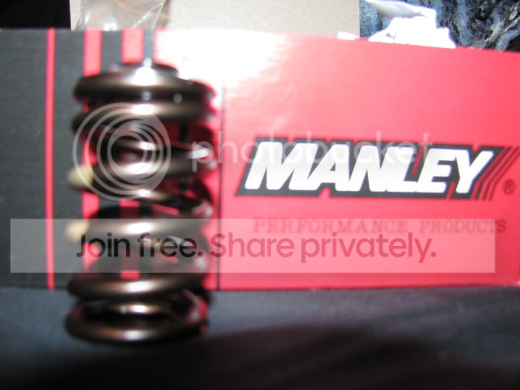

I'll also be having Manley springs and retains installed along with Delta Camshaft 272s.

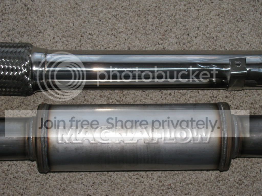

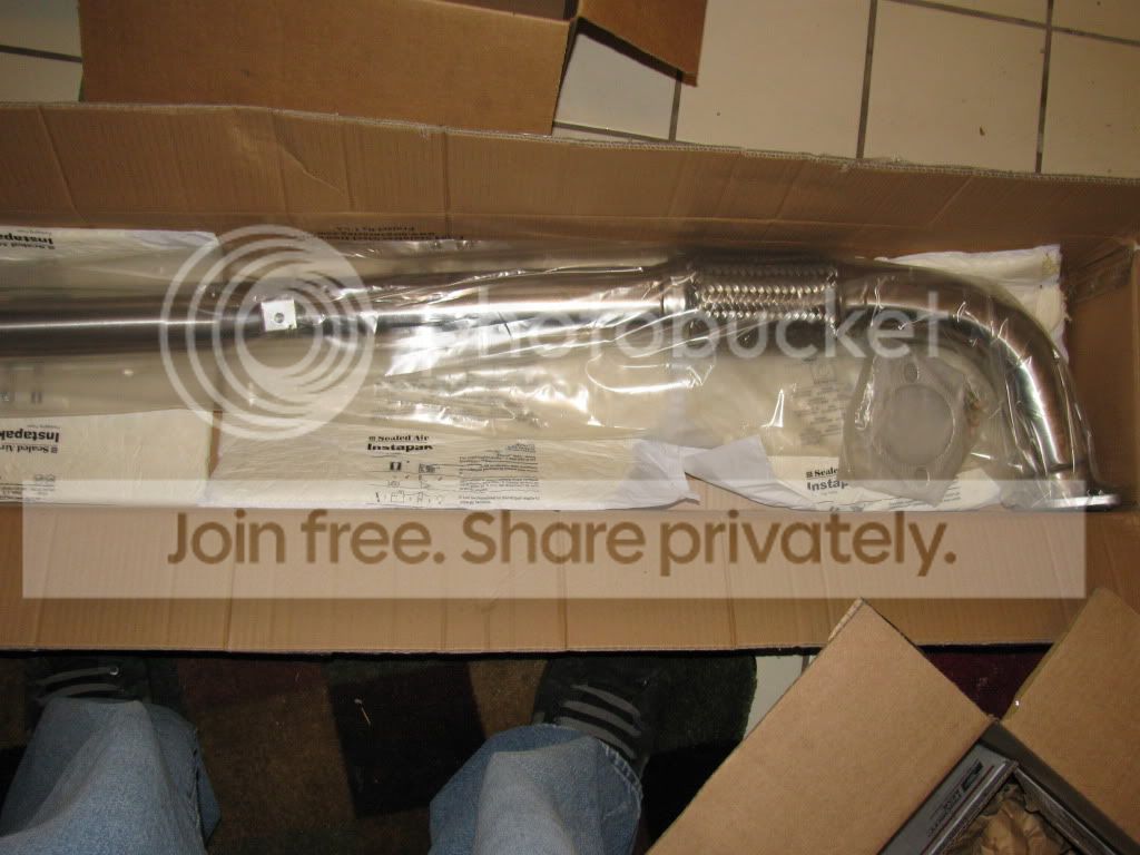

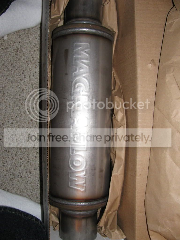

). I ordered a Megan Racing downpipe from one of our vendors (Thank you again) and a Magnaflow muffler (Part #12867) as well.
I'm going to be reusing most of my current parts from when I built my exhaust which includes 2 resonators, high flow cat and Magnaflow part #12298. I'll be having the shop do the work which will include chopping the MRDP to weld in the cat. and put on a v-band at the end. The catback will consist of the 5in round muffler, the 2 resonators then the dual outlet exhaust. Shouldn't need much straight pipe being AWD. I'll have the muffler painted black with polished tips.
Megan Racing AWD Down Pipe and Magnaflow muffler.

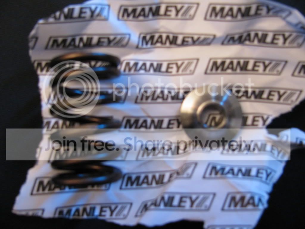

Hopefully this will drasticly reduce the noise and maybe get rid of the 3k drone (if not lower the dB of it). I want the performance 100% but with a lot less noise for comfort reasons. I also got 272 Delta cams to throw in and Manley springs & retainers so I can be safer with my build and have the extra power/rpm range when I throw on the HX40.

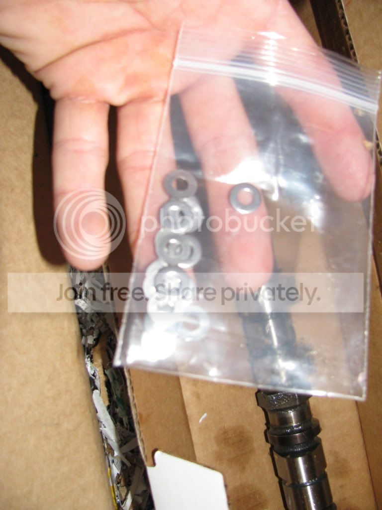

Shims

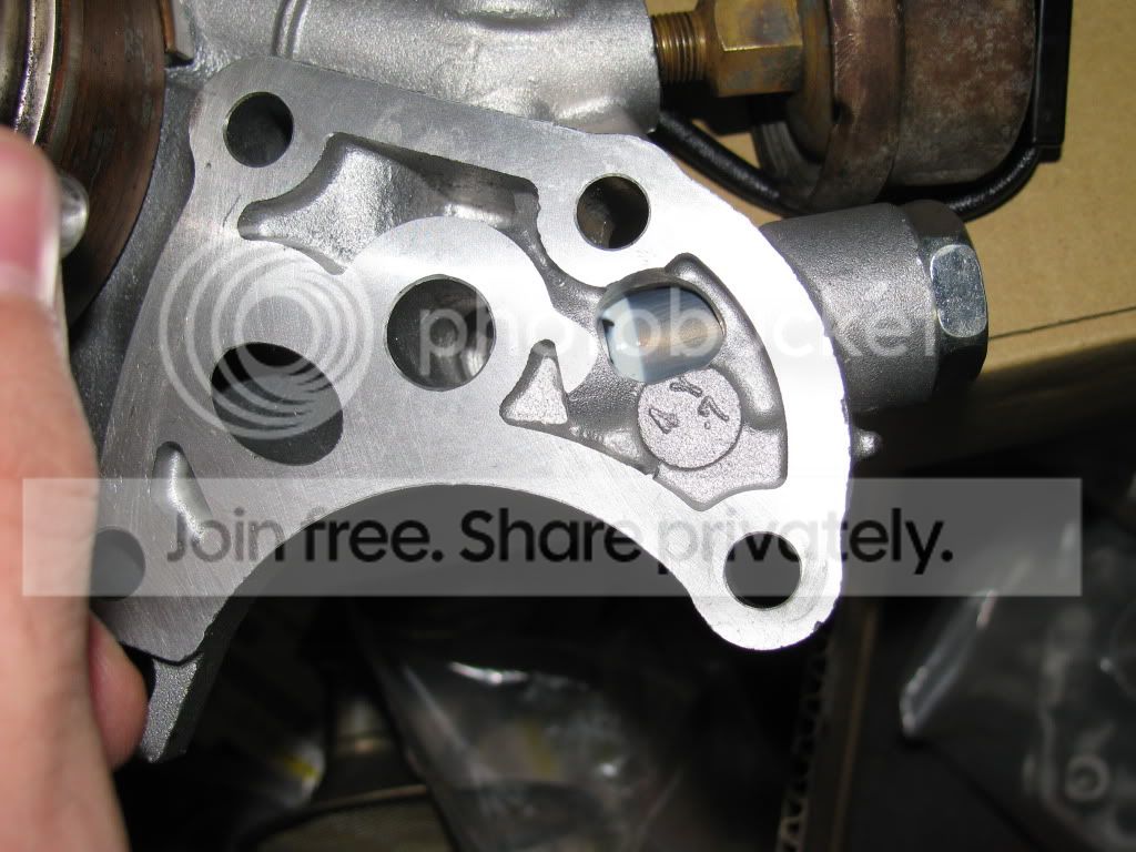

I also got a new oil filter housing (OFH) and decided to go with the water cooled housing. Since I have my balance shafts removed, I went and ported the oil relief valve as well as stated in the previous entry. Here is the picture of the final product.

). I ordered a Megan Racing downpipe from one of our vendors (Thank you again) and a Magnaflow muffler (Part #12867) as well. I'm going to be reusing most of my current parts from when I built my exhaust which includes 2 resonators, high flow cat and Magnaflow part #12298. I'll be having the shop do the work which will include chopping the MRDP to weld in the cat. and put on a v-band at the end. The catback will consist of the 5in round muffler, the 2 resonators then the dual outlet exhaust. Shouldn't need much straight pipe being AWD. I'll have the muffler painted black with polished tips.
Shims
