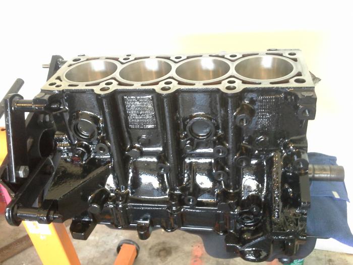

The shop I took to is a performance Machine shop. He asked me if it was gonna be a dd, drag car ect. If it was gonna be turbo charged and how much boost I was gonna run. He was also checking all the tolerances.

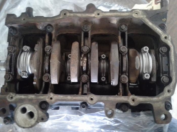

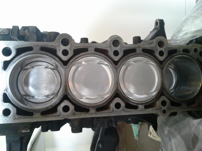

Finally got my block back from the Machine shop. It ran me $670 washed, bore and honed, crank grinded, crank polished, ACL bearing kit main and rod, balanced, and assembled short block.

Wow. That's realy not a bad price. What's the name of the shop you used? There arnt any around Shreveport with sending to
