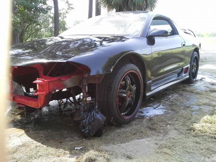

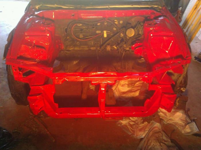

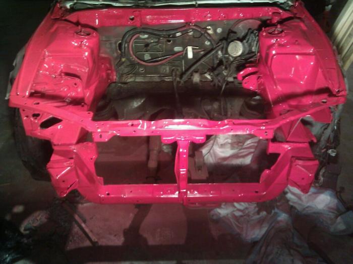

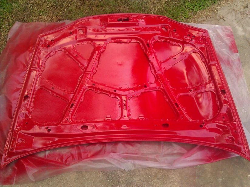

First coat of paint.

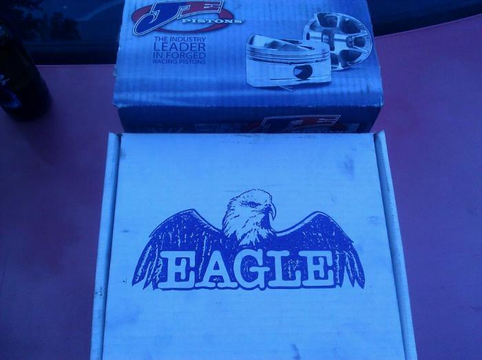

Got my pistons in today! I've had my rods for a while though.
Hopefully the block will be going to the machine shop in a couple of weeks. Gonna have it bored, hot tanked, balanced, crank re ground,
Your pistons would of looked better had you bought them off me, but beyond that, everything is coming together nicely

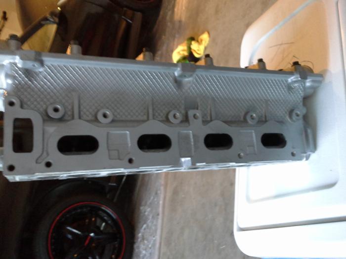

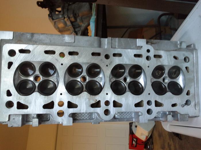

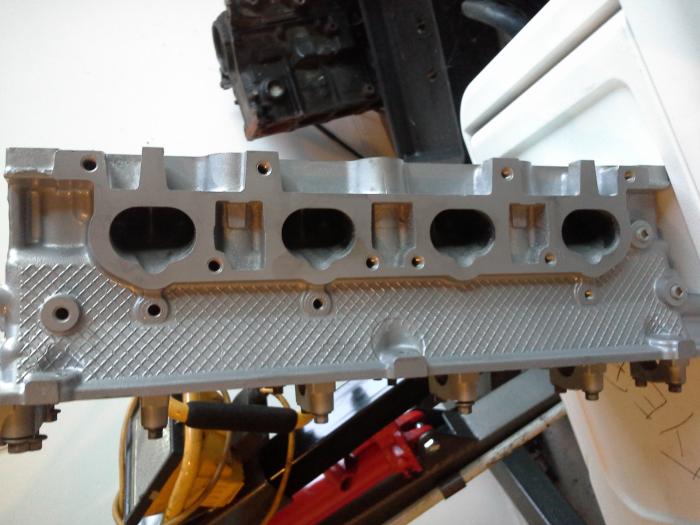

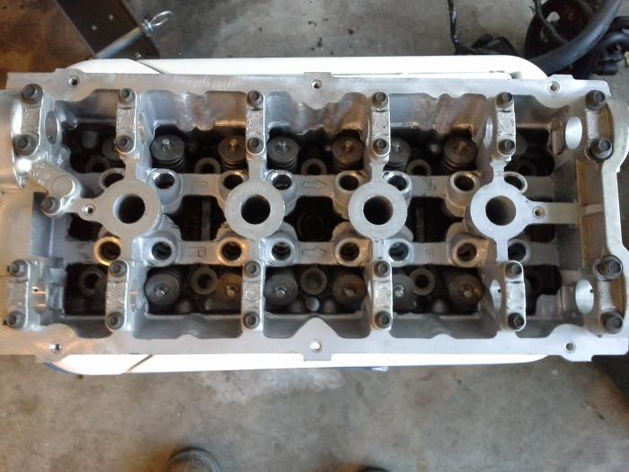

Sent the head to the machine shop yesterday to get a valve job and resurface the head. Picked it up today 200 bucks for the job, just gonna run a shock head for now. Gonna hopefully send the block to the Machine shop within the next week or so. Here are some pics.
Not gonna lie, the head looks like it had a really crappy resurface job done, especially for a mls hg. U might wanna send that back and tell them to hit a 20ra or better, u might have sealing issues otherwise..
The other option u have if u want a stroker is a cloud car block swap. Grab a 2.4 from a stratus, cirrus or breeze and throw the dohc head on it.
Other than that, looks good so far. Good luck with it
