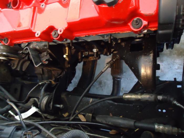

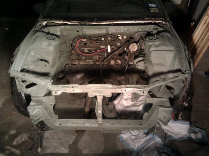

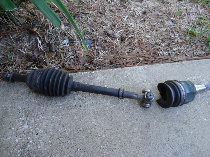

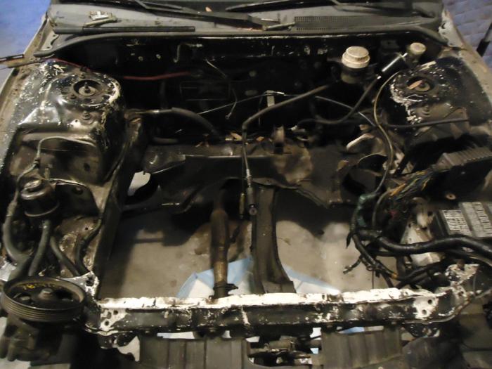

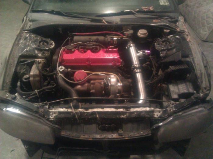

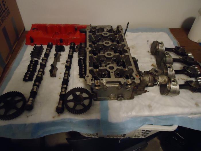

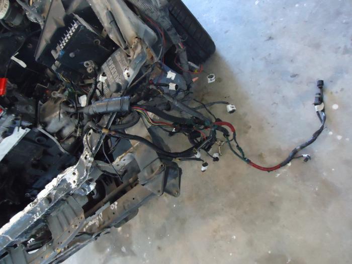

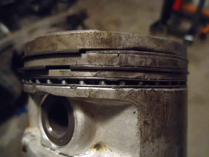

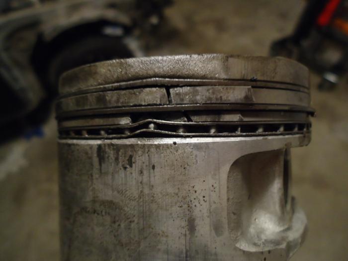

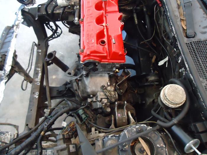

The motor is ready to be pulled ,ive gotten everything disconnected and out of the way as you can see from the pics below. Next weekend ill be buying a engine hoist to pull it. When the motor is out I want to strip the engine bay and re paint either black or white not sure yet. One of my cv joints fell apart after taking it out, yeah it was bad as you can see but ill be geting all new cv joints, control arms ,wheel bearings, and coil overs. Well here are a few pics ill up date when the motor is out.

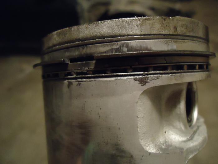

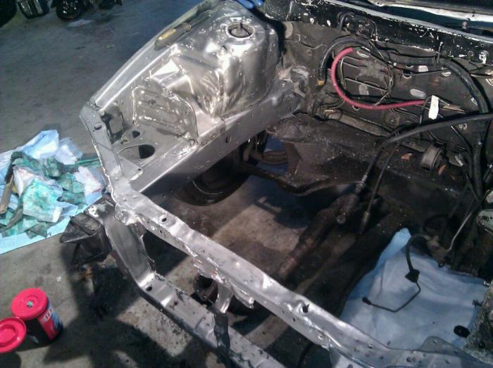

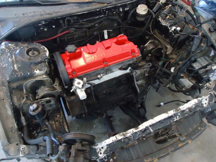

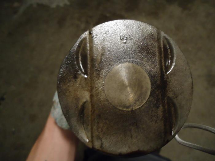

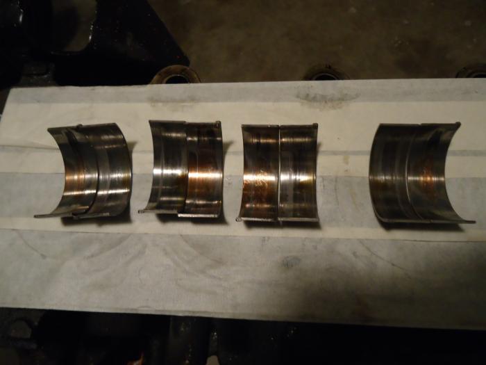

So I've started striping the paint from my engine bay, its comming along pretty good. I'm gonna primer it gray then paint it red. I also ordered my pistions last week JE 8:5:1 should be here some time this week of next. I already have my eagle rods, when I get the pistions my block will be headed to the machine shop. Ill update with pics later.
looks good! i also am putting together my turbo 420a. i think i read up that the je pistons have some piston slap to them, i went with the wiesco low comp pistons. eagle rods. arp main studs. Also it looks like you were running the ic pipes from the turbo to the tb. How much psi were you running when it blew?
Yeah I've read that to but also read that wiesco break. The gauge read 12psi 3 wot and smoke everywhere think it had to do somtning with the fuel to air ratio
