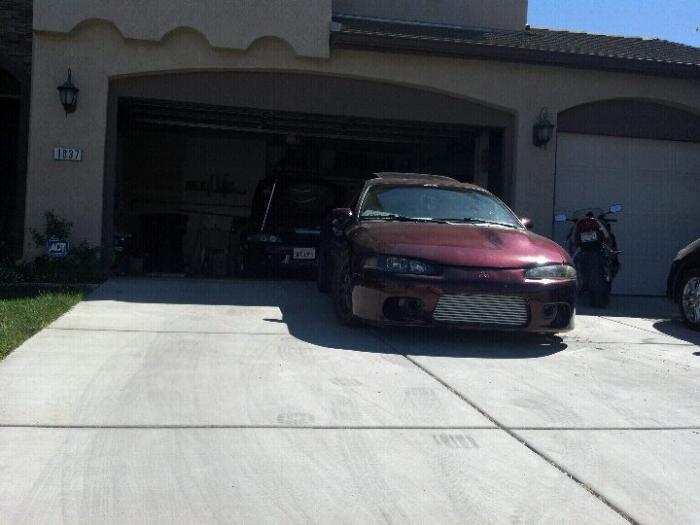

Hey DSMers,
This build is a In Memory Of Brandon Stamper, He is my best friend. i met him a few years ago in high school, we had auto shop together. we both clicked pretty well together. He was into motorcycle, so am I.
Brandon actually hated any imports for the longest time, he thought that every import was just like every honda he sees around town LOL, till he rode in my DSM (99GSX). he fell in love with them. after i graduated highschool i move to Sacramento to attend UTI. He was still going to be a Senior. while i was in Sac he became my motorcycle mentor and i became his DSM mentor.
1 year later he graduated highschool and i graduated UTI and moved back and on that same day he went and bought himself a 97 GSX. on the way home from purchasing the car it spun a bearing. thats when we began to plan a build for the car. about one month later on 9/15/2012 i was having a graduation party for graduating UTI. on that same morning we pulled the engine out of the car. he looked like the happiest guy ever LOL. while we were at the party he decided he wanted to get his jeep.(he Brought his Motorcycle (CBR929)). on his way to pick up the jeep he got cut off by a elderly lady and t-boned her. Brandon Stamper was pronounced died on the way to the hospital that day.
the day of the funeral his mom asked me if i wanted to finish the build. i greatfully said yes. we had a car wash fund raiser and made shirts for him and took any profit to the build.
The plans with the car are going to be about 300-400awhp. DD

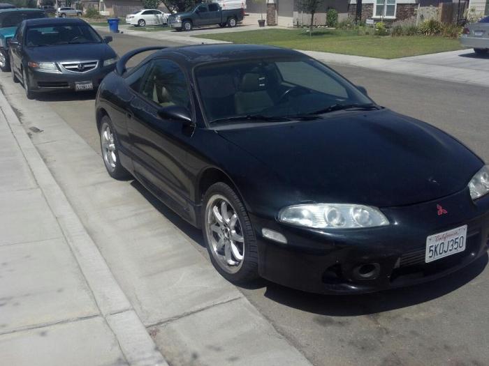

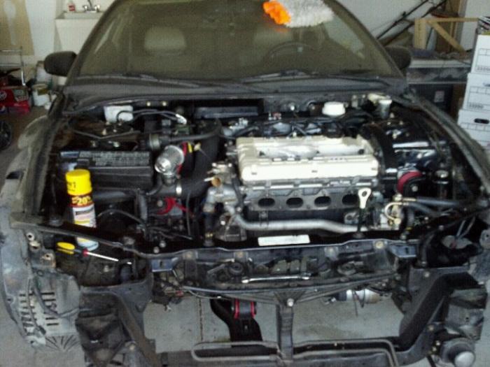

here are some pics of the car form when he got it to how is sits now

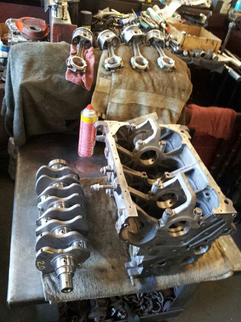

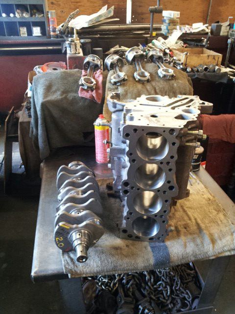

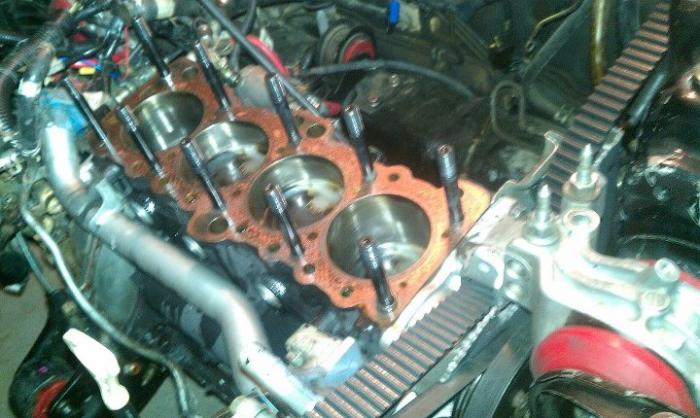

some info on the block:
.020 over.
new 10/10 crank
evo9 aluminum pistons with graveyard upgraded rings
1g big rods with race bearings
decked and honed
all hot tanked and cleaned
block painted black
b/s elimination kit

hey guys not to much going on right now with the build but thought i would do alittle update on it :)
hopefully it will be shifted into overdrive and my goal is to get it running by the end of feb.

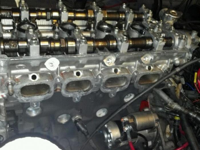

right now the head is at the machine shop and will be getting ported/polished, valve job(1mm over), decked, tanked/cleaned, and pressure tested.. i decided im going to go with the Delta k272 for the cams and not to sure on the valves/springs, but ill figure it out soon LOL.
the short block is pretty much built already.

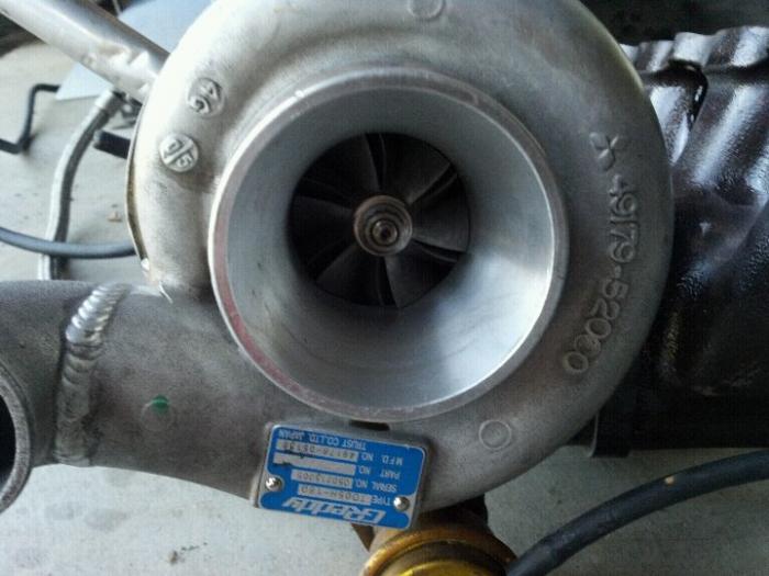

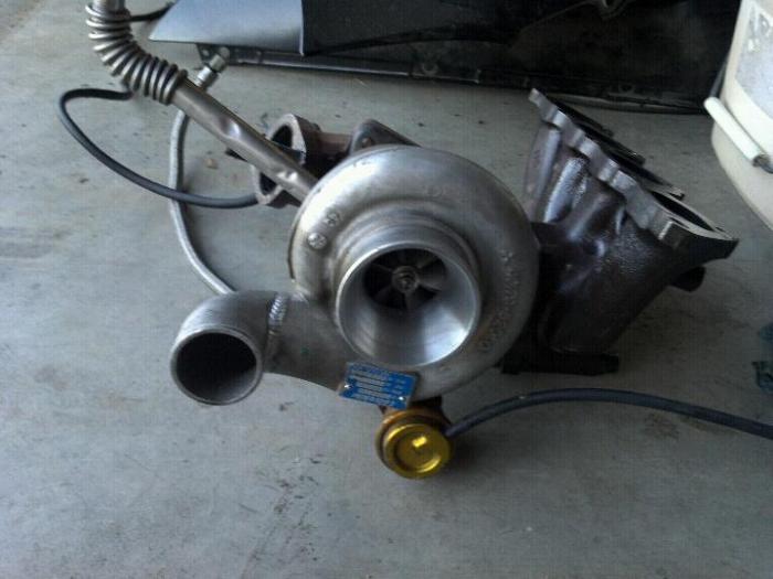

next i will be sending out the turbo, exhaust mani, intake mani to a buddy in sac so it can all get ported/polished and have the turbo rebuilt.
im trying to post 3 pictures of the short block but it keeps say i exceeded my quota for my memory or something like that. ill keep trying but till then have a nice day :) :dsm:
sup guys.. so the plans have changed i am now going to go with crower 272/272, they actually came in today:) and yesterday the adjustable cam gears came in so finally i can put the head back together once the springs come in.
oh and i got the flywheel in and resurfaced. i went with ACT
once i get all that done the engine should be ready to put back together once i find the bolts to the oil filter housing, flywheel, and some other shit LOL :ohdamn: they have to be somewhere in the garage.
so one i find out how to post more picture i will, i have yet to still figure that out ahah

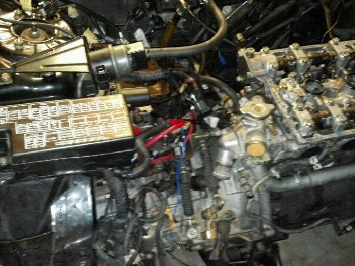

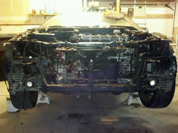

so just a small update on the car and where it is at.

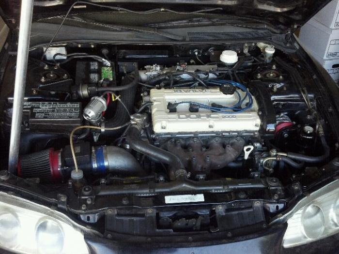

about 2 weeks ago i finally droped the engine and trans in, but ran into some problems. the car before had a 2g CAS with a 2g CKP. snd in the process of pulling the motor in the begining the CKP snaped into pieces. :ohdamn: and it completly slipped my mind that it broke and i would need a new CKP if i want to run stock ecu for a while, till i save for the dsmlink. i only noticed that we didnt install the CKP in the new block after it was in the car. :banghead: so my options now are to either buy a new 2g CKP and have to pull the timing belt and everything back off to put the sensor in or just save up for the 1g CAS and DSMlink and just get it over with all at once.
and ive decided to go with the 1g CAS/ DSMlink route.
but on the bright side all the car needs now is
plug in sensors
fluids (tans, diff, coolant, transfercase, ect..)
run vacuum lines
intake manifold gasket
1g CAS
DSMlink
and she shall live once again :thumb:
