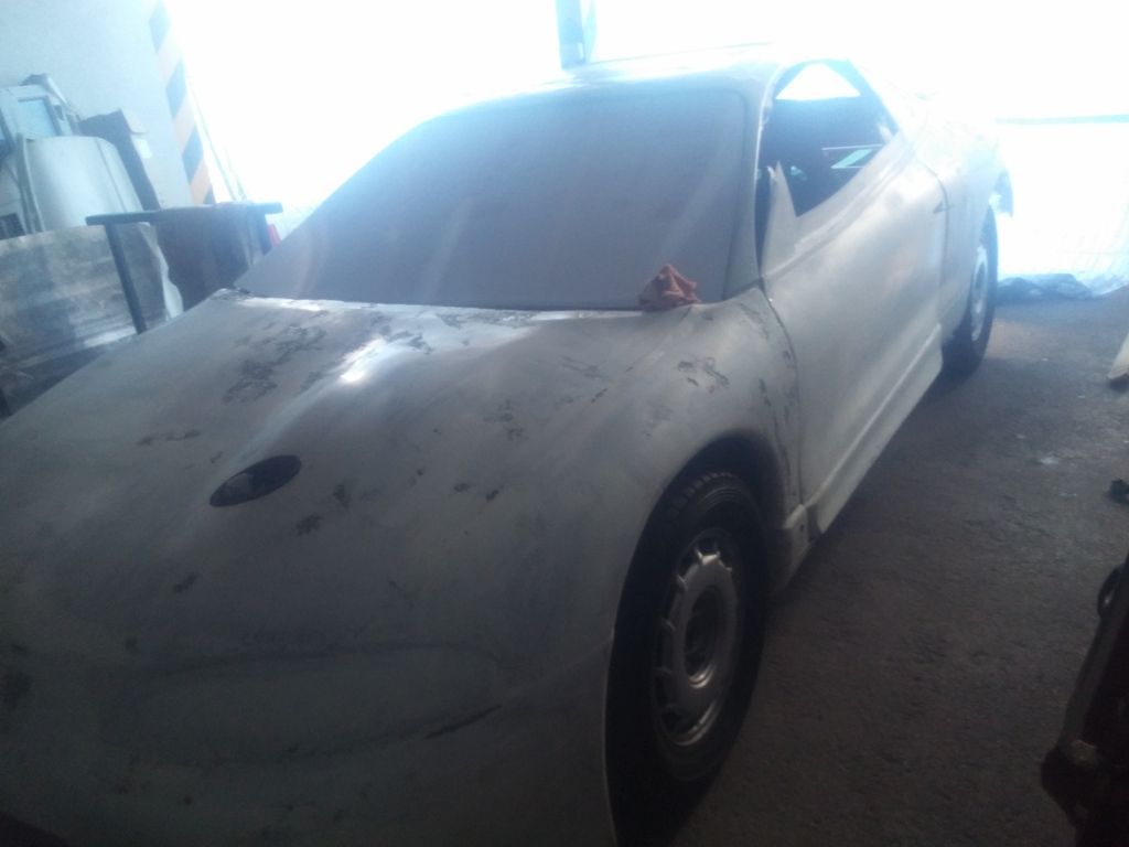

Meanwhile in Czech republic part2 2015 build/FIBERGLASS 2G SHELL/ LIGHTEST 2G Auto AWD attempt
That glass is the ta-tas. I'm dying of itchy ness just thinking about that though.

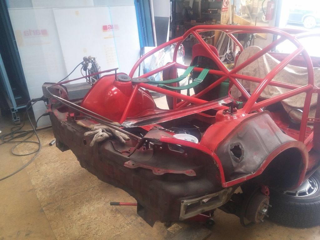

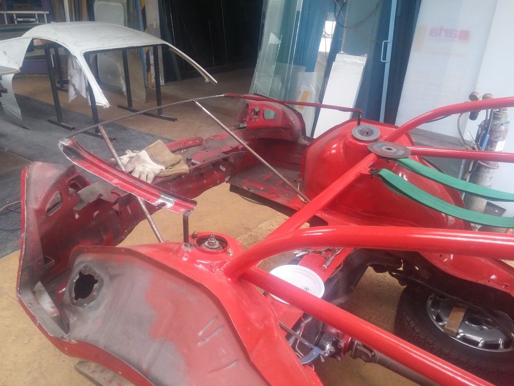

Why did you reuse half of the chassis?
umm sorry but dont understand what you sayin in first sentence/ my english :(

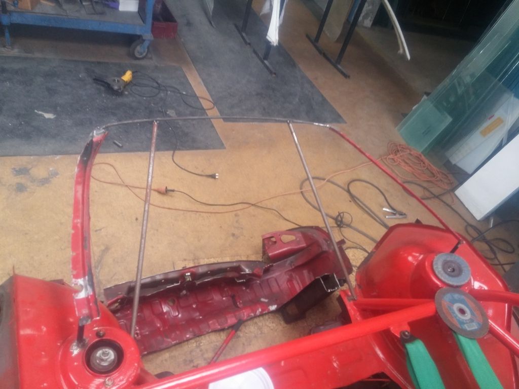

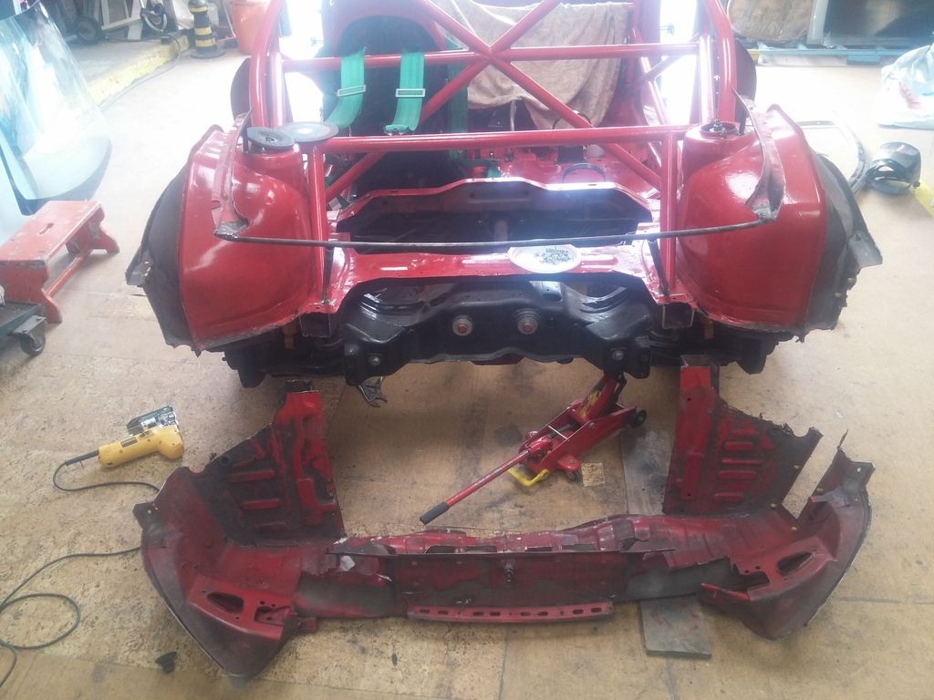

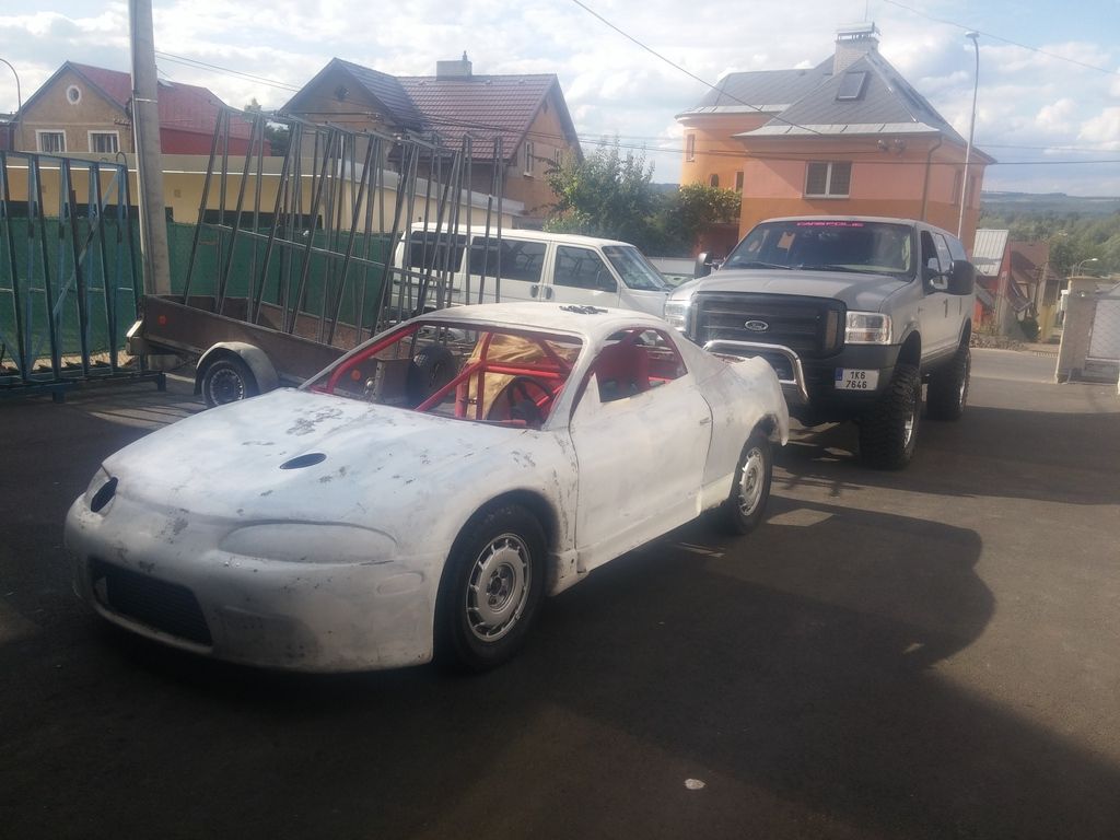

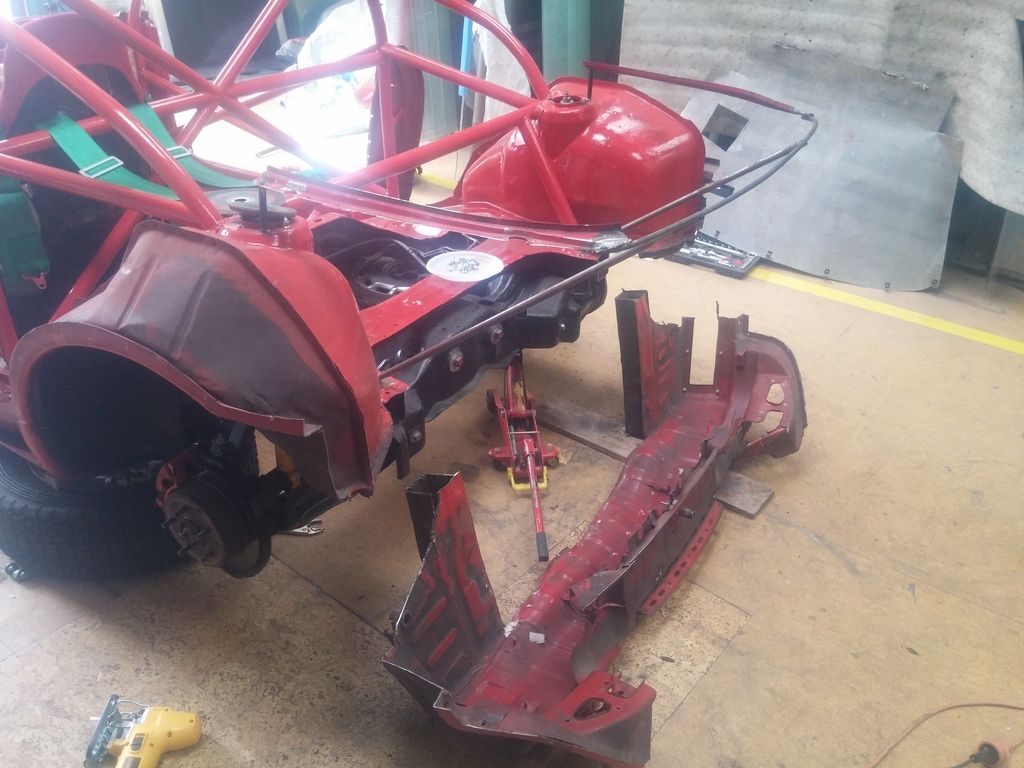

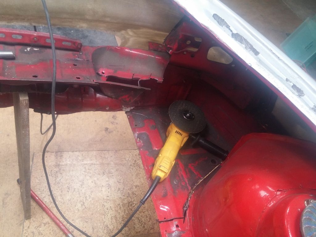

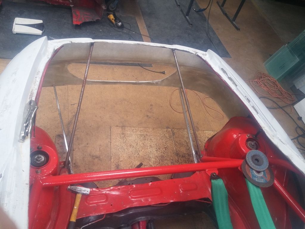

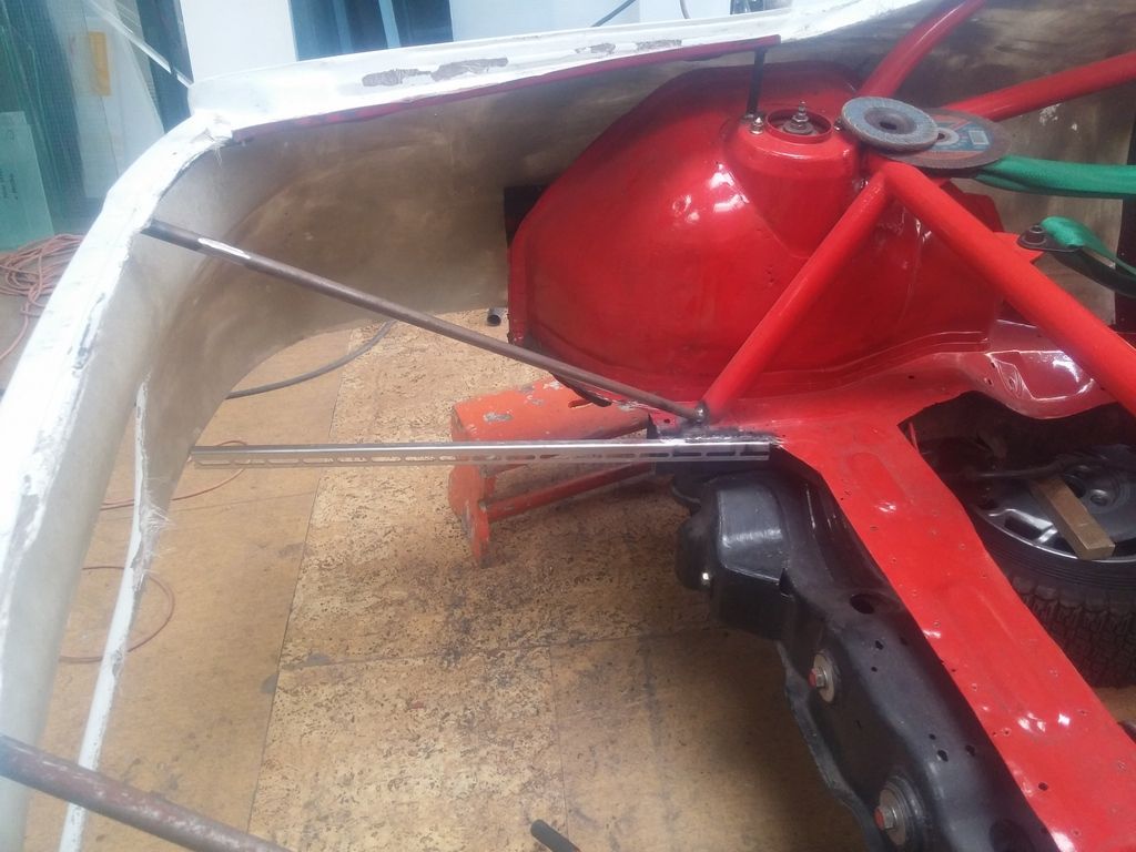

anyhow, why Iam using floor w firewall.. basically..Iam One man show and working every f_cking day after work since 1.1.2015..hadn´t free day since...time is flyin and I dont have the options to build complete tubed floor chassis.. Thast my target for next seasson.. Lastly.. Iam going cut out whole rear cargo w tail light wall.. right after subframe mounting point:)

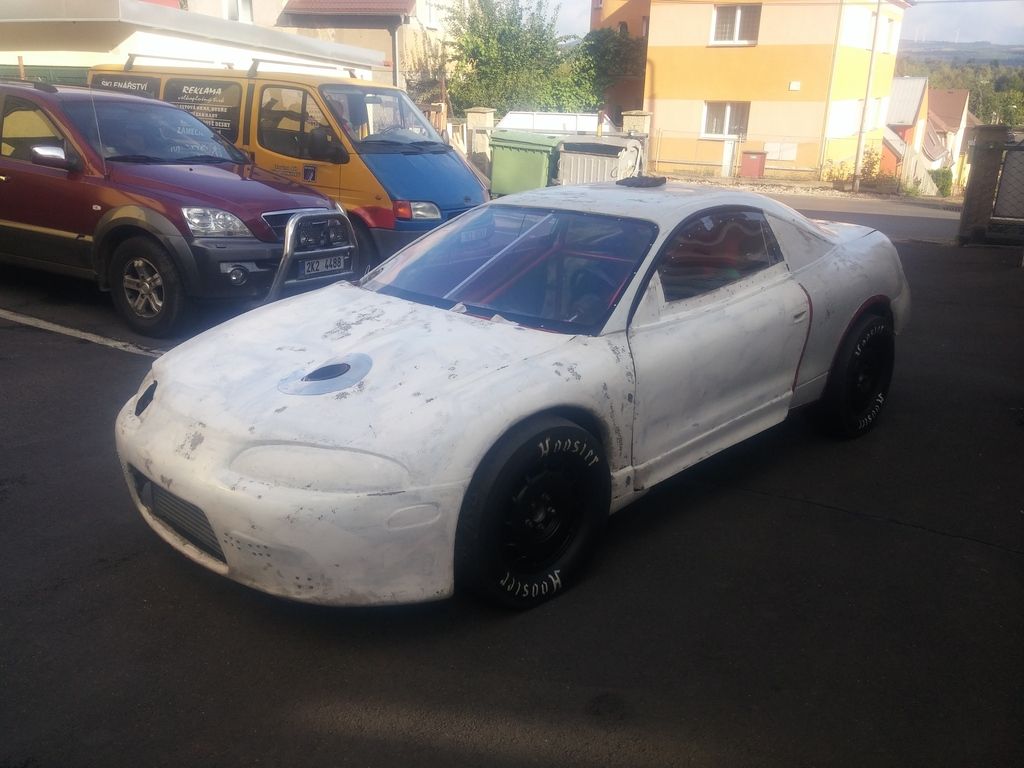

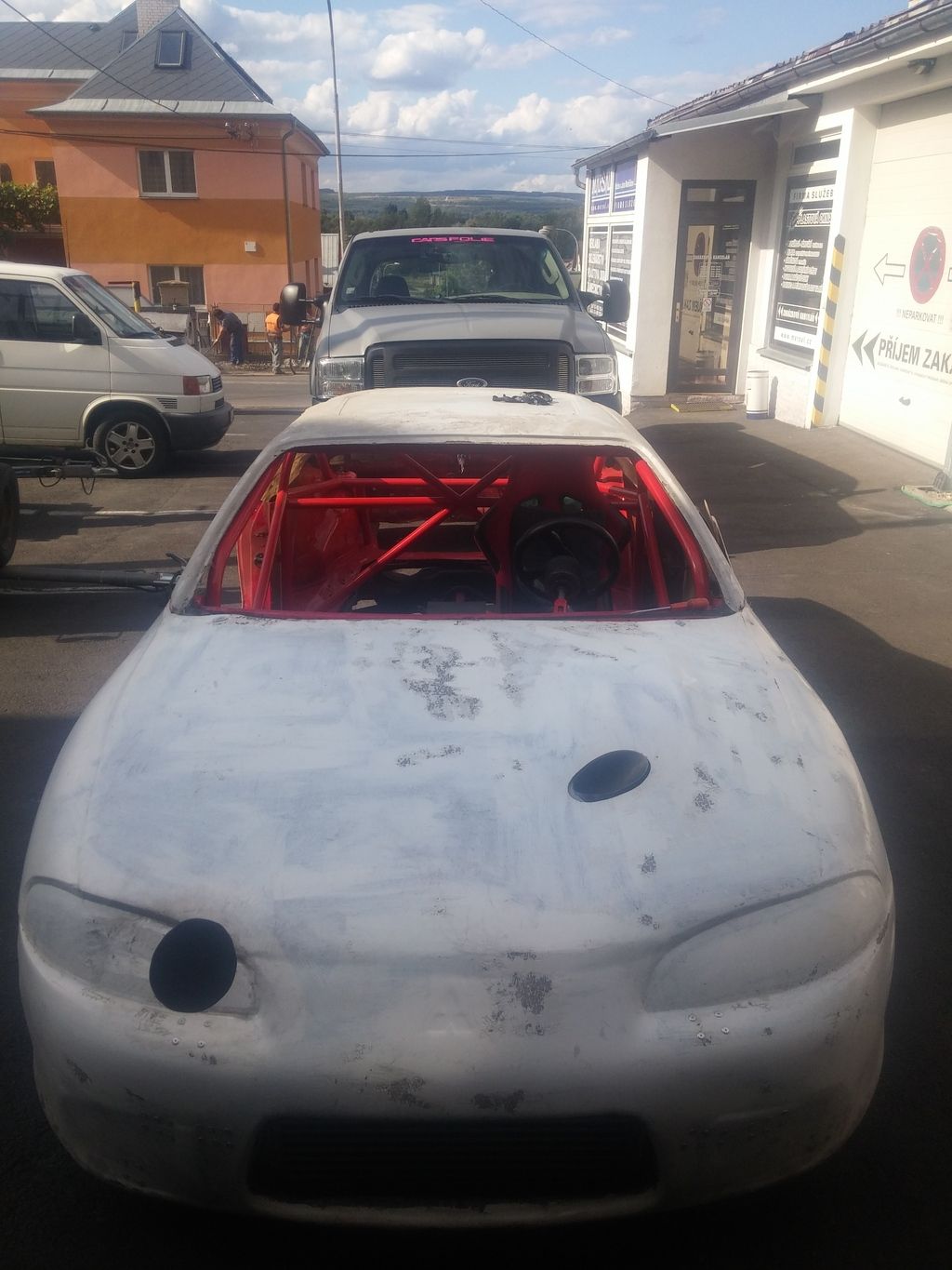

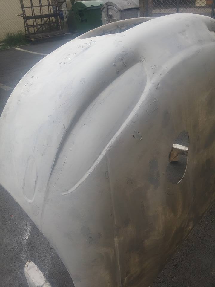

Sadly we had some crappy gel coat at final products and we got huge wrinkle on like 80% surface.. gotta spend day or two w finishing and sanding..But overall it was cool ..except all the sanding work o all the molds...
Awesome build its coming so far i would be so scared to just chop my car up like that LOL
Thanks, well.. its just evolution.. Got the car since 2003.. With welded center diff.. no PS, spool up over 4k rpms w A/T ..its pretty anoying drive it in small city..lots of tight turns and car/center diff just hate it..so you feel bad.. That way wanna push it to its limit without compromise :)

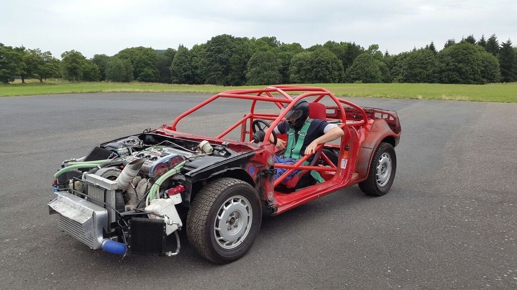

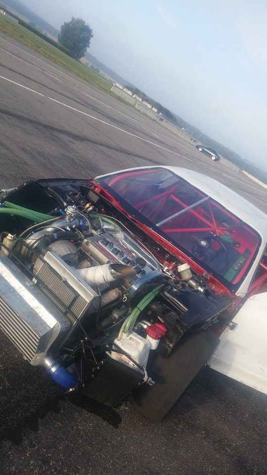

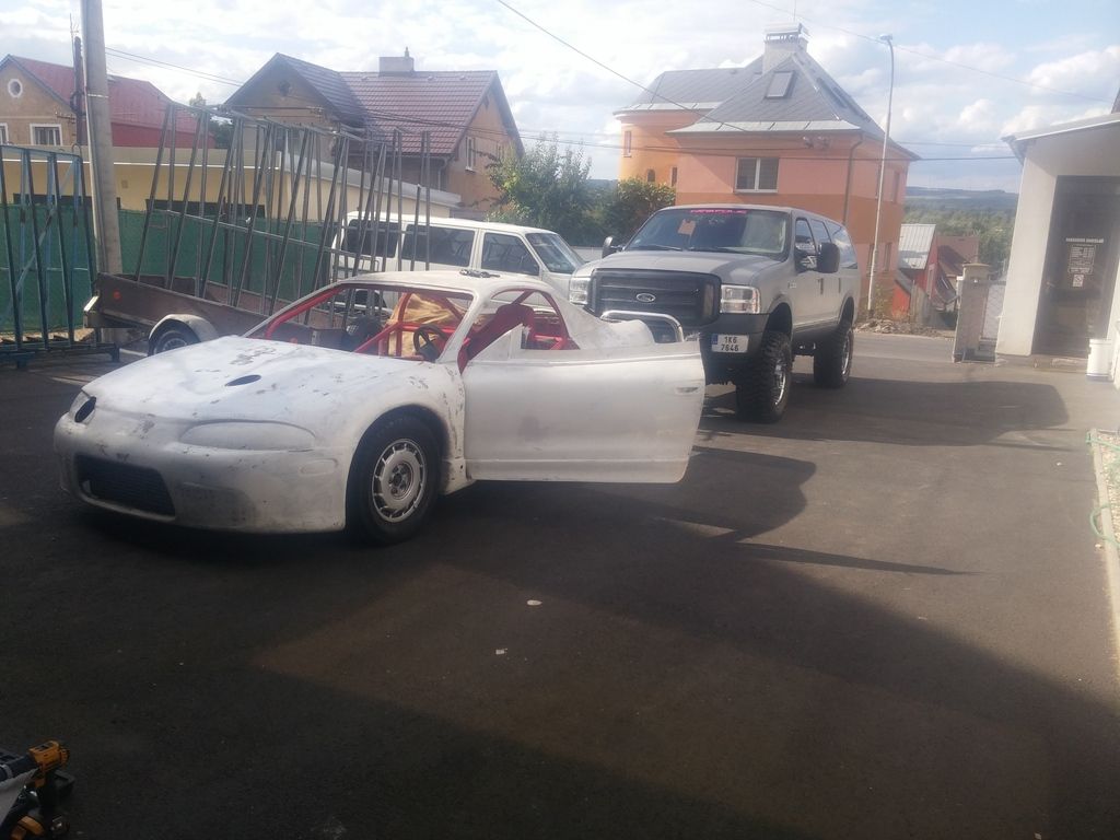

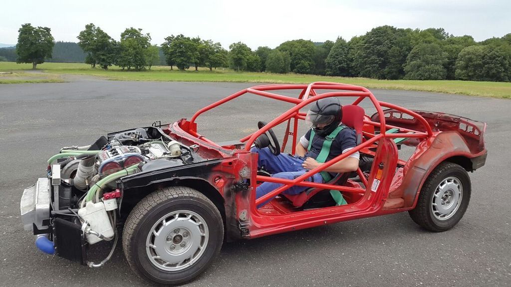

Drove her for first time without any fiberglass part on.. just roll cage. .lotta fun..imagine hood exit exhaust and you not having windshield..LOL was hot out there hahah..

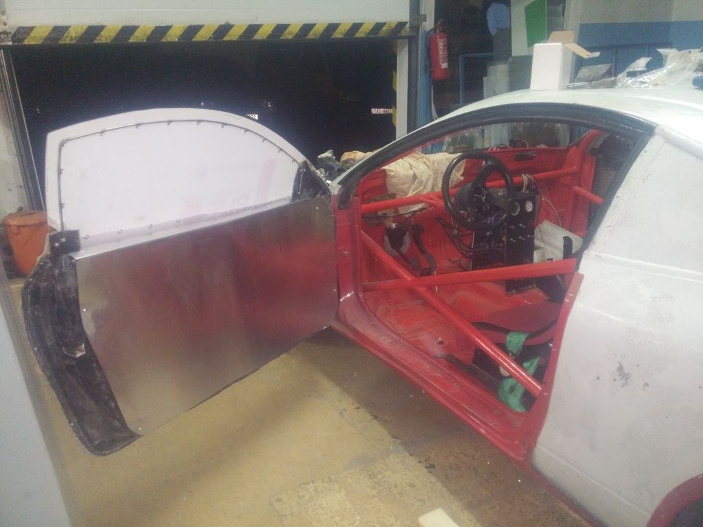

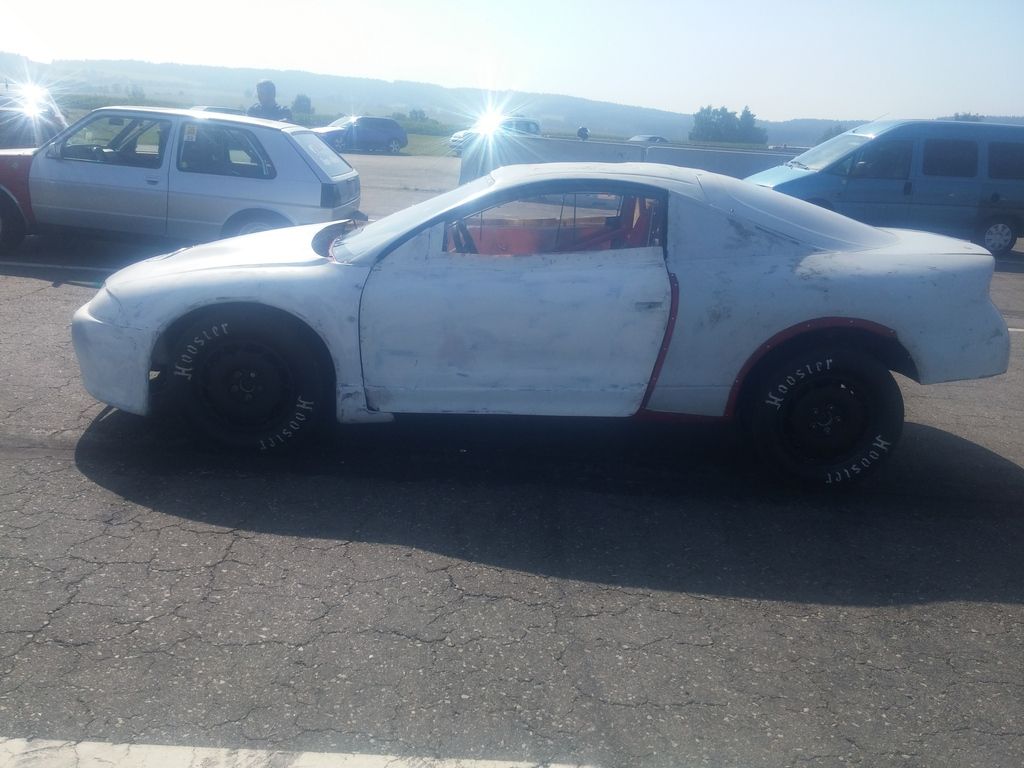

Finished doors w aluminum inside panels..lexan glass..etc etc.. Was pretty scared run car for first time w whole body parts on it LOL)but all last ..no issues till now.

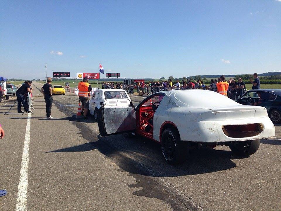

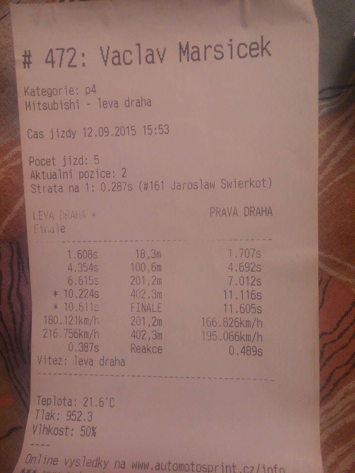

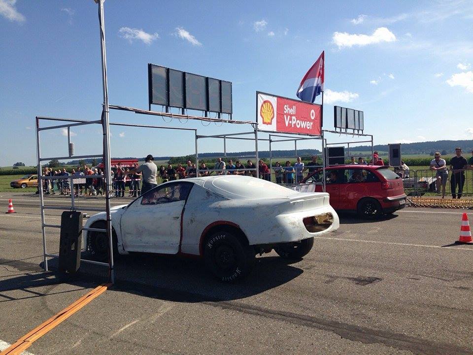

last week raced on local race event... finished 2nd in fastest class.. all had R32 engines or simmilar.. lost finals due TPS sensor.. caer wasnt able move from pre stage to stage...then wasnt able spool up my turbo and leaved line w 0.5sec reaction and not fully spooled:(( Car was running nicely..35ish PSI of boost. Time slip down
Now finishing shell.. sanding.. filler on..sanding...another filler..sanding... and hopefully this weekend will paint her :)
Then gottta turn up the boost to 45psi and install shift light so I can easilly shift/ now had only my cell phone..smart phone w app from my EMS/ EMU no time check the damn damaged "track" and check rpms... w shift lighjt will be much easier :)

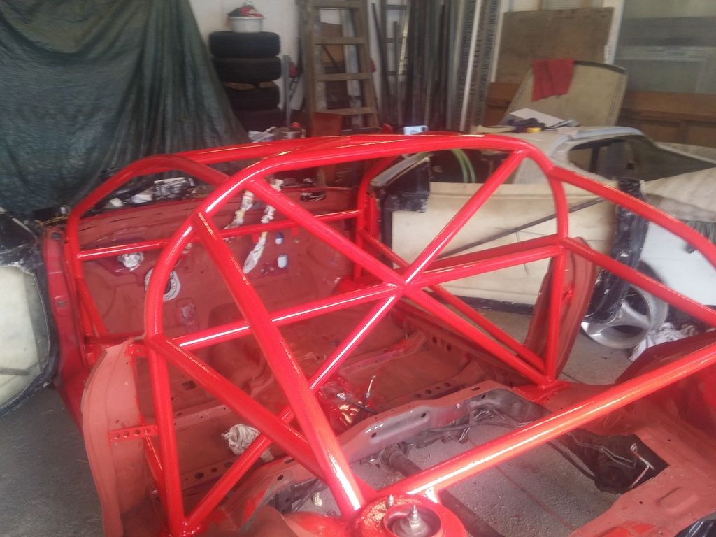

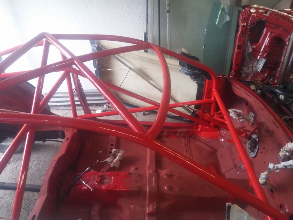

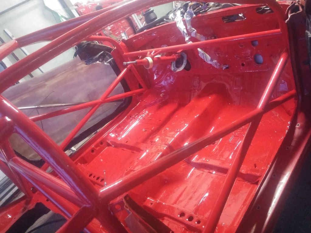

painted cage and interior

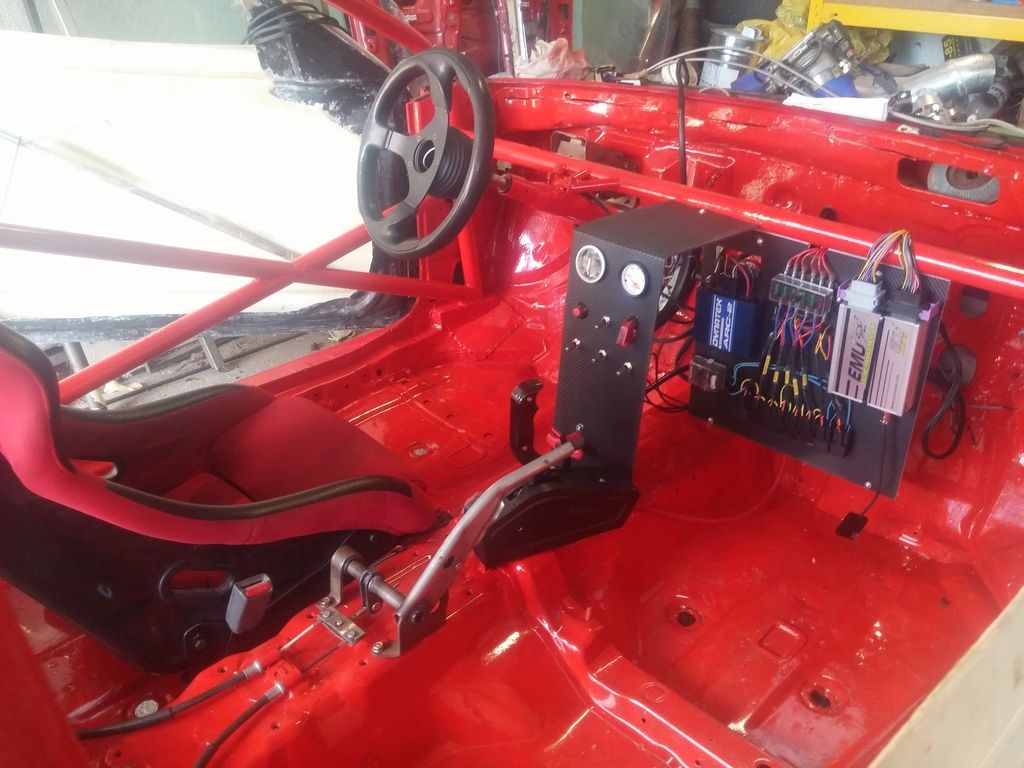

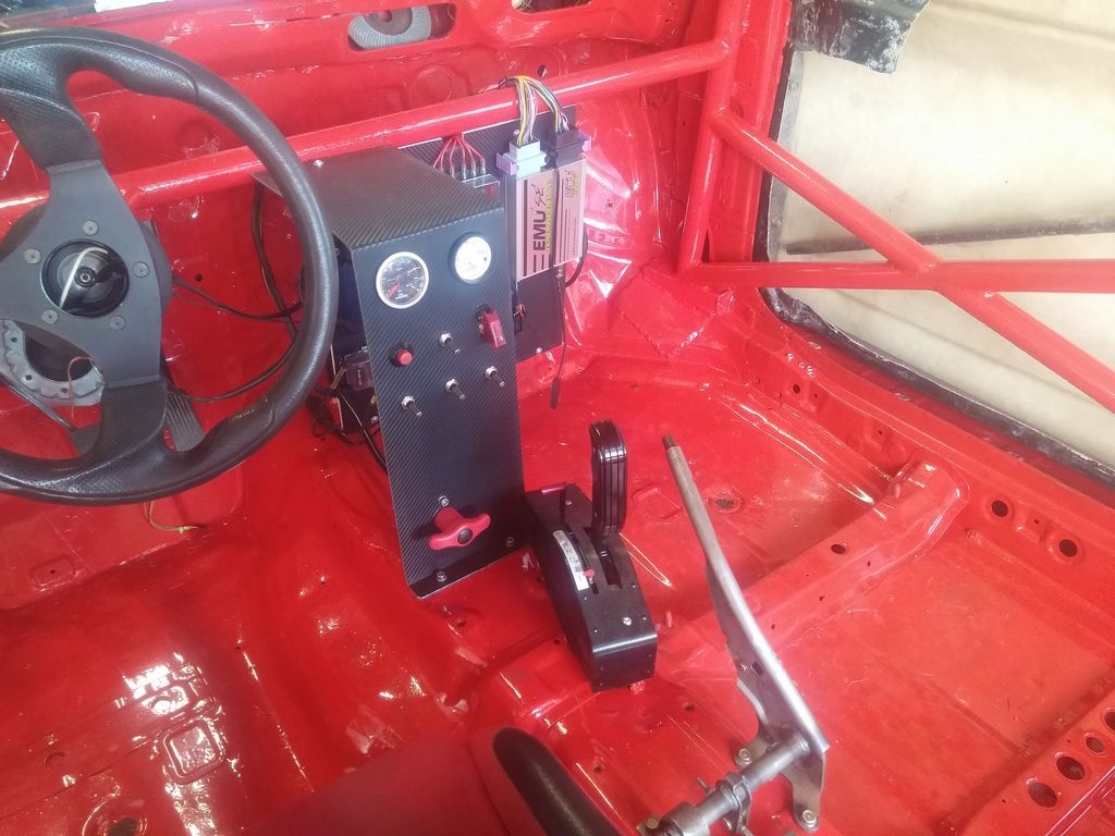

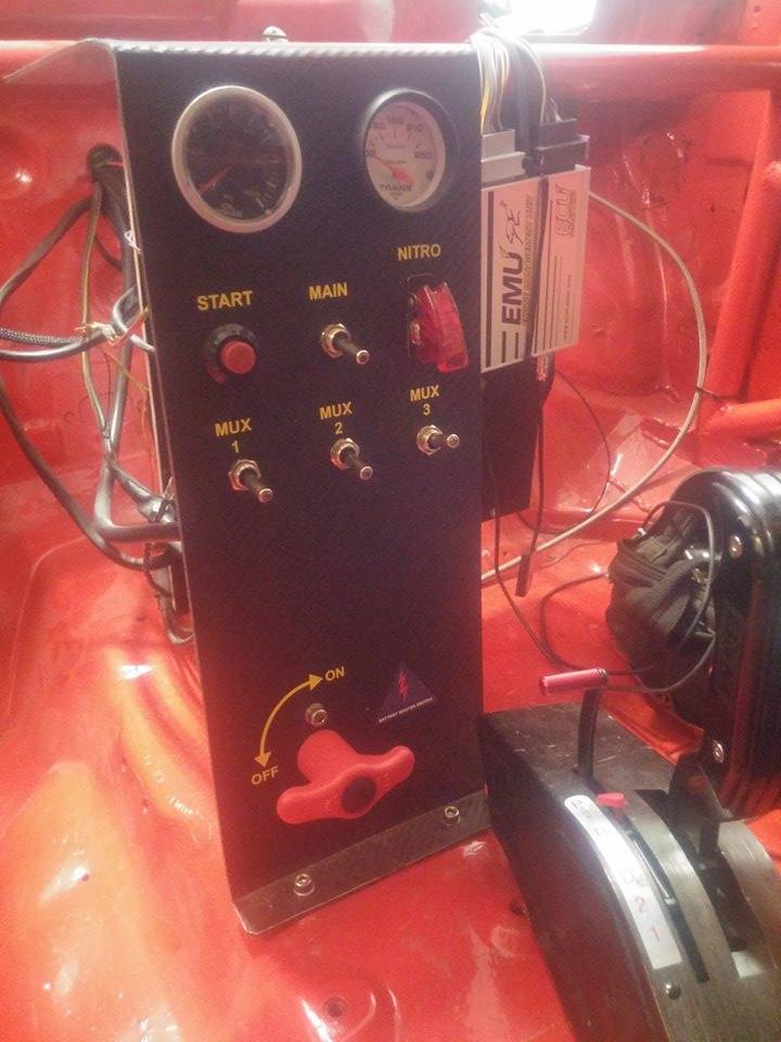

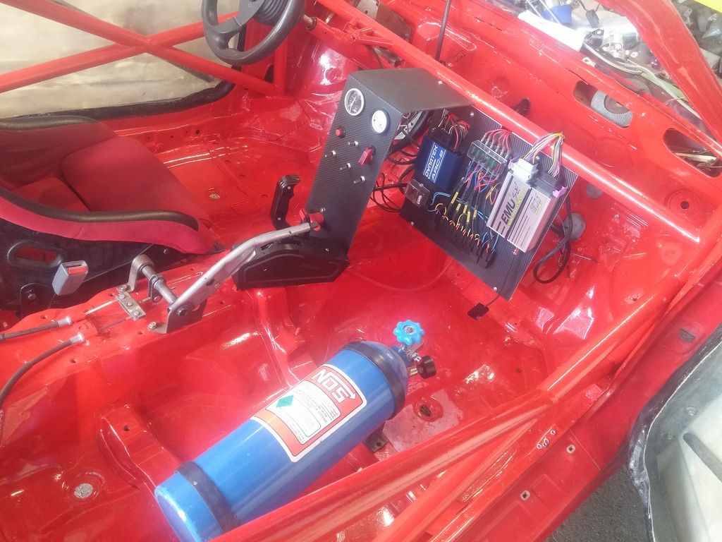

Finished el panel w EMU, Dynatek and switches. new ratchet shifter,

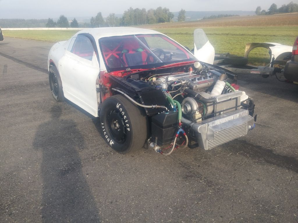

Best ET for now... Best trap is 136,5Mph. Best 60" is 1,539sec on just old airport field/no prep, Leaving w 15psi, w more boost car just spins and goes sideways..
Till now Iam happy hows car working..cant wait turn it up to 45psi boost .
As for weight.. Iam roughly between 2200/ 2310lbs w full tank of E95, With stock subfarmes.. stock brakes.. PIG heavy / 60lbs heavy turbo.. 22lbs ex manifold..

Iam using Koni yellows w HaR springs, Hard Prothanes bushings all around plus braced rear arms.
Gotta redo aligment, Had to install 30mm wheel spacers cus slicks were touching knuckles when car touched ground.. now w spacers I can see lotta "A" at rear/ will put washer under rear upper arms to get "0"
next week 3.10 going for another race Surface got better traction..with better aligment hope to cut at least 1,4 at 60" Plus 45psi boost.. Yummyyy :)

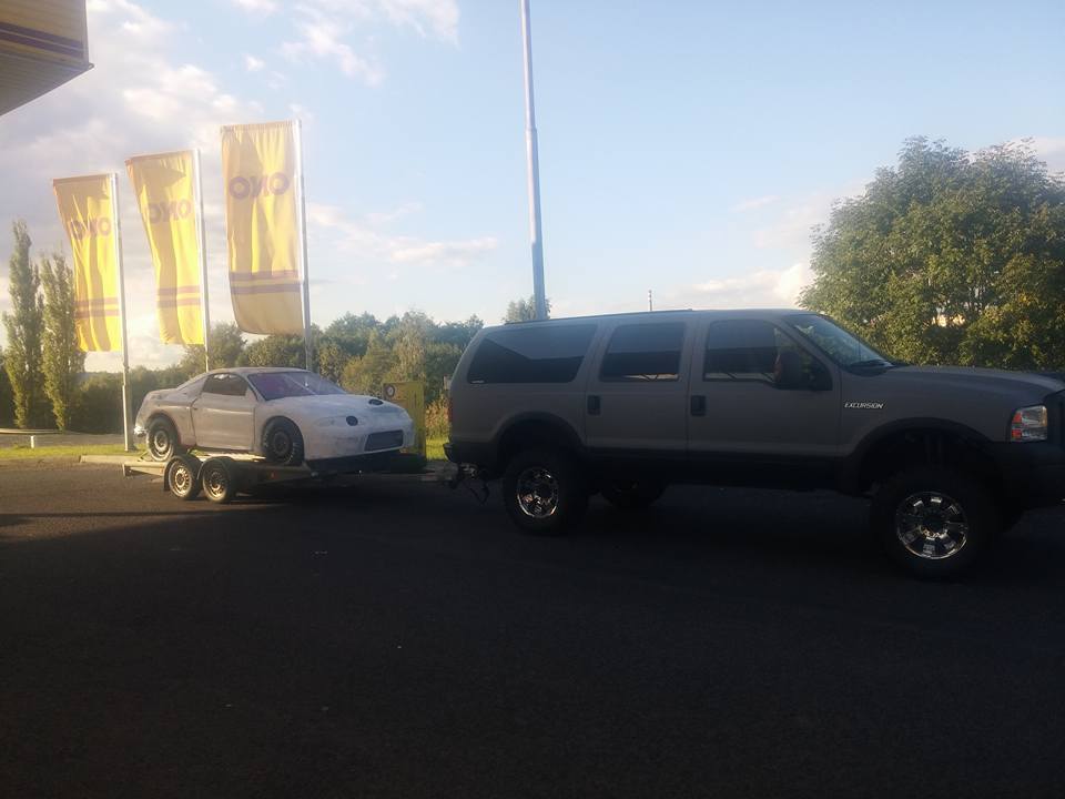

Thanks! we meassured car on trailer w towing car.. calculated 940kgs That was with only roll cage...without fiberglass panels.. expecting 2200/2300lbs weight w fulll tank.
What fasteners are you using for what is now the hood (the entire front section) of this beast?
Have you noticed any flexing or other unwanted movement in the panels? Am wondering about that since panels are not supported in too many places, although fiberglass is more rigid than metal.
