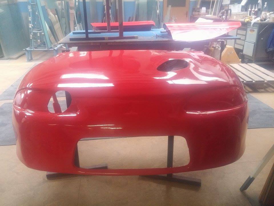

What fasteners are you using for what is now the hood (the entire front section) of this beast?
Have you noticed any flexing or other unwanted movement in the panels? Am wondering about that since panels are not supported in too many places, although fiberglass is more rigid than metal.
Windshield shakes a bit at over 100mph up to 136mph/till now LOL .. 1piece Front end is solid.. I did my own hinges plus using 6xDzus fasteners. doors are solid, and windows on them are solid as well.. but once recon bit shaking at my drivers side.. Gotta use my big heater and bend/deflect glass edge at roof area, just where is my wndow frame/there is highest air pressure pushing window out..
Was scared about rear end at Traps.. no clue what kind of pressure pushing rear hatch down/kinda a down force. with like 136mph seems my structure hold no prob..
Rear hatch holds on 4x Dzeus fasterners as well.. and again its solid :)

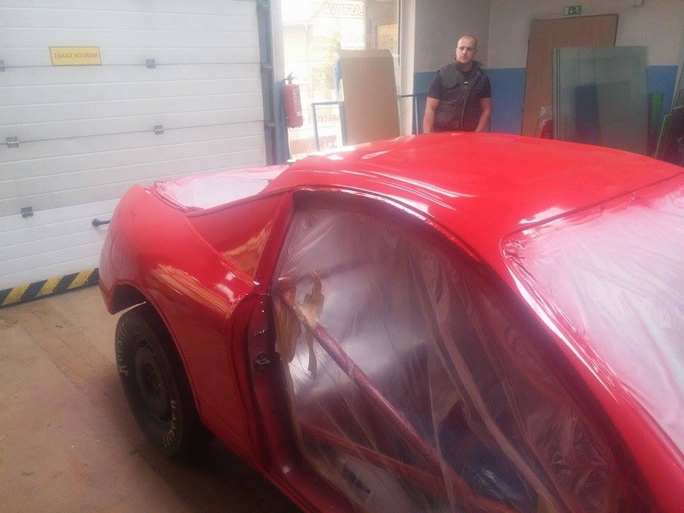

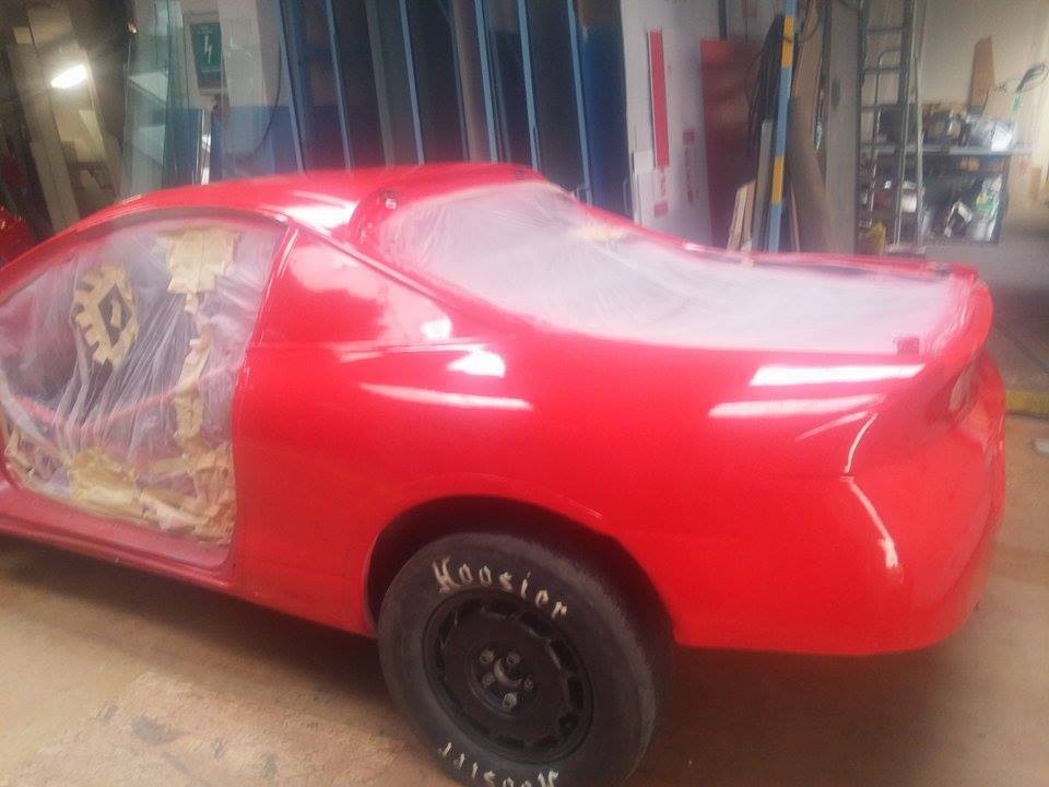

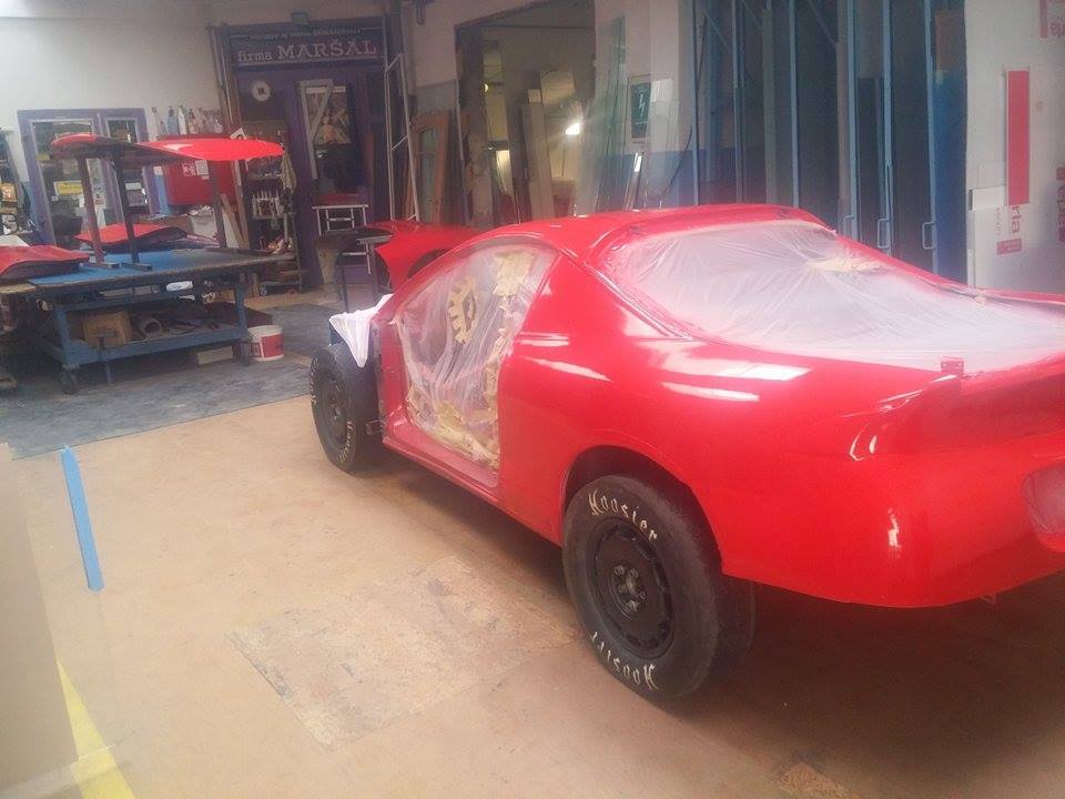

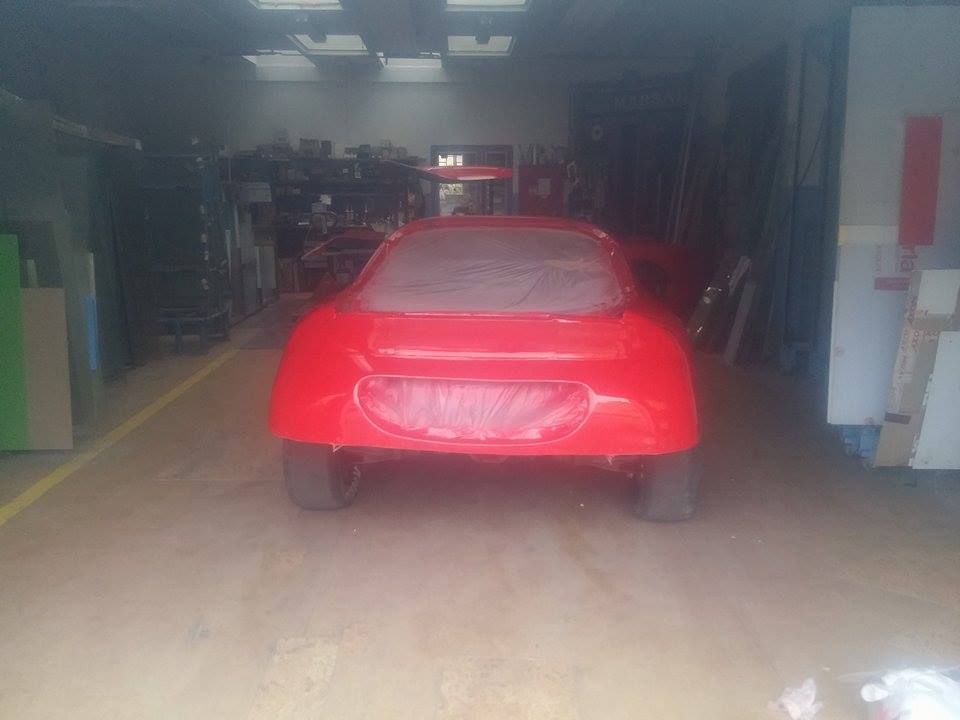

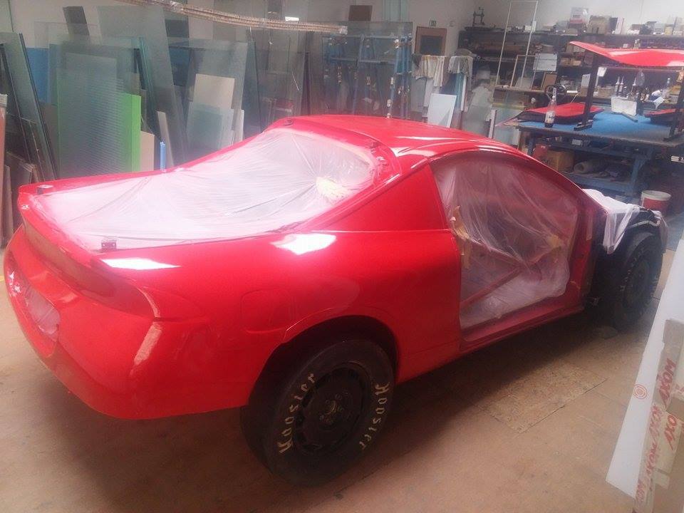

Paint job should finish tommorow.. back in red :hellyeah:
You should air brush some taillights on the back and make the side windows look tinted. Break up the all red alittle :) really good work bro! Came out really nice you got skills brah
Thought about air brush head ligts..some kind of angry eyes.. :) Thanks!

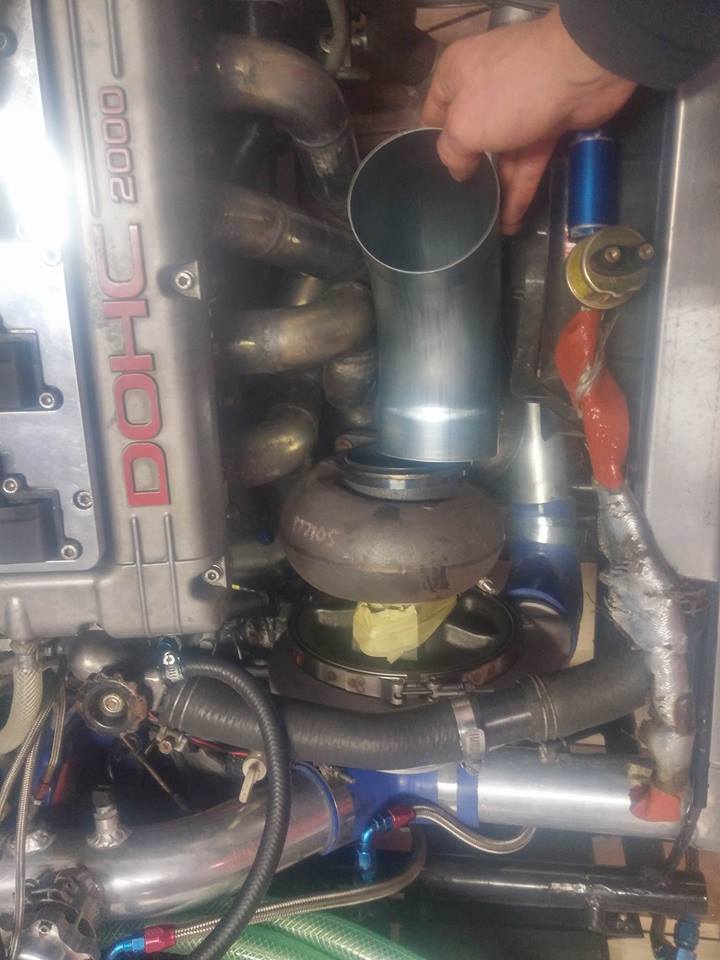

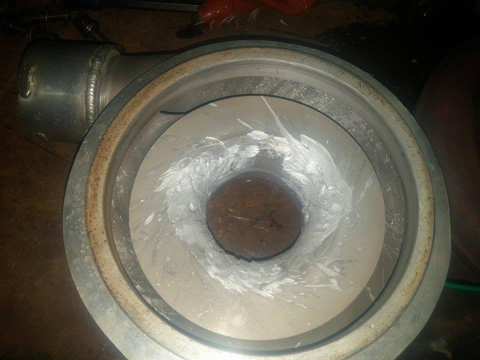

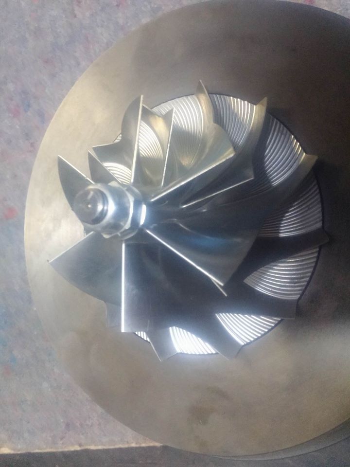

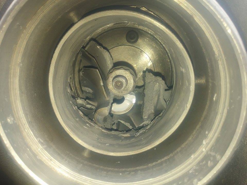

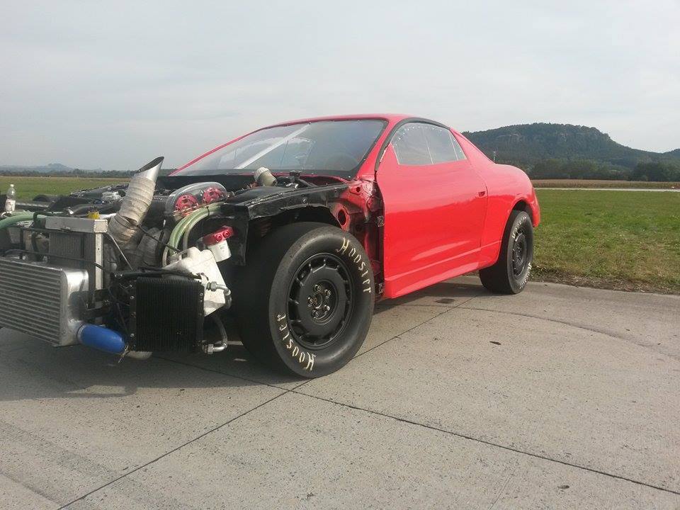

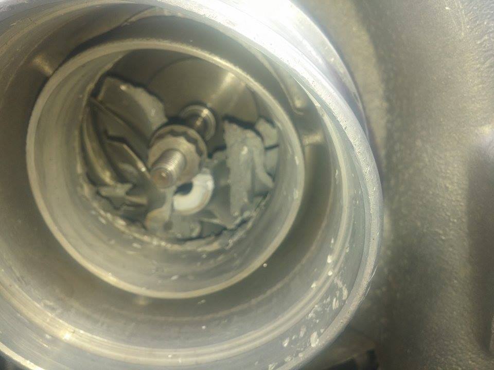

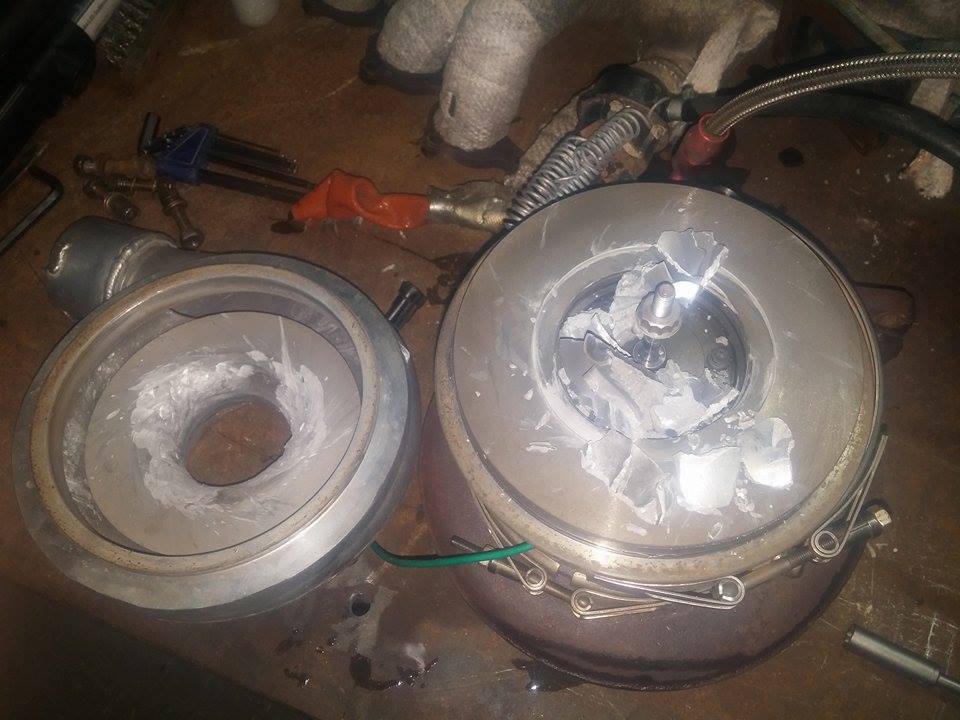

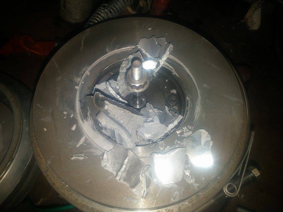

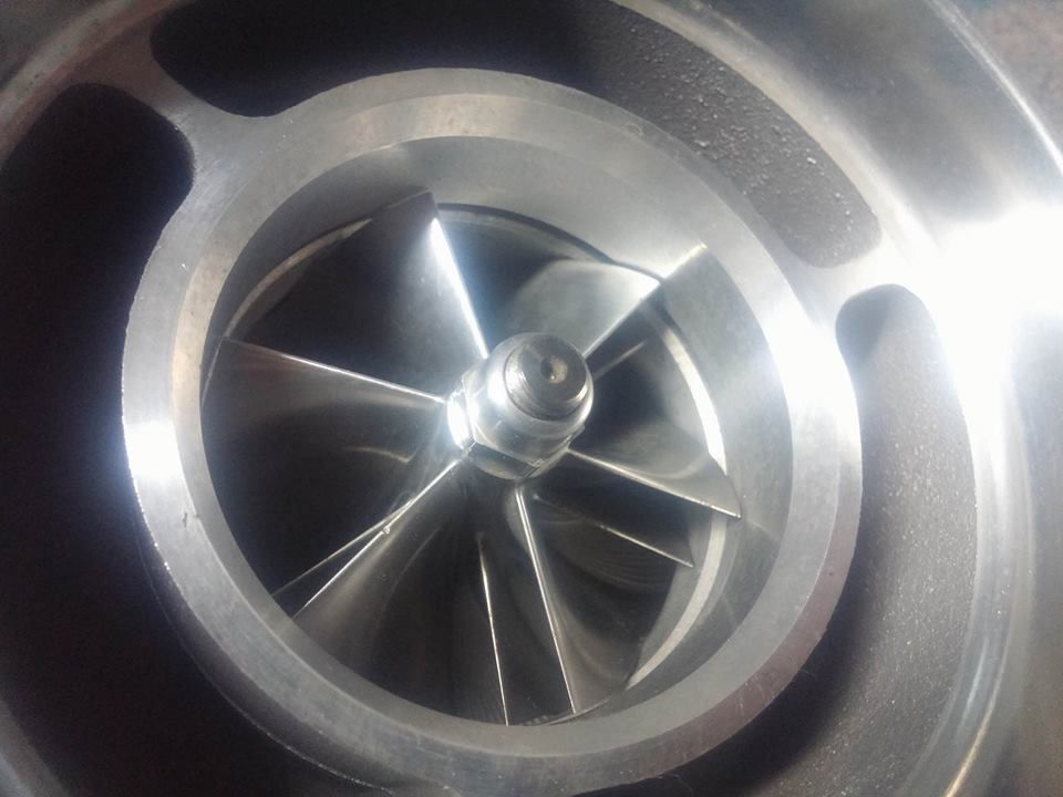

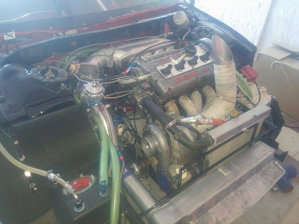

lotta things happend in past week... first off... blowed my turbo Holset He531V she wasnt able push more than 41psi of boost..I locked VGT ..completely off..turbo overspun..pushed lotta pressure without airflow and rip apart..

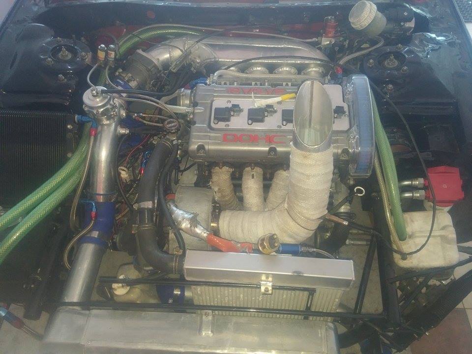

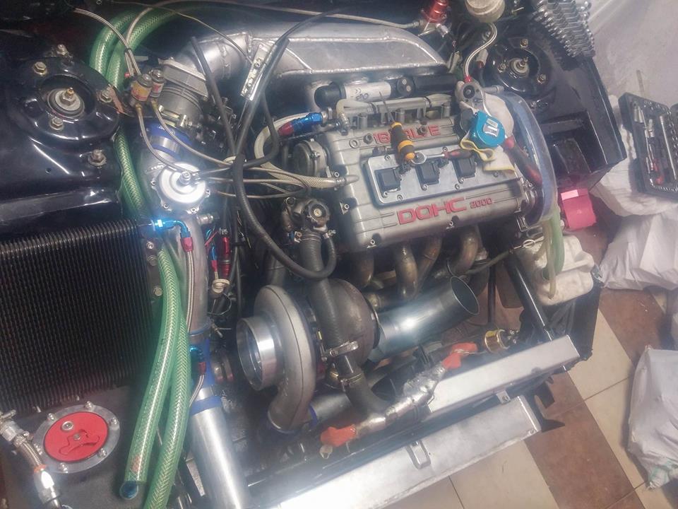

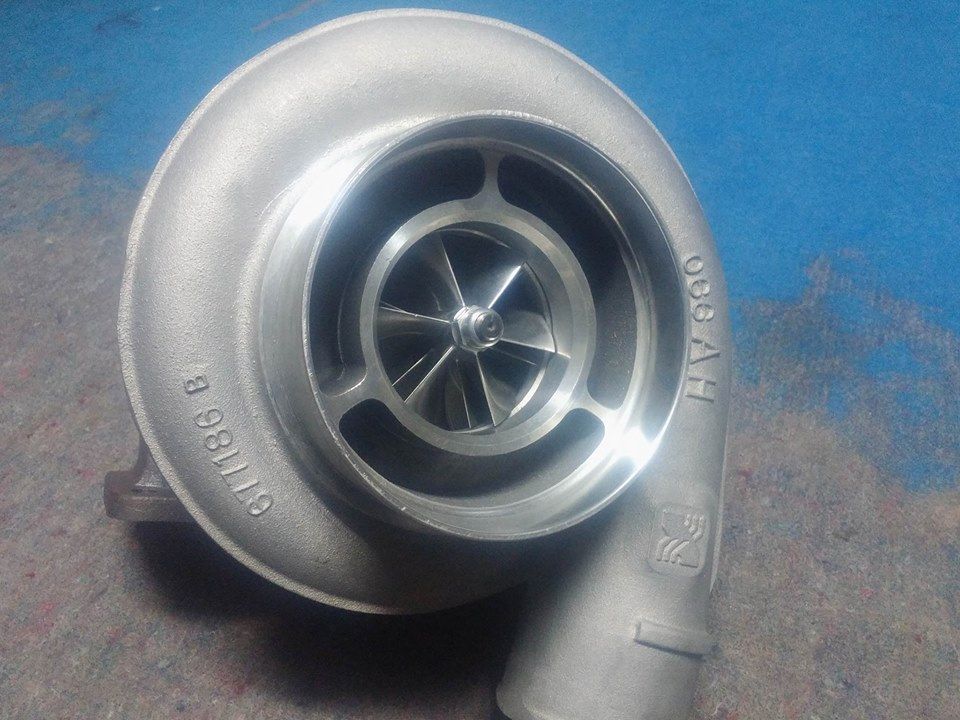

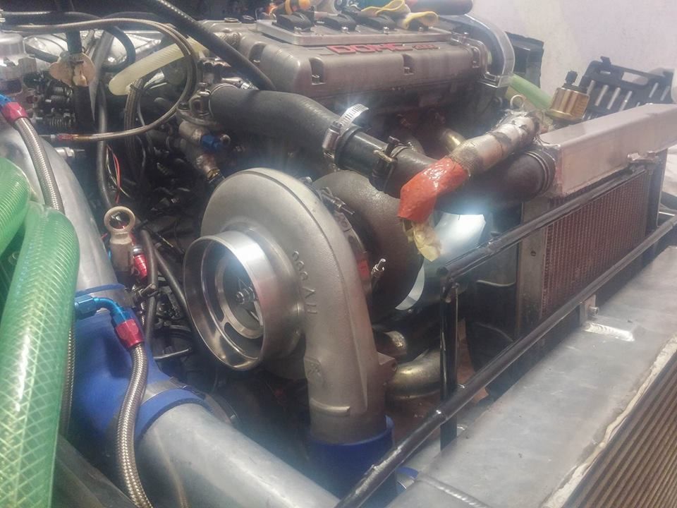

After this awesome day had only one chance get my car back together w friends turbo.. basically its my old turbo from 2010 or so.. BW s366 w 0.91ar. Spent whole day after day job to put it on my car..on my ex manis..resoleved lotta issues. worked till 2am and went sleep.. next day after job in friday was able fire her up..no leaks at all..

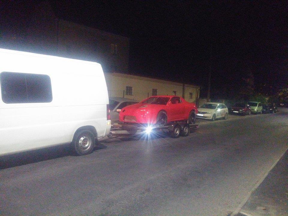

next was get towing car and trailer.. had to wait lotta hours.. after filling tank on towing car, that was like 6 pm we were able get the car to tune airfield. Darknes becoming at about 7:15.. had small amount of time get the turbo at least to 43psi of boost.
W only hallman MBC and controling my single tial44 and mbc almost completely in she did only 41psi of boost falling down to like 39psi..then screwed completely IN..turbo pushed only 37psi falling to 33ish..and gets only worst..lower boost..
Luckilly remembered that and unscrewed MBC two turns and she pushed back 41psi to 39PSI just before first run.
S366 IN

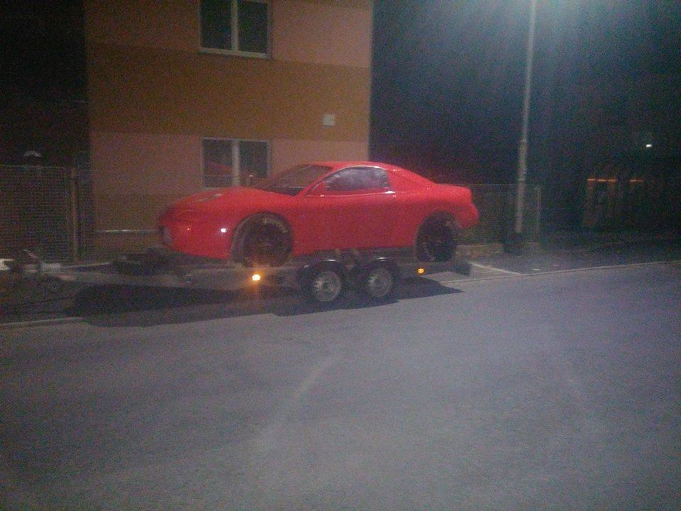

On trailer about to start trip..

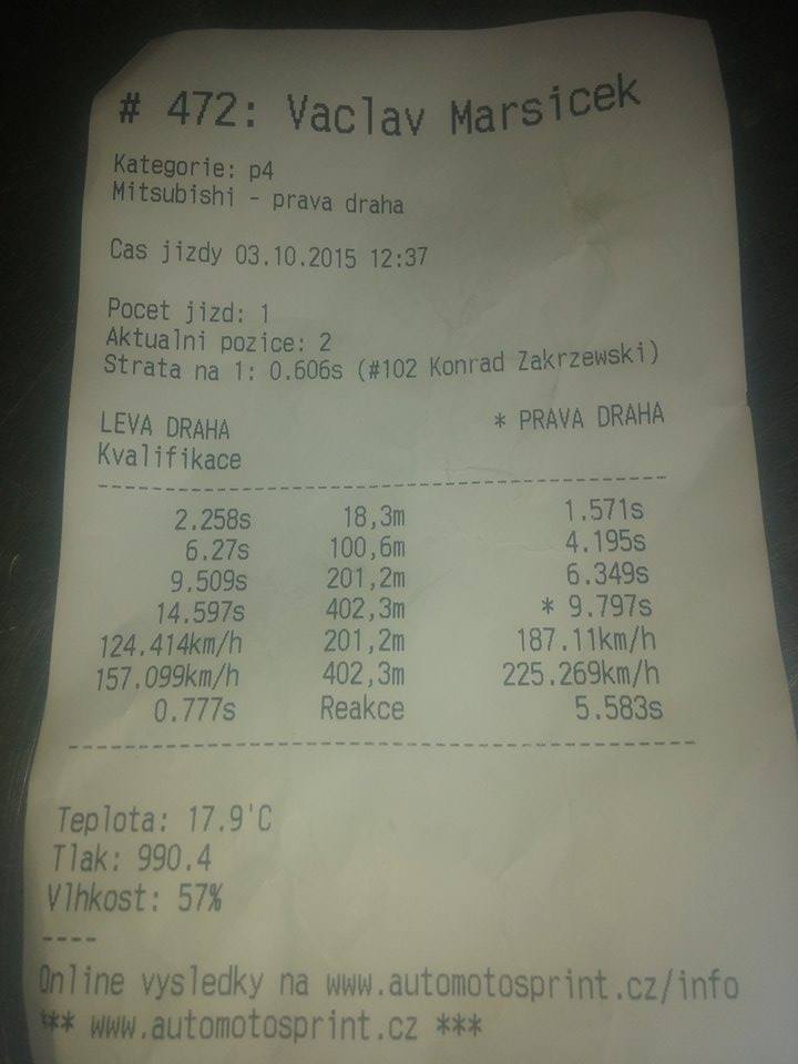

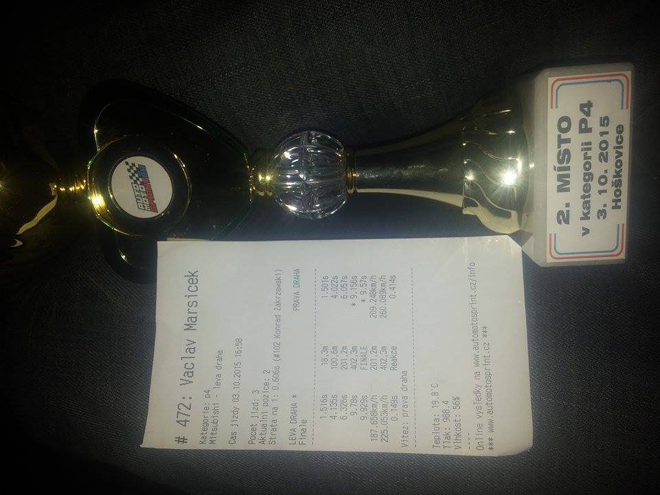

First 9SEC Timeslip!! heck yeahhhh!!

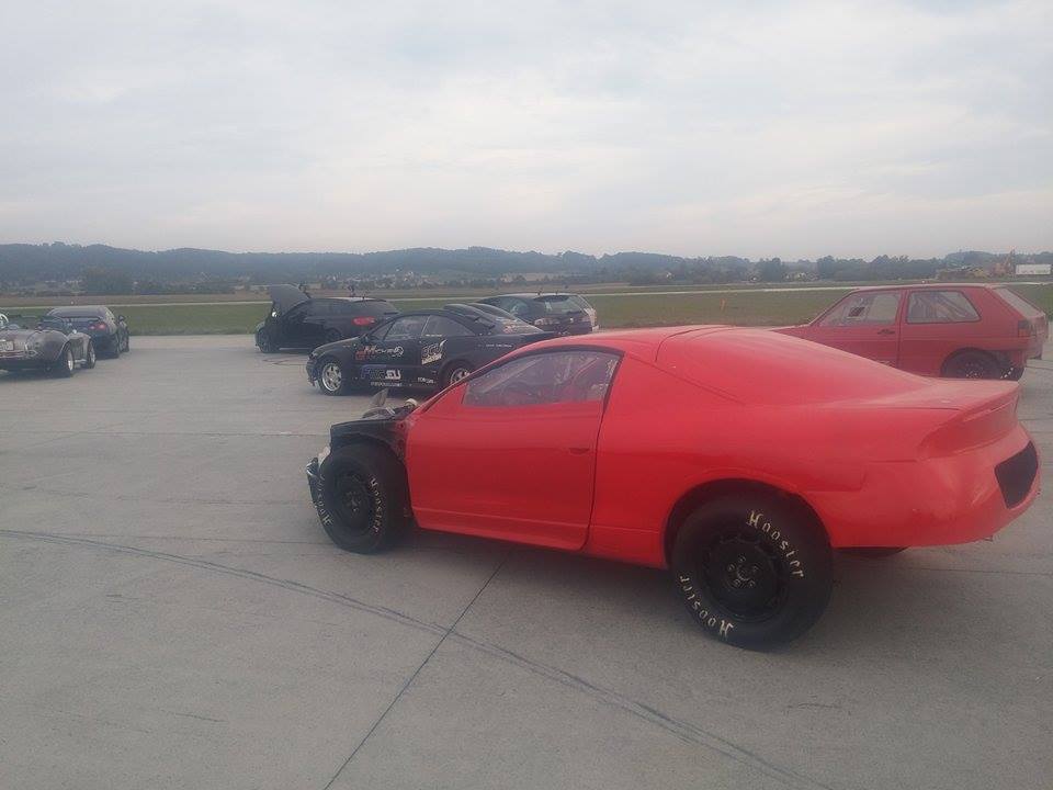

Did not even run semi final cus rival left home w issues.. so went to Finals..where I met w ne of the European fastest car.. BiMoto VWR32 Opel Calibra they call it Tsunami calibra.. he using Two VW R32 engines.. two 3.2l engines w power of 1400HP plus Nitrous!!Yeah.... must be miracle to win with tis car.. but I never gaved up!!and smoked him on reaction.. was first to almost 3/4 of track...then his massive trap speed brought him over me...Lost the rac by like 0.4sec.. which is not bad at all w spare turbo.. with falling boost in every gear.. without my front clip on car due different exhaust which not ft into my prew outlet threw hood.. lastly now found from datalog I leaved every race with only 7psi boost!!! still 1,5sec at 60´ LOL cant imagine 10 or 15psi.. f_ck
Standing next to BiMoto R32 Tsunami Calibra
Awesome aero huh..thats how raced today:( who knows what only this could affect ET and TRAP...
Consistent passes
Finally 2nd ..again :(
