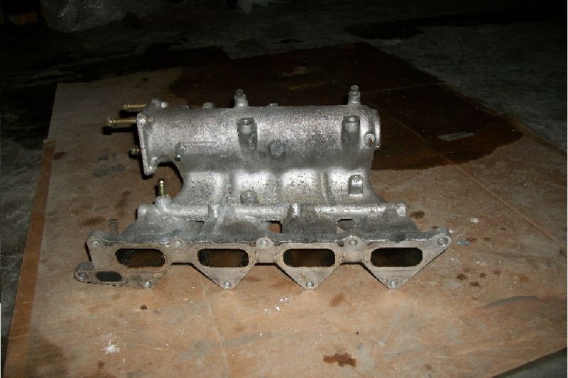

The intake that came with the new motor

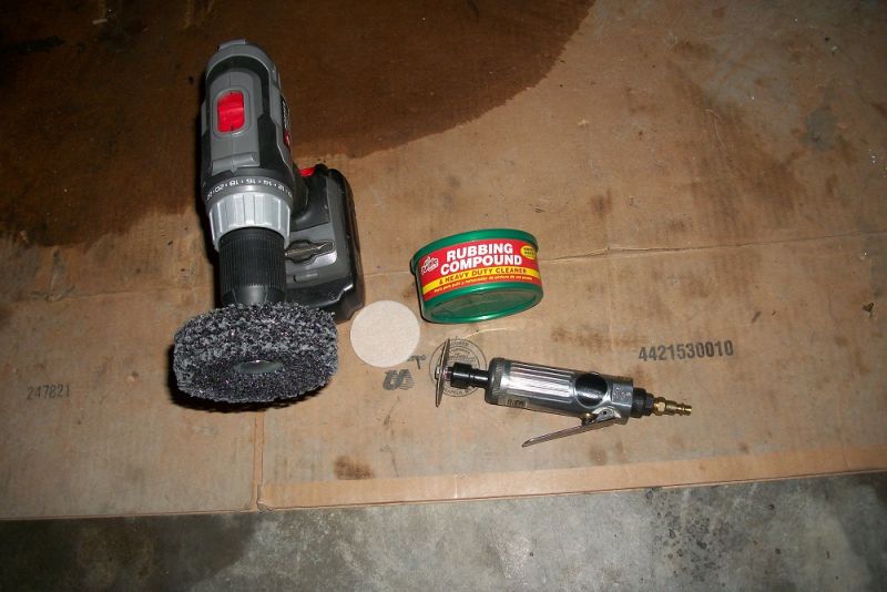

The polishing kit i made contains rubbing compound, a scratch pad an a drill, I have the furniture thing that is made of felt to apply the compound. This I will drill a hole into so that I may attach it to the die grinder or the drill. I picked it all up at walmart. and it cost me like 15 bucks all together.

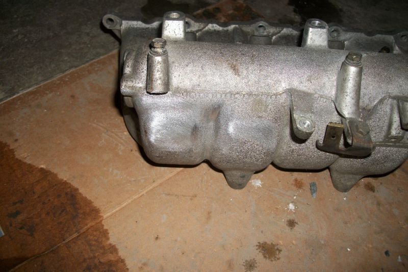

This is a little test spot with the scratch pad I did and yep it pulls all of the cast marks right off.

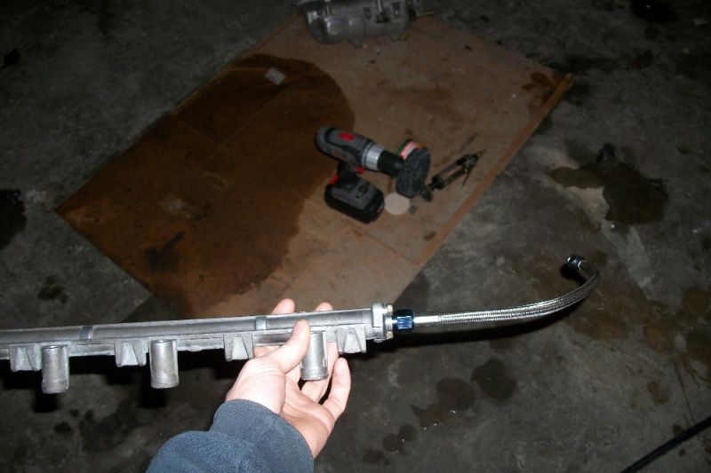

Stock fuel rail with a -6an fuel line attached.

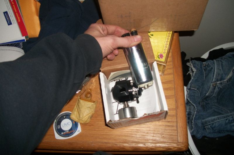

Walbro 255 with the AEM FPR and an ebay 0-60psi liquid filled gauge.
yeah im resizing some pics to upload now maybe someone can tell me.
Yes that is a EVO I-III/RVR manifold. Very good manifold for most medium turbos.
Nice parts man! Give us a pic of the finished product on that intake mani. I might go that route on my 2g stocker intake. Or I might just have it bead blasted, for it looks like someone wiped their butt with it as of now. Keep us updated brotha!
looks like the rvr intake mani, measure the throttle body opening if its smaller than 60mm port it out (if your using a 1g tb)
yeah i just ran into the little issue that the rubbing compound isn't as aggressive as I hoped. Ill just have to polish it the right way luckily harbor fright tools has a kit for pretty cheap. using that scratch pad worked out perfect for starting out.
