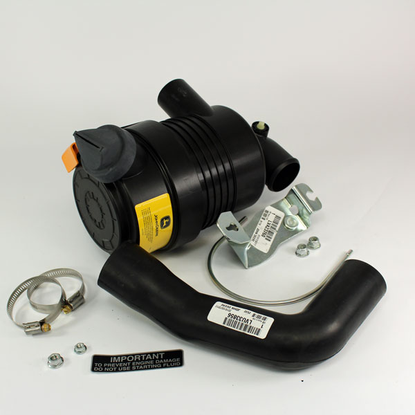

Anyone in here have any connections at John Deere? I'm dealing with an engine failure on a sub-200 hour John Deere 1025R sub-compact tractor due to what my tractor mechanic confirmed is a design flaw. Had nothing to do with misuse or neglect. I've found many other 1025R owners who have dealt with this issue, yet strangely enough, JD hasn't issued a recall for it. However, they DID make a retrofit bracket kit that remedies the situation available.

That's pretty interesting. Looking at pics of the basic Yanmar 3TNV80F, those 3 bolts through the valve cover aren't there. Whoever added them (John Deere apparently) - bad idea.

Same basic problem though. Vibration, fatigue cracking after some period of time, failure.

The studs in the valve cover are OEM on John Deere tractors from like 2015 through 2018 or something like that. They revised the design after they started offering a retrofit kit when too many owners complained of the air filter bracket rattling loose, and some engine failures due to cracked valve covers. They were giving away those kits up until earlier this year.
