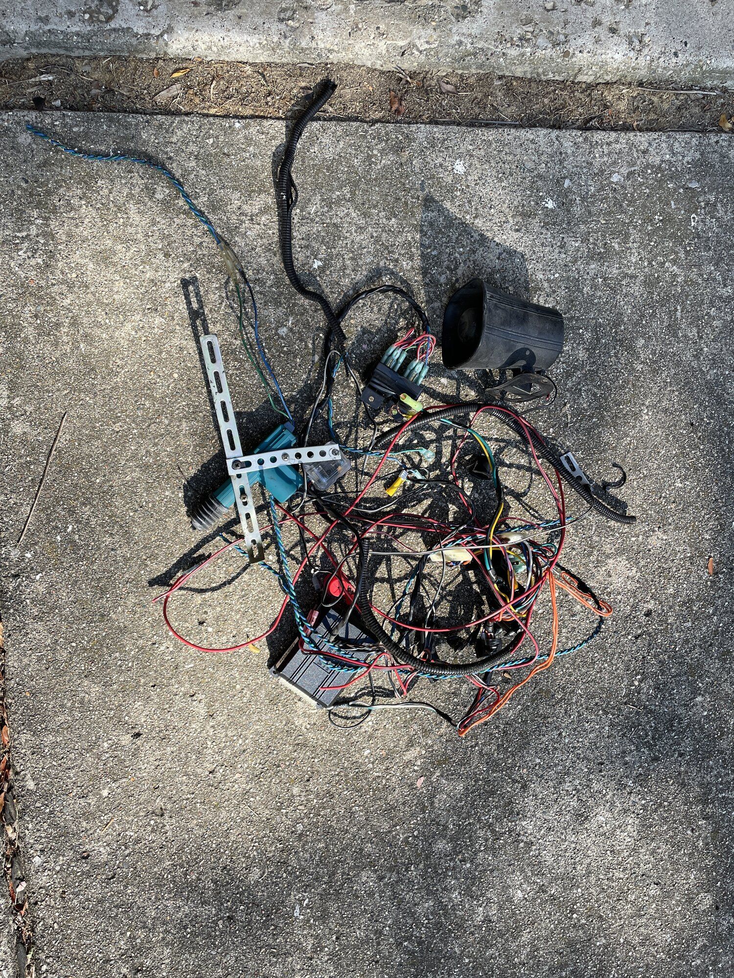

First things first, the battery. I went and got a new Interstate battery from Costco. But before installing it, I decided I had to rip out that Viper alarm. That thing was always a pain in the butt. It constantly drained the battery, so when the car was sitting for a couple weeks, I'd come out to recharge the battery and the alarm would go off. Then one fob lost its programming or something, etc. etc. Super annoying.
I don't have any photos of the ripping out, but here's the rats nest that came out:
The most annoying thing is that the alarm installers cut like 2" out of the main starter wire for the kill relay. So it would no longer reach itself, and it's like a 12 gauge wire. I tried soldering it, but even with a soldering gun I couldn't get the wire hot enough to flow the solder. So instead I had to crimp, which I'm sure will be fine. There's tons of stuff in cars that are crimped connectors.
But I got it all crimped and put back together.

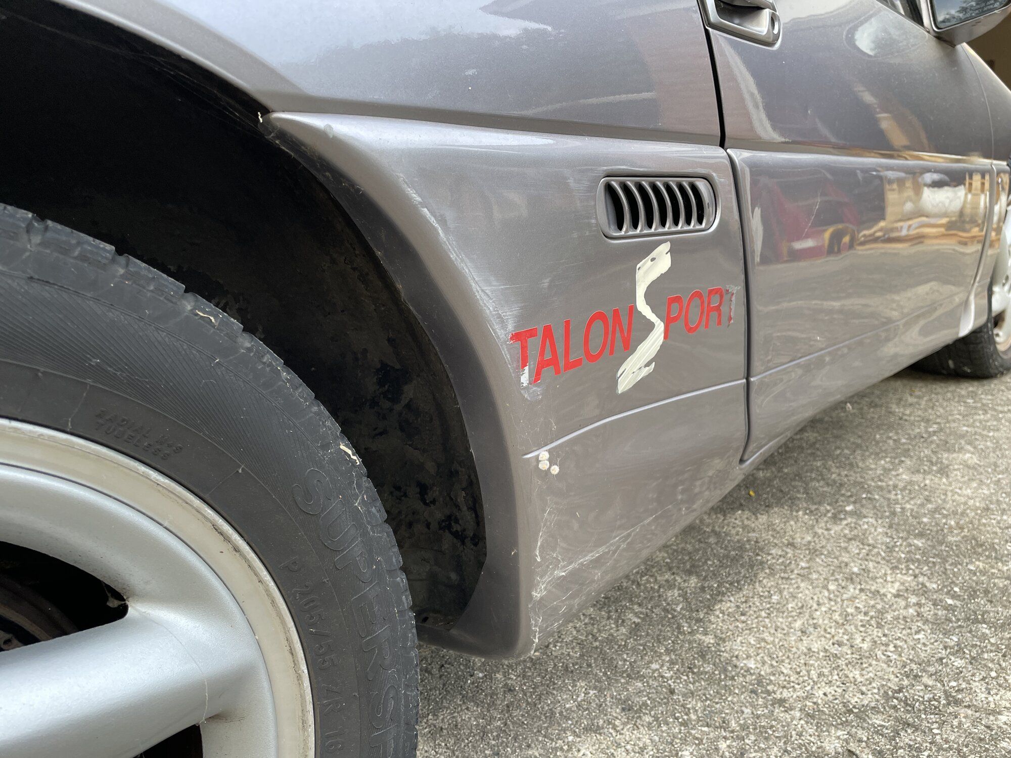

Did a little over the weekend; moved the car out to the driveway so I can wash it. It's very dusty.
And because I had it backed into the garage, the passenger side was close to the garage wall. I forgot that about 8 years ago, someone scraped down the passenger side when backing out of the driveway next to it.
I *think* much of that will buff out, but the area below the vent there is pushed in. I'll have to pull off the plastic cladding and see if I can bang it out, I'm hoping it should be fine. I'm willing to go get body/paint work if necessary. I know there's a big 2" long scratch on the passenger fender when the weed whacker fell off the shelf onto the car.
I have replacement decals to restore it to original and get rid of the silly "Talon Port".

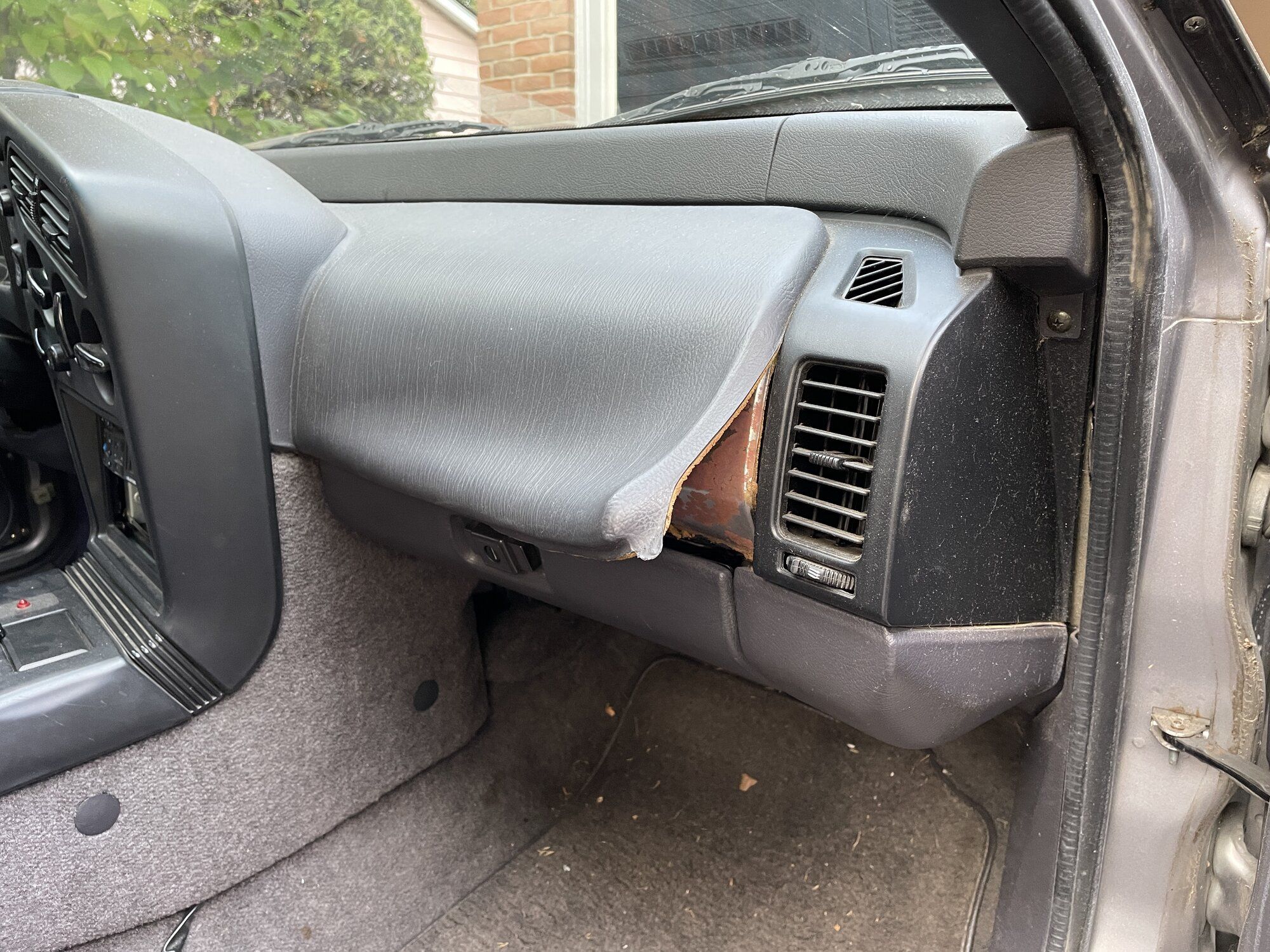

And I've got dash curl, so planning on how to fix that. What's the right glue to use for this that is compatible with foam underneath?

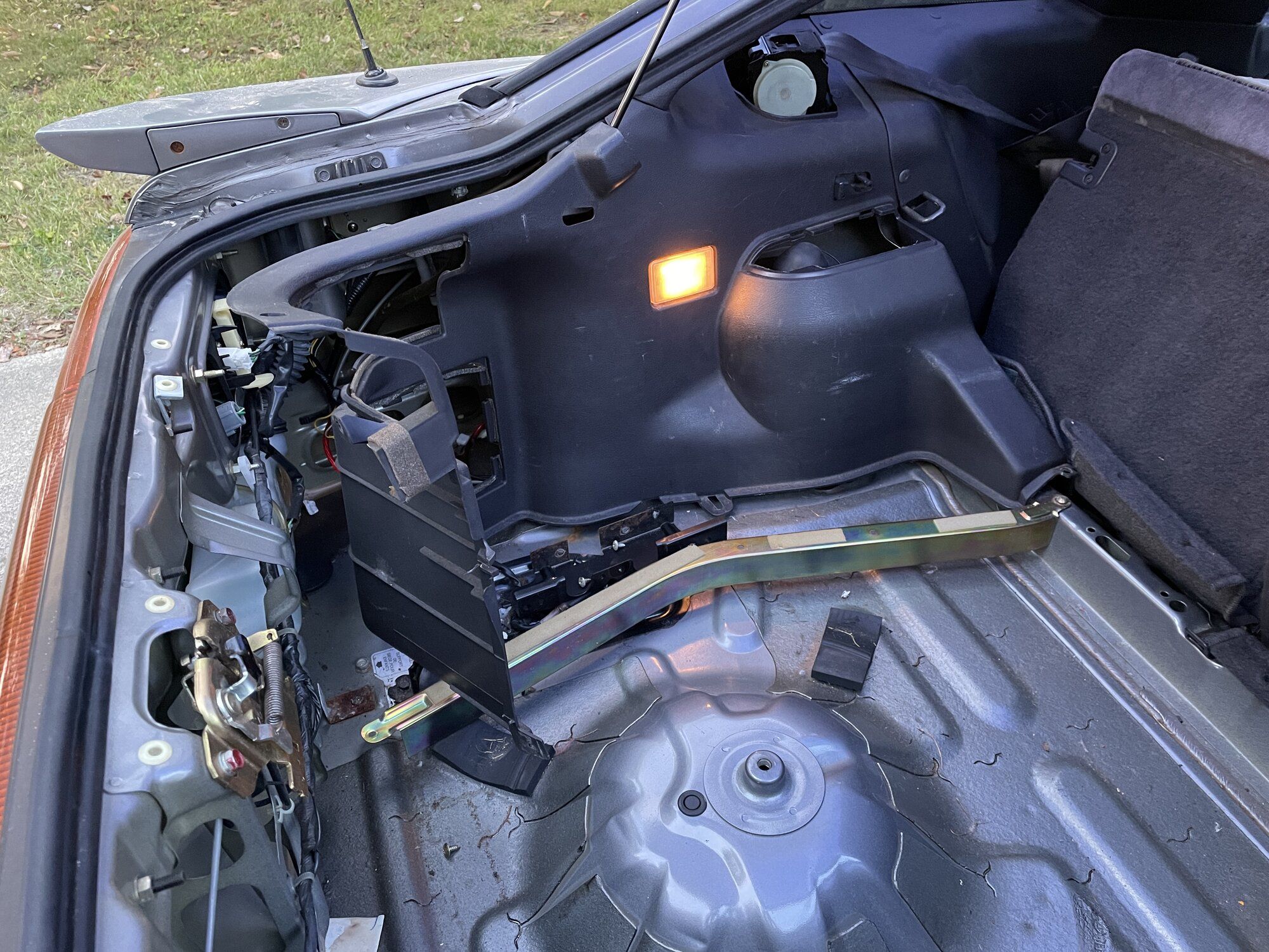

Also I replaced the hatch struts which were completely shot. Annoying how much I had to pull apart just to get to the lower mounts. I know there's an old article that says to flex out the plastic over the mount, but I just didn't trust it. The plastic covers over the taillights and etc. FELT brittle holding them in my hand, like they might just fall apart looking at them.

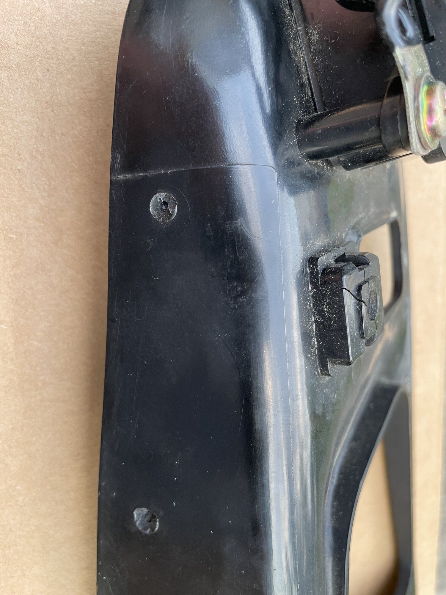

And I need to tackle the loose door controls panel. The plastic rivets look like this:

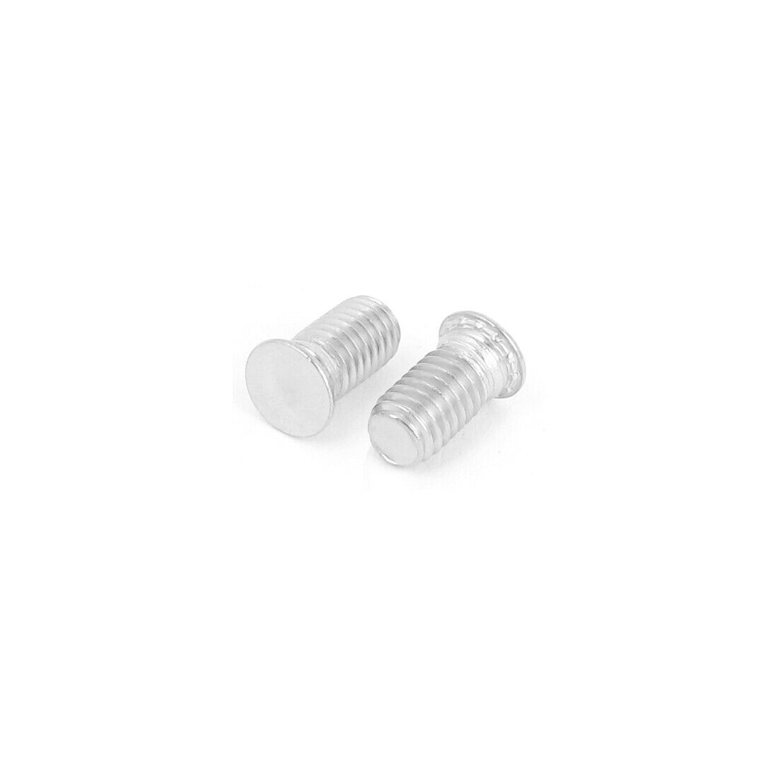

*EVERY* single one is gone. I was thinking of gluing on some short threaded standoffs then put a bolt through the door panel, so I got one to test. And while that might work, while looking at it, I thought about going the opposite way around. Gluing some of these onto the control panel in the broken rivet spots:
Then putting a nut and potentially 1 or more washers from the door panel side. Seems like that would work better. Too bad I can't find these bolts locally, I have to wait for them to come from China(!) via Ebay.

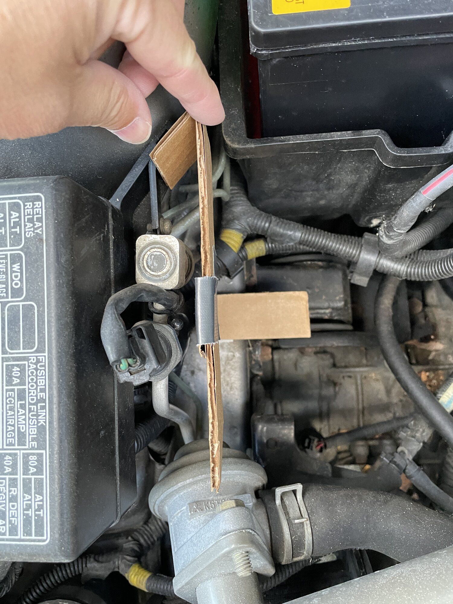

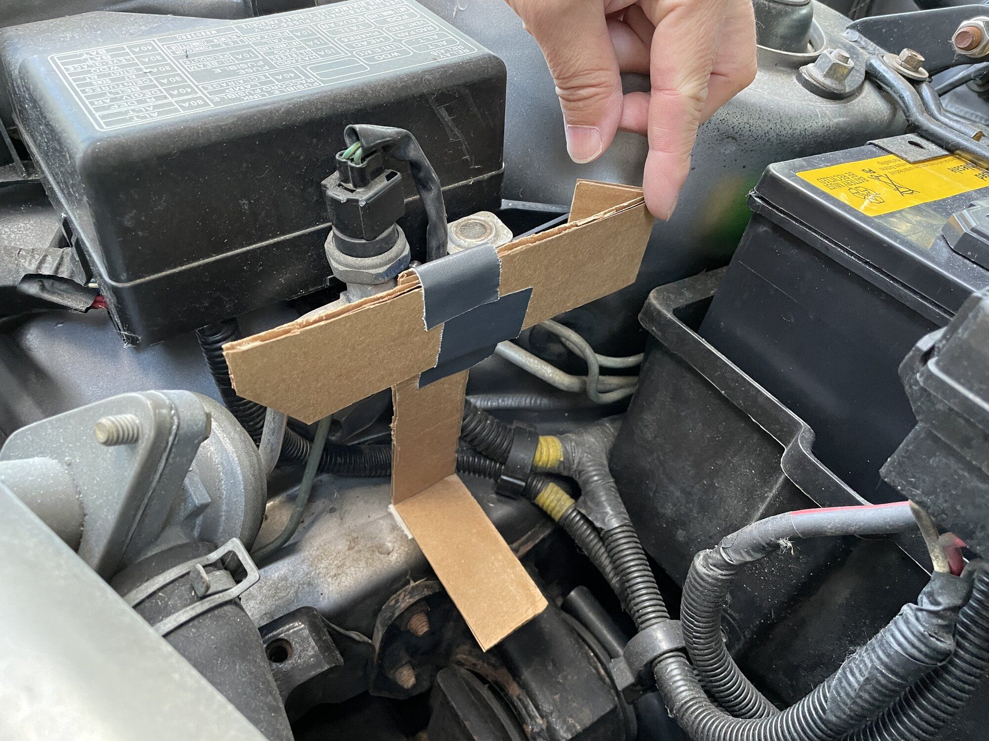

But I did start considering where to put the oil catchcans. I’m following the PCV article on here, adding the recommended two cans: one between the PCV and the IM with an extra one way valve. The other between the VC breather and the turbo intake.
I’ve got some sheet metal pieces that I can weld up to make a bracket out of. It’s 20 gauge, so probably a bit thin. I guess I can stack two together to beef it up a bit. So far I’m planning to do something like this:
There’s an empty threaded hole at the base there from whatever was taken out of this area, was it AC stuff?
Then there’s a bolt behind the horizontal bend through a bracket already there, I can just get a longer bolt. I’m not crazy about the backward bend of the mock-up, so I’ll probably fiddle around to see if there’s a better way. Otherwise I’d have to have a hole in the bracket to be able to access the bolt. I guess I could do a 90 degree left, then the 45 degree right to the bolt point.

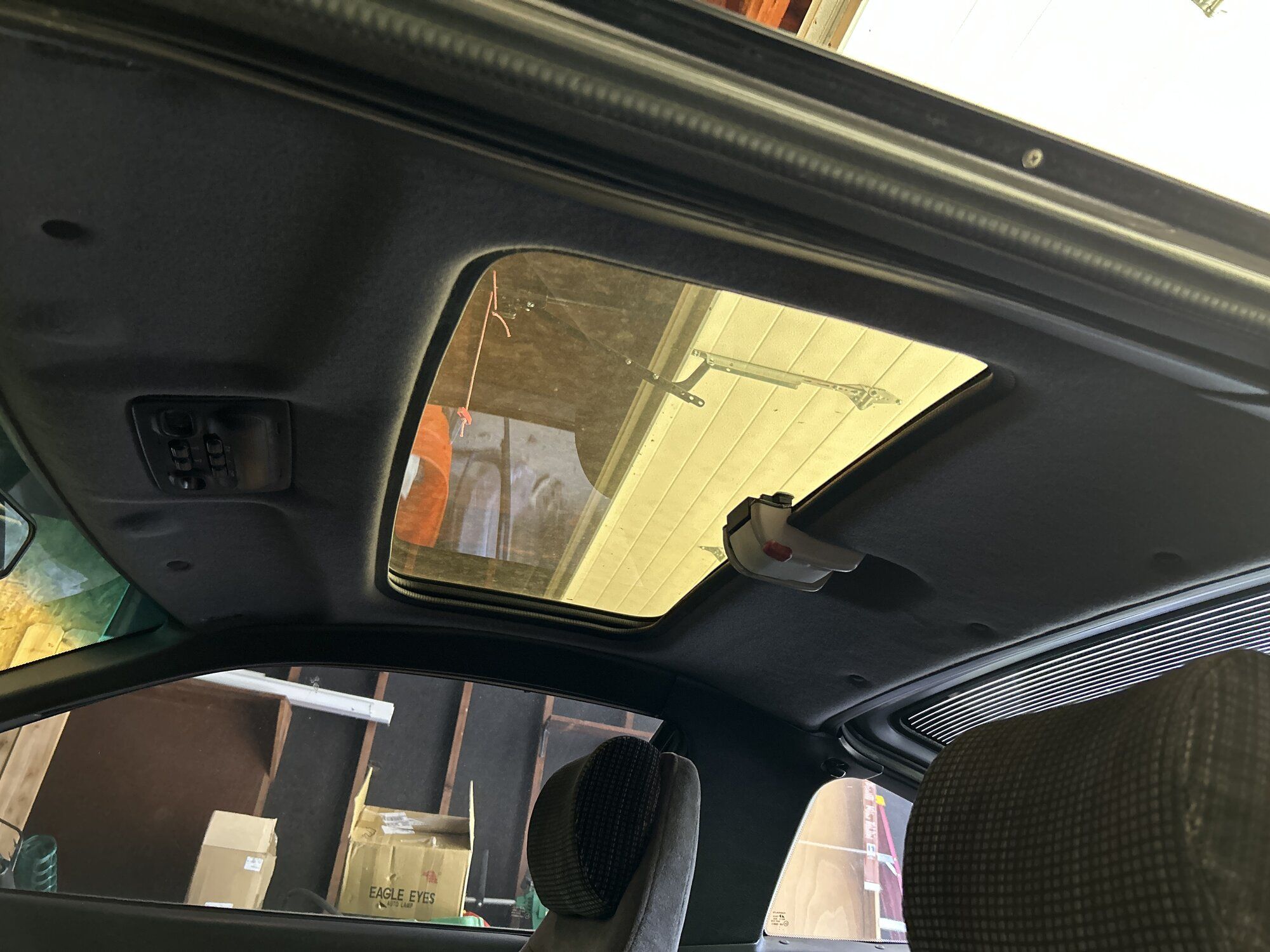

Finally got the headliner installed. I recovered it over the winter but had been waiting for nice weather to put it in.
I always thought the ash grey color that it originally was, was super weird due to everything else being dark gray, so I chose a charcoal headliner. I also had to change the rubber moulding around the sunroof because that was also ash colored, so I bought 20 feet of black off Ebay.

I removed the "Talon Sport" decals, which wasn't too bad. The passenger side was mangled from a vehicle scrape and the driver's side left a shadow on the paint I'll have to buff off before I put on the side replacements. I added the rear decals and it's pretty good looking. I'll post photos; in case anyone wants to know, I found the decals at Hoosier Decal. They are not exactly like OEM but close enough, and from a distance you can't tell they are individual letters and not a sheet decal.

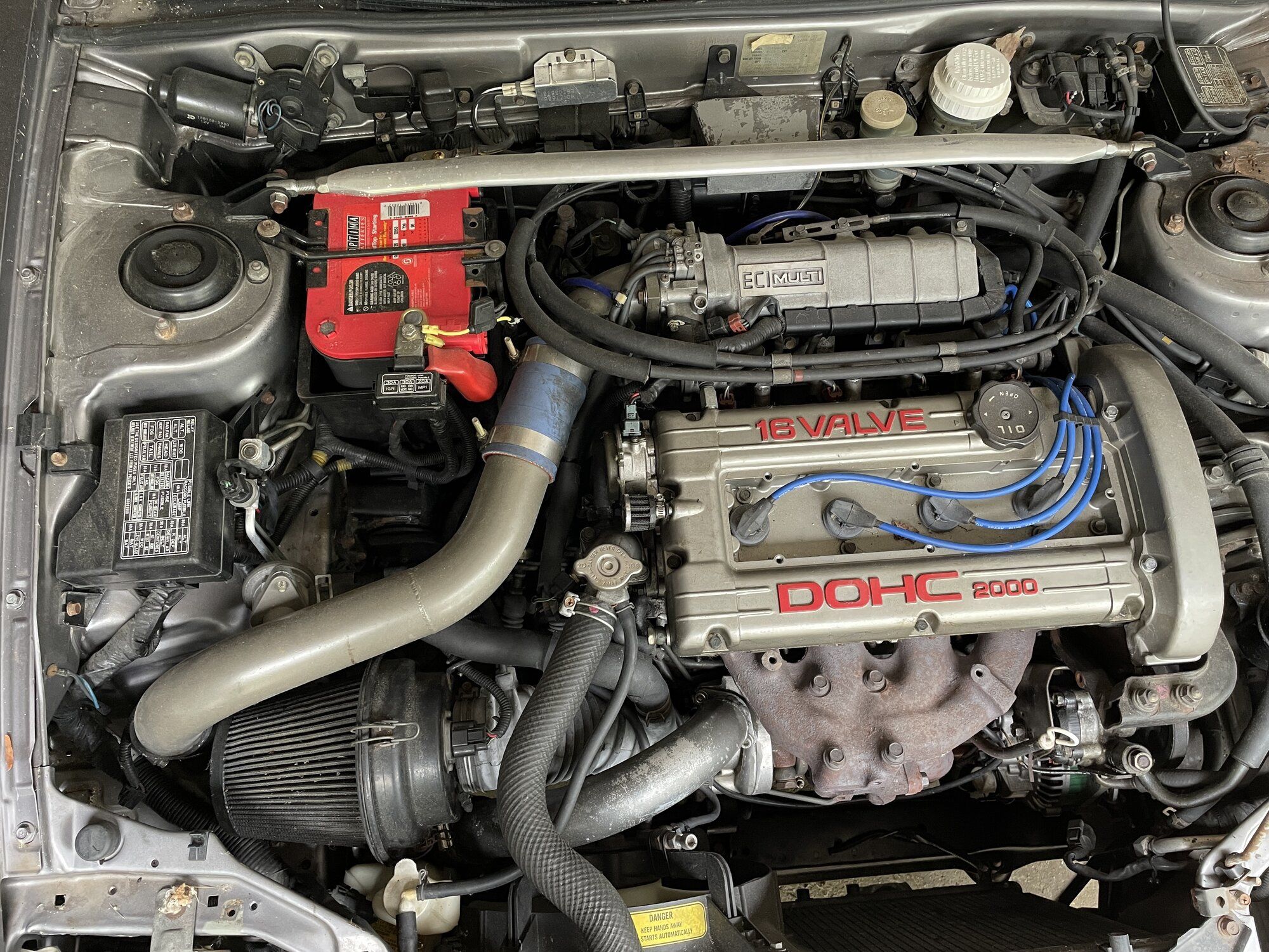

Dove in today and swapped out the ECU for the ECMlink one. Wasn't too bad actually, except the middle connector on the ECU, the locking tab broke, so instead of having a U shaped lock tab to push on, the bottom of the U broke off, so it's the two legs - and that's a pain to try to unlock. Hopefully I won't have to take it out again.
I didn't remove all the SuperAFC wiring; it was nice of whoever to put bullet connectors on the signal wire, so that was easy to just put back together, and the other 3 wires are just for power and ground, so no problem there. I simply disconnected the Apexi but will eventually take that wiring out though, probably when I go back in there to wire up the wideband O2 sensor I just got.
Initial running on the new ECU, car starts and runs down the road just fine, no changes there. But idling is worse, after a few minutes of warming up, it will just start fluctuating RPMs leading to a stall. I got data logged, so hopefully that will help.
