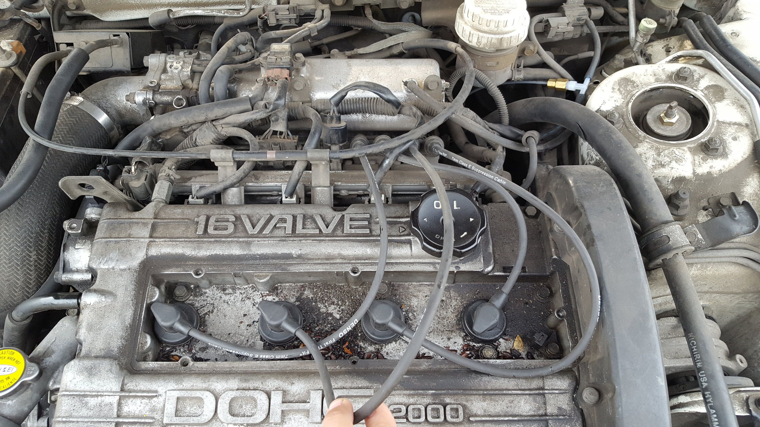

So here I am about to replace one of my ignition coils but as I take a closer look at things I see something a little troubling. All the information I see says that the plug order of the coils, from left to right as standing in front of the engine, is 4-1-2-3.
4-1-3-2!
Should the engine run as it does with this configuration? I'm tempted to swap the wires at the coil to the correct order. Not sure why this works as it does.
4-1-3-2!
You see that because its the same. Coils are paired. 4123 is the same as many other combinations
The first coil could be 41 or 14 and the 2nd coil 23 or 32. Doesnt matter. Any combination of that is the same.
Just finished the coil replacement and while I was there is switched 2 & 3 so the order is what it should be, 4-1-2-3. Ran just like it did before. So I then swapped them back to 4-1-3-2 and it ran just about the same. What Mello and pauleyman said makes sense so I'm going to run them 3-2 for a tank of gas then switch to 2-3 and see if the gas mileage changes. I'm thinking that's the only way I can see a change without any type of datalogging system.
