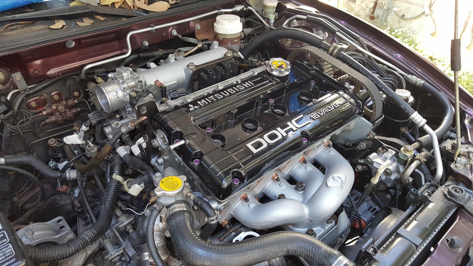

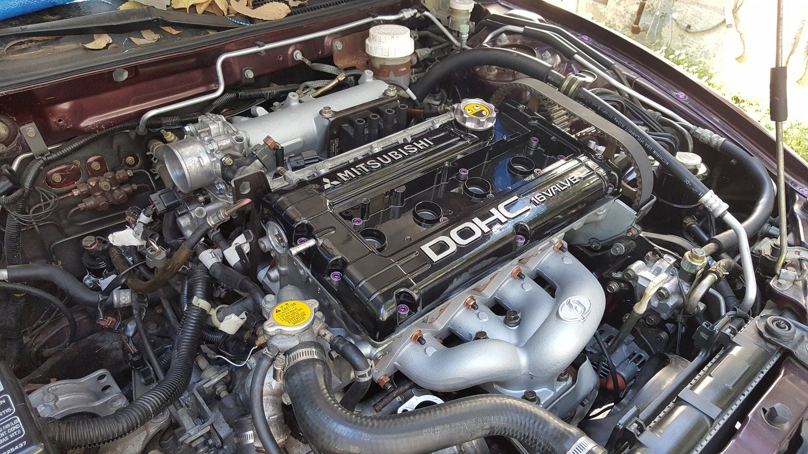

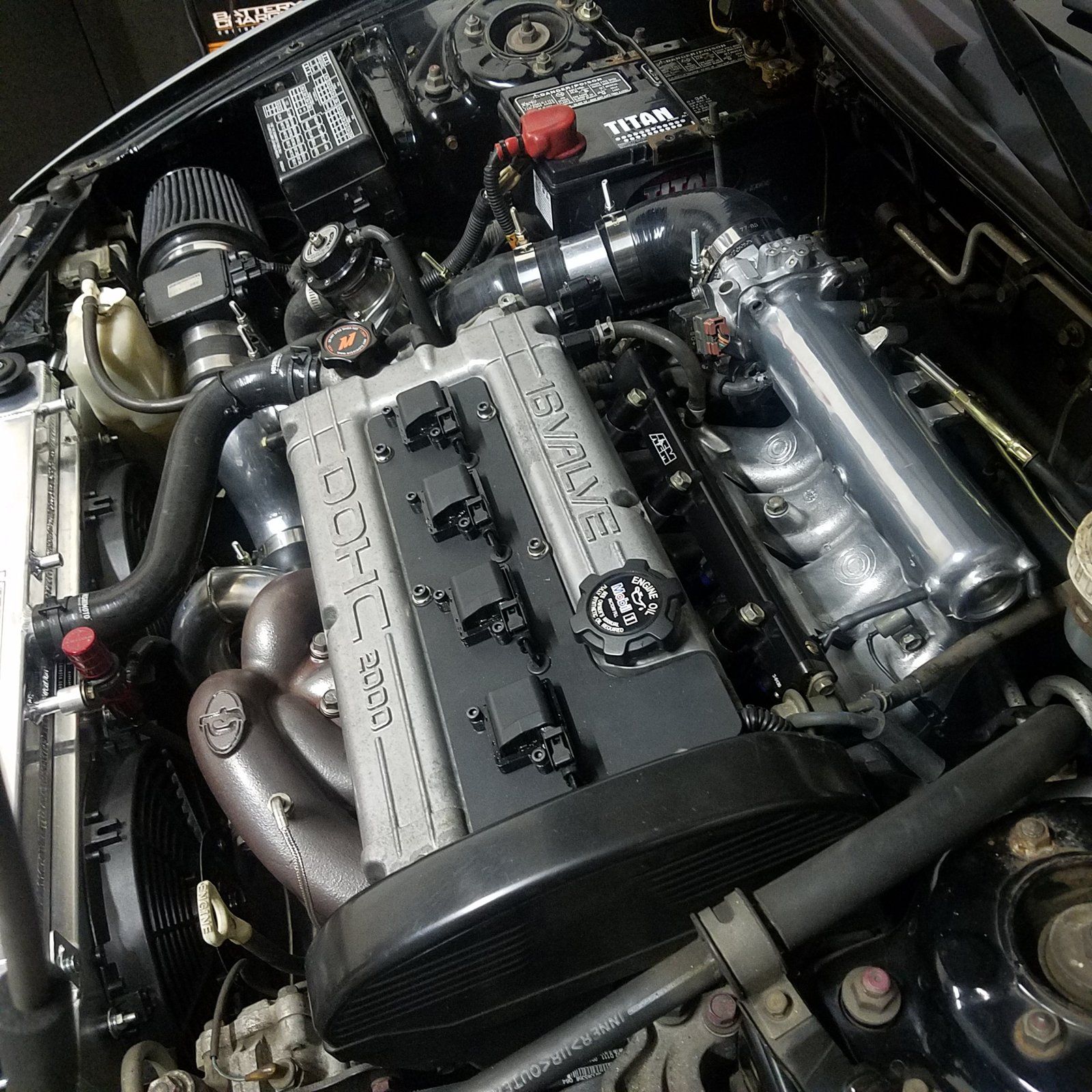

I run the evo 3 intake with 1g N/T TB and love it! I actually just shaved all the unused tab/mounting points off the intake manifold which was more of a pain than I thought. Keep up the good work!
Meh....
Lol. Just teasin ya man. Looks great! Love my Evo3 mani too. FP looks "pretty" :)
Aren't our motor pics a work of art? Lol
Keep us posted!
That's awesome man! I have yet to drive it and hit boost with my new setup because I need to get my upper intercooler piping welded, but when I do I'm sure I'll notice a difference! Have a link of yours shaved?

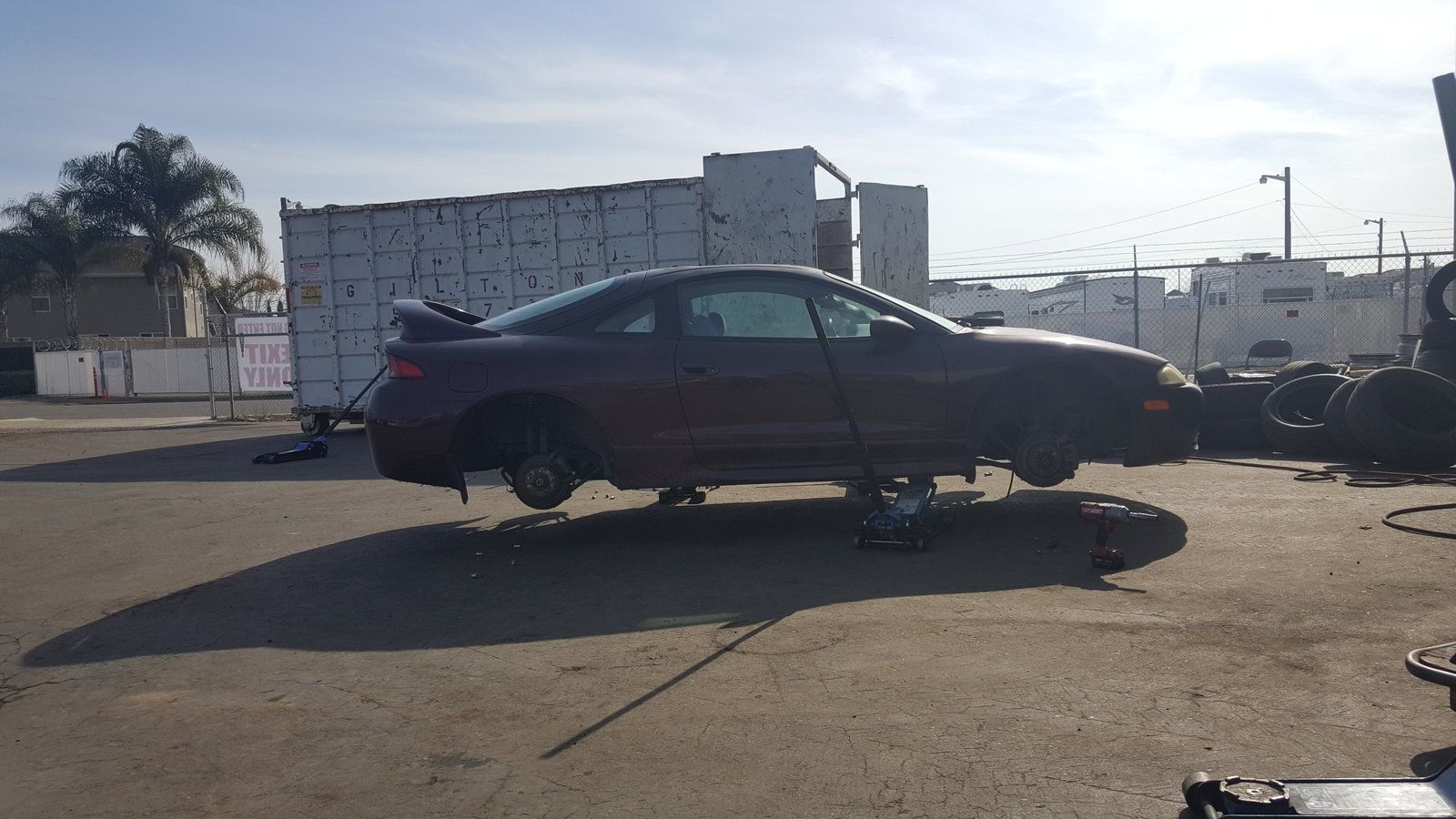

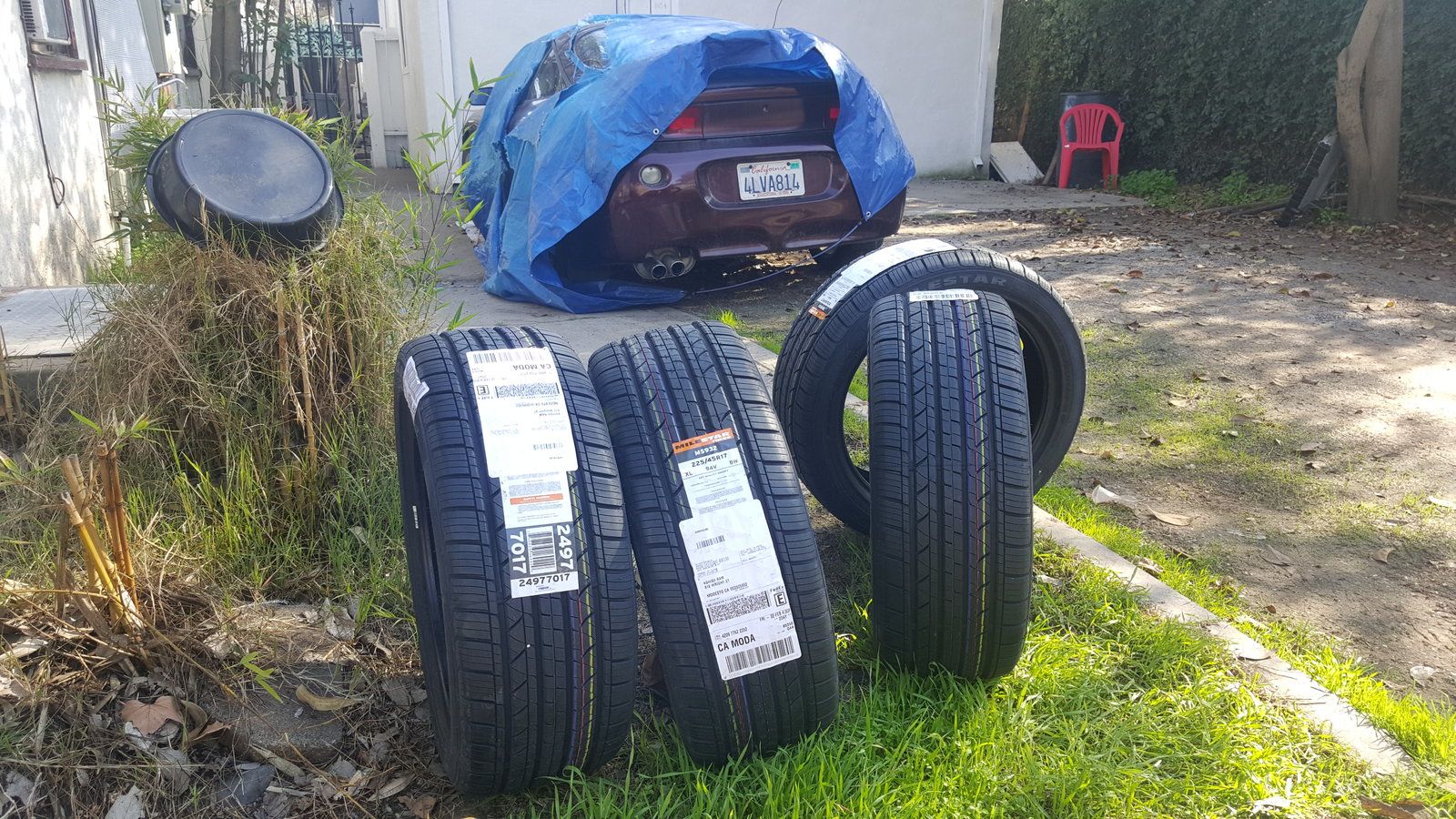

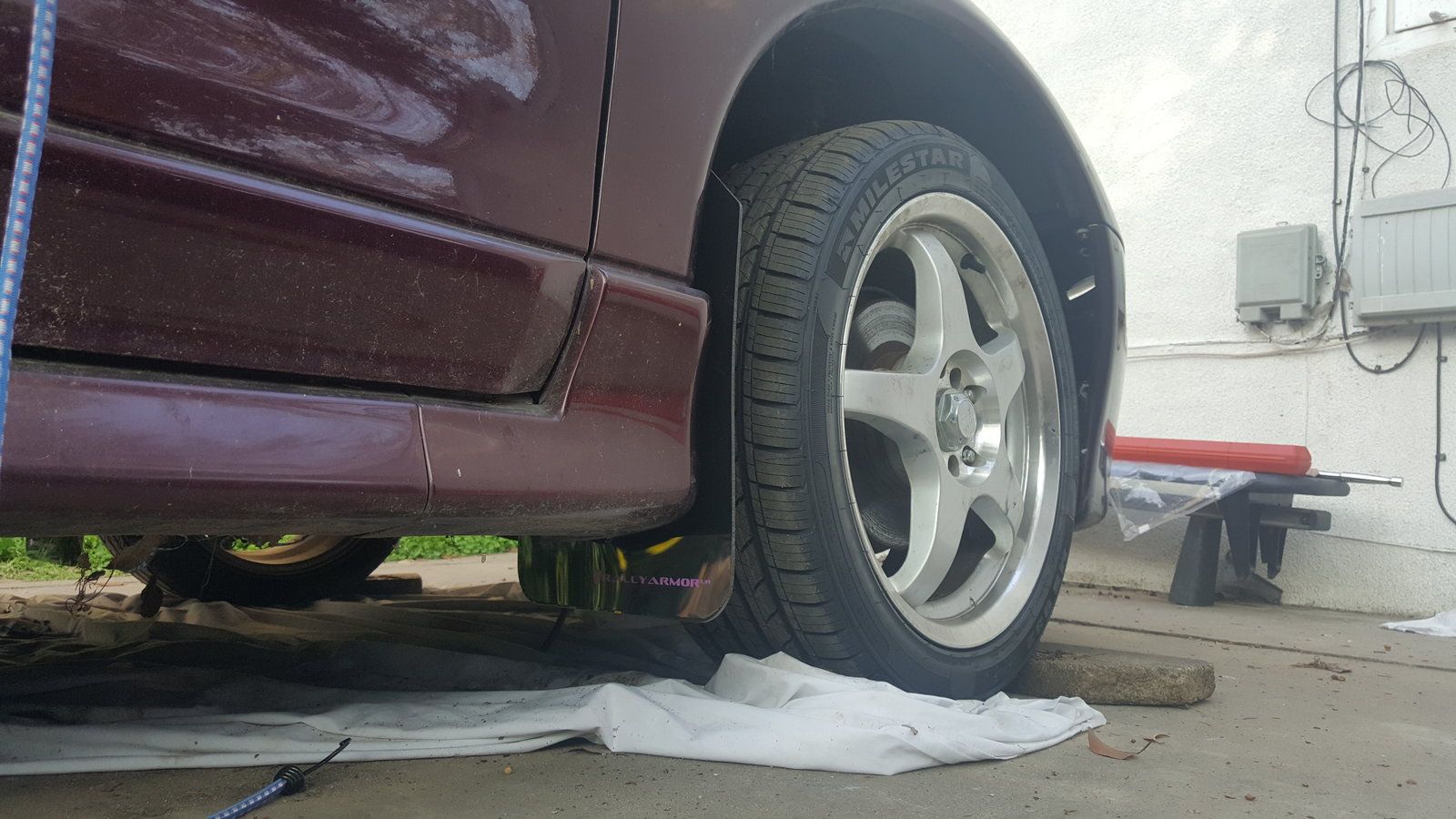

So because I don't have the funds for it and I just really need to start driving my car, I ordered some really cheap tires but they have extremely good reviews. Brand new 225/45/17 for $52 per tire! I'll let you guys know how they hold up for daily driving and what not.
I should have had amazon package them because the truck driver literally left them in the back alley and I get a LOT of homeless/sketchy people walking back there and stealing crap. I check my delivery updates and see that it's delivered but nothing at my front door. Thank goodness I was home! Lol
^^ Here she is getting tires on after 5 years of sitting and no driving.

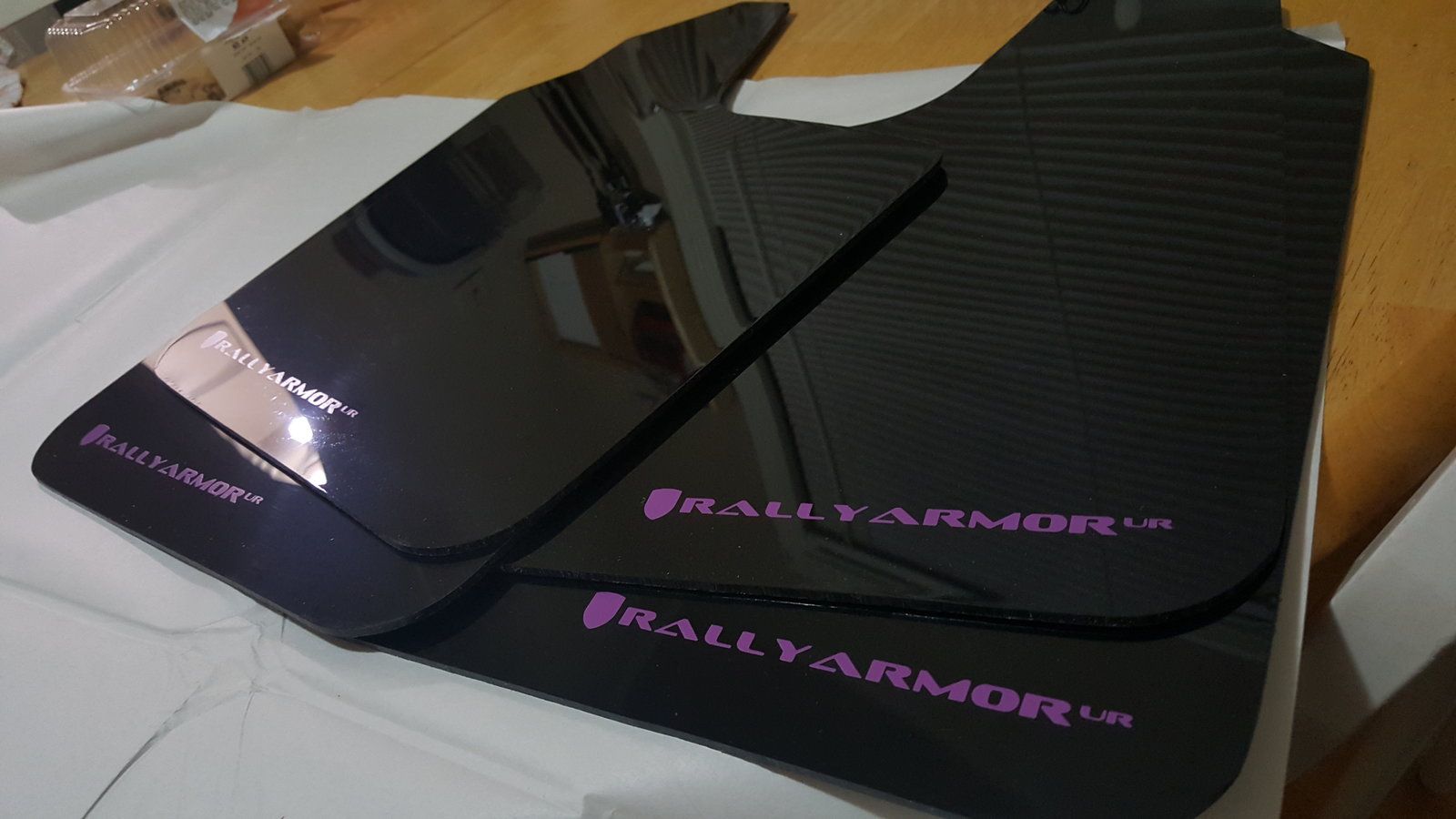

Bringing these back LOL had these sitting brand new for years I figured I better install them now or else I never will haha. Got these Rally Armor mud flaps custom done :D

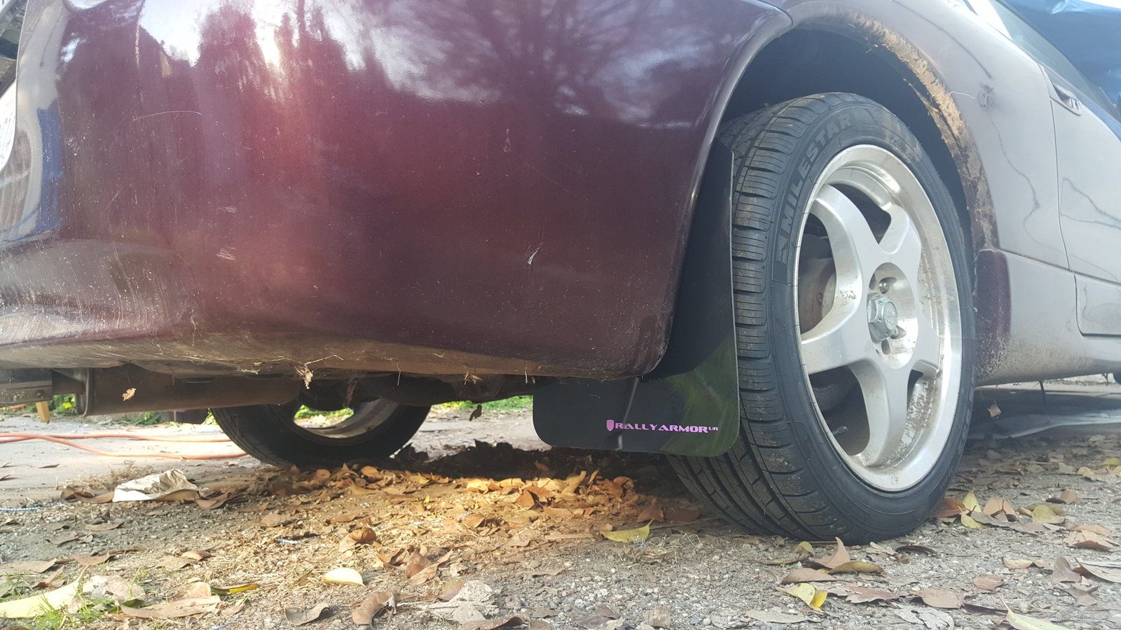

Installed I think I got them pretty much as close to perfect I could given my OCD. The front driver's side is angled a bit more but no one notices but me. YET IT STILL KILLS ME!!
I know I know: HOLY WHEELGAP BATMAN! I really hope to get rid of that issue soon with some coilovers =/

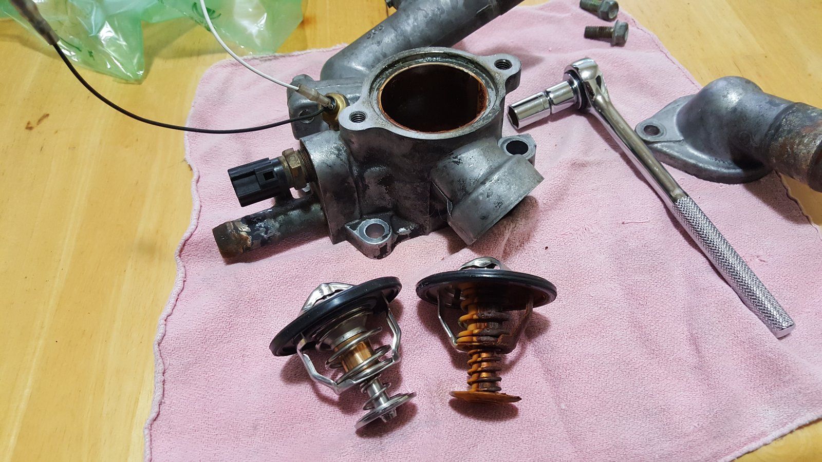

Running the GATES Thermostat part number 33987. A member here did a test on numerous thermostats that were advertised for 170 and 180 and his car ended up running at 203 to 206 on the highway. This thermostat cracked open spot on at 180 and his car ran at 196 on the highway. So this is what I'm running:

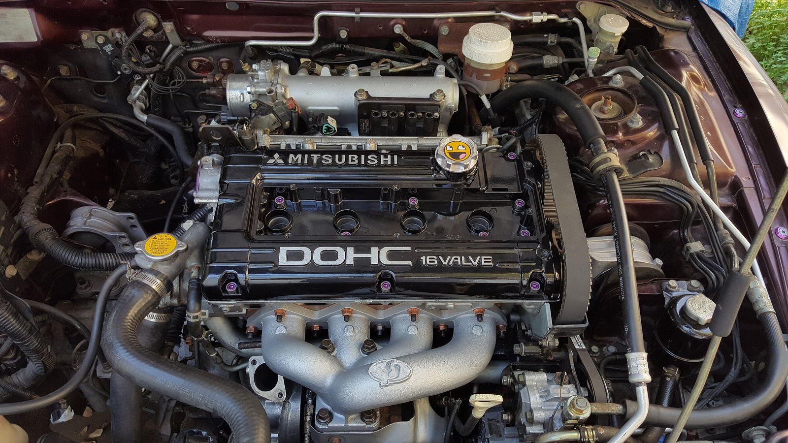

Starting to look pretty again :)

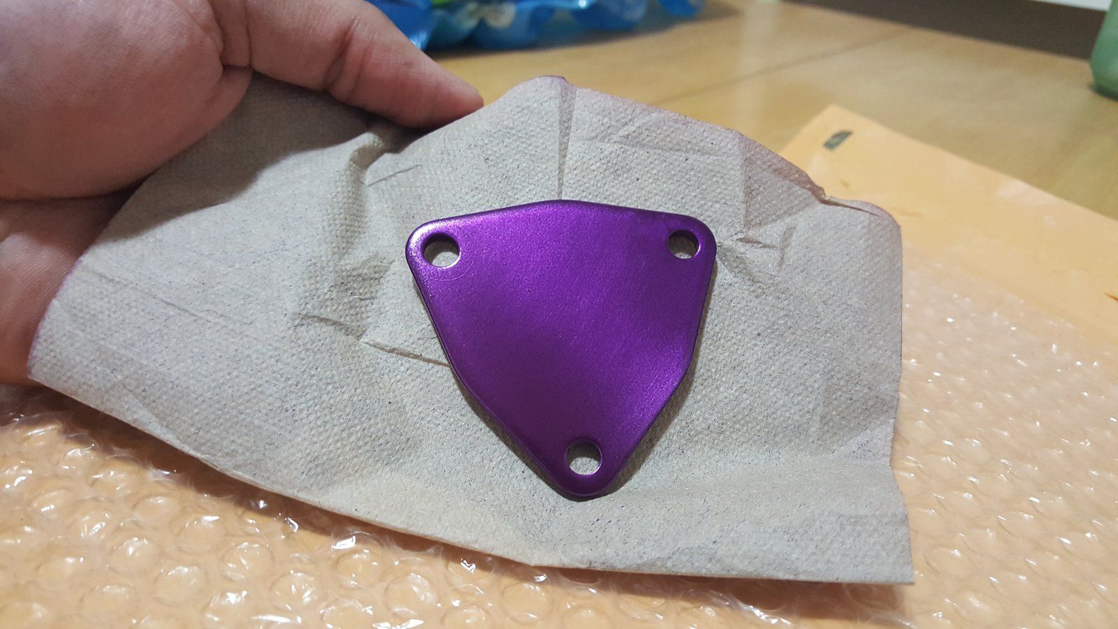

These are pics from before the throttle body was rebuilt
Nice purple!
I like how you've utilized peer resources throughout your build. Good job on doing everything yourself regardless of where you have to do it. It's how I built my first racecar.
Nice purple!
I really appreciate the compliment! It's been very very difficult but I knew it would make me feel that much more accomplished when done. Thank for acknowledging the effort as it means a lot!

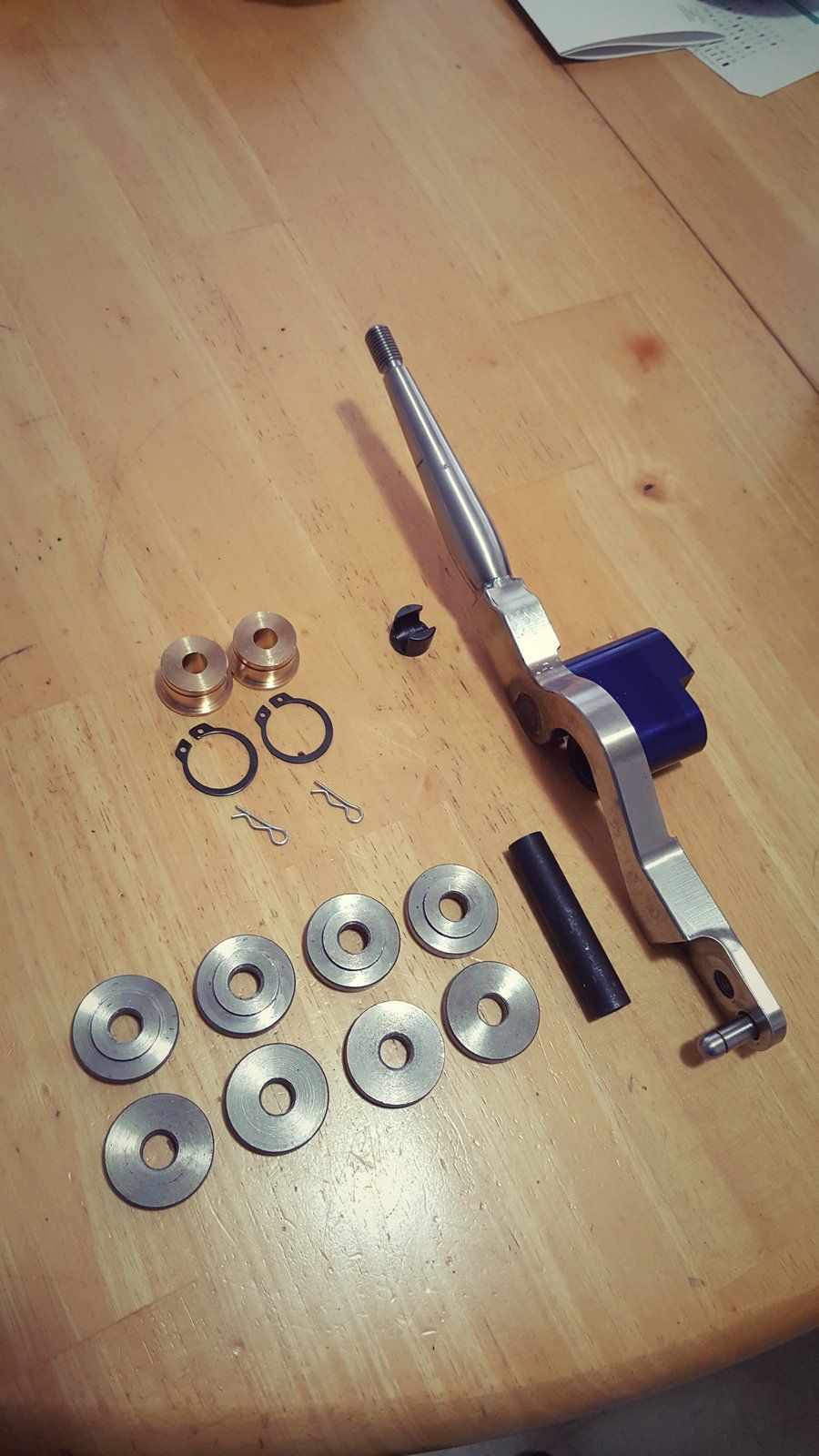

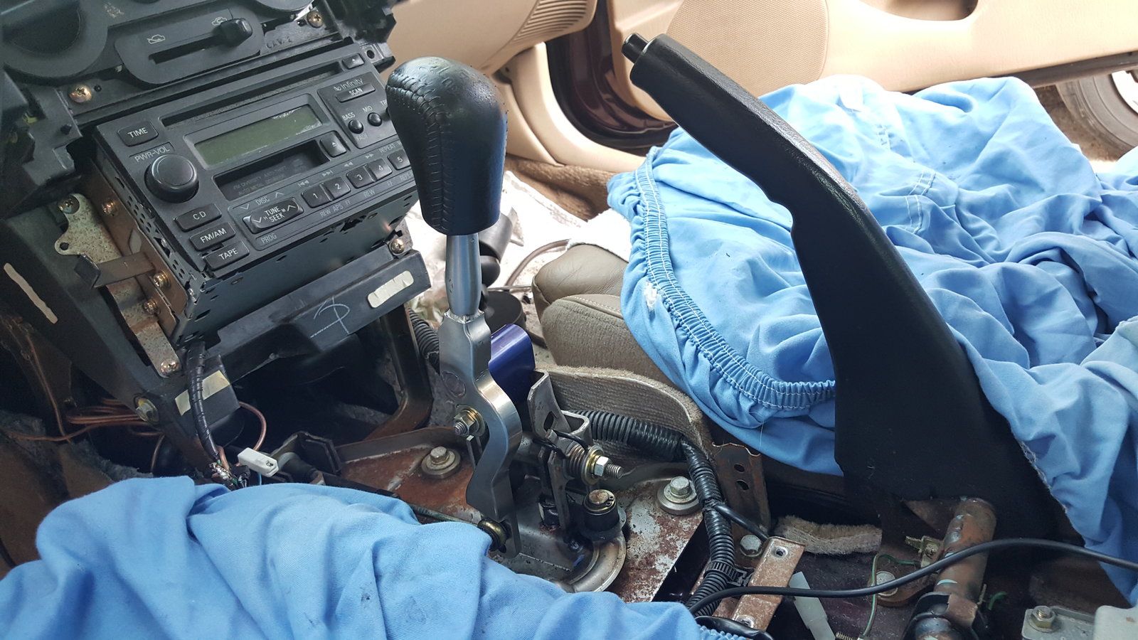

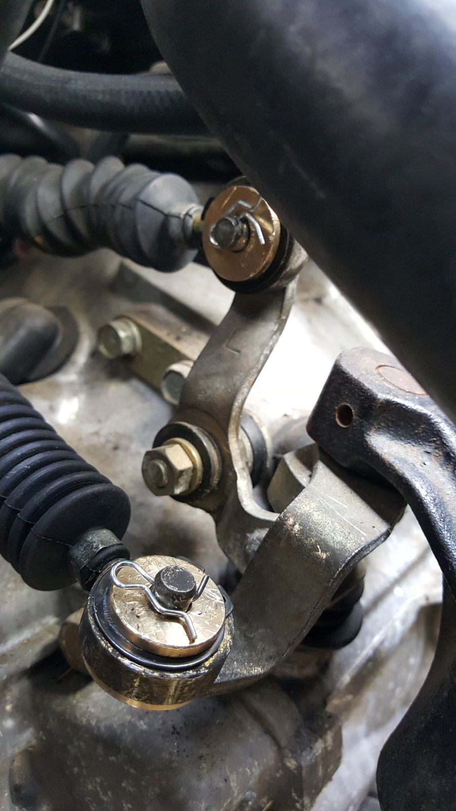

Finally got everything I wanted to complete my shifter setup! Scored a genuine B&M shifter for a steal! Had to pair it all with some new brass shifter cable bushings and solid shifter base bushings from extremepsi!

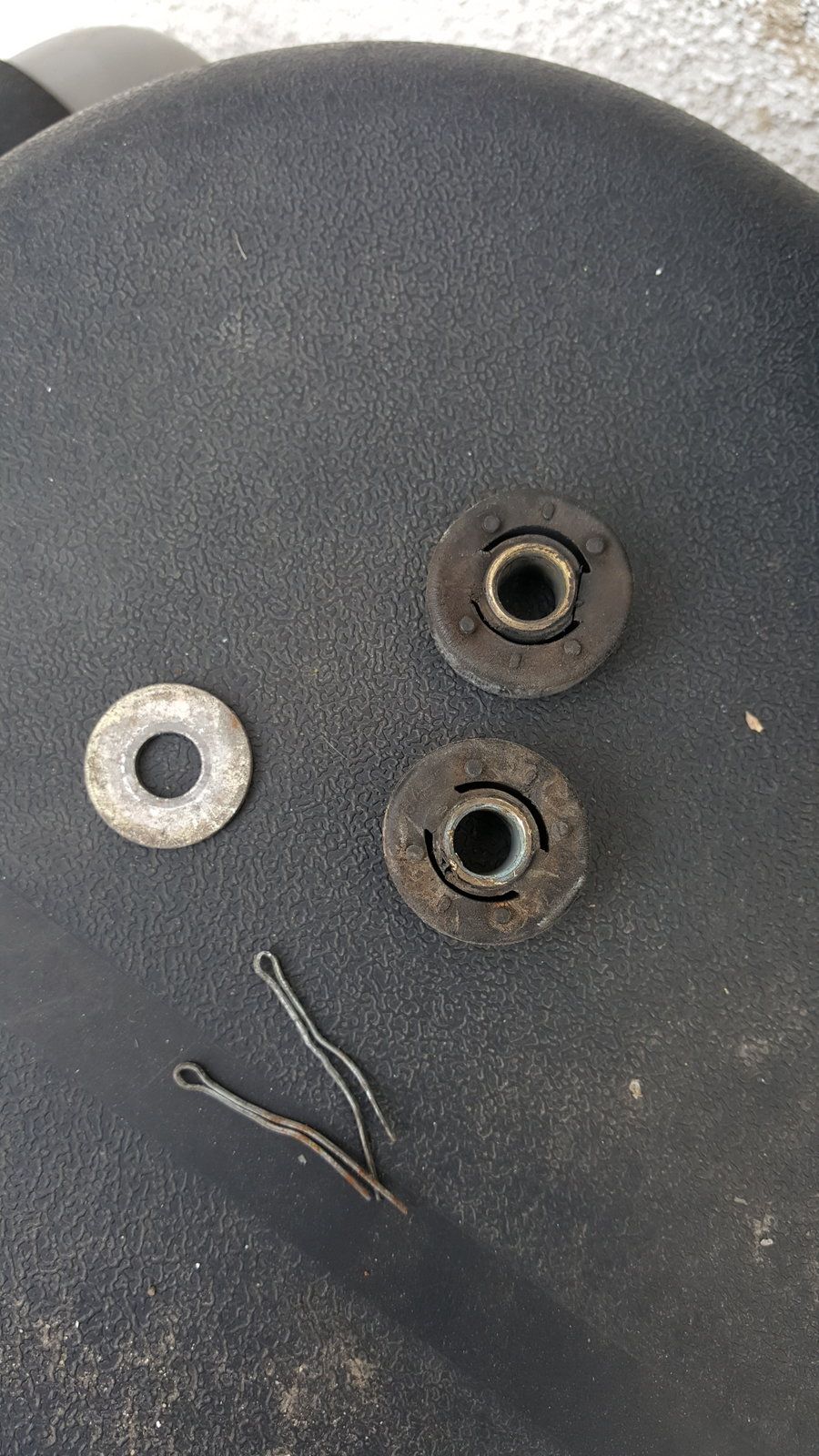

The install with the cable bushings was a PAIN for one of the bushings BUT I made sure for a proper install (sanded down the posts and used some dry graphite lubricant)
The old worn out rubber bushings:
New bushings:
Install of the B&M shifter and solid base bushings:

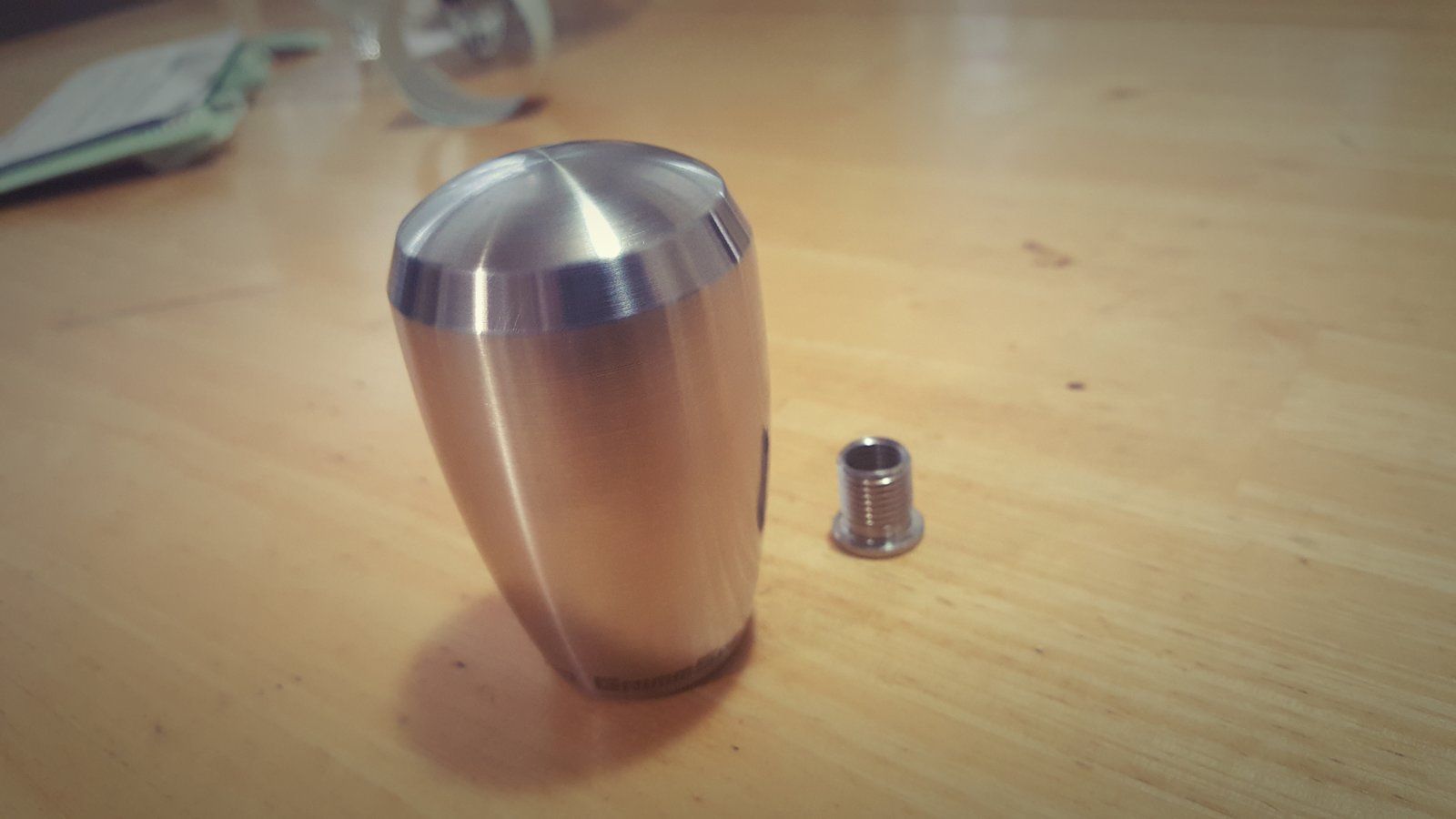

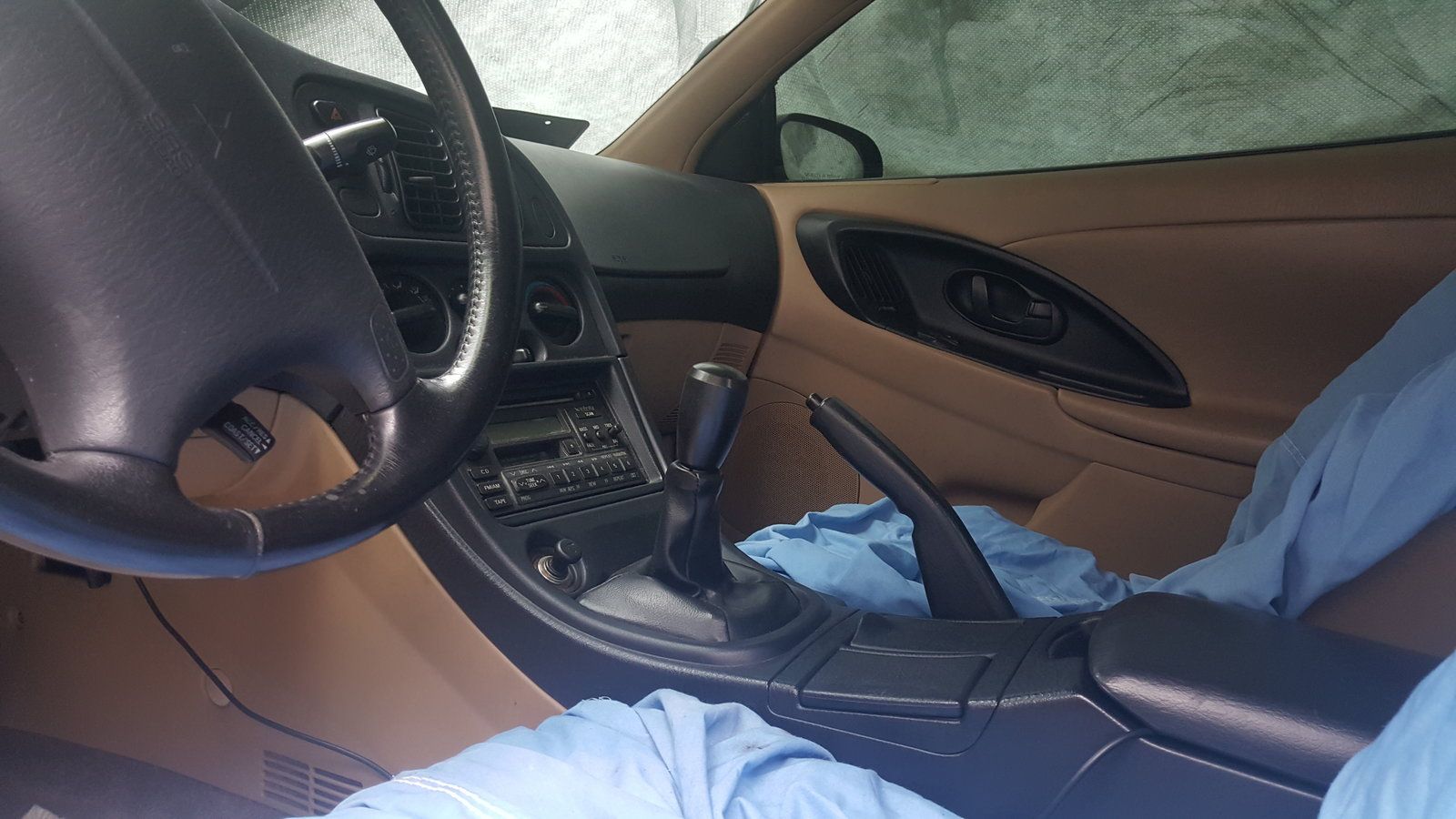

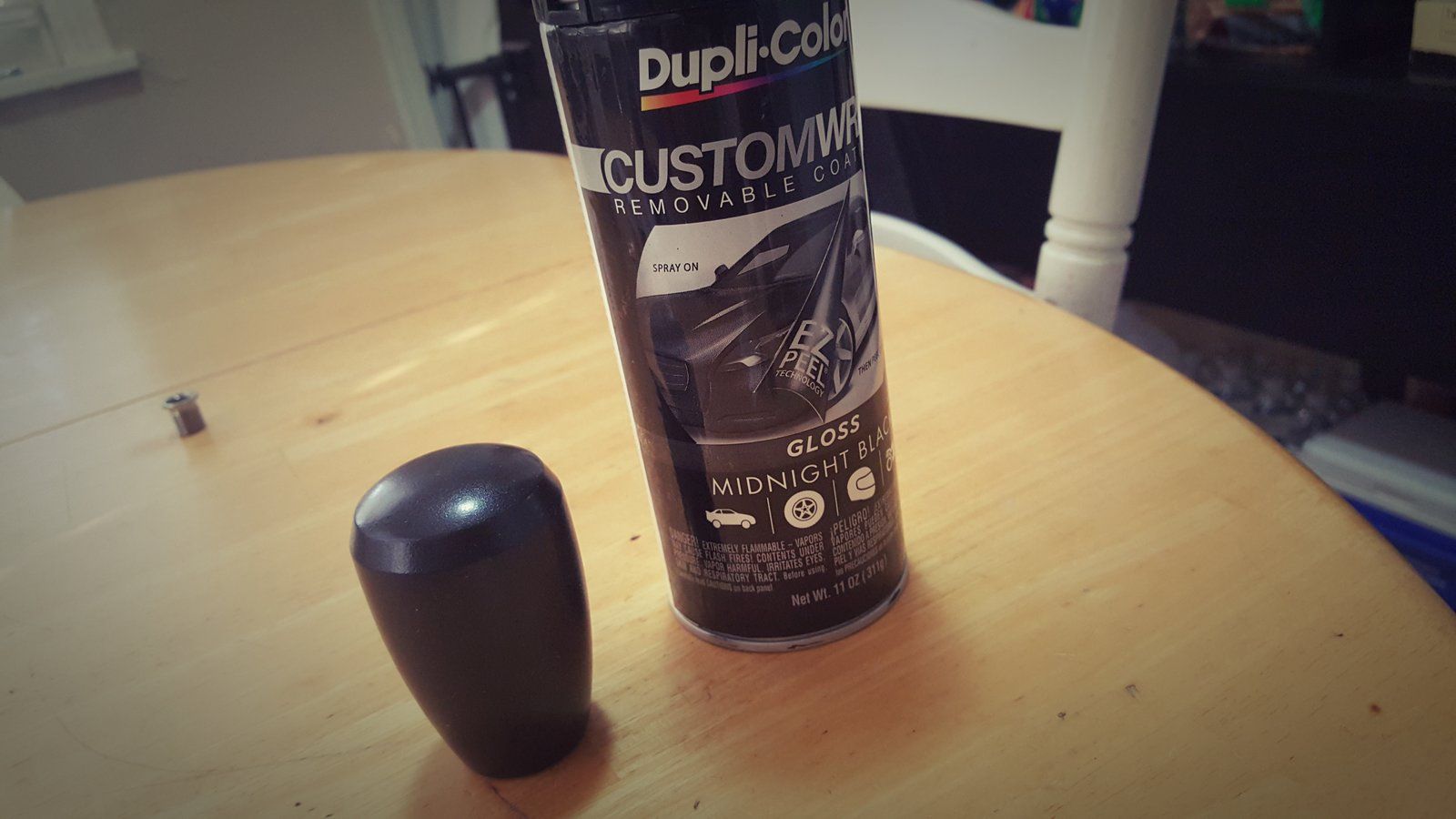

Now I LOVE my OEM shifter knob but I REALLY wanted a nice weighted one. Soo I ordered this! Weighs in at.. Wait for it... 675 grams!! OEM is 355-396 grams I believe. So this thing is HEAVY
First thing I wanted to do was paint it to get it to look OEM so here's the after:
I was SO happy with the final outcome and OEM look. Here's the finished setup:

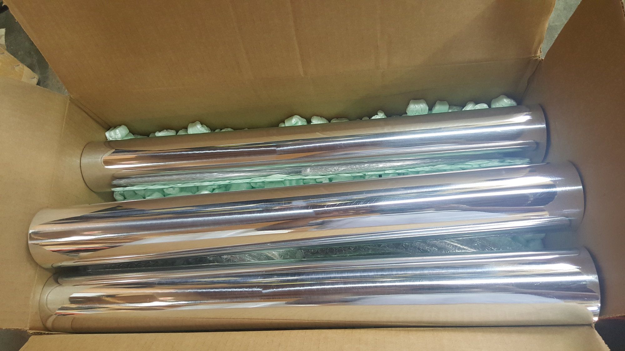

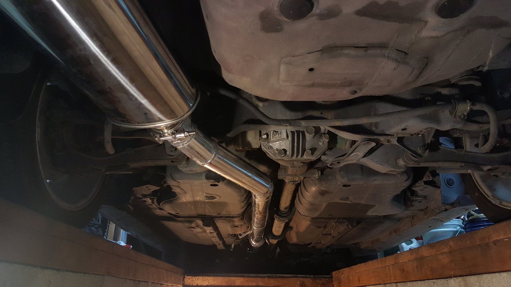

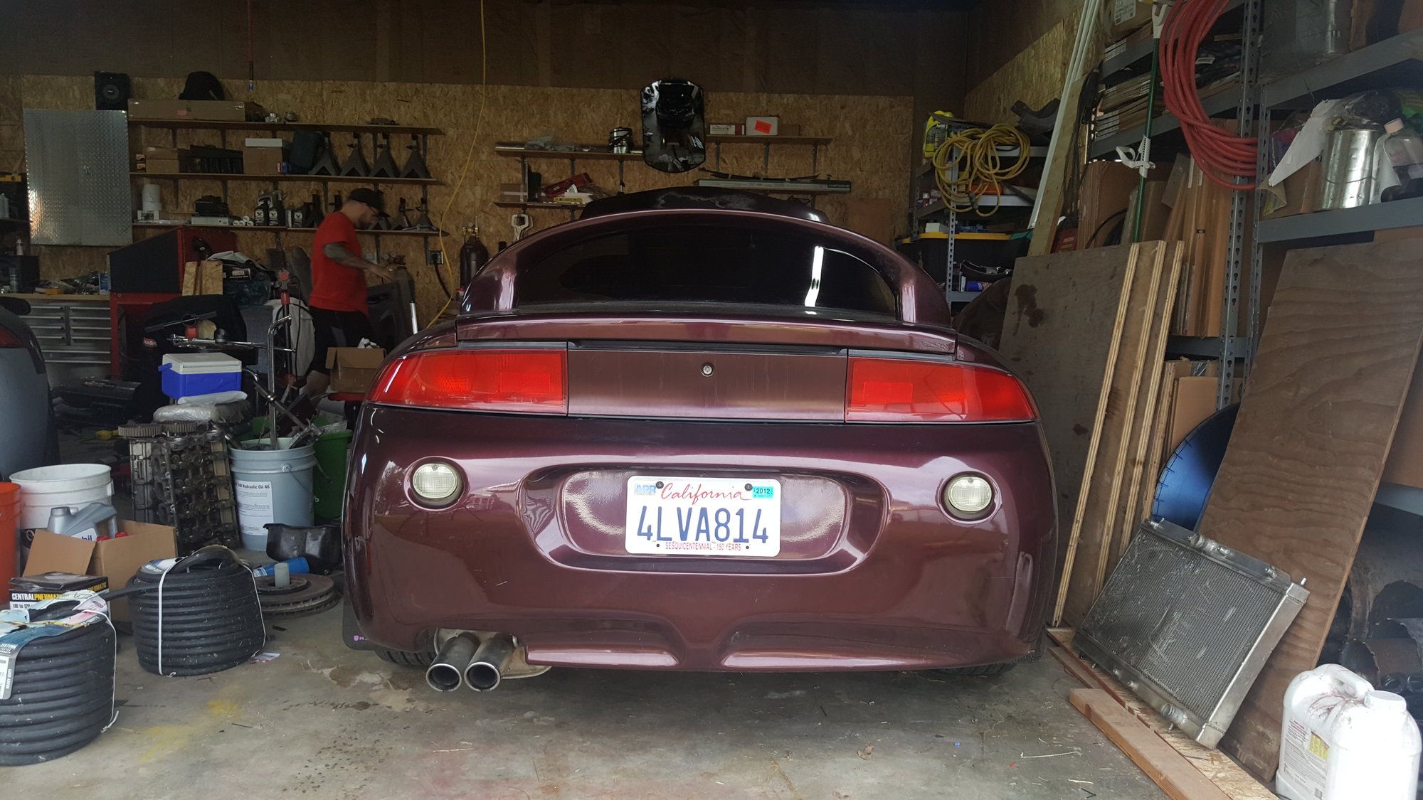

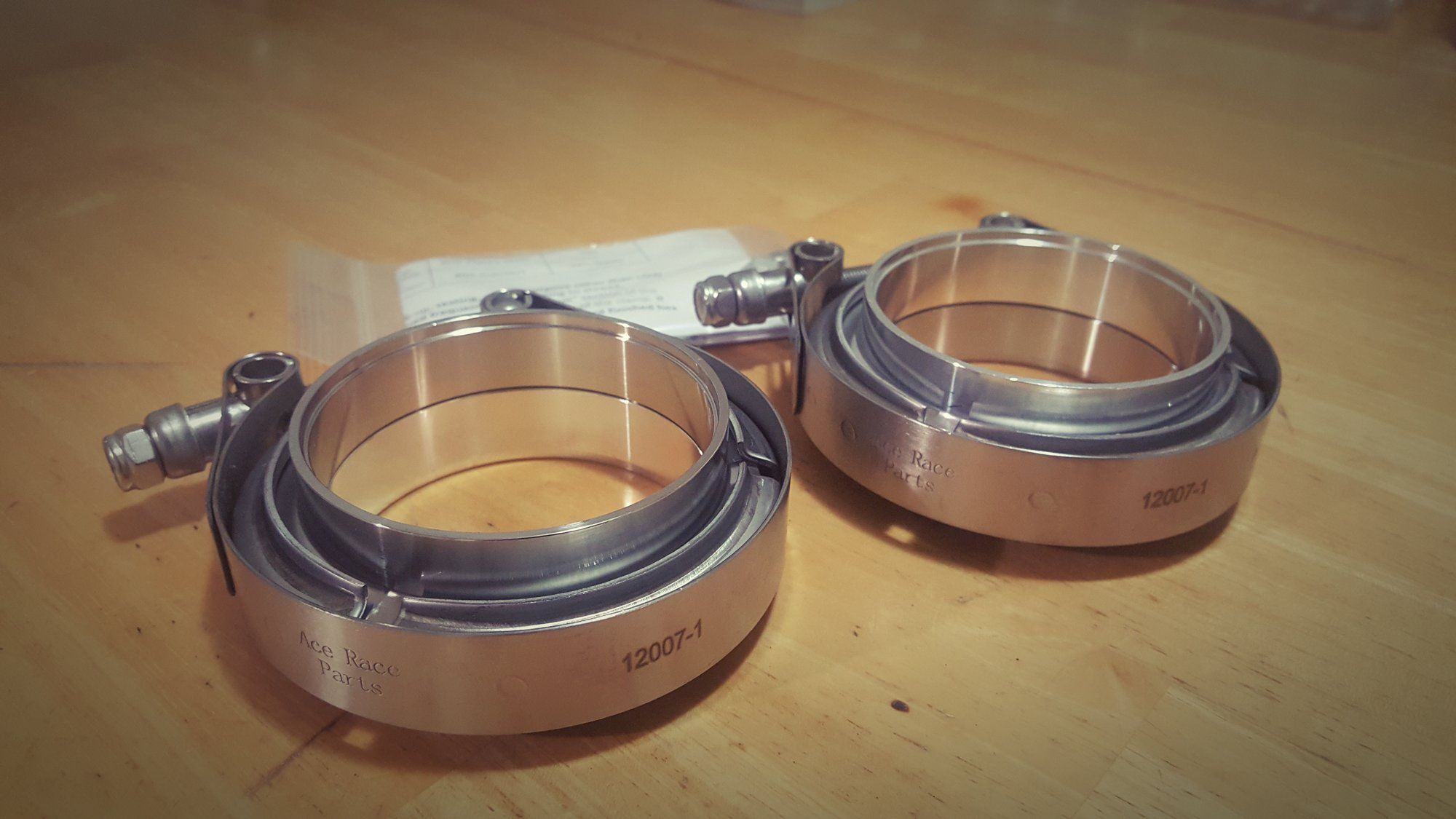

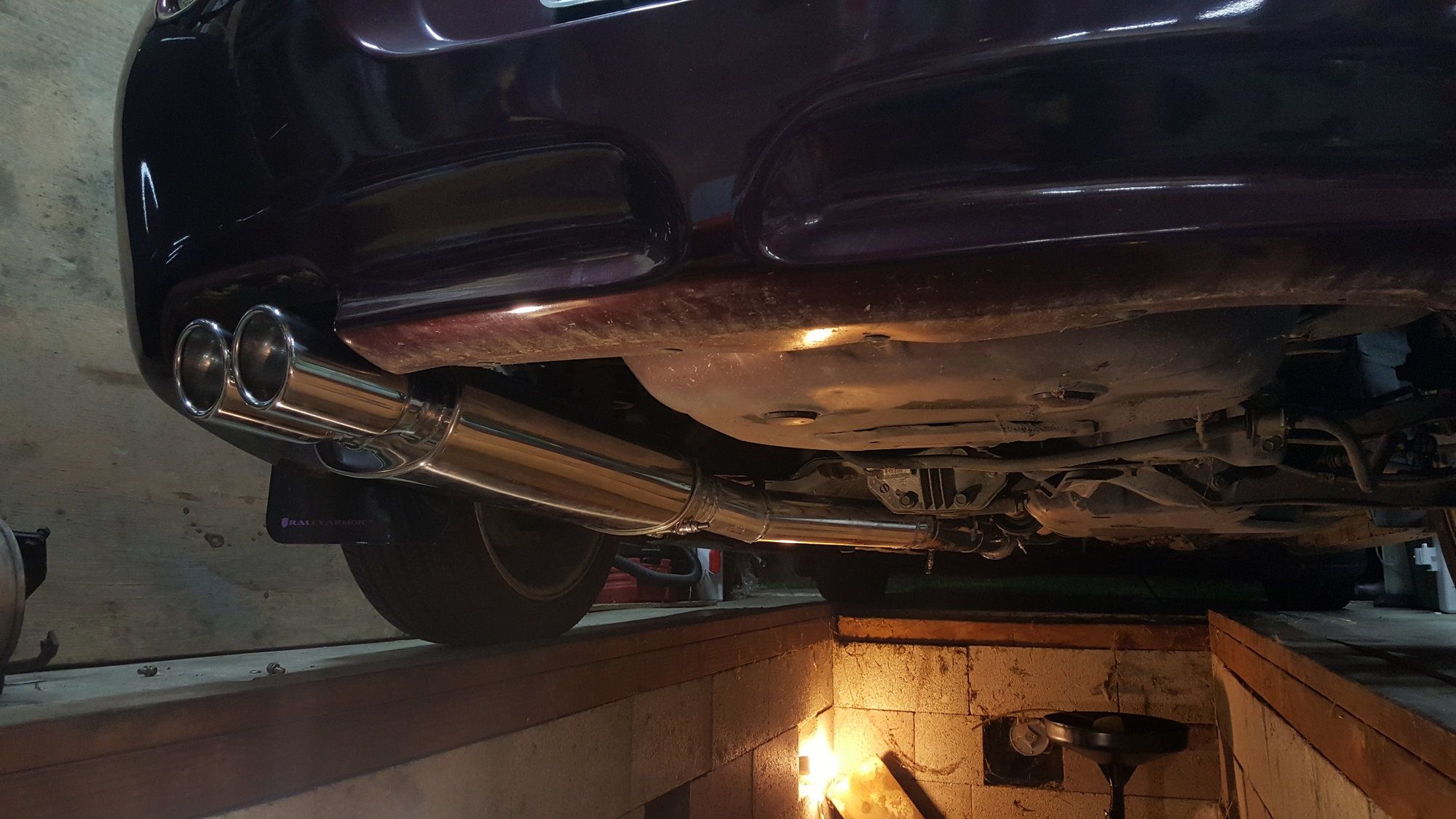

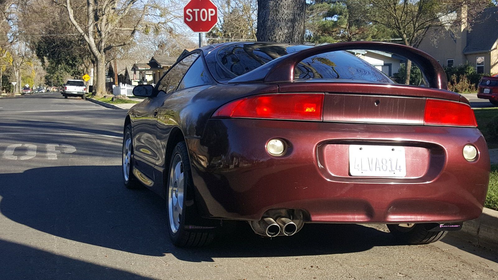

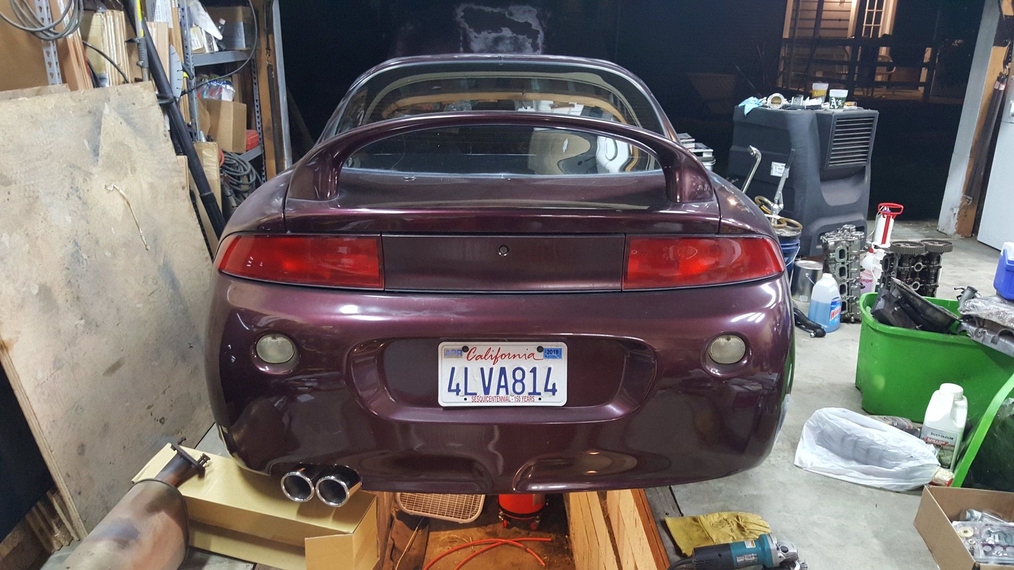

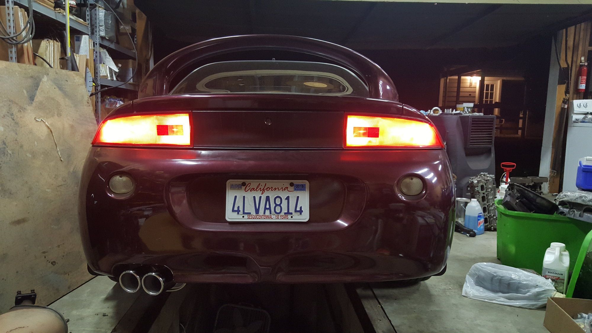

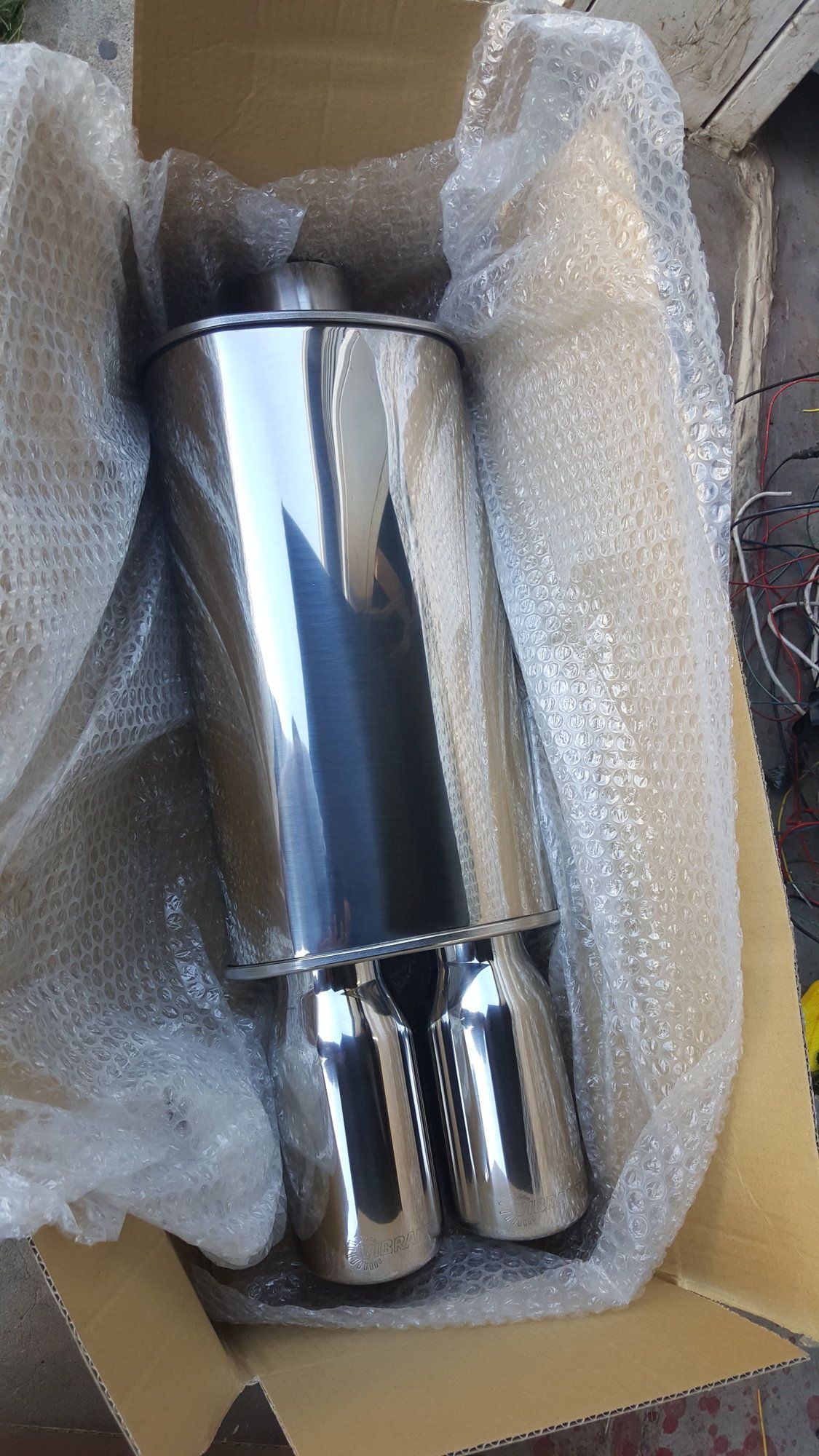

Finally, a buddy of mine had time to work on my car. I've been wanting to get my exhaust done for a while. My goal was to have a light-weight exhaust system. So, I decided to do an aluminum exhaust.
Parts:
You're gonna love the V bands, I love mine.
So how's the aluminum sound? Is it tinny since its aluminum or is it normal?
Hey Marty, honestly I don't notice any difference but I think its because the muffler is ss.
However, when we had the piping done to about a ft away from the muffler (not connected to the muffler) I started up the car and I guess you could say it was a little more tinny if anything. It sounded SUPER nice though. Just revving it sounded like a big truck with those huge turbos that spool very loudly! Wish I could have left it LOL
Keep in mind I only have a 16g haha

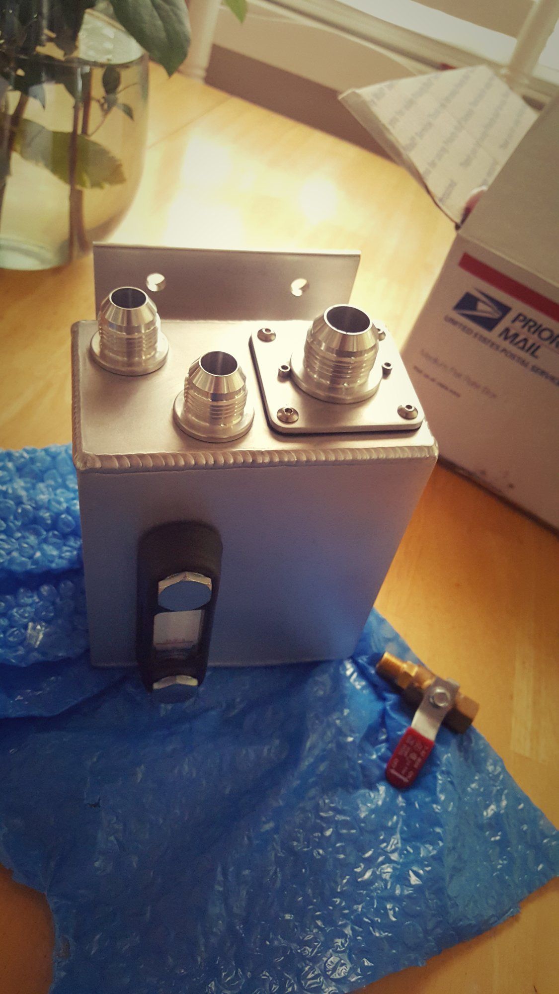

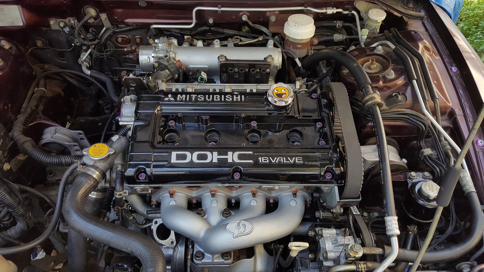

Been a while but I finally got time to work on my car since school is done for the semester and I've finished an entrance exam. Figured it was then time to FINALLY install my Calan VS3 Catch Can I've had sitting for years brand new!

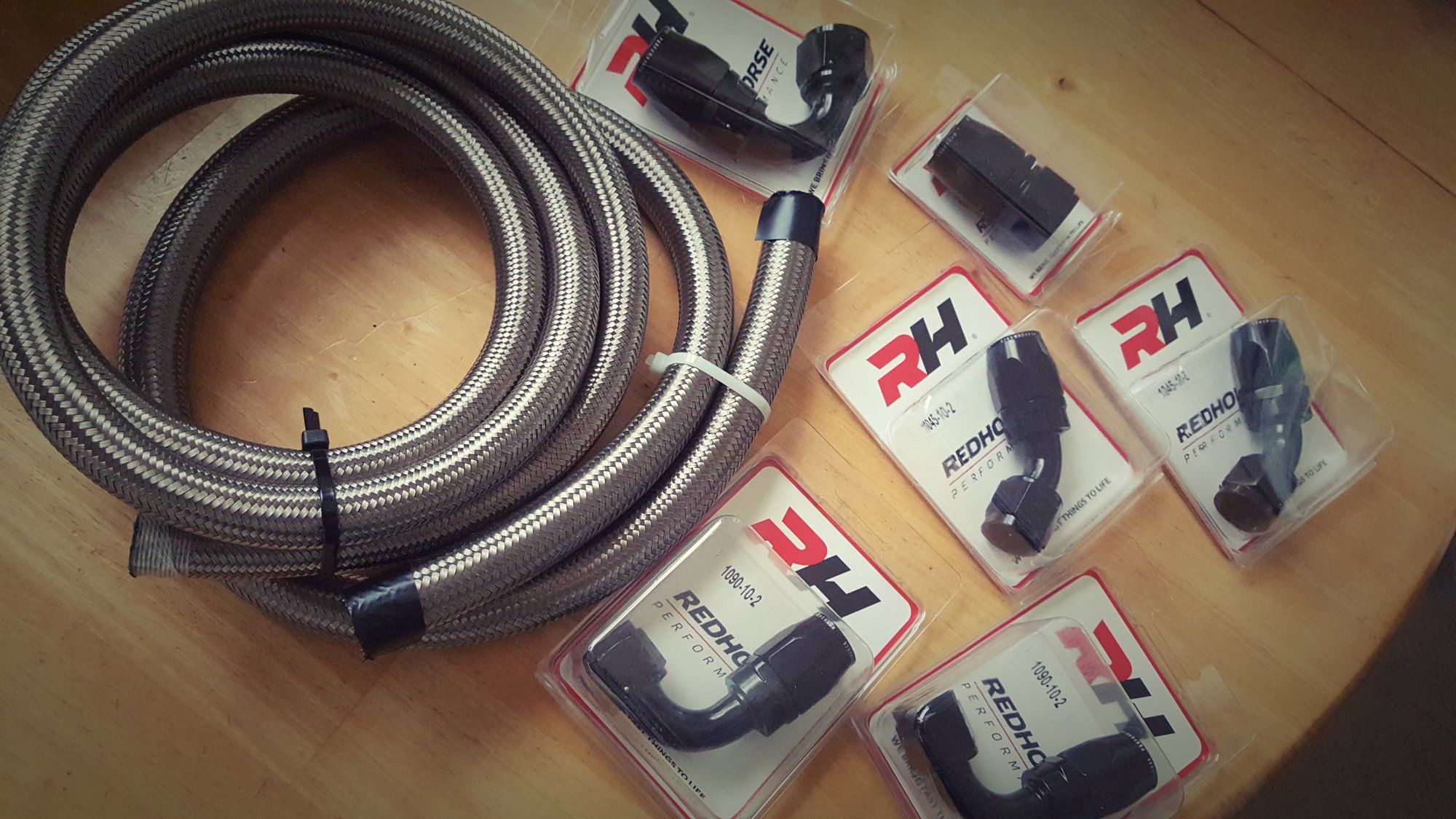

Also, ordered some SS lines and a couple of 10 AN and 12 AN Fittings from Red Horse Performance (Labor Day Sale!!)
Also, had a Valve Cover sitting for years brand new that was FINALLY installed for this setup as well. After numerous OCD measurements and all of my other issues with perfection, I finally finished. Fittings just BARELY clear my hood from contact when the hood is closed. All in all, I'm very very happy with my setup but I can honestly say my taste has changed since the years have passed and I prefer my black VC :(
But oh well, it's still pretty and if ever needed, I will powder coat of black again :cool:.

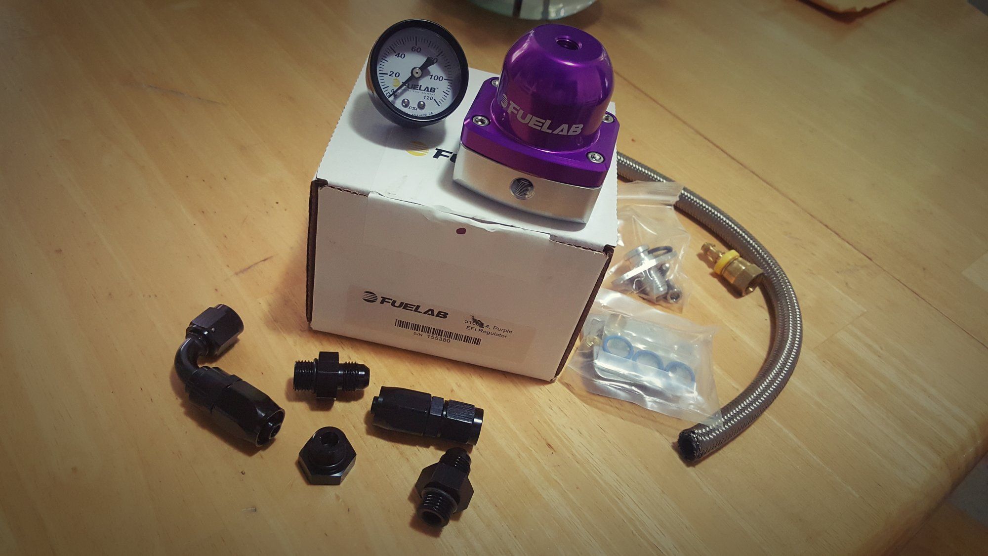

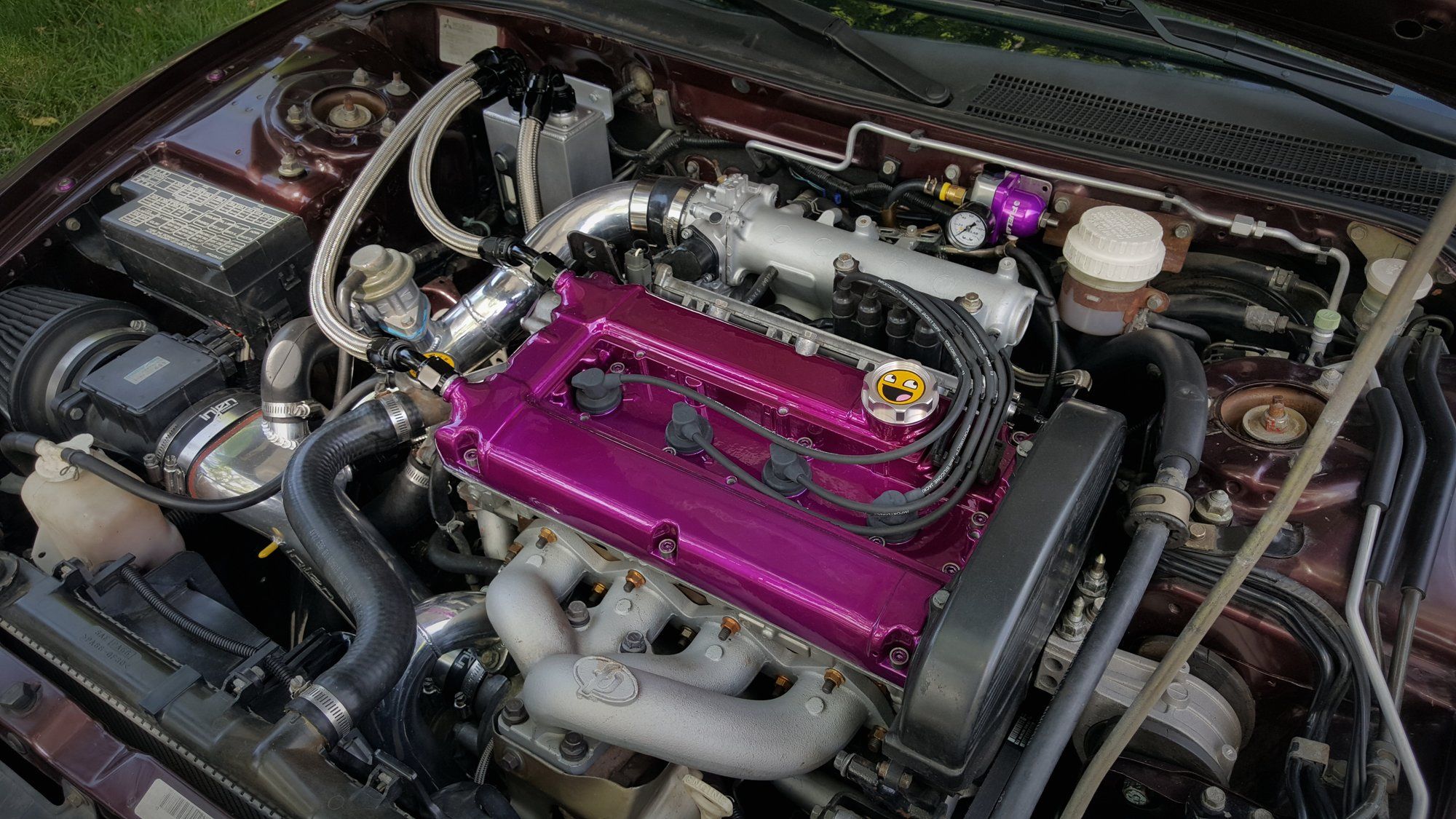

Lastly, I also decided to start on my fuel set up by installing my Fuelab afpr. Since I had a day to myself to figure it out, I figured why not.
Finished product:
