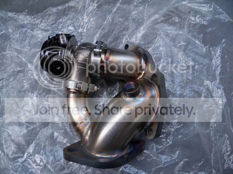

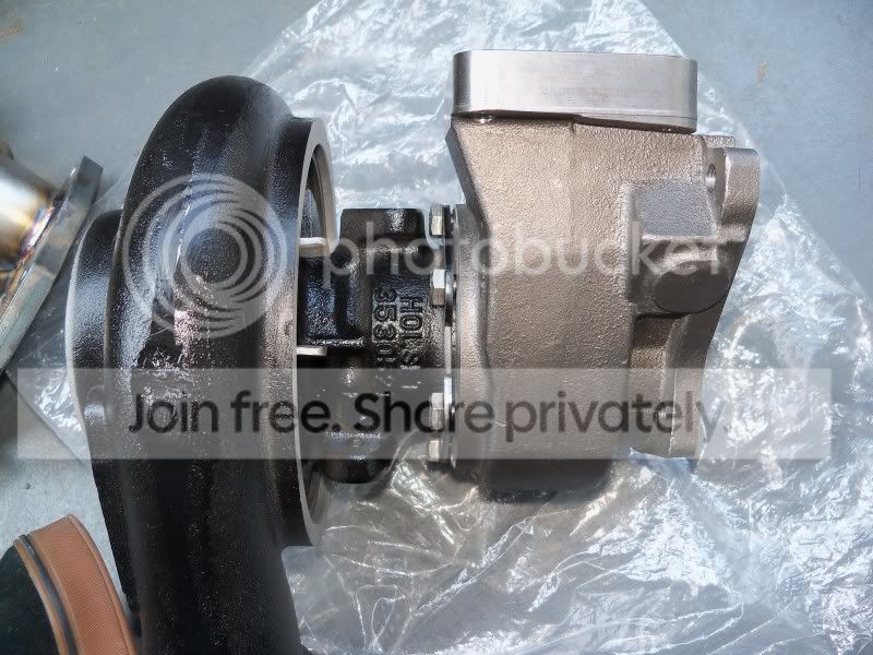

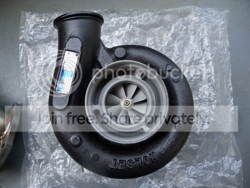

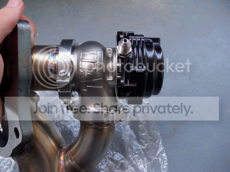

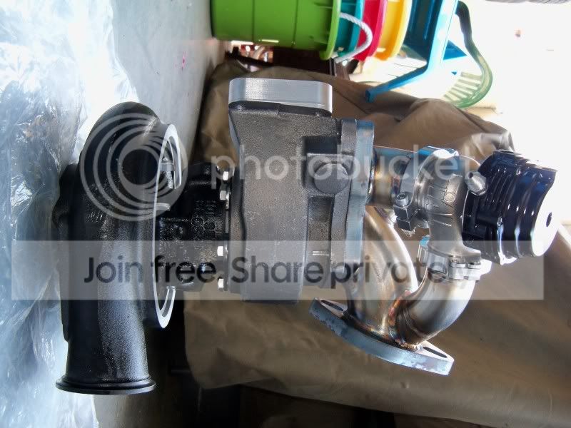

Here are pictures of the new components, Install pictures will follow when I have time to put it on.

And I know I could have gone cheaper but I didn't want an external at all as California is hell for modified cars if the cops can see the changes so I wanted the MV-S as it is packaged pretty damn small. On my friends 1G it actually looks pretty stealth under the heat shield he made.

The turbo had more shaft play than I was comfortable with. The compressor wheel was getting close to being able to hit the housing. A few of my friends have run Hholsets in the same condition but I just didn't feel good about it.
