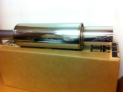

here it is i was thinking about that HKS because a friend of mine has a TSI AWD and he knows about dsms, he suggested that exhaust, but i just dont wanna sound like a honda no more :barf: , and i dont wanna rush that turbo intall

The only thing usable for you from that system is the muffler. None of the hangers are correct and the flange wouldn't even bolt to your convertor/test pipe. Just buy yourself an HKS muffler and weld it on if that's what you want. You gest the most performance benefits if the entire exhaust is the same diameter. You don't want to size it up and down repeatedly and have weird bends.

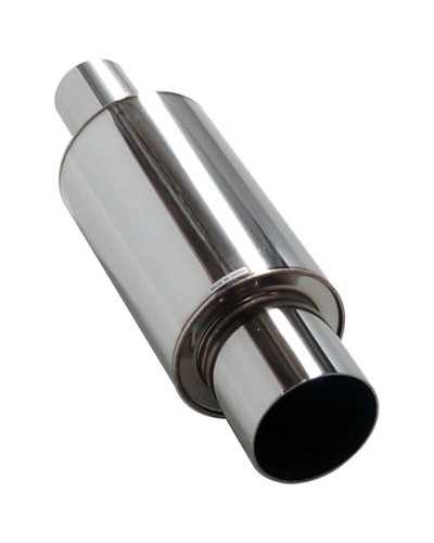

this one what do you think about it? will it help my honda ass sounding car? :barf:
My setup is 3 inch from front to back and it's not loud at all and it definitely does not sound like a honda. If you don't go turbo take any recommendations from BLACK'98DSM I beleive he is na and without a turbo you may want a quality exhaust.

damn it :banghead: where can I get like a real HKS then, no burnt tip :nono:
You can buy straight from their website, or you can use the site to collect the part number and search elsewhere. Just be careful of large price differences as those are probably knockoffs.
