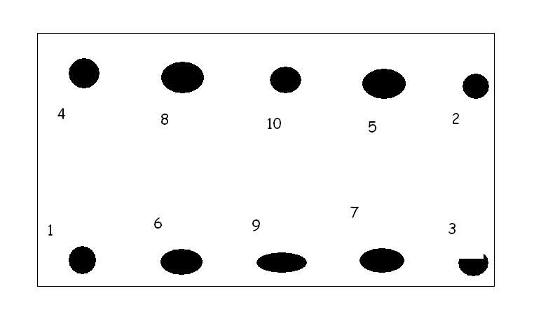

Disconnect the negative terminal on the batery, disconnect all fuel/vacuum lines and connectors going into the head/IM/EM, etc then remove the timing belt (It would be a good time to change it too if you haven't. Check out http://www.vfaq.com/mods/timingbelt-2G.html on info in replacing the timing belt), and then remove the head studs in the proper way (Screw them back in the other way around. Replace 10 with 1, 9 with 2 and so on). Also keep in mind there are other ways to screw and unscrew the head studs, this is just one of many (Sorry for the shitty drawing):
http://i17.photobucket.com/albums/b81/Starscream808/Headstudsscrewpattern.jpg
